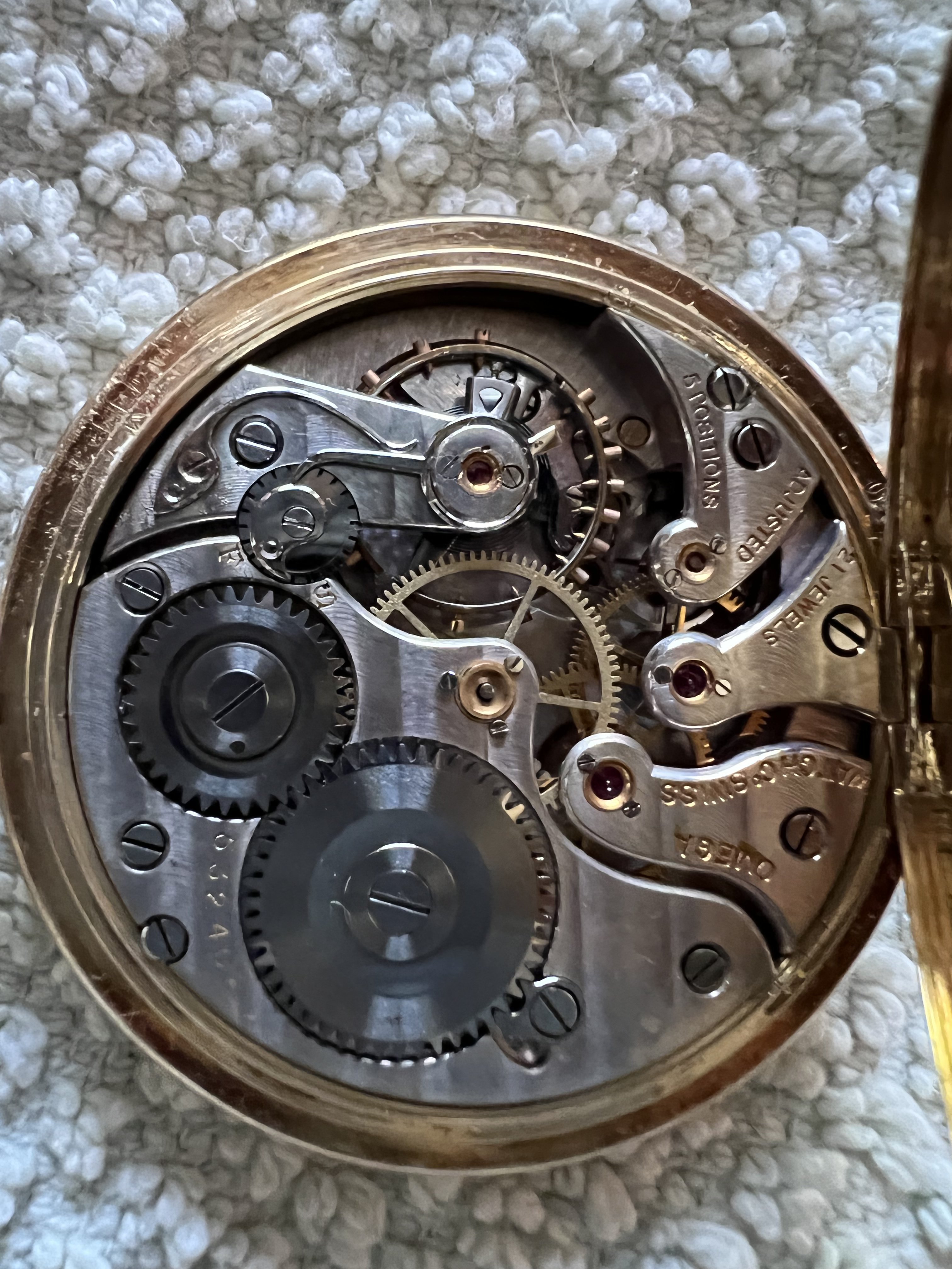

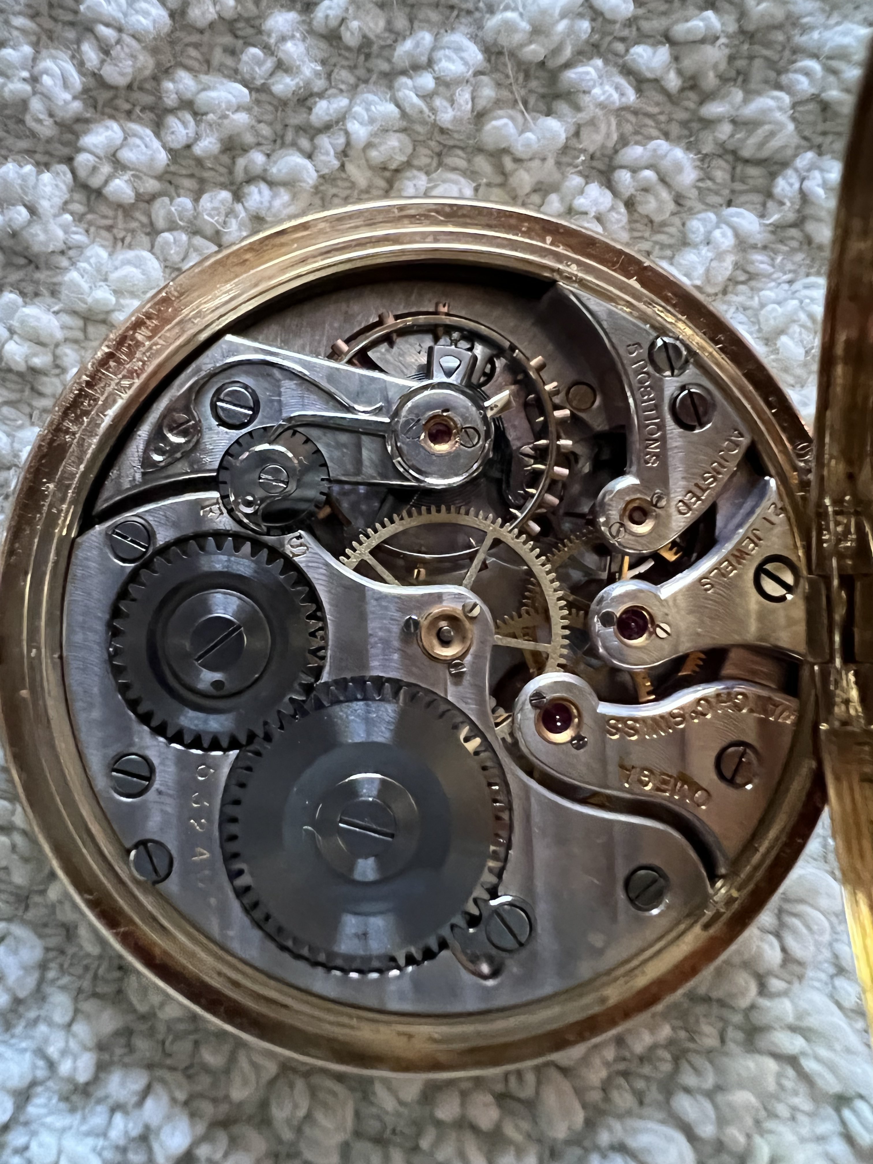

Well my literal mind misunderstood the 11 o’clock reference. I found the tab and opened it, here is what I found so far.

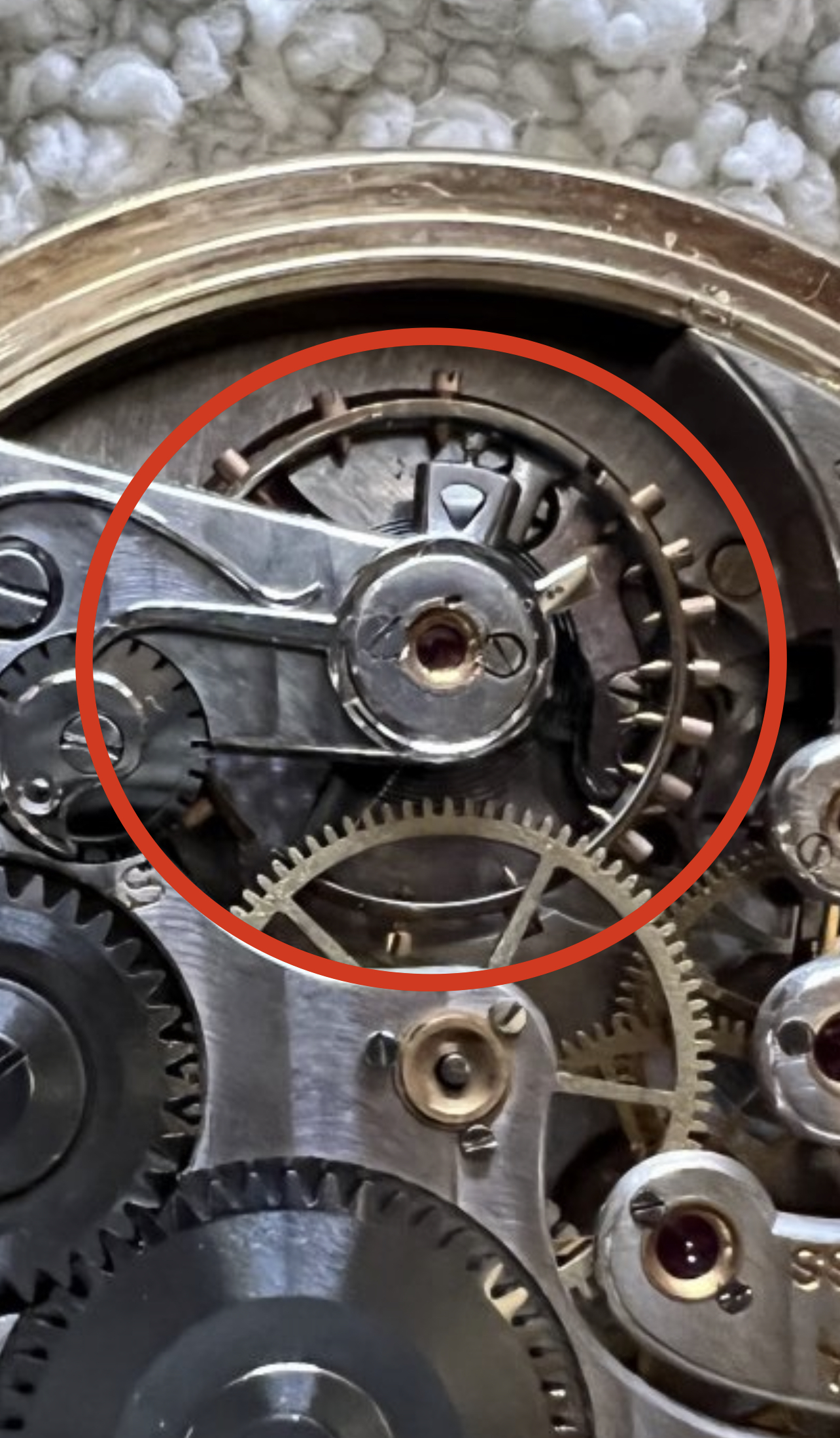

Thanks for the great info. Do I need to look under the spiny thing with the pokey parts or can I bypass that nerve racking step.

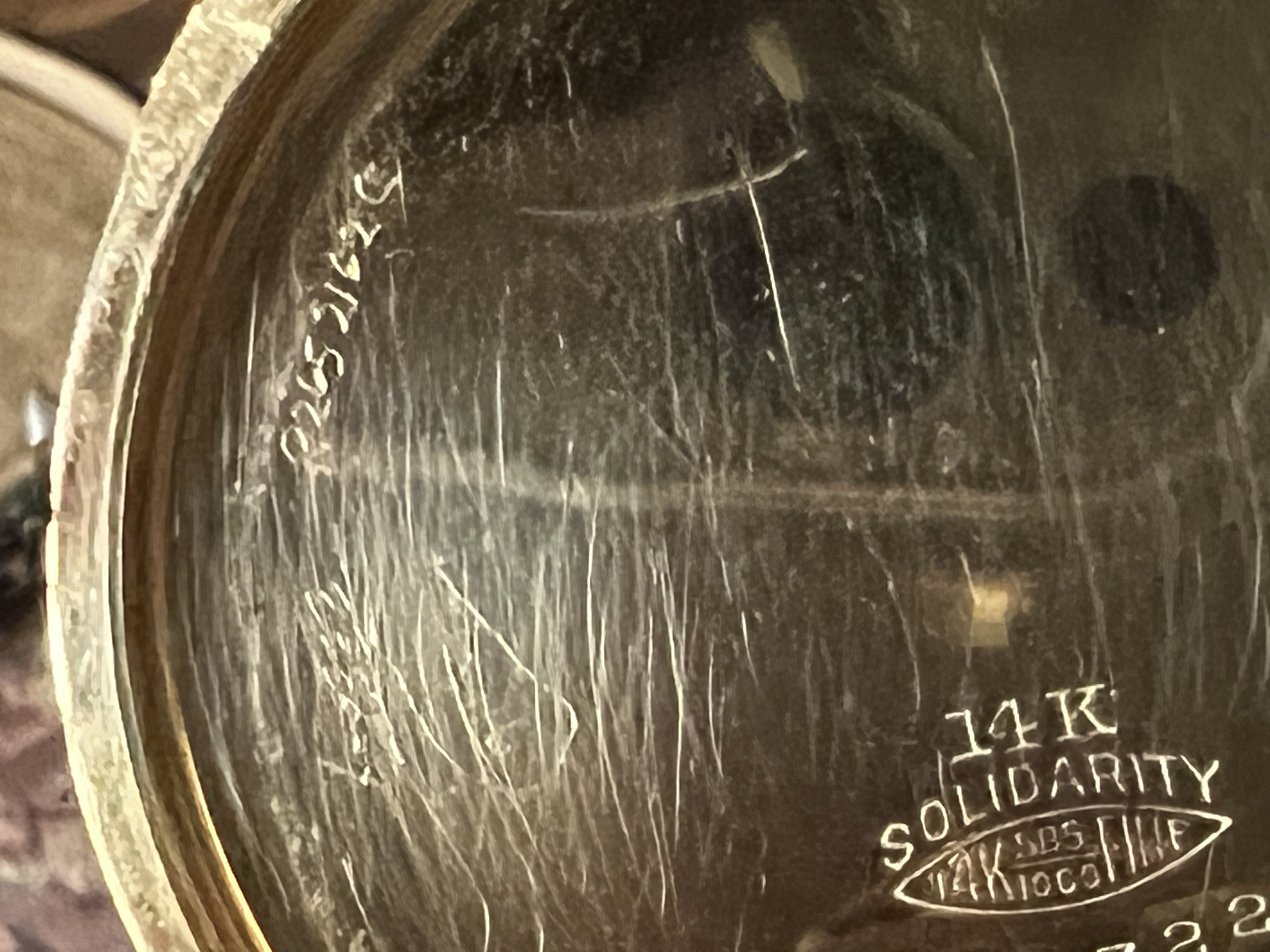

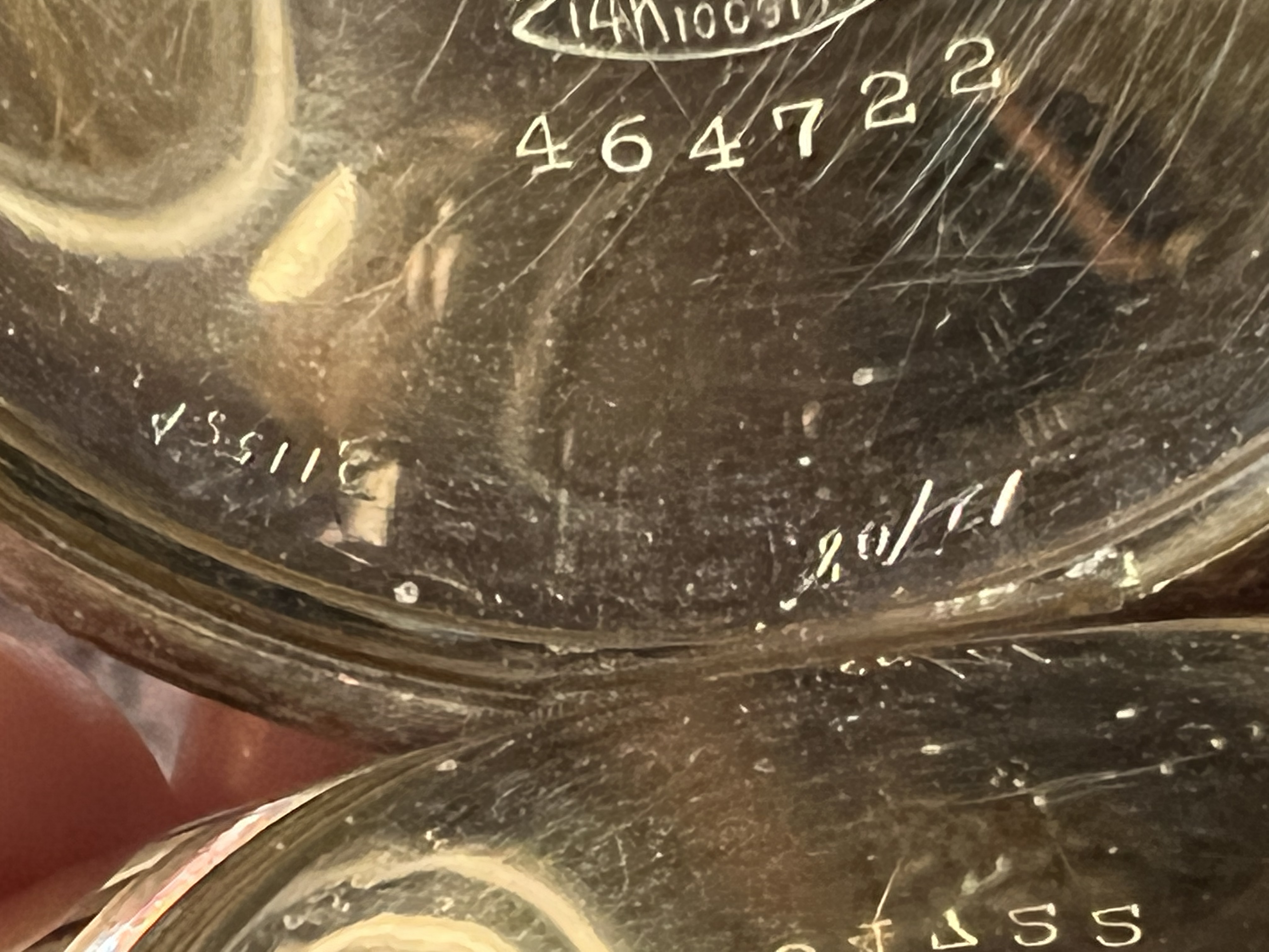

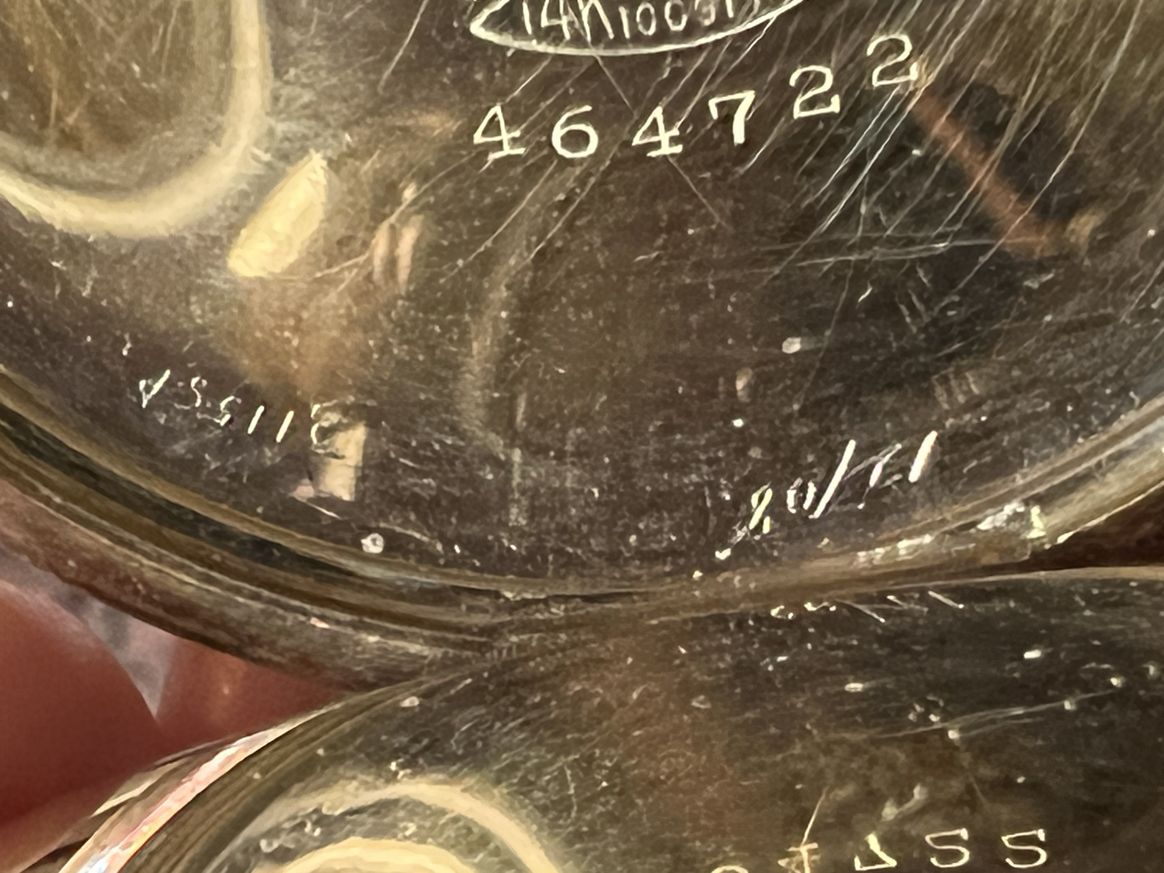

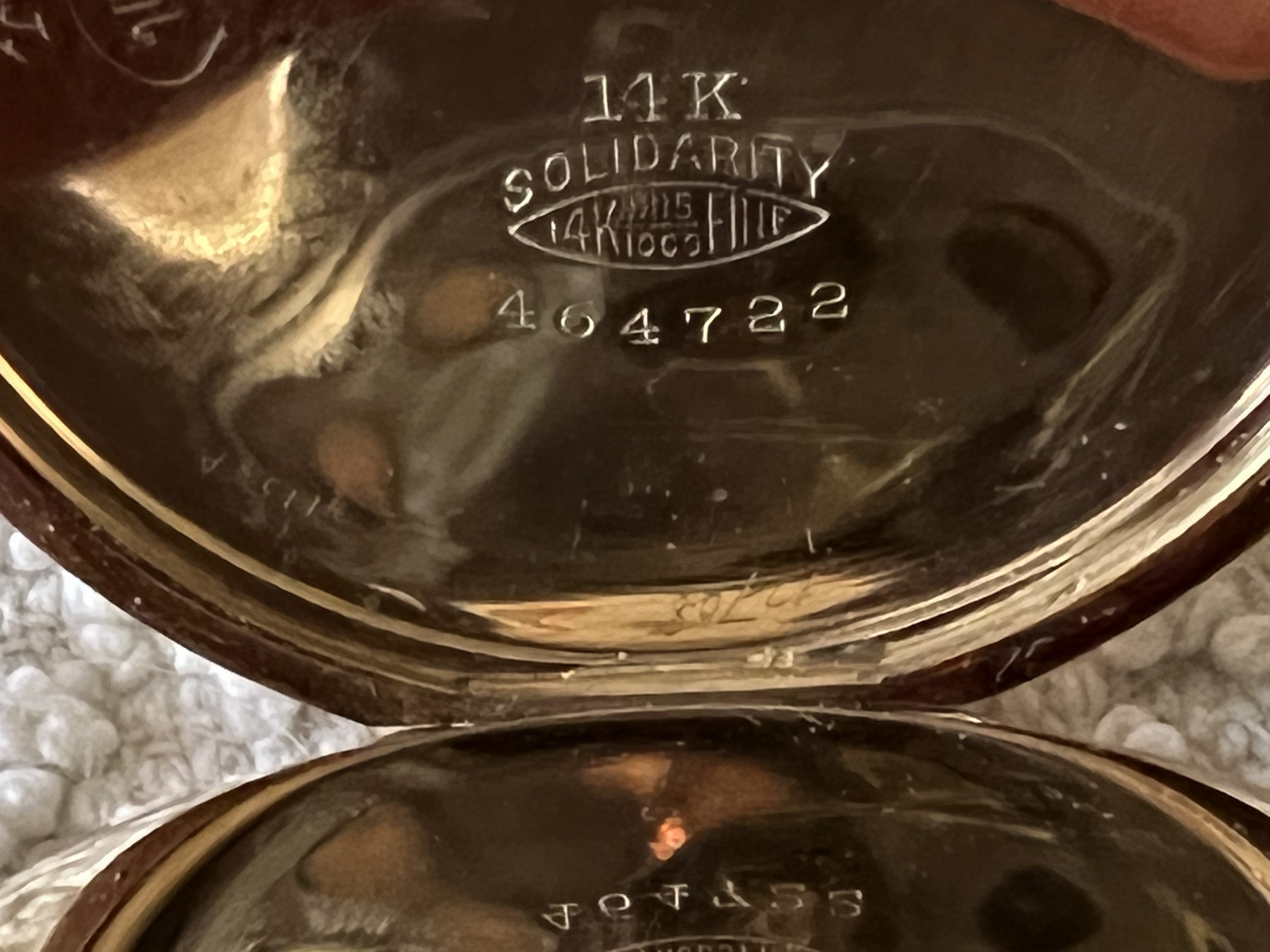

I noticed some etched numbers on the inside of the case back one looks like 12/08 and the other much longer. Any significance?

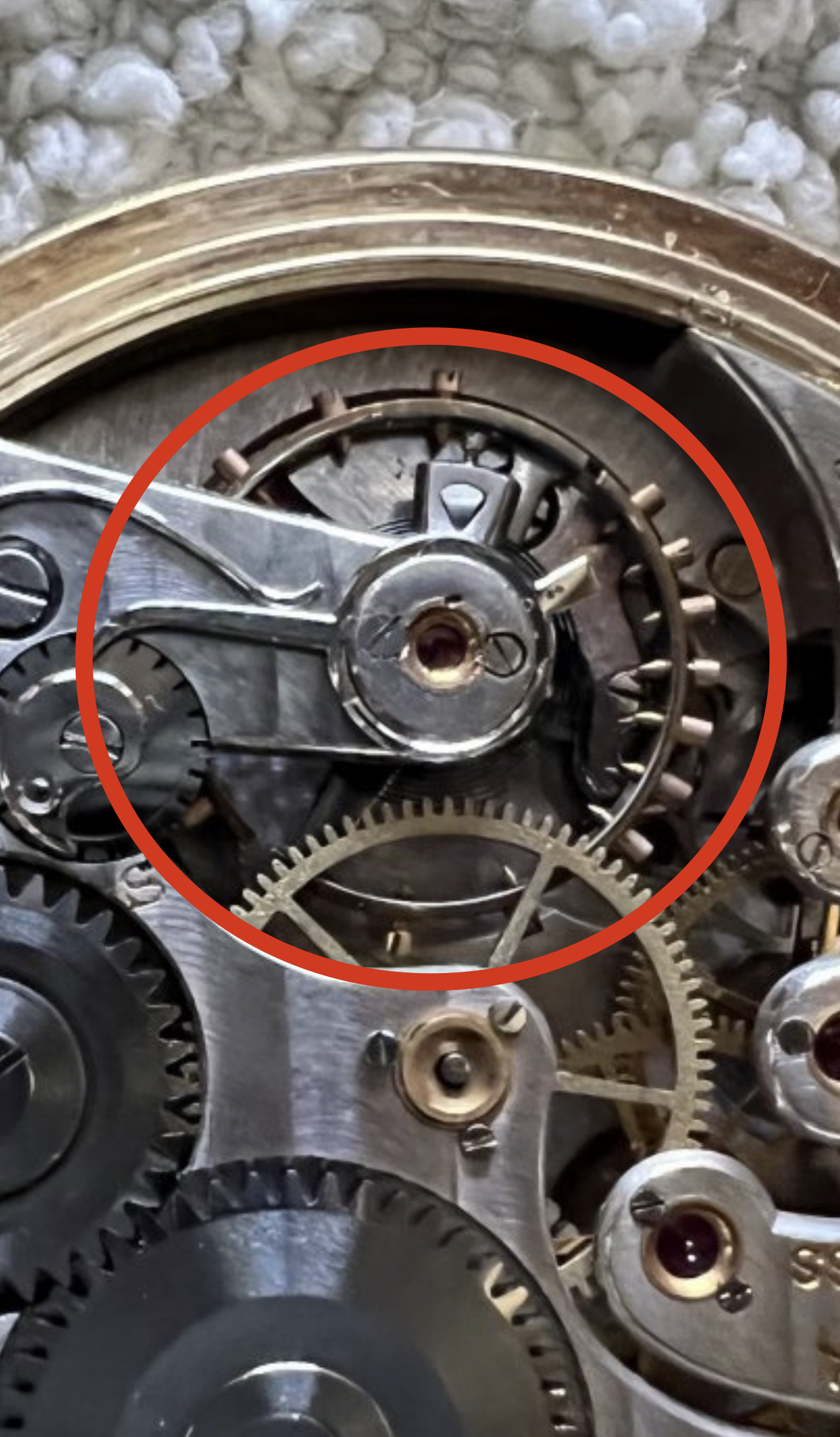

Sorry to step on toes of the experts here, who will be along shortly I’m sure, but you seem to be in front of the watch at the moment and I want to be sure and say: STOP!!
He did not mean to somehow get under/behind the “spiny thing with pokey parts” but instead only to look behind it! This is the spinny-pokey:
Often, but not always, there may be some tiny numbers stamped on the plates around/behind this part, which may need a light and magnifying glass to find if there.
But don’t touch anything in there, nor think that anyone is suggesting you try and get back there! 😁
Not anymore. Those are marks made by watchmakers who have serviced the movement. 12/08 might indicate a service in December of 1908.

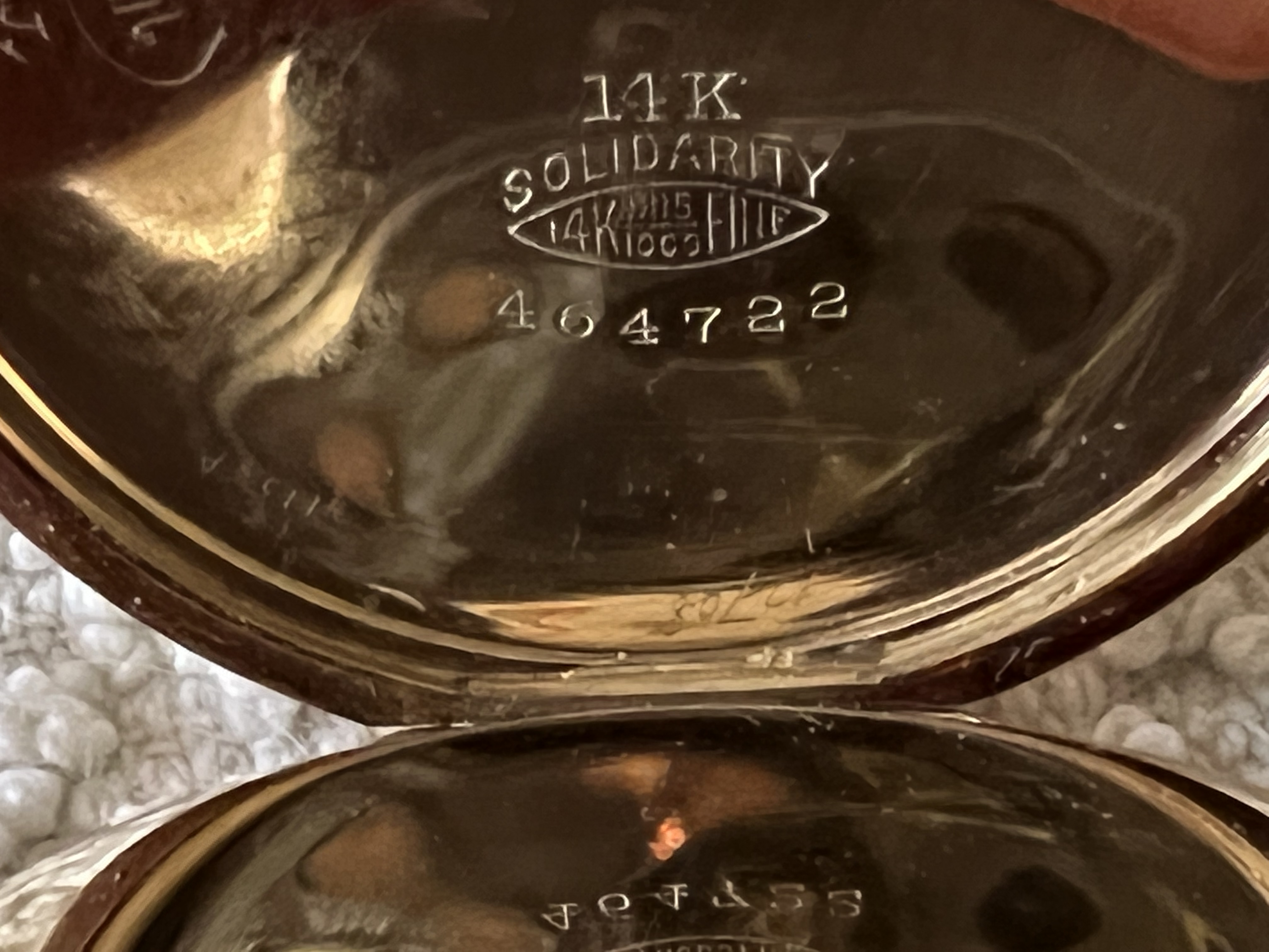

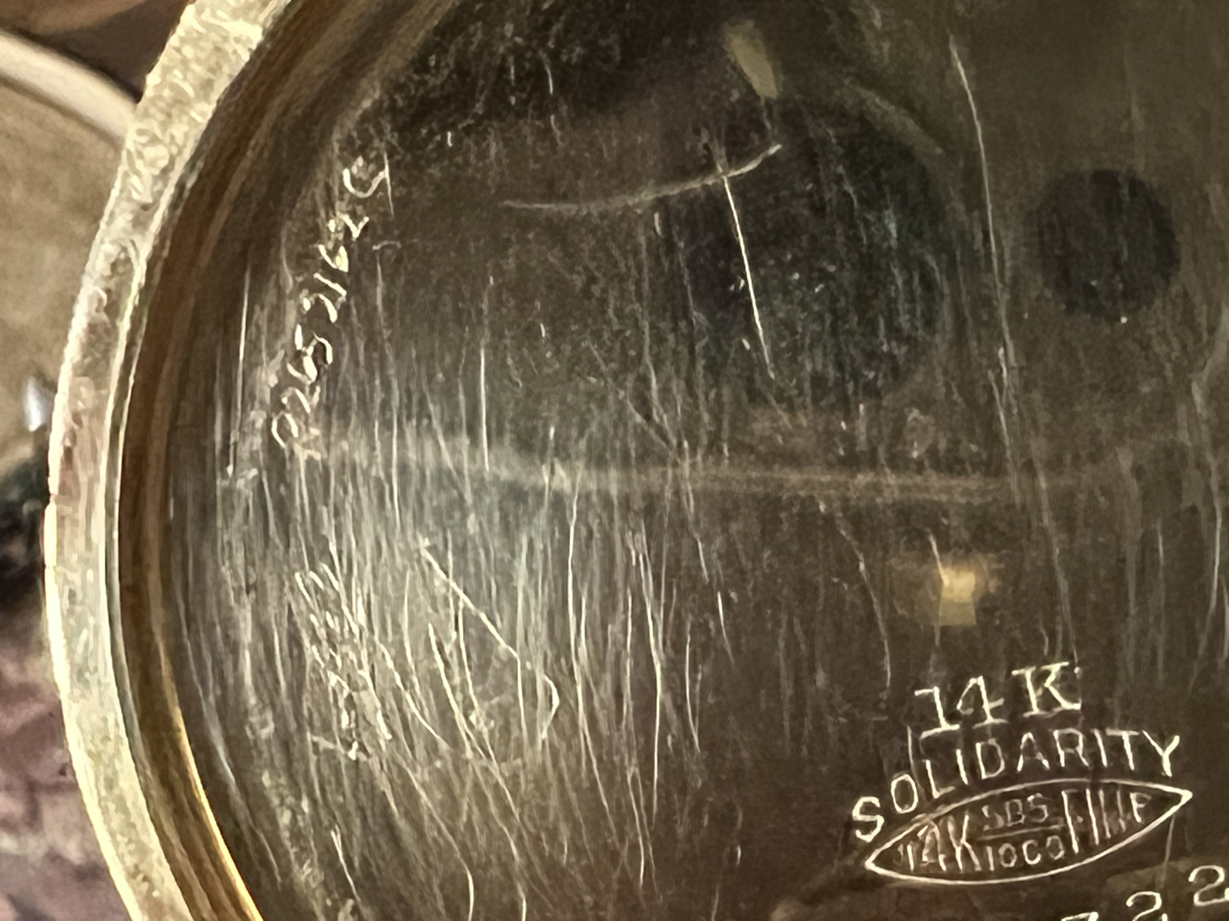

Solid gold 14K case. 21 jewels implies higher quality. Adjusted five positions (out of 6, and position 6 is ignored because the watch is "never" in that position) implies higher quality. The craftsmanship on the case certainly says higher quality.
You have what was originally the best a person could buy at the time, and a proper watchmaker can get it to run to the same specification or better than new. You have a stellar piece, and only sell that as a last resort (pay for a new liver, etc).

There probably won't be any markings under the spinny thing with pokey parts, it's a bit early for those markings.
The movement is as I see it an Omega 19''' NN LX 21p.
19''' is 19 ligne, the size of the movement, about 42 millimetres.
NN is for New Negative, the type of setting mechanism activated by the crown.
LX is a grade of finish (I assume).
21p is 21 pierres (stones) which means 21 jewels.
The movement was introduced by Omega in 1904 and the 5.3 million dates the movement to some time around 1915 to 1920.
As mentioned by previous posters, this movement would have been shipped from Switzerland to the US, I assume to Hueters Jewellers in Cleveland. A customer would then have selected a case (almost always American made) and dial (they weren't usually interested in the movement as it was never seen by them) and the watchmaker would have assembled them. It's also possible that Hueters had watches pre-assembled and customers could walk in and pick one off the shelf.
As also noted, this is an very nice watch and deserves to be serviced and worn and treated with kid gloves.
