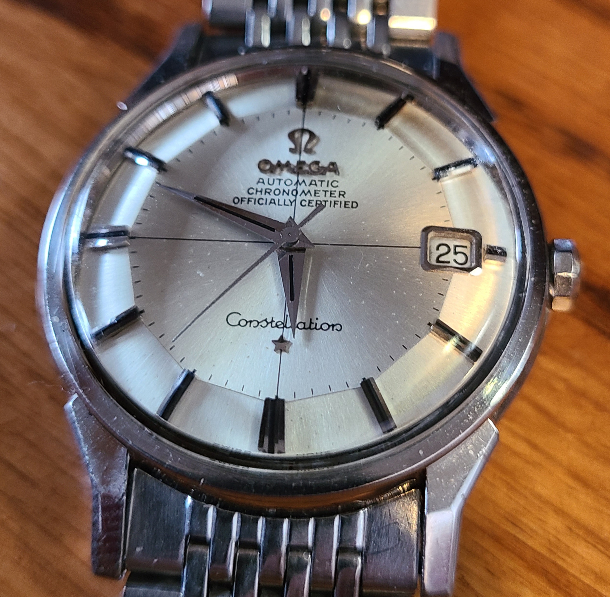

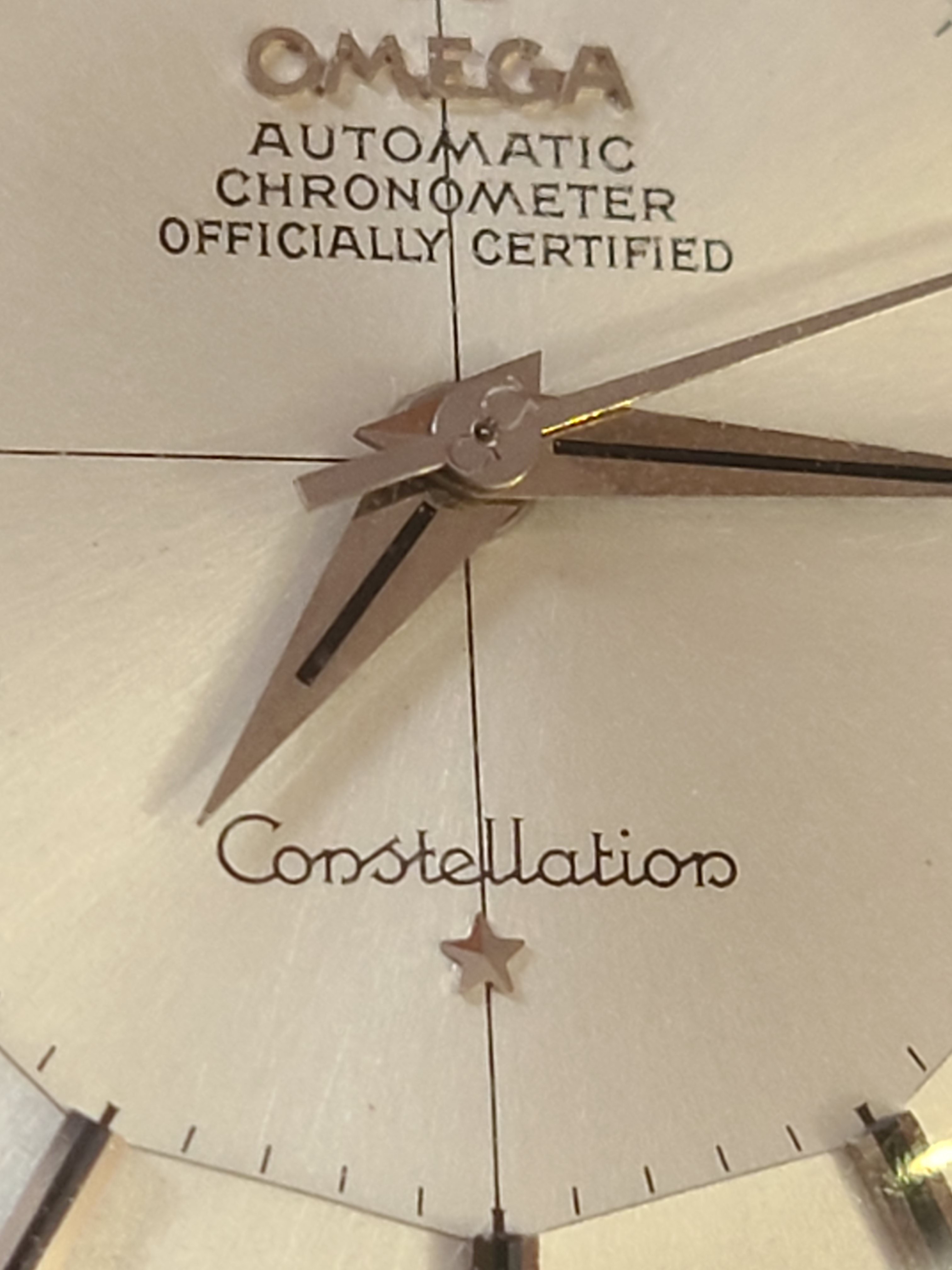

How can you tell if the cross hair is original or added later?
238
852
Looking at the full resolution image, it looks like there is more degradation of the pigment in the minute markers than there is in the cross hair. This makes me suspect the cross hair was added later.

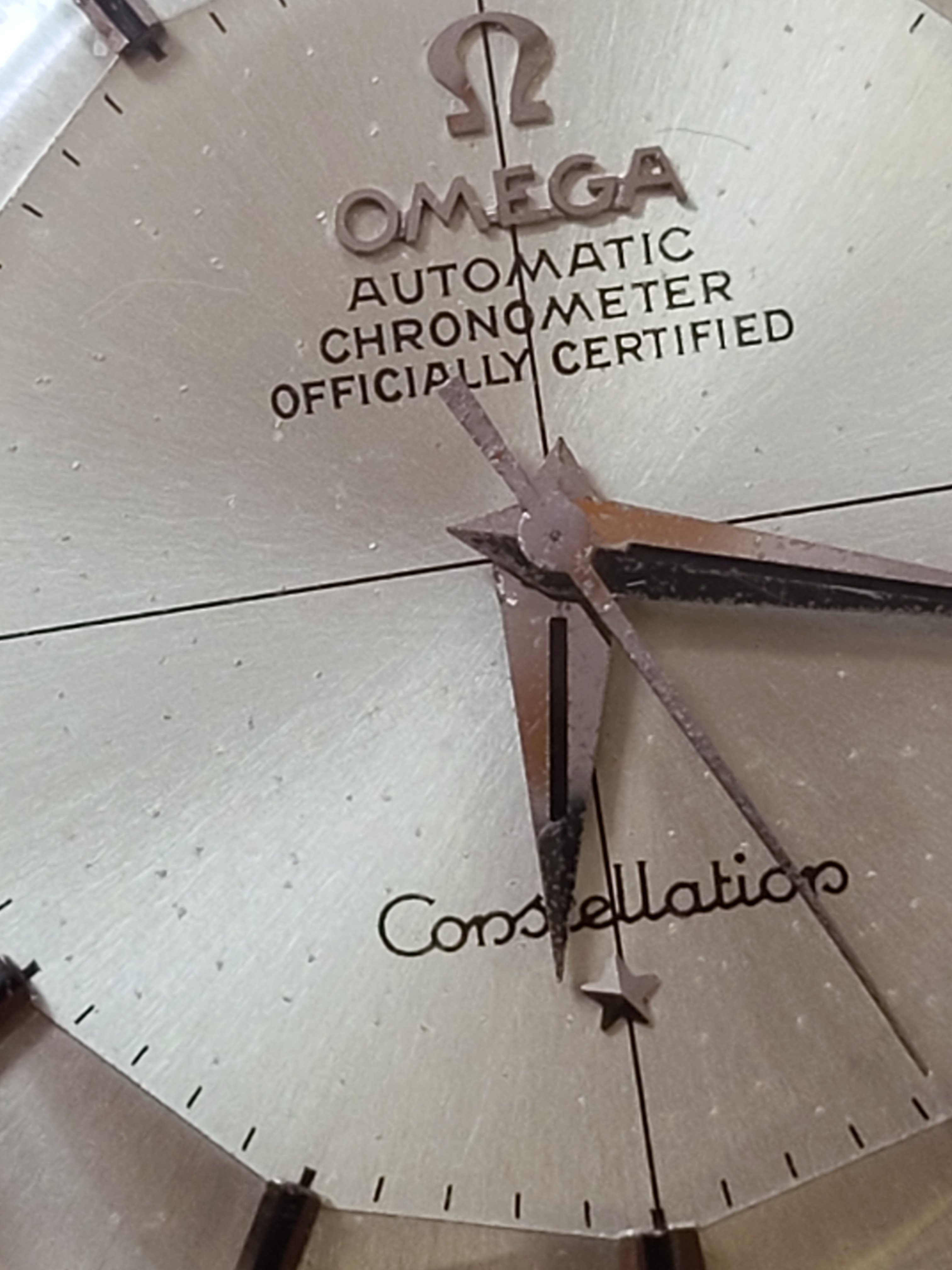

Is it also because the line is slightly off center from the 6 o clock printed marker?
491
404
To my eye the cross hairs are a little wide and not parallel to the double-l in constellation, suggesting a later application. But it looks like the cross hair goes under the applied logos which involves a lot of work removing the logos, printing the cross-hairs and reapplying the logos. I wonder if the applied elements were removed but not the indices? Looking at the verso would help clarify the dial's history.
1,120
1,792
Has it got something to do with the dial “freckles” when viewed through a loupe?
232
247
Is the horizontal line a bit thicker or is it just me?

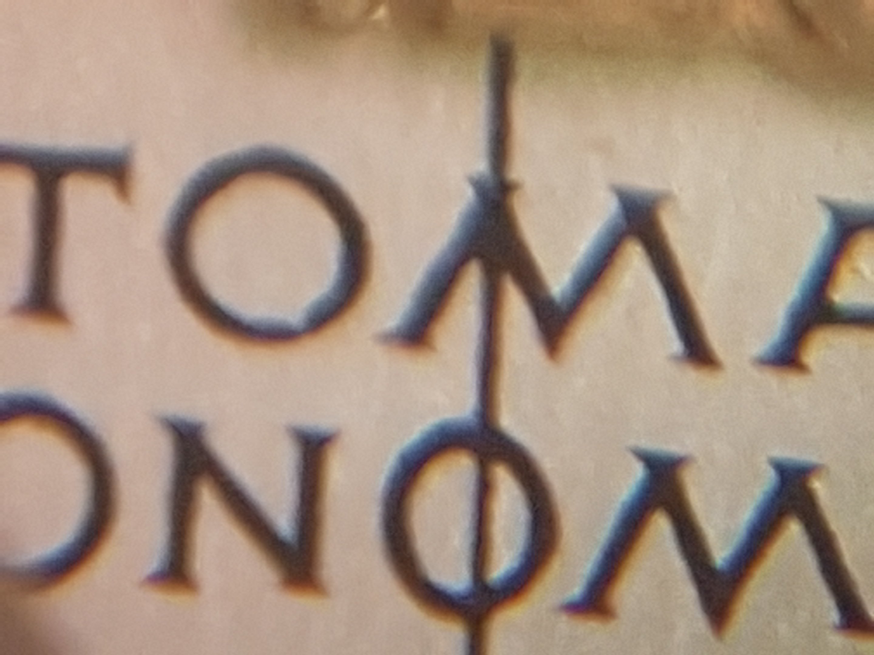

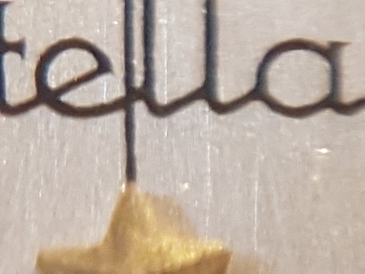

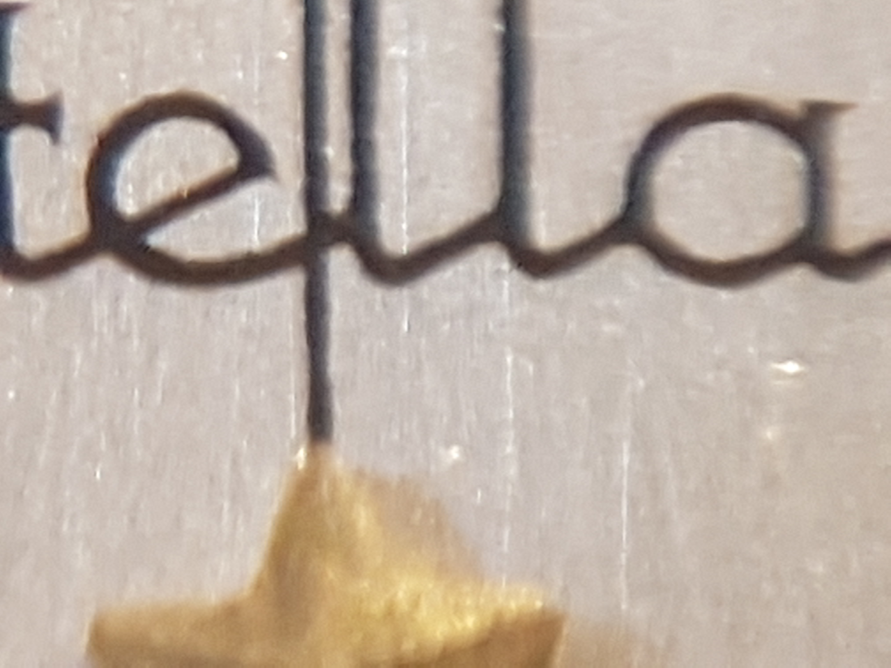

Under a X10 loup, I can see the cross hair goes over the script like this
That means the script was already dried for a long time then the cross hair goes over and they don't mix together.
On the ones with original cross hair, scripts and cross hair mixed beautifully at the points they met. That means they were printed at the same time.
Hope it helps when you buy ones with cross hairs.

Sorry, being slow tonight - please run this past me again
WTH am i looking at in that photo? And What are the white lines ( that look like 2 matchsticks laid on a wooden table?)
3,133
5,569
Sorry, being slow tonight - please run this past me again.
It means that if you look under a glass at where the line crosses the script, you'll see the shape of the line continuing as it runs over the script. Which means that the line has been overprinted. Whereas if they had been printed together the inks will have merged, so that the line will appear to run up to the script, stop, and restart at the far side.
1,325
1,872
Yes, i understood the concept - but how does that relate to the photo Hoi posted??

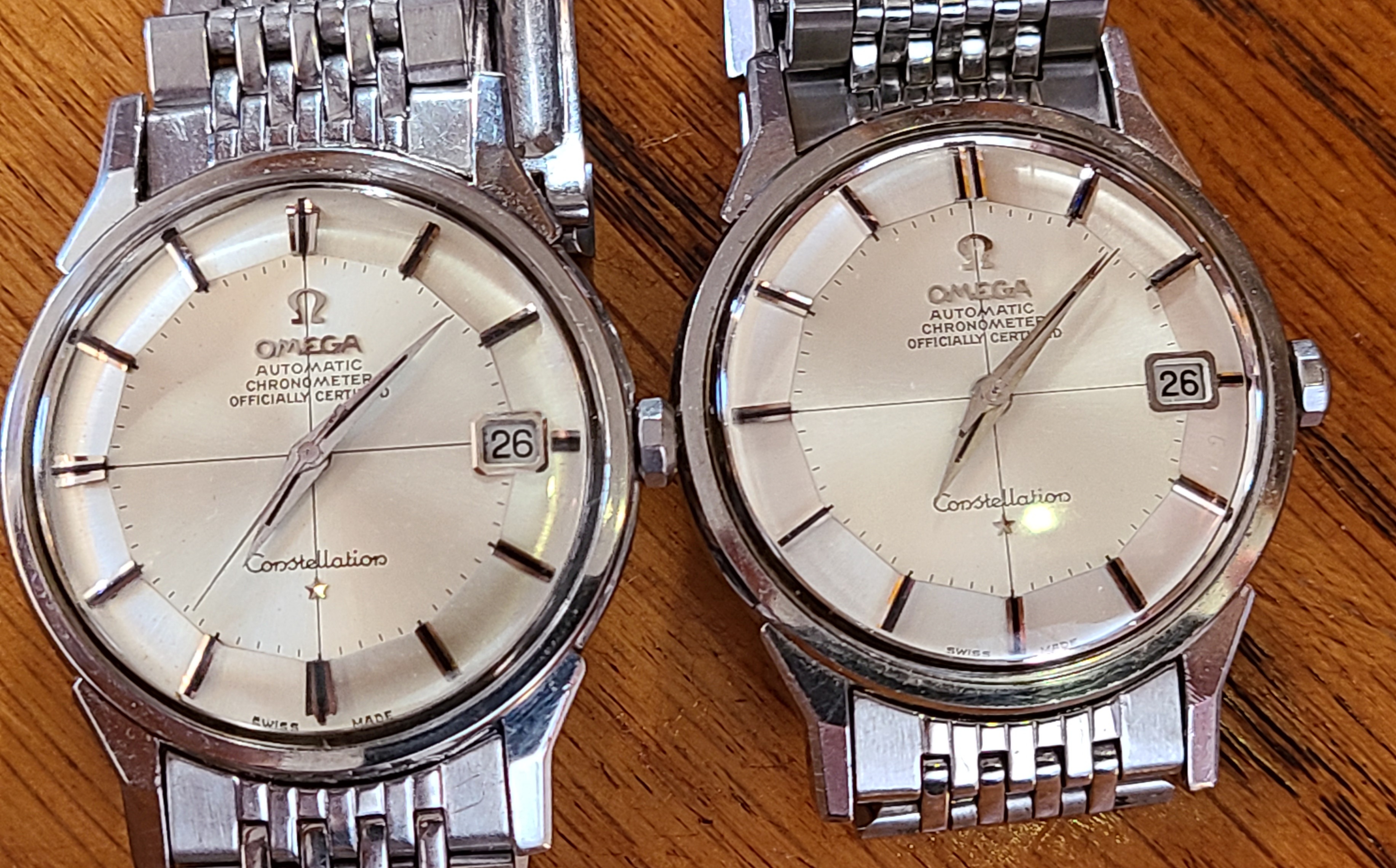

lets see some photos of good and fake examples please
429
2,853
I don't think you can tell from photo like this.
I’m looking at that picture under a loupe and I definitely can’t tell the difference.
1,325
1,872
Thanks, but they both look the same to me, even when expanded
