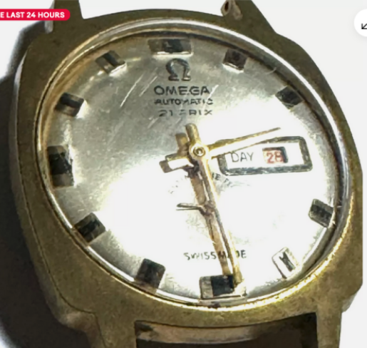

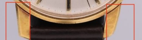

I don't have it yet. But since everyone is asking:
How bad is it?
13,492
31,811
You're going to need a skilled jeweler to fix that without causing more damage, good luck.
Can a jeweler remove the watch internals and open it? Should I ask a watch maker to disassemble it first?
Would a skilled watchmaker be able to fix it too?
24,836
55,255
TBH, unless there is something tremendously special about the watch, I think you should probably just leave it. As long as you can squeeze the strap between the lugs, the watch is wearable. It would be a shame to damage the case while attempting to straighten it. If you really find it bothers you, you can always sell it and buy another, and next time you'll know better.
