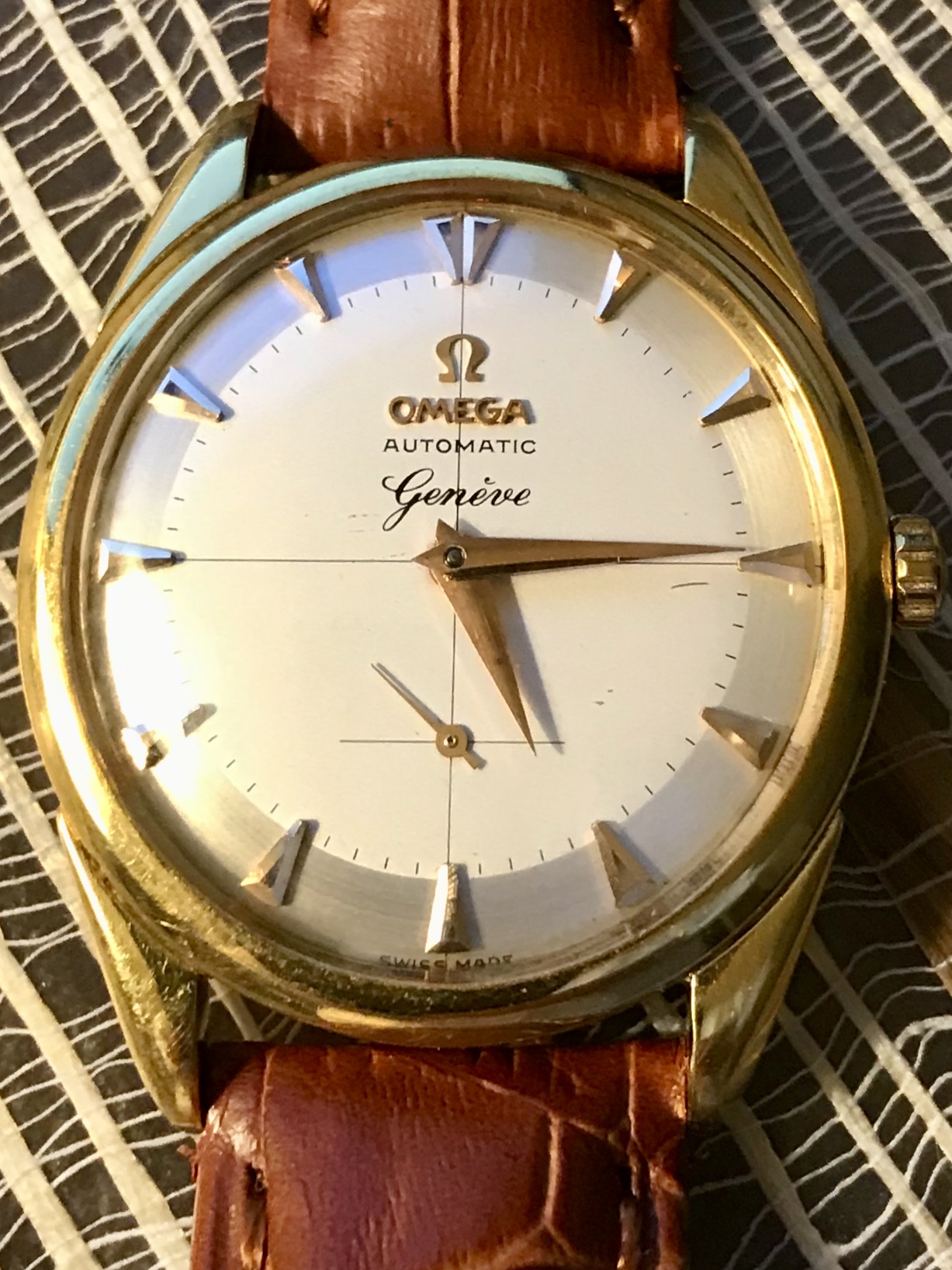

The MOY test is not always reliable. Generally, a dial that has a later added crosshair is also going to have the typical signs of a redial. Look at the font, the indices, the minute track, spacing, etc. Does anything look “off”? The centering of the crosshair lines may be slightly askew (do they pass through the center of the Omega symbol and end in the center of the 12, 3, 6 and 9 indices?), or are the crosshair lines darker, lighter, thicker or a different color than the rest of the print used for the minute track, etc.? If there is a small seconds subdial, does the vertical crosshair line bisect the subdial straight down the middle? It should. Here’s a photo of my Omega Geneve which has an original crosshair dial. This is how things should look.

Obviously; it's specific to Constellations. But the article does give further information on detecting a later crosshair. Like you said, variations in colour, line thickness, and where exactly the lines bisect other dial features are all good indicators.
