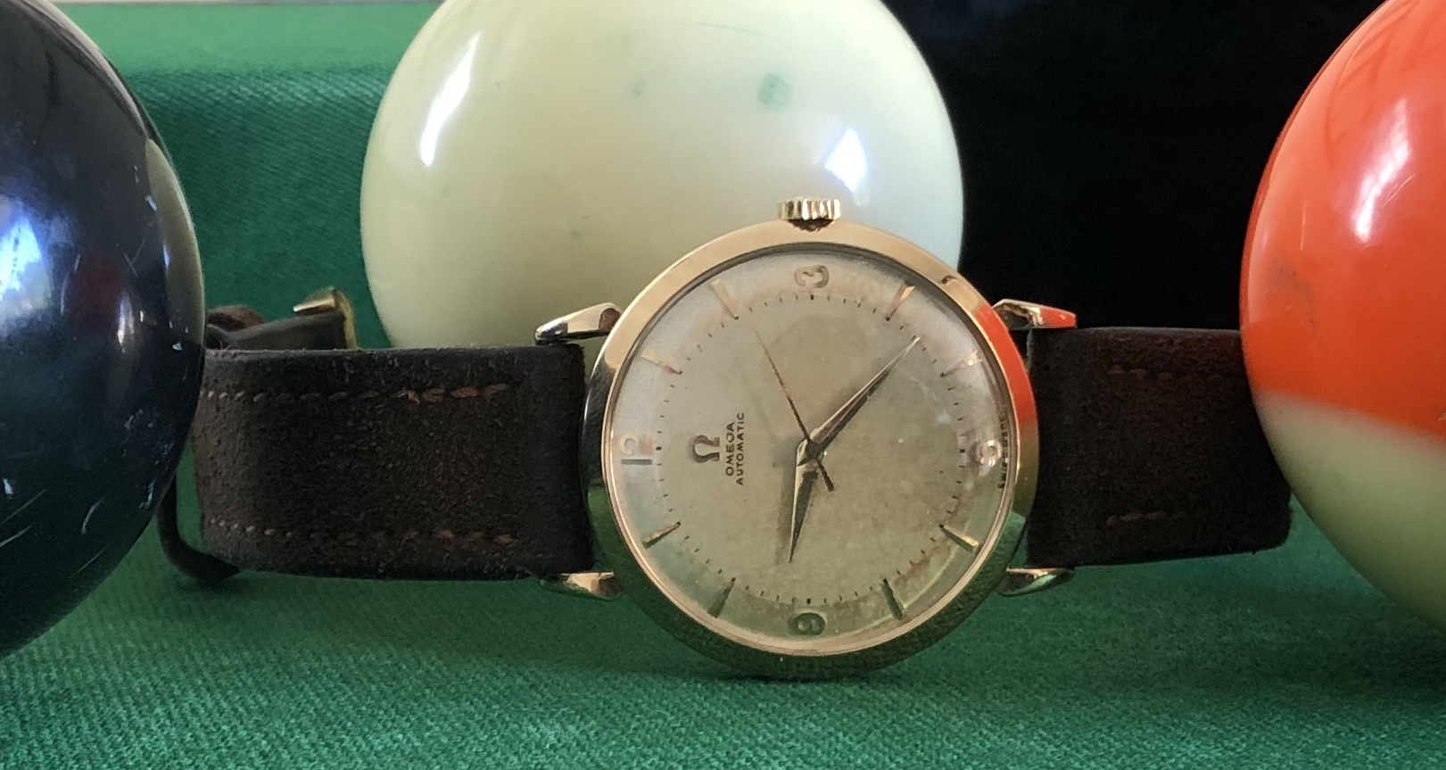

How bad is this redial? How much does it affect the value?

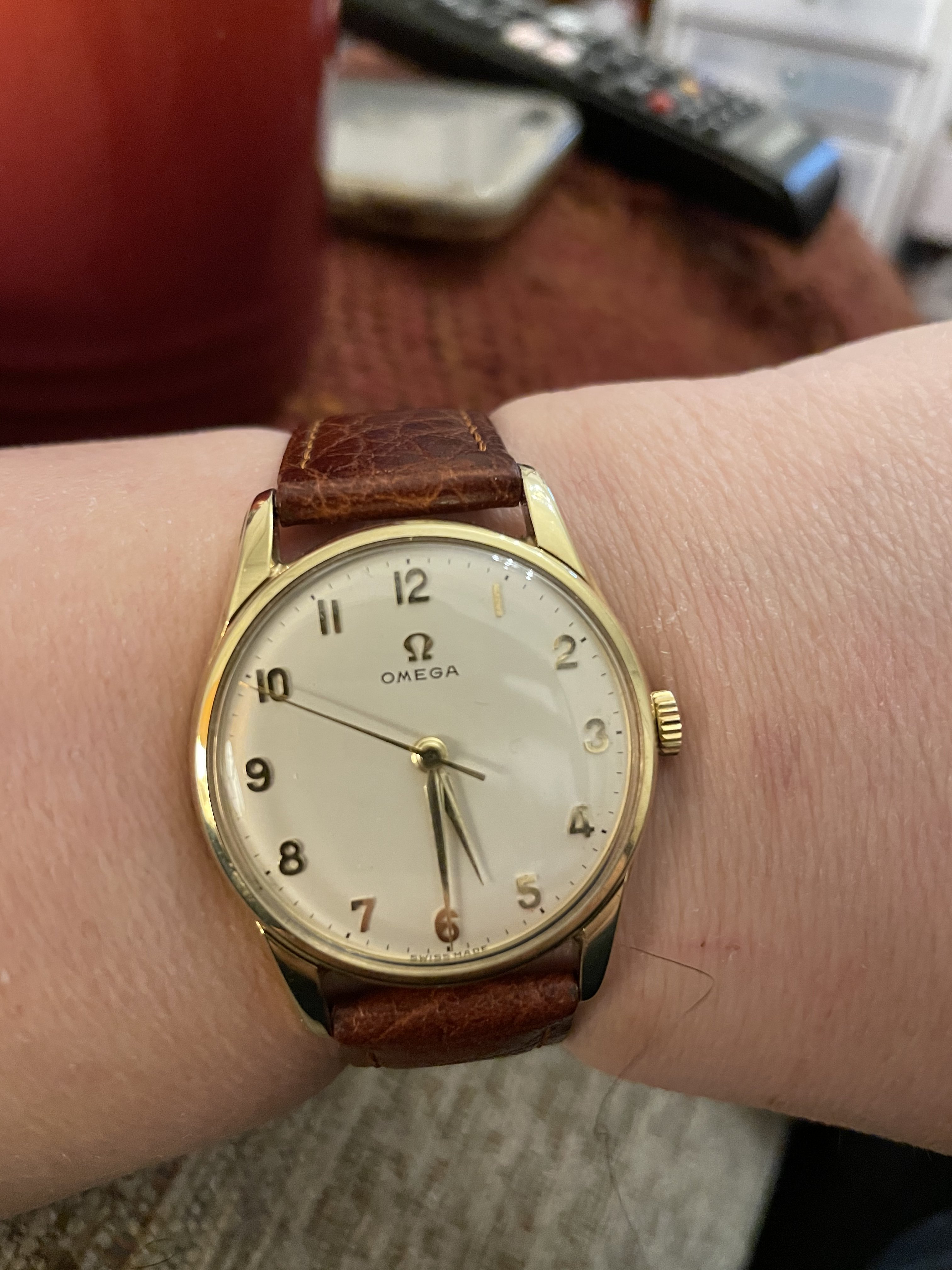

My watch arrived today. cynicism has gone: thanks for your input, I just couldn’t believe what a lovely example I’d got.

Oh now I think it is a redial.

So let's dig in!
Here are some of my cal. 30 watches. I am sure they all have original dials.
I am not at all sure that all of these dials are original. But we can each have our own opinions.
1,531
1,088
Which of these watch do you think is a redial? I am pretty sure none is.

Just as an extra question- one winding up seems to last about 8-10 hours - is that normal?

Now it's pretty clear - great watch. Congrats!
If you mean the power reserve, I think that is not normal. This calibers should have around 40 hours power reserve for proper running. You should visit a watchmaker who specializes on these 30T2 family movements.

No not normal. As I mentioned in my earlier posts it will need a service. When healthy a full wind lasts circa 40 hours. When you buy a second hand watch, you always need to factor in the service cost, that is unless the seller provides written proof it was done in the past few years. Sellers routinely lie unfortunately or sell it as perfect just because the second hand moves.

It's not, I'm afraid. 45 hours is what it should do or should've done new. In my experience, it's absolutely not unrealistic to have that power reserve when they're in good nick, even after so many years. You'll need a service for this one.
/edit: I was waaaaay to slow there, apparently. 😀
/edit2: Here you'll find some data to your movement, including the power reserve:
http://www.ranfft.de/cgi-bin/bidfun-db.cgi?10&ranfft&0&2uswk&Omega_285

It’s not an automatic though.

Manual wind/Auto makes little difference, it is a still a mechanical device. It will still need a service at least every 6-7 years to run optimally. You can get away with longer but something that hasn't been touched in 20-40 years wont be healthy.

Needs servicing, no doubt. Slight chance mainspring needs degrading, often gets just changed.
not sure if it is a redial (the movement shows no sign of past humidity damage, so why repainting). However, it has probably been gently washed, and the laquering may have suffered.

I misunderstood the term “power reserve”. Newbie.

Can you explain what you mean by degrading? The guy who sold it to me said it has just been serviced- and it does feel a bit tight when I wind it?

Bear in mind that there are two issues.
The first was that the case, dial, hands etc were in great condition for a 70 year old watch and the consensus is that it’s original.
The second is that any piece of vintage machinery needs care and servicing.
Your watchmaker will have no problem lubricating it and securing any replacement parts that need replacing - like the mainspring that is responsible for you power reserve.
Think of it like replacing a clutch cable or brake pads, oil filters, or lamp bulbs on your car.

If it only lasts 8 hours after winding fully ie until you can't wind it any further then the guy's verbal assurance that it had just been serviced was to put it politely an exaggeration. Or to put it less politely b***s***. If you are winding it fully, ie for about 60-80 winds and it stops running that soon then clearly needs work. Sellers regularly do this, probably 80-90% of the watches for sale at any one time on ebay for example are in urgent need of a service. Are you winding it fully?

Yes I’m winding it fully and I can turn it maybe 8 turns

I still don’t know what degrading means though sorry
