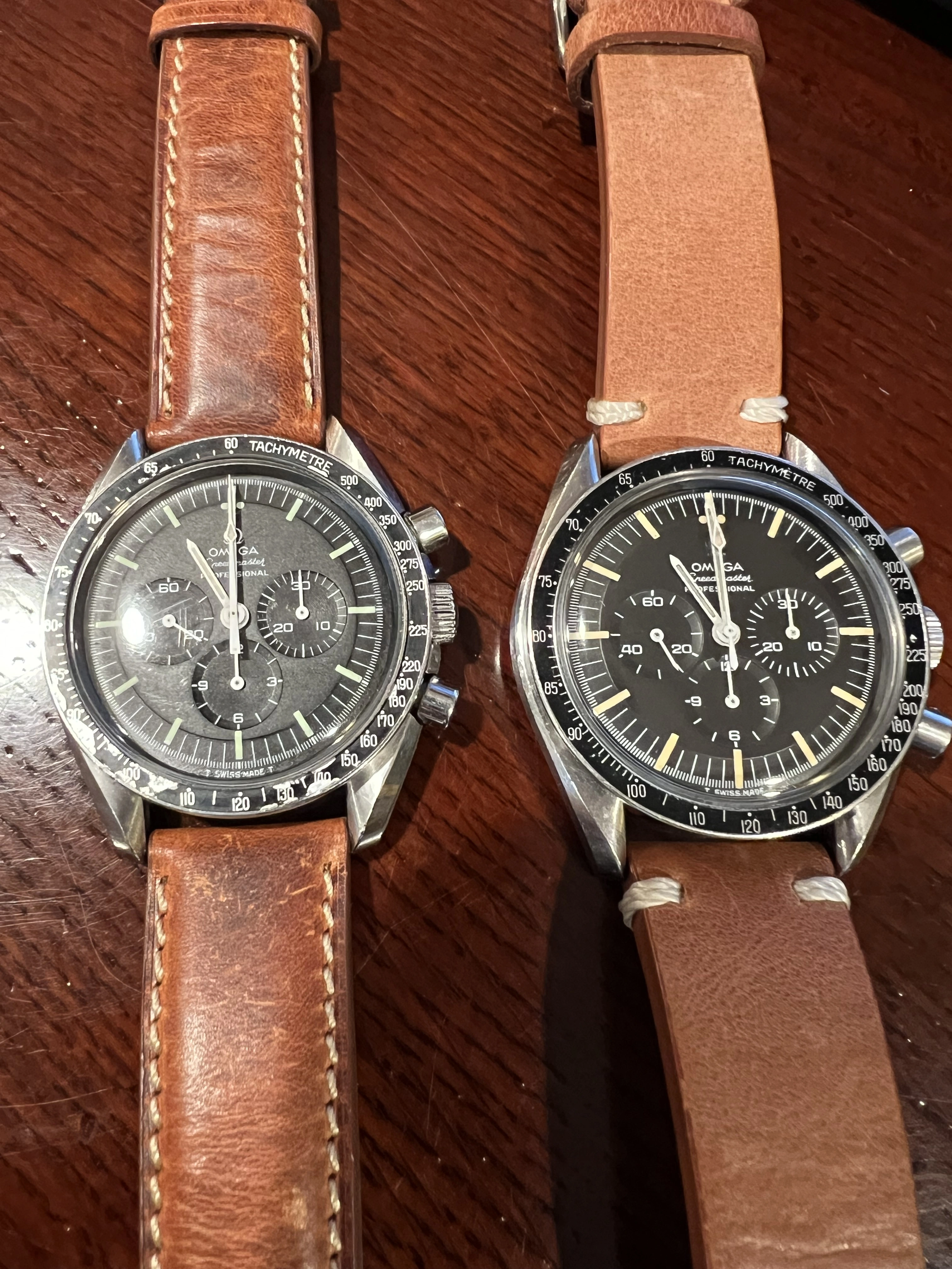

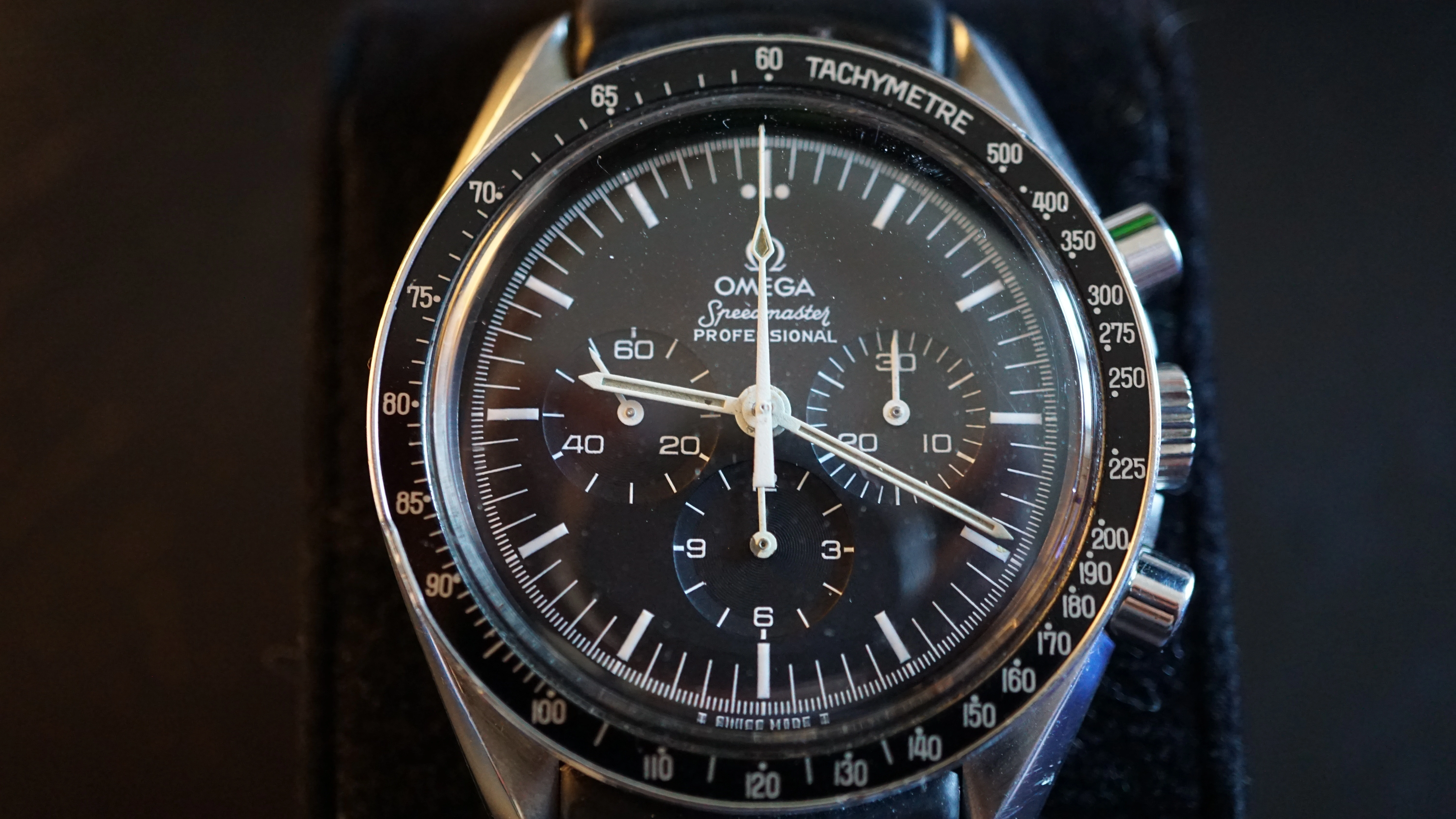

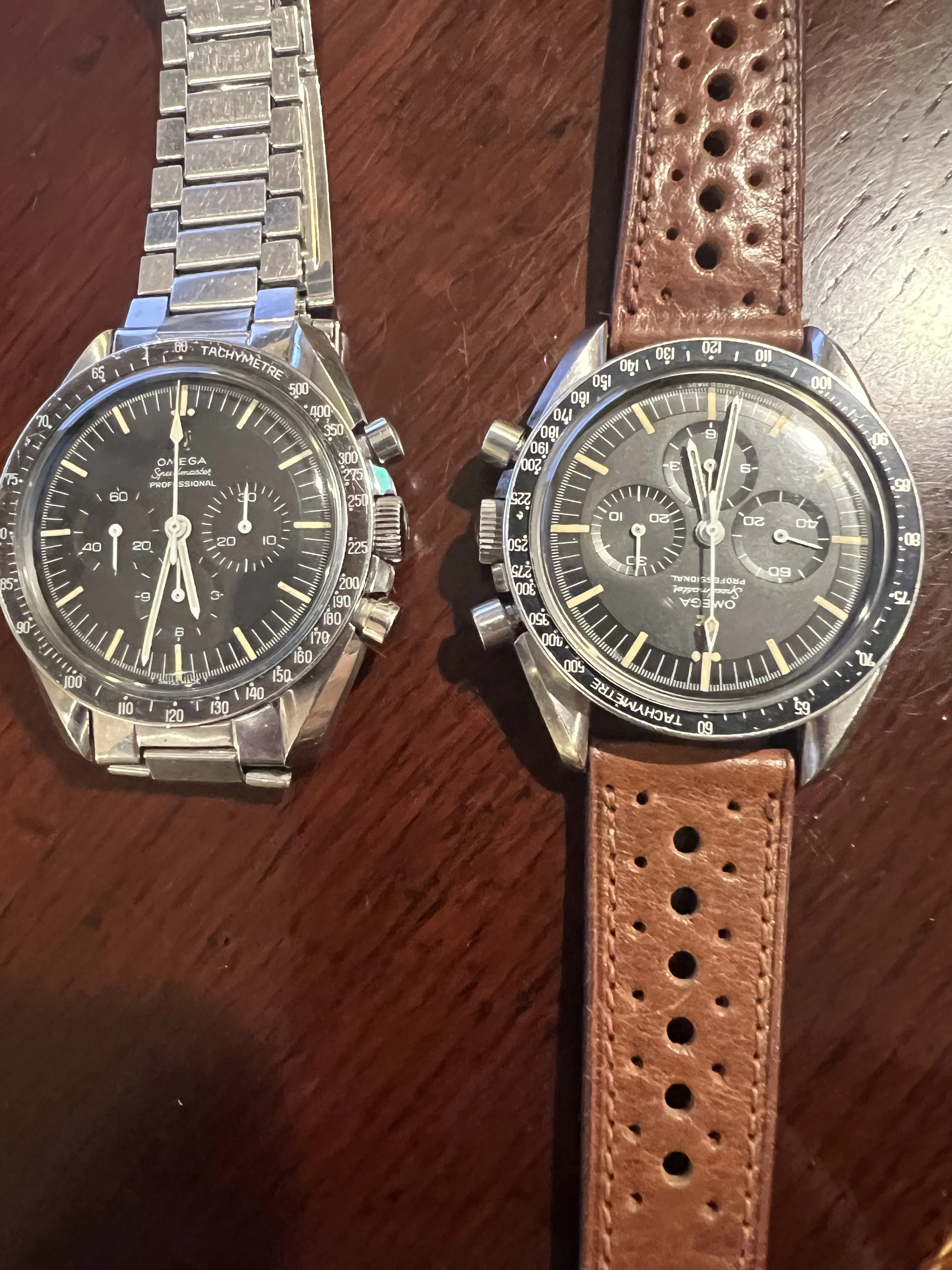

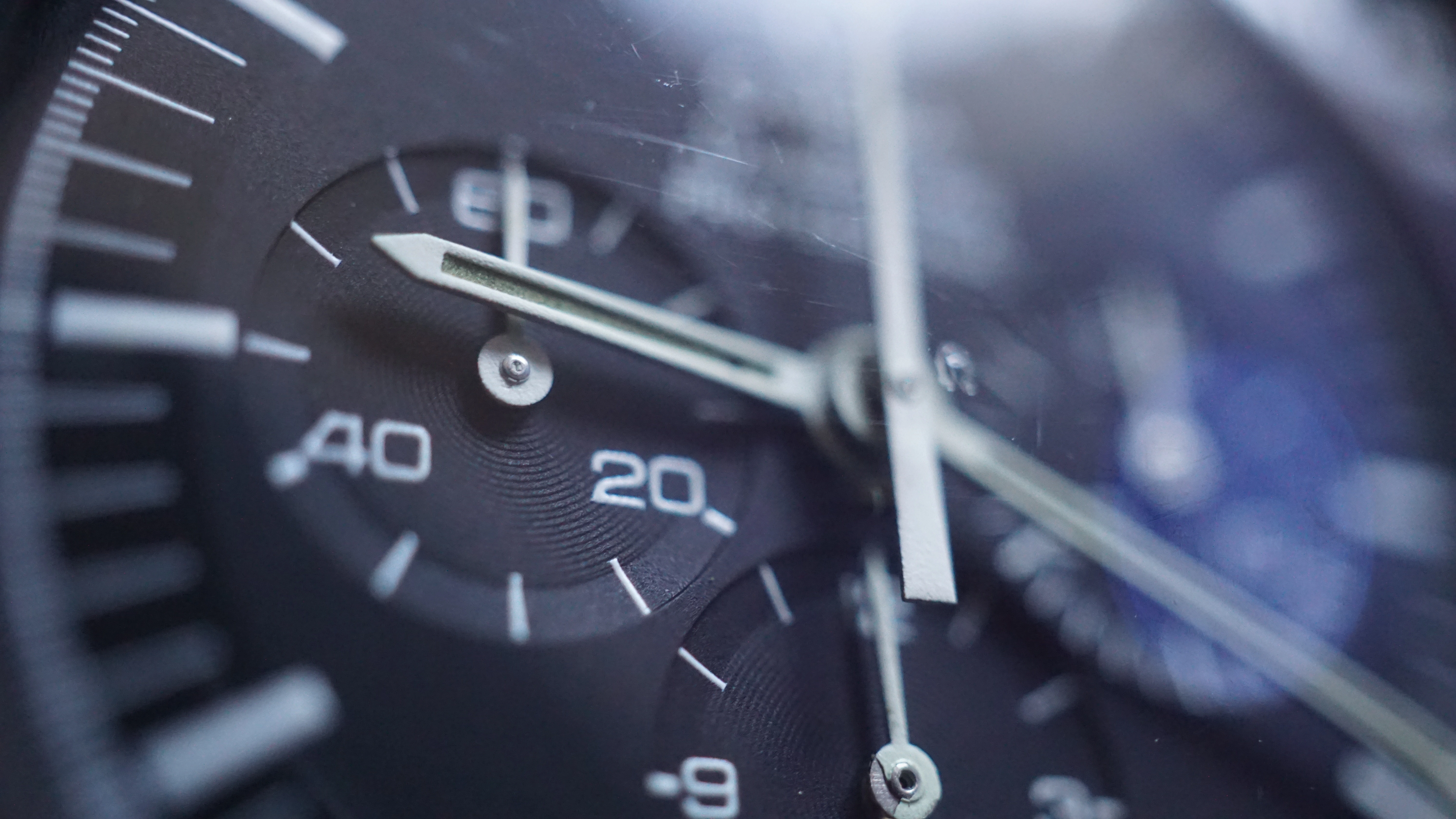

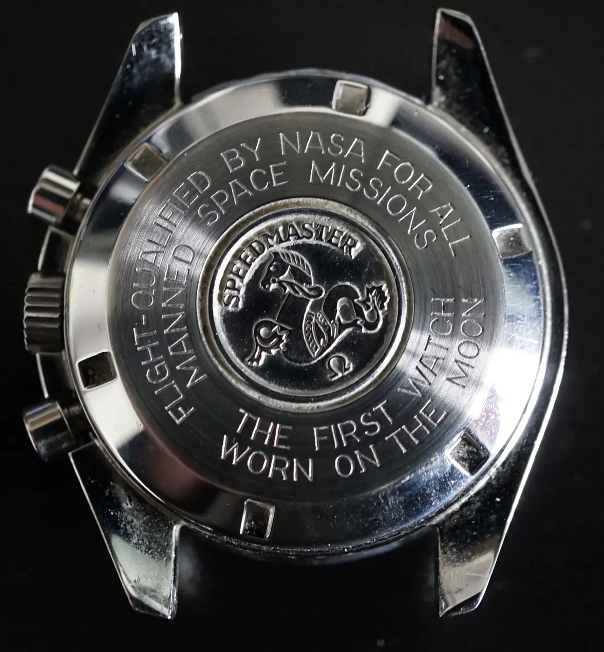

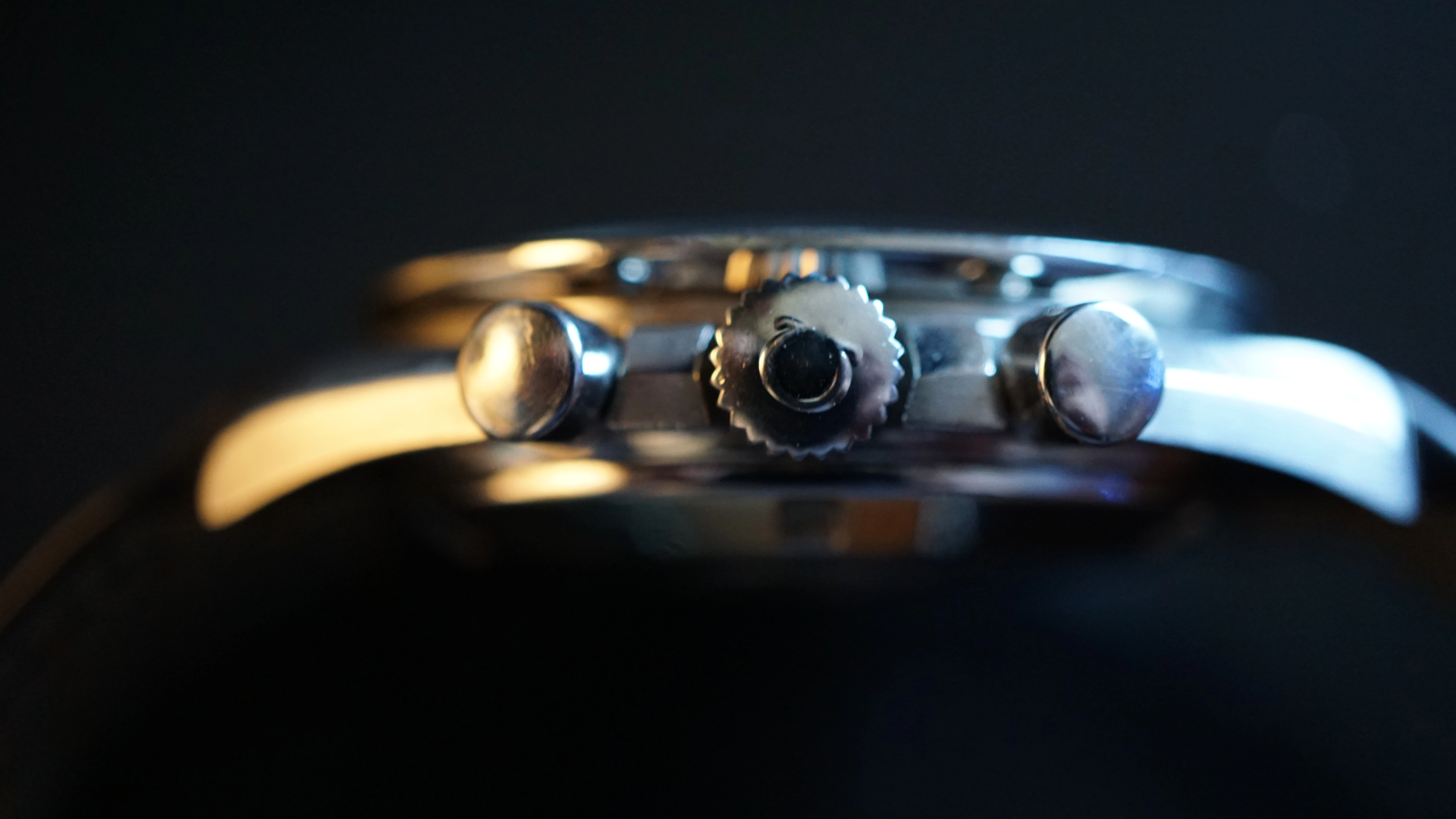

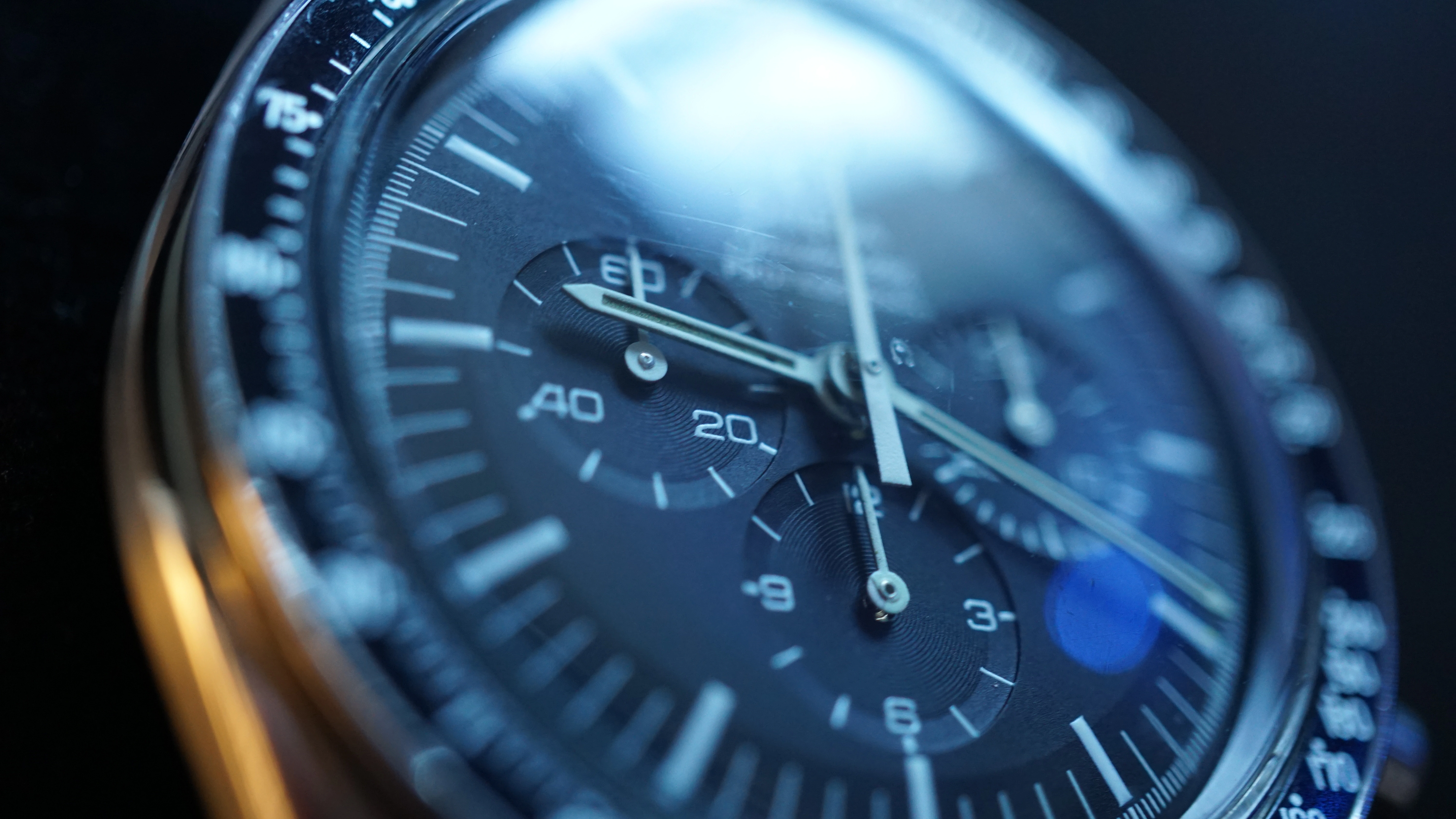

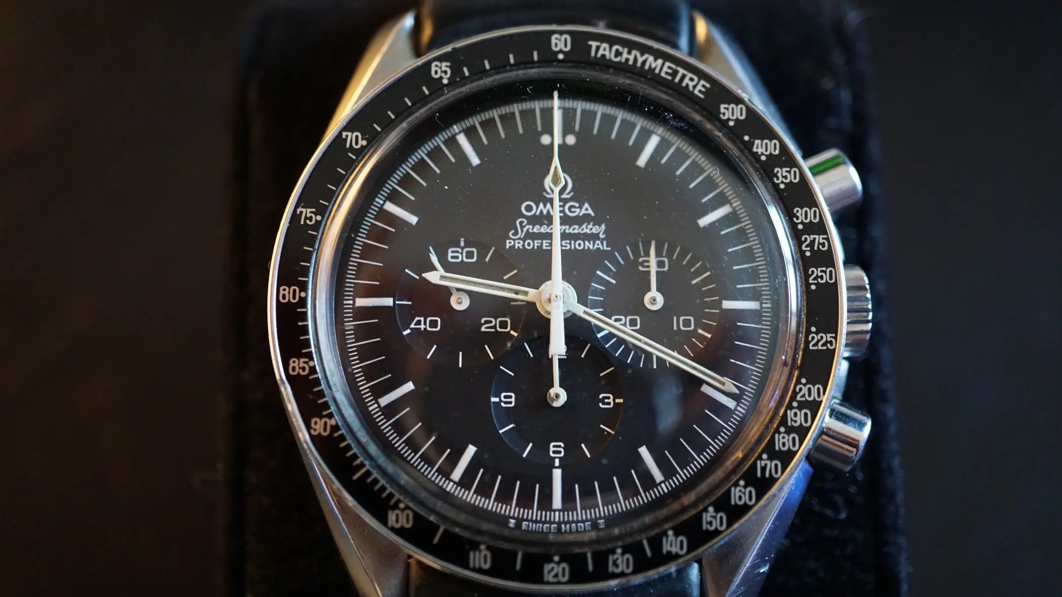

Hi @Spacefruit,
See below…. let me know if there’s something not shown in these images that would help.
Many thanks,
CH
5,343
24,416
I would not feel the need to change the case and dial.
I’m not sure I understand the problem that you think changing them will fix. I may have missed something, but I can’t see a problem with case, and the dial is just patinated as many are.
If you swap parts The danger is you will end up with a watch with out character. With service parts, or parts that don’t actually make it much better.
Change the dial, the hands look off, so you change them. Then bezel patina looks out of place so you get a new one. Now the case patina doesn’t match and on and on.
Better off buying bother watch. Cheaper too.
He was saying something about a leather strap which needed to be held by tape but don't understand either. Maybe the springbars are too short?

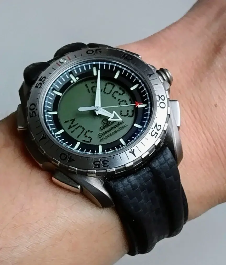

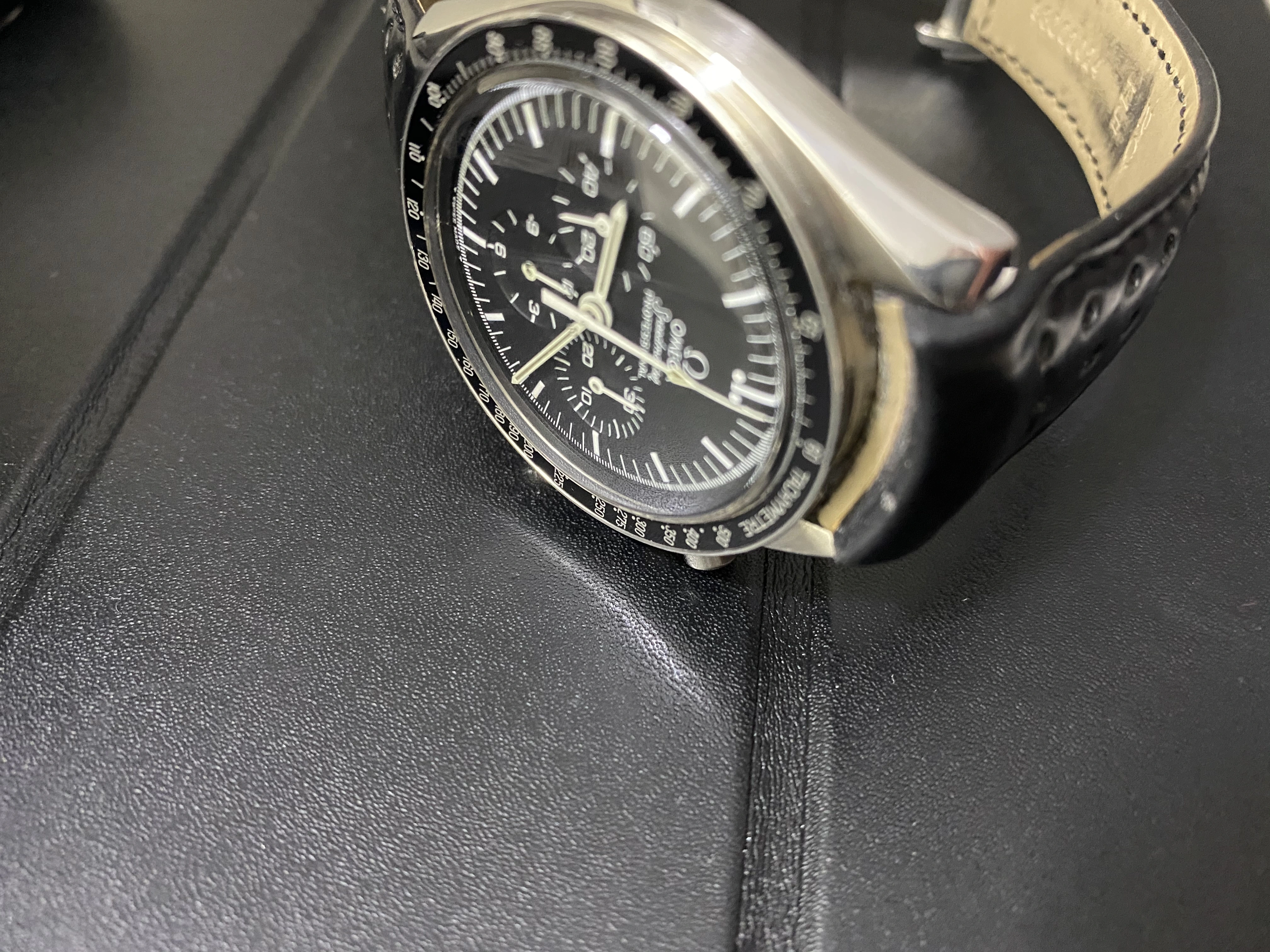

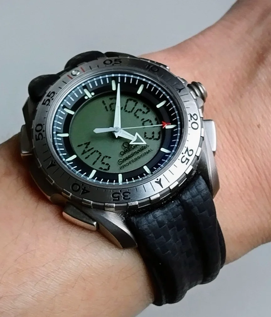

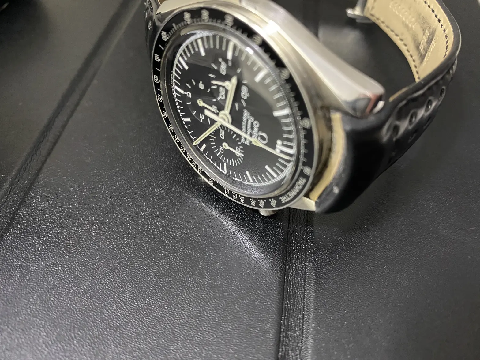

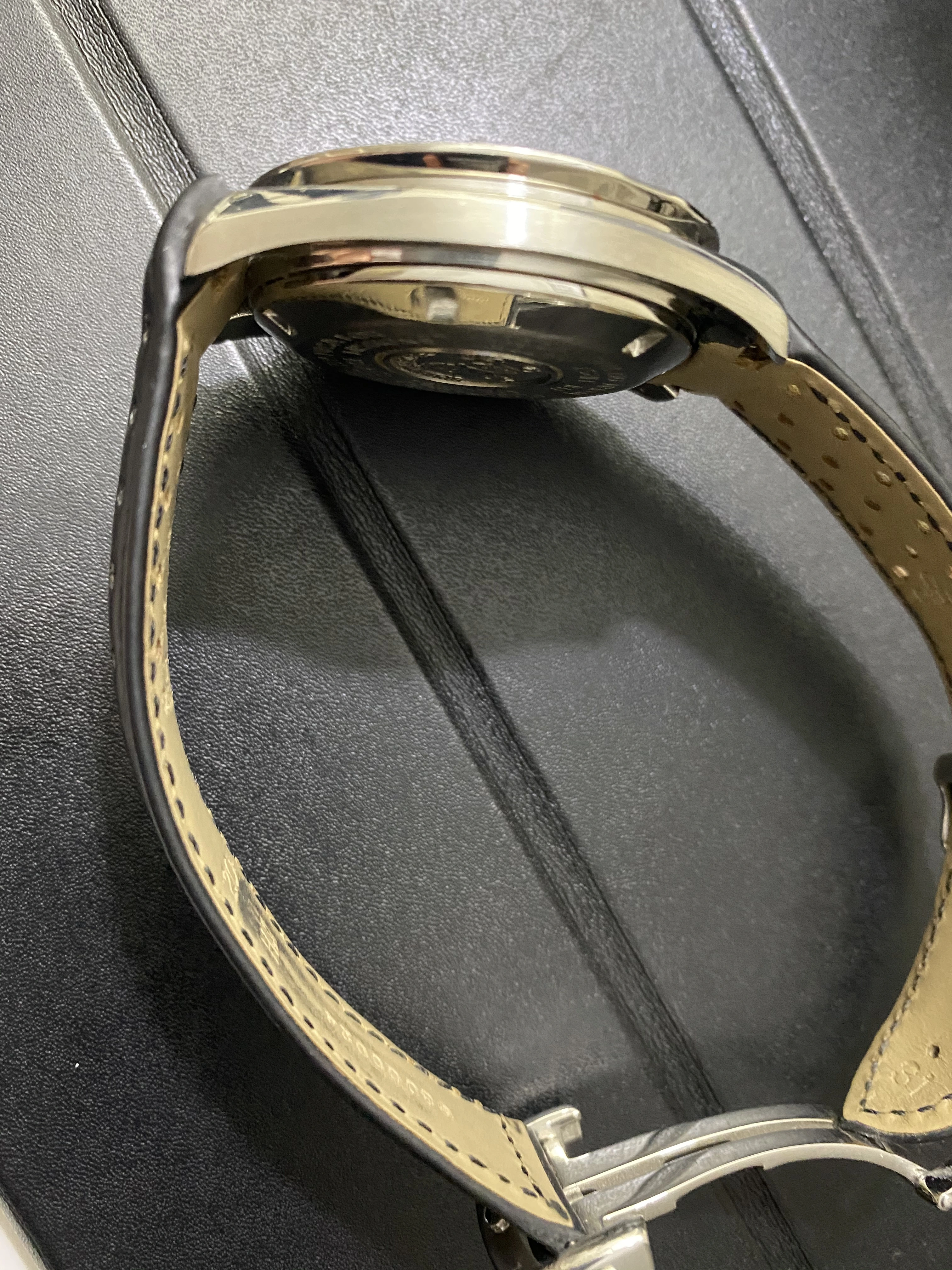

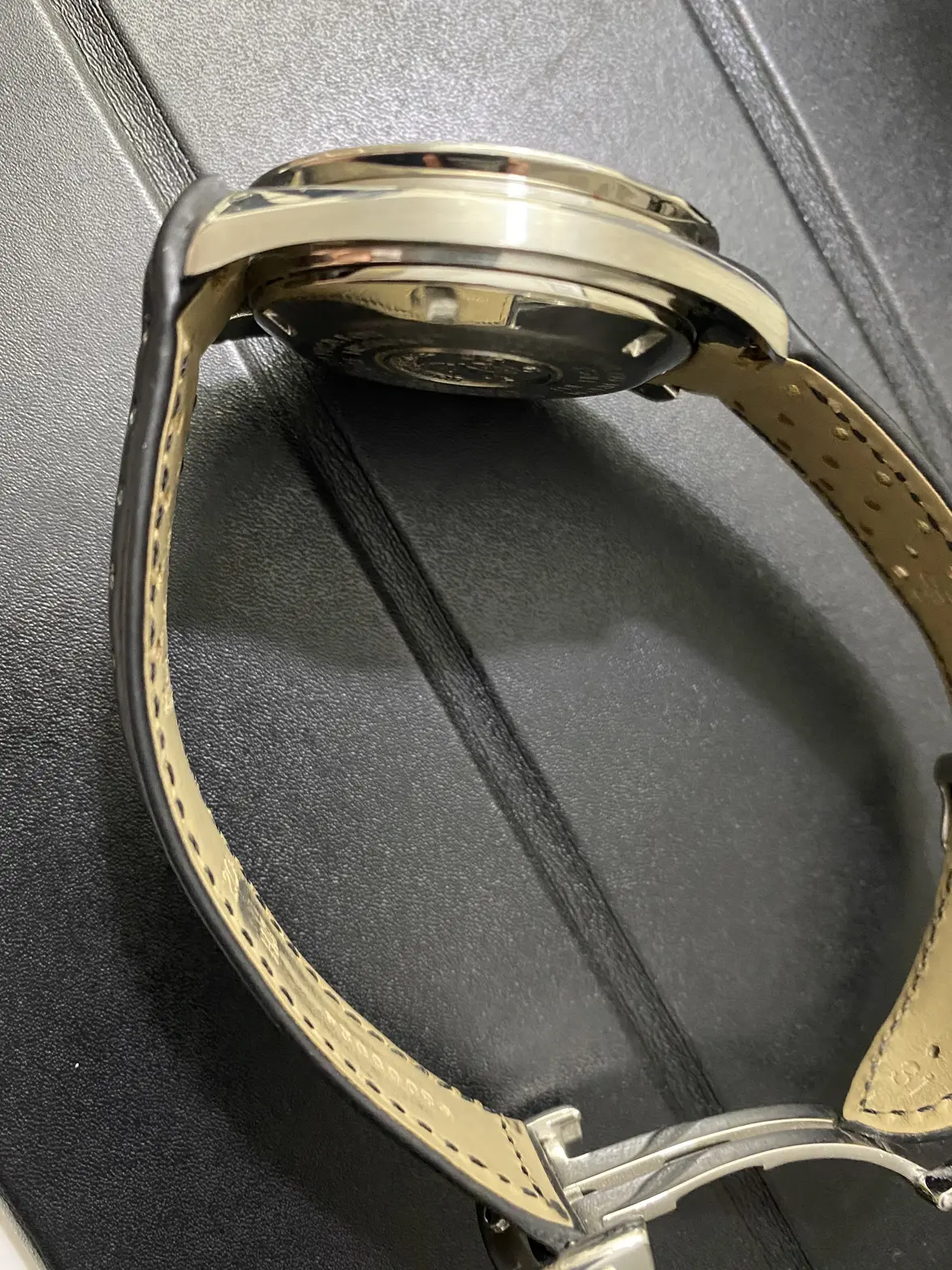

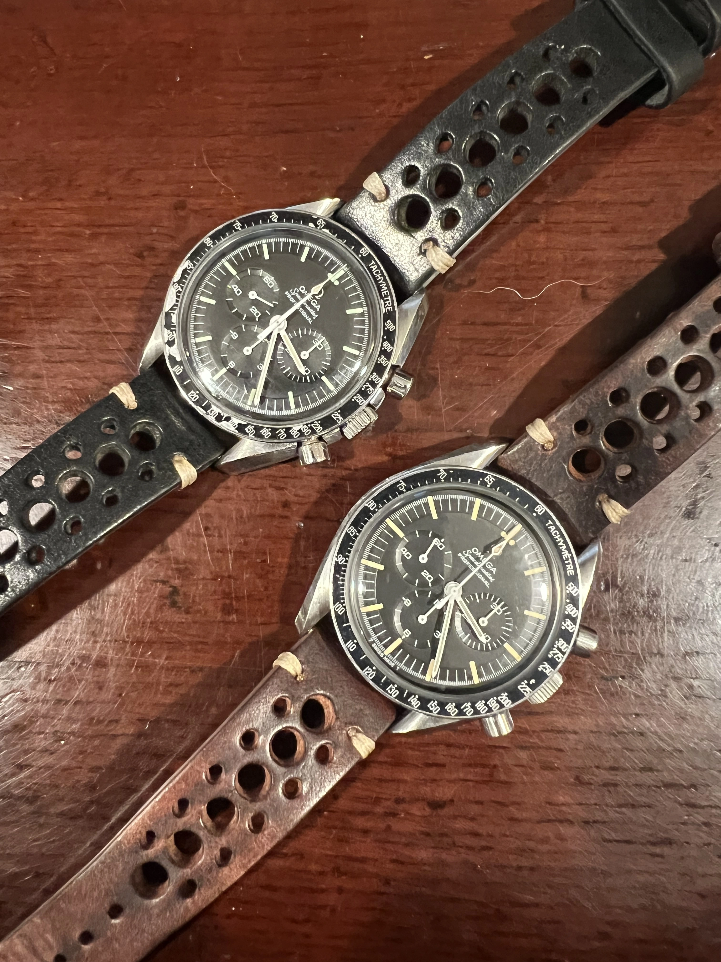

As per image, the rally strap does this. I place slithers of tape on top of each other to pack it out to prevent this. The tape is placed on the case between the lugs and where the strap should stay seated. I was told this happens because the case has been over polished. I’ve also been told it’s due to the strap not being made for this watch. I’m unclear which it is. Simon Freese has had the watch many years ago and said the case was over polished and he could correct this and it would prevent the rally strap doing this. I don’t have much knowledge of watches but I wonder why anybody would polish so much between the lugs, where it will be covered by a bracelet or strap?
6,201
30,230
Don't think that strap fits that watchhead anyway. Just measure the space between the lugs and order a normal leather strap that fits without the integrated look. It looks like the design of the carbon strap on my X-33 which I wouldn't fit on my moonwatch.
3,301
7,282

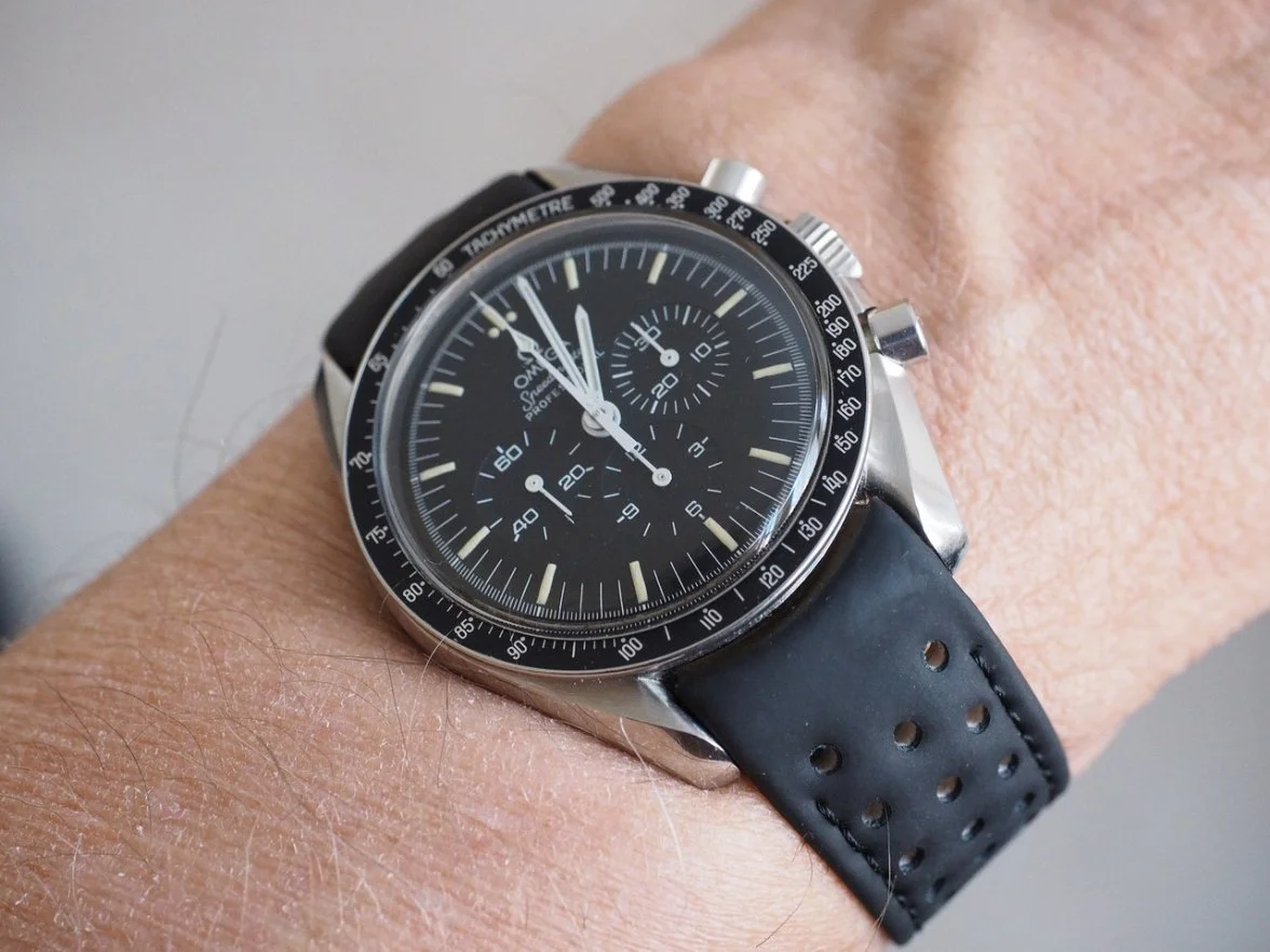

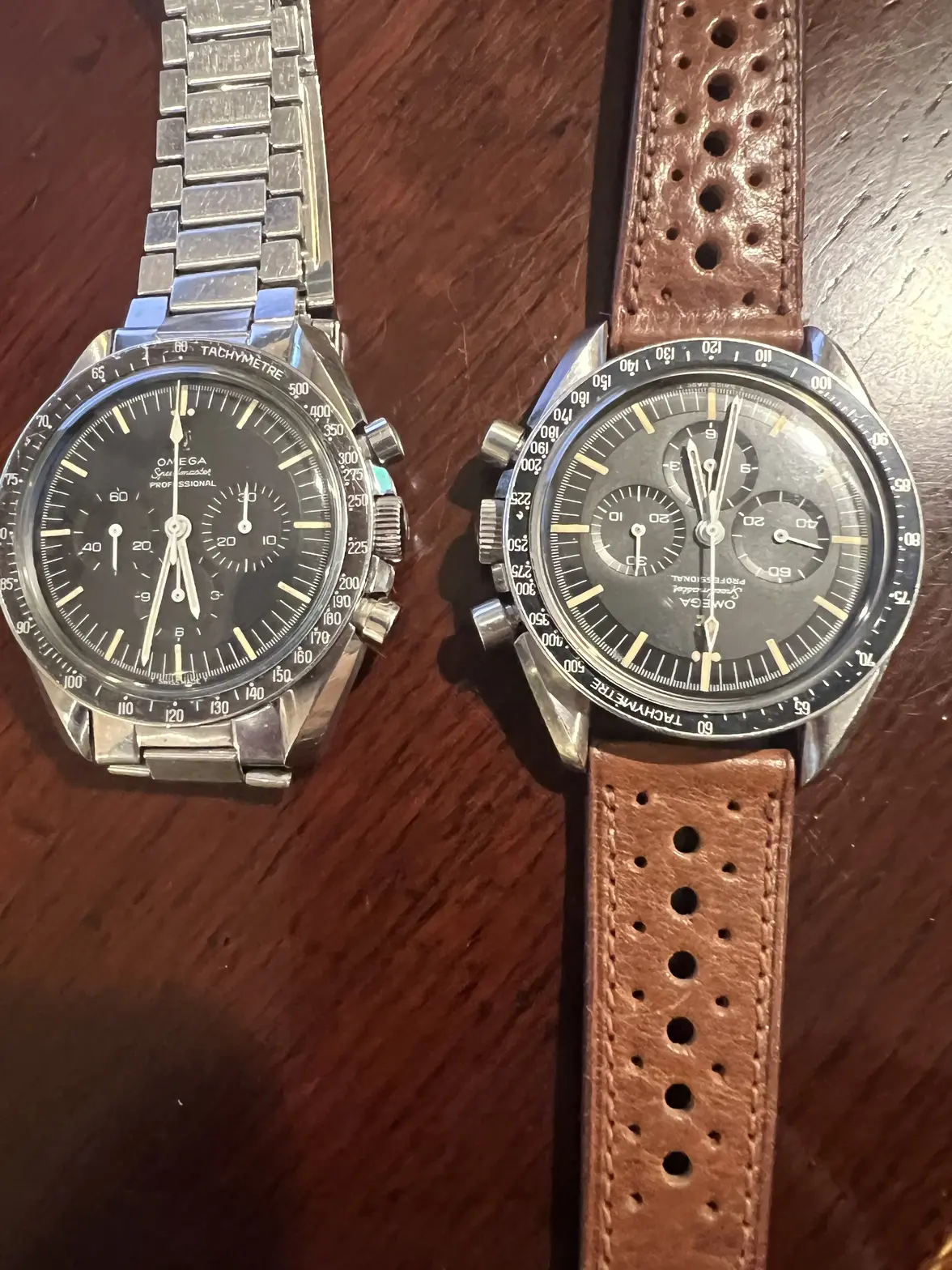

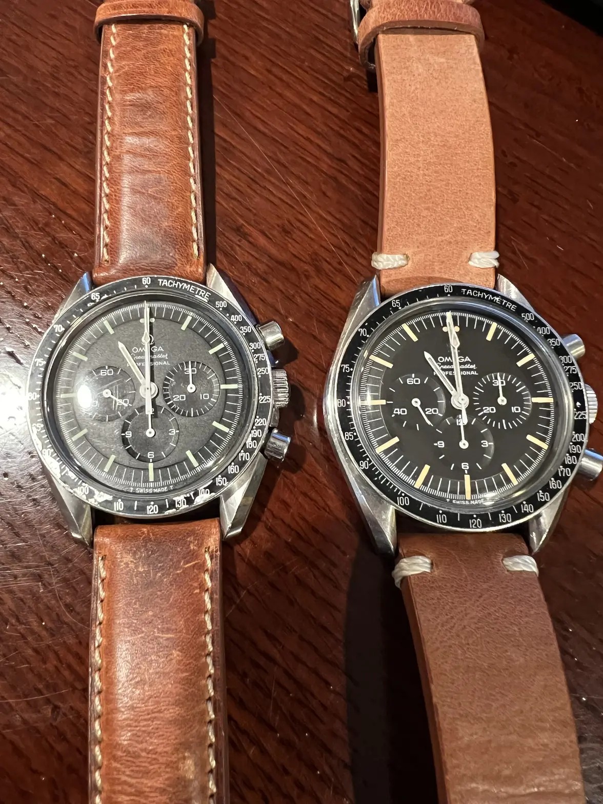

I think you just have a strap that isn’t right for Speedy. If you prefer leather any 20 mm strap with straight end should fit fine. I doubt there is a problem with the case.

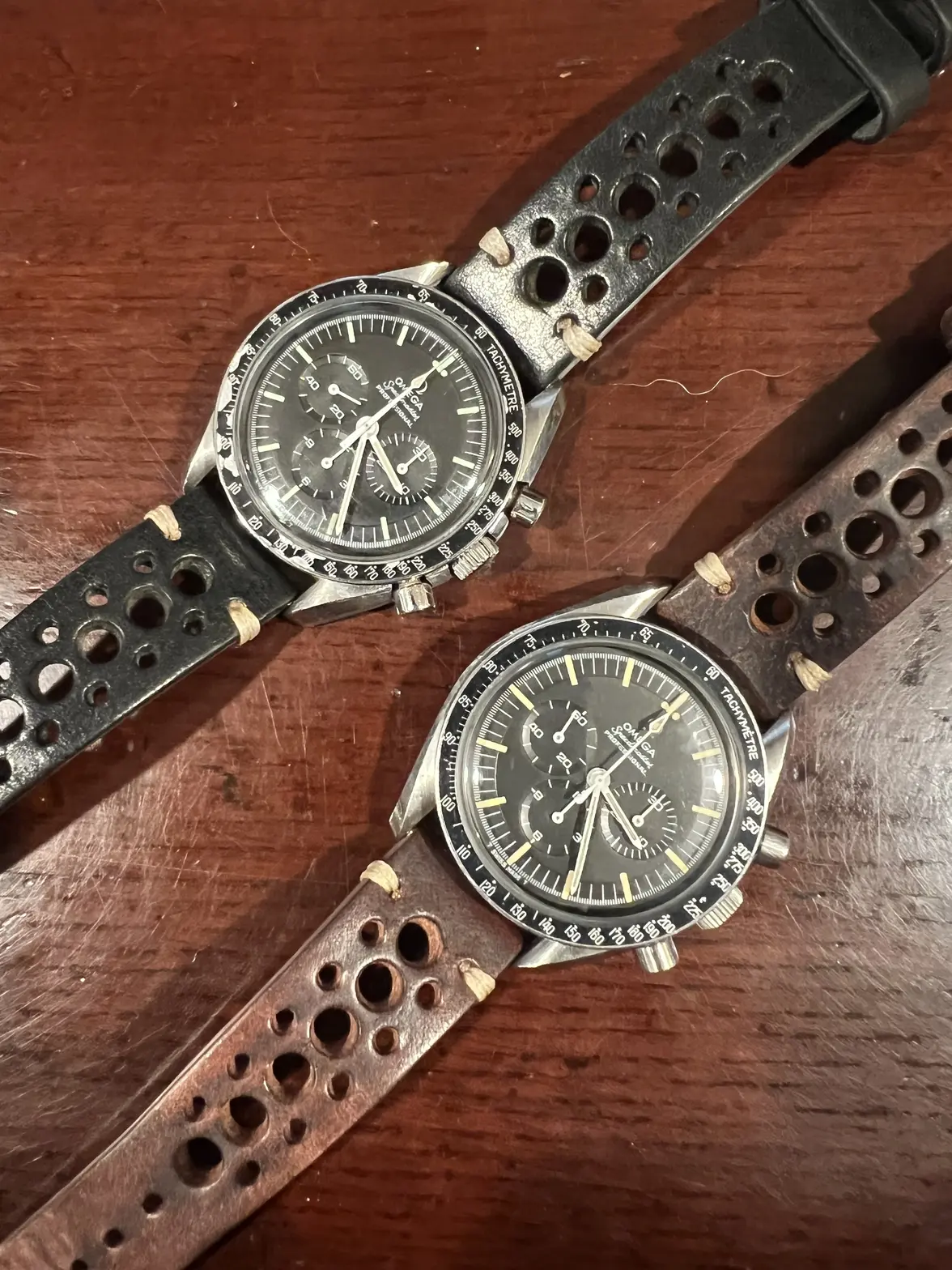

Some examples

Thanks for all responses. The rally strap fitted is the Omega ref: 98000024. I had been led to believe, at time of purchase, that this would fit correctly?
6,201
30,230
It was for the Omega - 3840.50.31
Speedmaster Split-Seconds, which was 43.3mm in diameter and 16.1mm in height, so there's the problem imo.
1,667
3,397
Maybe it needs beefier springbars like 2 mm diameter ?
108
44
That may fix the issue. I’m going to take it into the watch shop next Saturday so I can ask them to try larger diameter spring bars on it.

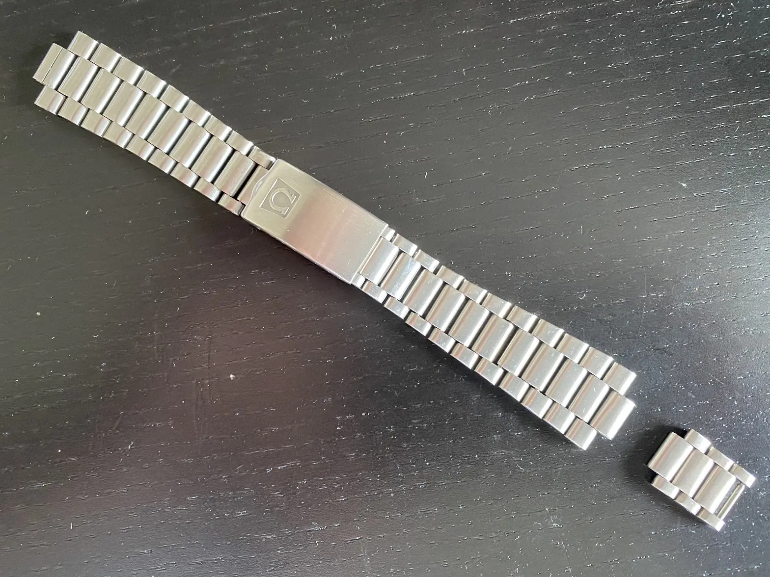

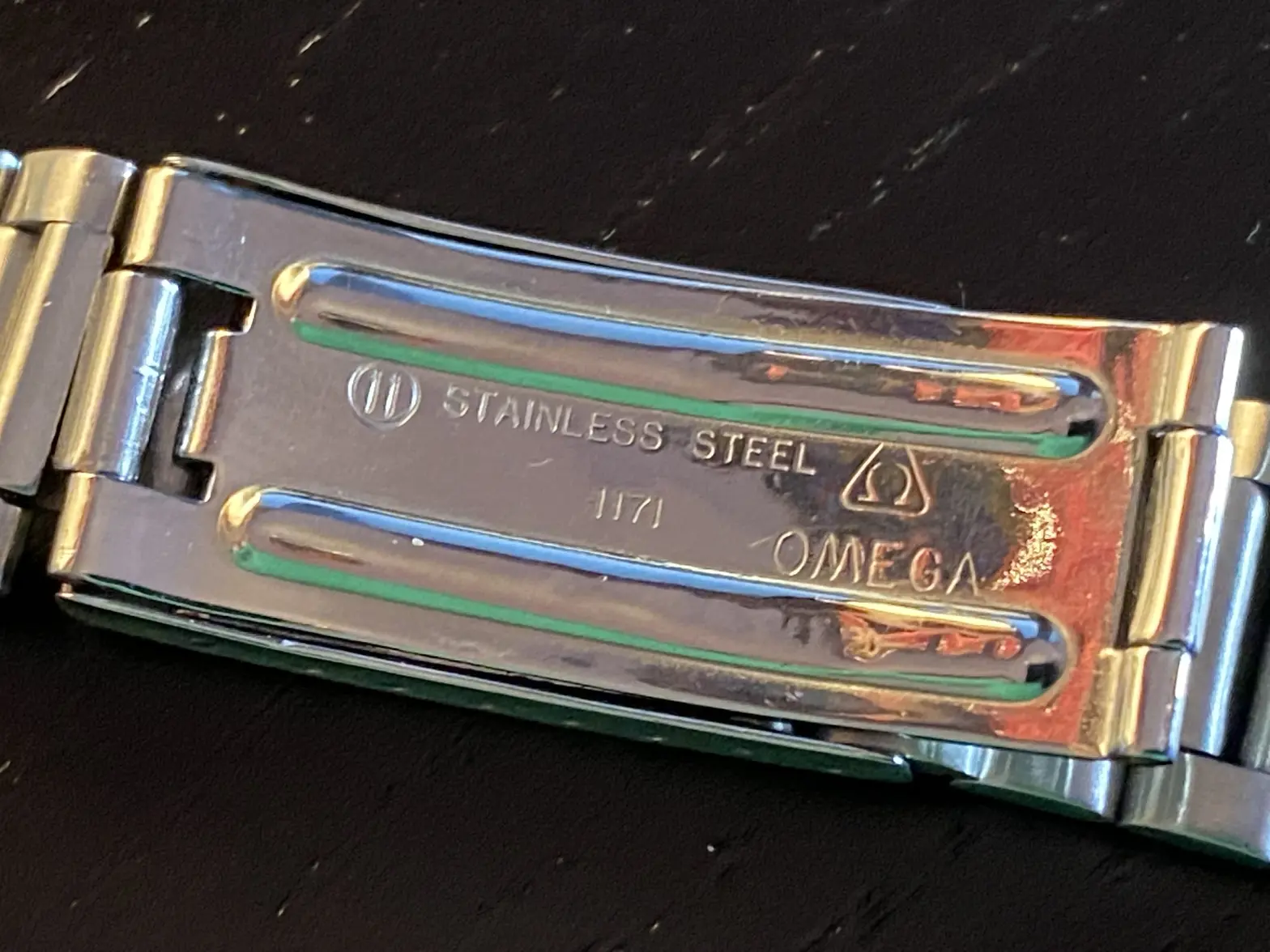

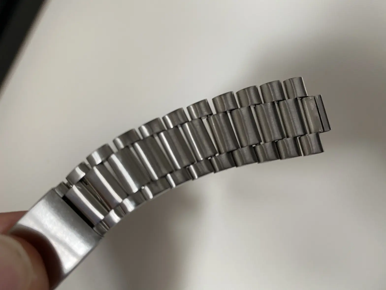

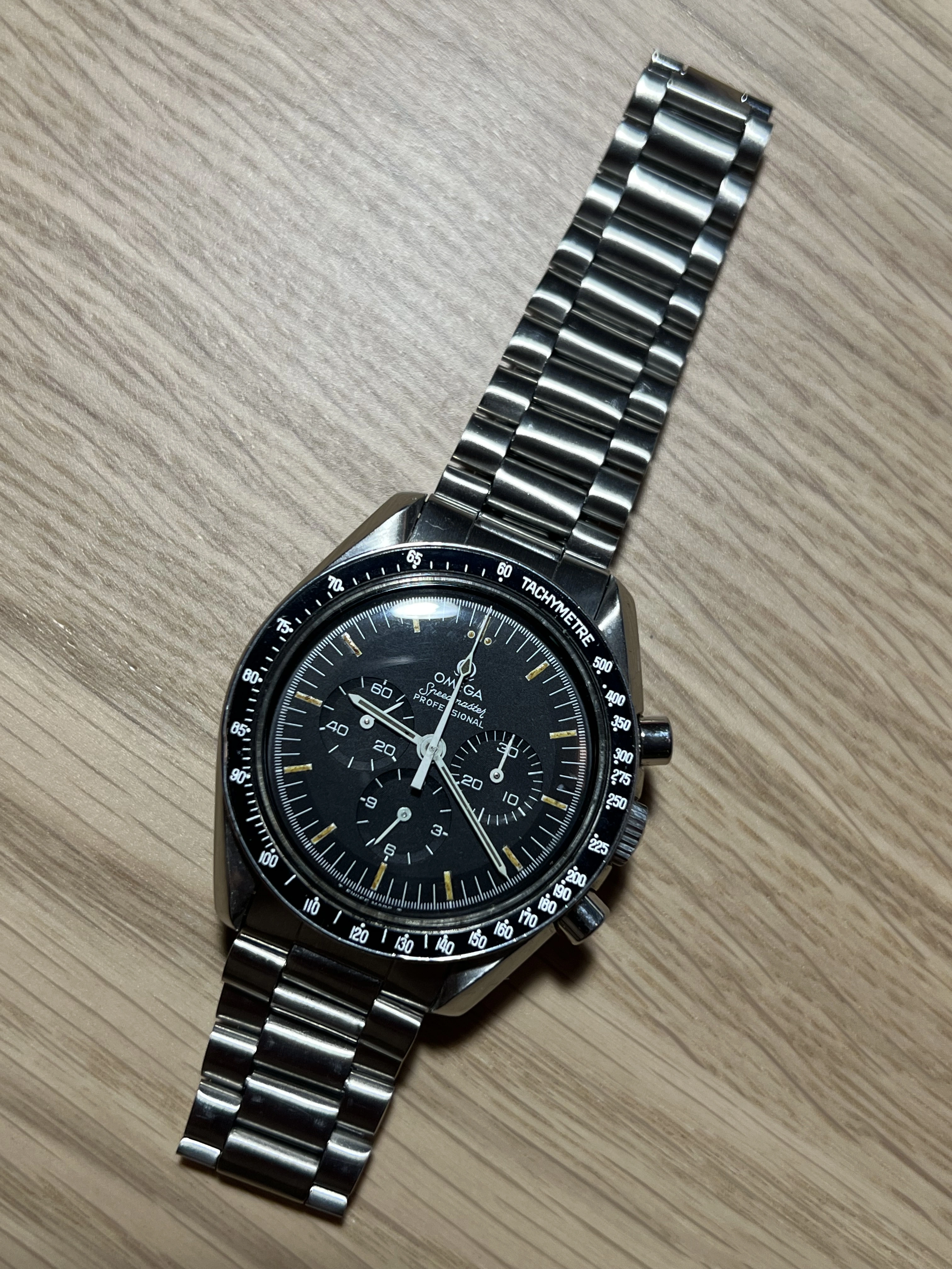

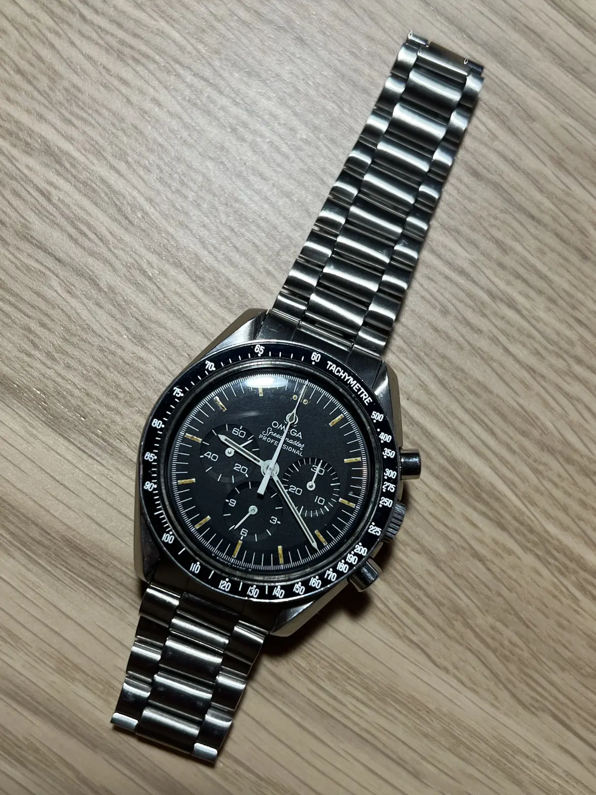

Just revisiting this thread as some questions went unanswered.

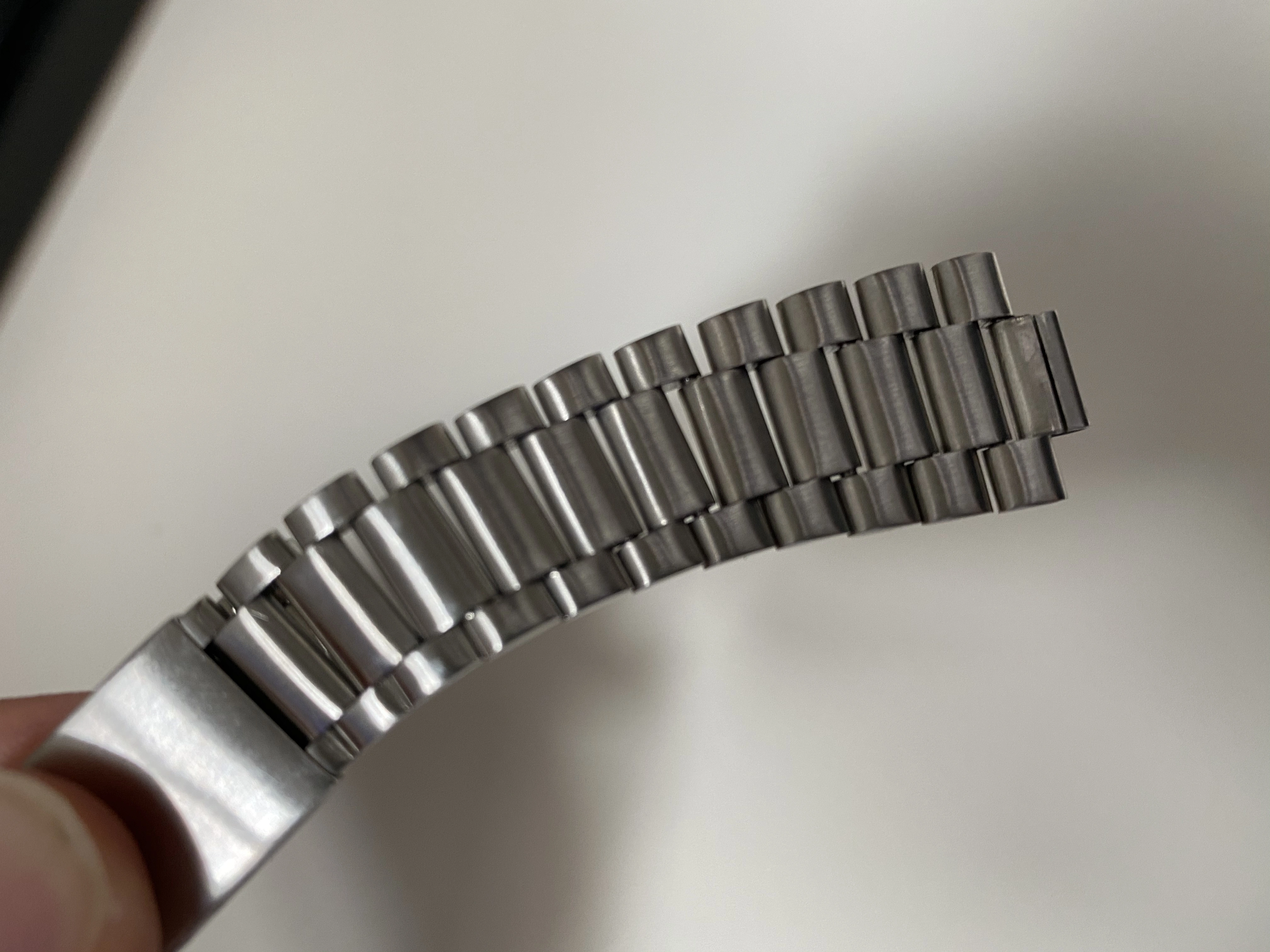

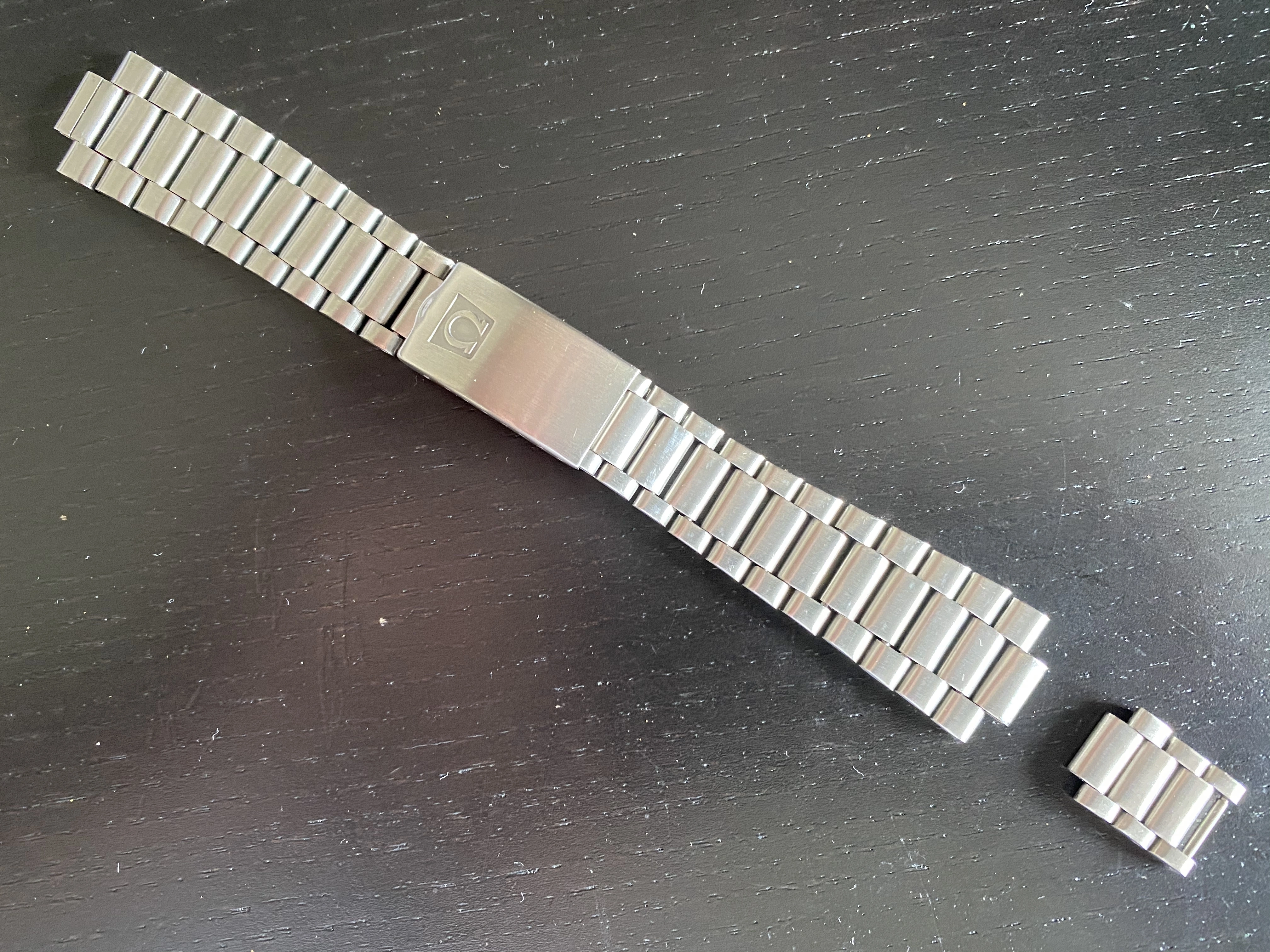

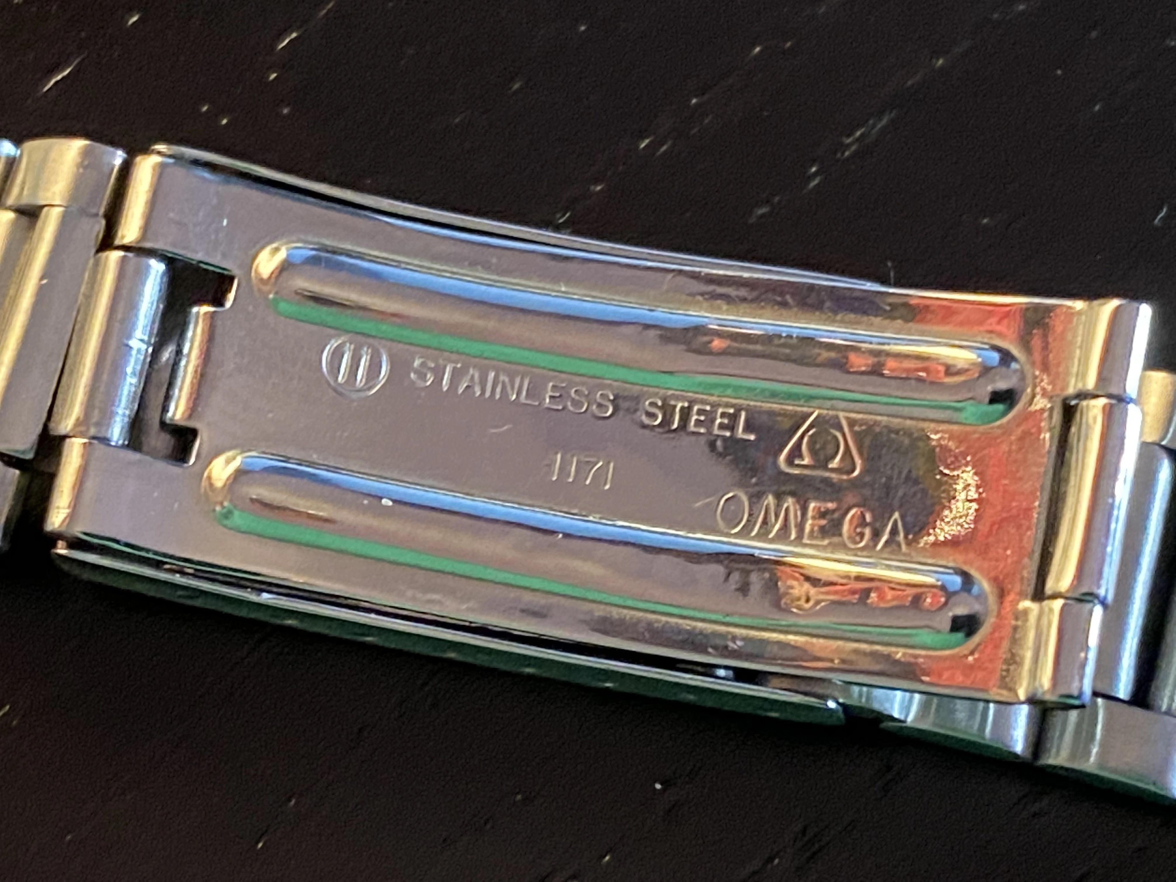

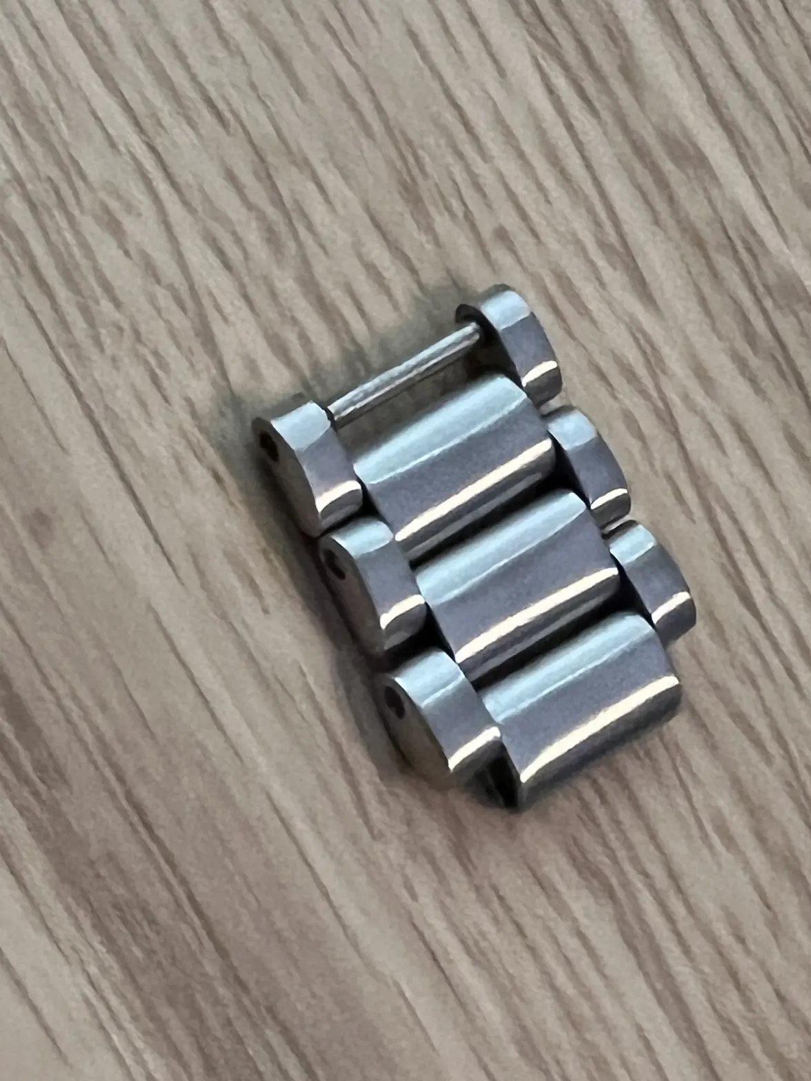

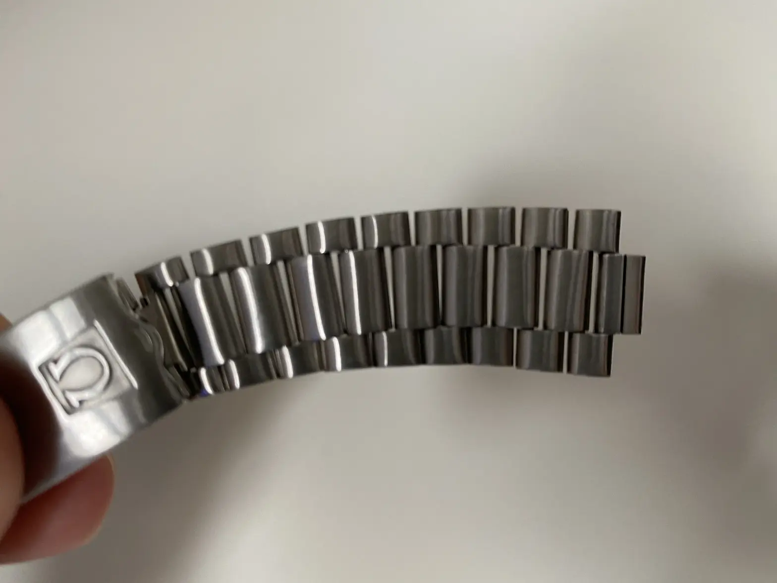

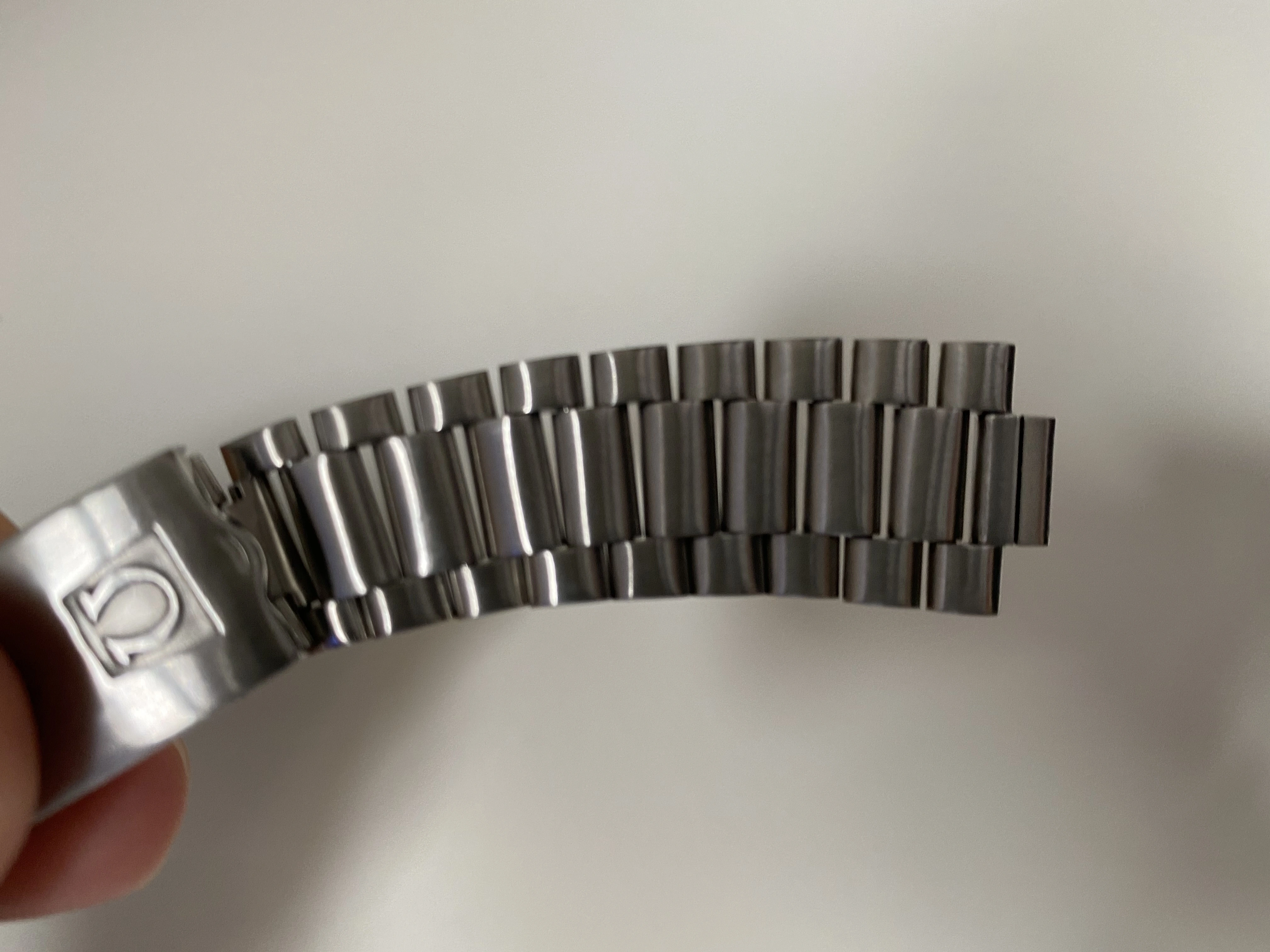

Can anybody give an opinion on the bracelet based on the images? I tried to show the curve to demonstrate the level of stretch. I have no idea if mine is considered poor condition or good.
Also, the clasp, is it easy to ‘adjust’ so it stays closed? I wouldn’t wear at the moment as it pops open so doesn’t feel secure.
TIA, CH
3,301
7,282
The bracelet is a good 1171. Doesn’t seem too stretched to me. Do you have the endlinks? They are 633 usually.
You can get watchmaker or jeweler to adjust clasp not a problem
