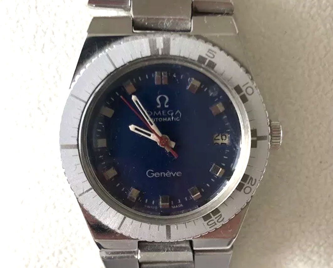

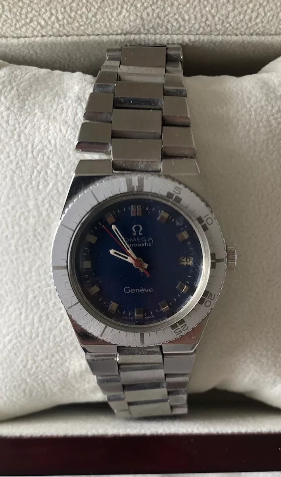

Hi guys! Could someone please tell me which reference this watch is? All I know is that it's an Omega Automatic Geneve.
And what's it roughly worth? Serviced?

With such low quality pictures from the front and no pictures from the inside of the watch (movement shots), it's hard to make a judgement. But my hunch is it's very, very likely to be a junk.

It looks like the 366.0823 but the dial proportions look like it may be the ladies version (midsize). If it is the smaller one then the value is a fraction of the 35mm version.
I don’t know the ref at all, but it does look fake, or at least poorly redialed with poorly repainted hands. @HenryBeer, what’s the backstory on this watch?

Well the name of the thread seems appropriate... streched bracelet, strange Omega logo, strange proportions... but it seems reference 166.0124 so I would not say it is fake

If it’s the full size version I agree it’s a 166.0124 but I also think it could be the ladies version.
Confirming the case size is critical.
Dial originality needs better pictures.

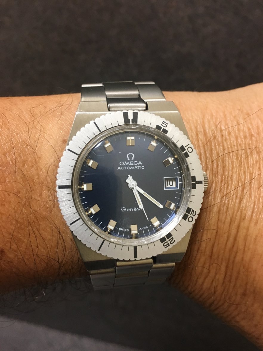

That dial just doesn't look right, I think it's trying to be this:

Thanks for the info everyone, I think the dial is fake at the very least.

That is a gorgeous watch!
Unfortunately not mine, I grabbed it from another thread.
