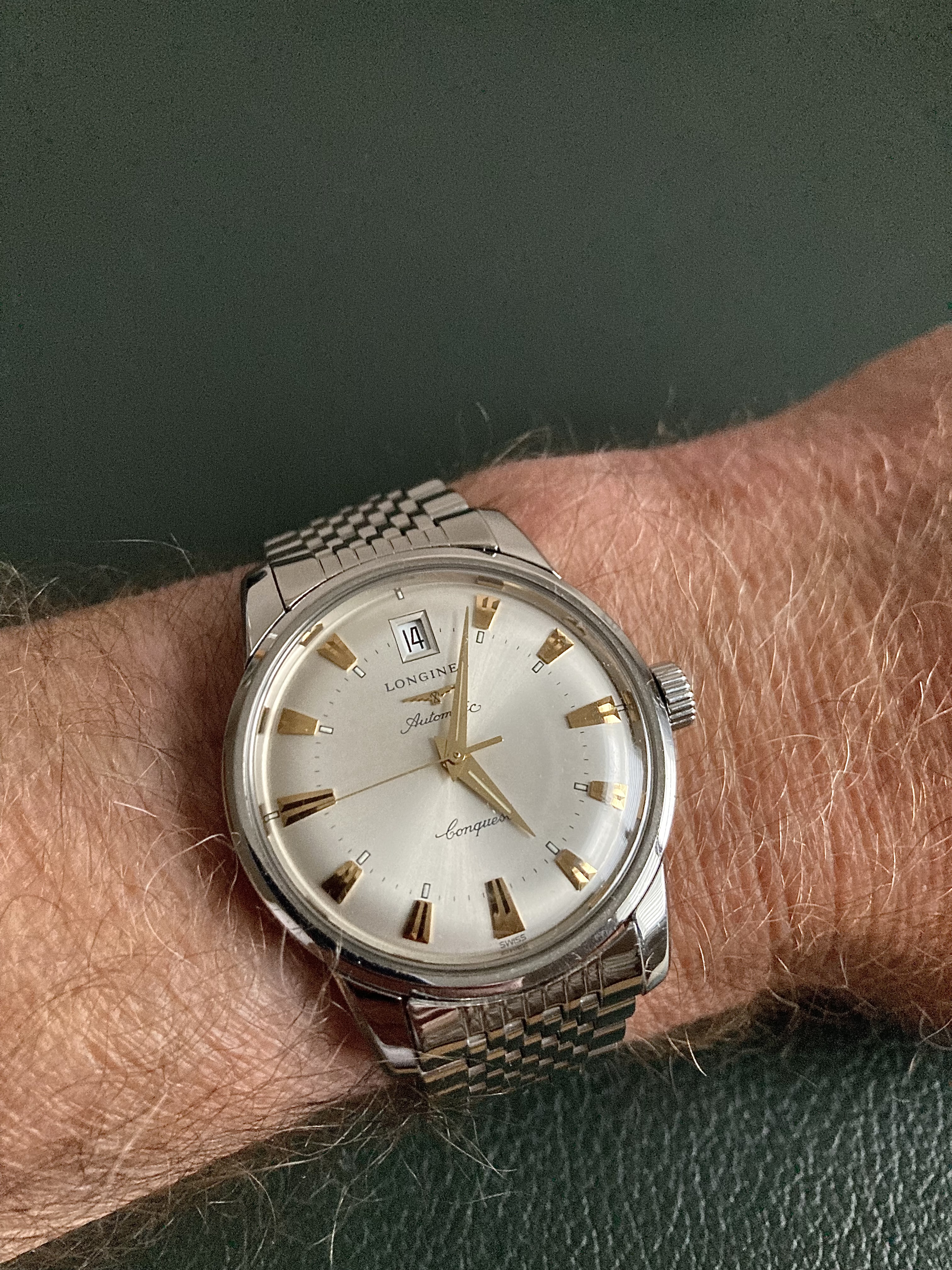

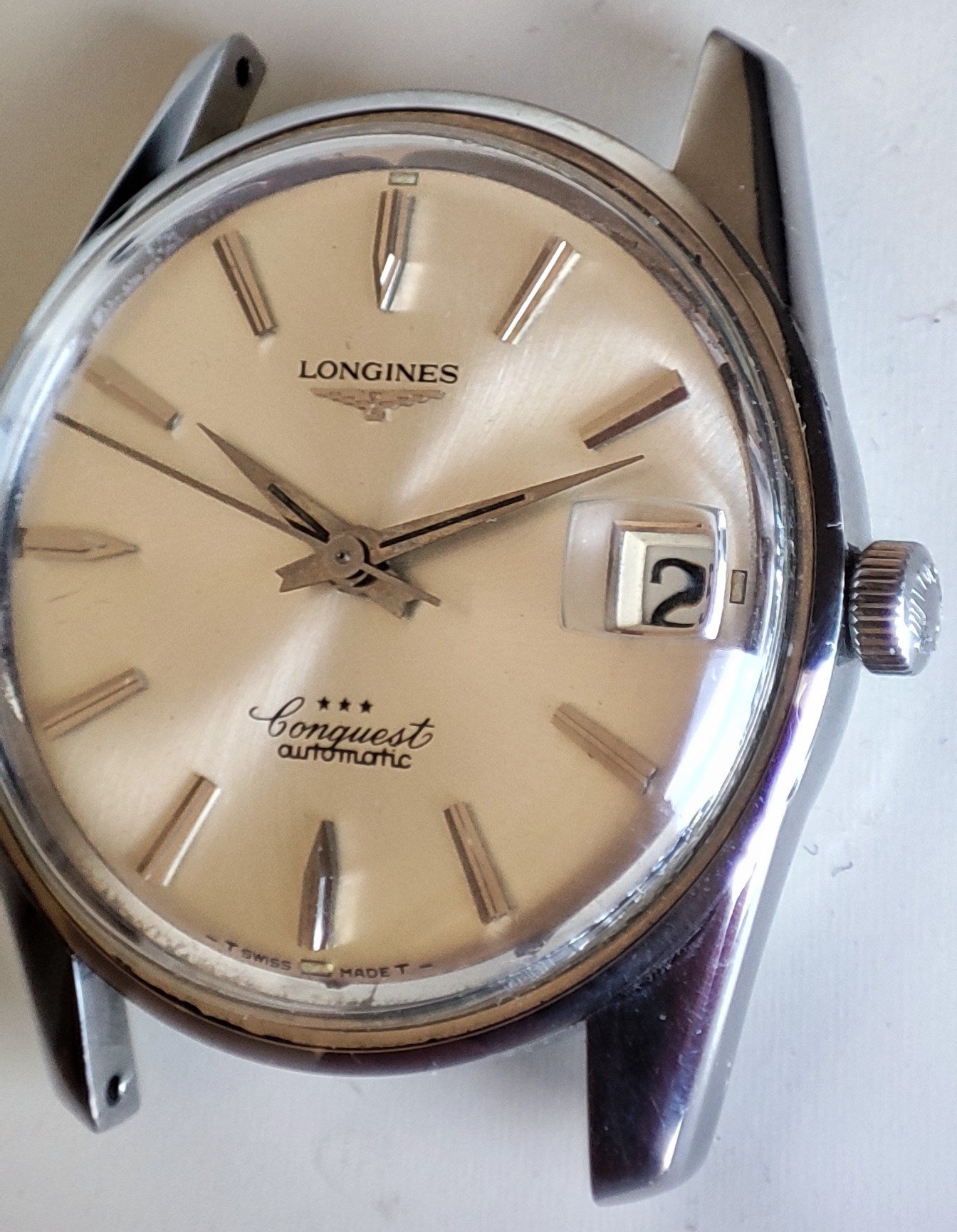

I've come into a little spare cash not a lot but it's mine, not the wife's or for the house, all mine
Anyway I've had yearning for a omega pie pan but trying to find a un molested one at the price is awkward.
So my equal love of longines has led me to this, I would be gutted if I make another redial/refurbished error.
So if the experts can pass comments on this I would be enormously grateful.
2,829
4,948

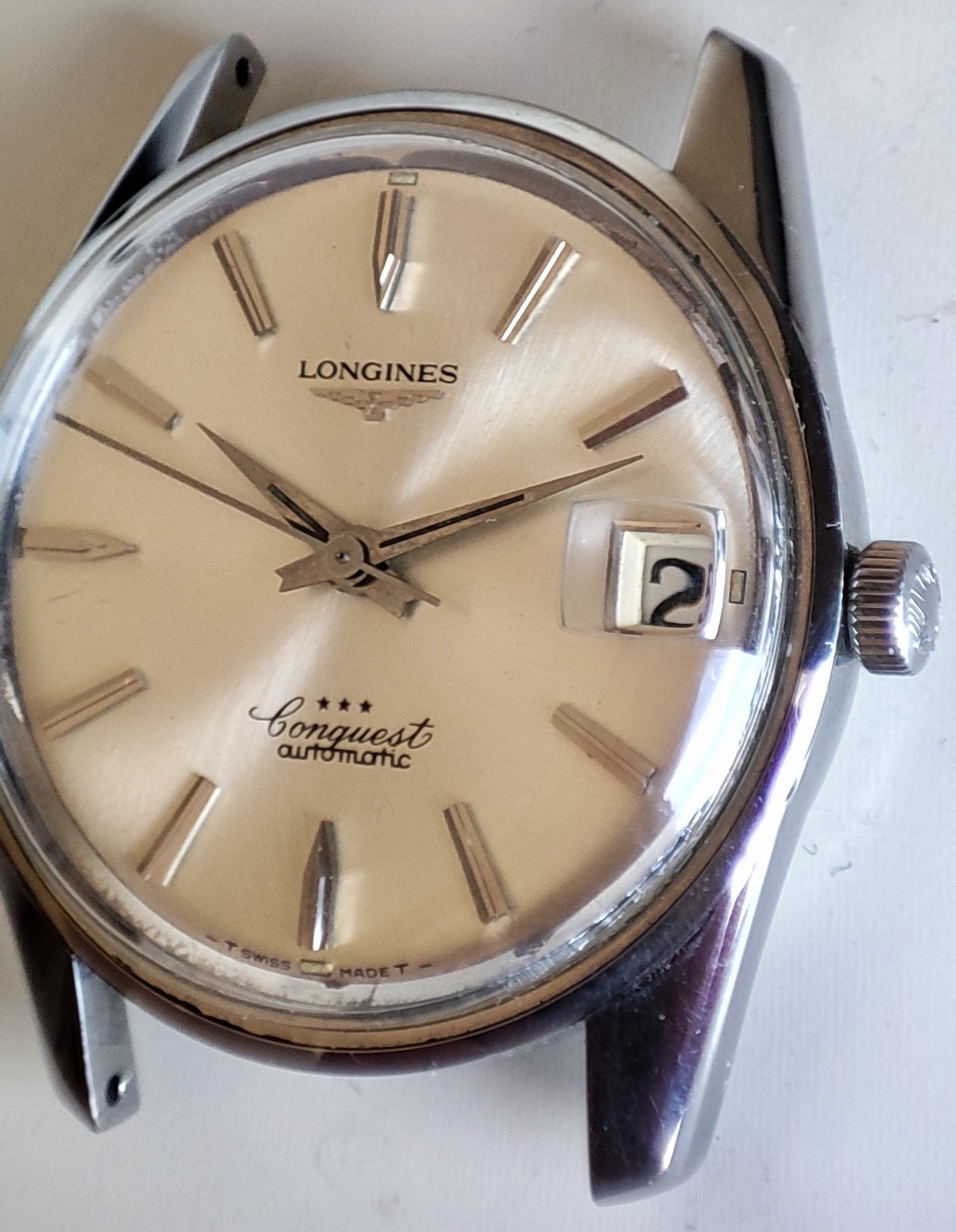

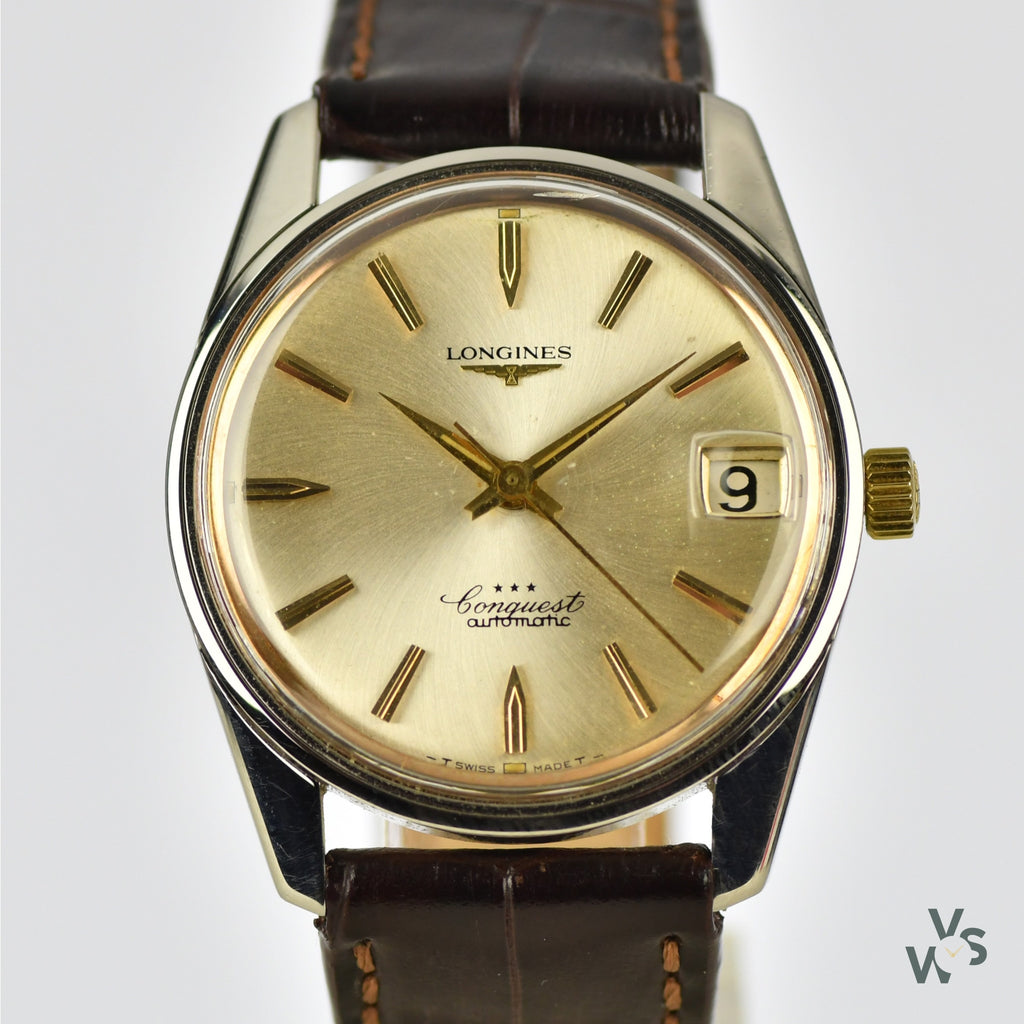

Dial looks fine, but the lugs look polished. Reference 9044 should have a clearly defined facet on the lugs (see below). Also, the price of $1400 is very high.
Source: https://omegaforums.net/threads/longines-conquest-ref-9044.95410/#post-1244799

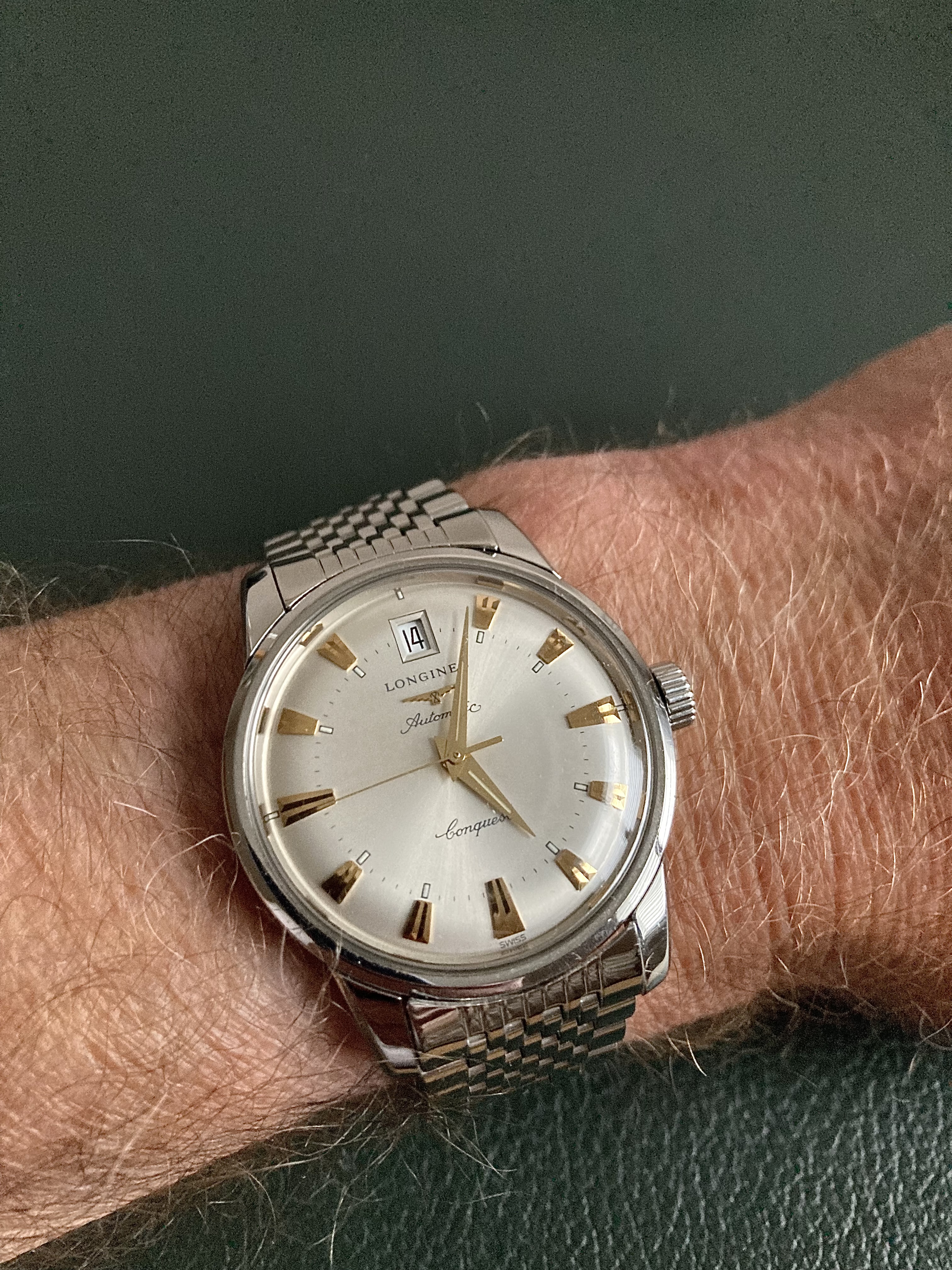

Longines are great and elegant watches but the price quoted is high. Unless you’re dead set on buying this particular model, you should consider buying a Longines Conquest Heritage - you can probably find a new one for that price and nearly new ones for around £600.

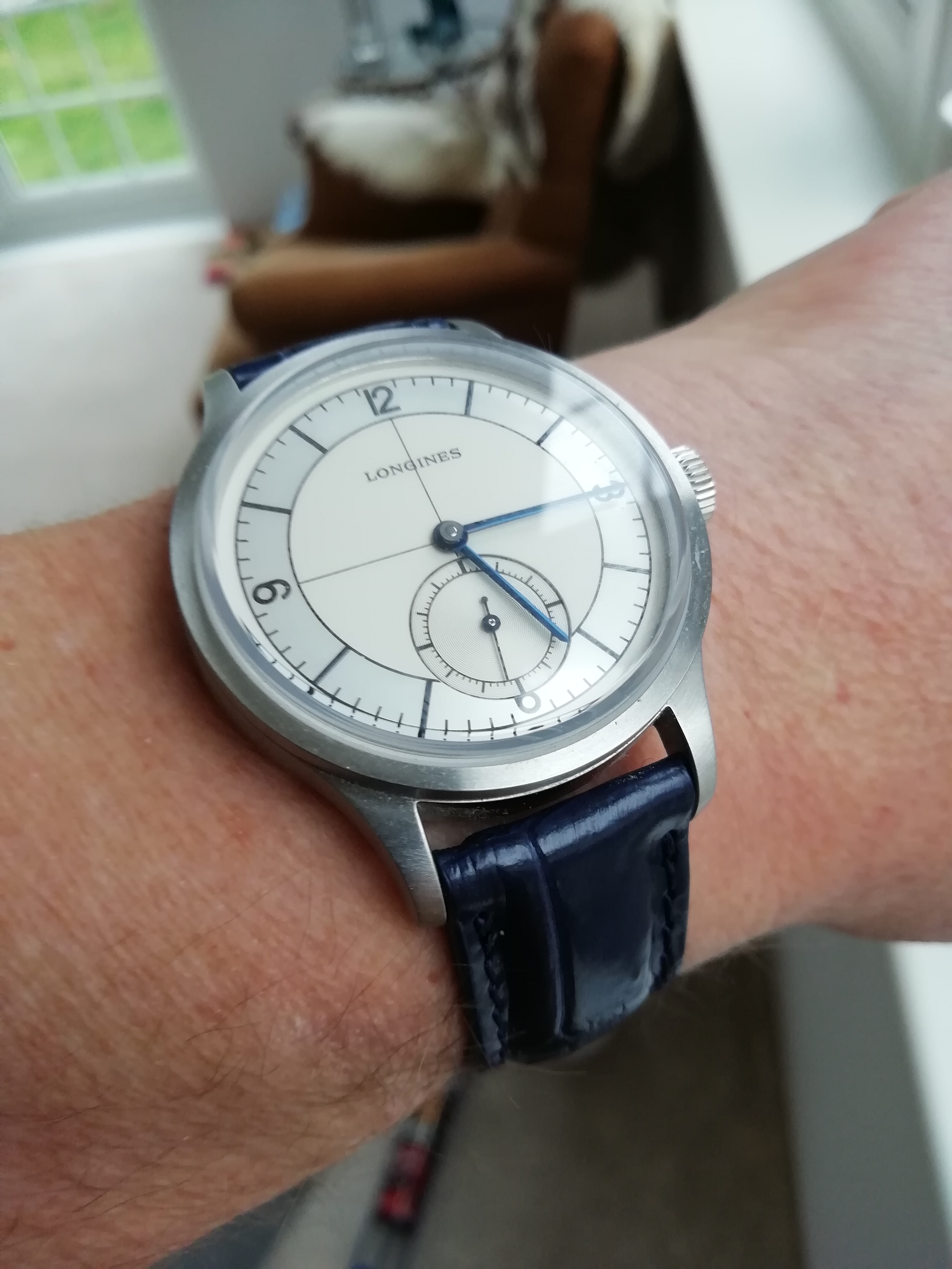

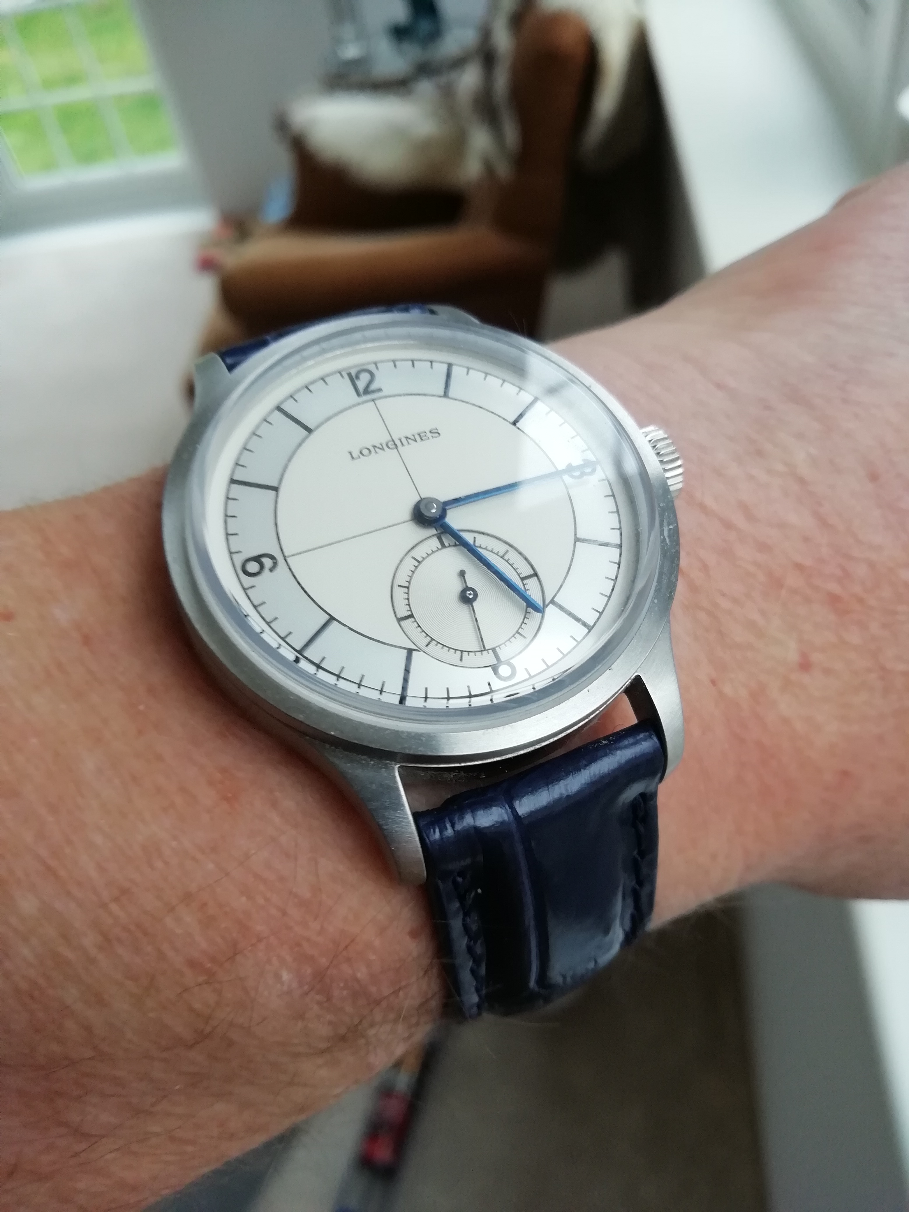

I have a heratige classic sector dial but wanted to add a real vintage to my collection

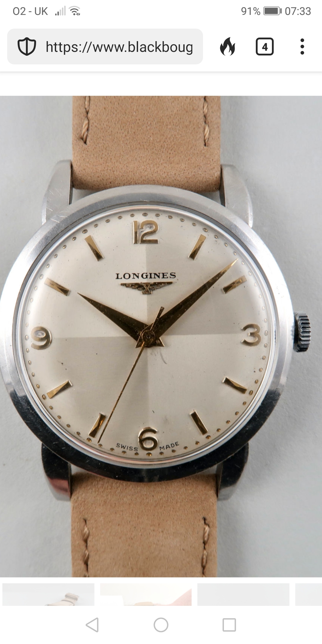

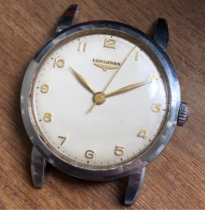

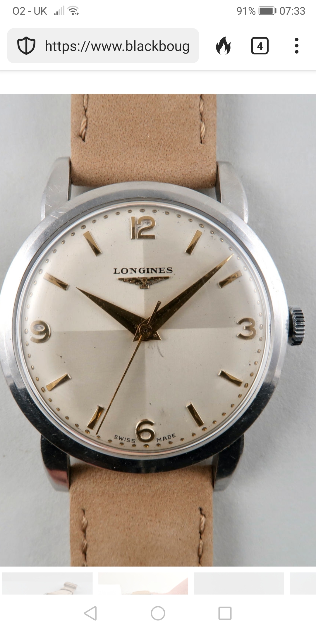

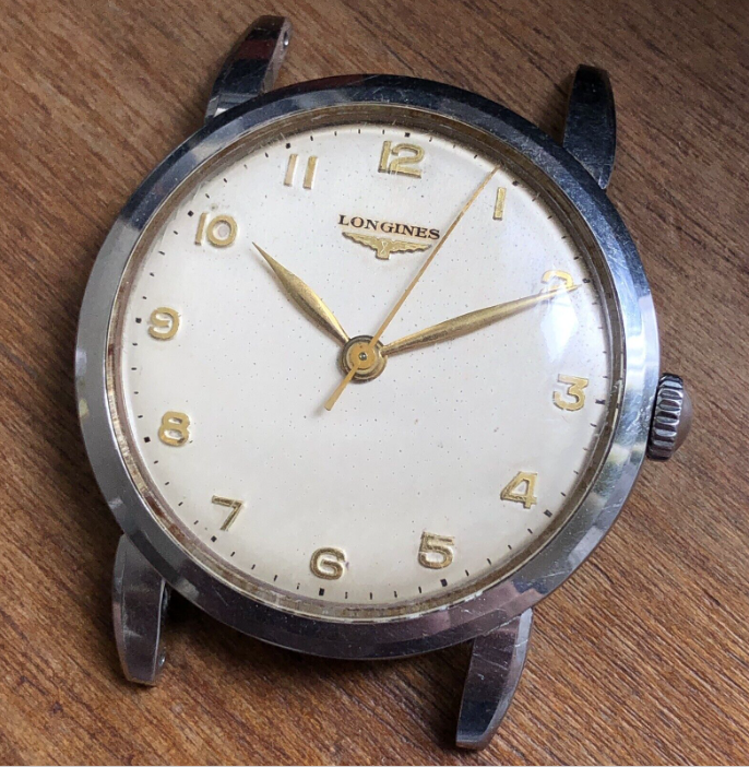

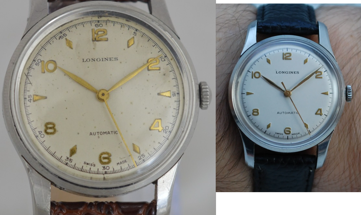

These two have caught my eye as well especially the last one.

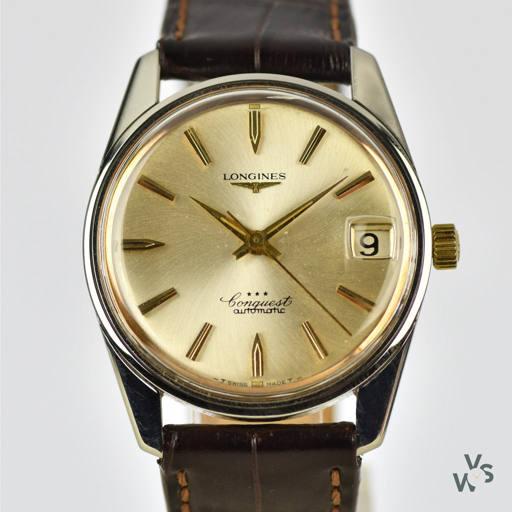

Ref 6379 and this one a ref 6446 my concern with this is the applied longines symbol looks crocked
Both are around £750
2,829
4,948

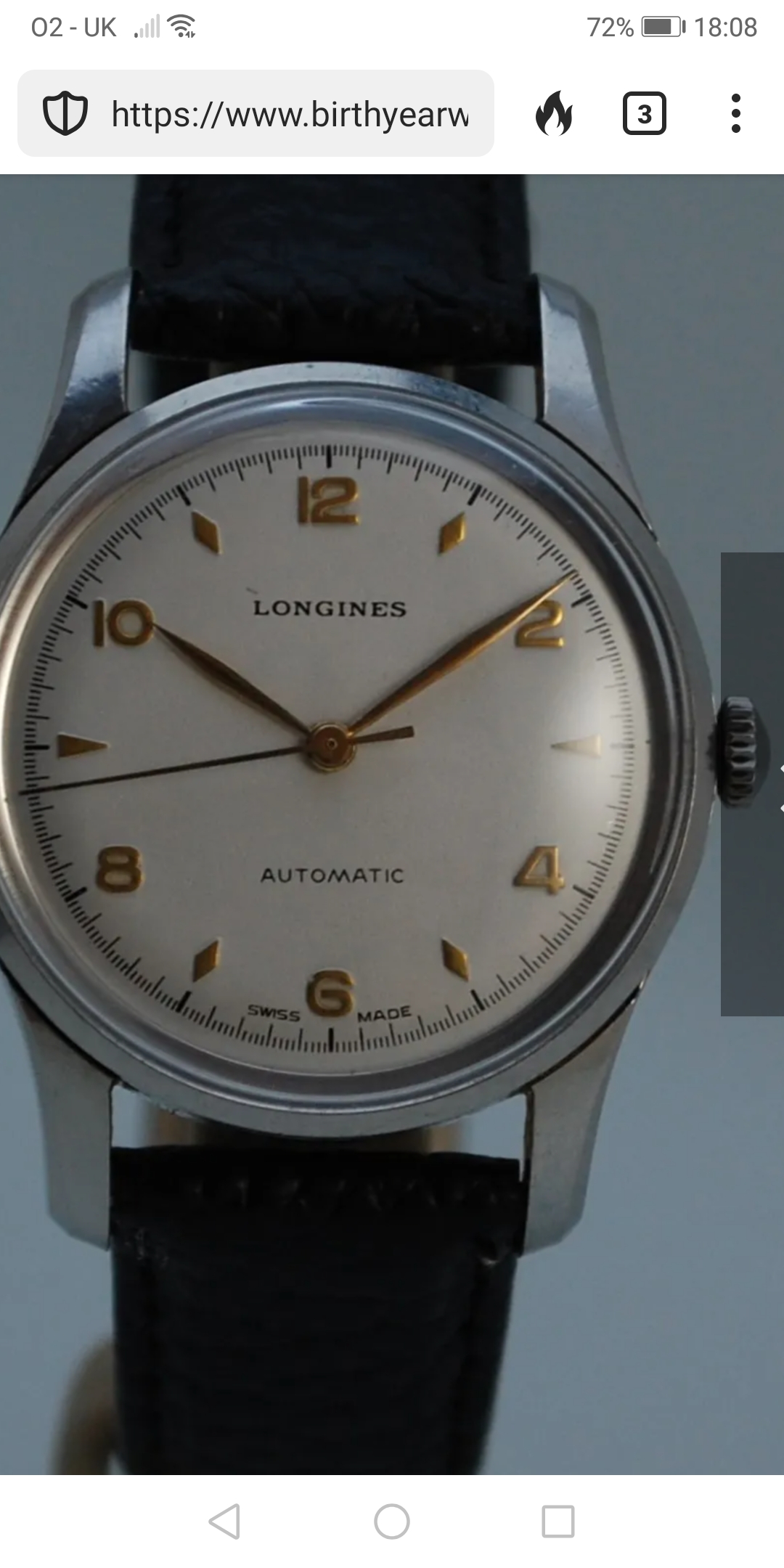

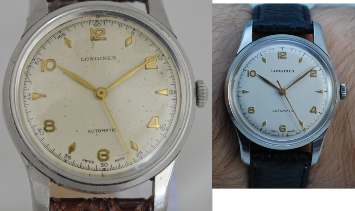

I do not like the look of the ref. 6379 dial (i.e. it might be a redial). Here is another one with close serial number (both start 8'640'xxx) and close case-back numbers (6379-2, 299 and 6379-2, 659).
Sources: https://www.kdclocks.co.uk/products/1952-longines-automatic-wristwatch and https://www.birthyearwatches.com/product/1952-longines-automatic/
The dial on the ref. 6446 is neat, but the crown is both not original and looks crooked. Below is a correct crown for comparison.
Source: https://www.ebay.com/itm/175620829156

Beautiful watch.
My initial worry was the dial was a redial as I thought the text was a little heavy but maybe not.
