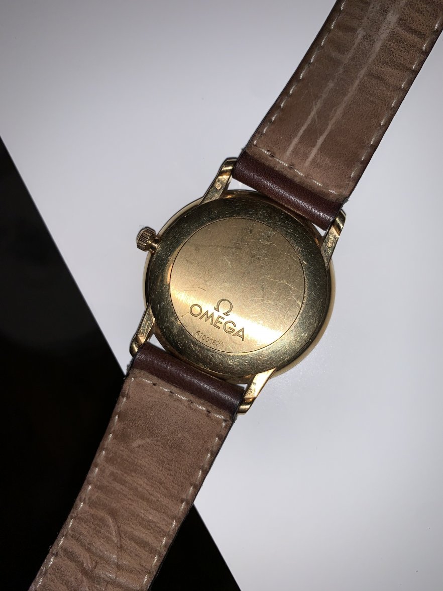

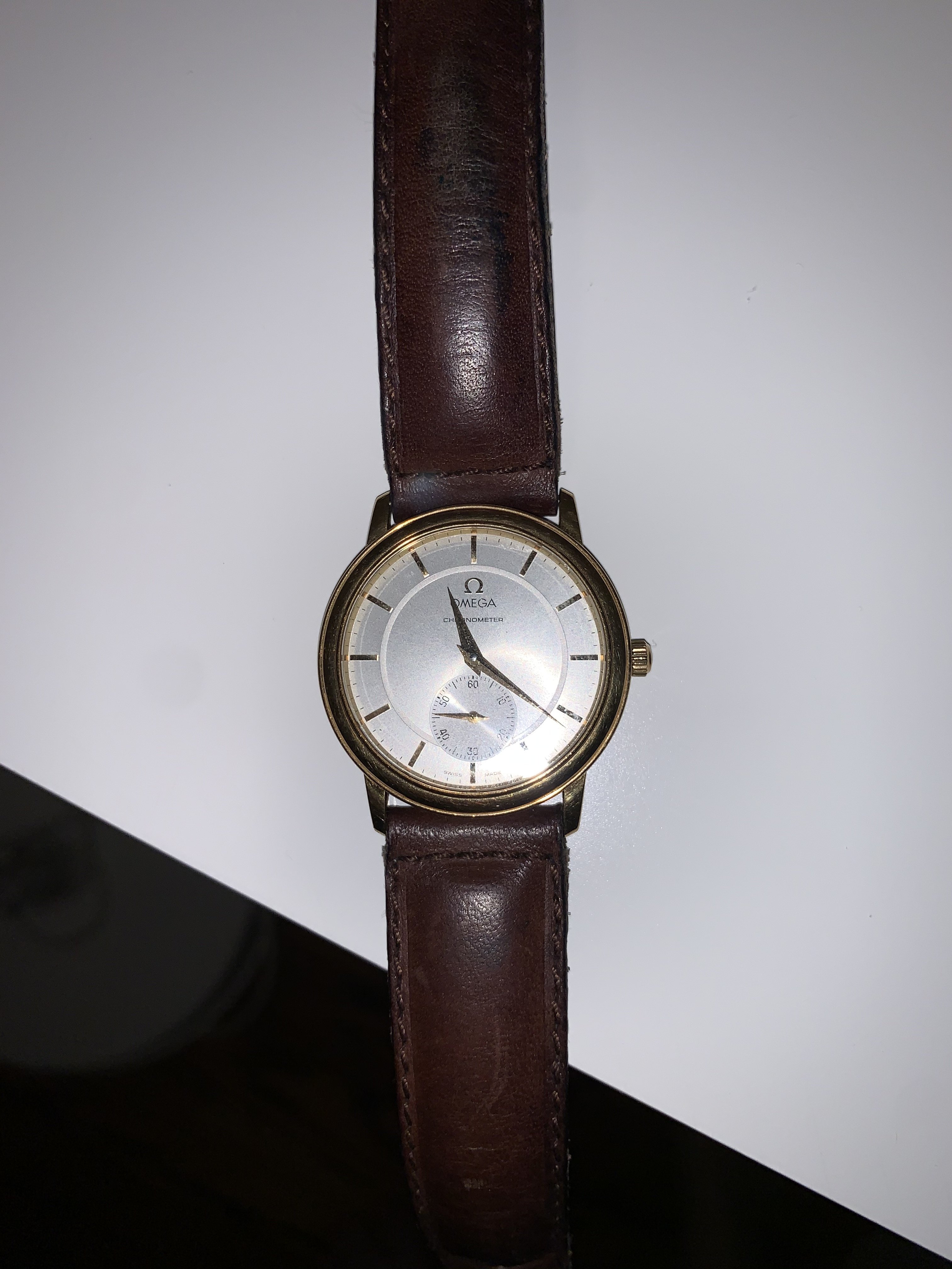

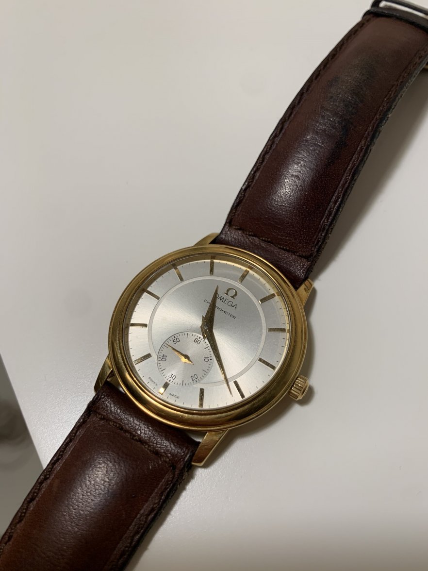

Hello all,
My girlfriend was just given this Omega from her father. Her father acquired the watch in the 1990s but we don't know much else. It would be great to know the age, model, and value.
Also, any recommendations on where to service the watch? Omega boutique in NYC wants $650+ which seems way too high.

Based on your photos I would say it is a De Ville Prestige Chronometer in 18K gold.
30,276
78,129
Serial number: 61001821
Article ref: 46203102
As Norm stated, it's a De Ville Prestige Chronometer in 18K gold, 34.4 mm case, with a Cal. 651/652 inside. Manual wind only.
