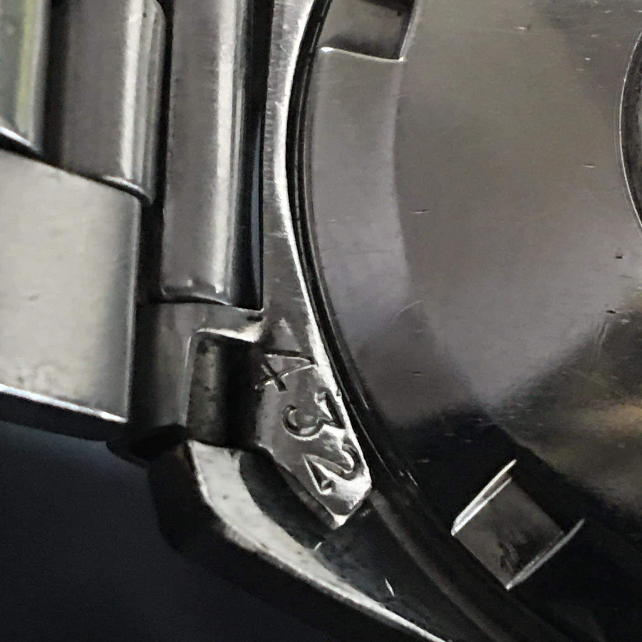

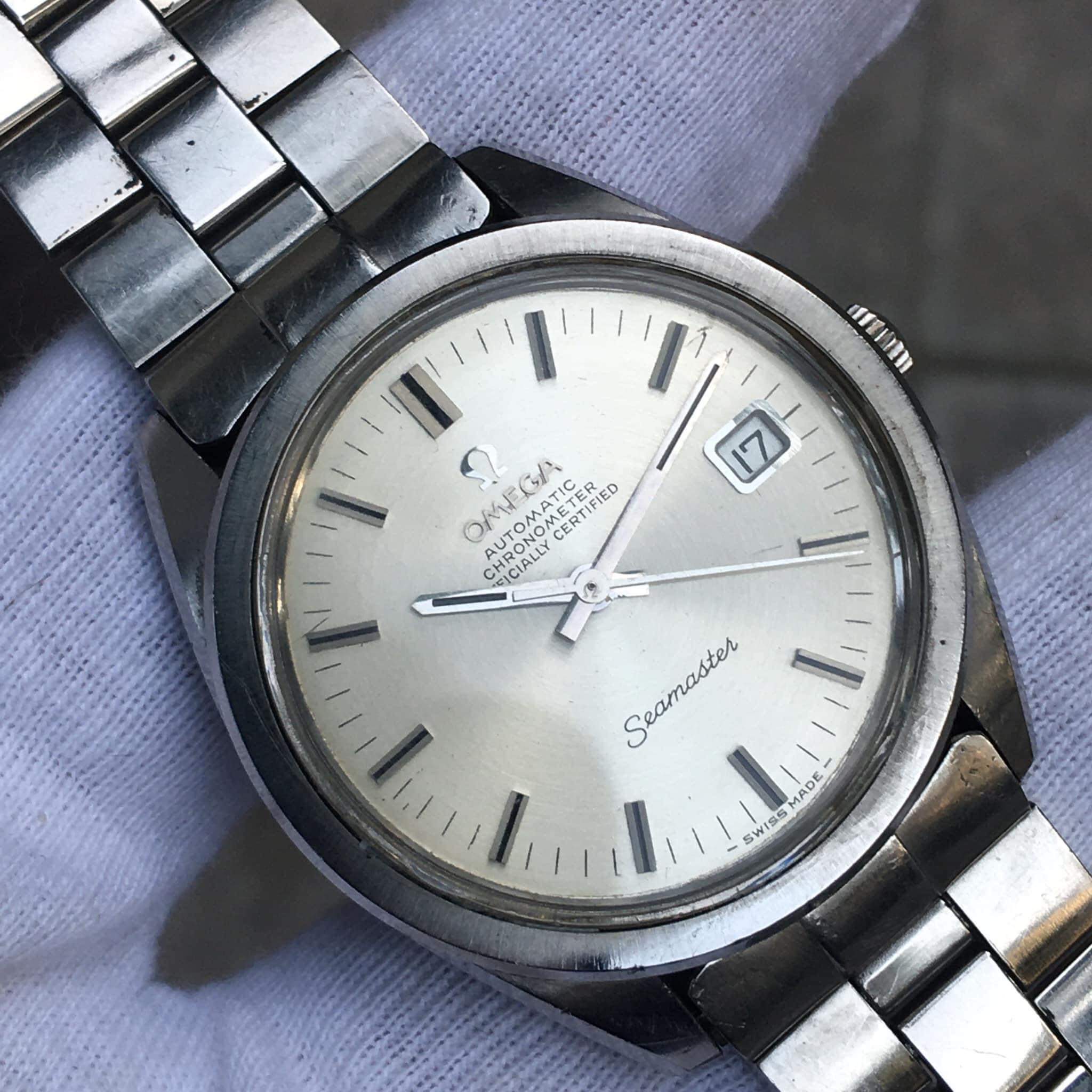

Hi guys,
Anyone know what is the ref of this bracelet.
Seller claims it is original omega. But I can not seem to find the matching ref for it, any idea?
Thanks a buch.
Harry

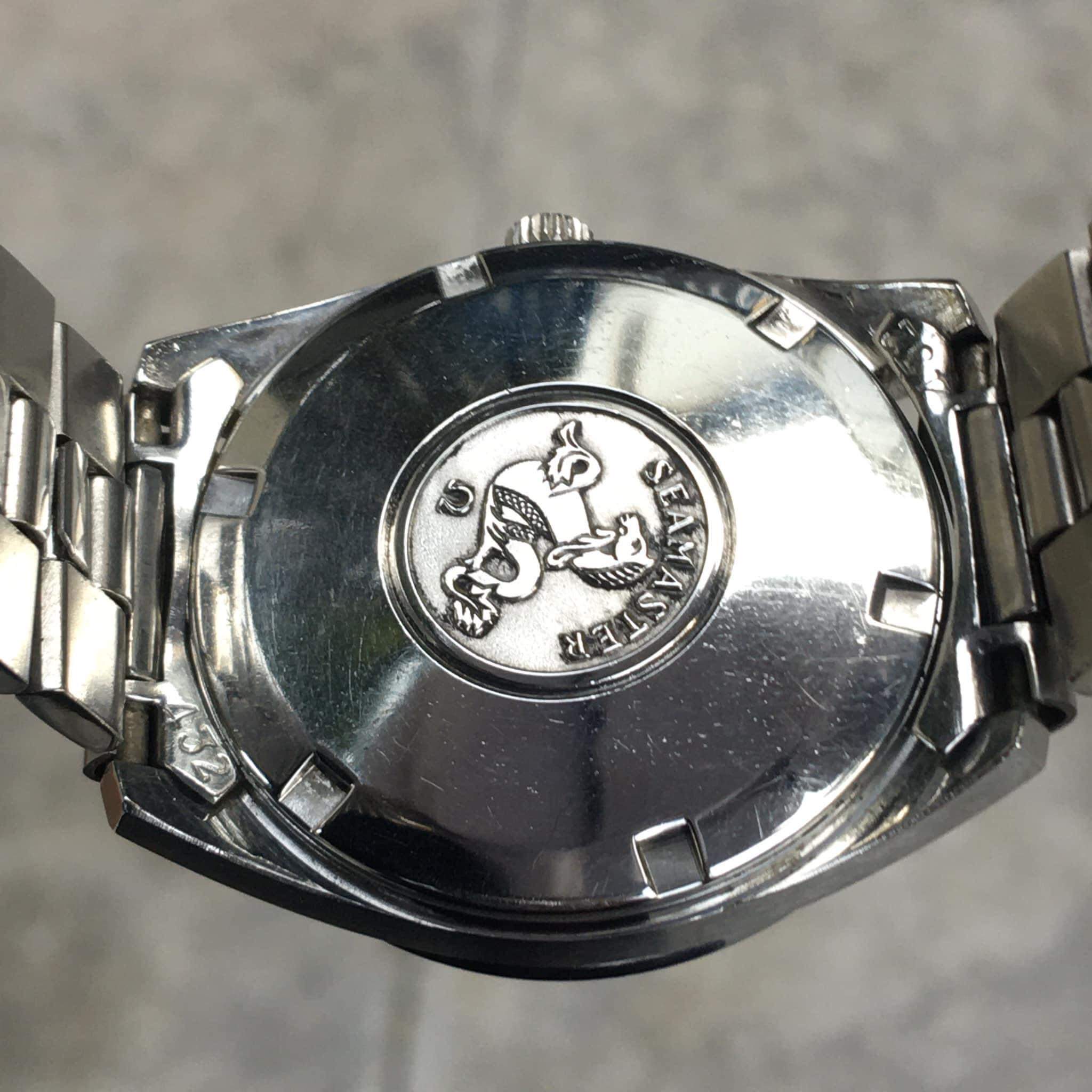

I don't doubt that's an original bracelet but it doesn't look like it fits the watch very well. I, personally, would not pay extra for it. Do you know the reference/case number of the watch?

I’m not sure... the shape makes me think seiko

Looks like a 168.022
The list found on this site says these fit:
1172/515
1067/532
1069/524
1098/540
1125/560
None of those look like the bracelet on the watch. 1125 seems to still be available.
13,555
23,503

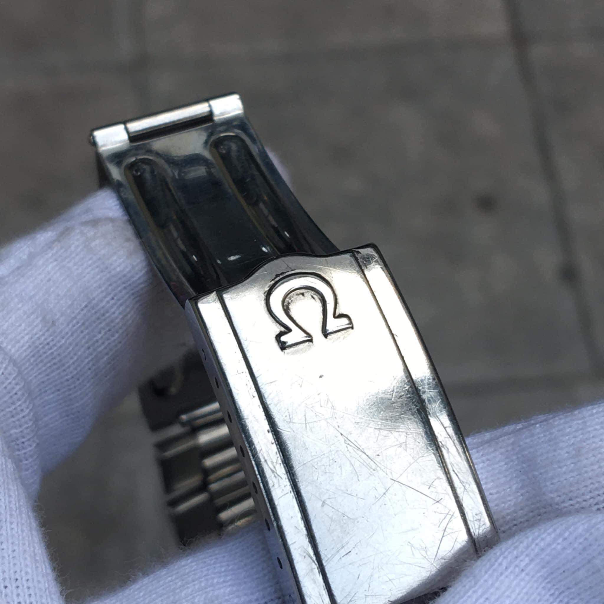

Have you got a picture of where the clasp joins to the bracelet?
Regardless, even if the bracelet isn’t a mish mash (those don’t look like Omega links), the end links don’t fit so I wouldn’t be factoring the bracelet into the price.
