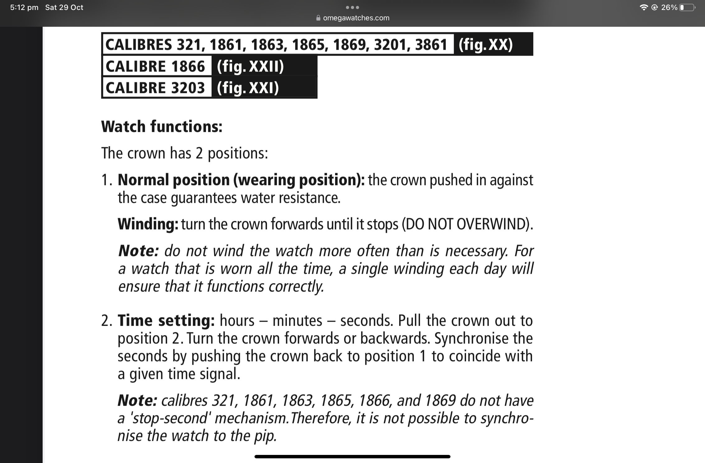

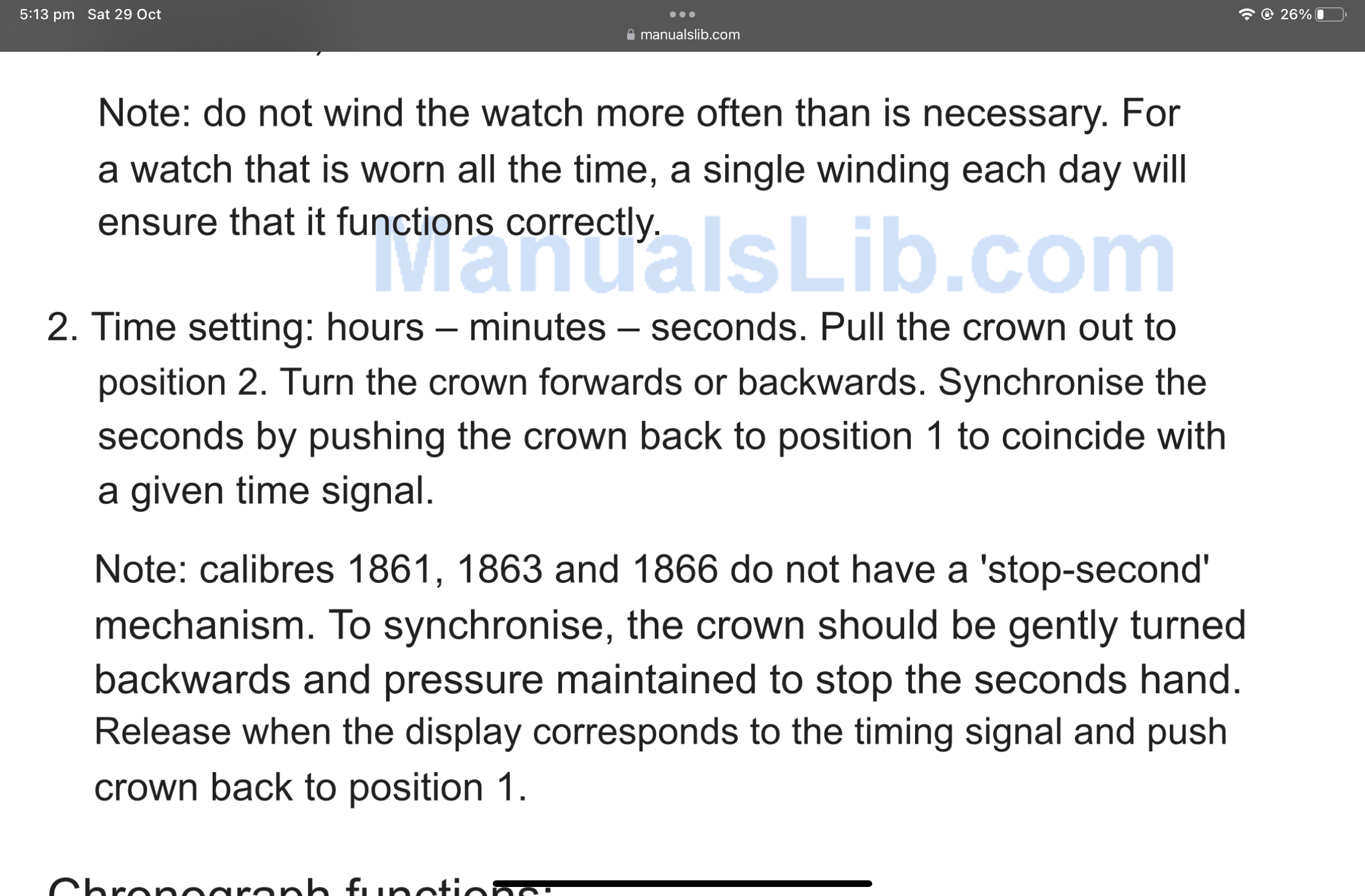

They do and they don’t 😉. It’s interesting that Omega changed their operating instructions for 1861s. A few years ago the manual stated you could pretty much back hack to synchronise the time by holding the crown against the power (see photo 1). Newer instructions just state that you can’t ‘synchronise to the pip’ (photo 2).

I do remember reading on OF (probably Archer) about the ‘back hack’ being bad for the movement as anytime it was going in a retrograde motion there was a possibility of damage, so maybe that was why it was amended.
2,012
3,409
Thanks, I thought I saw this. If I need to ‘back hack’ I’ll only do it when the mainspring has been wound down as it’s too strong otherwise.

Wowser…this is great information, @rob#1 and @YY77 …I had no idea things changed! Thank you, sirs [may I have another?]. I need to NOT be pissed off now! 👍

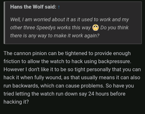

(Please correct me anyone if this is overly simplistic or my terminology is wrong). Many watches will “back hack”, it’s kind of how you synchronized multiple watches before hacking was an option. If you are setting your watch and roll the hands backwards (counter clockwise), you may notice that the second hand stops- you are pushing the train in the opposite direction than it was designed to run. Those of us who have 9/12 date set watches see this all the time.
So if you set you time and apply slight back pressure on the crown (like you are going to wind it backwards) the second hand wills sit still until you release it. So if you want to synchronize your watch with another time keeper- this is the low-tech way to do it,
As some have mentioned, it’s not good for some movements, some it doesn’t really matter- results may vary.
