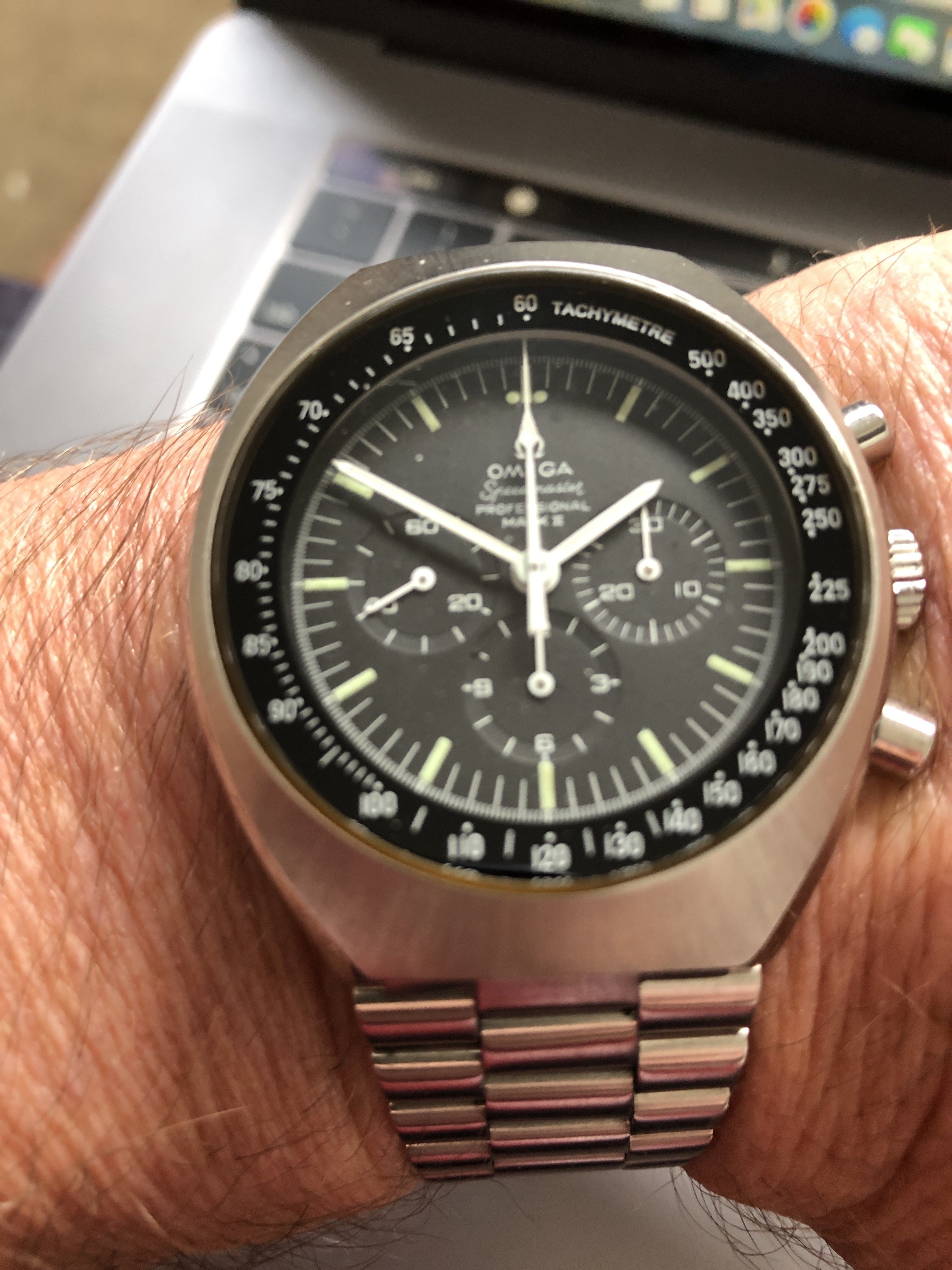

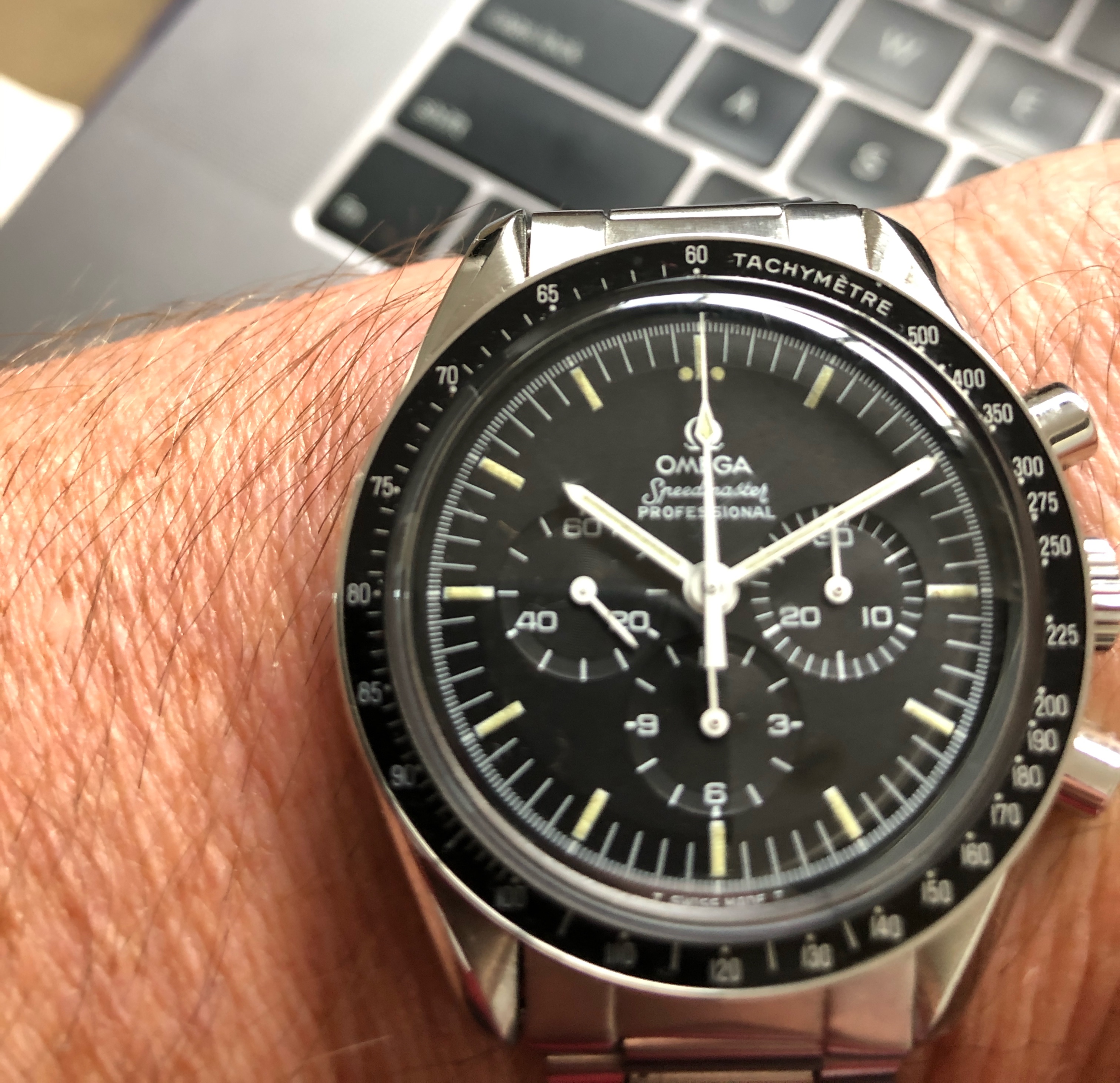

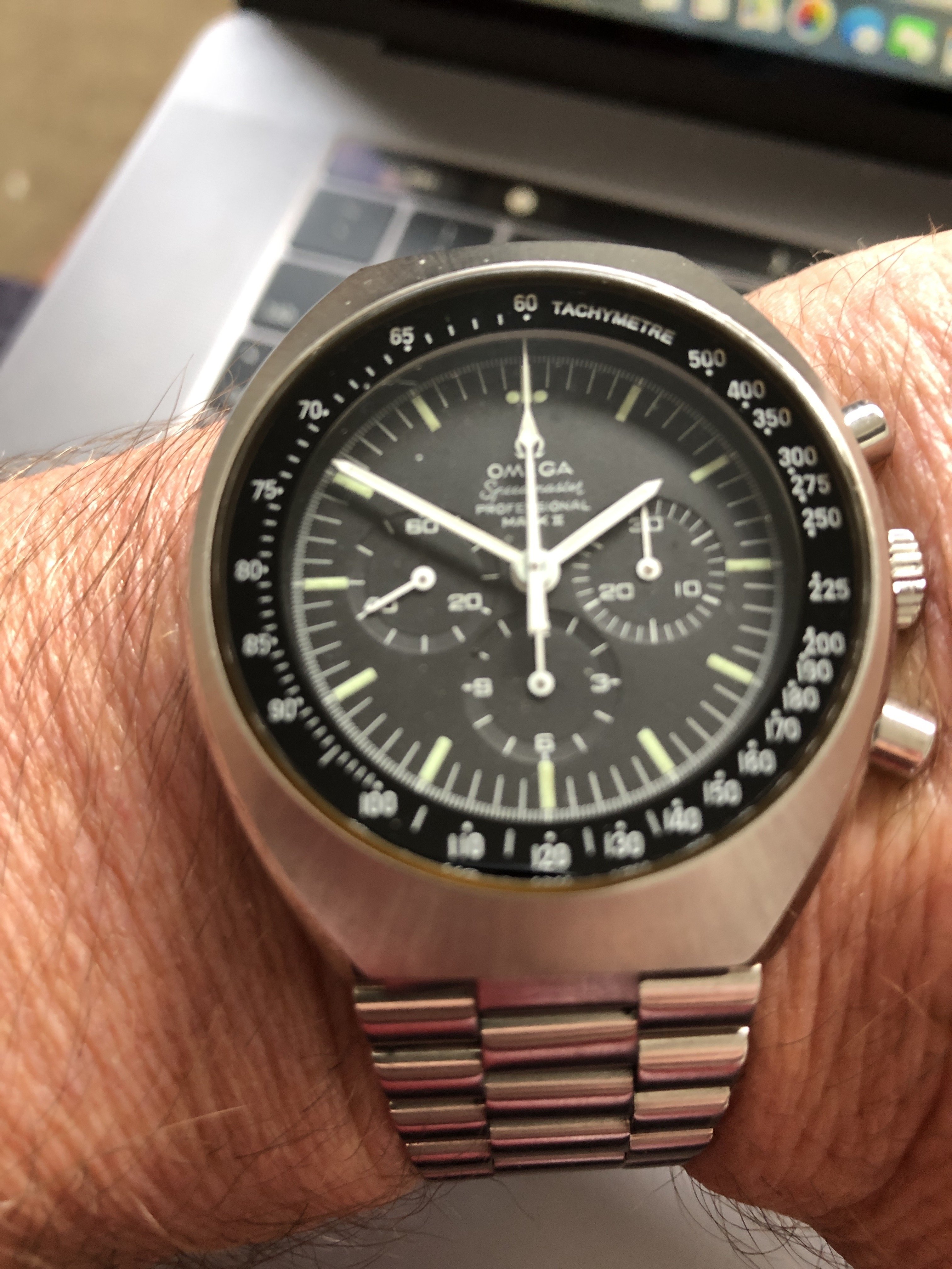

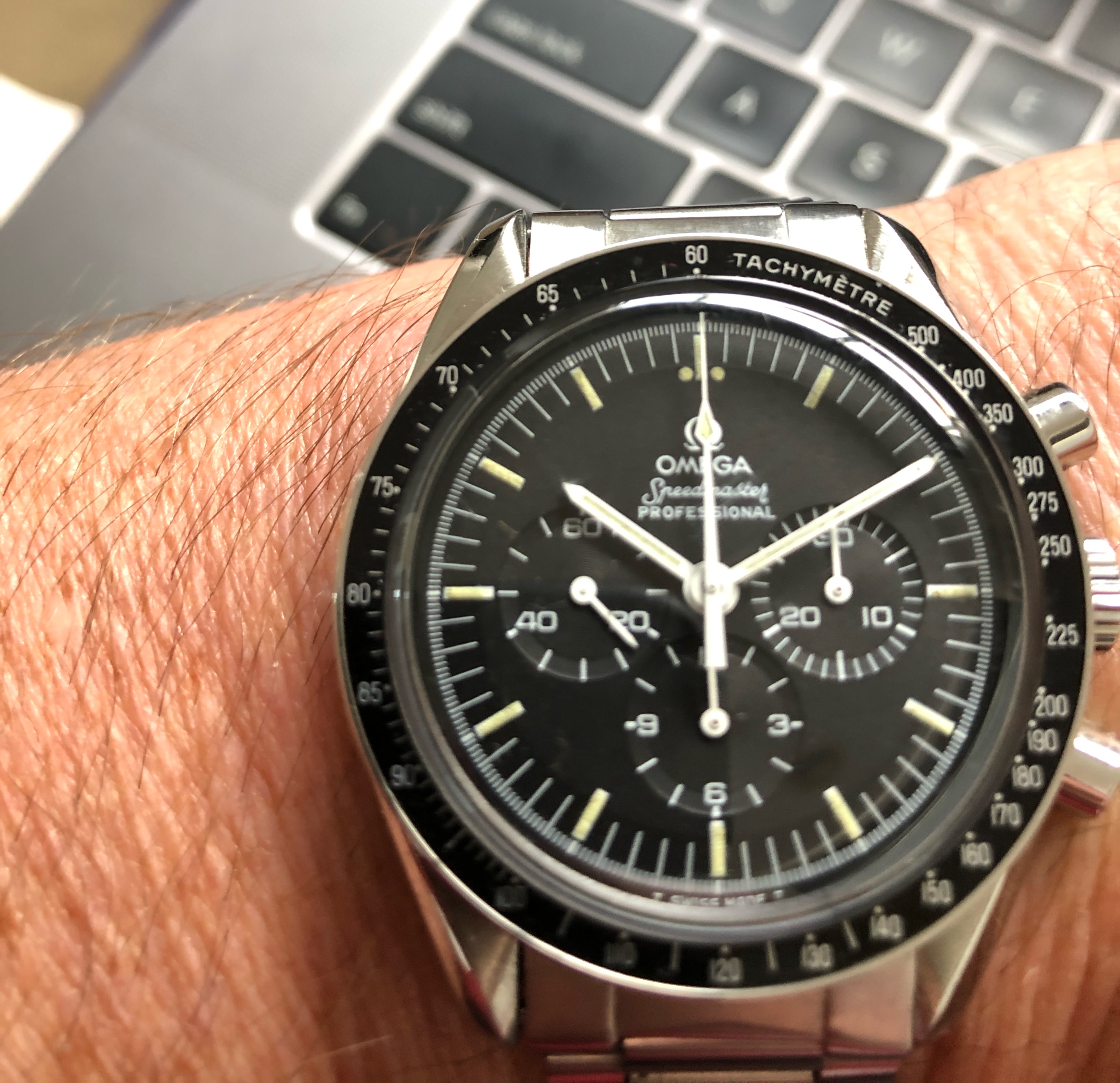

I can't comment on Sixties Speedies but I have two seventies Speedmasters that had hand issues and both are resolved to my satisfaction. My '76 Speedmaster hands were knackered after years of daily wear. My watchmaker had a tritium set on hand from a dial conversion and I am very happy with the result, although the hands are almost "too" perfect and lume is not an exact match. I have owned this watch a long time and it is worn regularly, would probably have had the hands repainted and relumed if the tritium hands were not available.
My Speedmaster MKii Telestop has service luminova hands. When I had Adam Lewis restore the watch he relumed the lumina hands to match the tritium lume on the dial. Again very happy with the result.

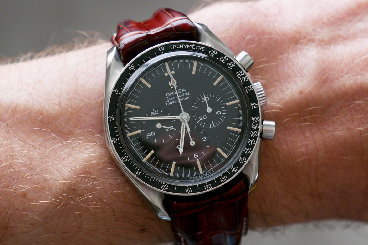

If the swapped hands were the correct hands, although not original to the watch, and matched the lume plots.... awesome. If the hands are incorrect for the particular reference... it's a no go, total turn off and I'd move on and look for another watch as finding a correct hand set will take time, if ever, and money, and color may not match. I'd more readily accept the wrong crown... they are out there, and even a correct caseback reference but wrong manufacture CB vs HF.
You can find some beautiful examples... they are out there. One just sold the other day on the Forum, a 145.012-67
Photo courtesy of bgrisso

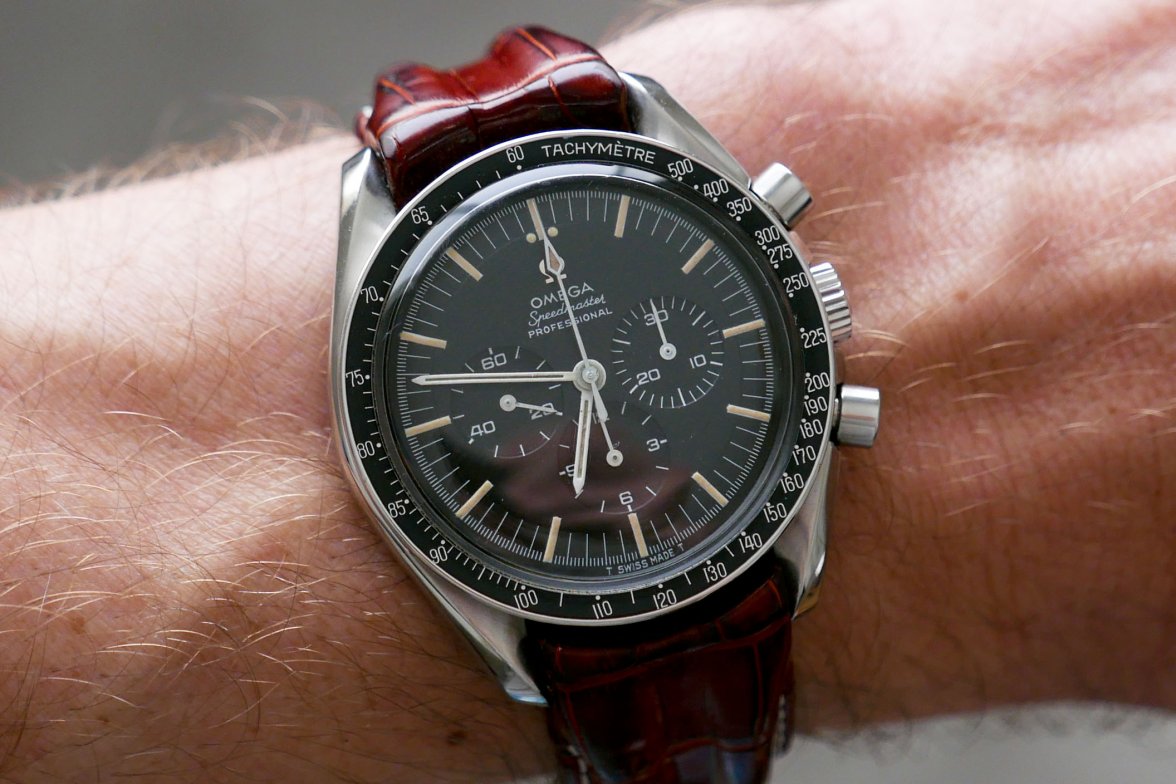

Thanks Sonicosa... now the song is stuck in my head too.
