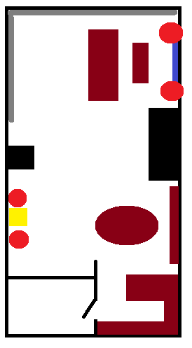

We have moved a bit around in the living room as well as gotten ourselves a TV (first TV I've ever owned...) and now we are looking at an audio set-up for music that will serve us.
We are not interested in high-end sound etc, but an amplifier that will
1) support bluetooth connection in order to stream music,
2) allow us to connect a record player,
3) a DAB+ receiver and
4) preferably also a built-in CD player.
I would also love to be able to set up two speaker sets in order to have decent stereo two places in the living room.
Dark Red: Furniture, kitchen, etc.
Yellow: Amplifier.
Red: Speakers.
Blue: TV.
I was thinking that I could have speakers on the left wall with wire connection and then active speakers on the far right wall connected via bluetooth and switch between those depending on where we are situated. Since we've gotten a decent HD TV, I would also like to be use the speakers on that wall for films etc.
...Is all this even possible? Will I have to make a dedicated set-up if I want to include the TV (which is the least priority)? Would it make more sense to have two sets of active speakers and ignore the amp?
I have tried to research the subject, but I have to say that it's a complete jungle and I end up more confused every time I set out to learn more 🤦

Skip the speakers at the TV and do a soundbar with active sub (usually sold as a kit)- that will take care of movies etc without setting up a whole system over there.
As for the hi-fI, You don’t have to go modern wireless over there as that will then be a dedicated system and you can use a proper set of passive speakers with cables, dedicated 2 channel receiver/integrated amplifier, and Bluetooth or wifi receiving module (there are some very good Bluetooth/wifi DAC’s out there for not crazy money)- a Sonos comes to mind the the wifi module which then you can use with wireless speakers around the house that will synch with your stereo.
As for turntable, if you get a receiver/int-amp that has a good phono stage, then your set for a turntable. If it doesn’t, outboard phono stages can be had reasonably. Depending on how much you want to spend and how compact you want the system will determine what components you want to get into.

We have a wonderful retailer in the US …. Crutchfield.com … You can go to their website, lots of articles and options and then go see a local retailer.
Since you no doubt have a smart TV, I second the sound bar/Sub suggestion for TV sound. It’s fuss free.
For Music I’d get an integrated amplifier with Blue Tooth, wired speakers, an entry level Pro-Ject Turntable and a separate CD player. Again, these are all well documented on the Crutchfield site and available in EU. You don’t need to go crazy financially.

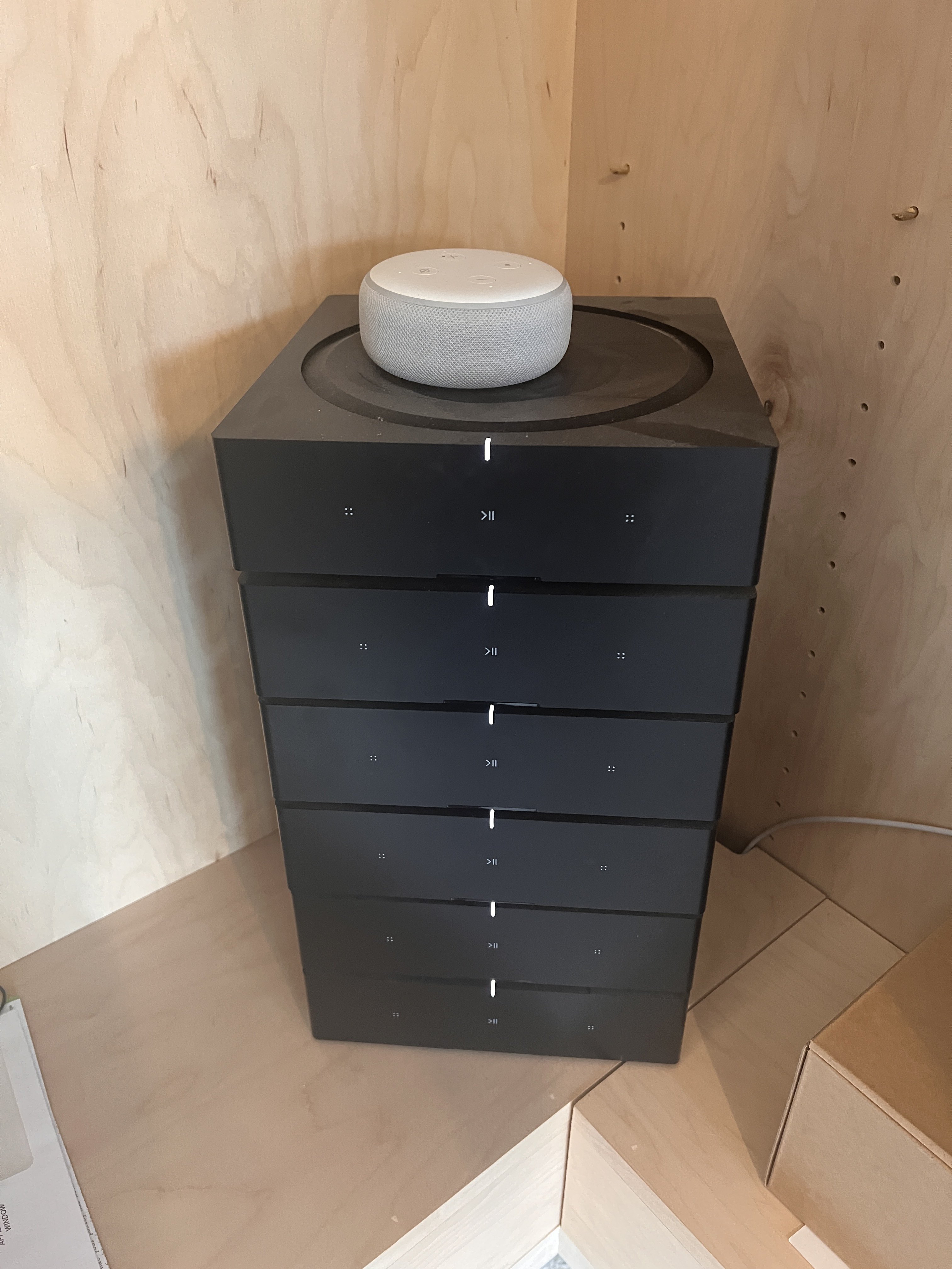

Sonos are such an easy and intuitive ecosystem.
Their newest amps (about 6” X 6” X 1.5”) are a breeze (I have a stack of 6 running my whole house), as well as their sound bar and sub on my TV. Their various extensions will allow you make any turn table or CD Player an over-air extension (ie the amp need not be near or in same room as turn table).
The few home audio company installers I know all agree: while there are some better sound quality products available, and while there are some other cheaper products available, nothing else can really compete in terms of ease of installation and ease of use.

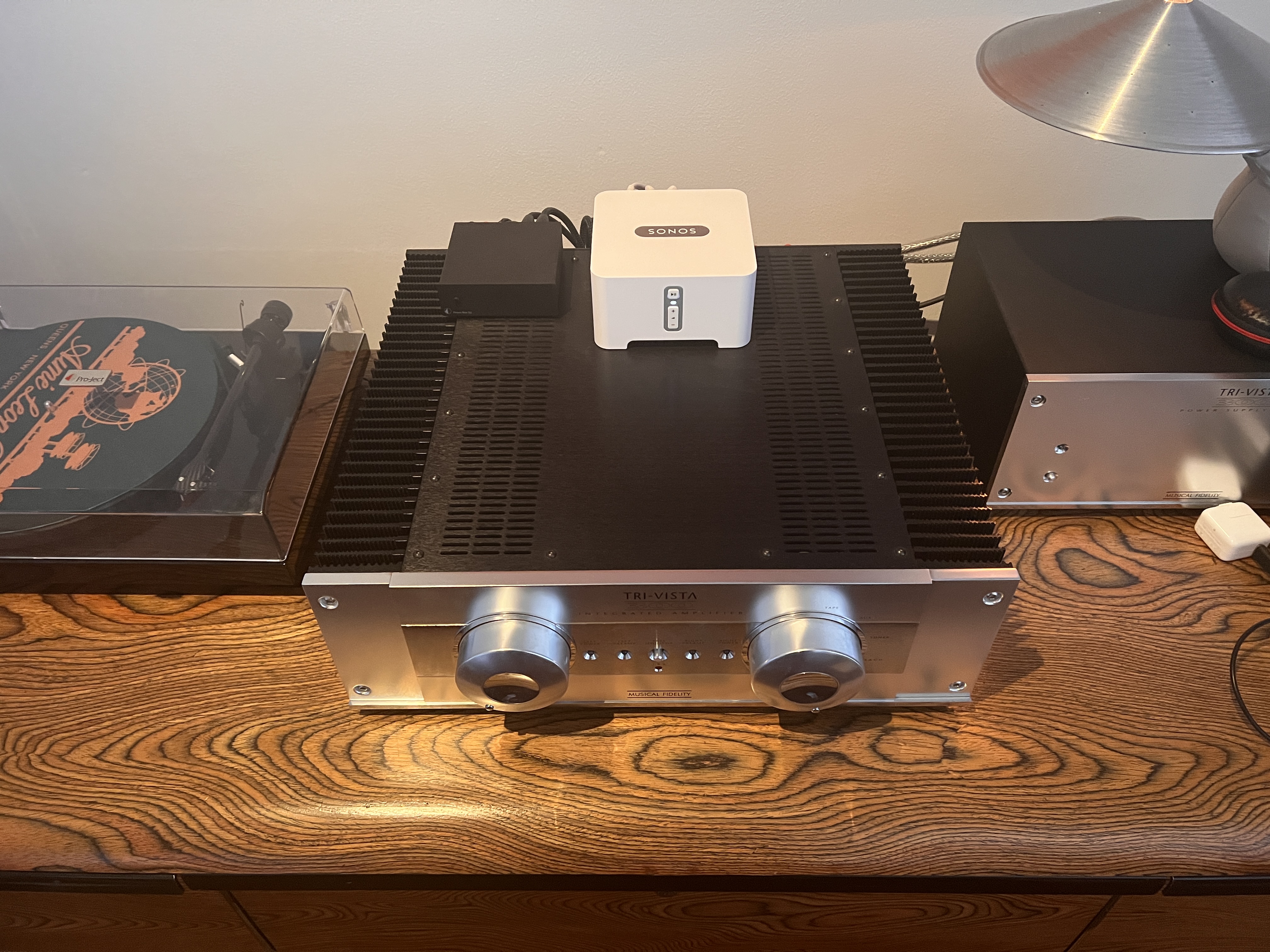

Worth considering. My deck of amps, and the wireless extension to my vinyl set.

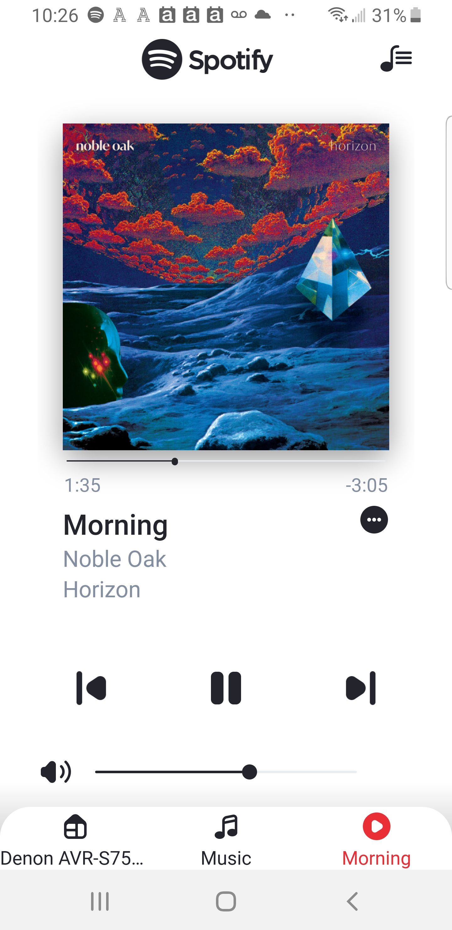

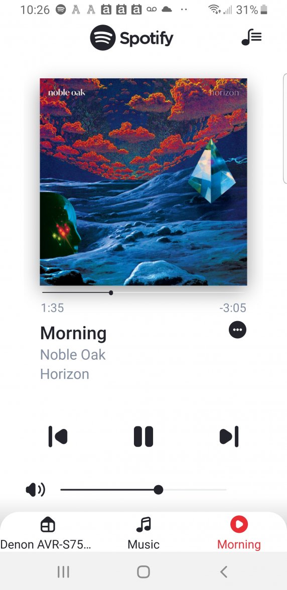

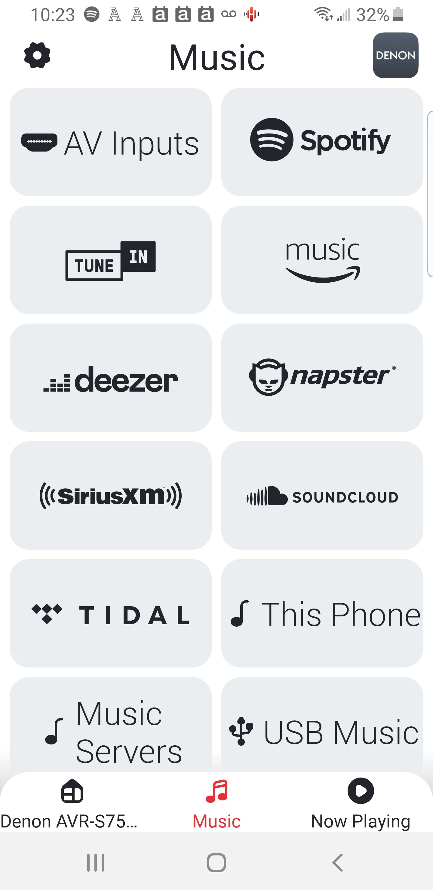

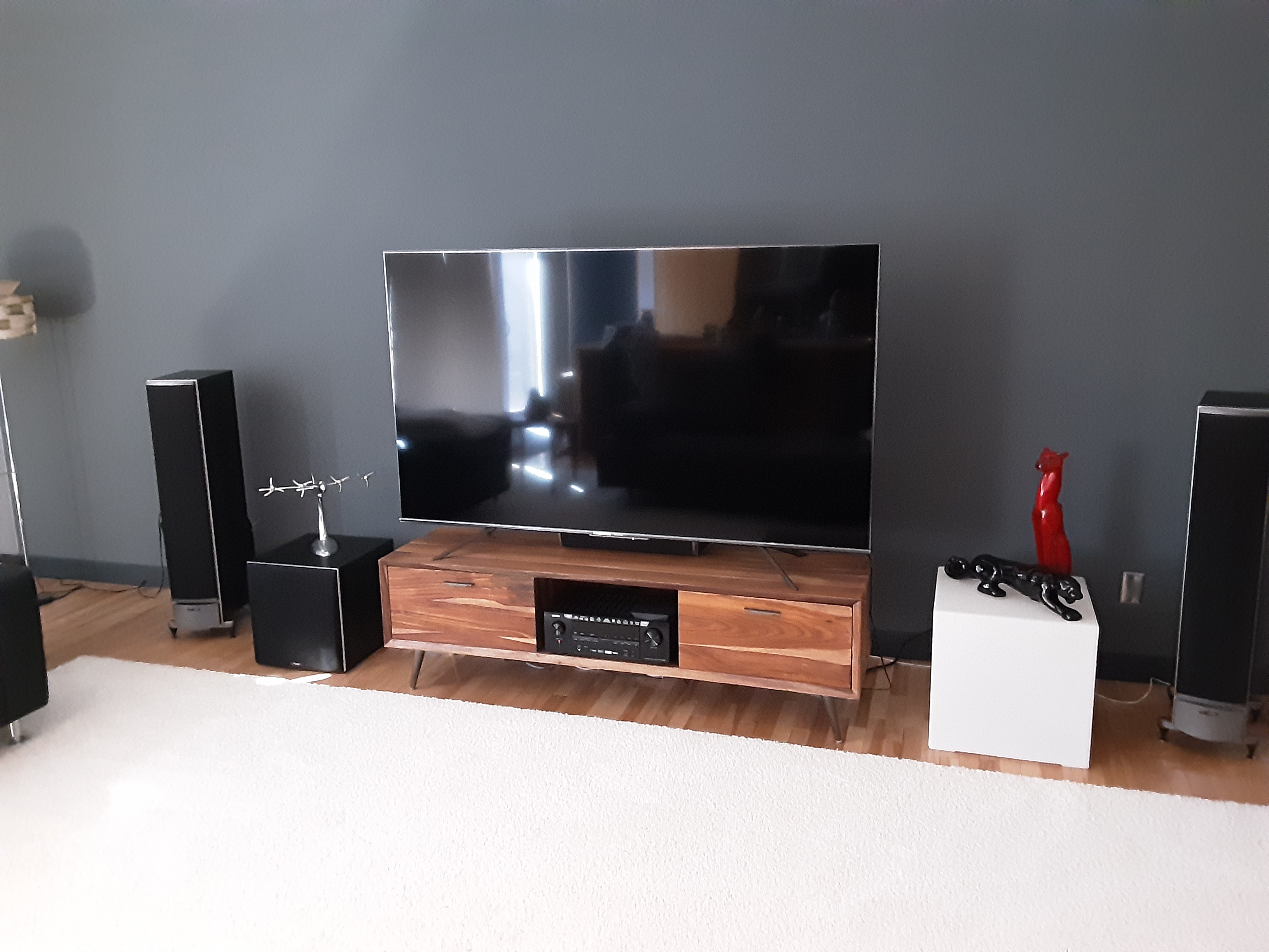

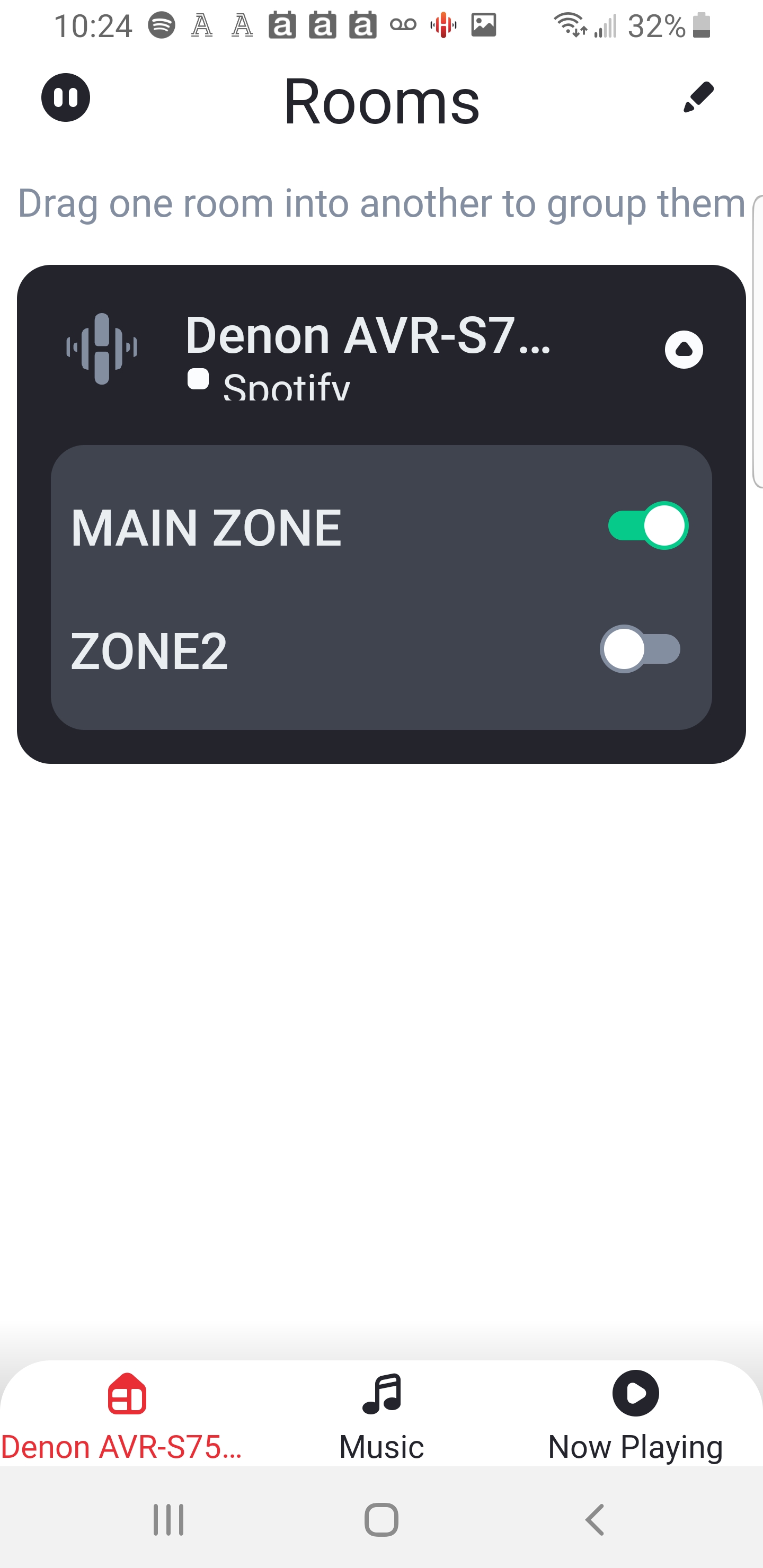

Not an audiophile by any stretch but here was my wired speaker solution for 2 zones. Denon 2 zone receiver with Bluetooth, wifi etc. Denon app controls both zones for music. They can be independent or have both zones playing the same thing. Then of course if you're just watching TV, you don't use the app at all and just use the TV remote as usual. My zone 2 for this receiver is 4 wired deck speakers outside. You can use the Spotify etc app directly to control the music if you prefer once you've opened up the Denon app.
