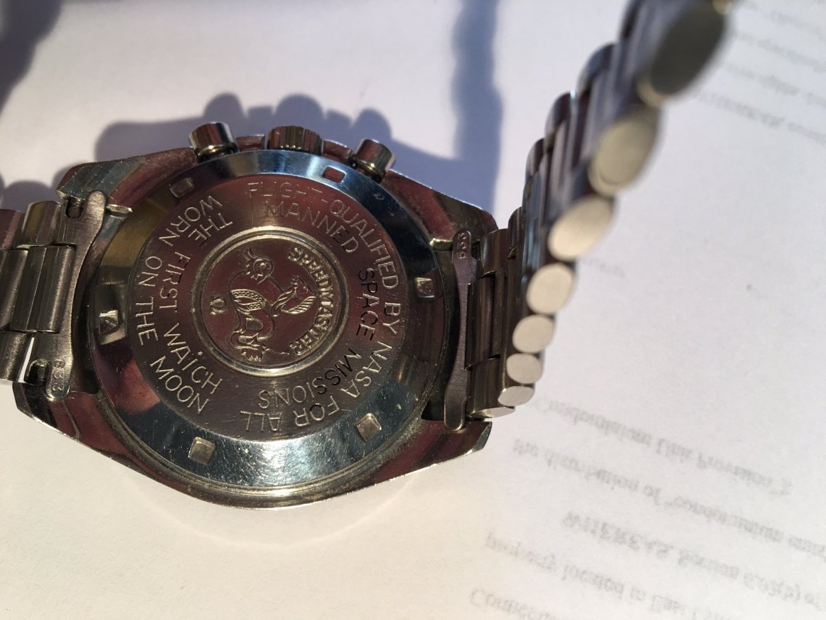

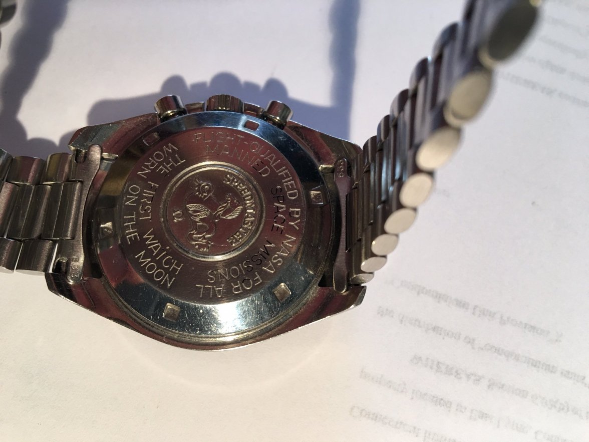

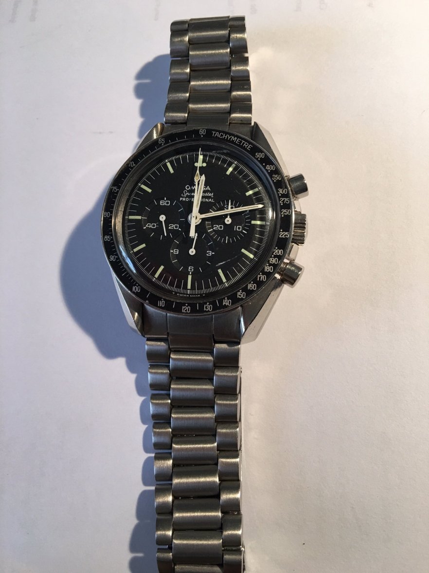

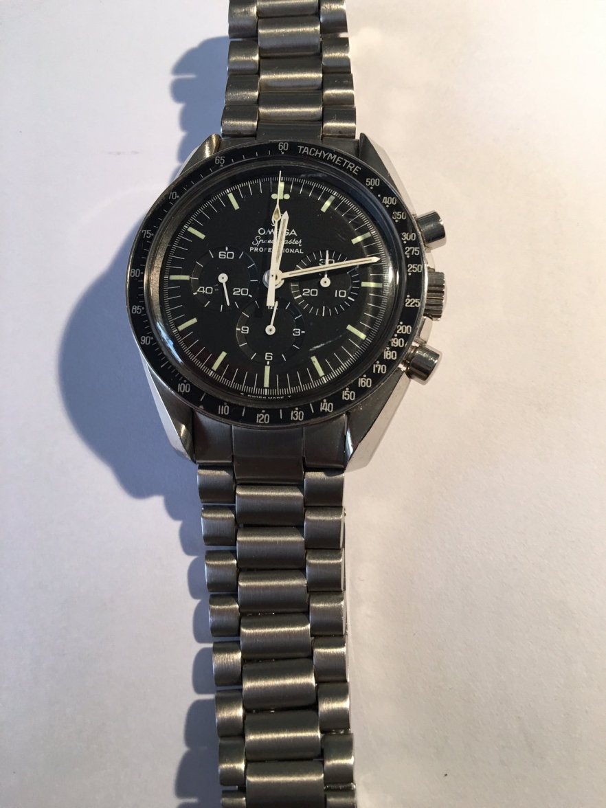

    Hey guys,
    I haven't had much to do with the Speedmasters but I have a bit of a weird opportunity to buy what I presume to be a 145.022-78 (no accesories) and was wondering if you guys could guide me. I know it comes with an 1171 bracelet which alone is $300-$500 (right?)
    I see it has a period correct DN90 bezel.
    He is an older man who is the original owner and says he has worn it only 1-2 dozen times and says it is in like new condition and he really sounds like an otherwise honest guy. I'm not sure what to do because the pictures he sent make the watch look a bit worn and the bezel doesn't look near mint (see 70 and 300)- but maybe that is just dirt... He also said he just had it serviced in the past couple of years because he believes that is what you are supposed to do.
    He started the watch at close to $4000 but I don't think he feels too strongly about keeping the watch at that price though he thinks he saw ebay sales that corroborate that... (Speedmaster101 says this is worth $3100 in good condition, head only)
    Is my assessment good? What do you think this is worth?
    Thank you in advance!

  2. Foo2rama Keeps his worms in a ball instead of a can. Jun 5, 2017
    17,045
    25,211
    Well that's not a -78 dial. 74 or 76. Needs service it has Chrono creep. Price seems good imho with the bracelet.

  4. BenBagbag Jun 5, 2017
    2,820
    8,983
    Upon closer inspection it looks like it may be a stepped dial - is that why you say it can't be 78?
  5. Foo2rama Keeps his worms in a ball instead of a can. Jun 5, 2017
    17,045
    25,211
    Dome with the early font from the step dial. Only -74 and some -76
    mr_yossarian, wwhntr and BenBagbag like this.

  8. Foo2rama Keeps his worms in a ball instead of a can. Jun 5, 2017
    17,045
    25,211
    No Chrono creep? Oh really? It can clearly be seen on the hour sub dial and then he calls it the wrong reference. I'd want to see movement shots and a caseback shot.
    I think the price is fine AFTER you get a serial number and case back shot. I'm betting it's a -76 as that stamping can look like an 78.
    Bracelet, nice dial and bezel seems like an ok pre service price.

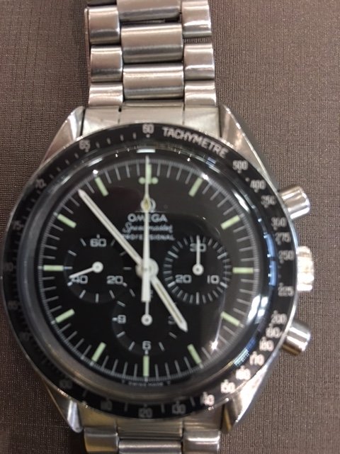

  15. BenBagbag Jun 13, 2017
    2,820
    8,983
    So... Apparently the watch was serviced 15 months ago by a reputable jeweler. The manager just hit the pusher and he says the hour chrono reset back into place. Does this mean that there is no chrono creep? Would you still recommend I get it serviced?

  18. Archer Omega Qualified Watchmaker Jun 13, 2017
    26,341
    65,043
    Of course it will reset - the issue is not resetting. The problem is that the counter moves away from zero even though the chronograph is not running. If he waits a while, he will see the counter move off zero again...
    Still needs to be addressed, and if it was serviced 15 months ago I would question the quality of the work since it's creeping now.
    Cheers, Al
  19. dennisthemenace Hey, he asked for it! Jun 13, 2017
    2,828
    4,460
    Chrono creep is not uniform between different watches. some can register an hour after six hours, others might take up to forty-eight hours to show one hour on the register. If the hour register hand is set properly it should always reset to zero so you can't just reset the watch and be sure there is no creep.
