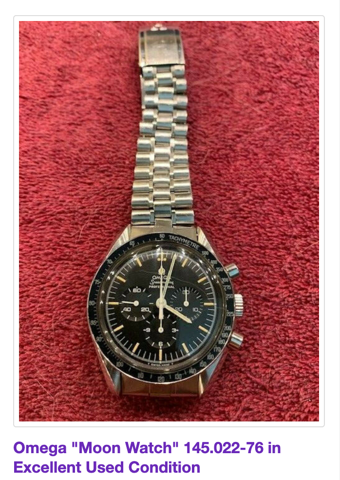

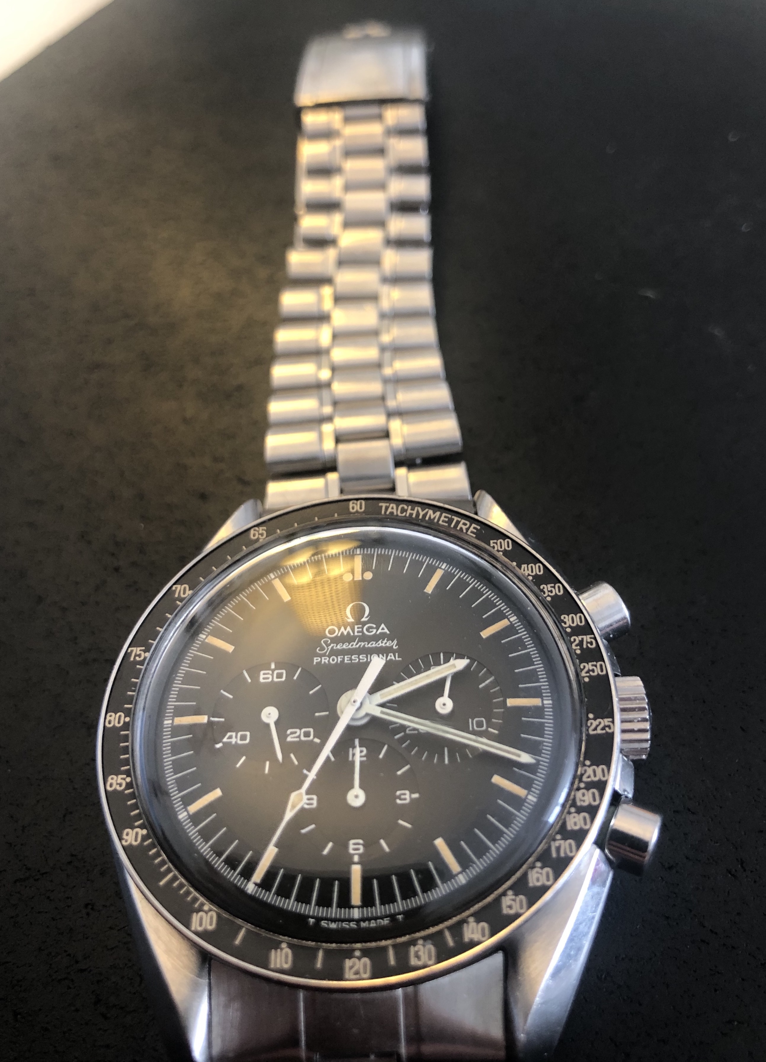

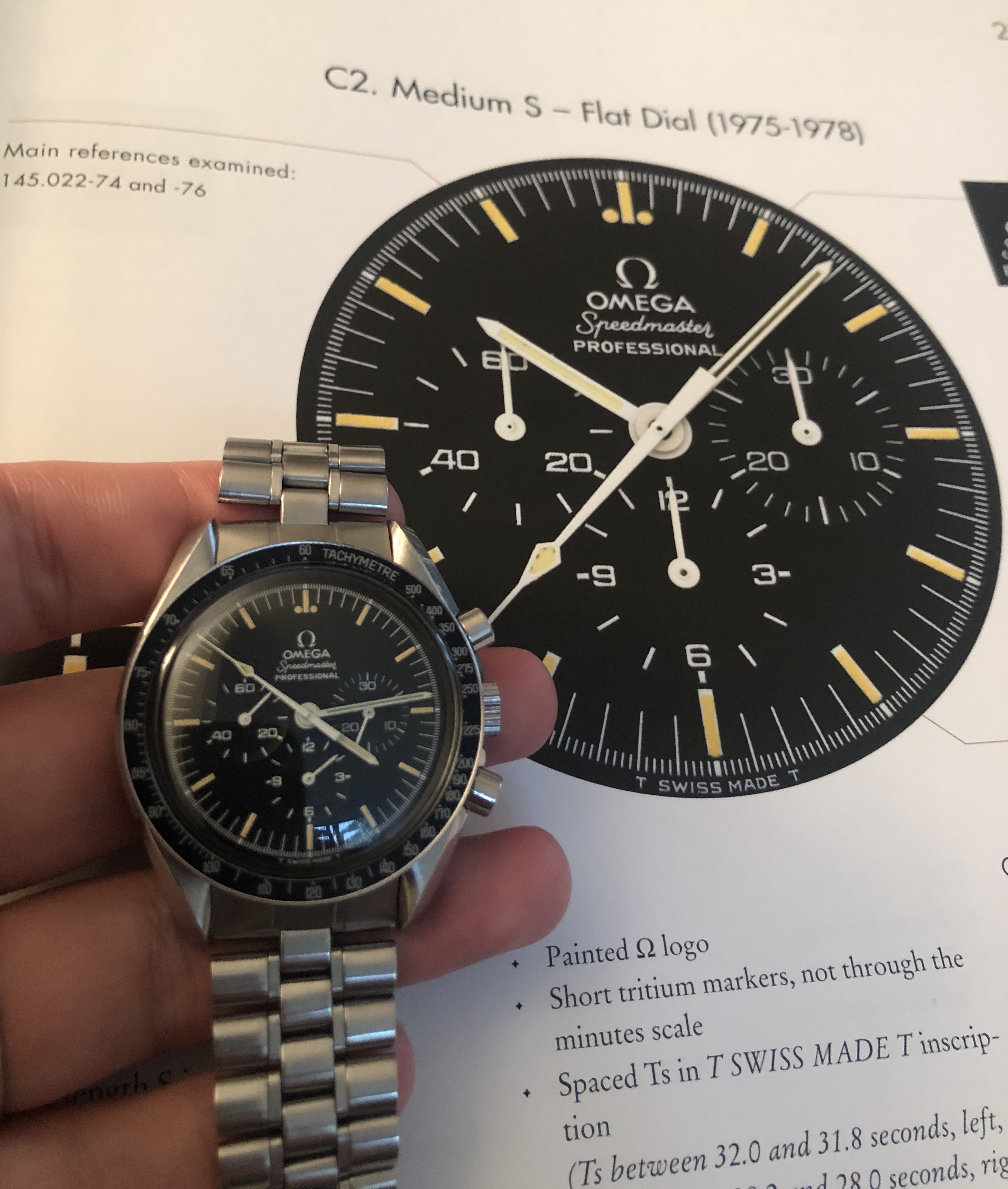

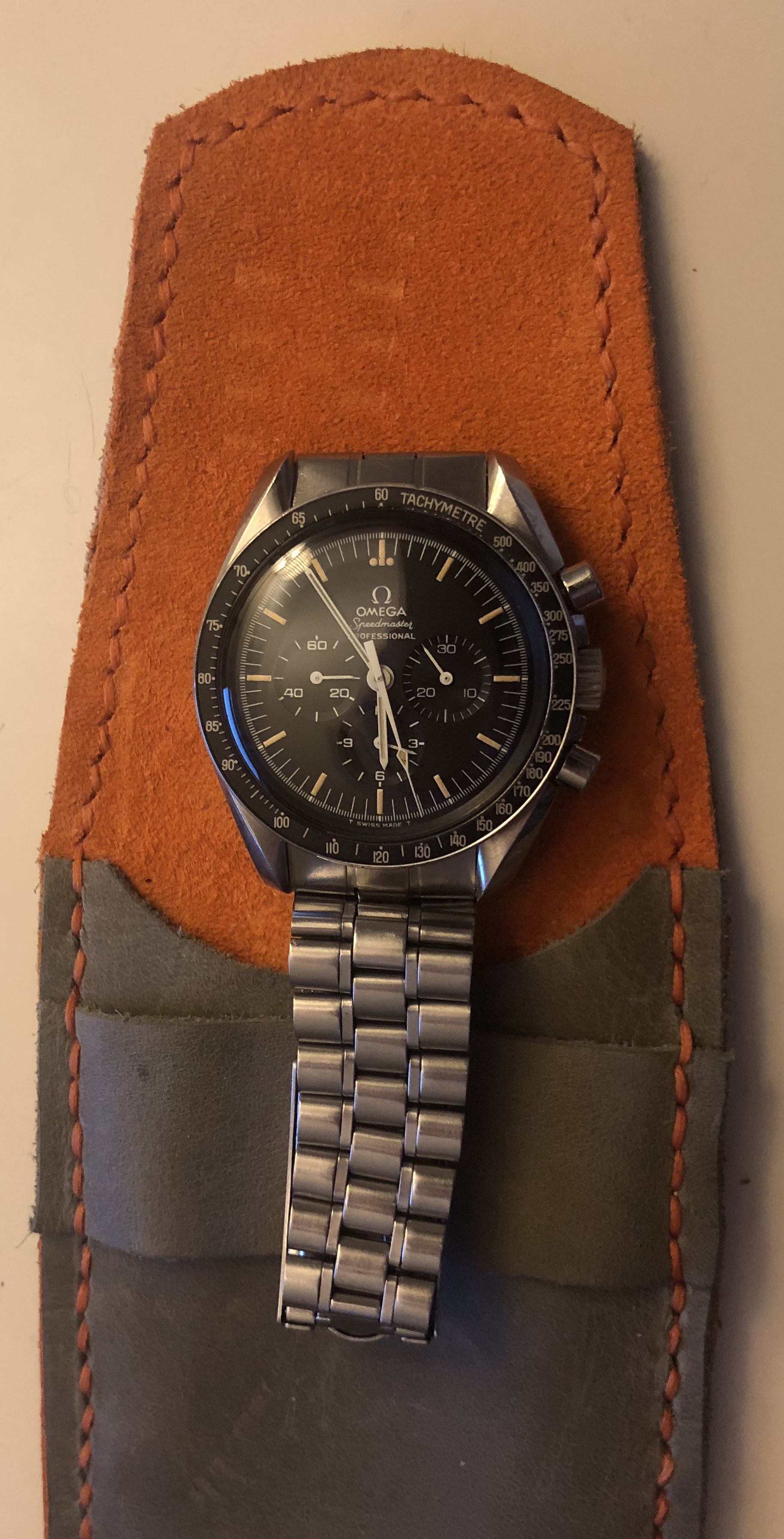

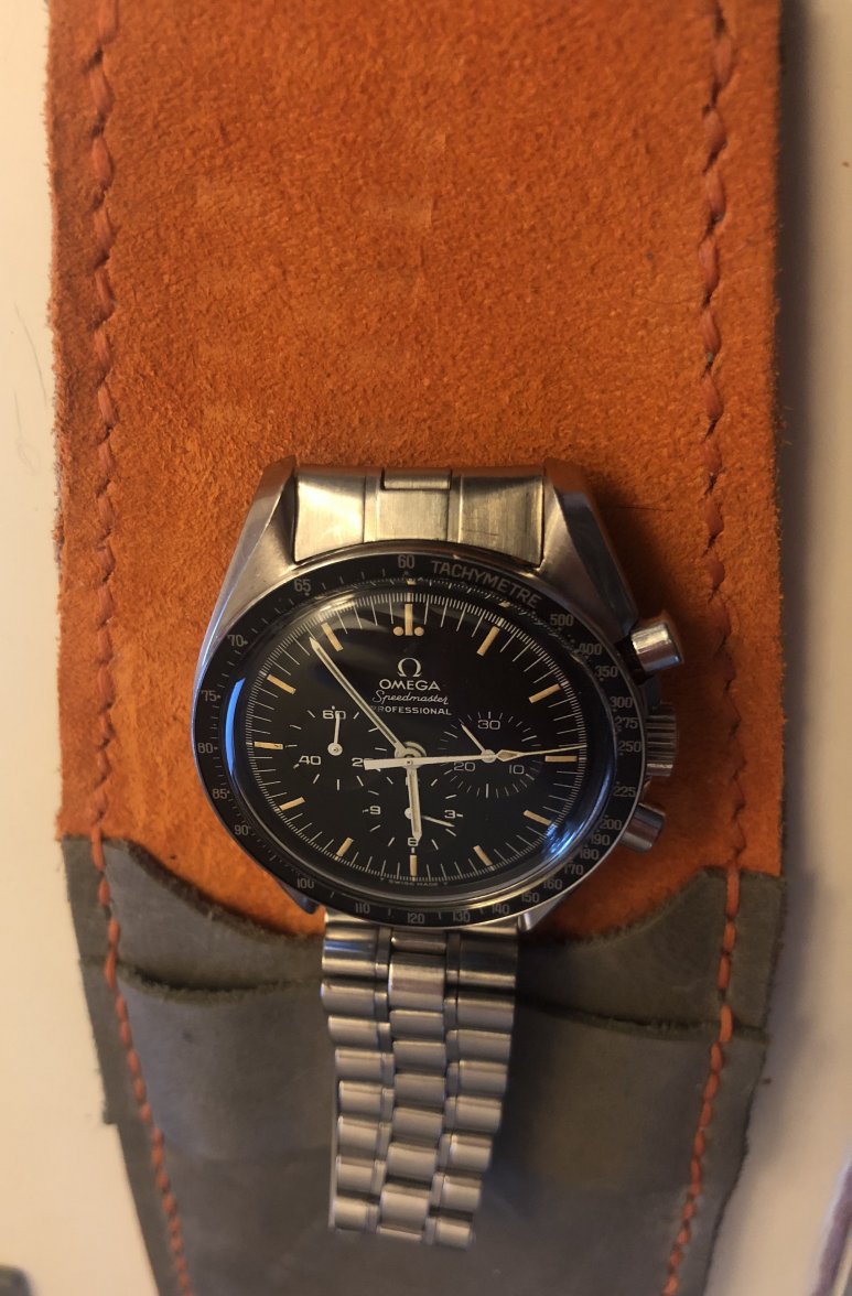

Hi everyone I recently took a bet on this eBay listing:
This is my first speedy pro after many MK IIs and I would love everyone's thoughts.
I believe it has the correct C2 dial, movement is 39,185,XXX, inside case back marked -76 HF, and an earlier Type 7 bracelet.
Any feedback appreciated since this is my first pro.

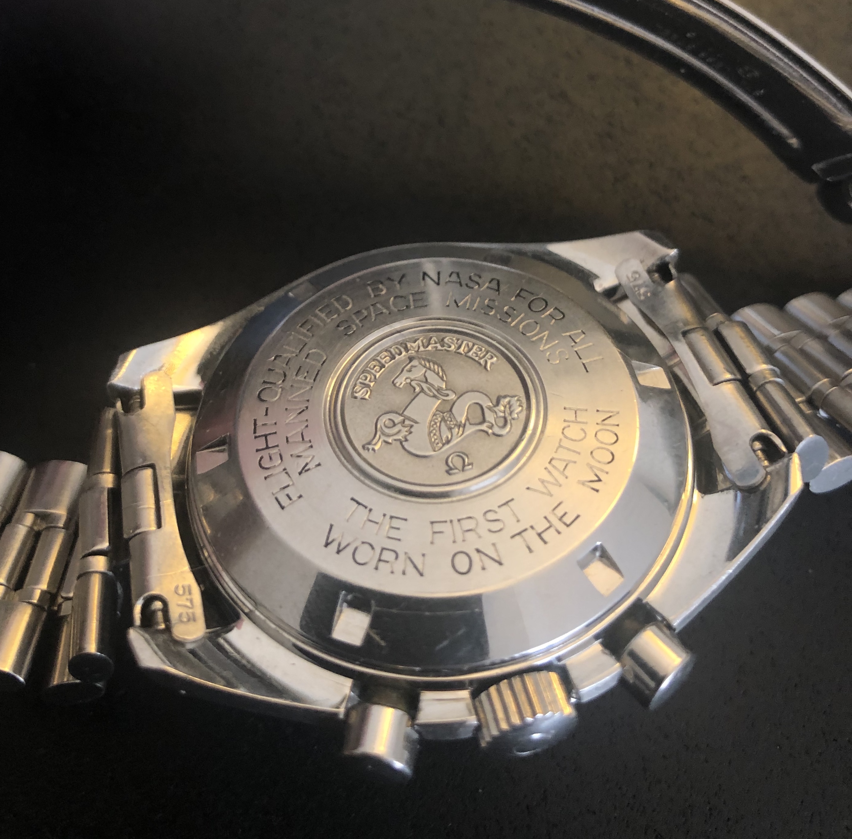

I’ll let the experts weigh in, but you identify this watch as a 1976 145.022 and the inside cover says it’s a 1978 145.022. I believe that a 1976 should have an 1171 bracelet with 633 end links and the Omega symbol set inside a trapezoid on the clasp.
1,585
6,830
Followed this auction too, it is a 145.022-78. Likely with an earlier bracelet as the 1116 was phased out by that time.
@bunthit, congratulations, this was a very, very good buy regardless!
2,827
4,722
Sometimes it is difficult to tell on these casebacks, at a glance the 76 looks like 78, but this one is definitely 76.
217
109
Looks like that to me too.
10,123
57,923
You’re both right. I looked at the case back more closely and it is a 76. I believe that I’m correct that the bracelet and clasp are incorrect for this reference. Should be an 1171/633 and the trapezoid with the Omega logo on the clasp.
1,585
6,830

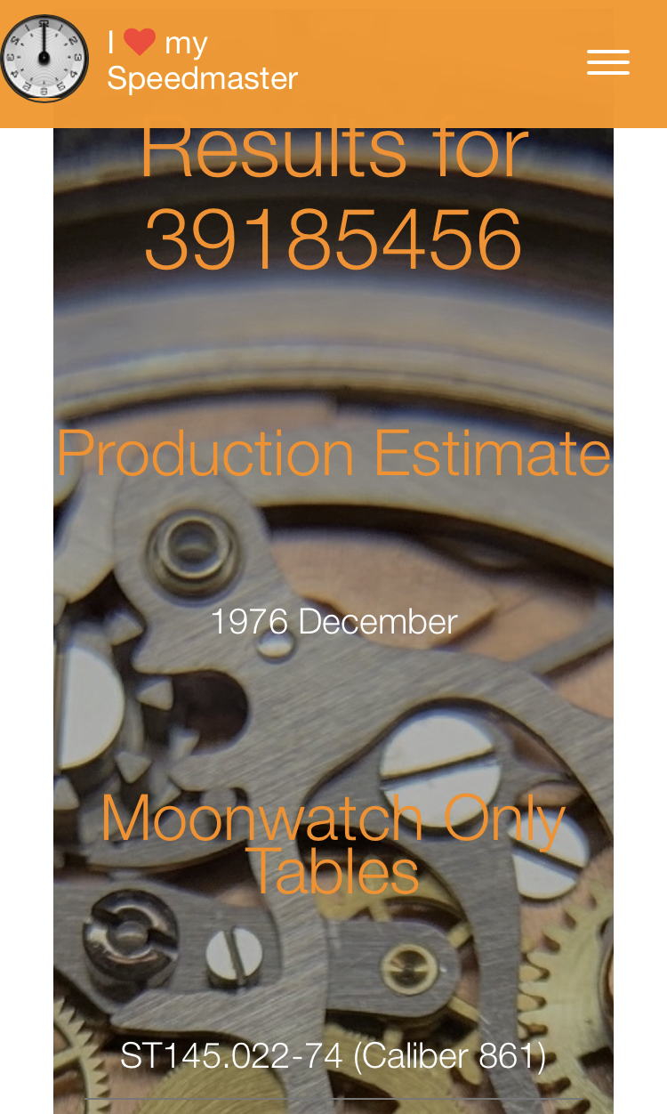

Yes, indeed. On closer inspection I agree on 145.022-76. Based on the serial and ilovespeedmaster, it would likely be an early one.
2,827
4,722
Unless someone swapped the dial for an earlier one , it was quite obvious that it couldn't be a 78.
As shown by the serial, its an early 76.
77
177

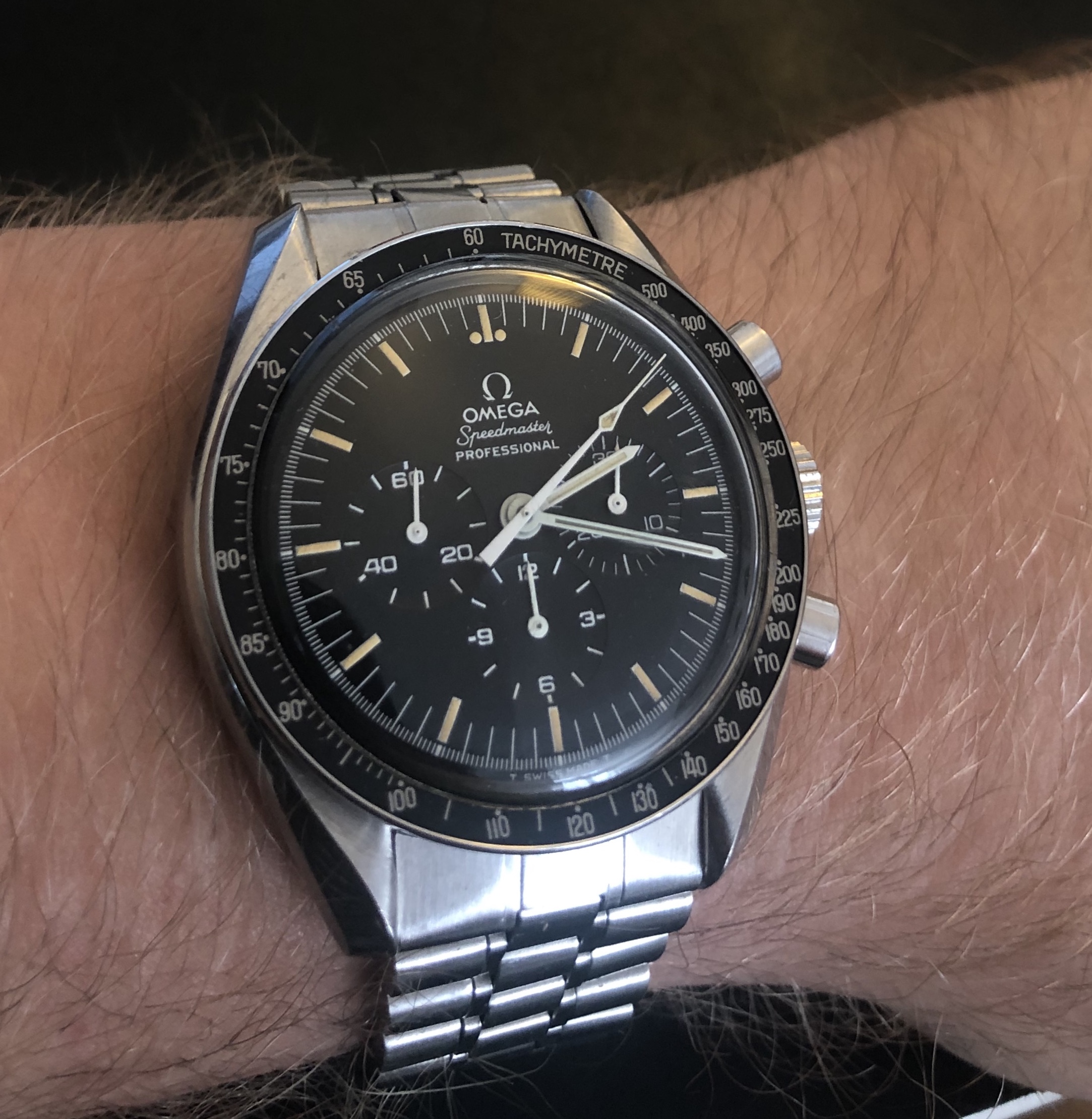

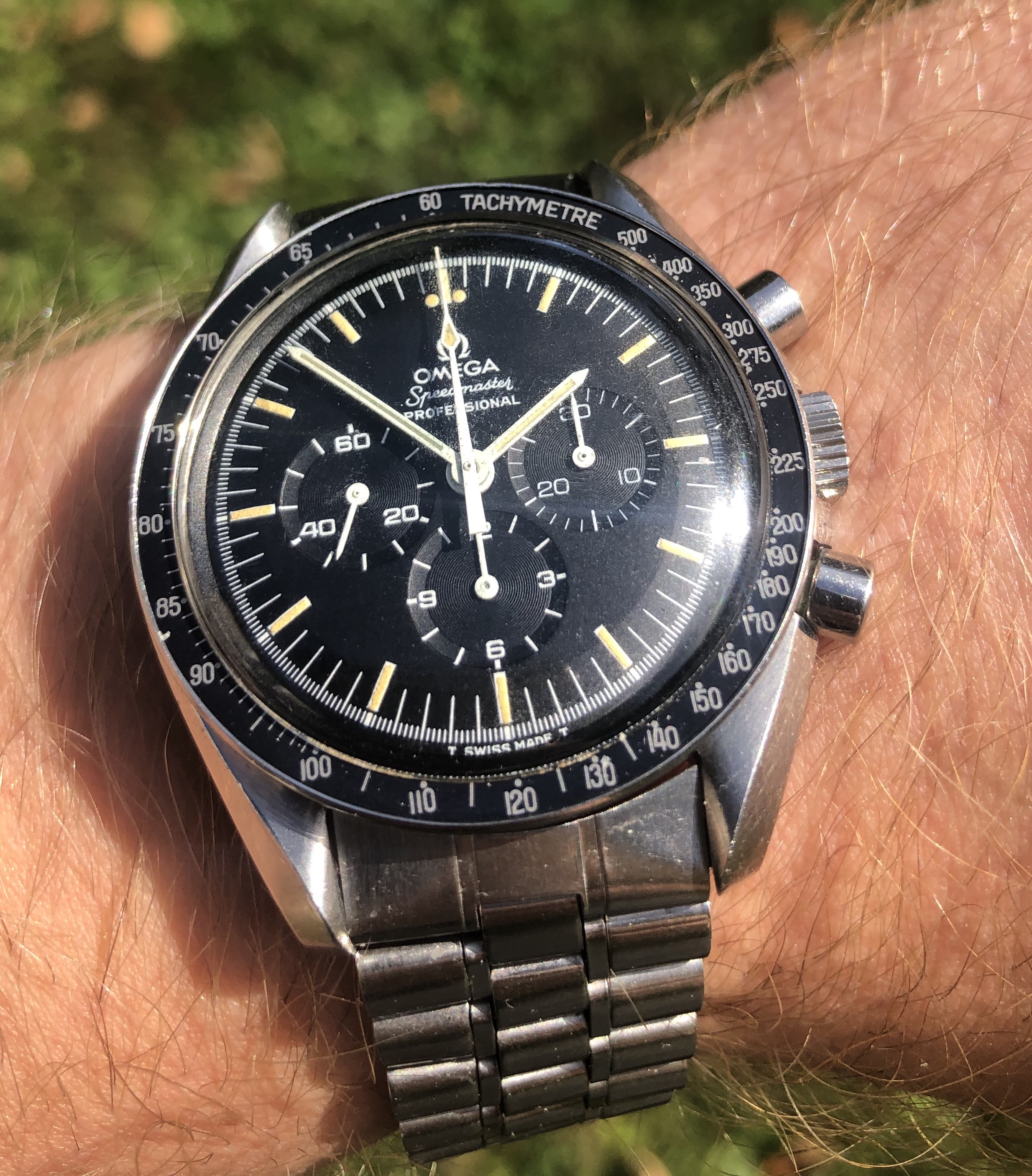

18,326
27,695

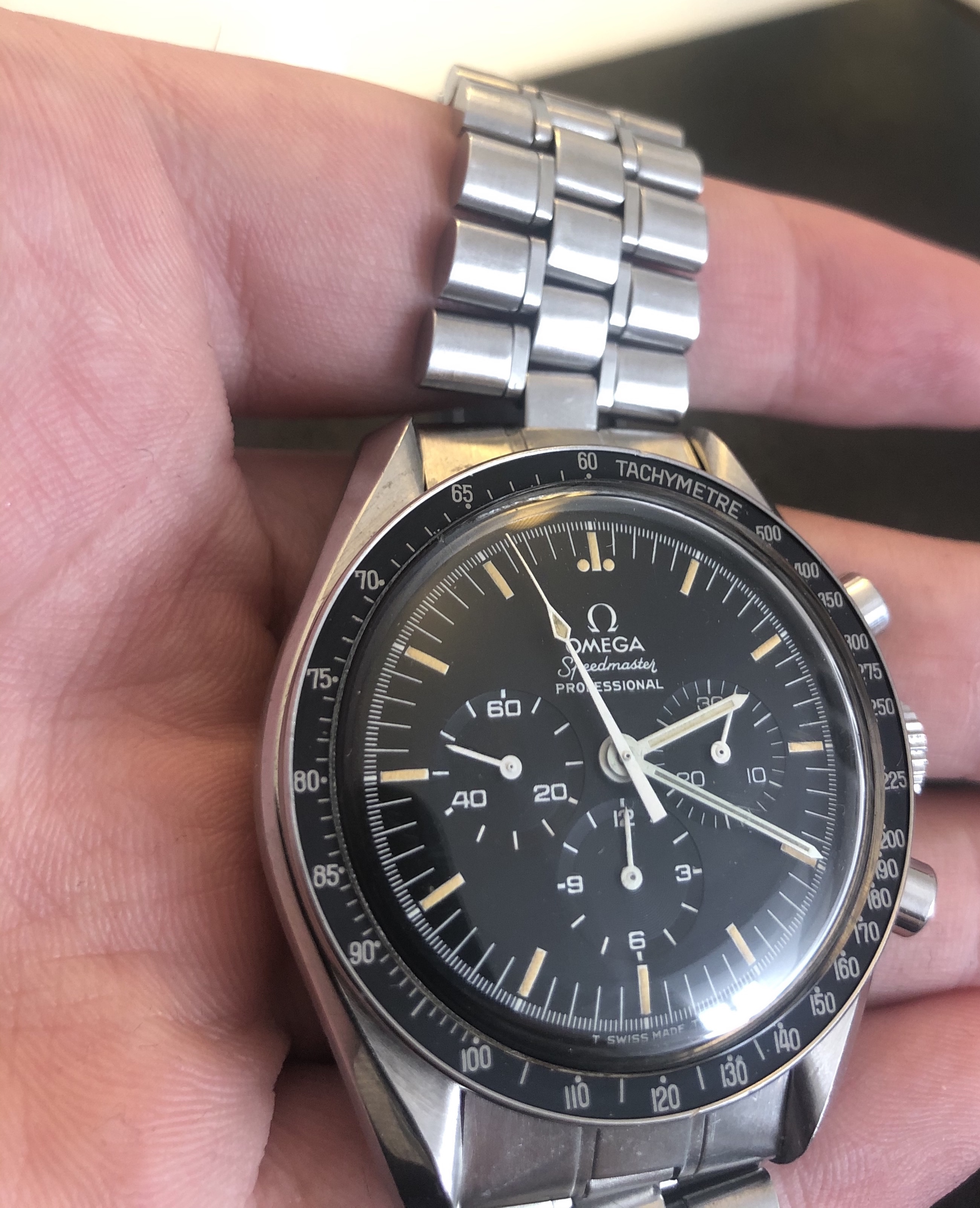

It’s a correct -76
Early dial as expected for the serial, correct bezel.
Matching lume on hands and dial. Looks pretty good love to see it natural light.
normally the lume goes slightly green but your slight amber is not unexpected.
bracelet is period correct and could be original. These could have gotten a few different bracelets. They left the factory head only.
