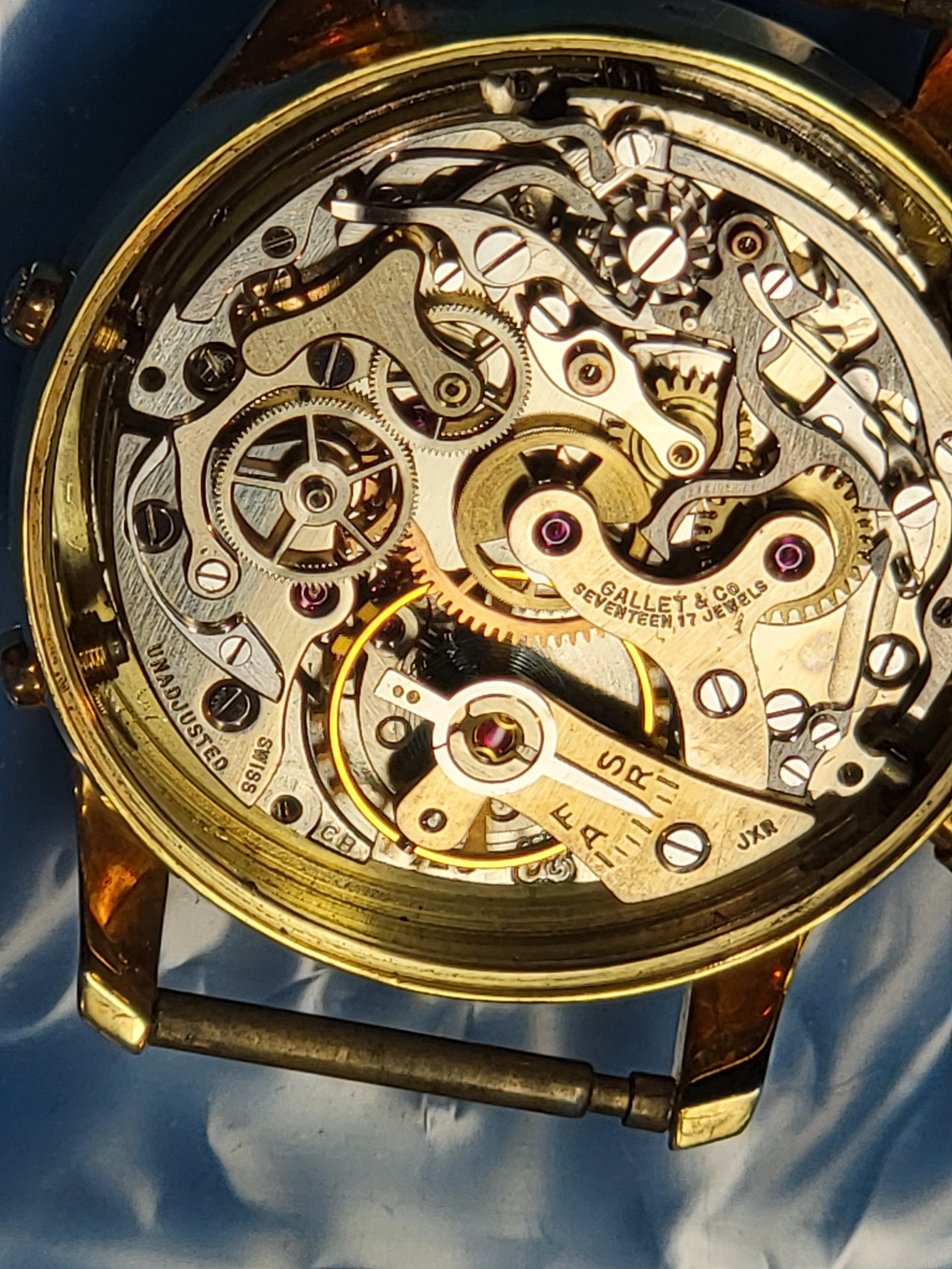

In the interest of fairness, I need to follow up the condition of my watch that was recently returned from Multichron. I had stated that it was not running.
Just got back from a quick trip to my local watchmaker. The movement appears clean. (The attached photo makes it appear darker than it did in reality.)
What's more, after lifting it from the case to inspect the work, the watch is now running (for the last 40 minutes anyway). Pure speculation but it may have been jammed up in shipment. The balance wheel was happily rocking away. They may have done what they said.
In any case, there's probably enough in this thread to caution anyone who is seeking feedback on the service center.
EDIT: Mr. Salz just wrote me to give me a heads up that I will notice that the watch quits running. Seeing how my watchmaker left the caseback loose, this explanation makes sense. Cudos to Larry for following up.
"You will also notice an issue where the movement functions well with good timing until the case back with hold down spring is tightened down. Then the watch only runs for a couple of minutes. This is a minor issue requiring adjustment of dial feet that hold the dial to the movement. Since this adjustment requires removing the 2 small date corrector assemblies again to access the dial feet, we decided to wait until the watch was ready for full completion with freshly gold plated pusher cap so as to not put any additional stress on the these correctors until we were ready to complete the job."

The movement looks clean and unmolested.
One thing I look for when opening a watch is the condition of the screw heads. The slots look perfect. They look almost new as . . . if they'd never been unscrewed or else the watch was serviced by a very careful watchmaker..
Earlier on in this thread I mentioned that you really need to put the watch on a timegrapher if you want to see whether the amplitude is as high as it ought to be for a recently serviced watch, whether the beat error is low and whether the plot on the timegrapher is straight and clean.
Even when the watch keeps time reasonably well, it does not indicate whether the watch has been properly serviced or not.
How did the watch run before you sent it in for service?
