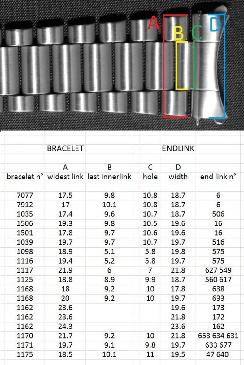

@uwsearch, any info on 1067 for Seamaster-s please?
I don't have any 1067, my Seamaster 120 are on 1098/547 and 1069/524.
1067 is a kind of smaller 1035 with spring flat links.
They were delivered on the early Seamaster 120 165.027 166.027 135.027 136.027 with 532 endlinks

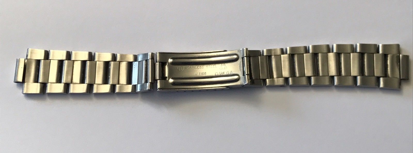

Check out this 1168 bracelet being sold as an Apollo-Soyuz bracelet. It has 18mm last links instead of the 20mm last links used for the Speedmaster. Don't get me wrong, you can still use it with 633 ends, but it is not worth $810 with the wrong size last links.( I know it has 18mm last links because I emailed the seller and asked. It is not mentioned in the listing.) This thread should be permanently pinned at the top of this section.
http://www.ebay.com/itm/Rare-Vintage-1975-OMEGA-Speedmaster-APOLLO-SOYUZ-861-Watch-Steel-Bracelet-1168/332392956643?ssPageName=STRK:MEBIDX:IT&_trksid=p2055119.m1438.l2649

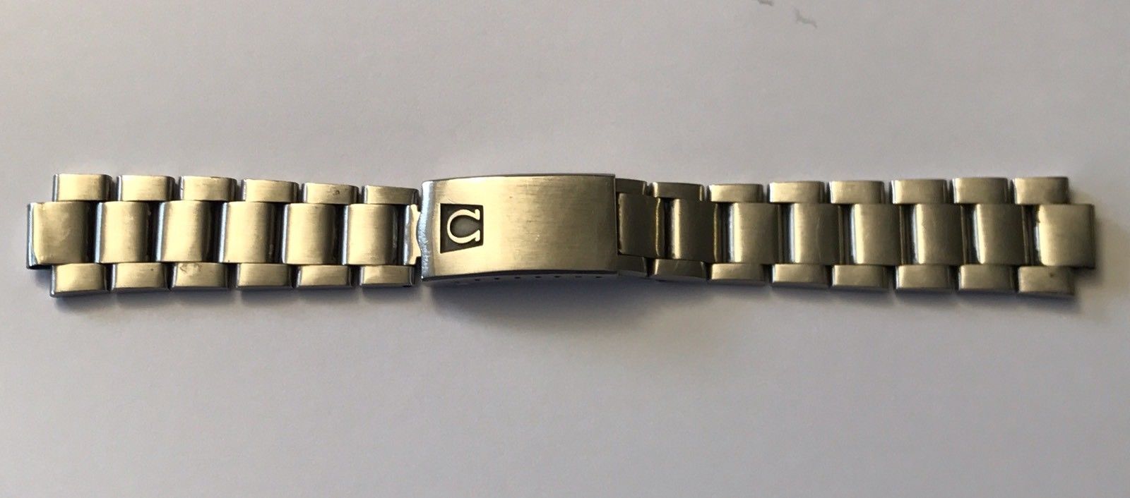

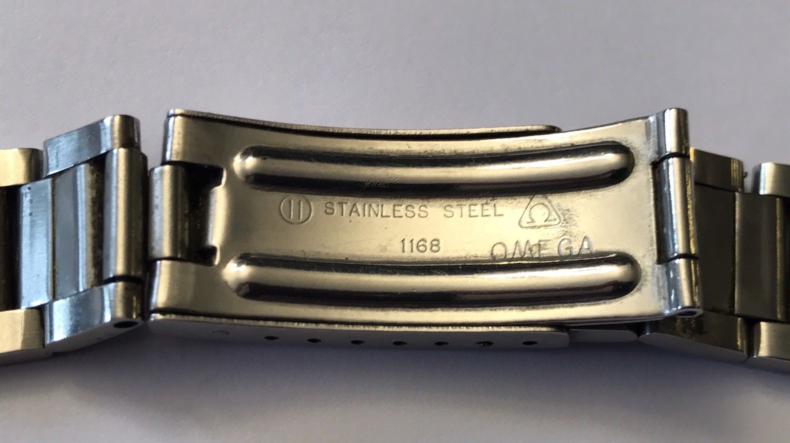

I'd be more concerned that this 1168 bracelet appears to have an incorrect buckle from an 1171 bracelet.
Furthermore, Regarding the links ( which appear correct for an 1168, but short), it is common for the last link to be narrower than the end link and lug gap. If the last bracelet link was equal to the lug width, the bracelet could scratch the insides of the lugs.
An example is the 1035 bracelet whose last link is approx approx 18mm while the lug gap on an Ed White 105.003 is 19mm. Occasionally you might see an incorrect 1039 bracelet attached to an Ed White. As the last link of a 1039
Is approx 19mm, the last link can often get stuck and rub the inside of the Ed White's lugs.

I was just pointing out there are 2 different 1168's with different last link widths. This is the wrong one to be listed for the A-S Speedmaster.
Note the previous chart:

Ok. These 1168s are a bit more modern than most of my bracelets and MWO only shows a raised emblem 1168 for Speedies.
The OP seems to indicate that, 18mm, 1168 were produced for Geneve's. Perhaps the bracelet you posted was originally from a Geneve?

If you want I can provide the data for a 1067:
A:18,4 B:10,1

Excellent post, bookmarked! In addition to the straight, fixed end link bracelets that feature in your 1162 section, there are a few others that I came across while researching correct bracelets for my watches. Might be useful for reference:
- 1171/175 (20mm fixed, straight end links. I believe these were for the 176.005 'TV dial' Seamaster).
- 1116/148 (20mm fixed, straight end links - bracelet tapers to 20mm at end links. I believe these were for the 145.024 'Flat Jedi' Seamaster)
- 1116/154 (20mm fixed, straight end links - bracelet tapers to wider than 20mm at end links to connect with the lines of the case of the 145.014 'Mark II' Speedmaster).
- 1159/154 (20mm fixed, straight end links - same as 1116/154 but with wider center links).
I recently purchased a 145.024 Seamaster Jedi, and it’s fitted with an 1171/175. Per the OPs photos, it’s the oldest 1171 version with the unboxed Omega symbol. Not clear if that bracelet was original to the watch, but seems to be chronologically correct if nothing else.
This version of the 1171 uses screw pins on the bracelet removable links. I recently tried to order additional screw pins and, when they were received, I found them to be roughly 1mm too long. The supplier was flummoxed, saying he had used these on many 1171s. So my question to the OP is this: does the subsequent 1171 version also use screw pins, and are they slightly longer?
