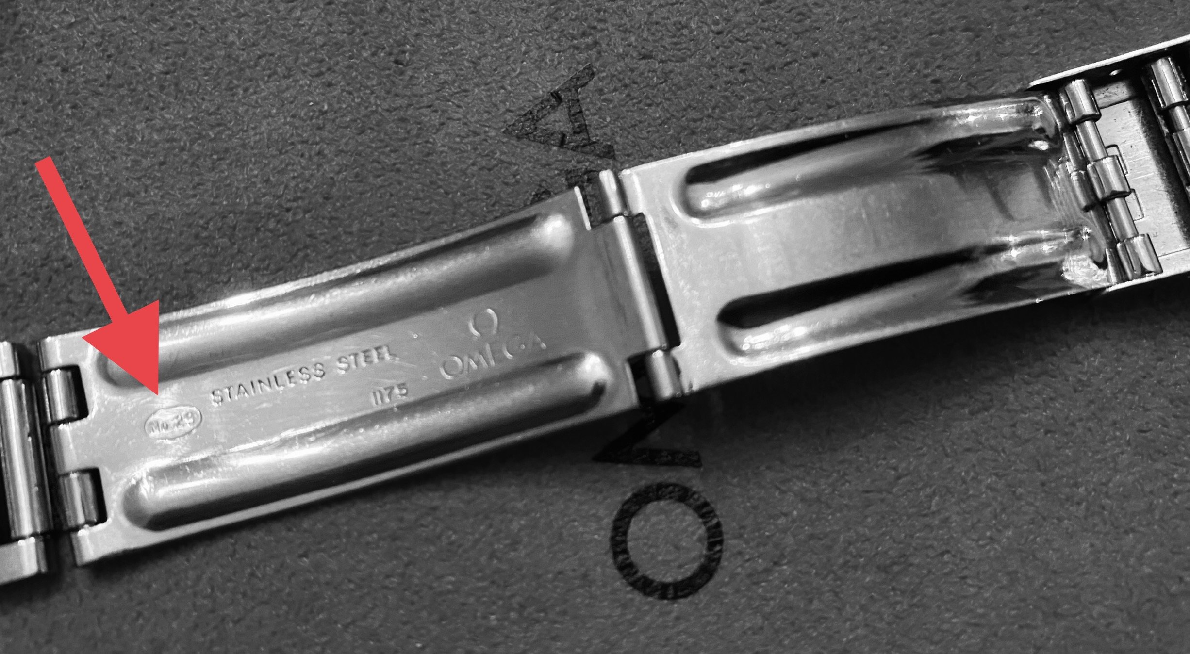

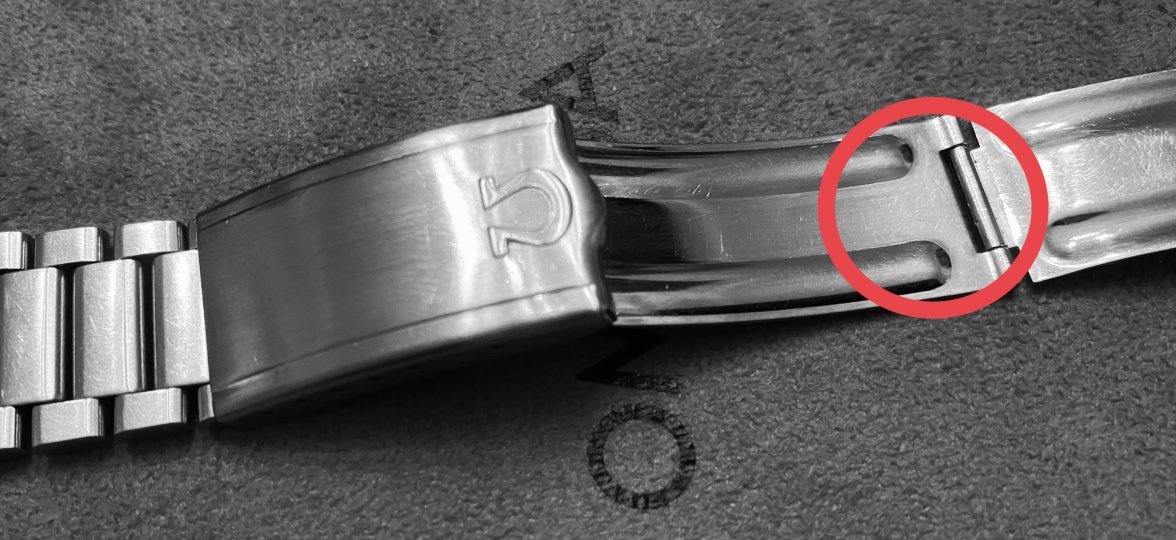

Hi,
I have a question to ask here already written in another post, but which also concerns my bracelet.
1175 question…
1st edition MWO shows a No.12 clasp and a date stamp…I have a No. 29 clasp and no date stamp. Is my 1175 a service 1175 or used for oter Omega watch?
1st edition MWO indicating date stamp and No.12…
My 1175 indicating No.29…
…and no date stamp…
Thanks Omega Forum!

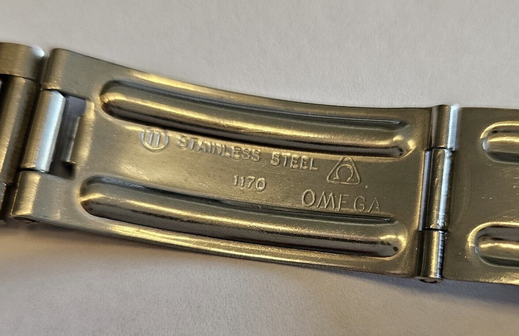

Dear Omega experts,
what do you think about this 1170 bracelet, is it genuine?
Looks like the letters aren't stamped or engraved, but embossed.
Thanks a lot for your evaluation.

Hi,
1175 question…
…and no date stamp…
Thanks Omega Forum!
My 1175 reports the no. 12 and a date 3 72... so coherent with the 145.022-71 it dress

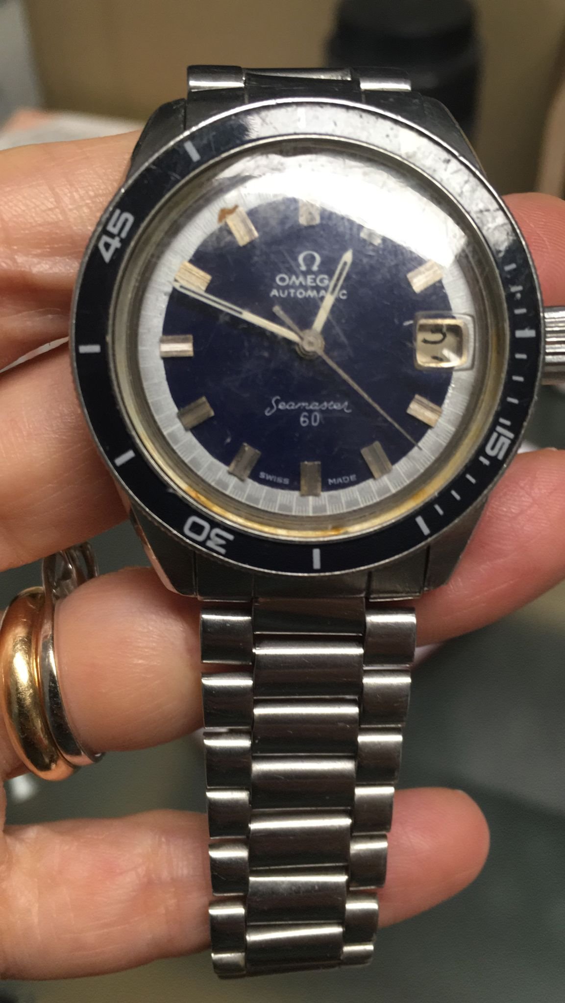

ok, maybe this is the right place to ask.. I have a Seamaster 60 "Big Crown" (deep blue dial with the 60 explicitly reported on it ) bought in 60's brand new in Italy (where I still live) by my father.
Now it is in service as my father passed away 10 years ago and when I found the watch in a drawer it was desperately asking a service.
The point is:
the watch is a 166.0062 and is fitted with bracelet 1125-11 and 560 endings..
I don't think he replaced the bracelet but who knows.
I would like to understand if the 1125 is the original standard for seamaster 60 or not.. I'm quite sure there are 2 different versions of the watch.. One earlier (that I have) that reports the 60 on the dial and come out with black bezel not matching dial color.
And the second version with no 60 on the dial that had the bezel matched with the dial, but that's another story..
My Question is:
would I find a different bracelet for my dad's watch to bring it back to original? Or is it 1125-11 with 560 ends correct?

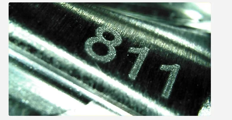

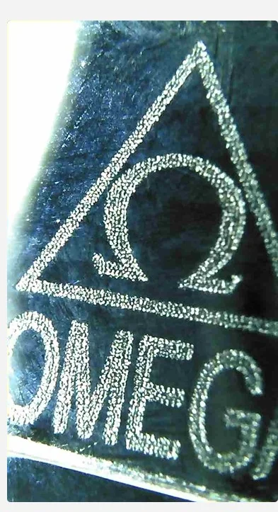

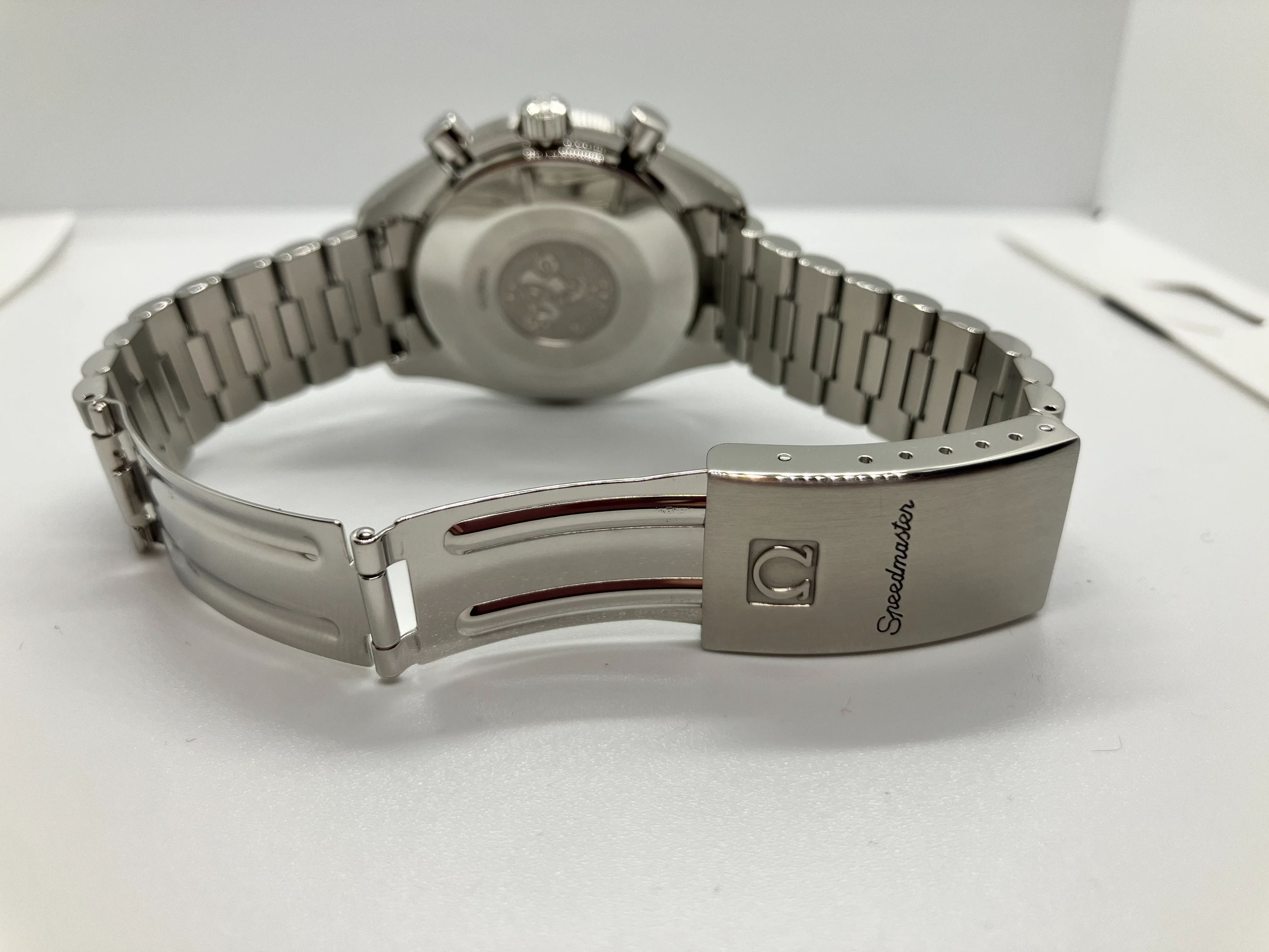

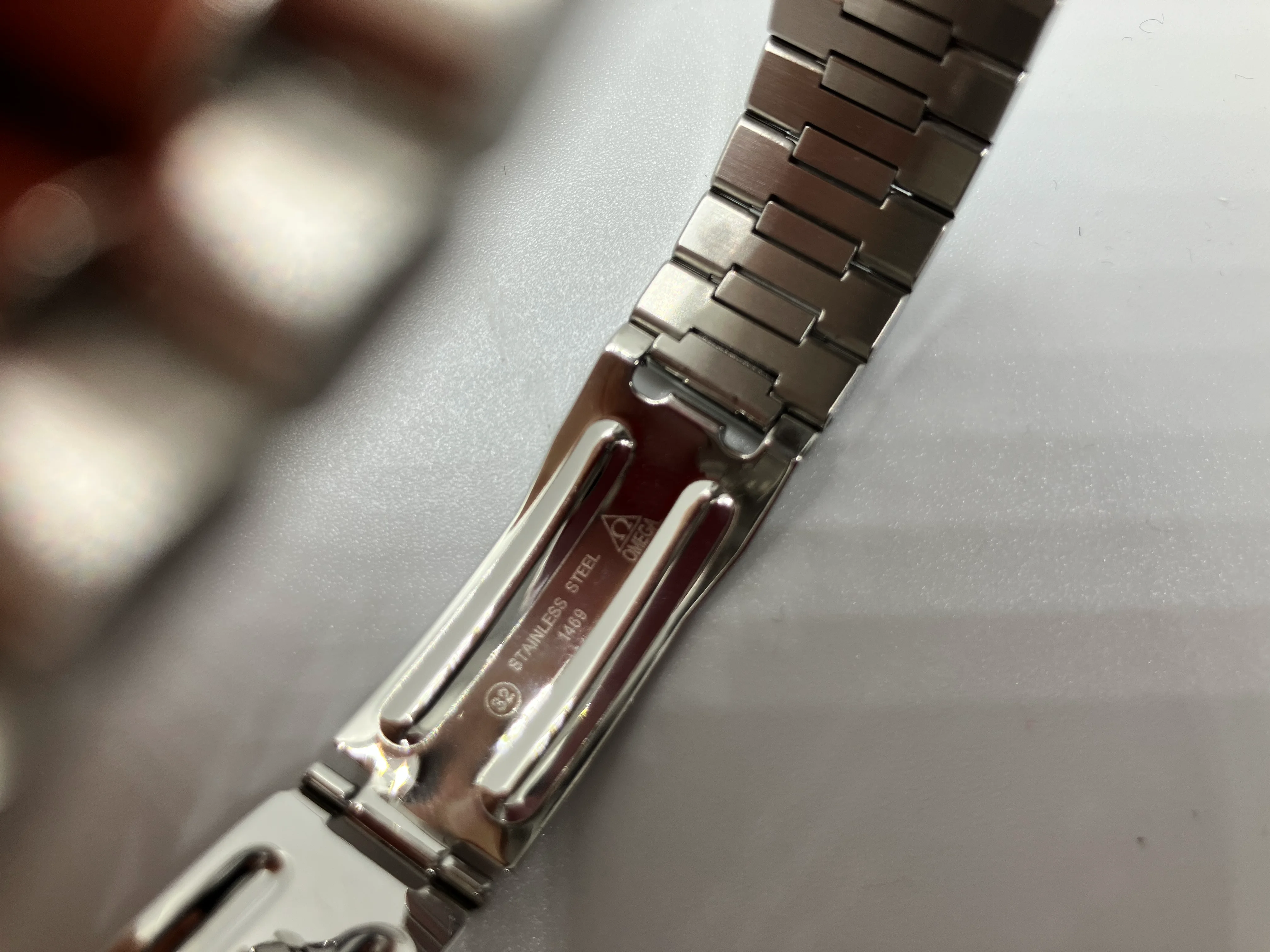

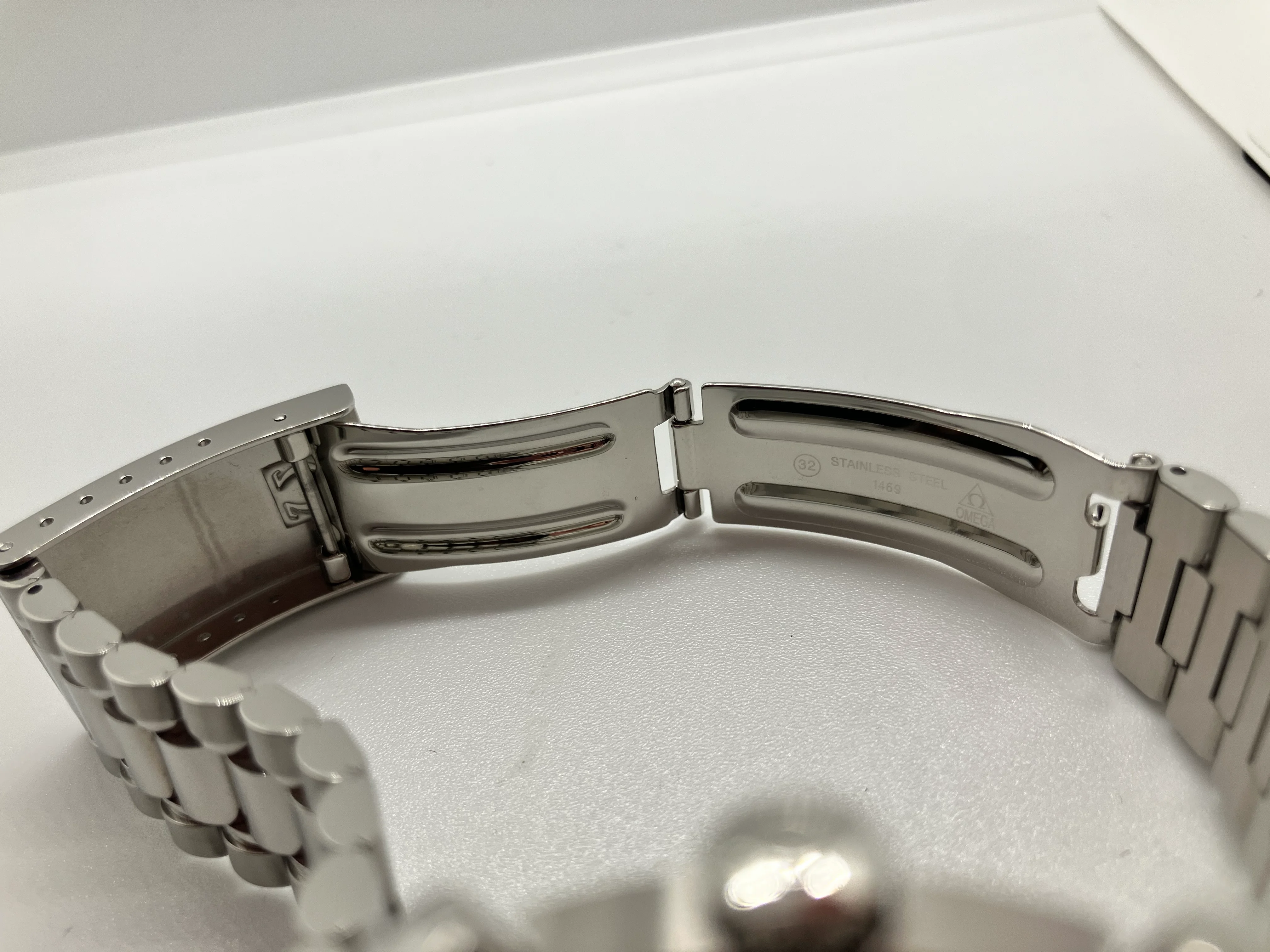

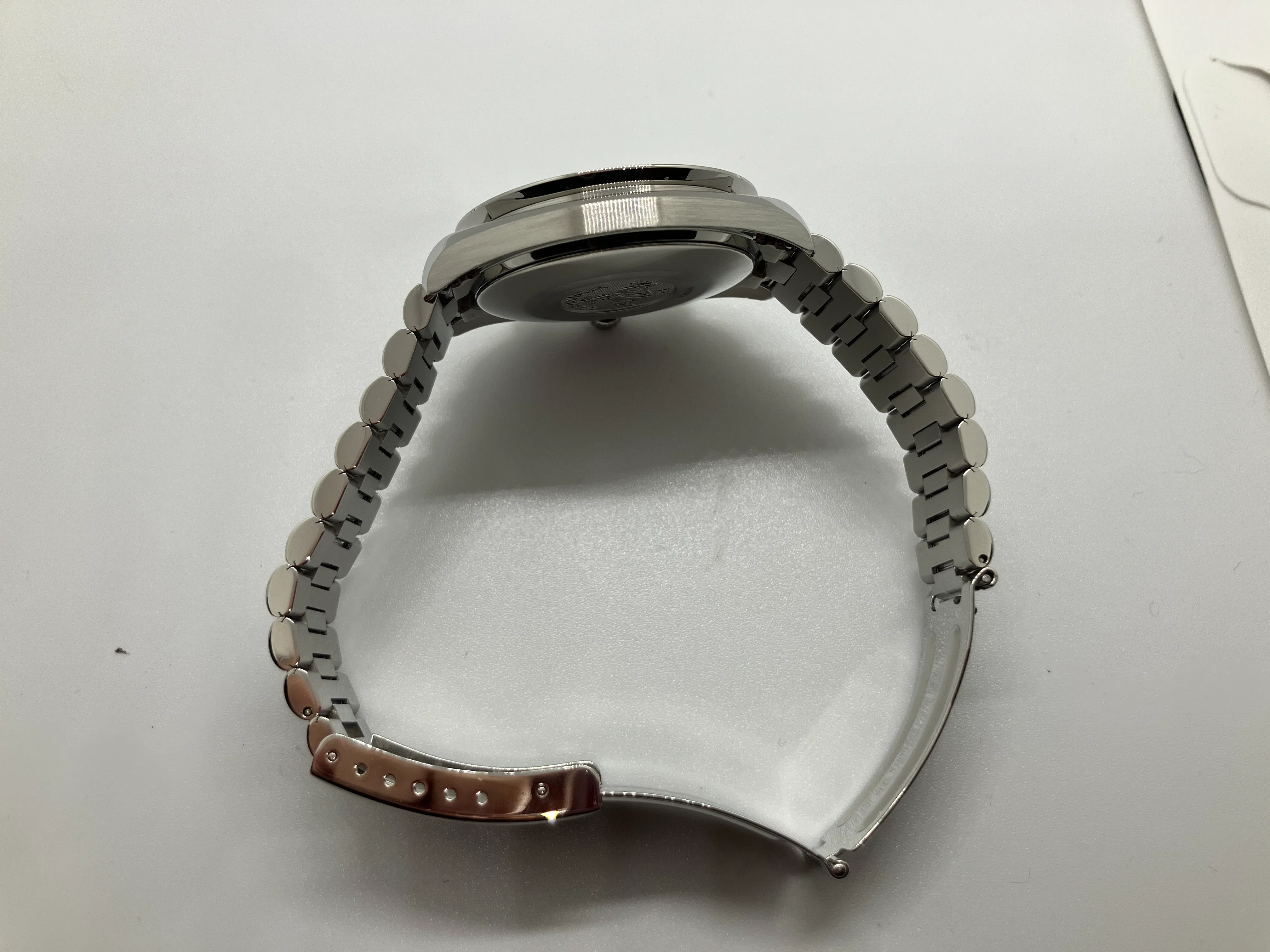

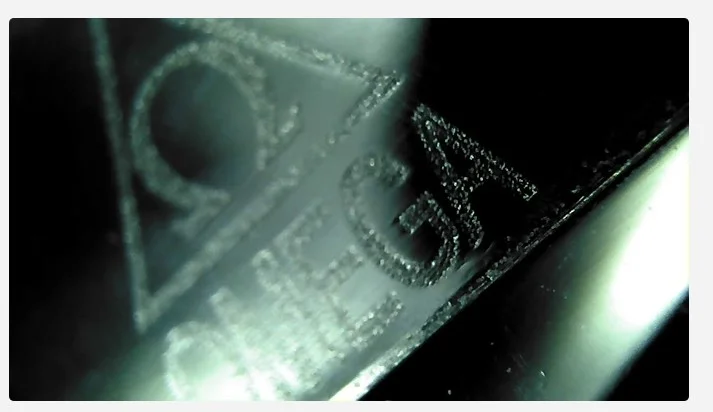

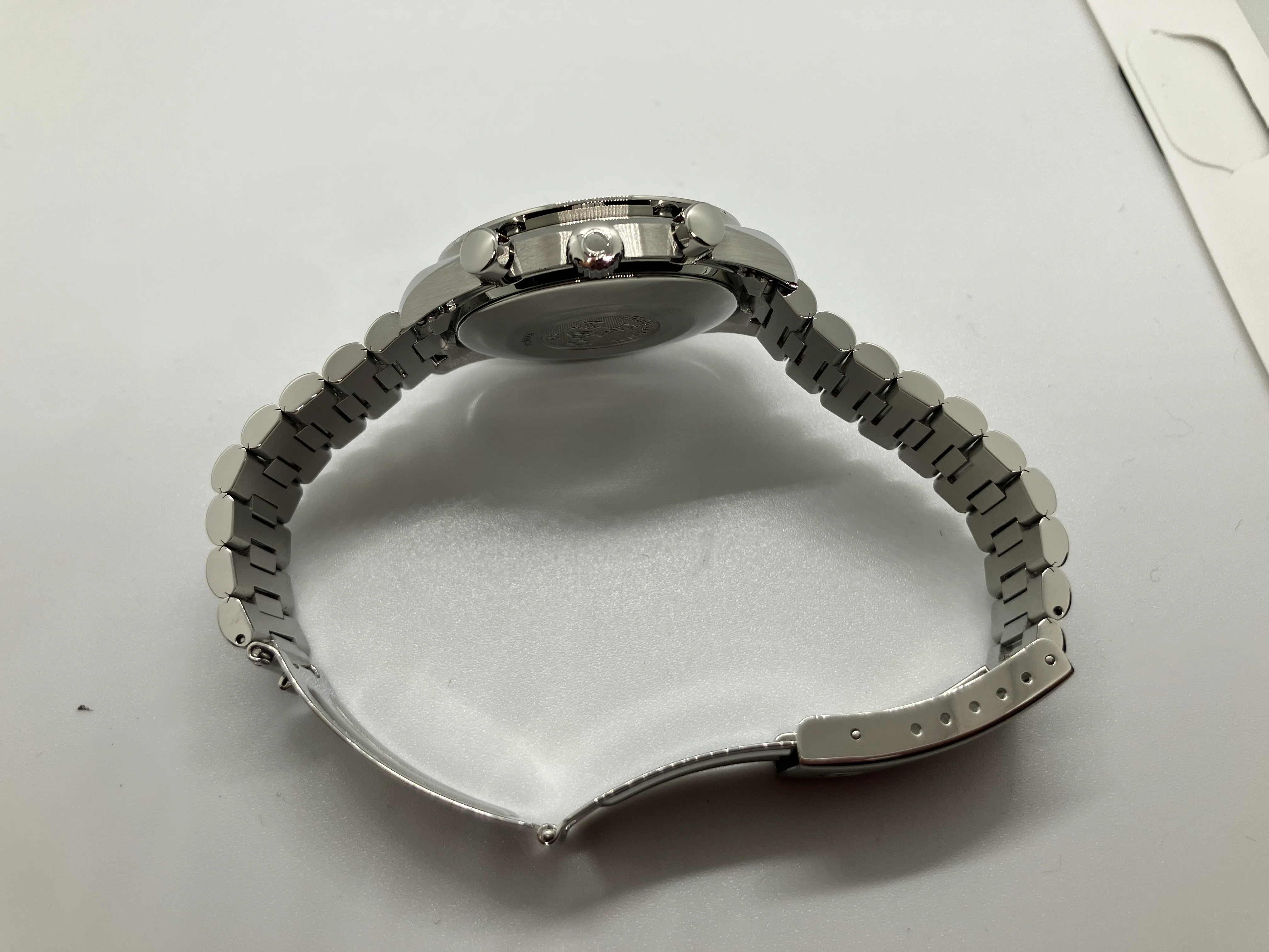

Hi everyone, I’d like to ask for your help in confirming the authenticity of this bracelet, ref. 1469, on a Speedmaster Reduced (serial > 90000000) I’m about to purchase.
The engraving on clasp and end links are laser-etched instead of punching, which raises my doubts.
I’ve attached some photos with close-ups of the engravings.
Thanks a lot for your help!
