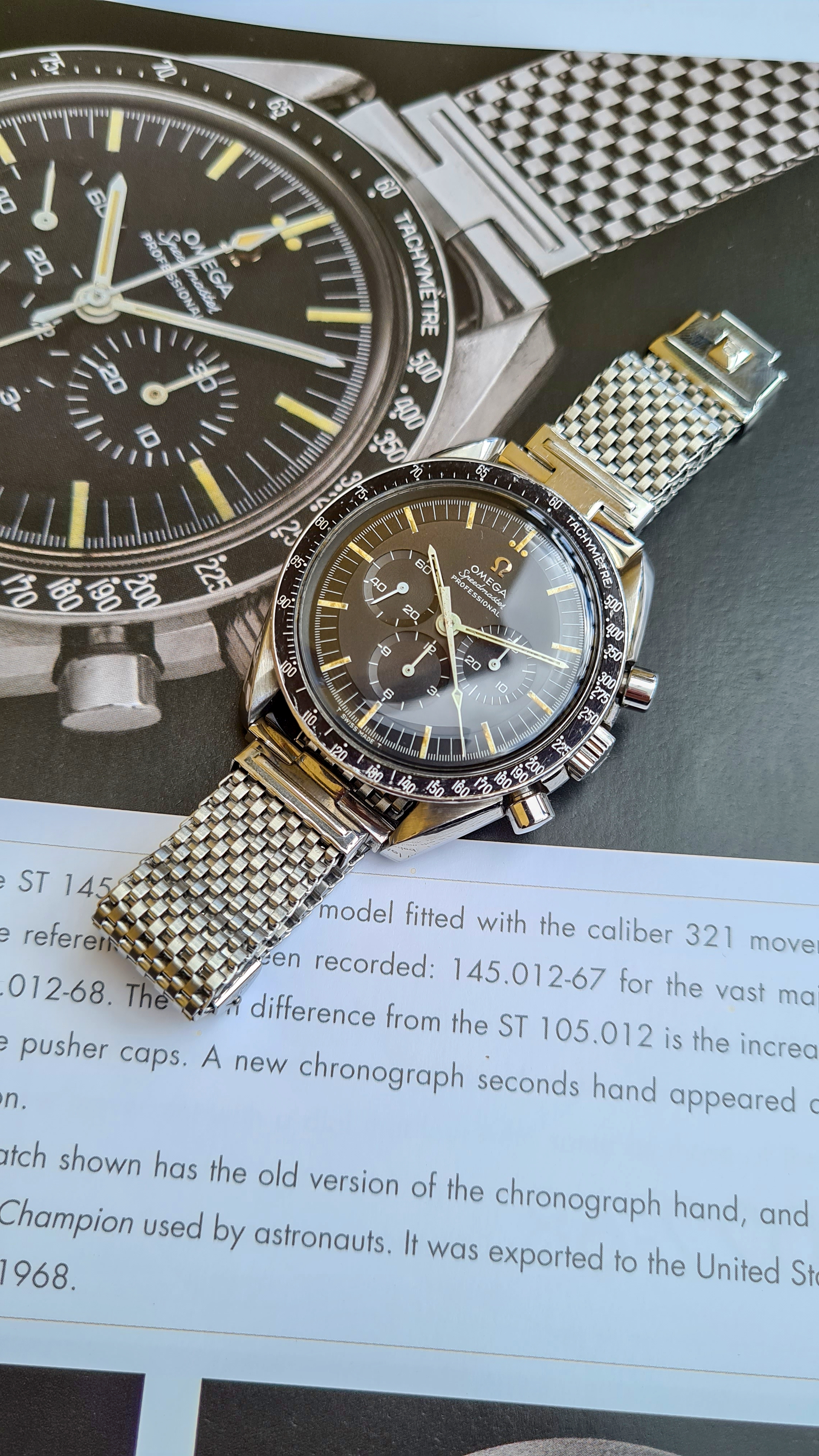

really ... ?? i really do not have that concern ..... here is my accutron astronaut .. paired with the JB Champion USA bracelet ...... it has never scratch the inside of the lugs ... ever ........
This is my favorite pairing for this bracelet- It’s the short, almost tucked lugs.

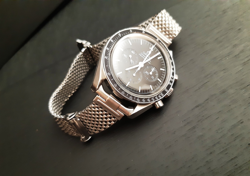

I really do not understand who started posting that concern concerning the end links damaging the inner surface of the lugs of a watch ... i can only confirm from personal experience using my JB Champion bracelets on several of my watches lug with 17mm thru
19mm and yes even on a watch who has 20mm lug width ... NEVER EVER have the end links damaged the inner surface of the lugs of any of my watches

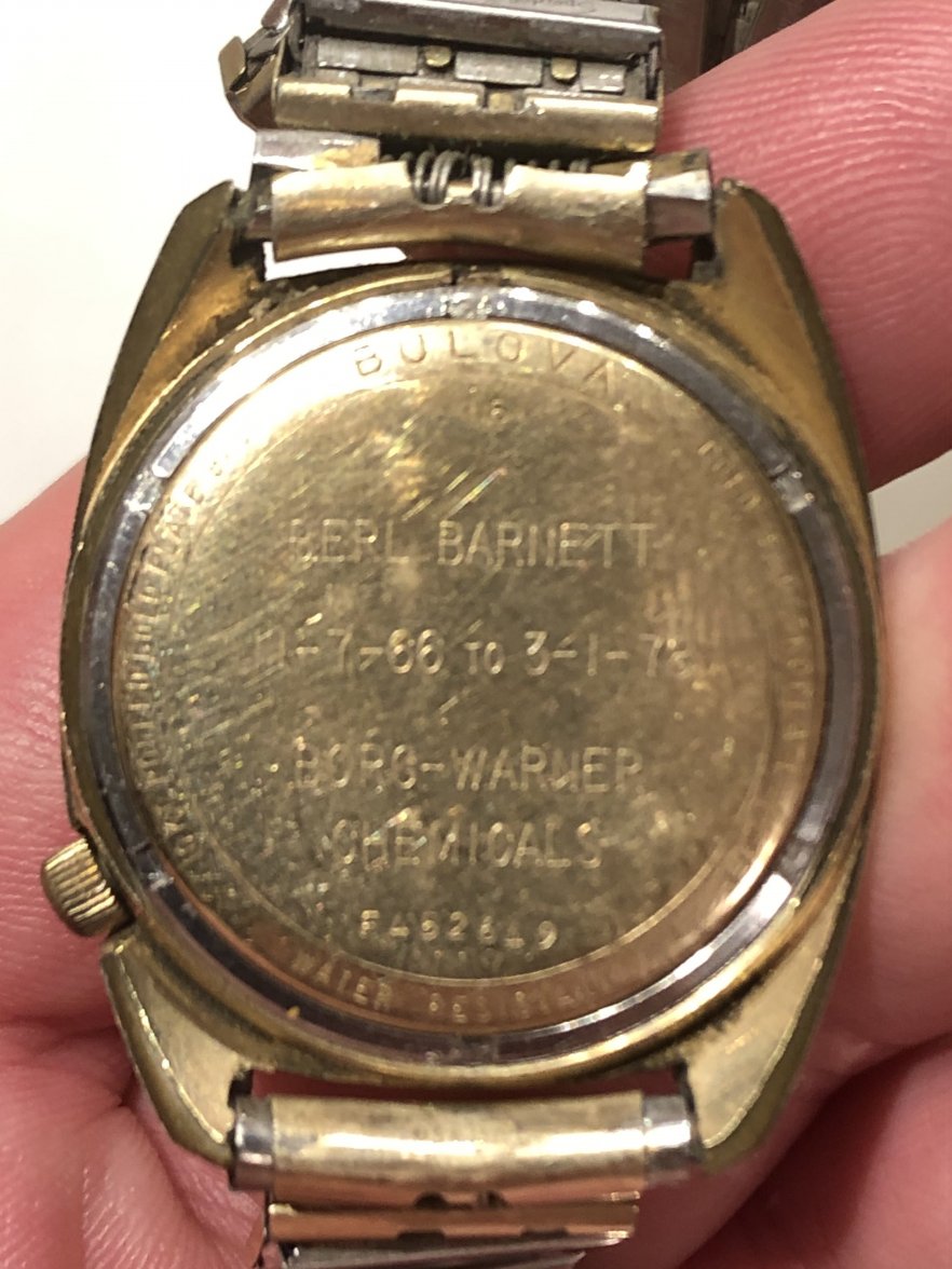

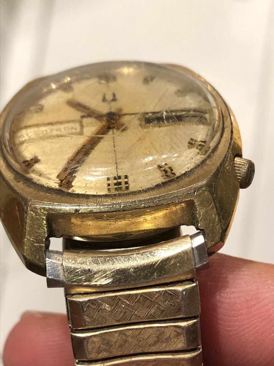

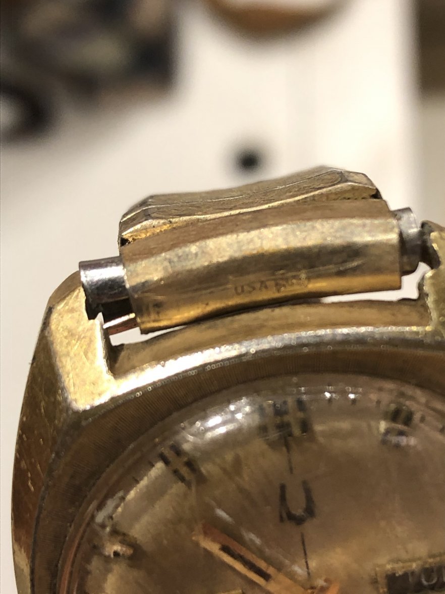

This is a common issue with any sort of spring loaded end link. The damage is most often seen on softer cases, like this one that is 18k gold:

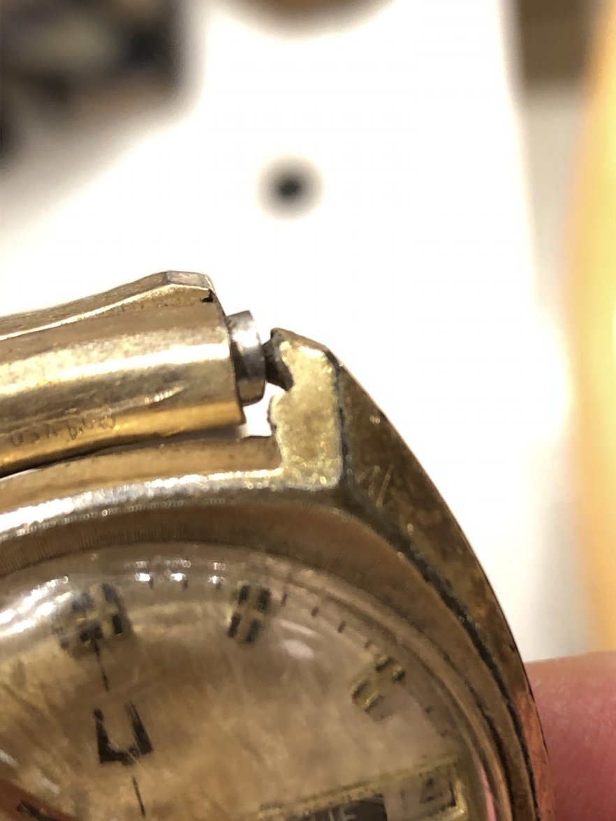

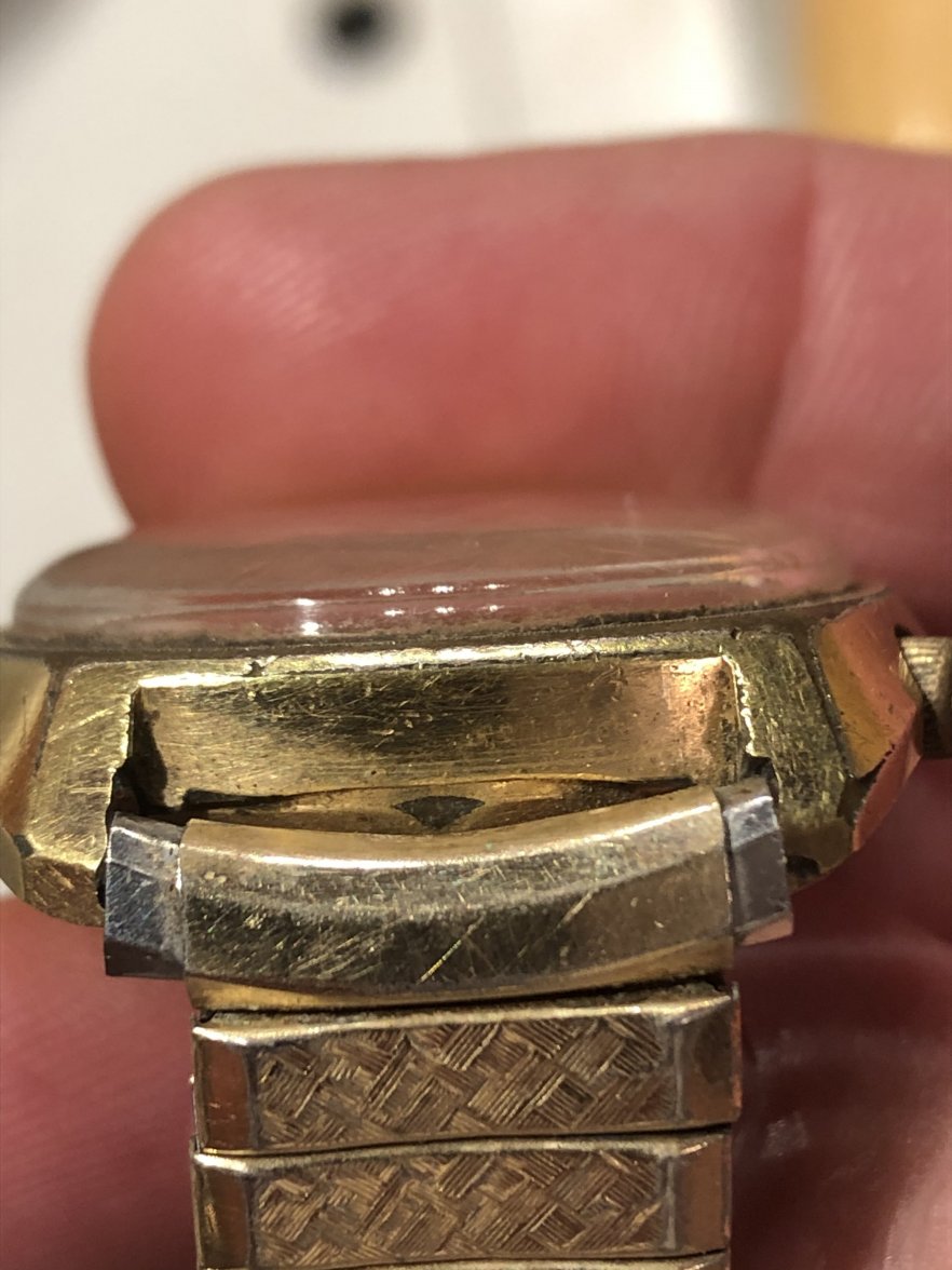

However, stainless steel cases are also affected:
Since there is nothing on the end link to keep it from moving relative to the case (as there typically is with fixed style end links) the relative motion of the parts, plus the pressure from the spring will eventually damage the case.
I usually advise my customers to avoid this sort of spring loaded end link, and people here have developed various work arounds to protect the cases from damage, such as fitting O-rings between the end link and the case.
Cheers, Al

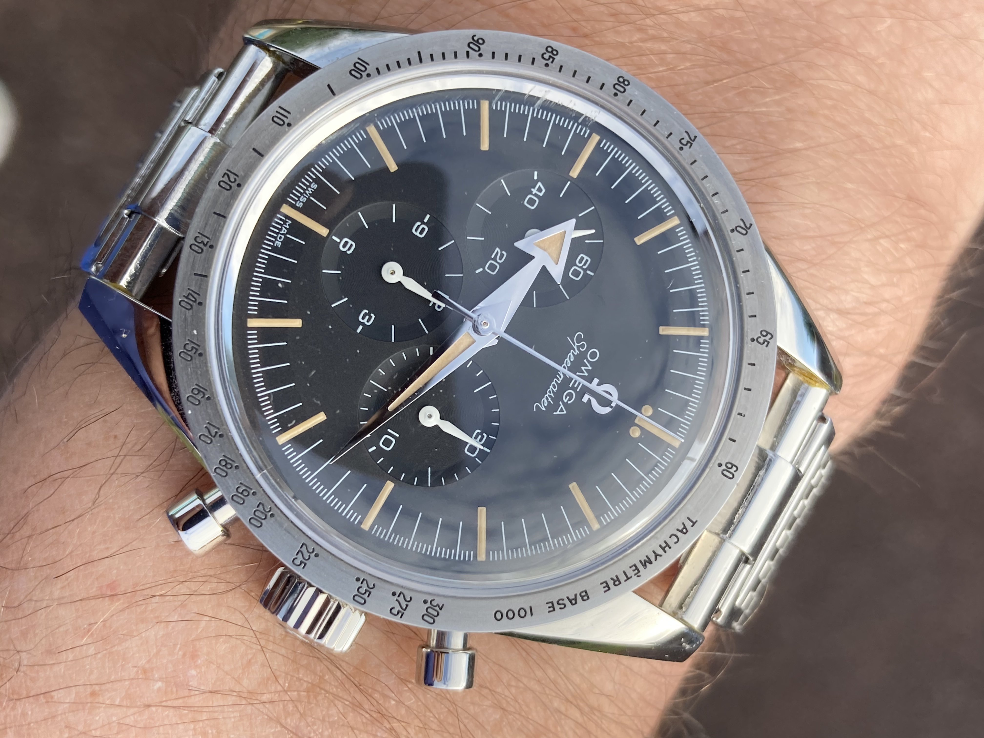

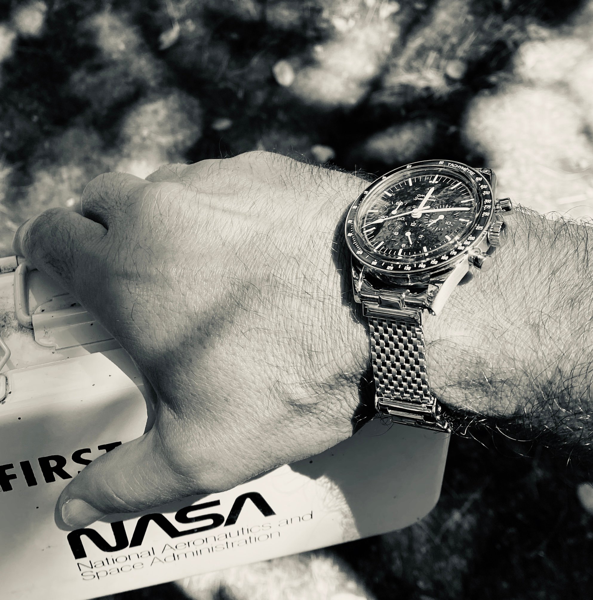

Finally my bracelet has arrived! Extremely comfortable, but the best picture was off the wrist 🙄

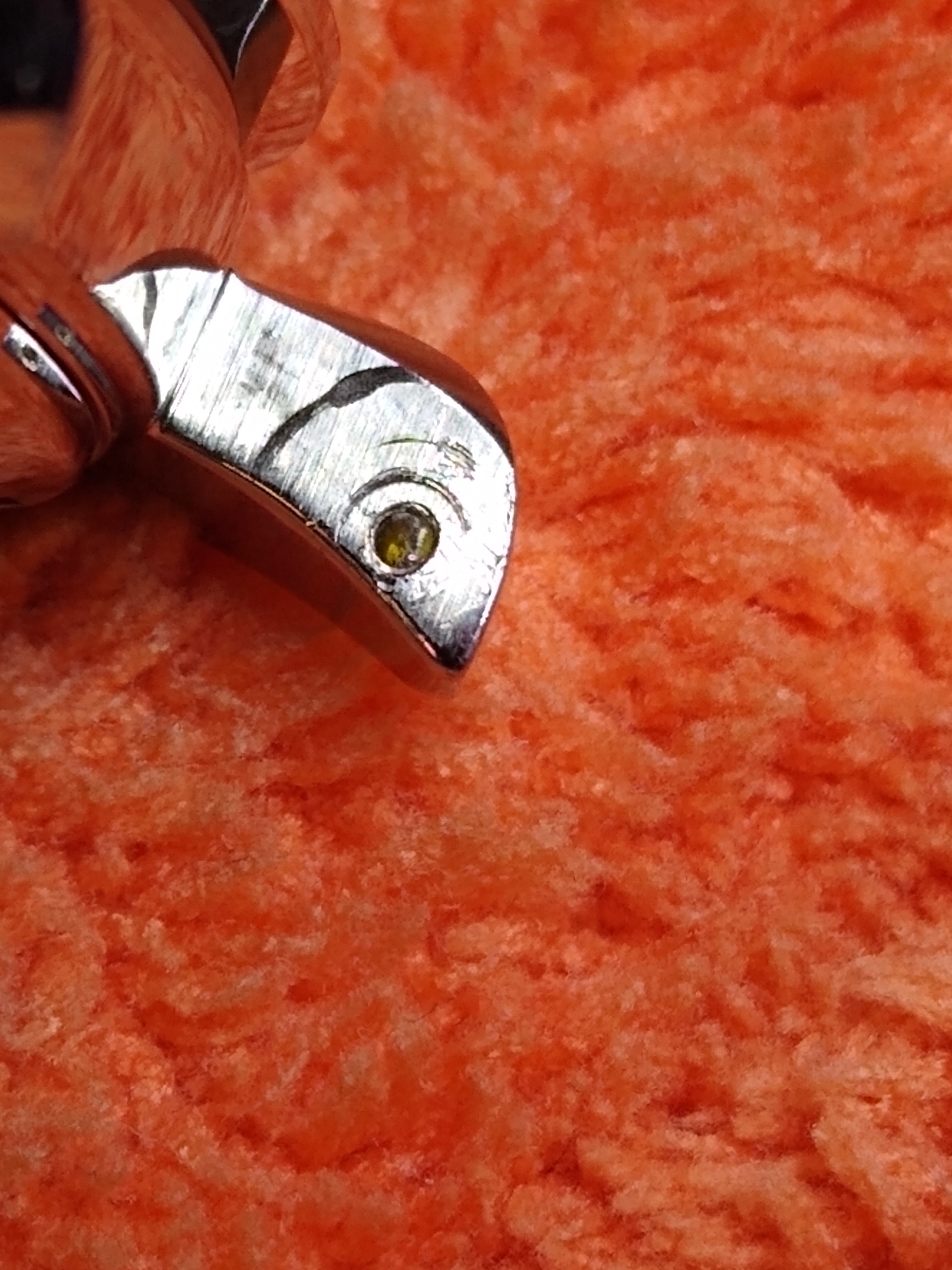

403
771
I wore my band for about 3 weeks, and it did mark the inside of the lugs. I went to other bands for awhile, but put it back on yesterday and really LOVE the look. I sanded the insides of the horned ends to see if it helps. That outer mark looks like it would be outside of where the yellow dots would protect. (the dot did fall the first time I wore it). It looks like it came from the horned ends.
