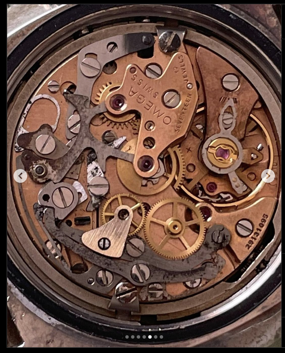

It has been assembled, but that's not serviced. It doesn't appear that any parts were replaced. It was just put back together so they didn't just send a bag of parts to Omega...
Pretty much all the steel parts in this watch are going to be replaced, so whatever cleaning up was done, wasn't going to save any of those parts. The minute recording wheel doesn't seem to have a pivot on it (not visible in the jewel) so it was either rusted away completely or broken off. It's still the same basket case it was, just not as ugly.

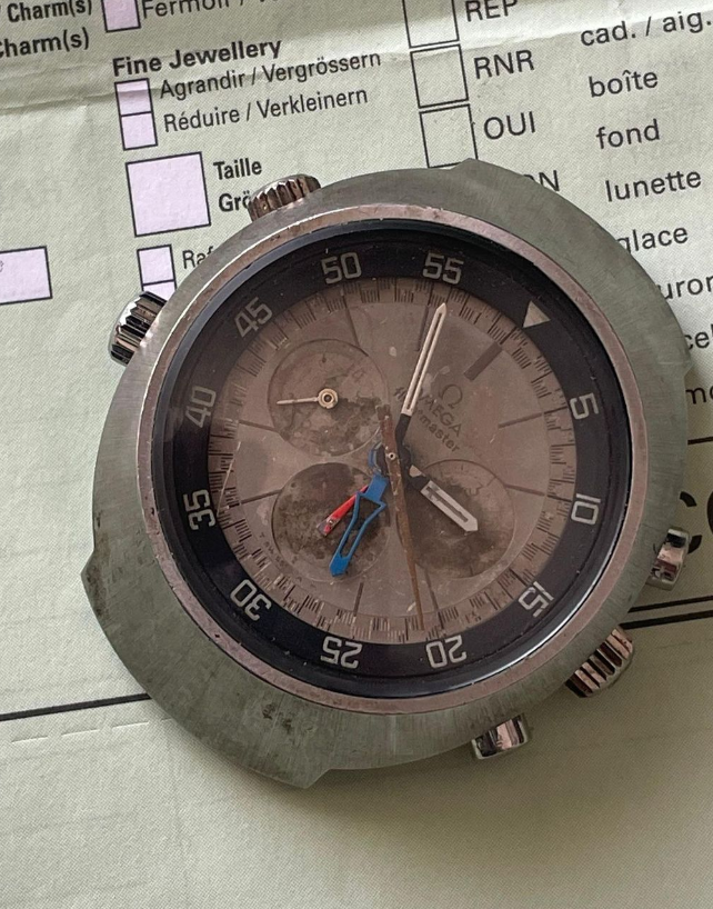

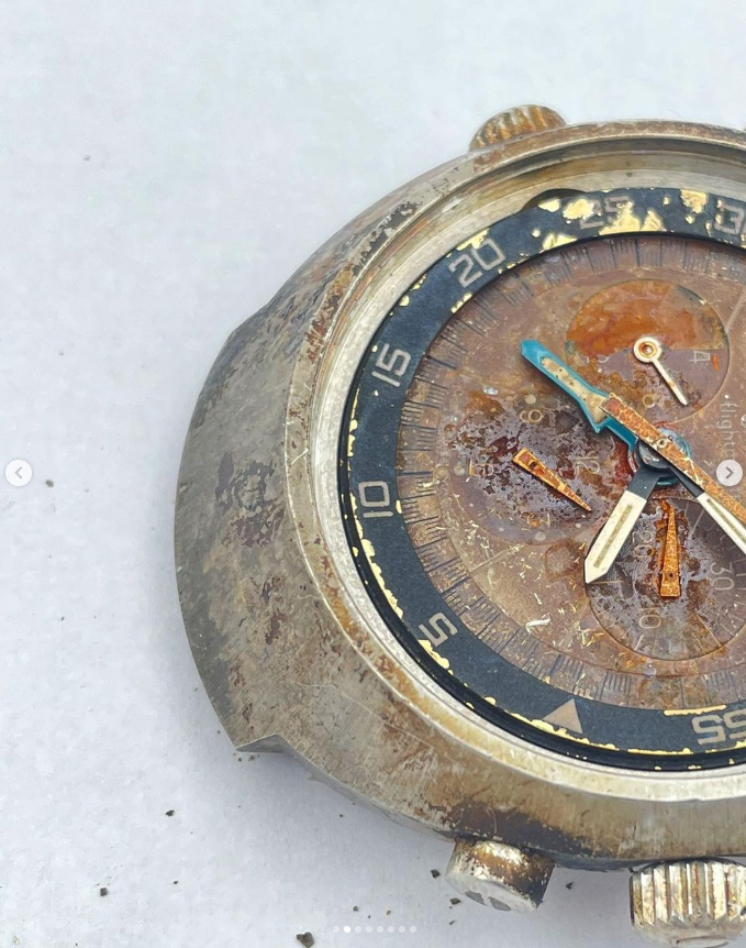

They said it was running again, didnt they? and also, they changed the inner bezel.
vs.
vs.
That’s not just a bezel, that looks like a new crystal as well- and they “cleaned” up the dial. I know a few members who would wear this as-is 🙄

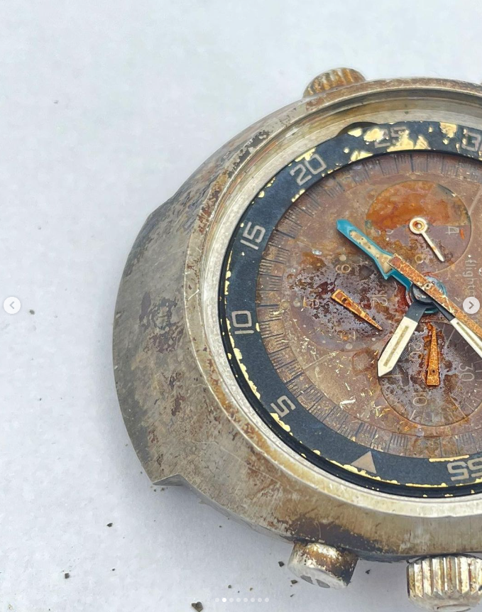

That would be called a “ghost” dial!!

Present!
I would have repaint the second hands and small chrono hands to have them more visible though.😁
