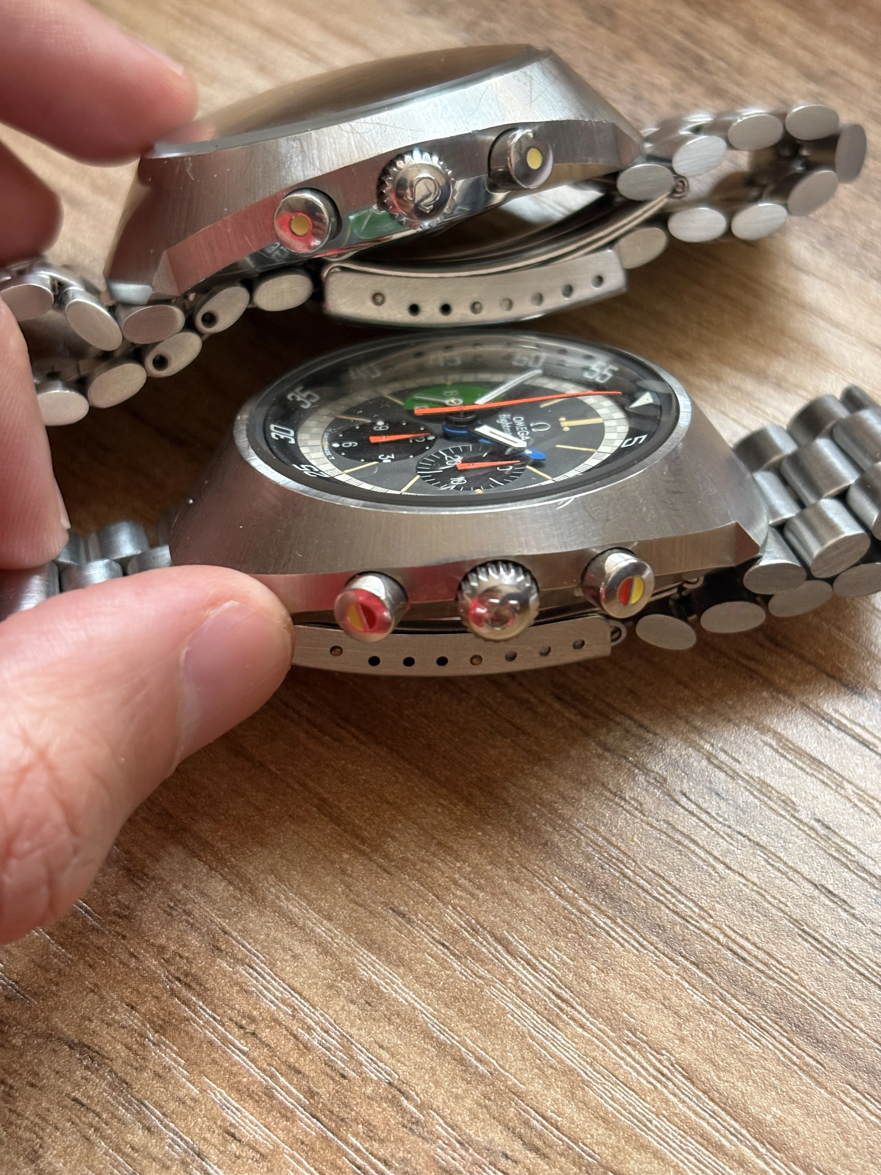

Kindly ask you to help me to find yellow dots pushers ( not red/yellow ) for my Flightmaster 145.013 for purchase.

You are only going to find vintage pushers like this, as all the new pushers are the two colour design.

Hello😀 yes, sure. I want to find old or NOS. I saw in previous topics, guy manage to find.

Well no so easy what you may find is the caps only, and you have to buy pushers apart as the pusher of your 2 colors pushers are not the same size.

Hi, I was there.... I bought NOS single color pusher caps here on OF...since I needed also the new pusher necks, I used NOS Speedmaster Mk3 pushers I had in stock as part donor... the necks were 100% match, only thing I had to use were the original flightmaster pusher extension rods...
I can verify statement above, that the single dot pushers cups won`t fit doble color pushers neck, as I have in somewhere in the box, but I doubt it, as the watch I have when bought, had one original single dot and one double colored cup fitted as replacement on original necks...
Good luck with your hunt, they pop up here time to time...

Thank you for additional information.

My experience is that they are the same size.

I confirm Single dot caps need different pusher that the 2 color caps
