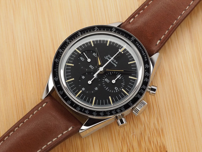

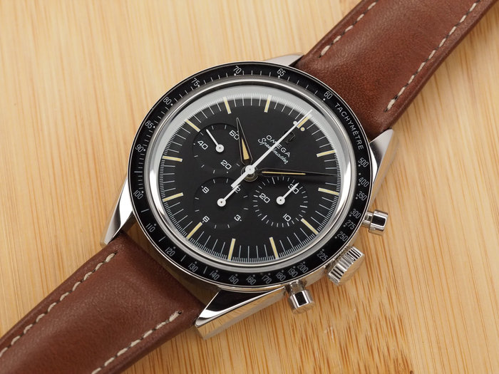

My FOIS already has a steel bezel but I guess one of the best upgrades is the hesalite crystal, seen here installed by Lewis Watch Co
1,134
1,690
Wha....okay, I gotta admit- that's actually one modded speedy I'd REALLY love to have!!
1,677
5,950
Yes I was thinking the same thing, I believe it is / was for sale for around USD$4200, if I didnt already have a FOIS then this would have been the one I'd have gone for, great looking watch
1,134
1,690
Wow, I completely missed this sale. I only saw the one that was broad-arrow modded a la 2915. That 2915 one wasn't lume colored so it was just kind of so-so. This one I would have actually jumped on...it's near identical to the real thing except for hands, bezel, very slight case finish, slight step on dial and the crown width.
1,677
5,950
I'm on his mailing list and this FOIS was for sale as of 3 days ago, I was seriously thinking of contacting him with a view to purchase and then selling my FOIS but for some stupid reason decided not to 😁
1,134
1,690
Darn! I would have known if I were on his list! Such a good chance gone to waste...🙁
Yes but the cost of that is crazy.
Wow those hands and indicies...
I’d love to get them in those color!
