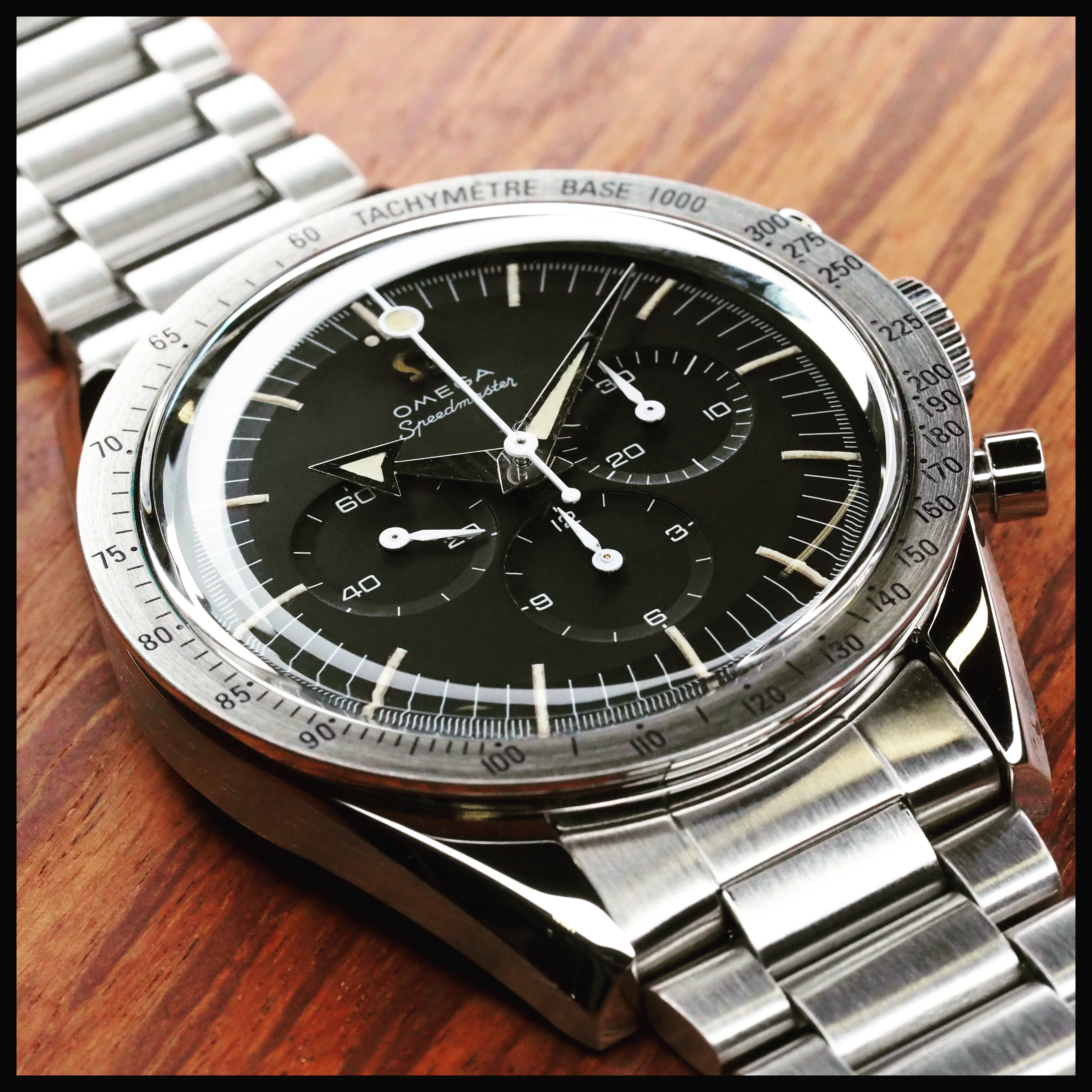

    Well, I thought some of you might possibly be interested in which parts are interchangeable from regular Speedmasters to the FOIS numbered edition to help improve the factory look if that is your thing. BTW the FOIS case middle is not available as a new standalone part from Omega unless you return the original case of your watch to them first.
    CK2915 service crown Part No. 069ST42062 - Direct fit. Wider than FOIS item.
    Any Speedmaster pro case back - Direct fit, including the modern pre moon replacement back Part No. 112ST1450012
    Any Speedmaster pro bezel - including the steel bezel from the early 2000's reissue Speedy Part No. 082SS1139
    Any Speedmaster pro hands - obviously, because it's a base Lemania designed and produced 1873 with a couple of Omega engravings aka the Omega 1861.
    Any Speedmaster Pro dial - for the same reasons as above.
    Any Speedmaster Pro movement ring - ( there are only two options for the 861/1861 ) same reasons as above. So it is possible to add a factory display back should you wish to show off the movement.
    The pushers are a bit odd and particular to this and I suspect the 60th anniversary case. They do not have a screw to retain the pusher cap, rather a simple (cheap) circlip. I have not had to change any of these yet but from basic measurements it appears other push in type pushers such as those from early real straight lug Speedmasters may fit.
    To prevent any ambiguity and hopefully placate whoever has been reporting my threads for self promotion, please don't ask me to source parts or mod your FOIS, instead, please ask your local Omega certified Watch service guy/girl, I'm sure they'd be happy to do it for you.
    Anyhow, Enjoy, over and out for 2017 :). Have a great 2018 everyone!
