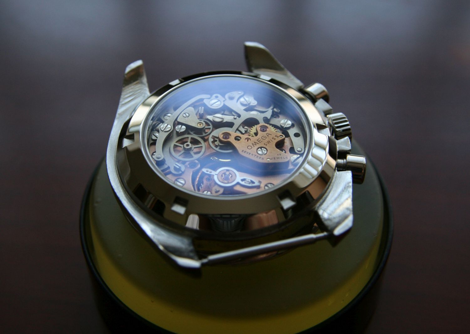

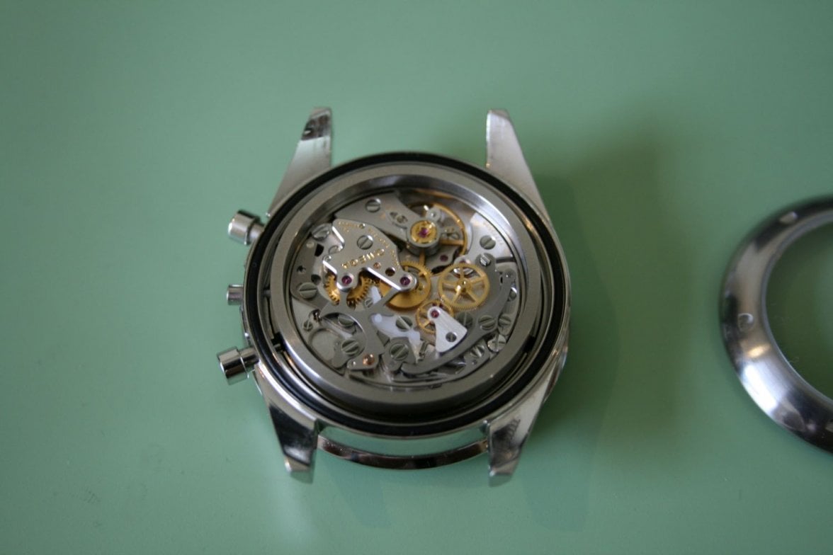

Here is the FOIS with sapphire caseback
The caseback tool I use - made by tog_man, gives a very nice fit with minimal chance of slipping or damage

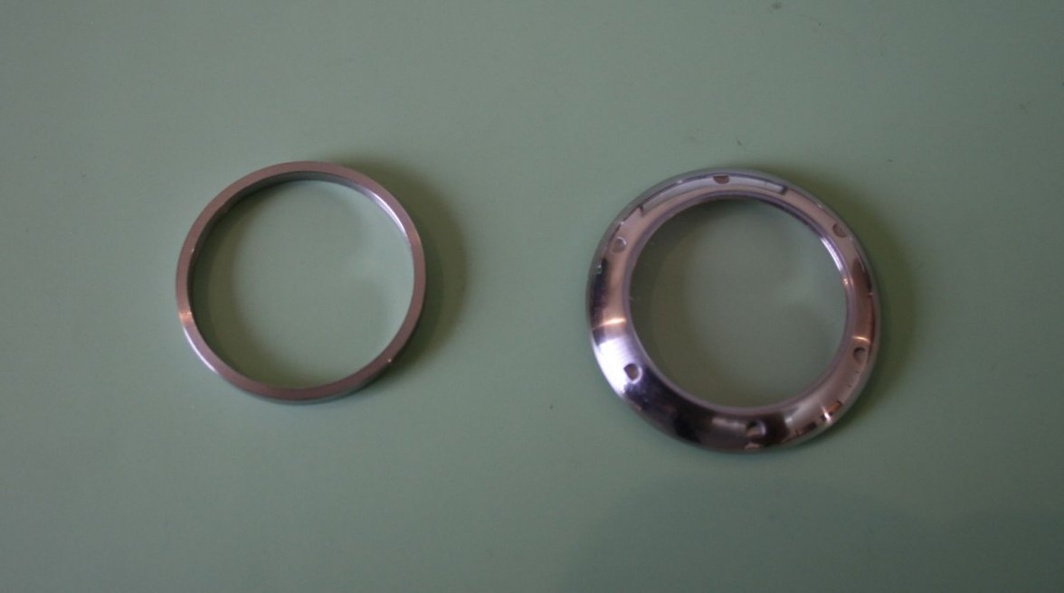

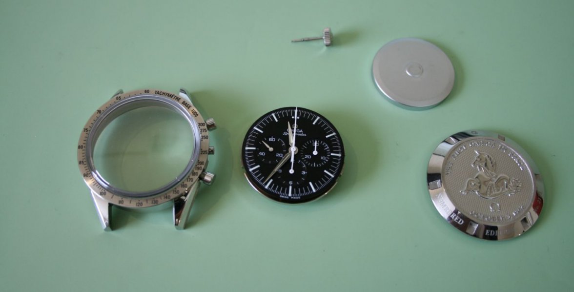

The parts side by side. The gasket is the one that goes on top of the movement spacer
The movement spacers
And finally the case back installed on FOIS
Some points to note if doing this yourself. I use a case back opener from tog_man (ebay seller), I find these work really well and are very straight forward to use. I use finger cots to ensure that my fingers dont touch any of the movement, anti-magnetic cover etc.
When I put back the FOIS case back, it screwed down completely without any major resistance from the o-ring, so I went ahead and replaced the o-ring. It would be advisable to replace the case back o-ring as a matter of course, and also a small amount of silicone grease on the gasket.

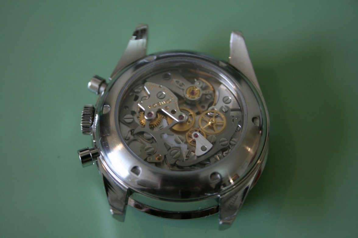

I was asked recently about the Preik case back and if it fitted the FOIS. Since my FOIS uses the same size case back as the normal Speedmaster, then logically a Preik case back for the normal Speedmaster should also fit.
As far as I know this is a standard Preik case back for the normal Speedmaster. The case back has a thread of approximately 33.7mm and the spacer is 31mm x 3.04mm
Once the case back is tight it fits up snug to the case. Everything looks and feels tight, although when gently shaking the watch there could be the slightest sound, hard to say to be honest though. But this was just to show that the Preik case back does fit the FOIS, but the original FOIS is going back on anyway as I have another use for the Preik caseback.

Which model speedmaster pro Sapphire caseback was used in thks mod?

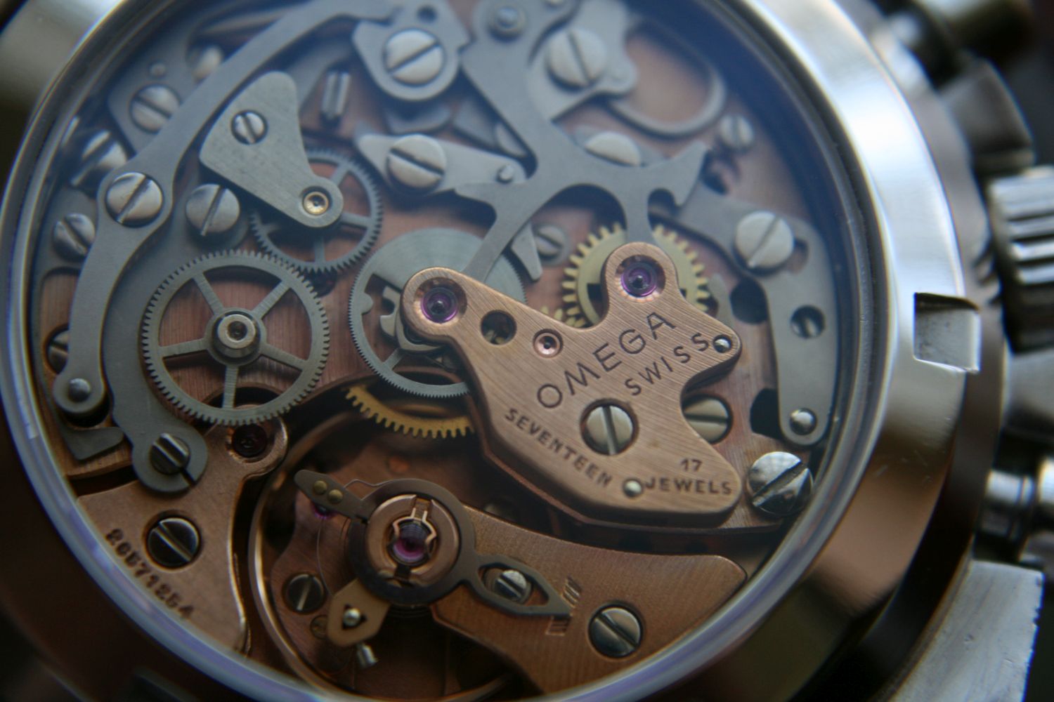

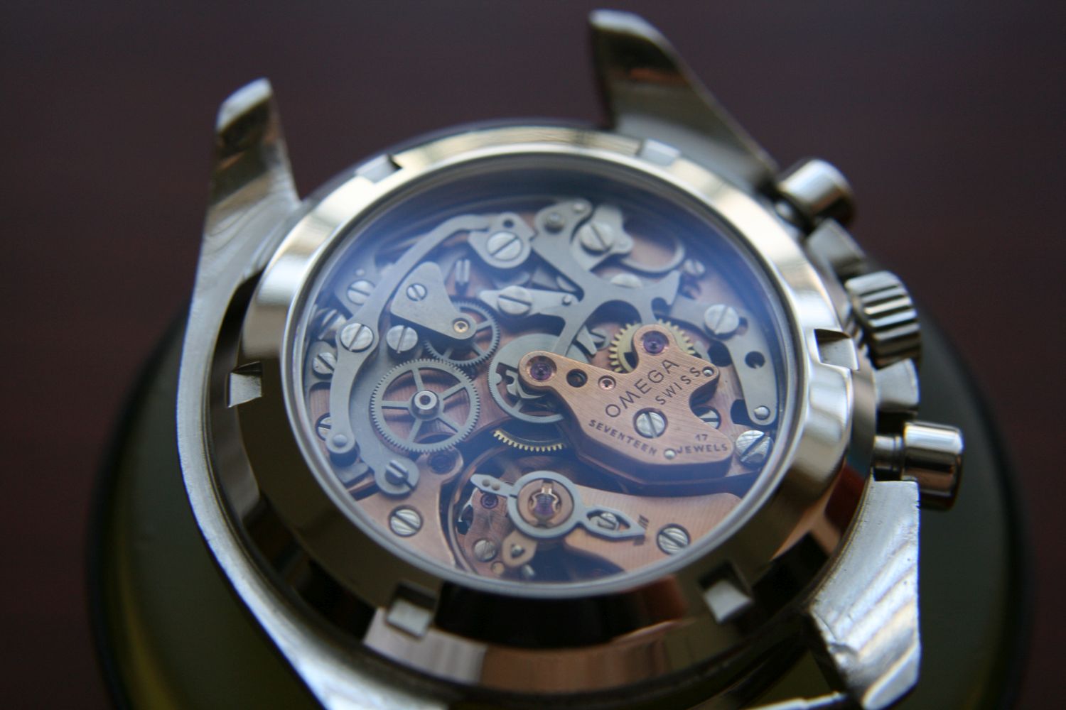

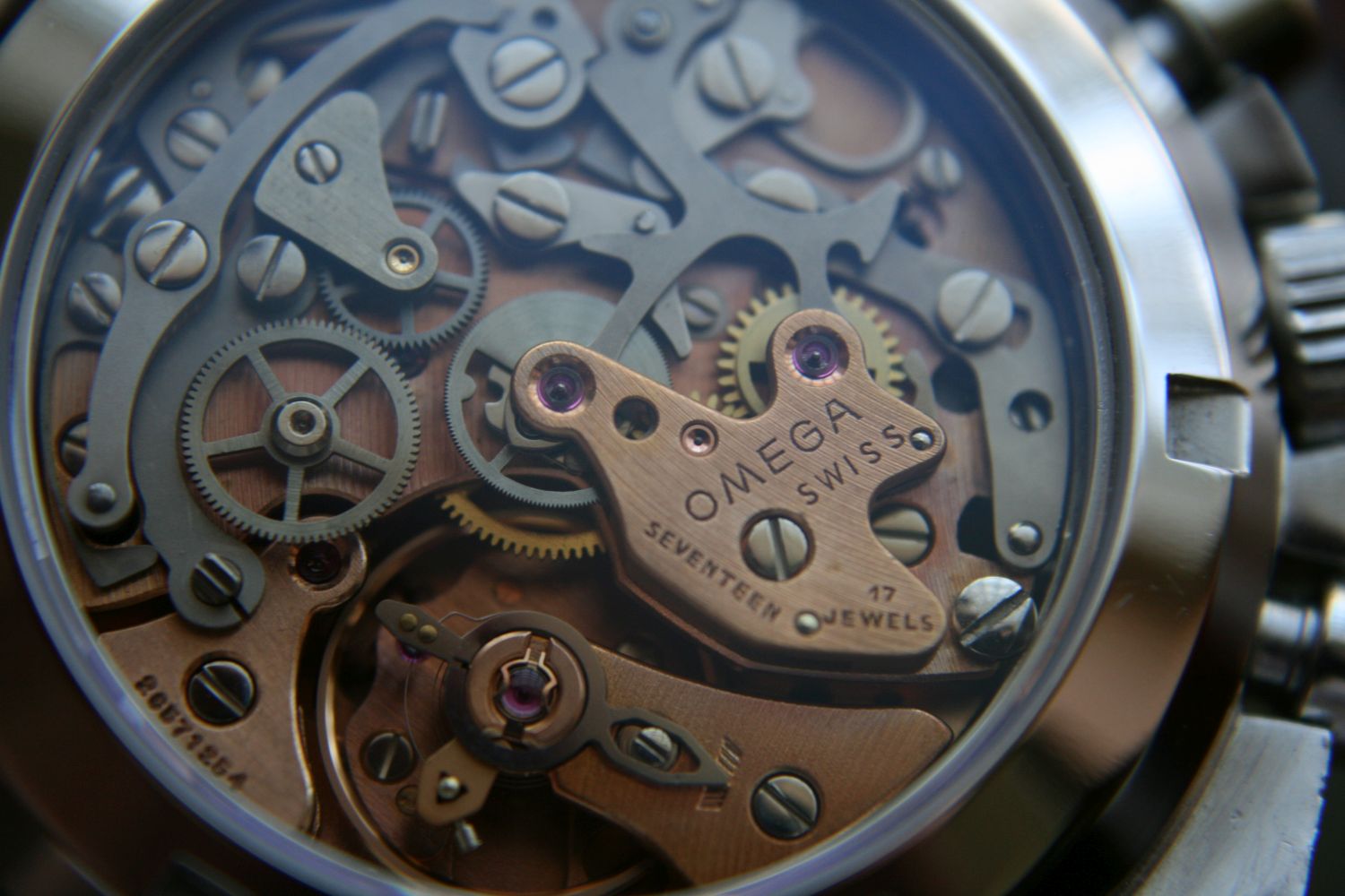

Not too bad..... the anti reflective coating gives a very clear view of the movement 😎
Mine had a very minuscule fleck of dust between the crystal and seal, but I removed the crystal, removed the dust and reseated the crystal.
After fitting the caseback, I then pressure tested the case to 3 bar and no problem with any leaks 👍
Looks really good, thank you. The only problem may be missing anti magenetic protection.
1,677
5,950
I've not encountered any issues with magnetism on my Speedmasters with Sapphire casebacks during normal everyday use, so I'm not sure how much difference the original metal cover and caseback make. This particular Speedmaster is my everyday work watch so it does get used in a variety of different situations.

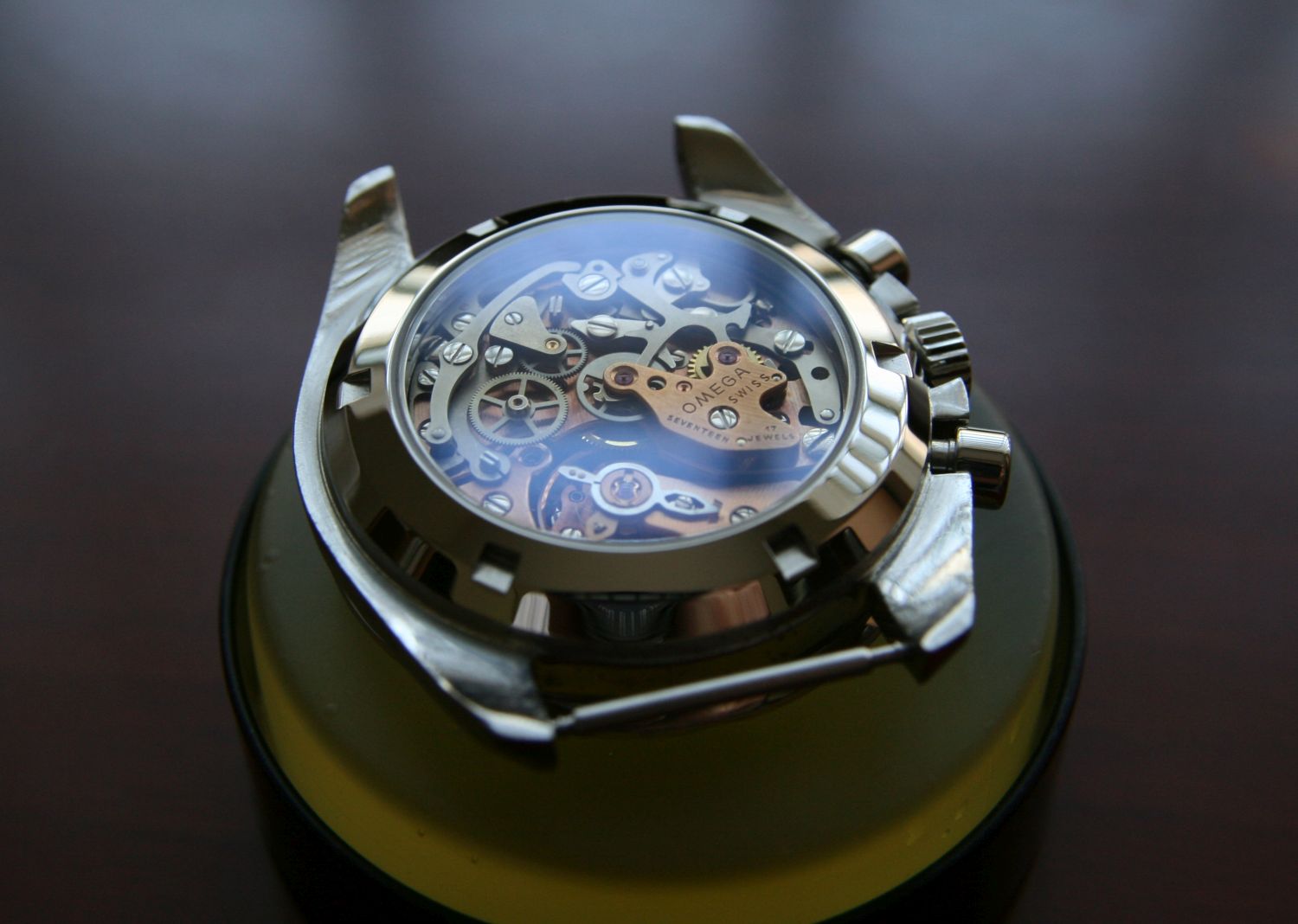

Those are beautiful pix, especially the additional dimensionality of the movement. Increasingly tempted to go that route. Is there any meaningful difference in thickness with the addition of the sapphire caseback?

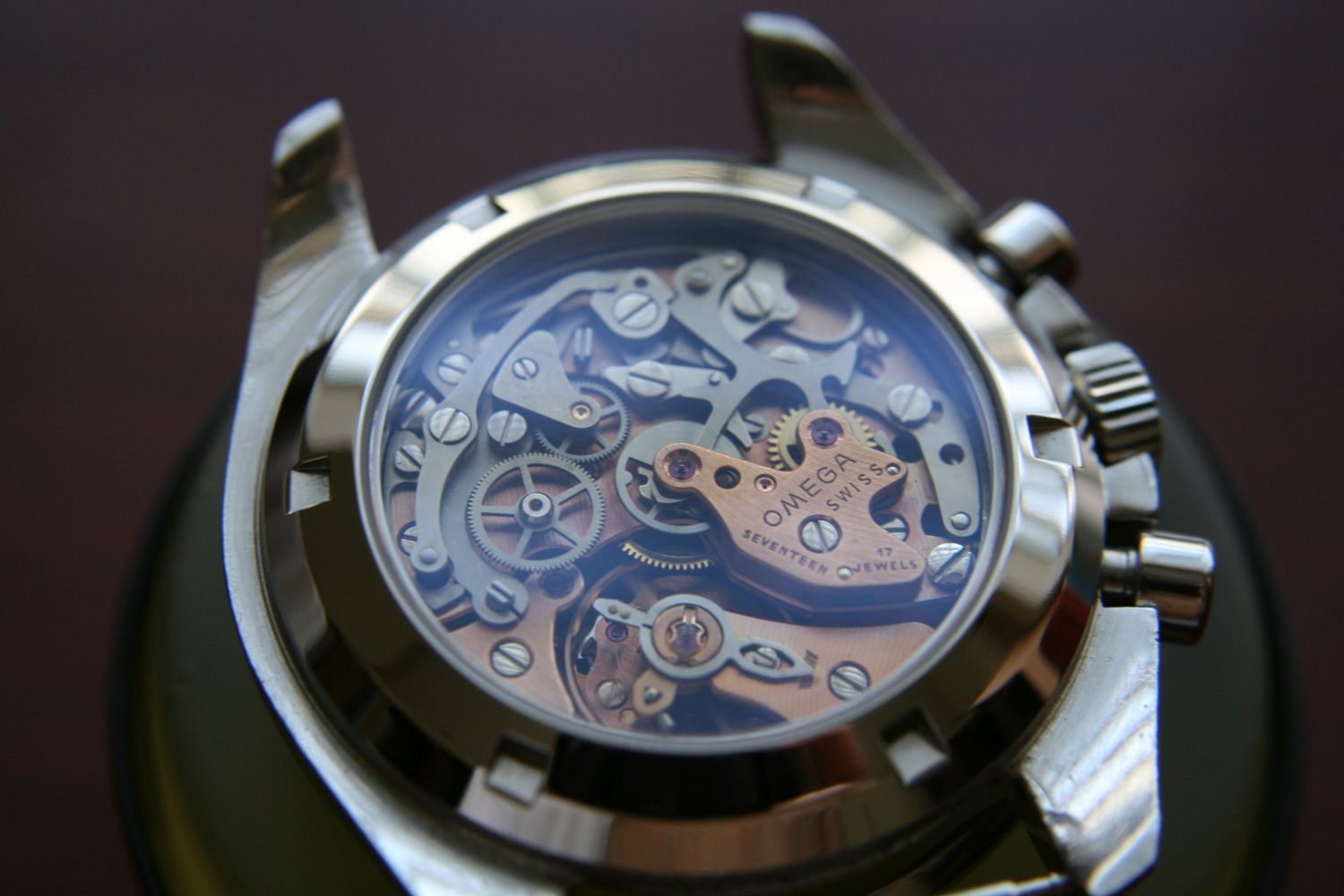

May I ask why you don't have rodium/ plated finishing in all your 1861 movement? (like other pictures above).
Edit, didn't realize it isn't a FOIS.

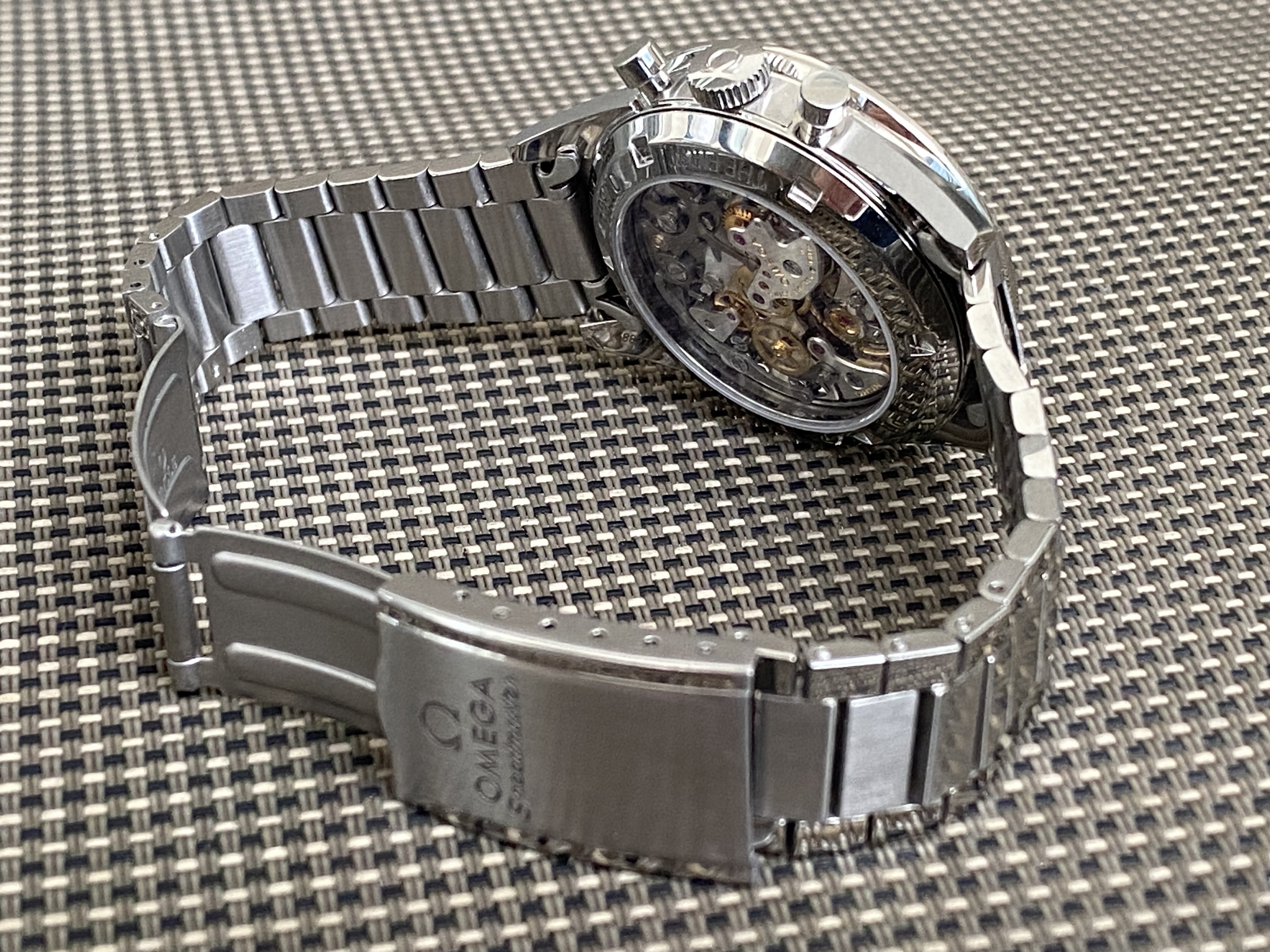

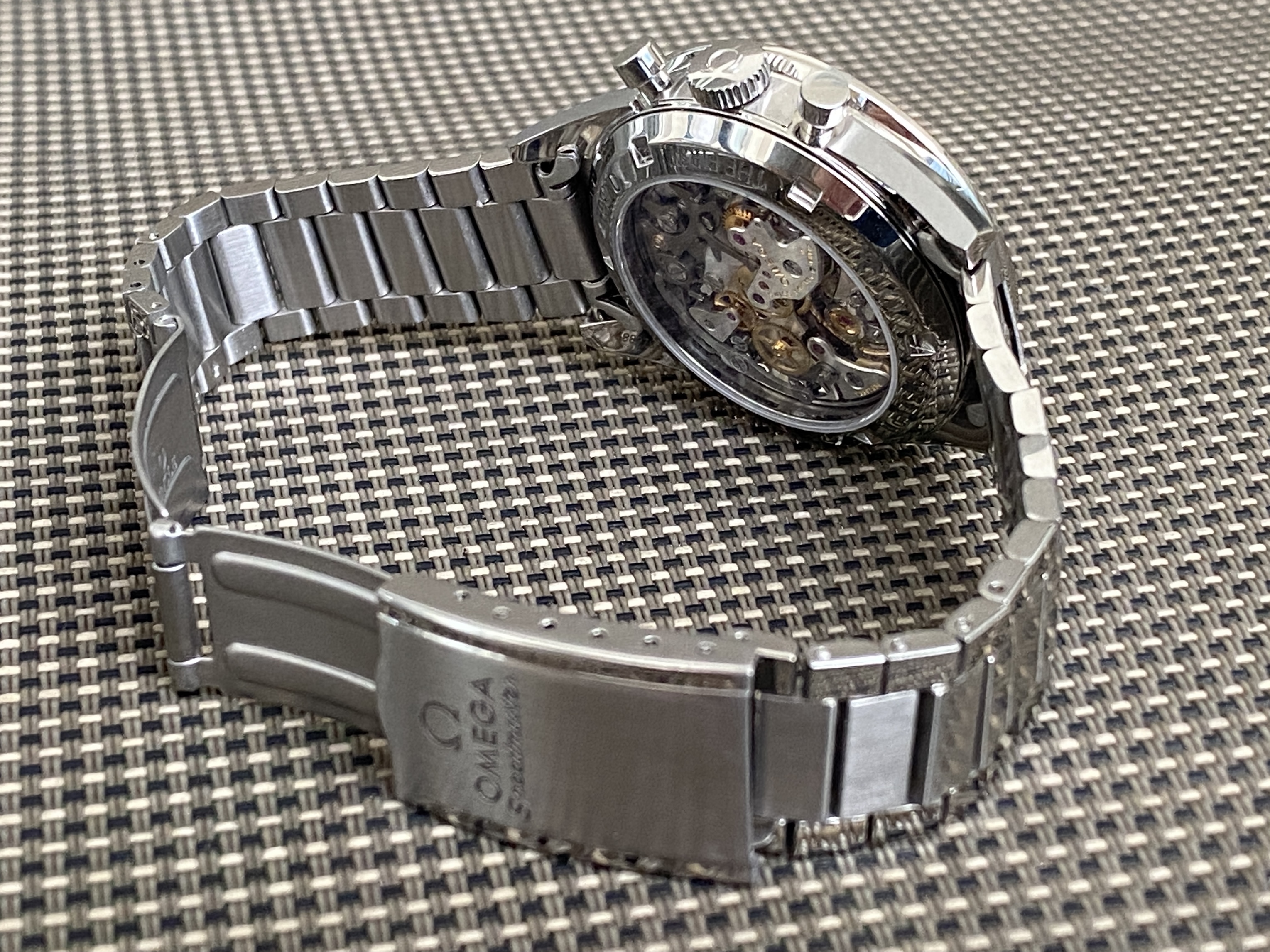

Spiralwinder delivers sapphire casebacks with proper spacers for hassle-free mounting at the back of FOIS. Here's mine (with custom laser engraving).
1,679
5,315

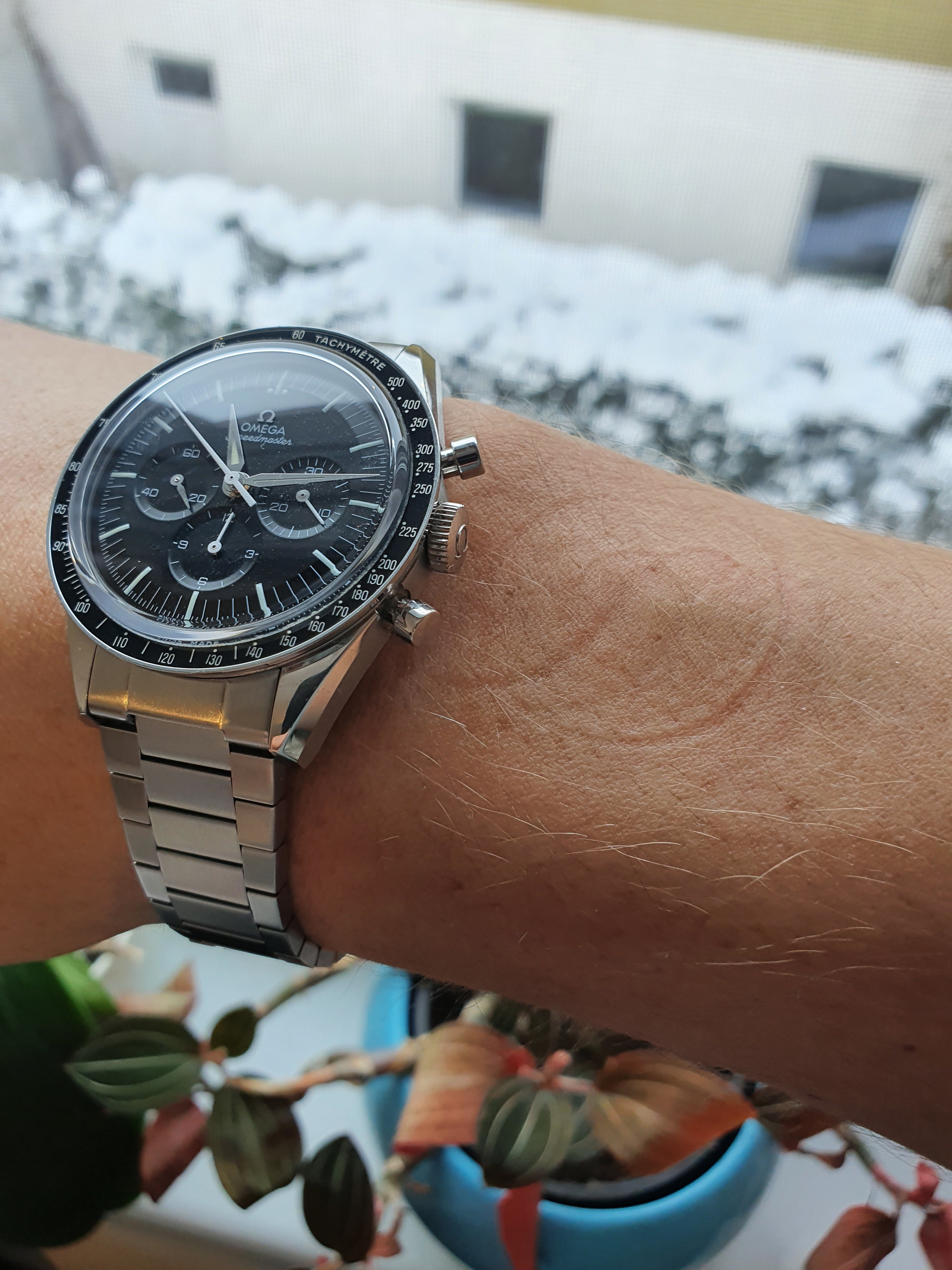

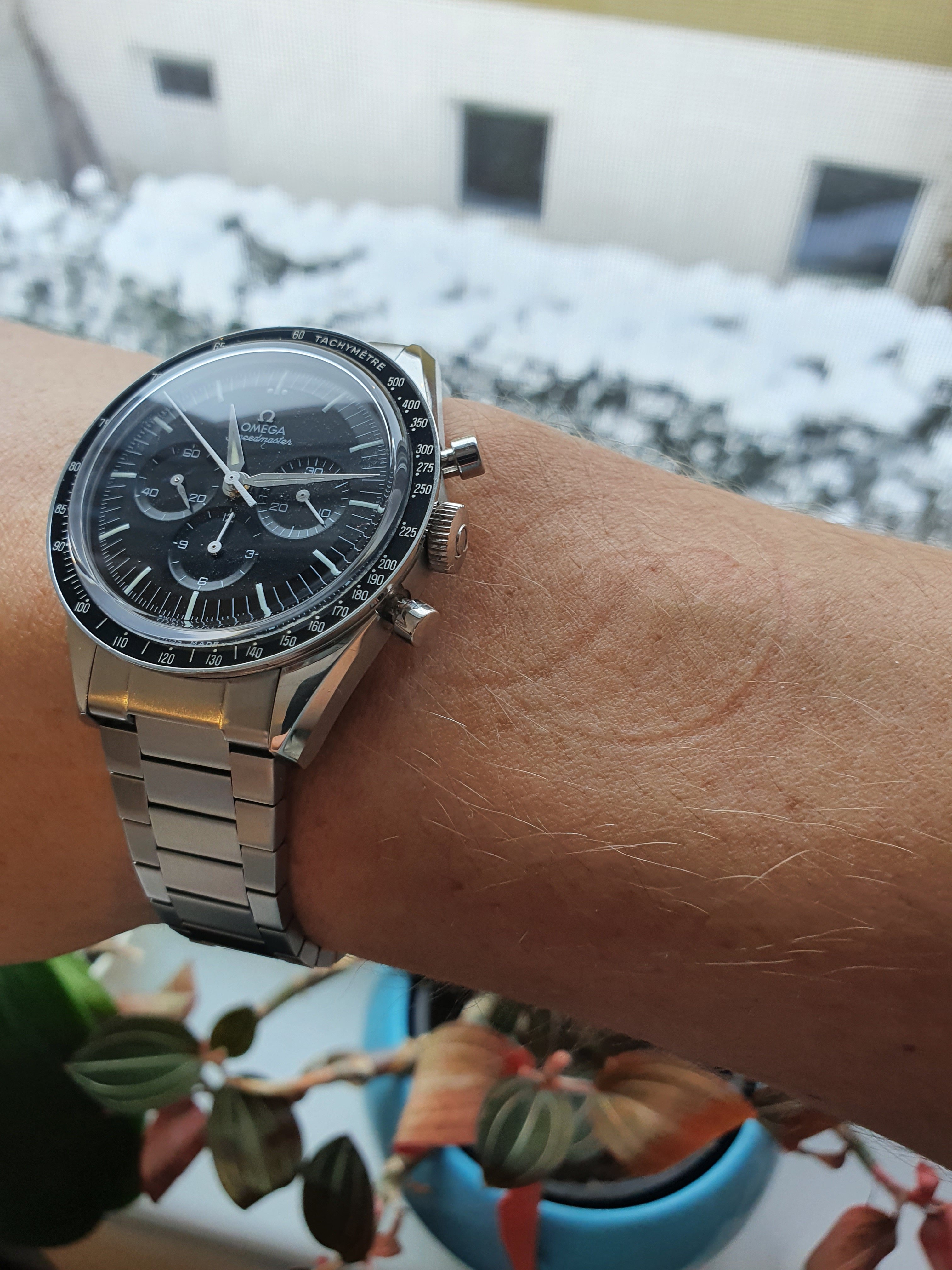

I like how your watch turned out. I dont like the original caseback as it leaves an imprint on my arm and is not so comfortable for me. It seems your caseback would be a good solution. Have you had your watch pressure tested?
