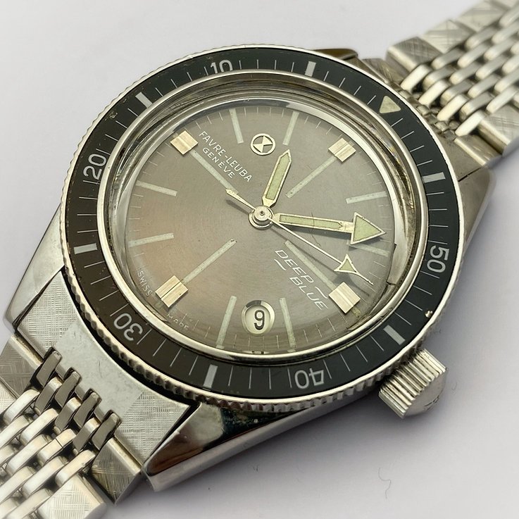

Here's the bracelet that I'm questioning...was this ever sold on the Deep Blue?
Certainly not with those end-pieces! 馃榿
And I am skeptical that they were ever original to the model.
460
1,108

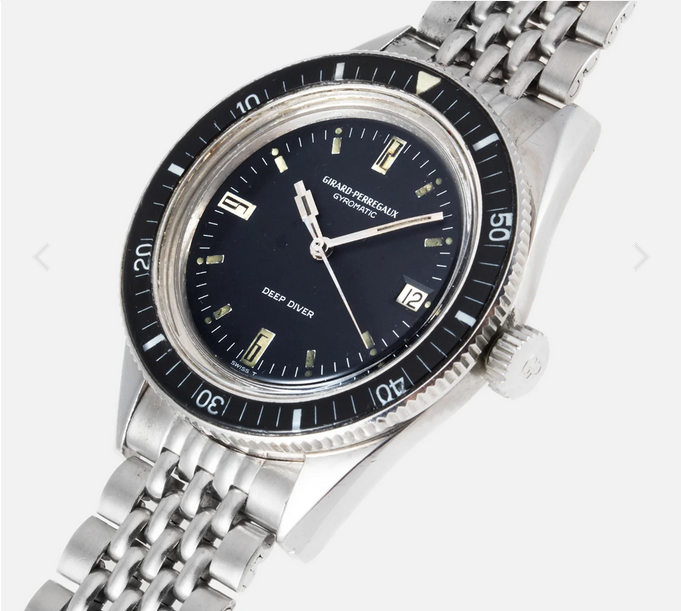

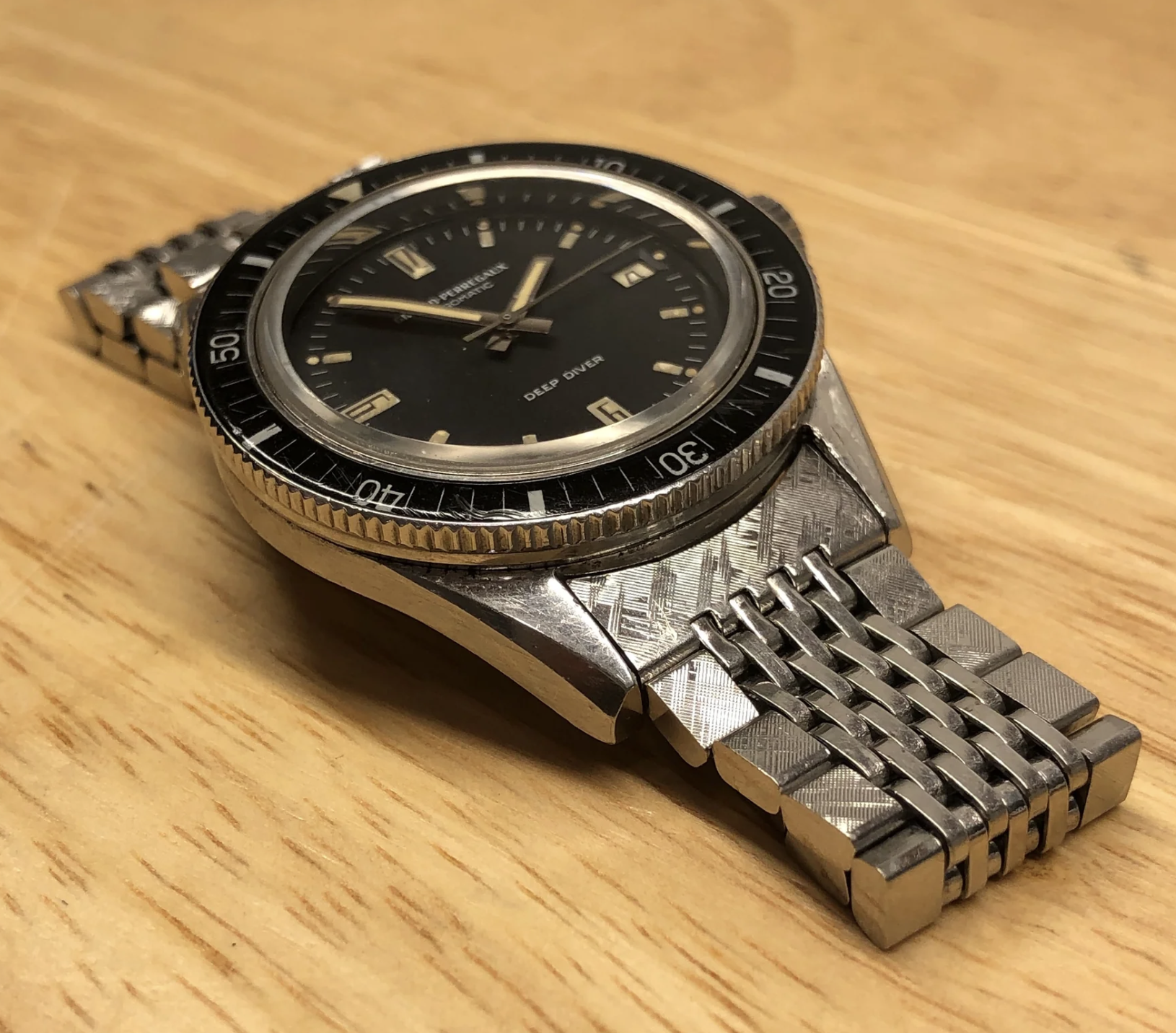

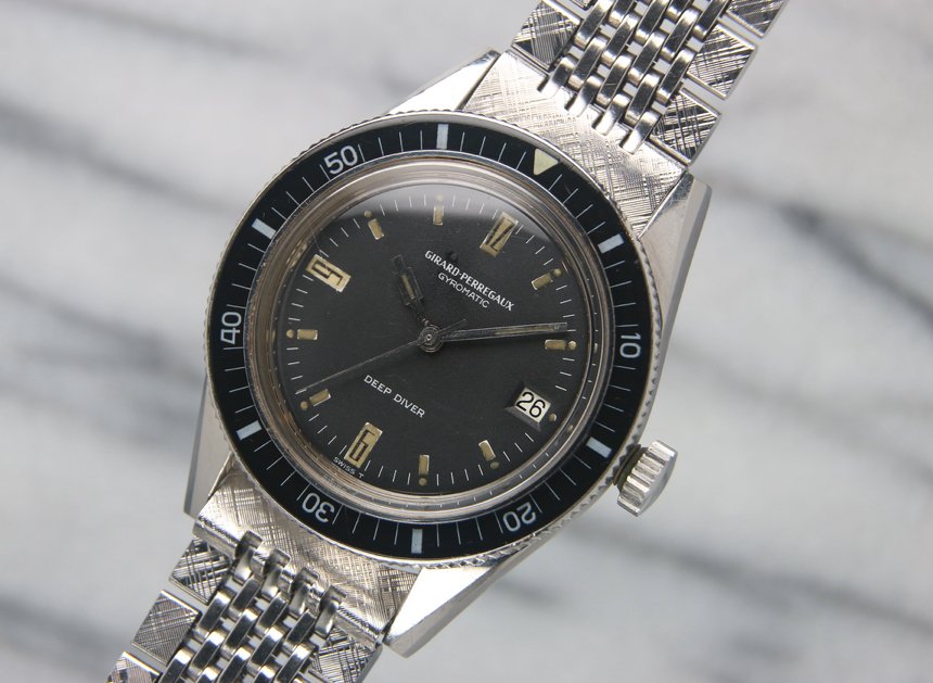

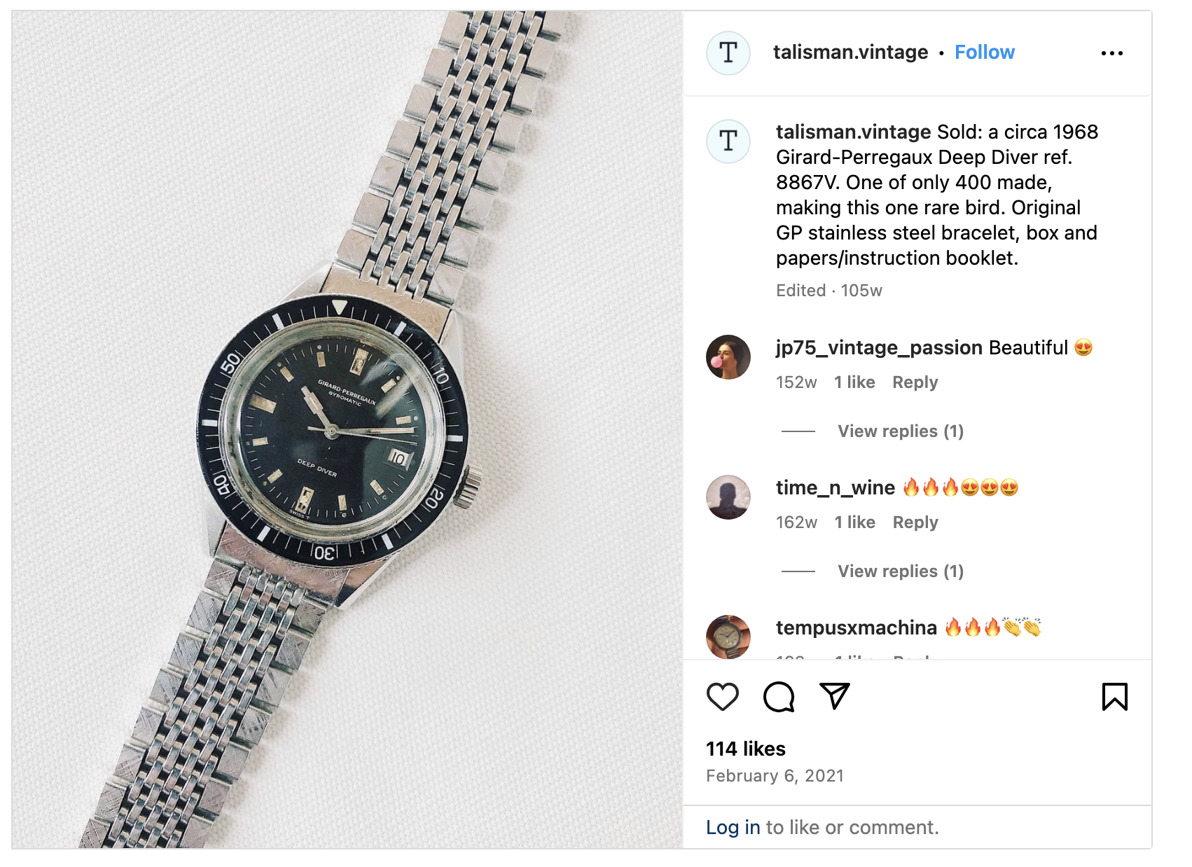

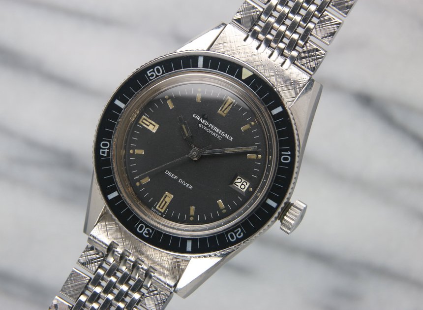

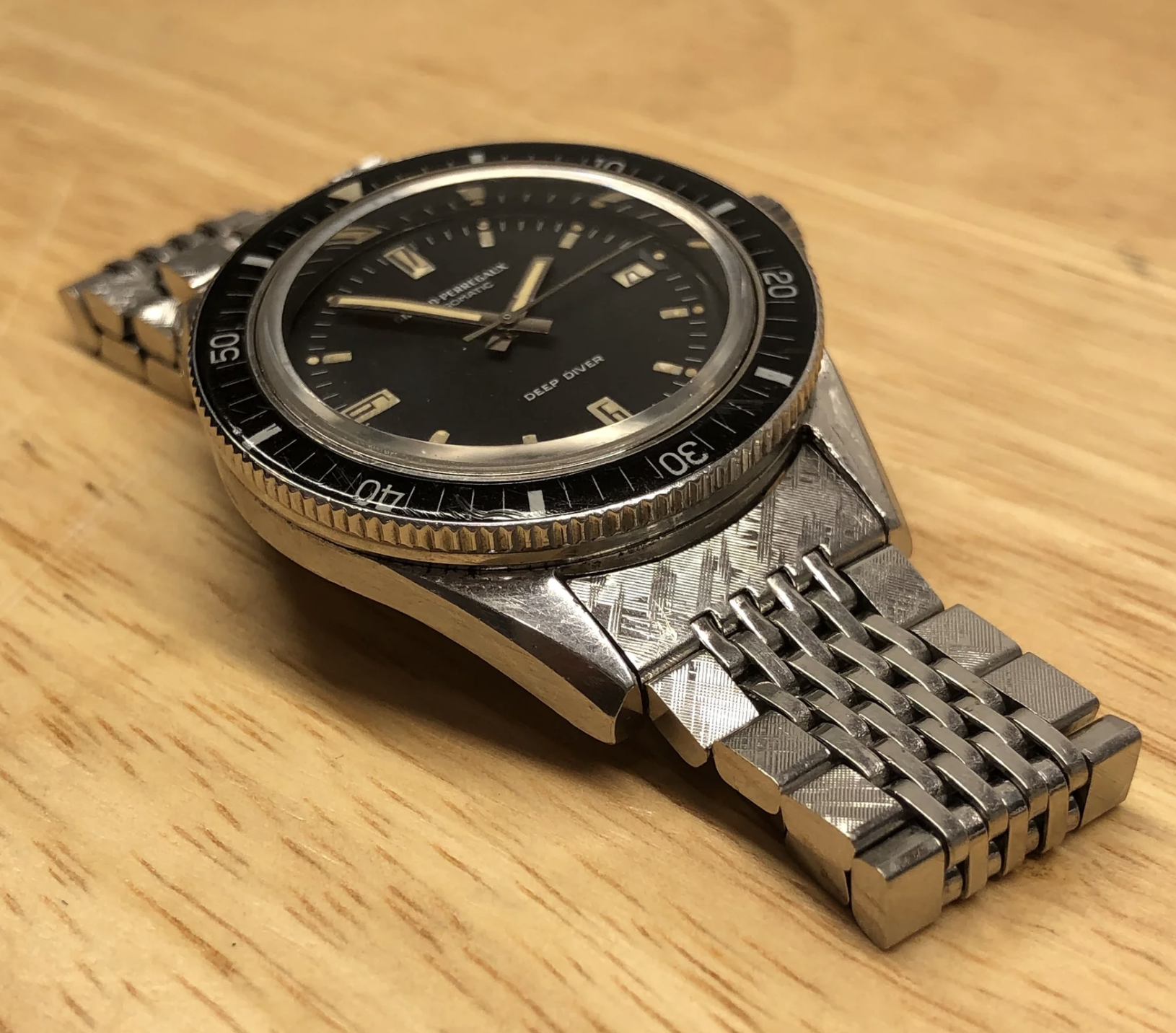

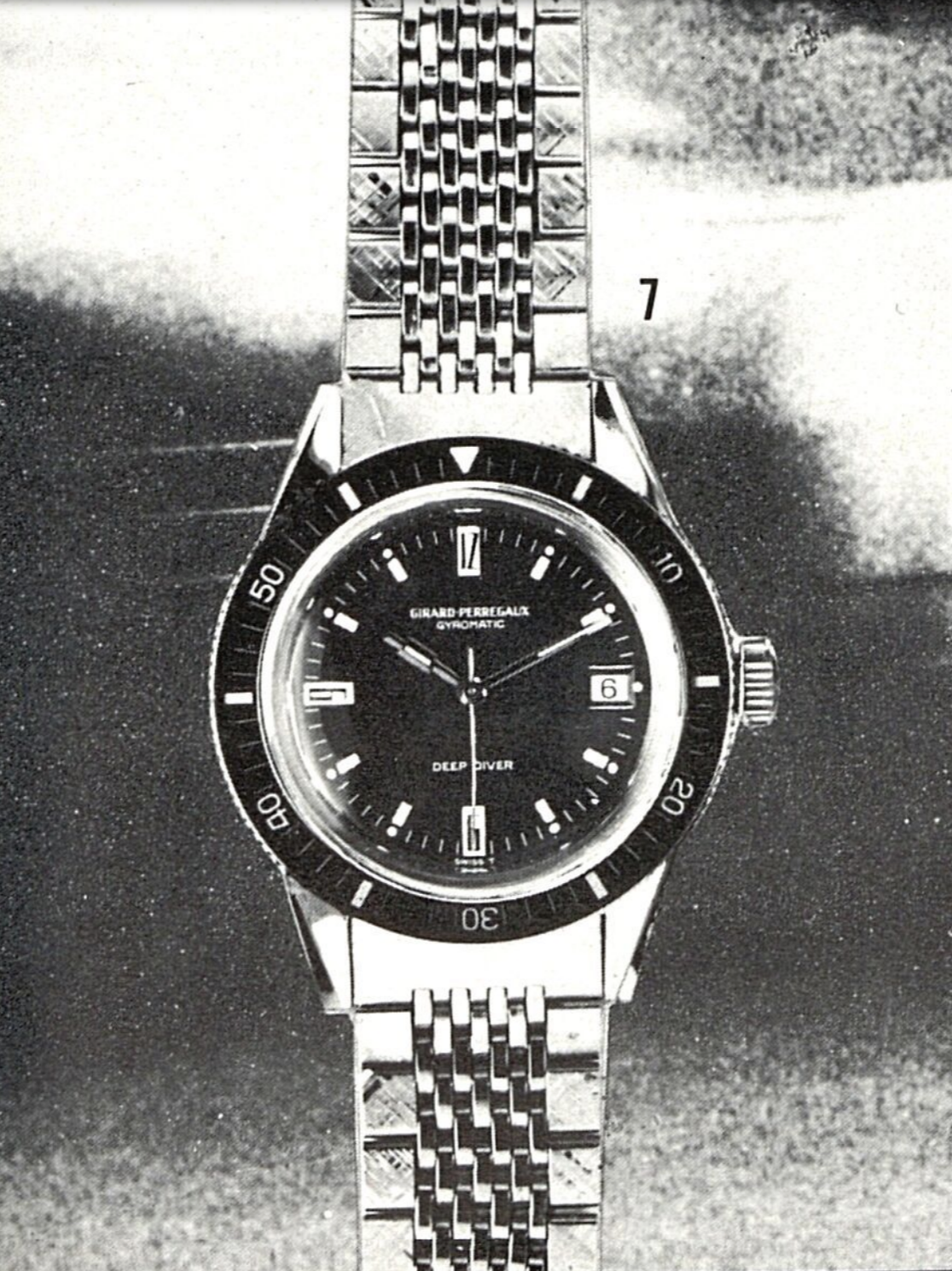

I have seen a handful of them with this style of bracelet, hence my question. They are identical to the bracelet found on the GP Deep Diver (photo below)...which also uses the same case as the Deep Blue. Coincidence? Aftermarket addition? Or, perhaps an original bracelet found on the latter iteration of the Deep Blues?
Here's the GP...same case, same bracelet.
8,293
29,371
I don't consider those GP bracelets to be relevant. And in fact, I am skeptical that they were ever issued with the Deep Diver models. Interestingly, though, the bracelet on this ref. 7897 appears quite similar to the original Deep Blue bracelet...
Why though?

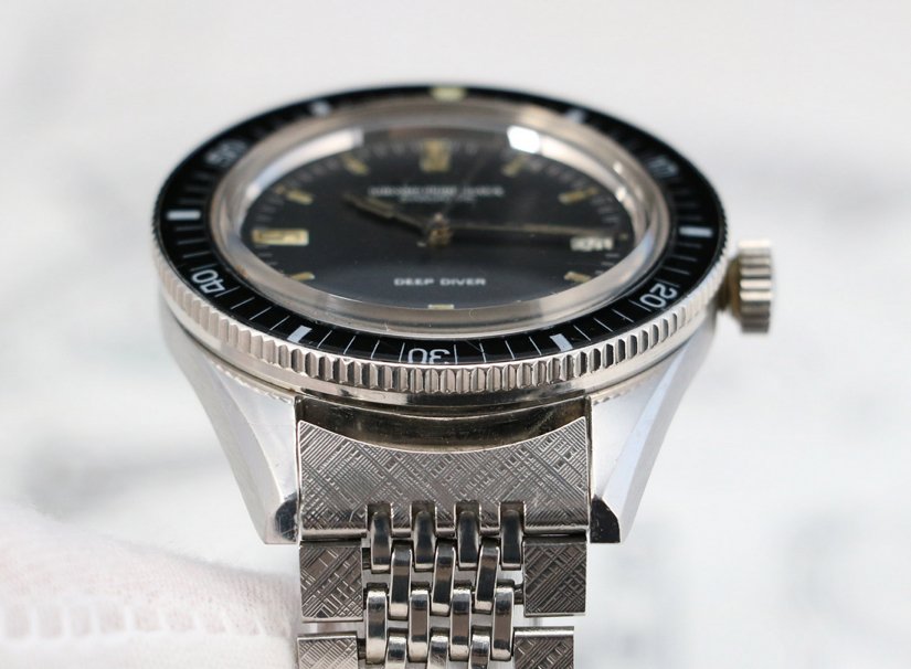

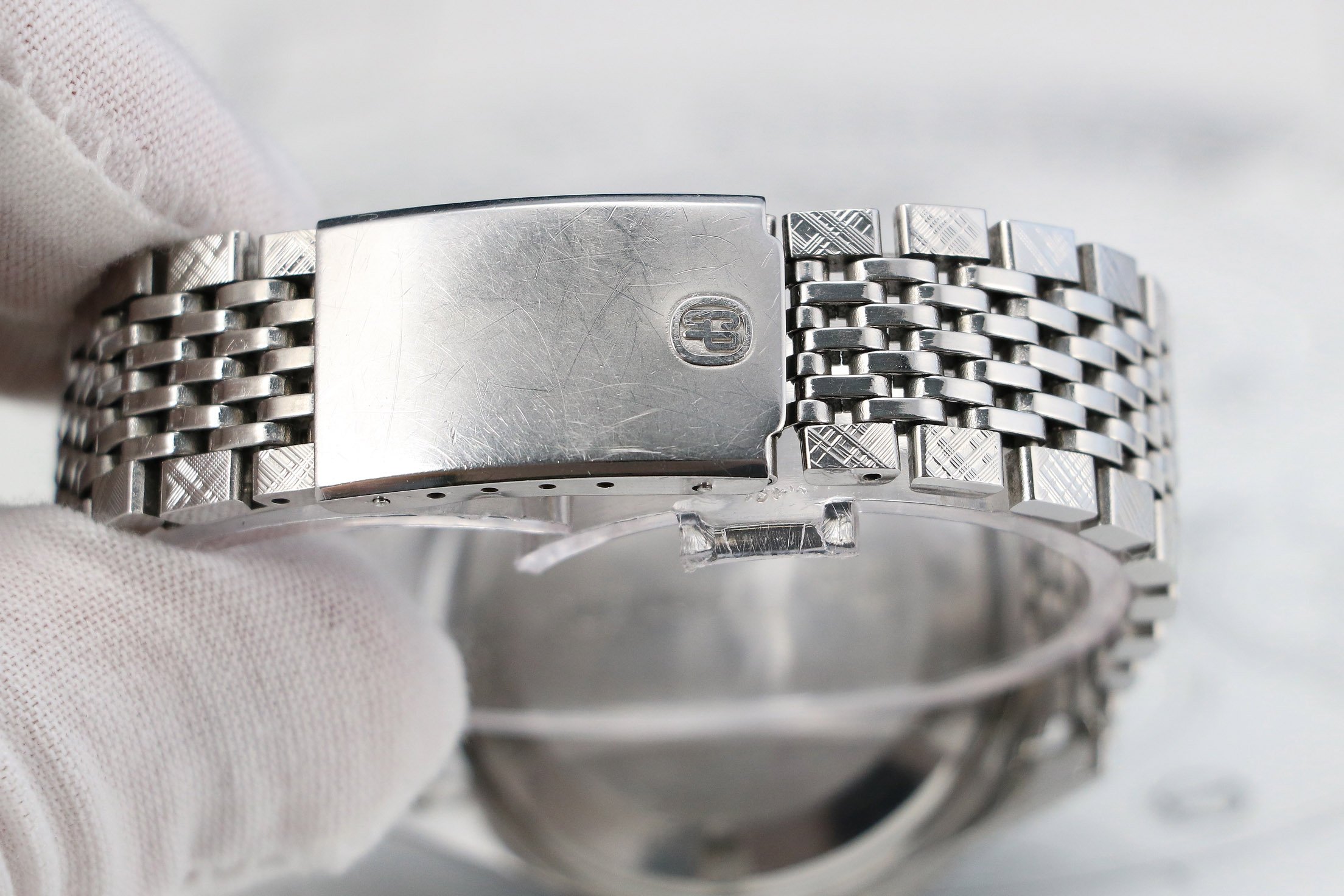

I'm not trying to argue with you because I have no proof other than photos these watches that show the same bracelet from multiple different people. But, I'm skeptical that these all happen to be later replacements. Unless, the watches that have them were bought on a strap and the owner went to FL later and added a bracelet.
I don't know the exact circulation, but there are a handful of examples (members of OF, actually) of the Deep Blue with this textured bracelet as well as a couple (by my count) GP Deep Divers that have sold in the last few years (Stetz, S. Song, Hashtag) with the same bracelet.

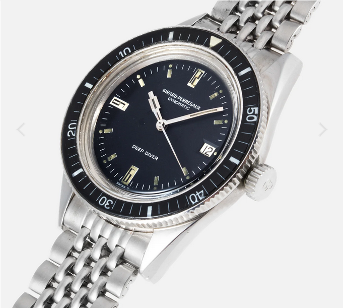

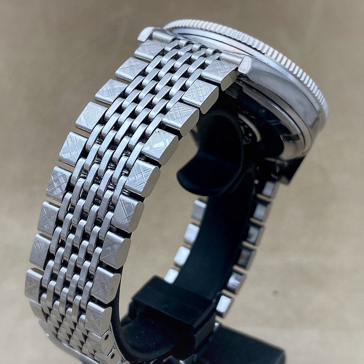

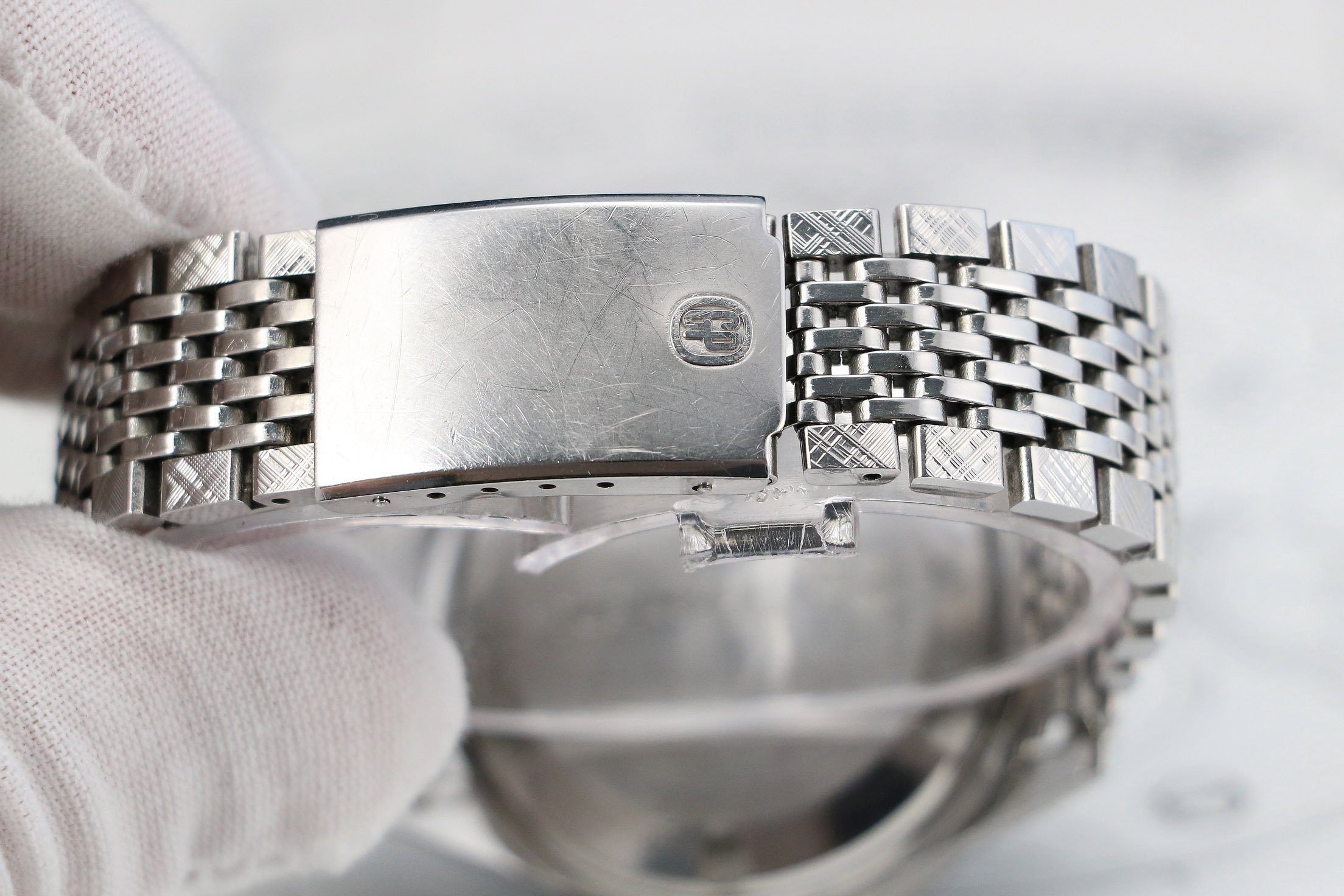

First, I am skeptical precisely because the evidence that you have thus far produced to support your hypothesis is so weak.

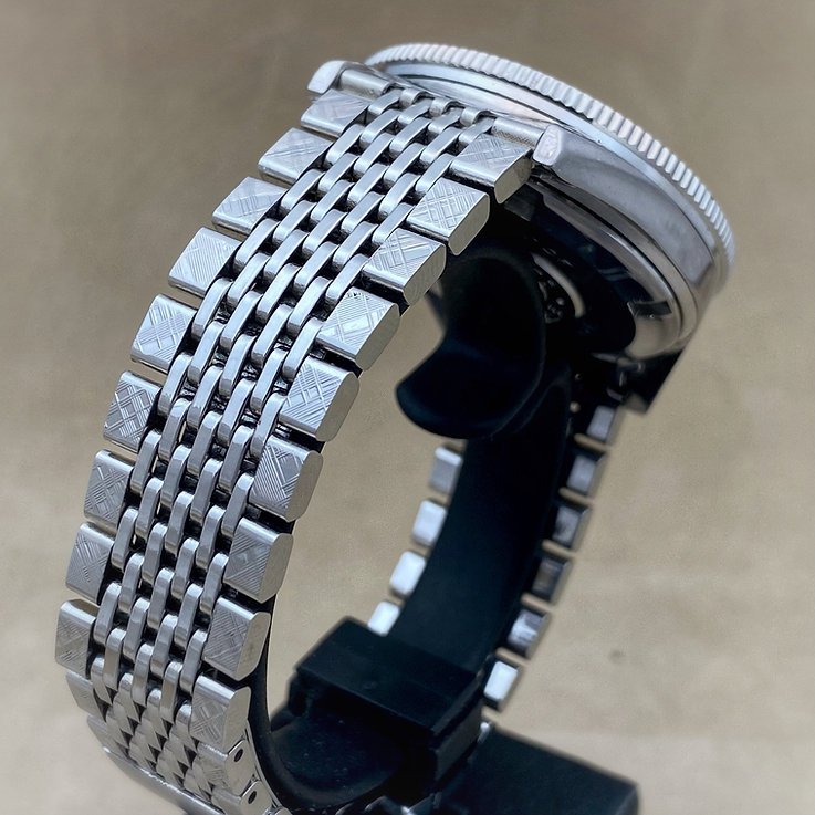

The first one below, from Song, is a standard BOR bracelet that doesn't even appear to fit very well. The second and third, from the Stetz example, and which you posted previously, is a style that is dissonant with a tool watch such as these, and also appear to be a poor fit.
Of course some dealers prefer to put bracelets, even if unoriginal, on such watches, which is yet another cause for skepticism.
You have produced no evidence from either GP or F-L material that such bracelets were ever employed, and your anecdotal evidence does not, in my view, come close to being compelling.
I'll keep an open mind, but would need to see much more to be convinced.

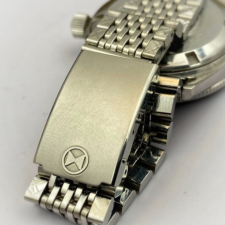

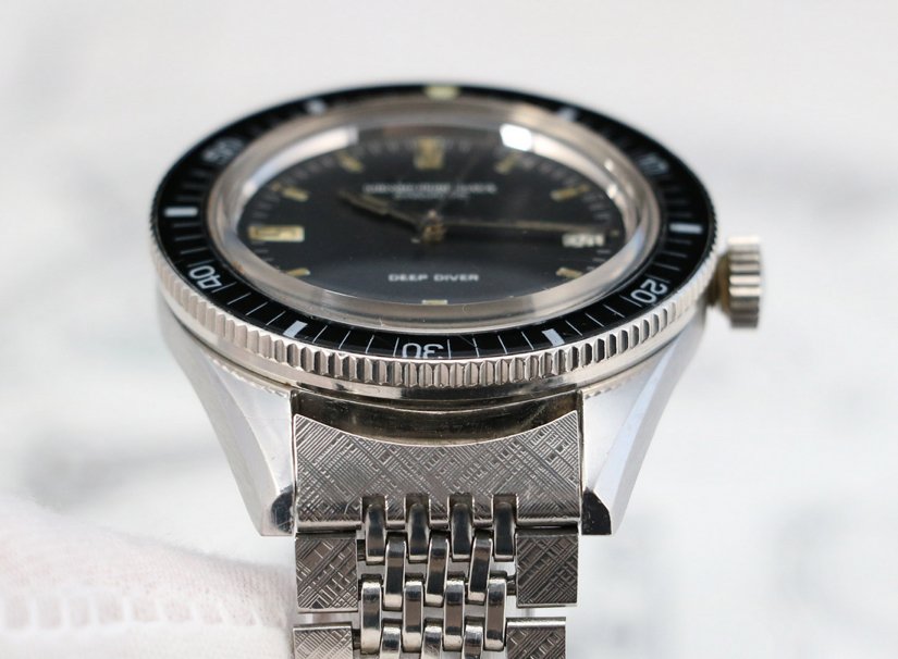

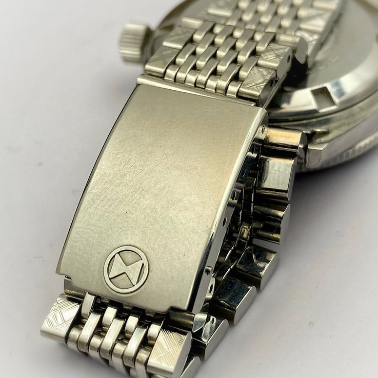

Human error mentioning S. Song. I hope you can see past that. Here's another example with the same bracelet. So you're telling me, that w/o any evidence of your own that you have founded skepticism? How is that argument any stronger?
I'm at least providing numerous examples to support the possibility. You have shown nothing of the contrary. I have no horse in this game, I no longer own my Deep Blue.
Well...We're talking about watches from the early 60's from brands that weren't known for their robust marketing. Just because it doesn't exist in advertising materials does not discount the possibility of truth.
Again, I invite you to present a stronger argument against...something more than it being dissonant with a tool watch of the era. It's no more dissonant than the bracelet that came on the Mark 1 Deep Blue...that itself is a fairly fancy bracelet for such a watch.
Update:
Here's a spread from issue #49 (1968) of Europa Star showing this exact bracelet on the GP.

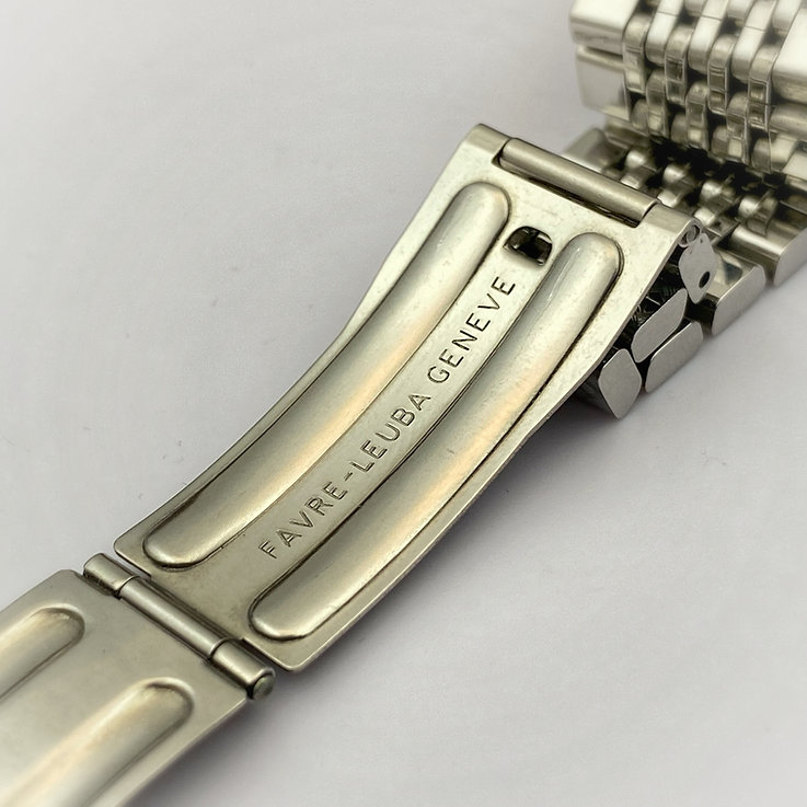

- a tiny number of examples shown with a particular style of bracelet, including (most recently) one testimonial of originality from a dealer

Your arrogance is palpable. See above. I'll re-post below. Europa Star issue 49 from 1968. Is this convincing enough for you? Don't let your arrogance get in the way of your humility.

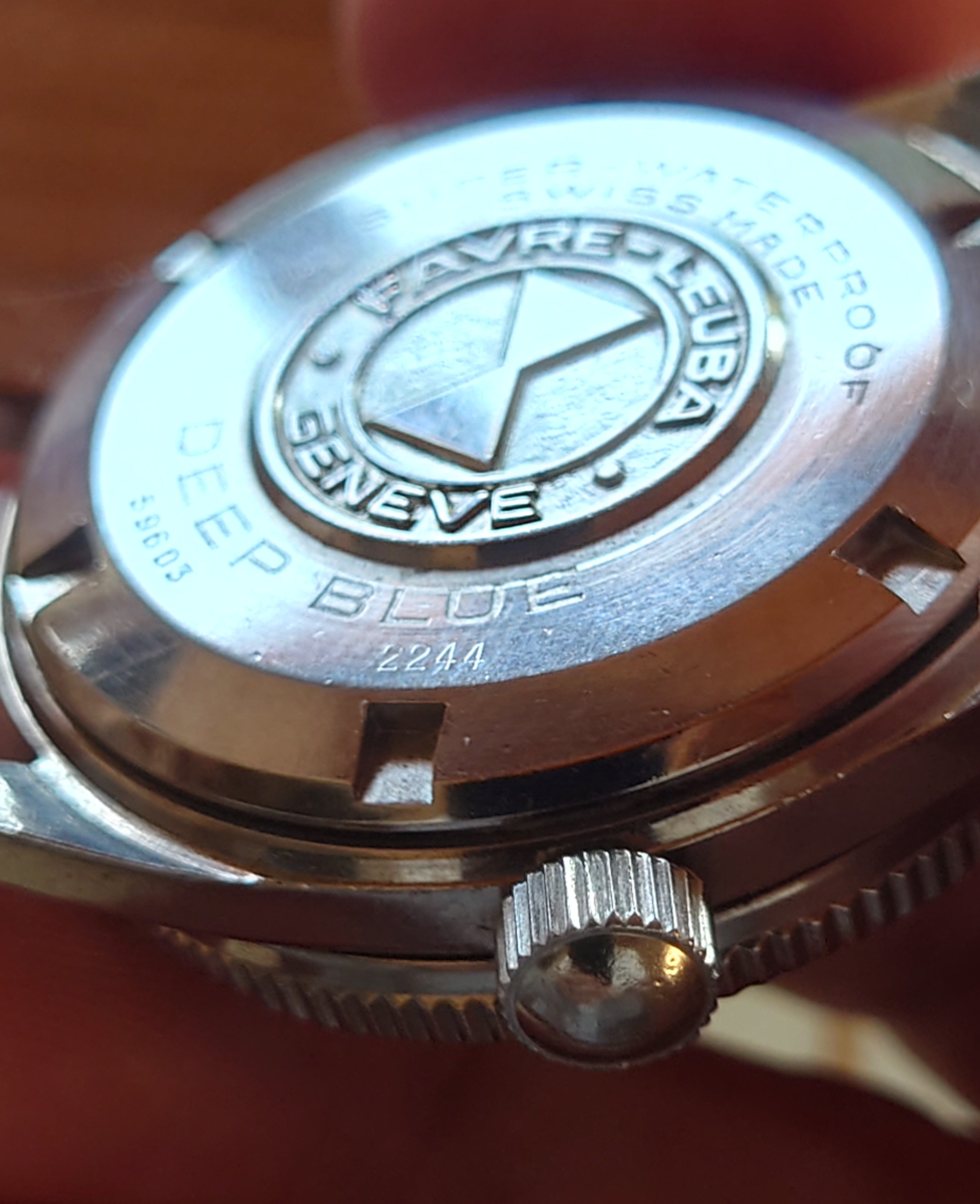

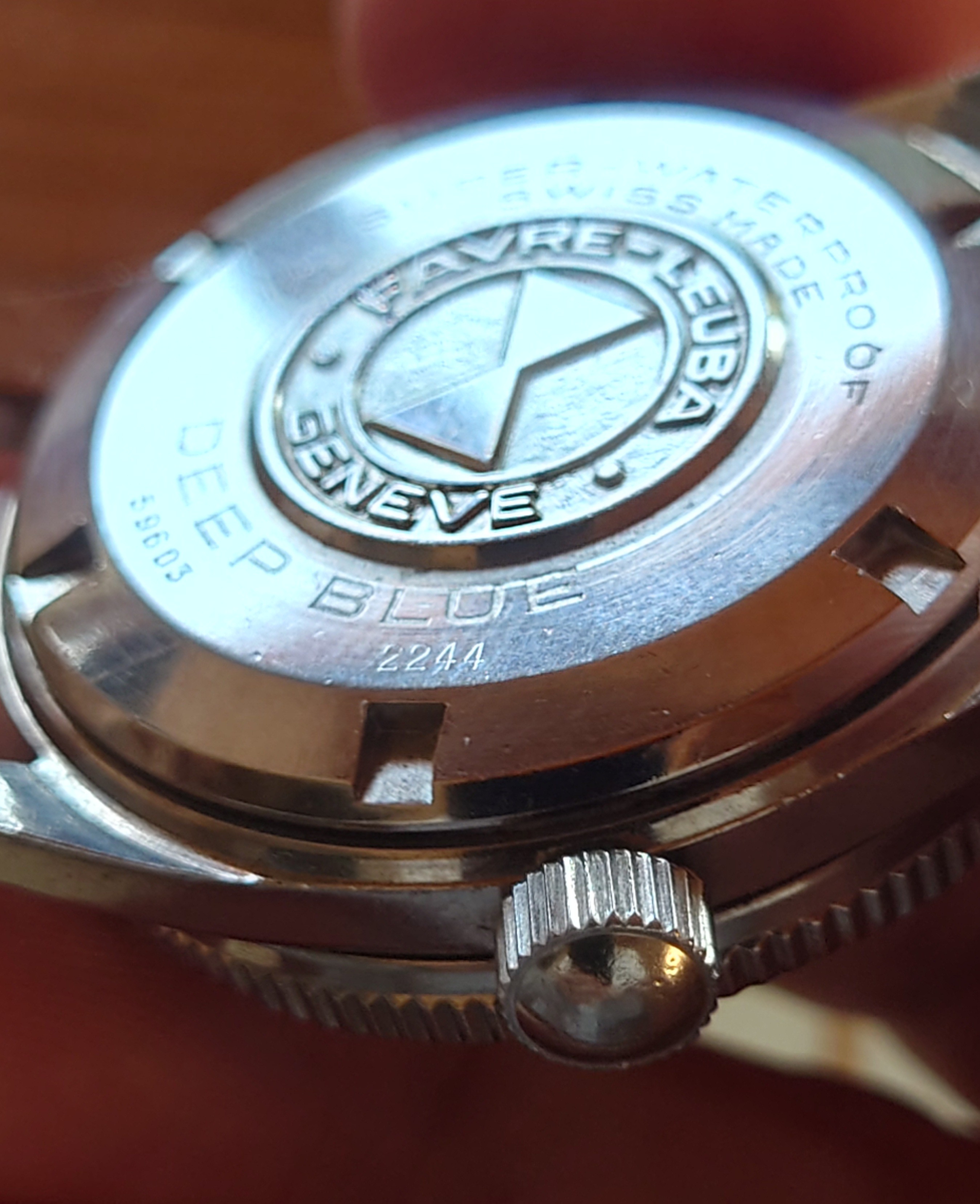

I am fascinated by the discussion on this thread. I stumbled upon it by chance while trying to find more information about my Deep Blue 59603. I have owned it since new in 1964 - 60 years. It still works and keeps time. Never been serviced.
It has a screw down chunky winder. Having spent plenty of time using it in the sea, it never allowed any ingress of water.
It never had a metal strap, but a black rubber strap with a metal buckle. The rubber strap had a Fabre Leuba logo. Never been able to find a replacement.
Serial number 2244.

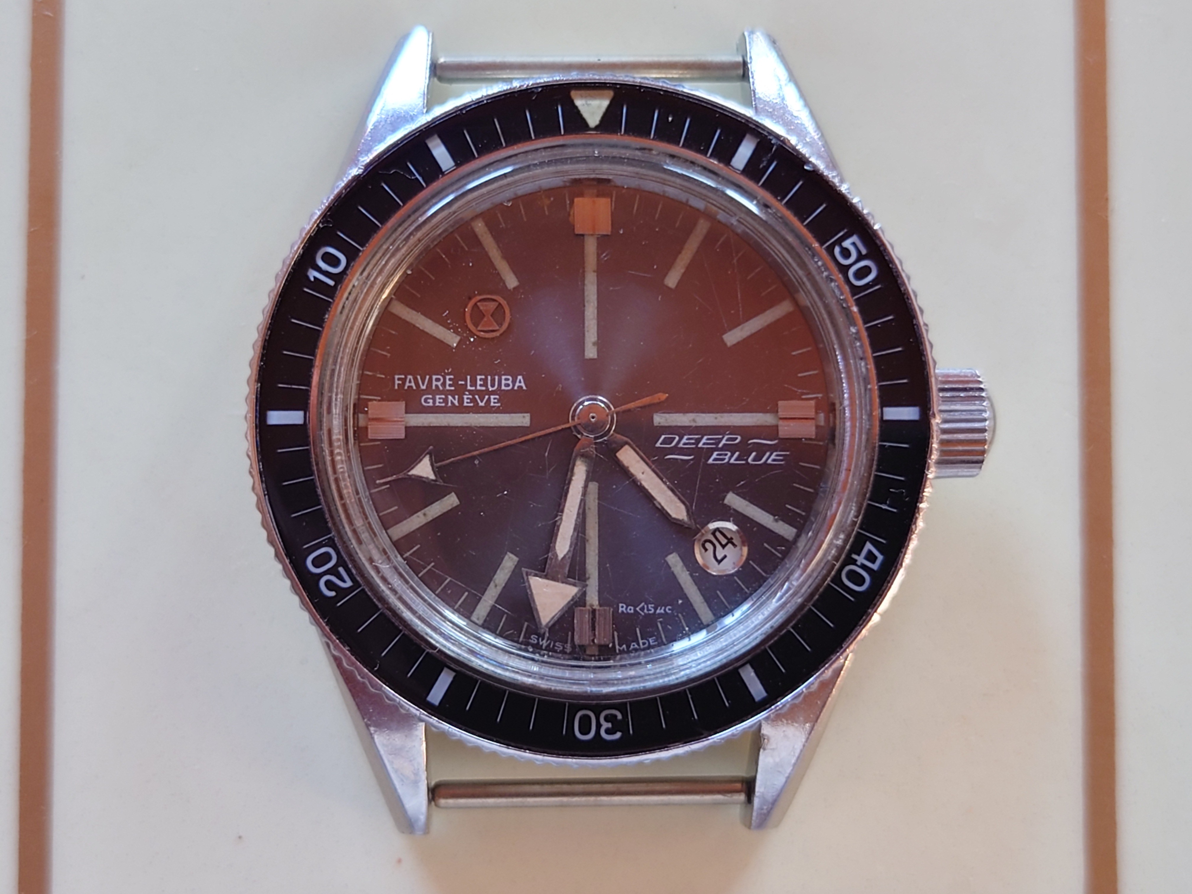

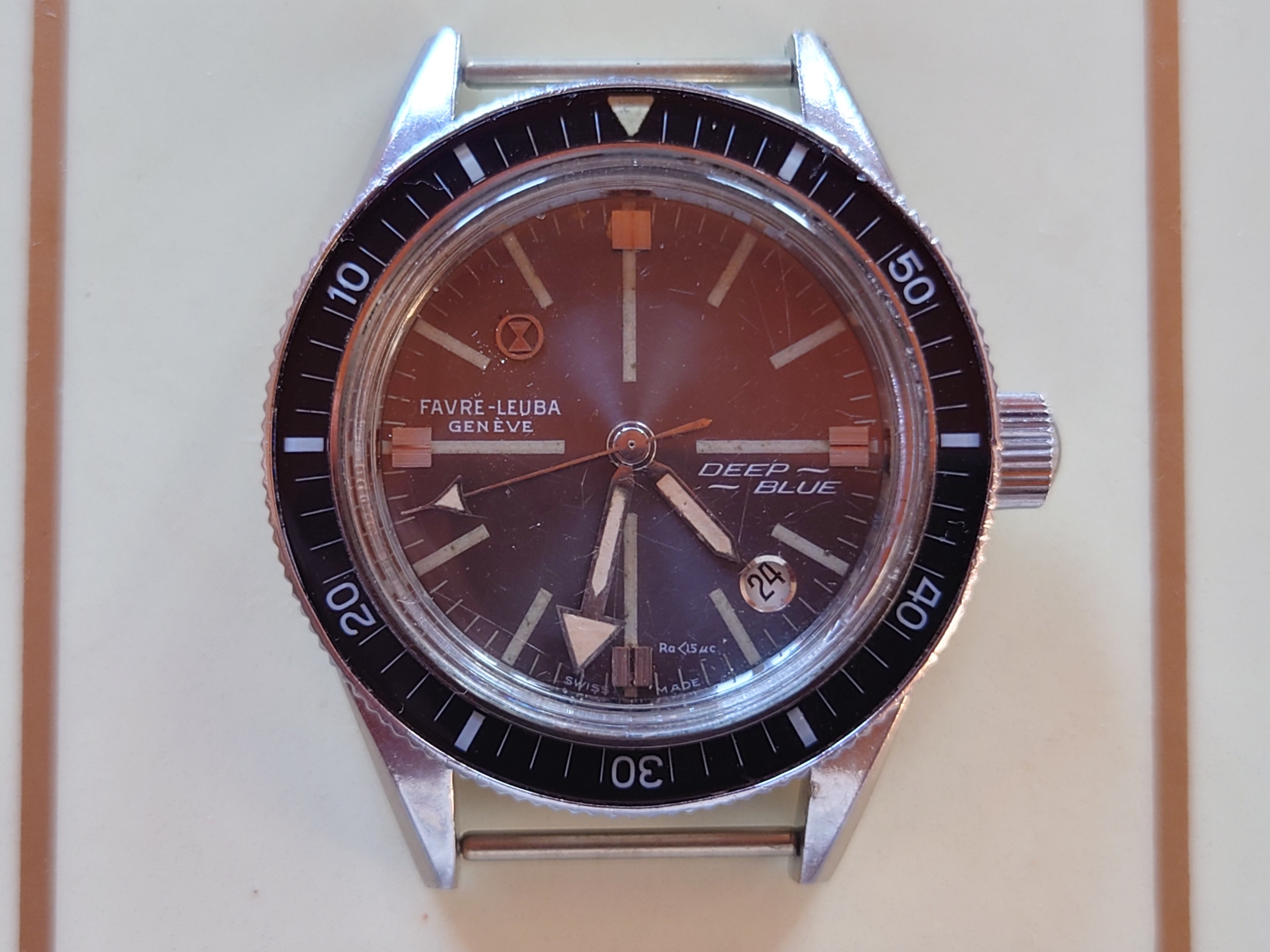

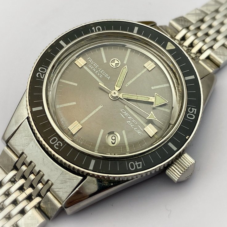

Here is my odd ball and a bracelet that I might put on mine. Been told the dial legit. The dial grew on me thought about getting the dial refinished but it it's a rare dial I might as well keep it that way. This one also has a none screw down crown.
3
Greetings from year 2026. 馃槉 Here's my recently aquired Deep Blue 59603. Mk2. Serial No. 2522. I wonder is this grey dial original color? Looks very solid, not faded. So may be this model came with the grey dial too? The crown came with a logo but not hour glass. I don't know if this is original. It works perfectly.
