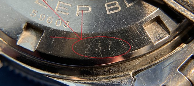

1. The earliest iteration has a metal count-up bezel, radium dial and non-screw down unsigned crown. I have one like this with serial number 237.

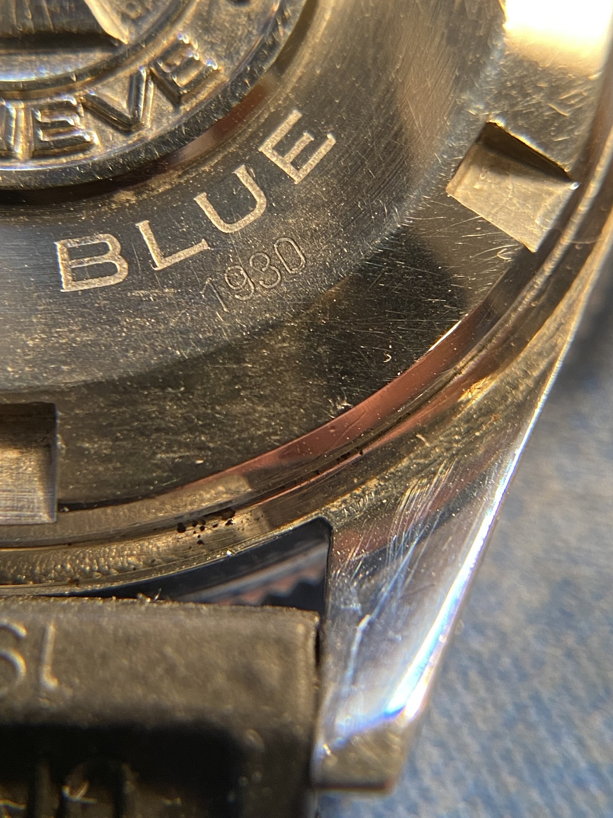

I have another early version that has plastic count-down bezel, radium dial and incorrect crown. And I am unsure whether it was originally fitted with a screw-down or non-screw-down crown. This one has serial 1930. I'm trying to figure out which crown version it started out with.

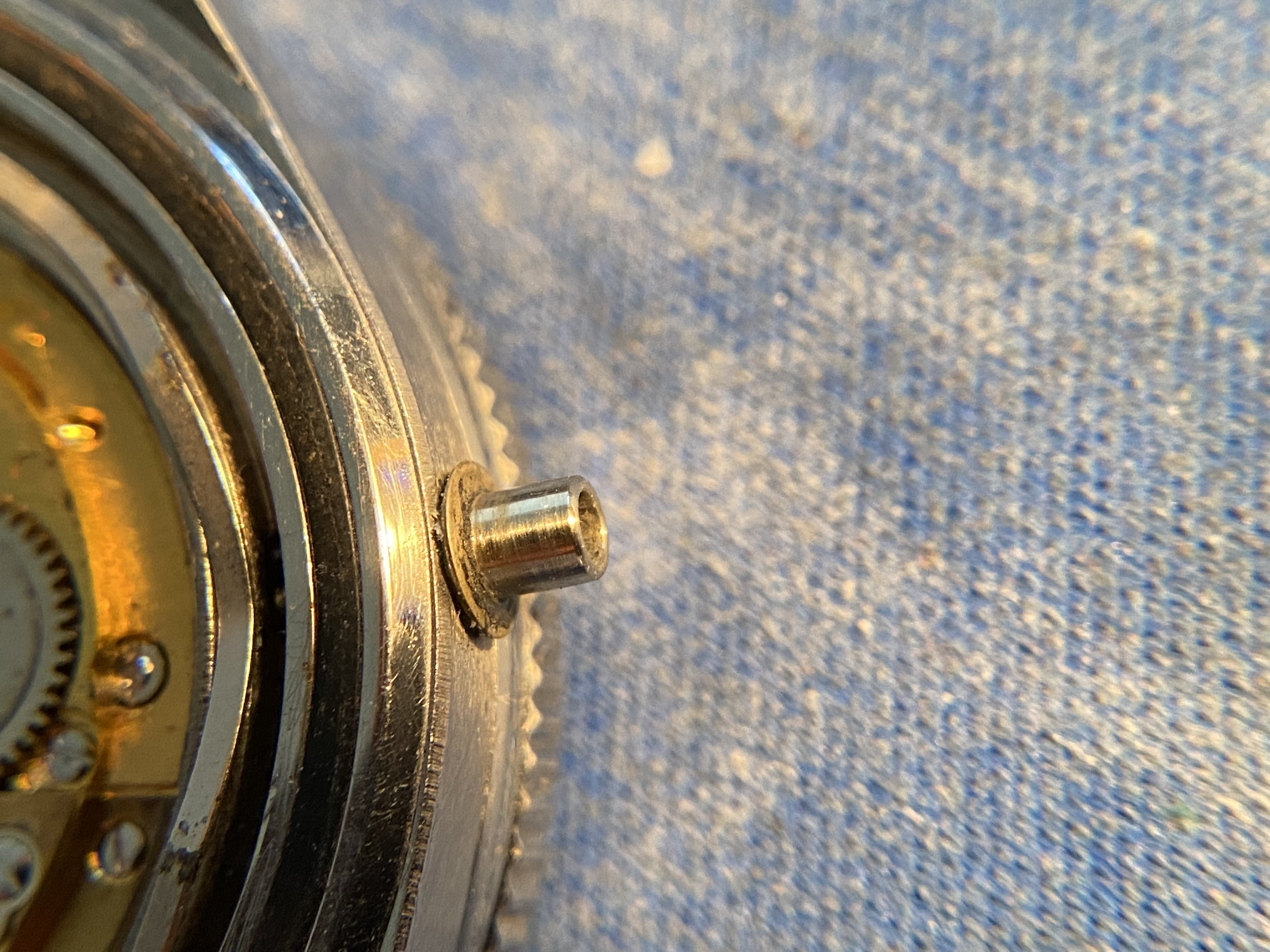

Serial 1930 (note incorrect case tube with small plate at base of midcase which allows incorrrect crown to be used without touching bezel. Question is did it start life with a screw-down or non-screw-down crown? I'd like to make it right someday.

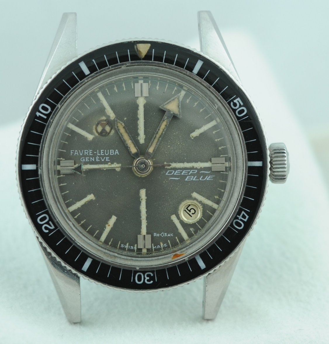

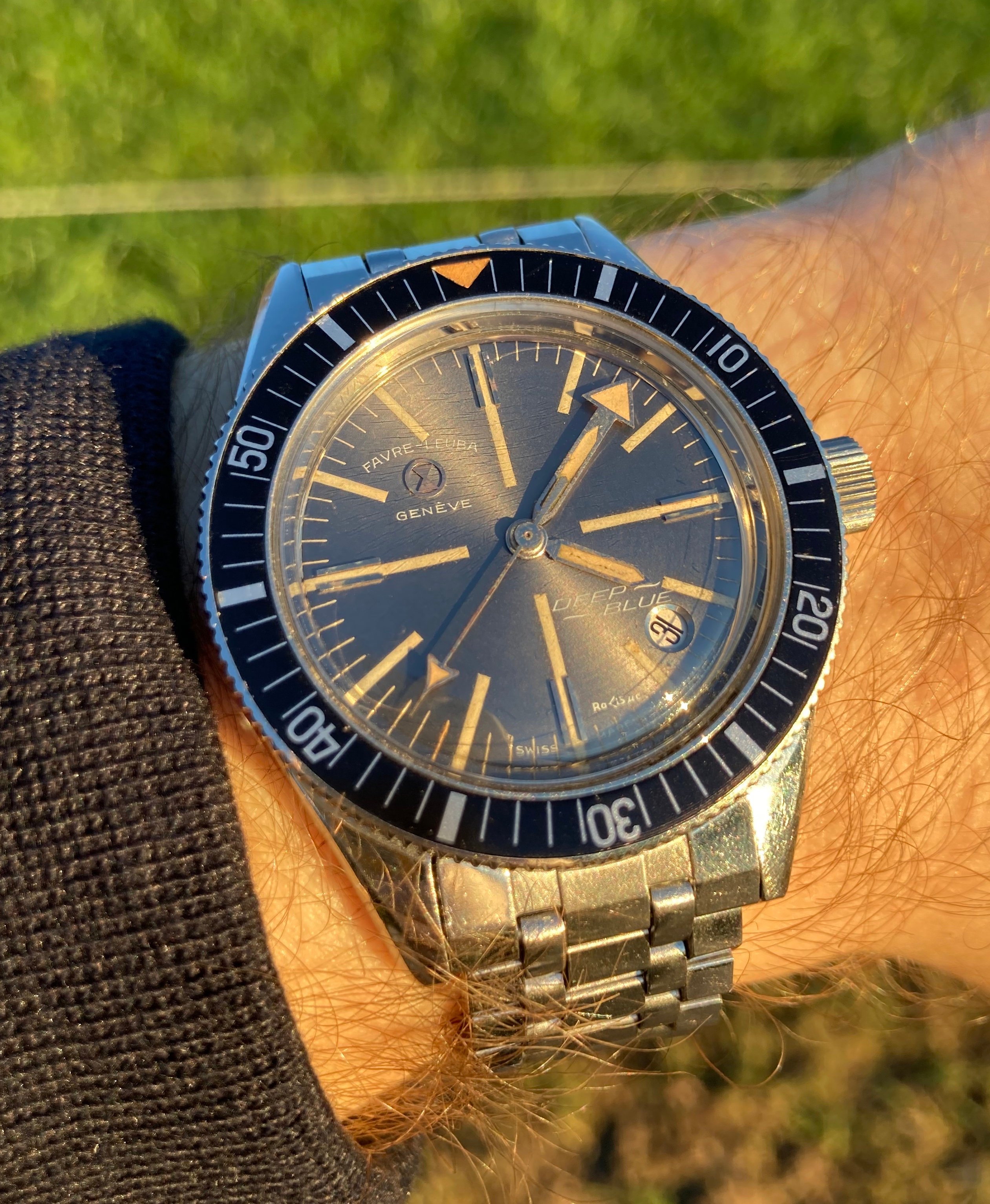

I believe that my Deep Blue is a Mk1. It has the count up bezel and an Mk1 dial (with some radium burn). The crown is not a screw down. Hope this helps

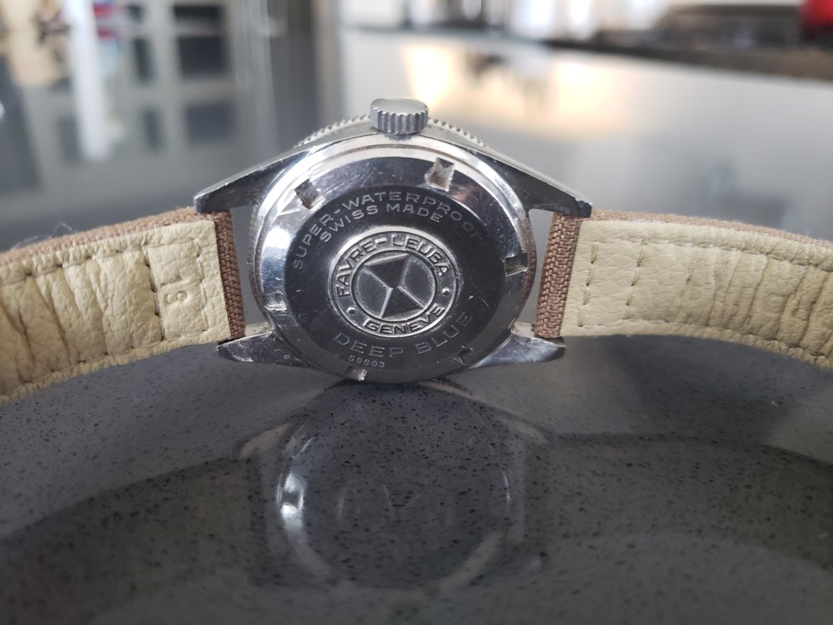

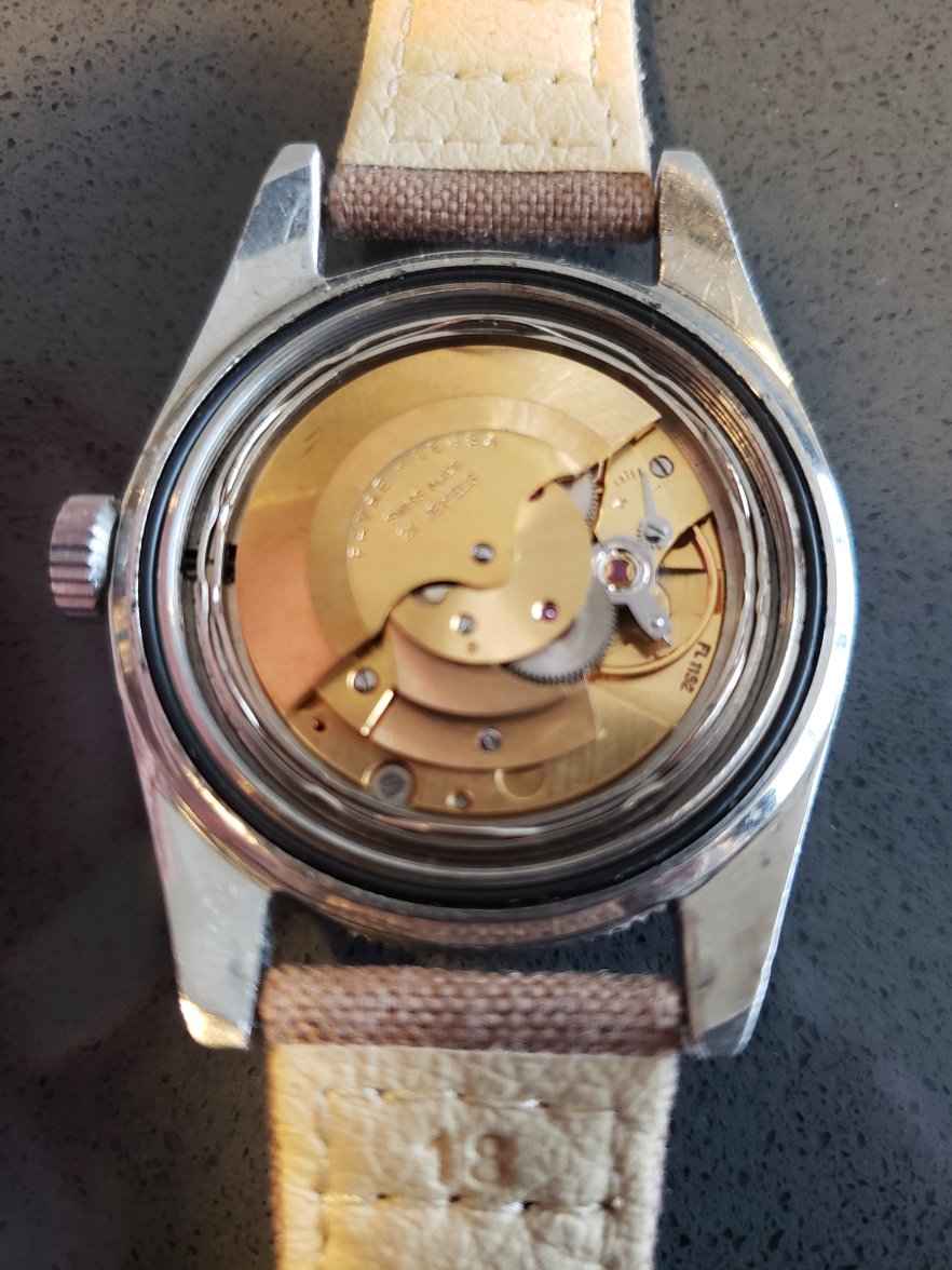

@tmw57 the only number on the case back is 59603 and it looks like the movement is FL 1152

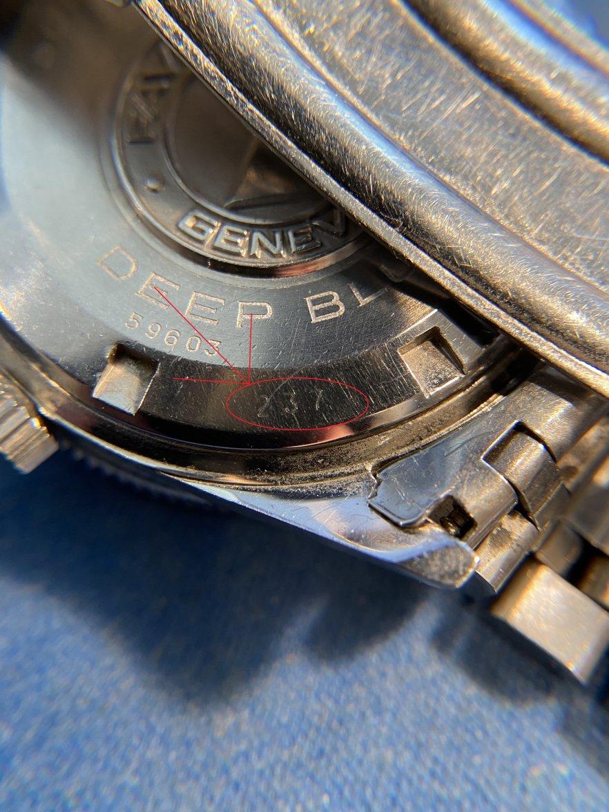

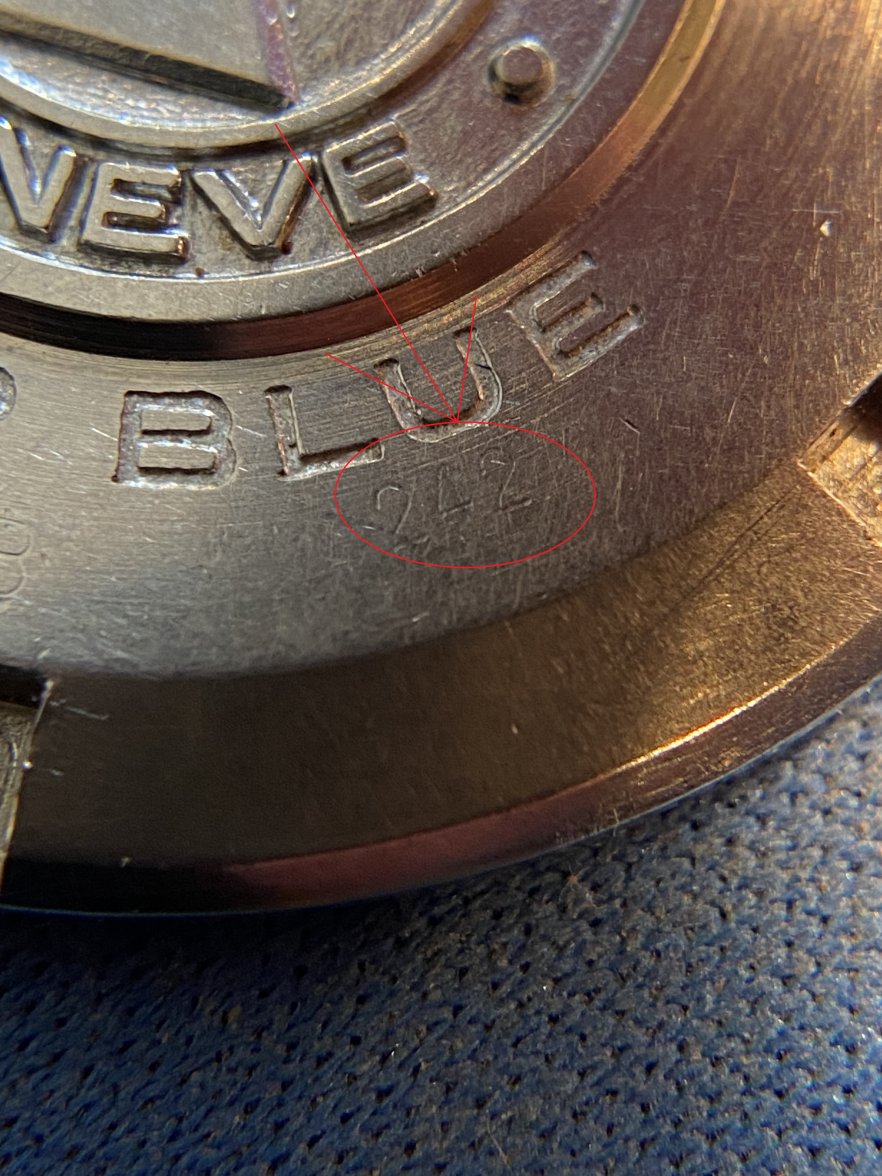

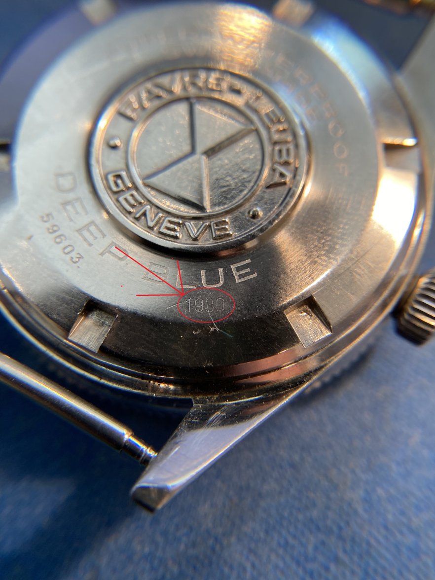

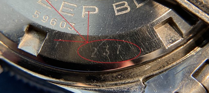

Hi J,
Thanks for the pics. And yes, the movement is indeed a cal. 1152. It sometimes takes patience to find the serial number. Unless yours has been worn off, some careful looking with a loupe may reveal it. Here is where they are on a few other Deep Blues..I had a hell of a time finding the serial in the last picture, #242.
Cheers,
Todd

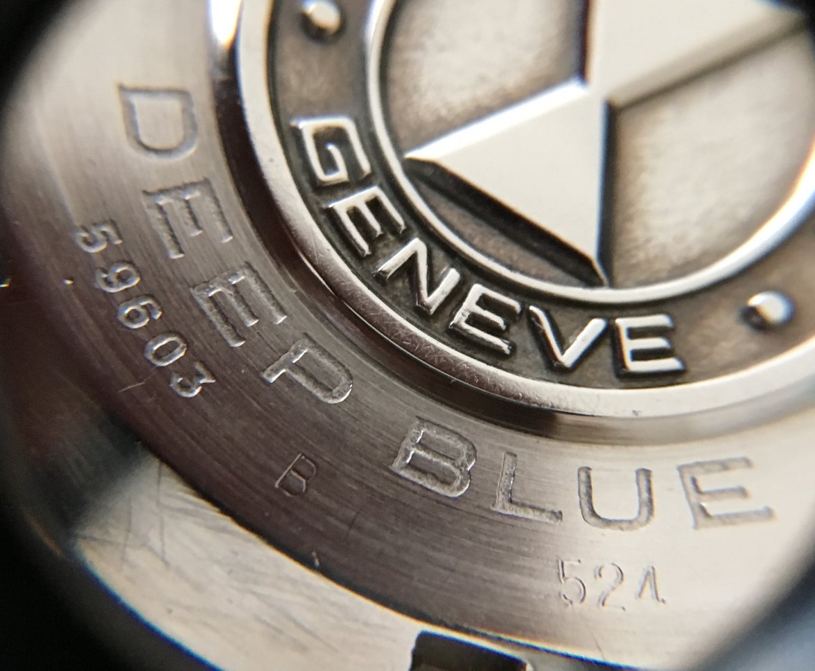

@tmw57 Okay I took a close look and the serial on the case back is 160
1,454
5,580
Great, thanks J.

Mark 1
Bezel: Steel count-up
Dial: Radium long applied markers at 3/6/9/12
Crown: non-screw down unsigned

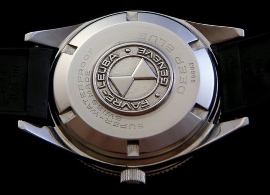

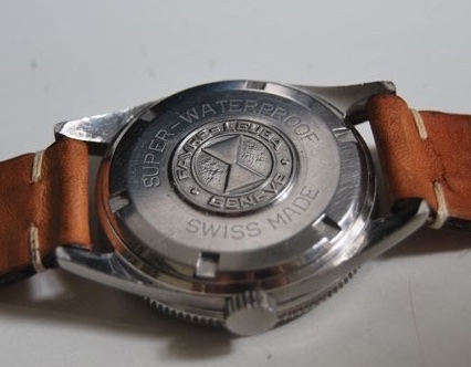

1 Caseback: Only with "Super-Waterproof Swiss Made"
2 Caseback: "Super-Waterproof Swiss Made Deep Blue and Ref 59603"
Serial-No.: Not on the same level as the Reference No. and as I have seen 3 digits long
Movement: FL 1152
Bracelet: 5 row FL signed
Catalog around 1964
FL Paper from 1964
Caseback 1
Caseback 2
Serial-No.

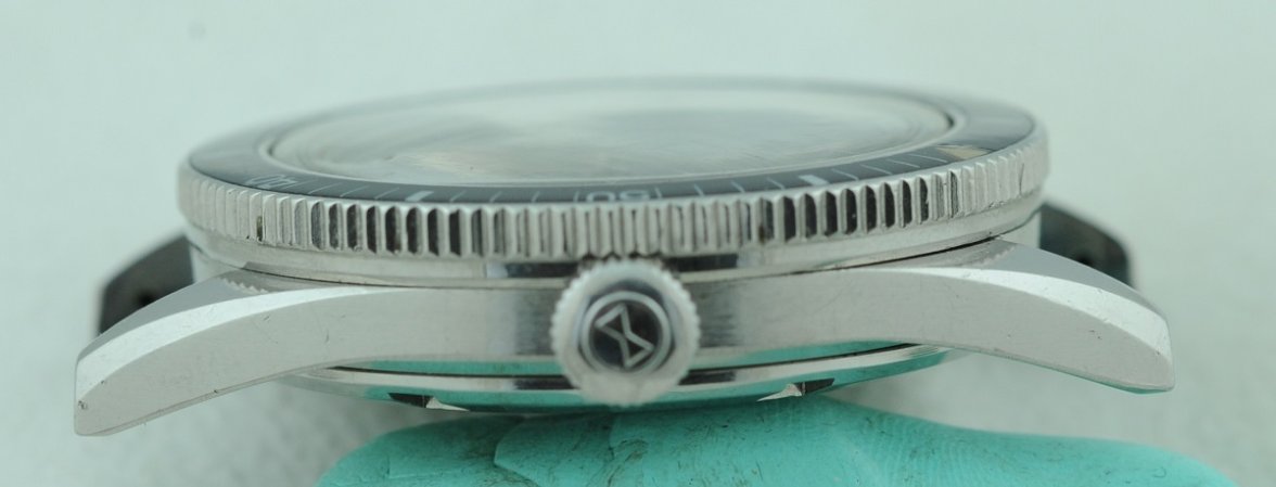

Mark 2
Bezel: Bakelite count-down
Dial: Tritium short applied markers at 3/6/9/12
Crown: screwed down signed with FL logo
Serial-No.: Same level as the Reference No. and as I have seen 3-4 digits long with letter "B"
Movement: FL 1152

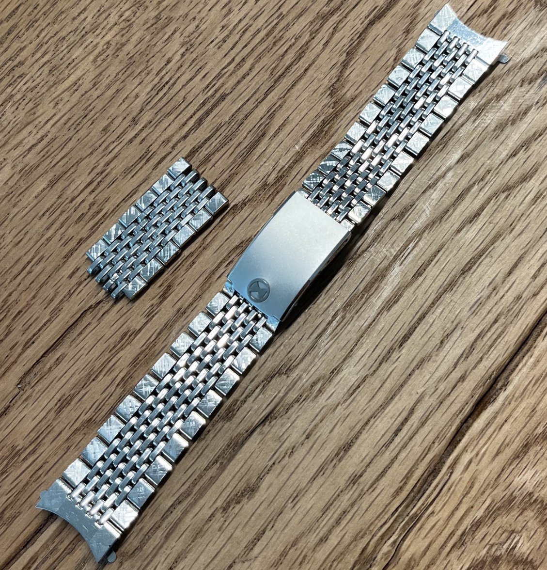

Bracelet: 5 row FL signed & "shark"
Catalog around 1970
Caseback with Ref., serial and letter "B"
Shark bracelet

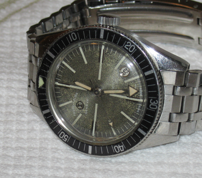

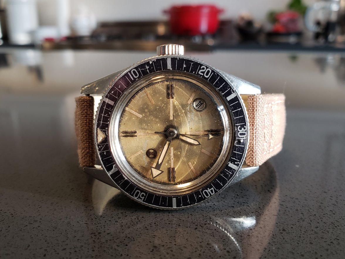

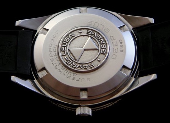

The remaining old lady in my collection
(with screw down crown because a wrong crown was mounted)

Looking at the case backs of my 3 examples (one is a parts watch)
1. serial #237 fits exact description of Mark I w/ case back 2
2. serial #242 "B" fits description of transitional. Radium dial, non-screw down crown, bakelite insert, serial number same level as reference number and with "B"
3. serial #1930 fits description of transitional and is the same format as above #242 with the exception of no letter "B" found. engraving has good depth so don't think it's been polished out.
So the only discrepancy between your description and my 3 examples is the absence of the "B" in a transitional model.
Lovely example. Are you saying it did not start it's life as a screw-down crown?
439
1,859
No, definitely not it was a non-screw down unsigned crown.
I gave the order to replace the tube and fit a screw down crown.
My watchmaker has a Geiger counter and I can tell you the dial and hands are still very hot.
As I don't wear this watch on a daily base I'm not so concerned about the radium more about the radon. So due to the aspect I haven't an original crown I decided to fit a FL screw down crown.

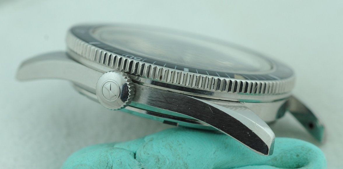

Maybe @Tony C. & @Zuke can share their dimensions of the non-screw down unsigned crown because I think they original and I haven't these in my documentation.

Thanks for the info. I have an original non-screw down and I can remove it within the next day to give photo's and measurements. Need to remove it to get an accurate depth reading. I have a Geiger and can give some measurements later today.
