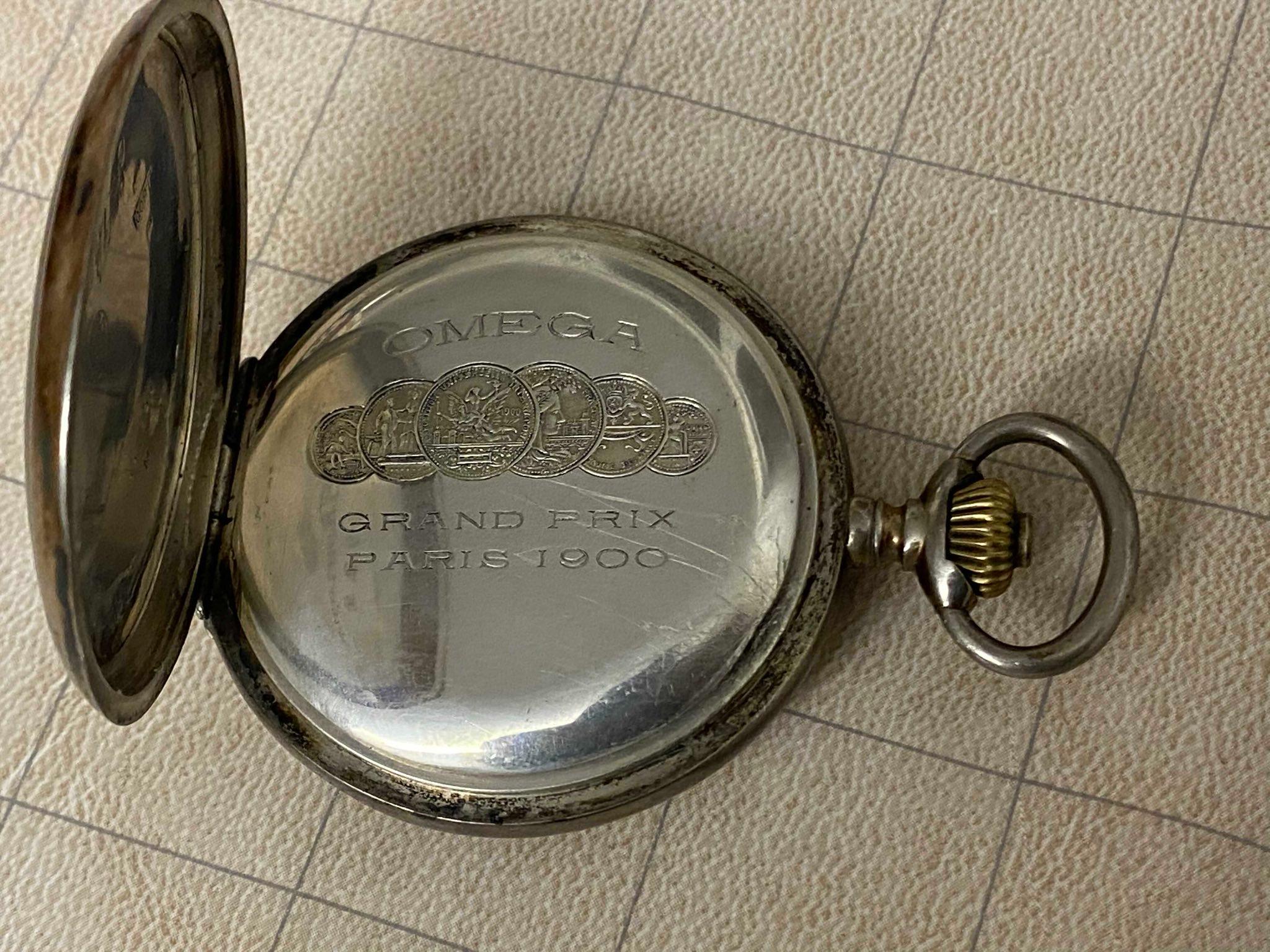

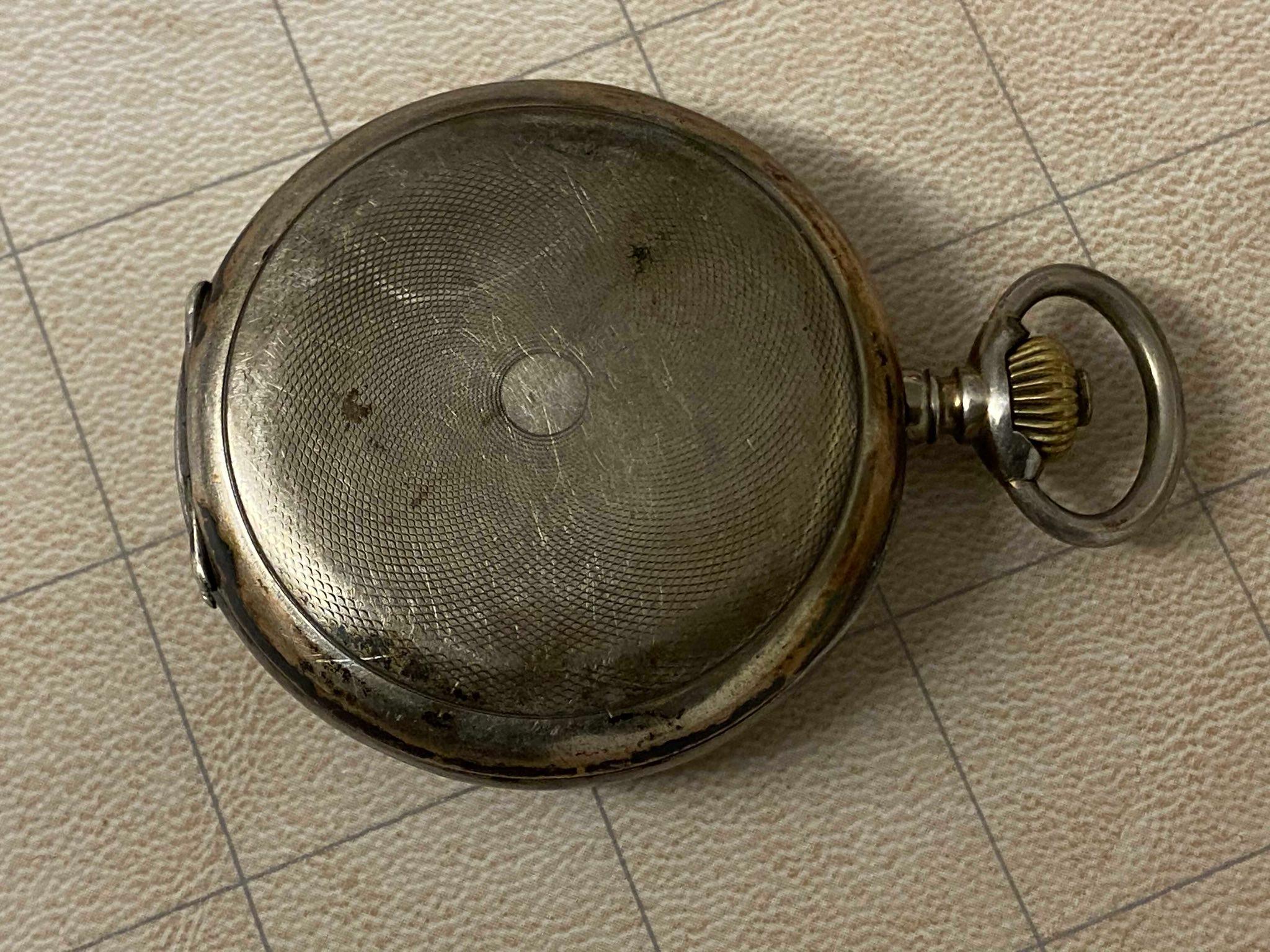

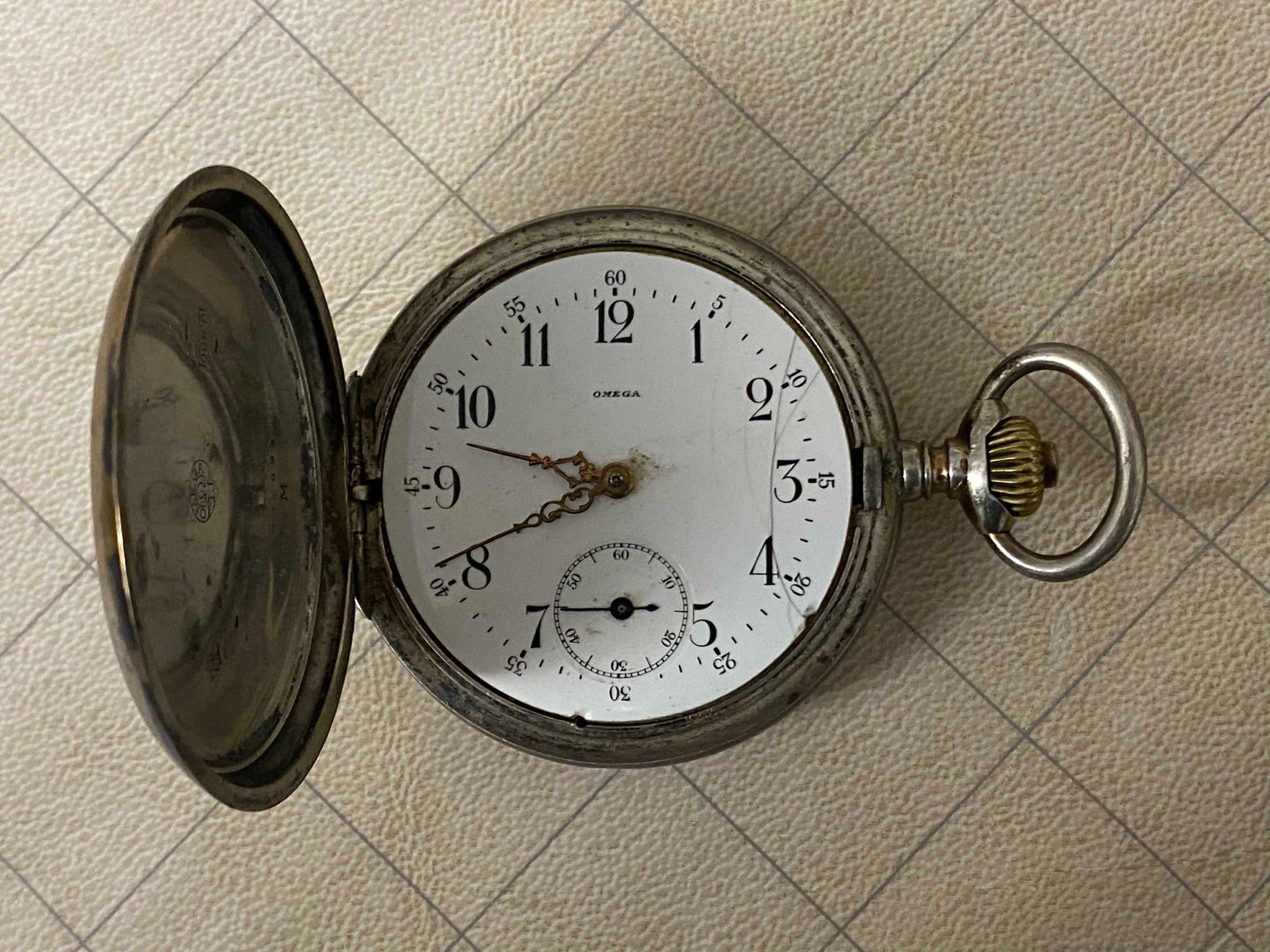

Good morning, y'all. Let me start with "Long time listener (well, sort of), first time caller." I saw an auction for a "used OMEGA Pocket watch" on the German fleabay. I had some concerns about it from the listing, but as I was buying a watch to take apart I wasn't as concerned. So now I'm curious, just how fake is this Fauxmega that I bought?

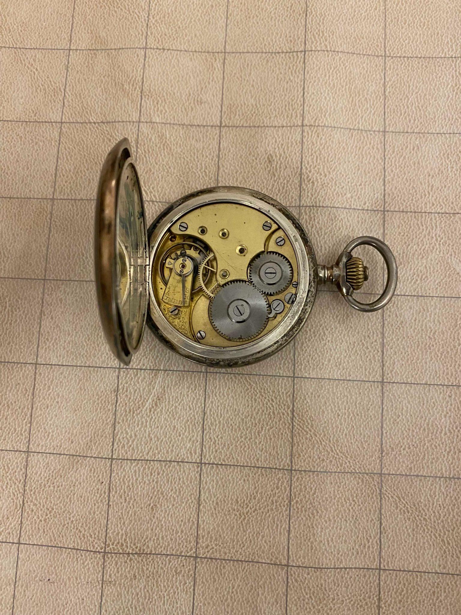

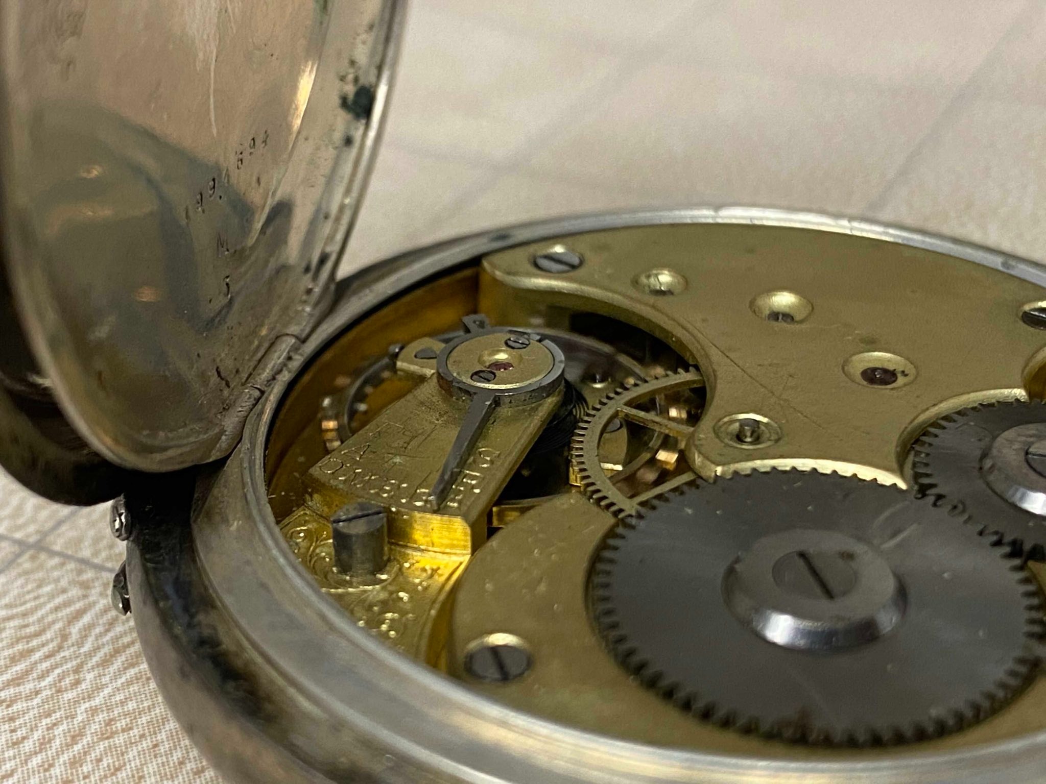

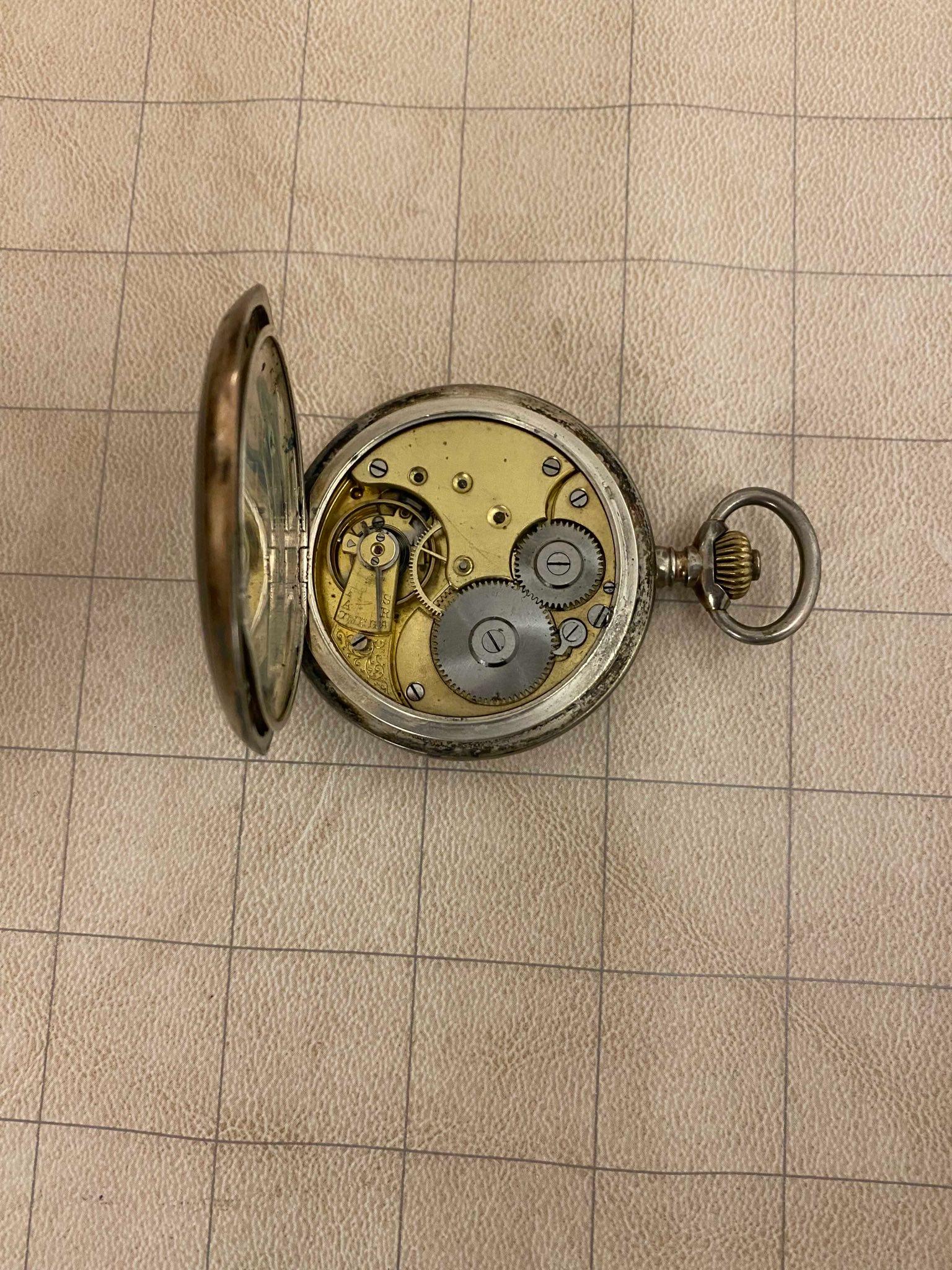

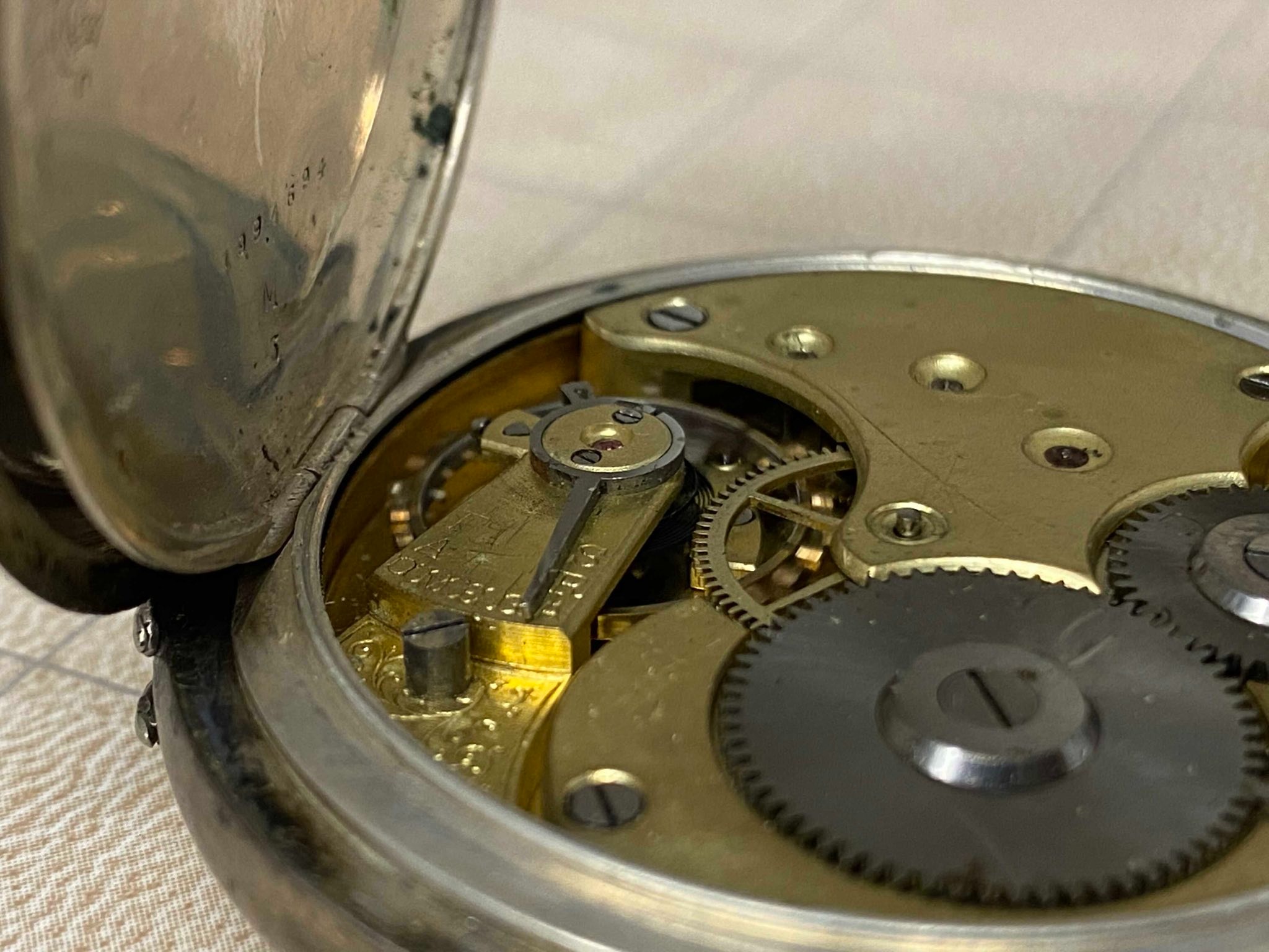

Starting with the dial, the Omega script has no Greek Omega. Since I wasn't sure what the face was, I wasn't sure how big of a warning sign this was (worn off the metal? Fallen off as it was a glued piece?). Moving to the works, there was an Omega indicated on the balance bridge, but nowhere else. And I would have expected to see an Omega on the main bridge, along with a serial number. I was pretty sure that either someone had worked on it and had to replace a bridge (wth? Is that even a thing?) or someone slapped an Omega balance bridge assembly onto something else. (Having received it, I'm even more certain the latter is the case).
What I wasn't able to see from the seller's pictures what that, are you sitting down? Good. There's no crystal. Am I smoking crack (again), or don't all pocket watches, regardless of case, have a crystal? It also appears that this is a porcelain face, so that's nice, I guess. I also couldn't see the screw holding down that balance. Getting the caseback open I saw more confirmation of my suspicion someone slapped an Omega balance into whatever this watch is. The screw holds it, but is totally wrong based on the fact I can see so much of that head. When I got it under a fluorescent lamp to take my own pics, I noticed the main portion of the top is red and the rim is gold. Did someone paint that? The watch runs (as in, minutes fast over the course of six hours on a wind; this baby's a sprinter!), and I didn't pay over $100 for it, so as a learner's piece I'm okay with it from that perspective.
If you've made it this far, thanks for any info on what I"m looking at here, and reference links will always be appreciated. In the mean time, or because we all need some, join me in laughing at this horribly faked Fauxmega, won't you?

I can't see anything wrong. It looks fine to me and no "faux Omega" at all.
Very early Omegas did not always have "Ω", and some had "Ω" but no "OMEGA" on the dial.

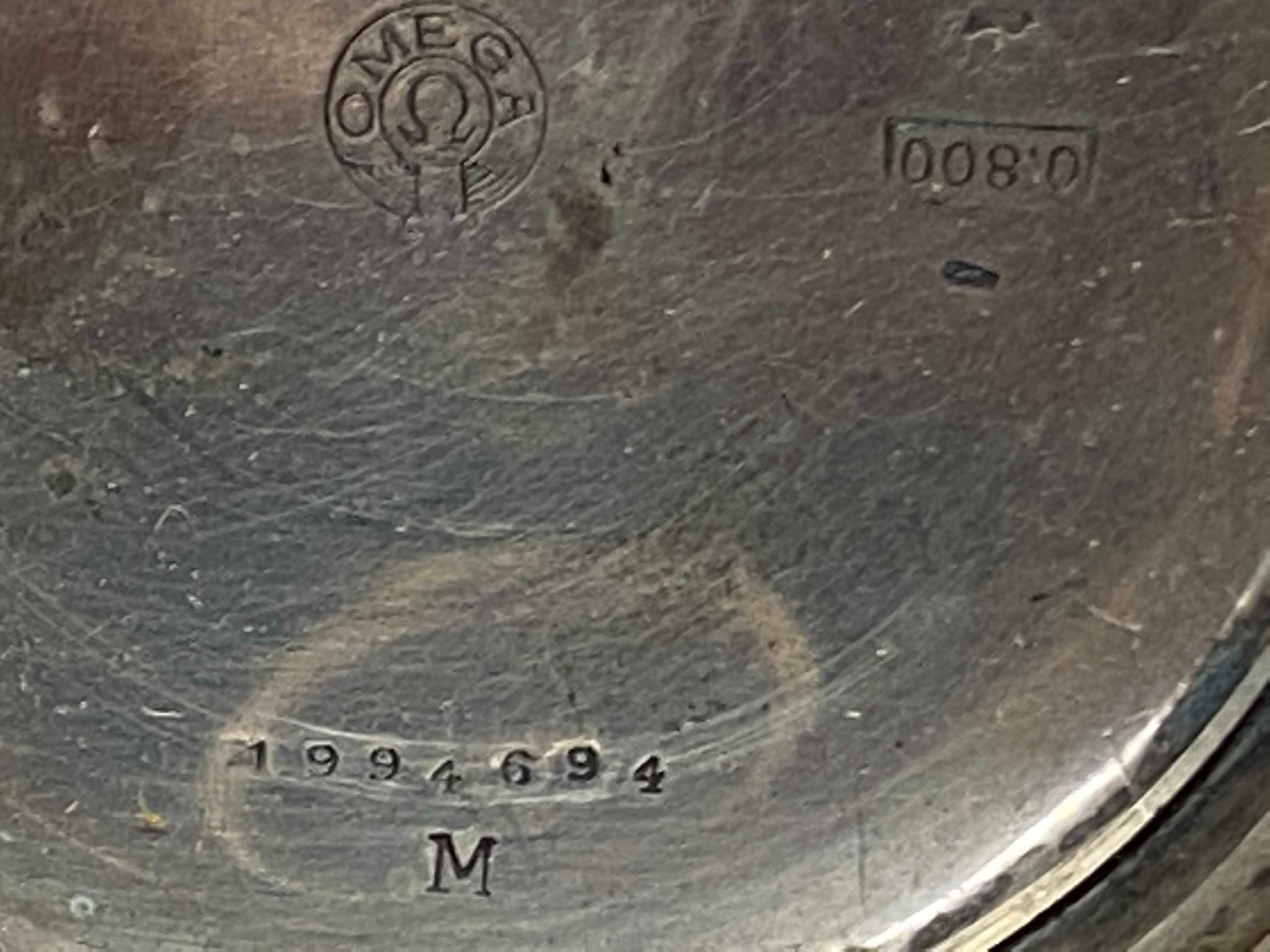

Very early Omega movements also had no serial number on the bridge, it was usually on the other side of the plate under the dial.
The "oversize" balance cock screw is also not unusual for watches from this era.

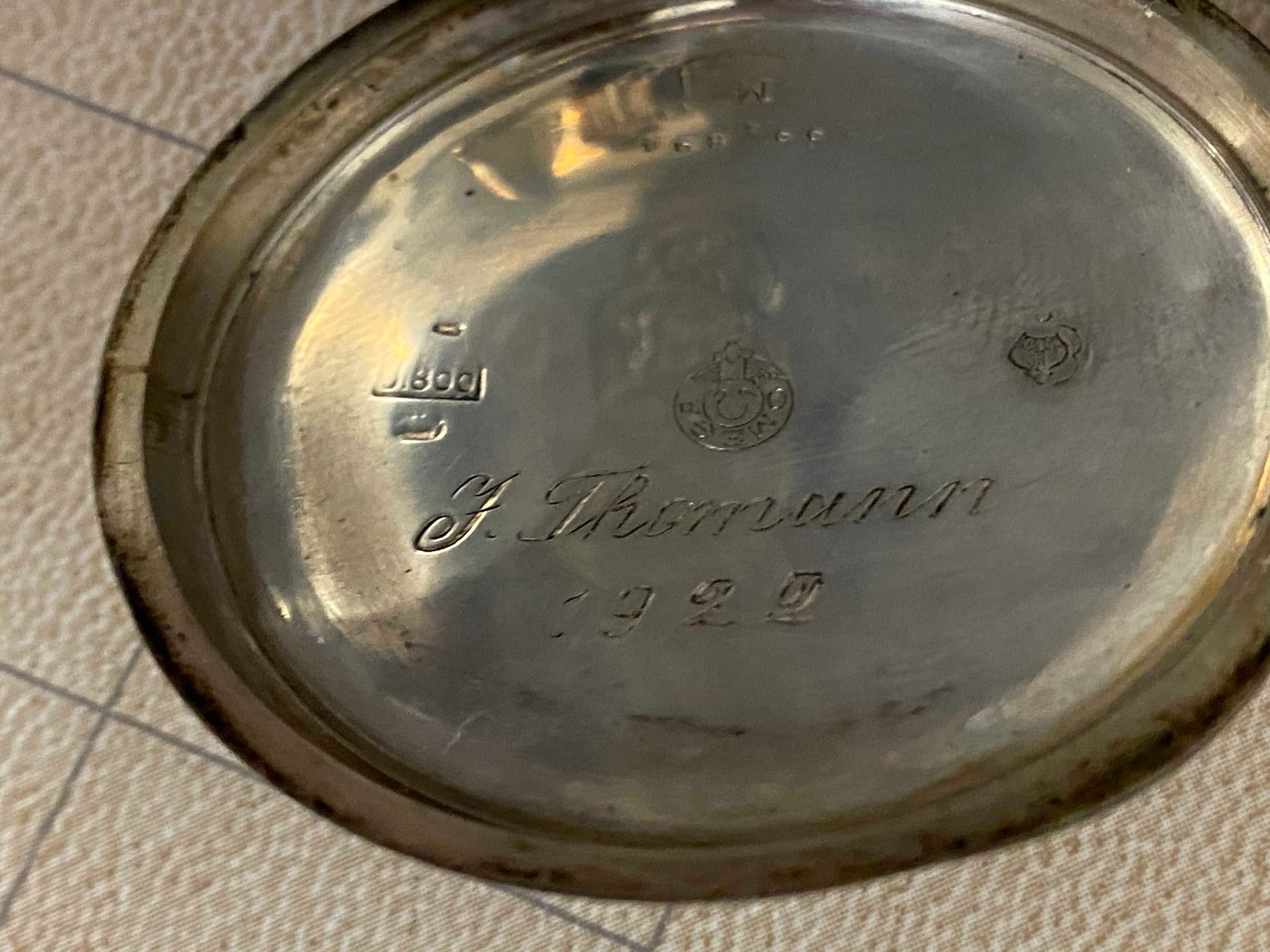

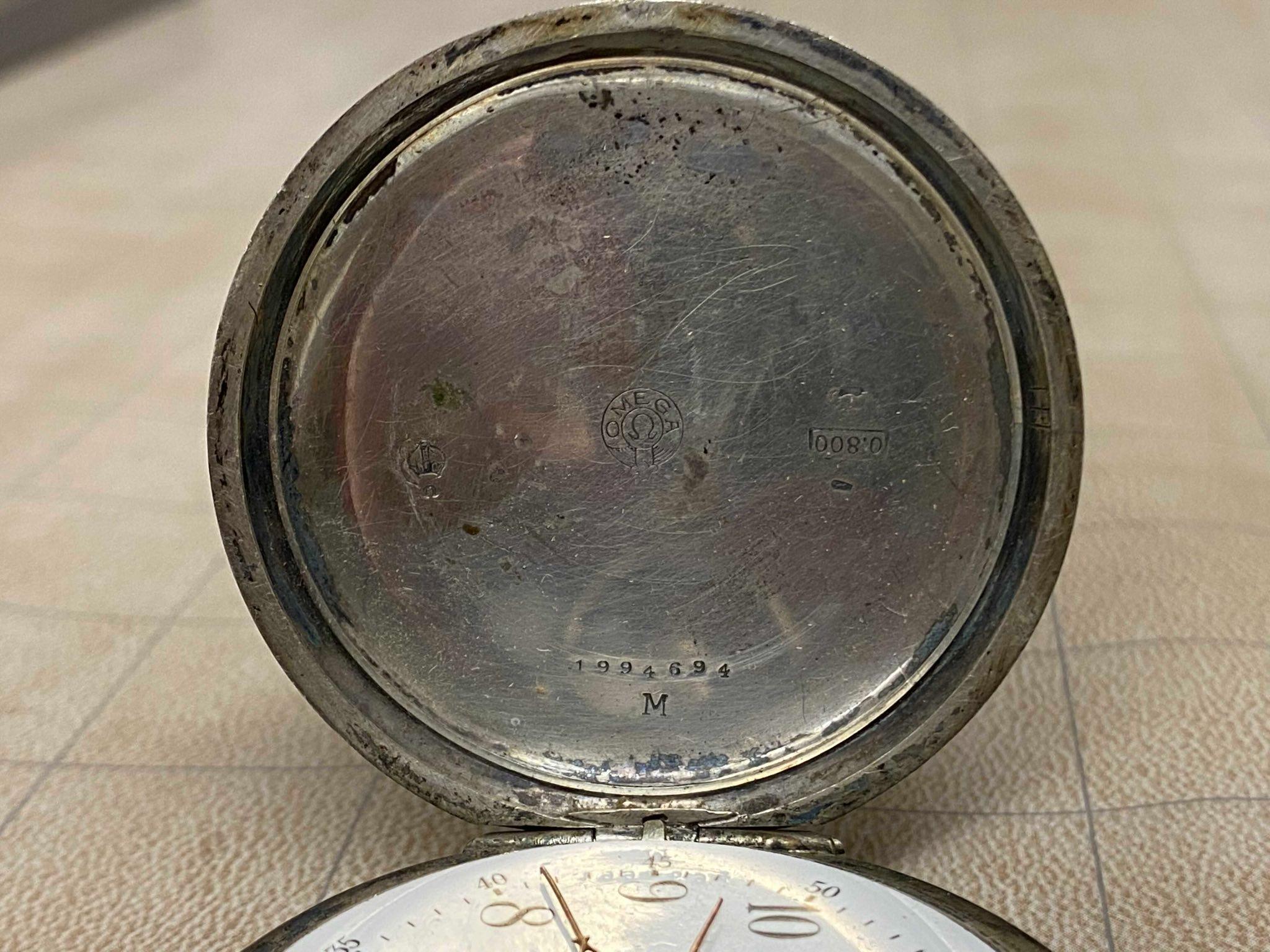

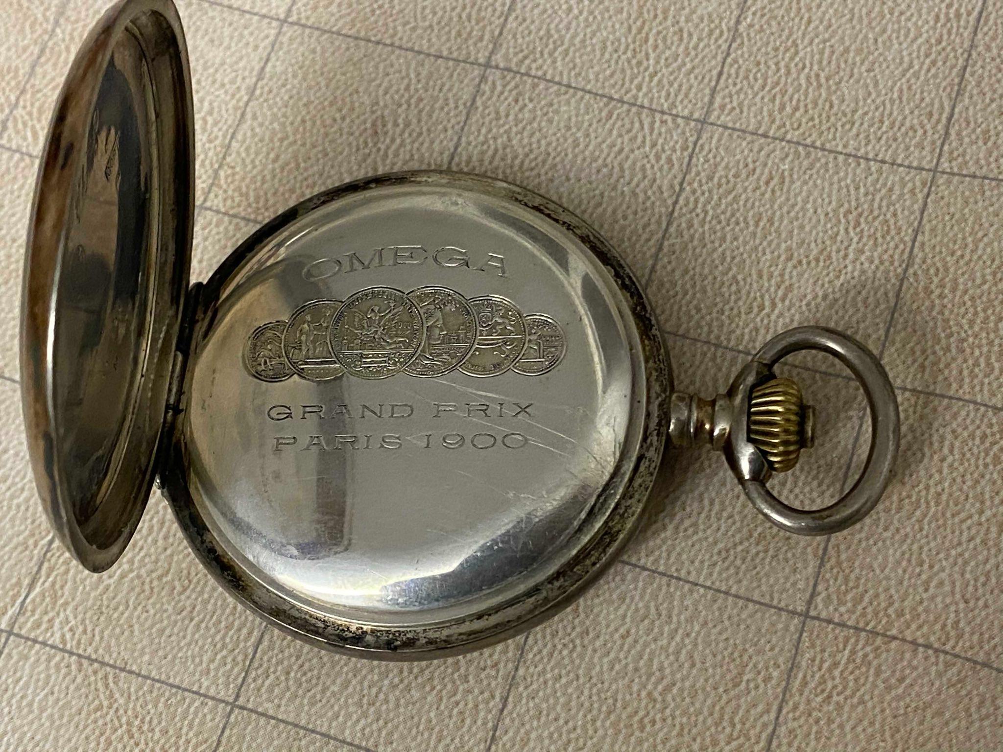

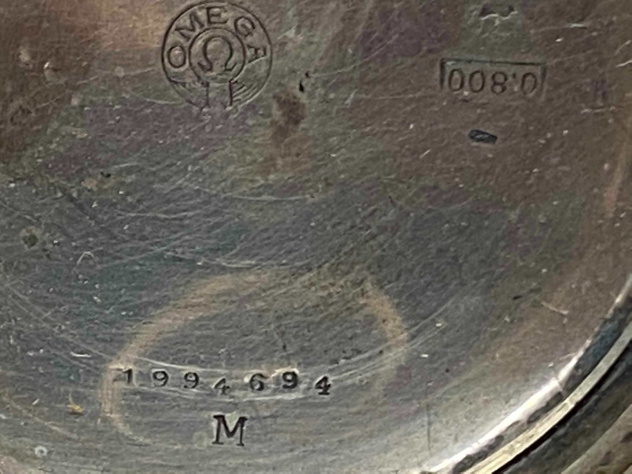

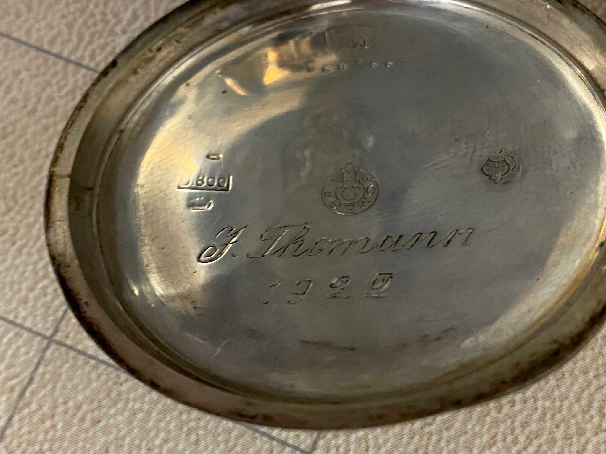

The serial number of the case dates the watch to about 1900 plus a year or two which aligns with the Grand Prix Paris embellishment on the cuvette. The case also bears a "crescent moon/crown" mark intended for watches exported to Germany.
I would guess that the movements is a caliber 19'''S, but if you can measure the total diameter of the plate we can pin it down.
18,840
39,183
Oh, well then. Thank you for the information. Would a watch of that vintage not have a crystal if it had a Hunter's case?
Yes. The crystal is obviously missing.
