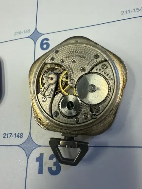

Now the bad. A check of a parts supplier shows few parts for that movement, so no comparison to other movements that might have used the same stem.
If you want to get it going and use it. Set an alert on Ebay that sends you an email if that movement is listed for sale or parts.
Might also try Dave's Watch Parts or Google vintage Omega pocket watch parts

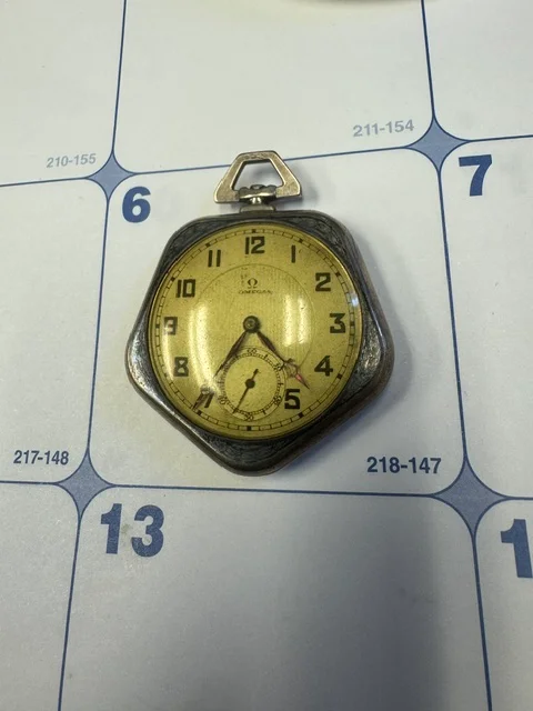

The hands are badly rusted! Perhaps too deteriorated to salvage! You need to get that gawdawful yellow crystal off the watch. As they gas out over decades, they rust anything nearby. I’l bet the dial is MUCH more attractive behind a modern acrylic or glass crystal.

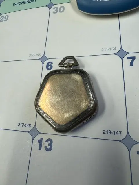

I agree about unique. Omega made many models but most with round cases, I could only find a couple of the pentagonal model in AJTT.
The hands may be a bit rusted, but with care they could be restored, they are very unusual "Omega" hands so should be kept.

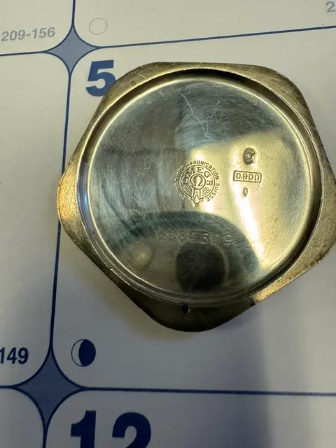

Serial number of the movement (6,029,159) dates to 1923.
Case serial dates to about the same date.

The "why can't I find another one anywhere" question has a likely boring-but-satisfying answer, and it's checkable: look inside the case lids for the casemaker's mark.
In that era, watches for the American market were routinely imported as bare movements and cased on this side of the water - tariffs made it cheaper - so Swiss movements ended up in cases made by American case companies, chosen from the casemaker's own catalog at the jeweler's counter. A coin-silver pentagon screams that story: if inside the back you find a US case company's stamp (Wadsworth, Keystone, Star, Illinois, and friends all marked their work) rather than Omega's own medallion, then the movement is all Omega and the case never appeared in any Omega catalog - which is exactly why no search ever finds its twin. Not a marriage in the shady sense; that's how the trade worked, and period-correct. One photo of the inside covers settles it either way.
On the missing crown and stem - better news than the thread suggests: a stem is a watchmaker's routine fix, not a donor-watch hunt. Material houses still list winding stems for a wide range of Omega pocket calibers, and where a genuine one can't be had, any competent watchmaker can fit and cut a stem to the keyless works and match a period-style crown to it. It's among the cheapest parts of getting this running; don't let it stall the project. This is a really cool watch; I would keep it.
And Canuck's serial dating is the anchor worth keeping: early 1920s - so this pentagon is ahead of the Deco wave rather than riding it, which arguably makes it more interesting, not less.

Thank you for the pictures and information JimInOz, Canuck and WatchBreaker. The pictures of other examples are incredible. I will have the crystal replaced, hands cleaned and source a stem. I have no sentimental value to this watch but definitely an appreciation for how unique it is. If feel it is well worth restoring. Thank you again.
