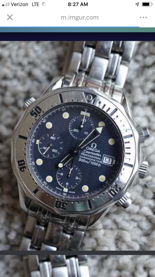

So I was looking at a Bond Seamaster chrono from the 90s. I noticed in doing a basic google search that the hands on the subdials are red, and in this pic they’re white. Thoughts?
30,064
77,620

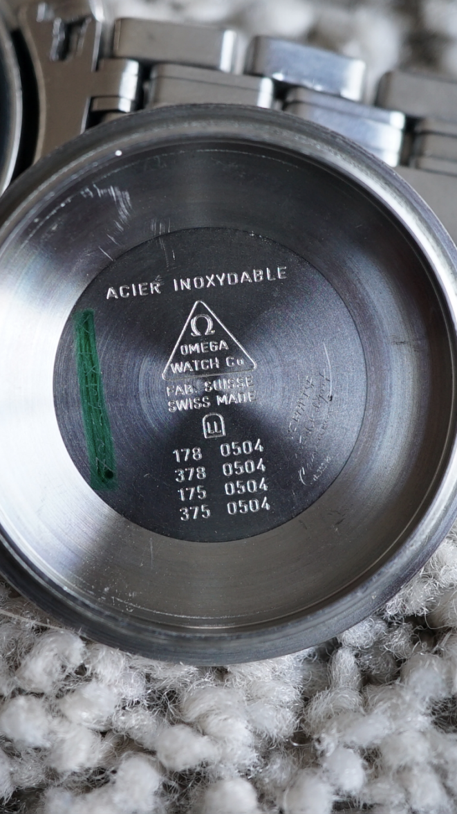

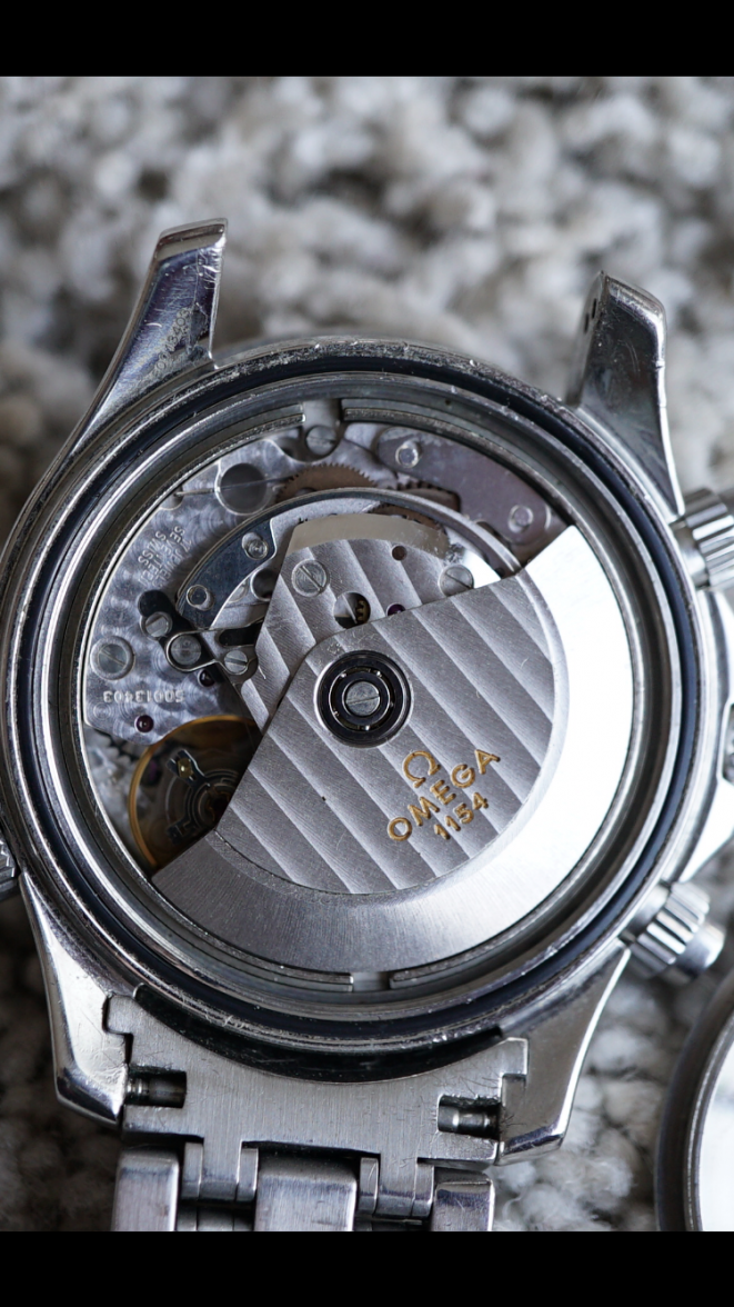

It looks fine to me - ref. 25988000. Over time the red tip of the chronograph seconds recording hand, the sub-dial hands, and the red marks around the dial will fade to white. This is an early variant with an 1154 - later used 1164.
