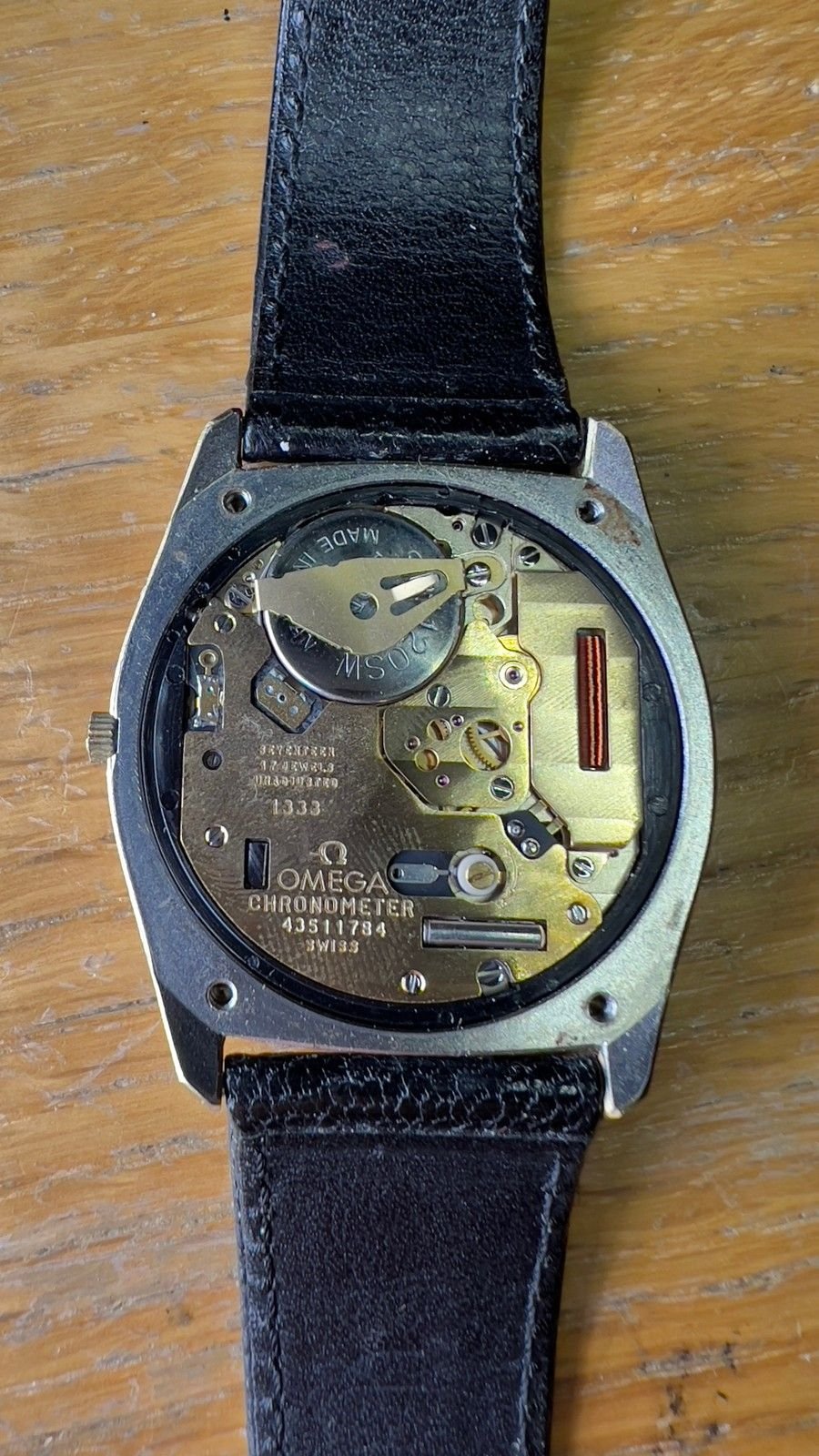

Question: How do I adjust the time on this watch. Right now I can pull the side nob, set hourly time
but the minut lever do not move, there are also no further setting on the side nob. However there is a tiny button or something right beside it. Also worth mentioning is that the minute lever do move, so does the second.
Thanks in advanced

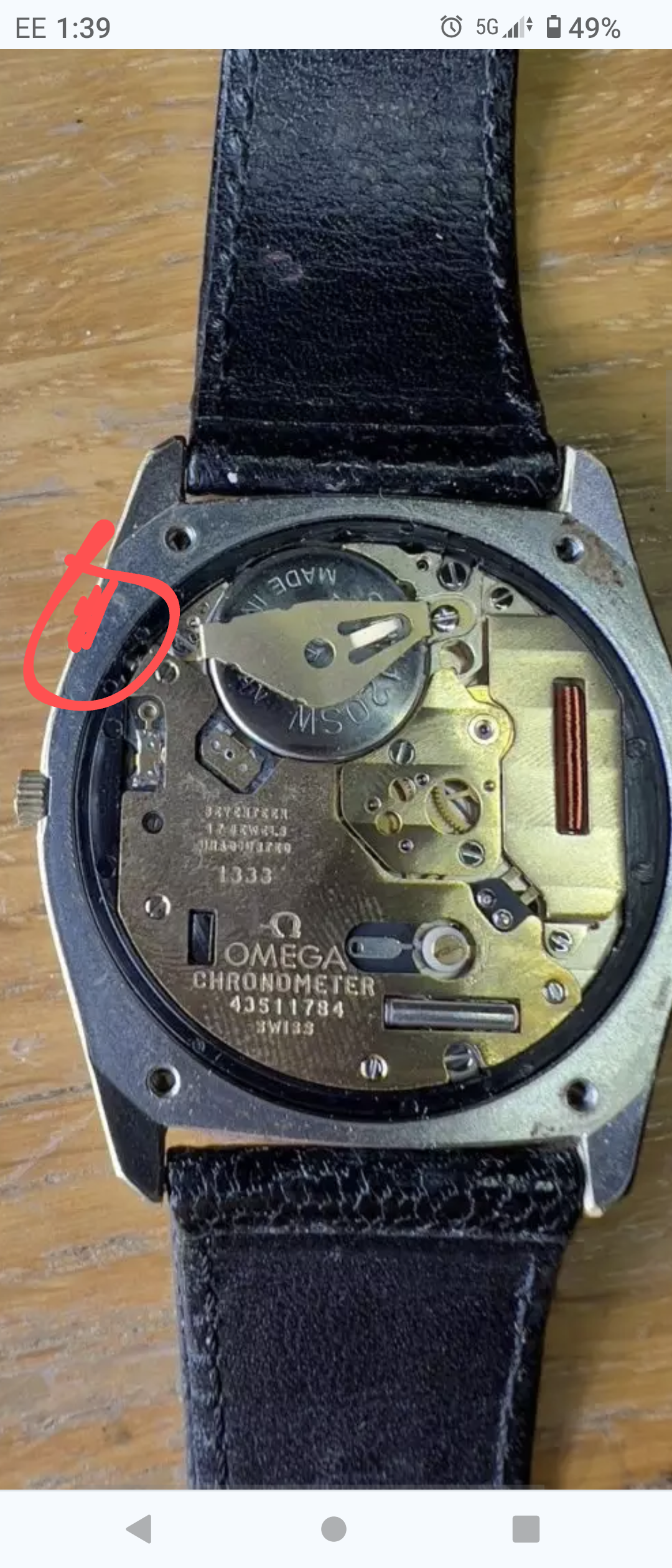

Should be a button here ? Flush with the side of the case these can be very temperamental I've owed one similar with the same movement. If you hold that little button in for 5 seconds then release then hold in again it should adjust the minute hand.

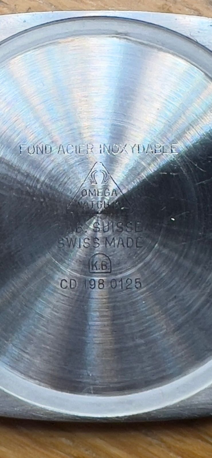

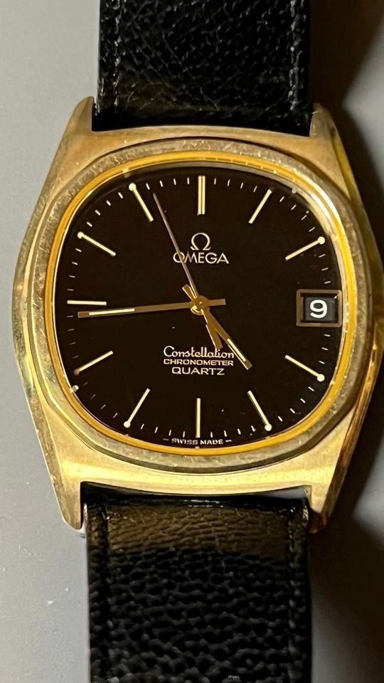

Its not from 1962 by the way, more like 1979-1980.
