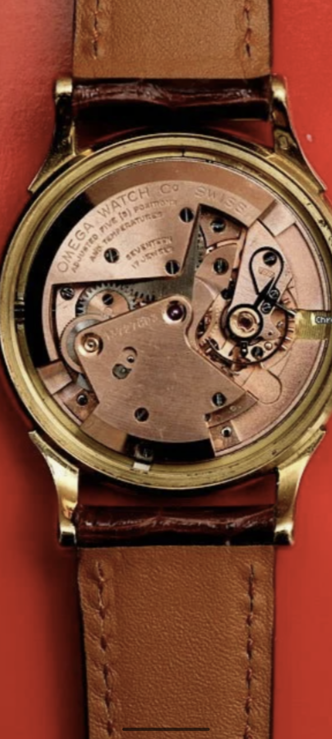

I'm considering buying an Omega Constellation and would love to have a ballpark estimation of what it's worth, and an opinion of the community if all parts are original.
The year of production listed is 1952 but the dial reminds me of Deluxe editions from 1956, and the serial on the case back run through the Emmy Watch database brings back a production in 1947.
Case is in solid 18kt gold and powered by the 354 movement (which would match the 1952 production I guess?)
So is this a sort of high end Frankenstein or did I get my research wrong? How much would you estimate such a piece?
Thanks for your help!

How could you tell anything from those crappy pictures? The watch looks like a Ref. 2699.
http://omega-constellation-collecto...ega-constellation-model-2699-star-of.html?m=1
Serial number of the movement should be in the mid 12 million to low 13 million range and cal. 352 or 354.

Thanks for your great input. The ref is indeed a 2699 as shown on the case back, and with a cal.354, but serial is in the lower 11 million. Would that be too early and confirm the 1947 production date?

With that early 11 million serial number then unfortunately the watch is a Franken.
13,685
19,062
Earliest Constellations were made in 1952, and the cal. 354’s started around 1953, so I’m afraid the movement is collection of parts that do not belong together.
The case and dial look genuine. Some early models used clover crowns, so that may be OK also.

Also the regular is pegged to the side so is in need of service.
Pass on this one.

It always concerns me when sellers have these wonderful angled, macro pictures but don’t provide me a basic front on shot of the dial.
4,459
11,355
I think the serial may be 13 million but from the pics it is blurred to look like 11.... It looks like a decent watch but nowhere near the $8k price the seller is asking online.

Are you still referring to the number on the caseback? The relevant number is the serial number on the movement which is blurred in the pictures though

Thank you so much for your insight. I was looking at the caseback and not where I should have! What would be a decent price for such a piece in your opinion?

Hi Bruce, thanks for your message. What do you mean by "the regular is pegged to the side"? Sorry I'm both new to the watch collecting world and not a native speaker!
I'm surprised as the watch is said to be fully serviced by what appears to be a serious vintage reseller.
If the movement serial number is 13 million and the case serial number (for gold watches only) is 11 million, that is what we would expect to see on a Ref. 2699. No frankenwatch. As I said, I can’t see anything regarding the movement serial.
He means that the regulator (not “regular”), which controls the rate at which the watch is running, is not balanced between fast and slow. When the regulator is too far to the fast or slow side, it is a sign that the movement may require service.
If you buy this watch, it should at least be inspected by a watchmaker to ensure that is was serviced properly.

Top left lug might be bent inward. It appears that strap has been cut down to fit, or worn away from getting pinched.
