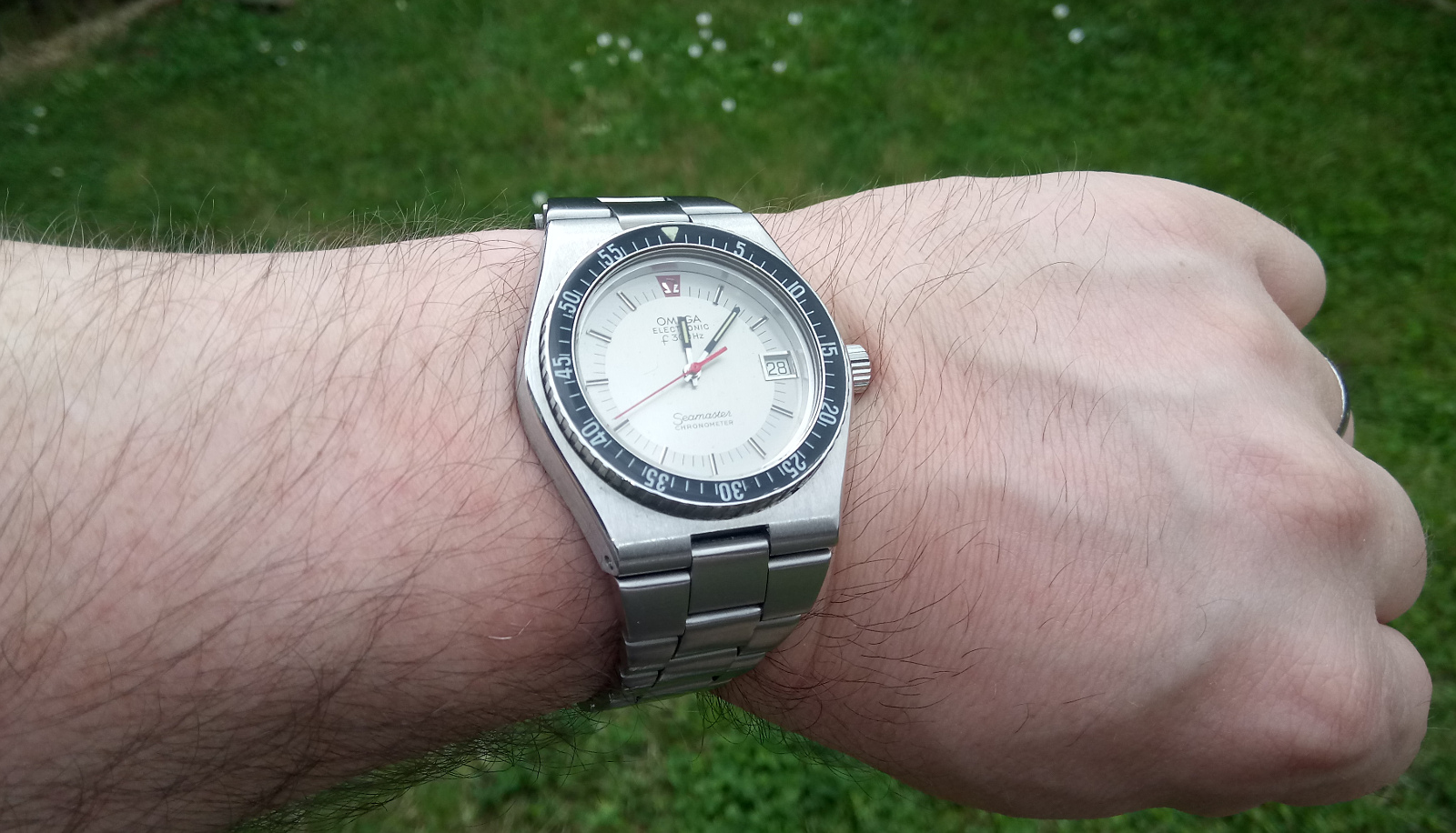

this looks like a 196.0030 with a Kal. 1310 to me馃槈
you hit the nail on the head! all you need to do is identify the bracelet? lol

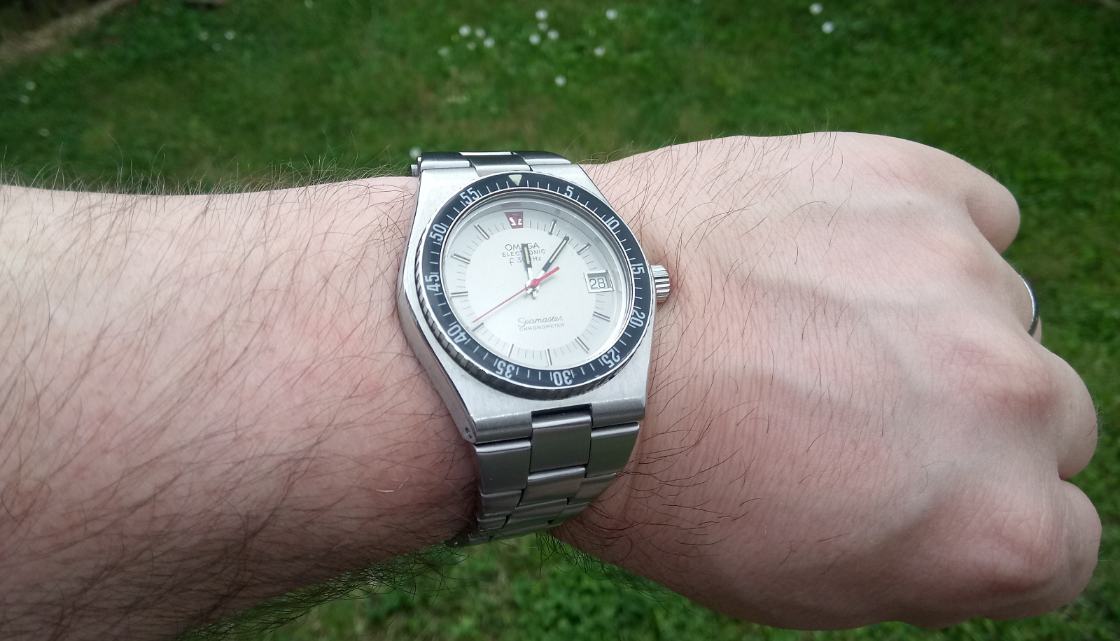

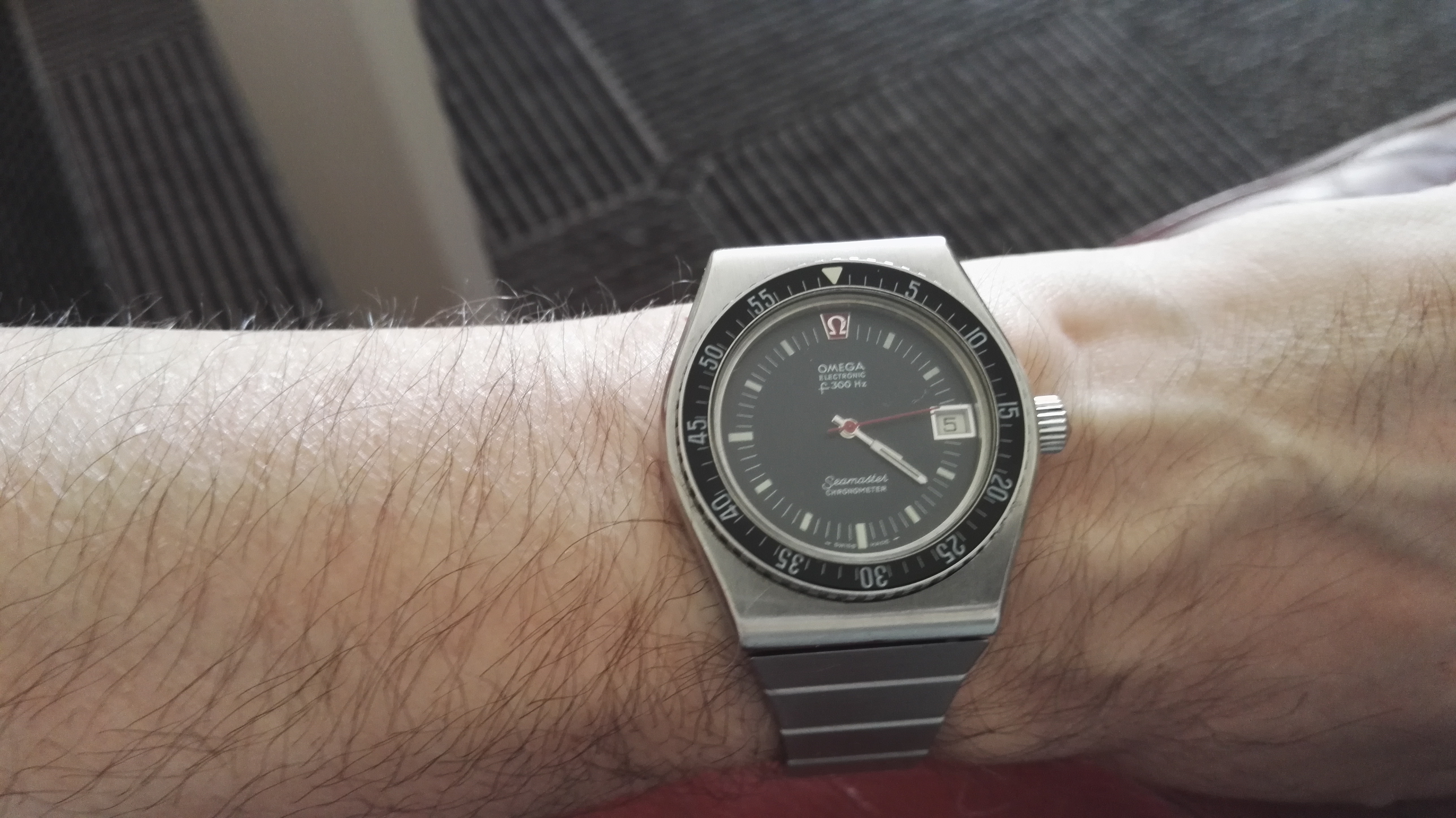

Here is one of my hummers. Love it.
Surely that isn't a hummer by dint of not humming. At all?

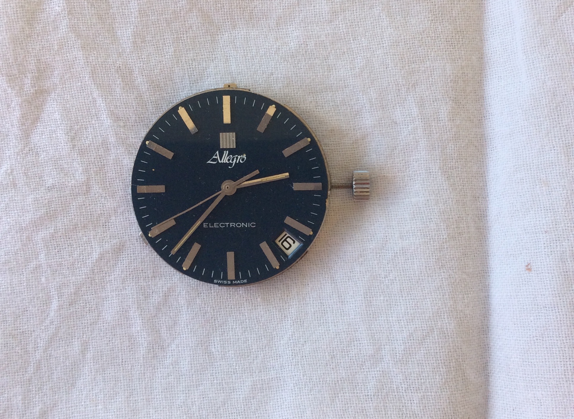

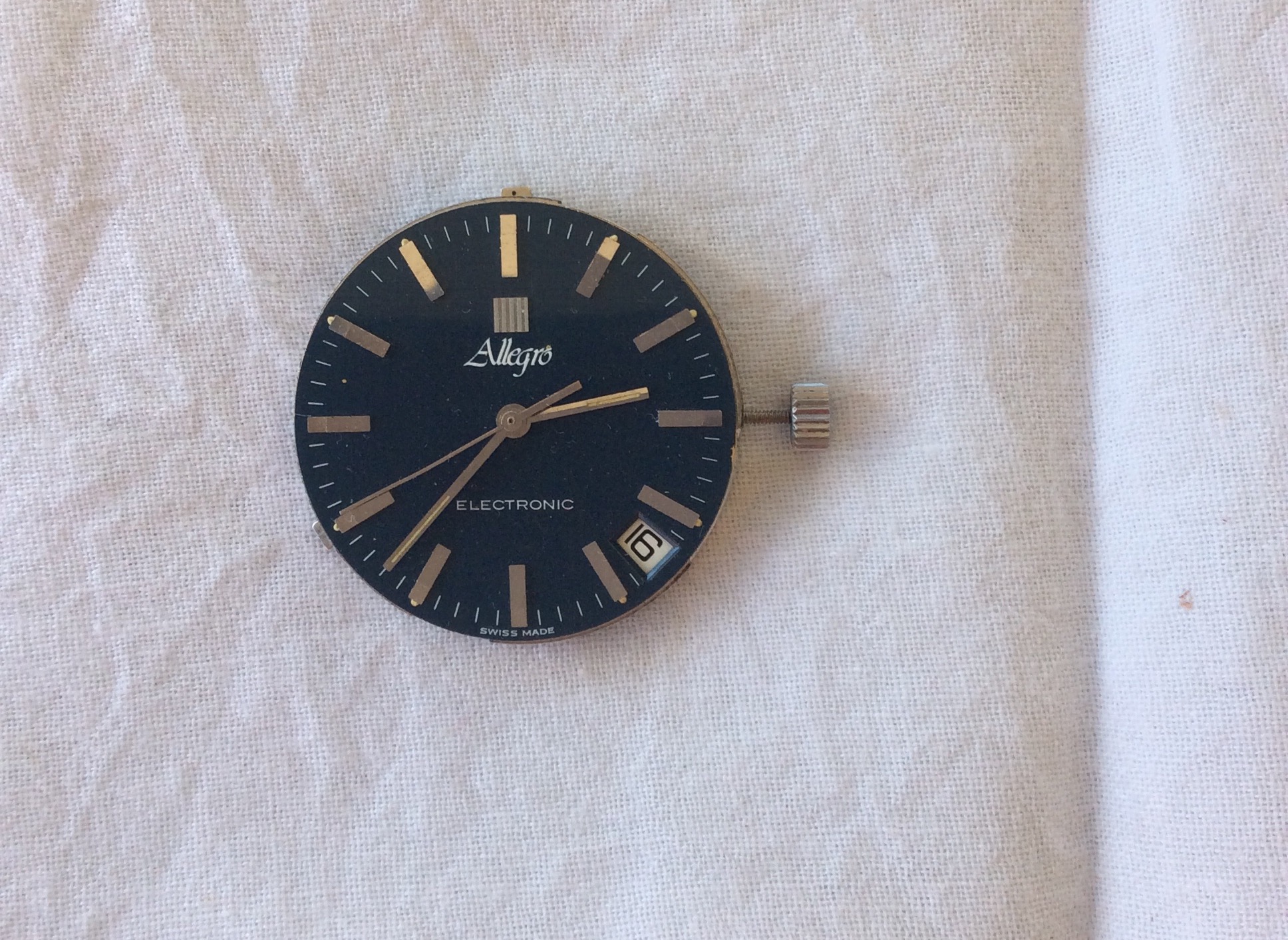

After repairing a couple of accutrons decided to have a go at an f300.
Below are before and after shots . I used a parts or repair allegro for an index wheel and resonator. The allegro dial looks to good to chuck so will now have to find a zenith case. It never stops does it

Looking good!
Thank you.

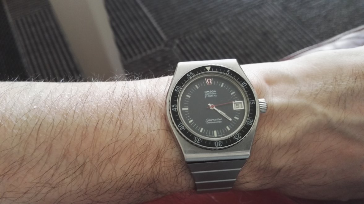

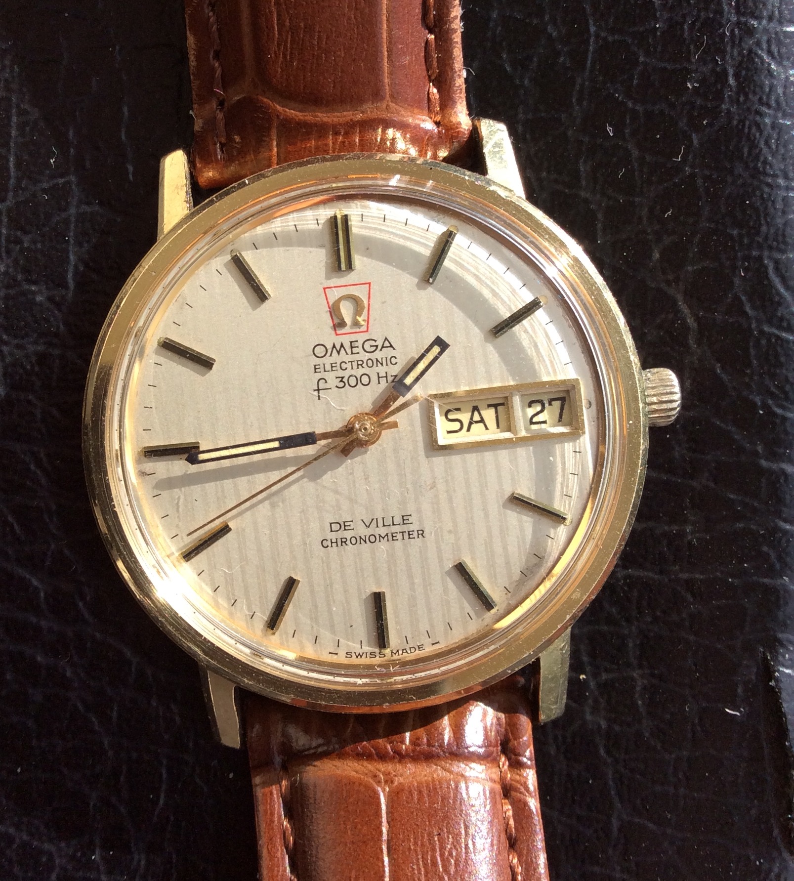

Btw this is one of my f300
10,804
16,814
I am not sure there is another source for the metal wheels, hence me name checking Paul who had a batch made. He must have sourced them somewhere so perhaps they can be found for self fitting, I dimly remember mention of a source in Germany, but I could be mistaken.

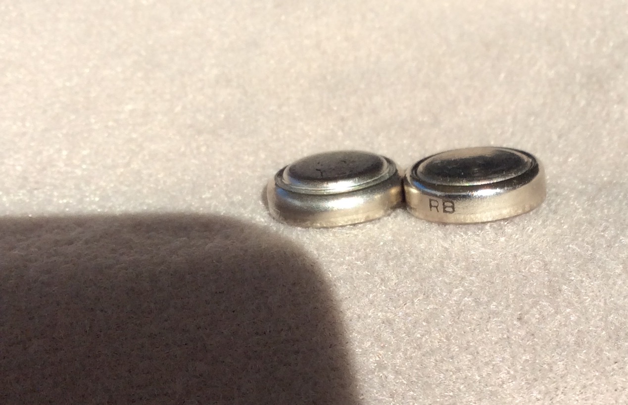

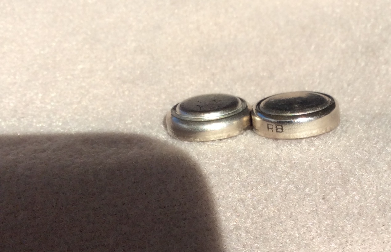

A bit late but a little trick told to me by a tuning fork expert that sees a lot of non working f300's come back to life especially if you see an energiser battery in the movement. Personally of the three non working parts or repair movements I purchased two went immediately albiet one needed a new index wheel.
Over the years the energiser 344 battery has got flatter in the centre section ( negative) which in turn will not operate some more worn f300's. By using a Renata battery that has the older profile of a raised centre ( negative) there is a likely hood the movement will start. Sometimes a little tap will help as the movement will most surely need a service. The energiser is on the right

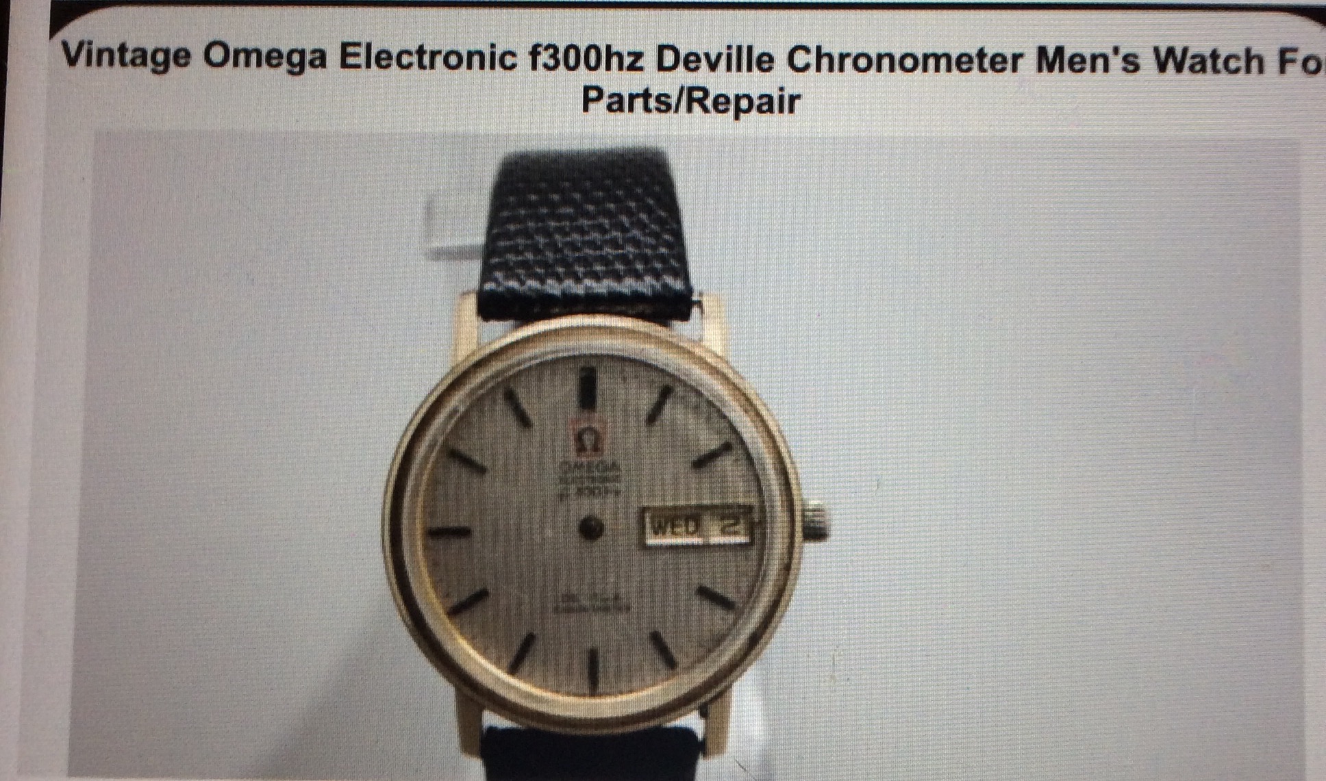

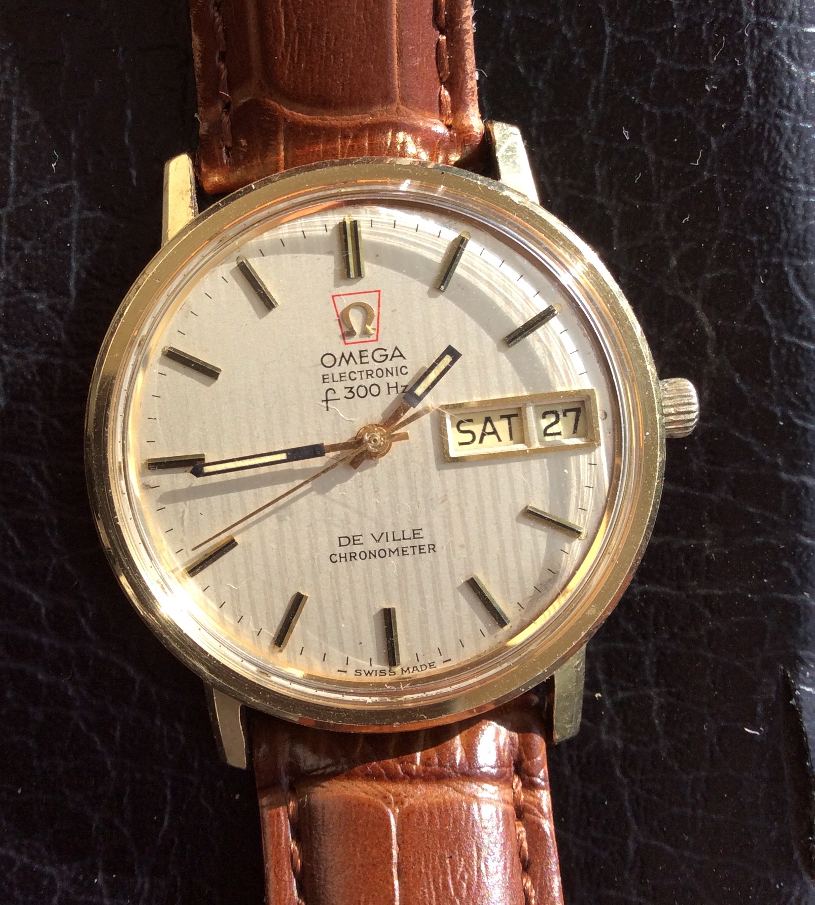

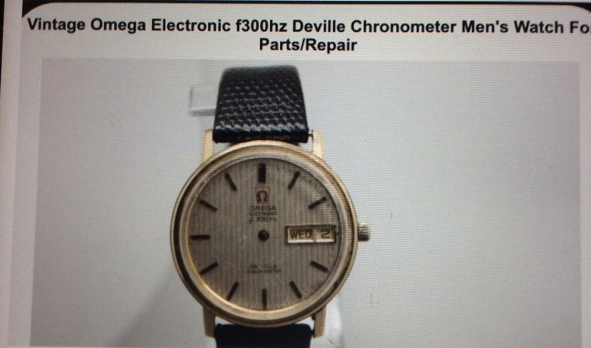

Looking at a few around the bay at the moment,can anyone clarify/knows why why some are Labeled omega electronic and not omega electronic seamaster, constellation etc?
TIA
228
264
Early models (Ref. 196.001) are only labeled f300 without anything else. The same it is with "official certified chronometers".
10,804
16,814
Omega played fast and loose with the labelling on many of the hummers. Other that the specialist Seamaster diver models and Speedsonics, most have identical specs, 30m water resistance etc so the dial label is kind of irrelevant. That is to say a steel Connie hummer is likely no better built than a Geneve, Seamaster, De Ville or even unlabelled. The movements are all the same, either 1250 or 1260 so differences are slight, mainly limited to case and dial materials
