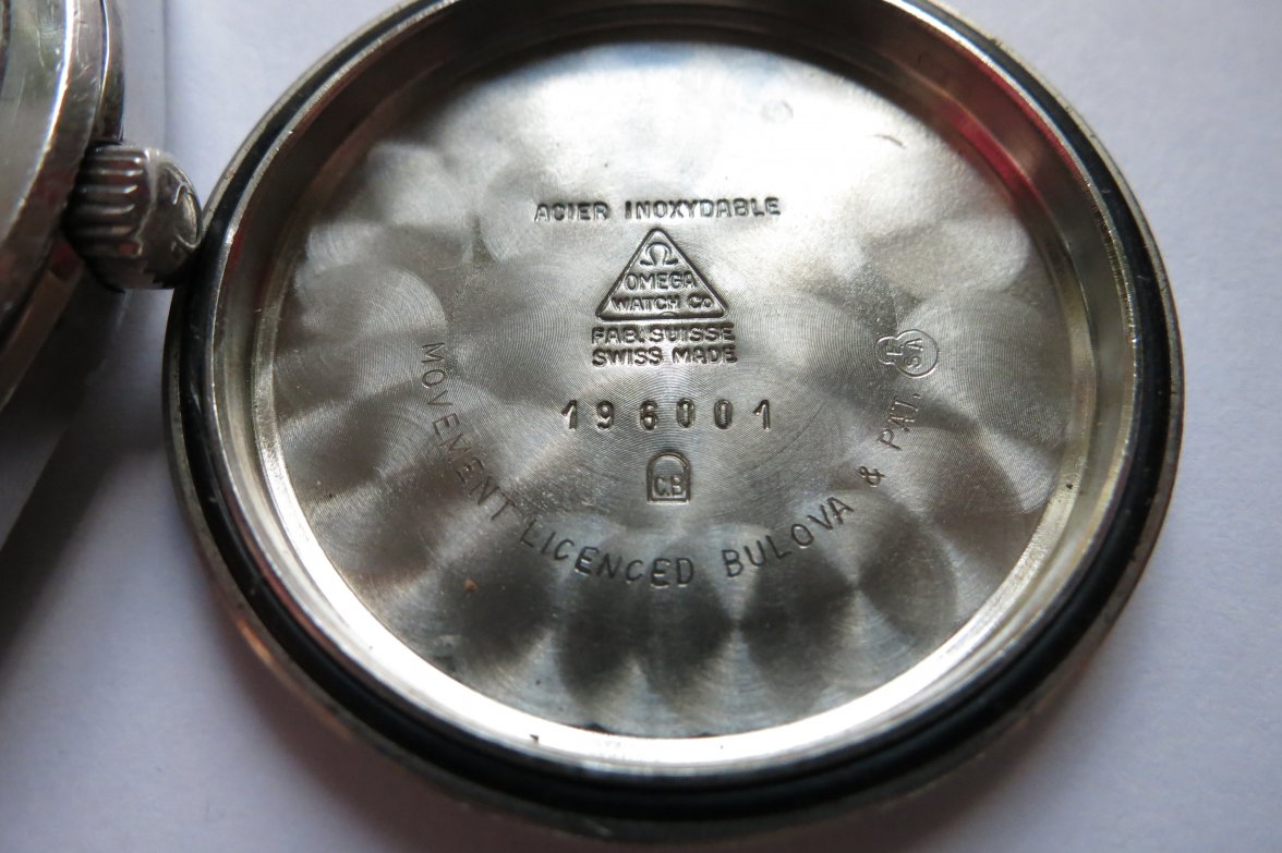

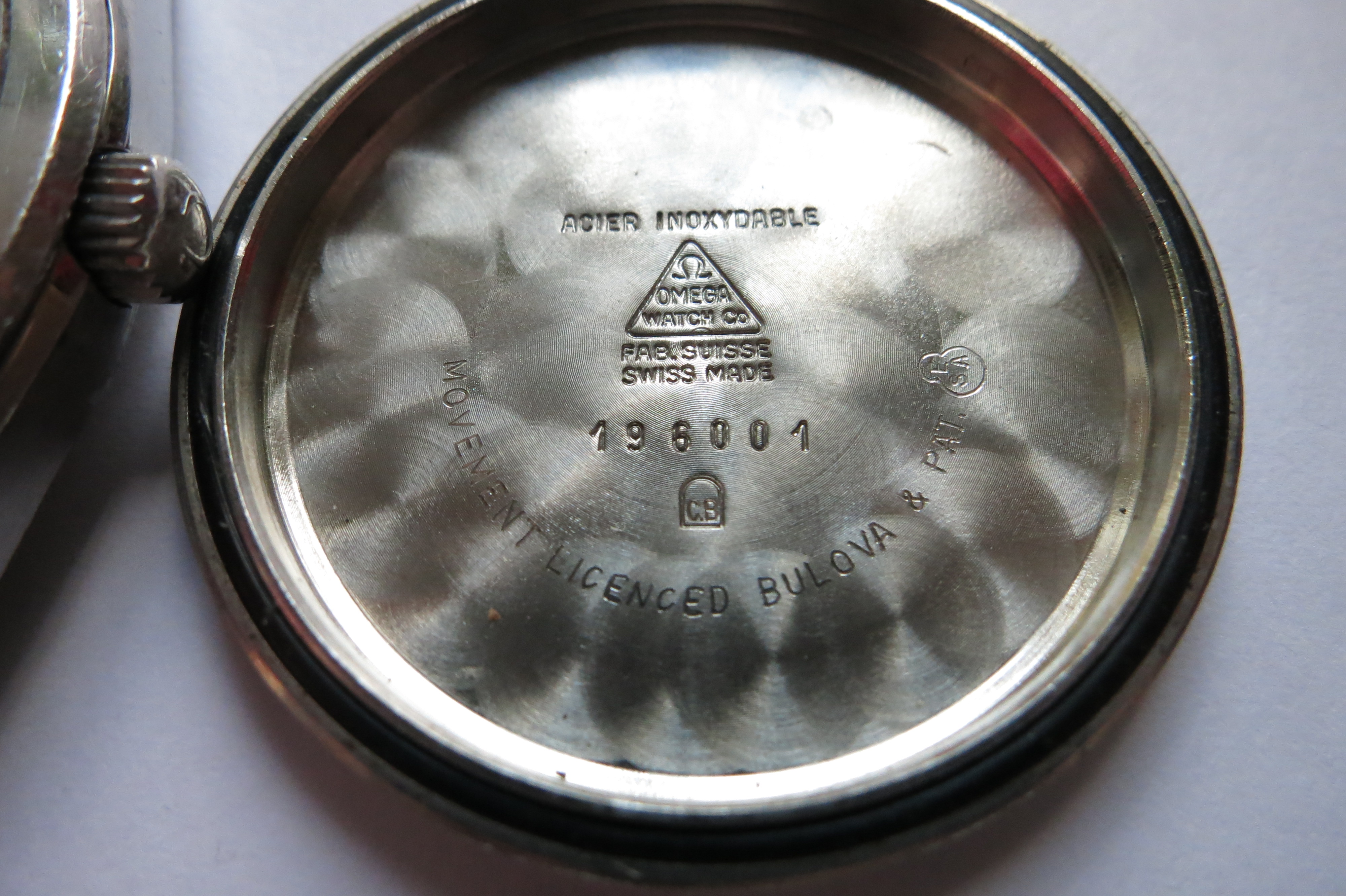

As I mentioned above, I have two of the 196001 (stamped without the dot after the first 3 digits). Didn't know that they are an anomaly.
10,804
16,814
I would genuinely like to see that, if you are able to take and post caseback and dial shots from one it may help to widen the knowledge base on hummers worldwide. Since the 001 is presumably the very first hummer model, it is just possible that they were substantially different to the rest of the breed, perhaps they called them 196 before they decided to certify them all for instance and then went with 198.
10,804
16,814
Well it certainly looks like 196, though the second part looks more like 601 to me in that pic ( which may be my error as 196.601 doesn't make a lot of sense)! Omega do have a history of using cases for multiple lines so perhaps that is what happened here, or something else weird is going on. It is marked as a chonmometer on the dial though so by their own logic it should have been a 198. No Bulova licence statement on that back either which is unusual though not unheard of. Maybe yours is a weird Japanese market special or a very early prototype or something different altogether.

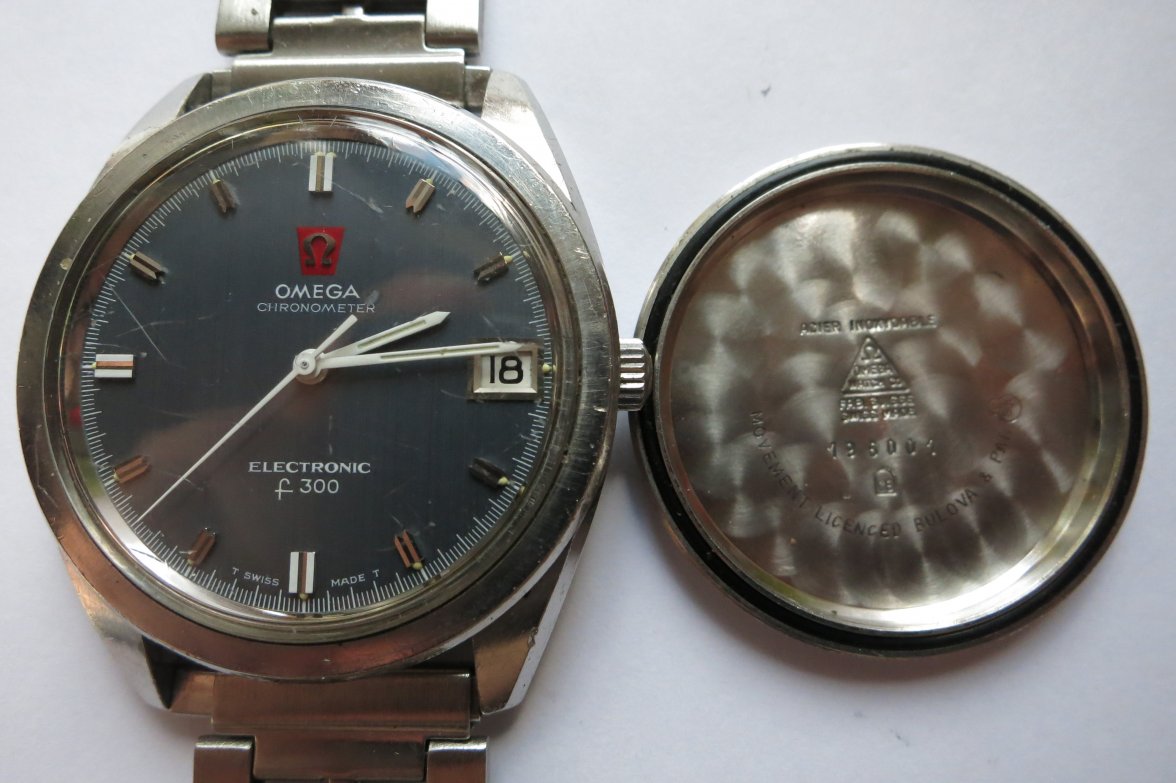

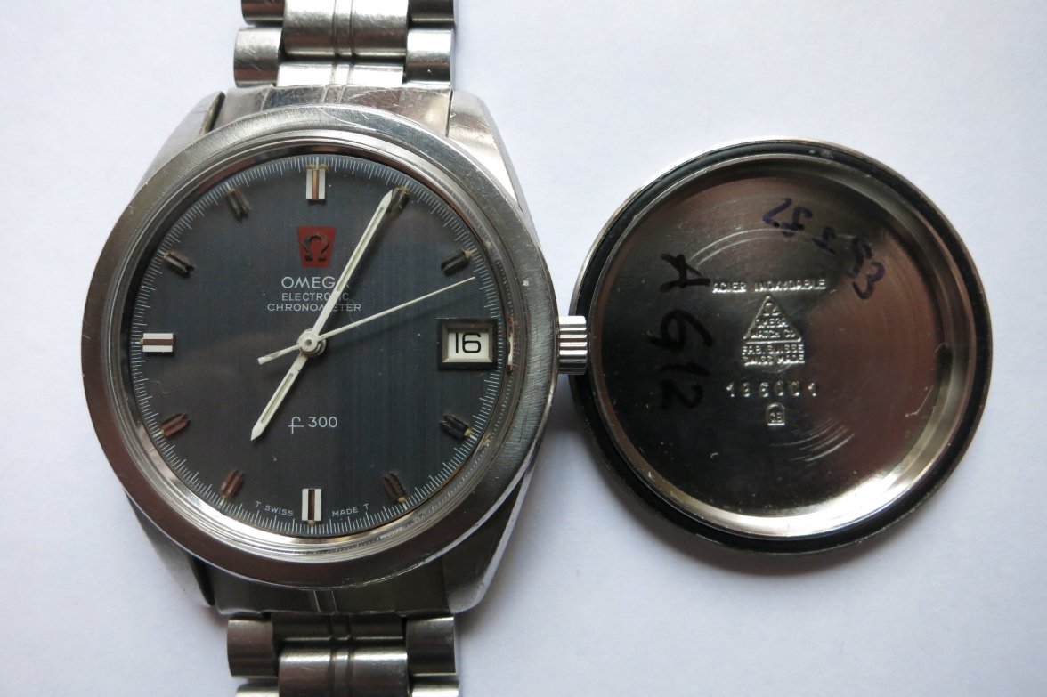

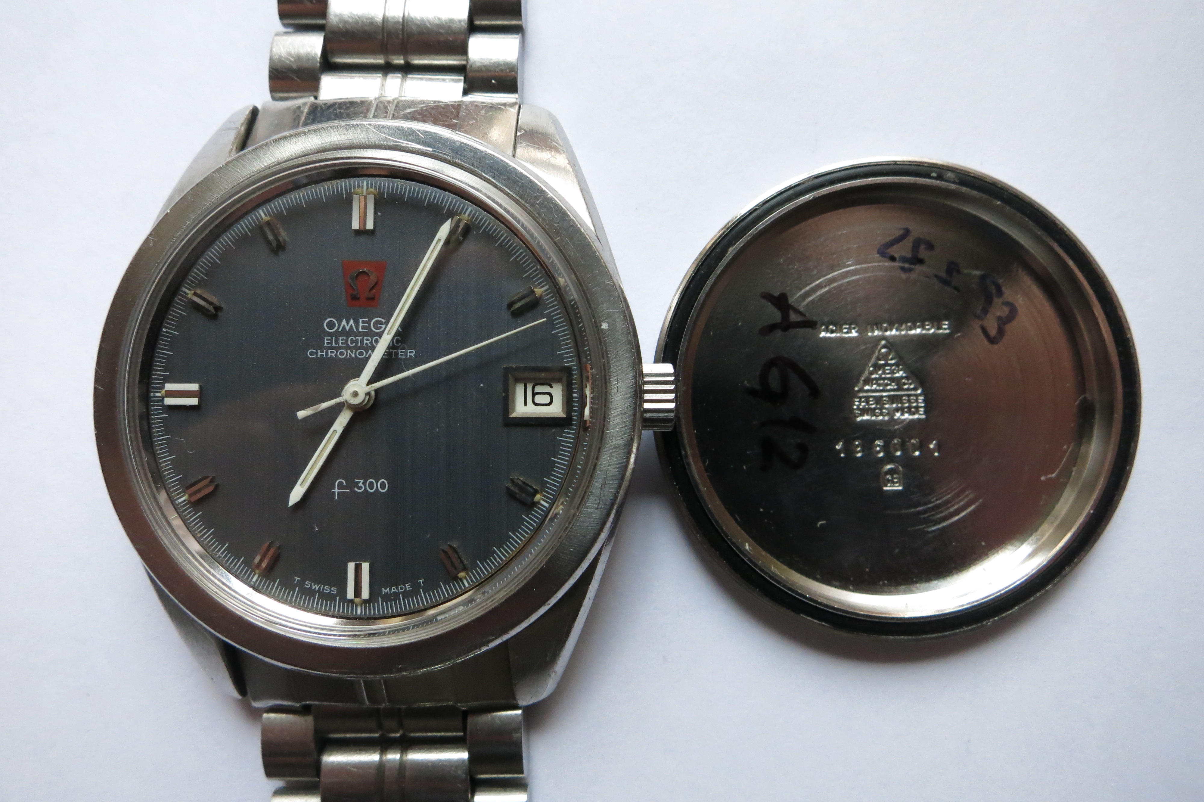

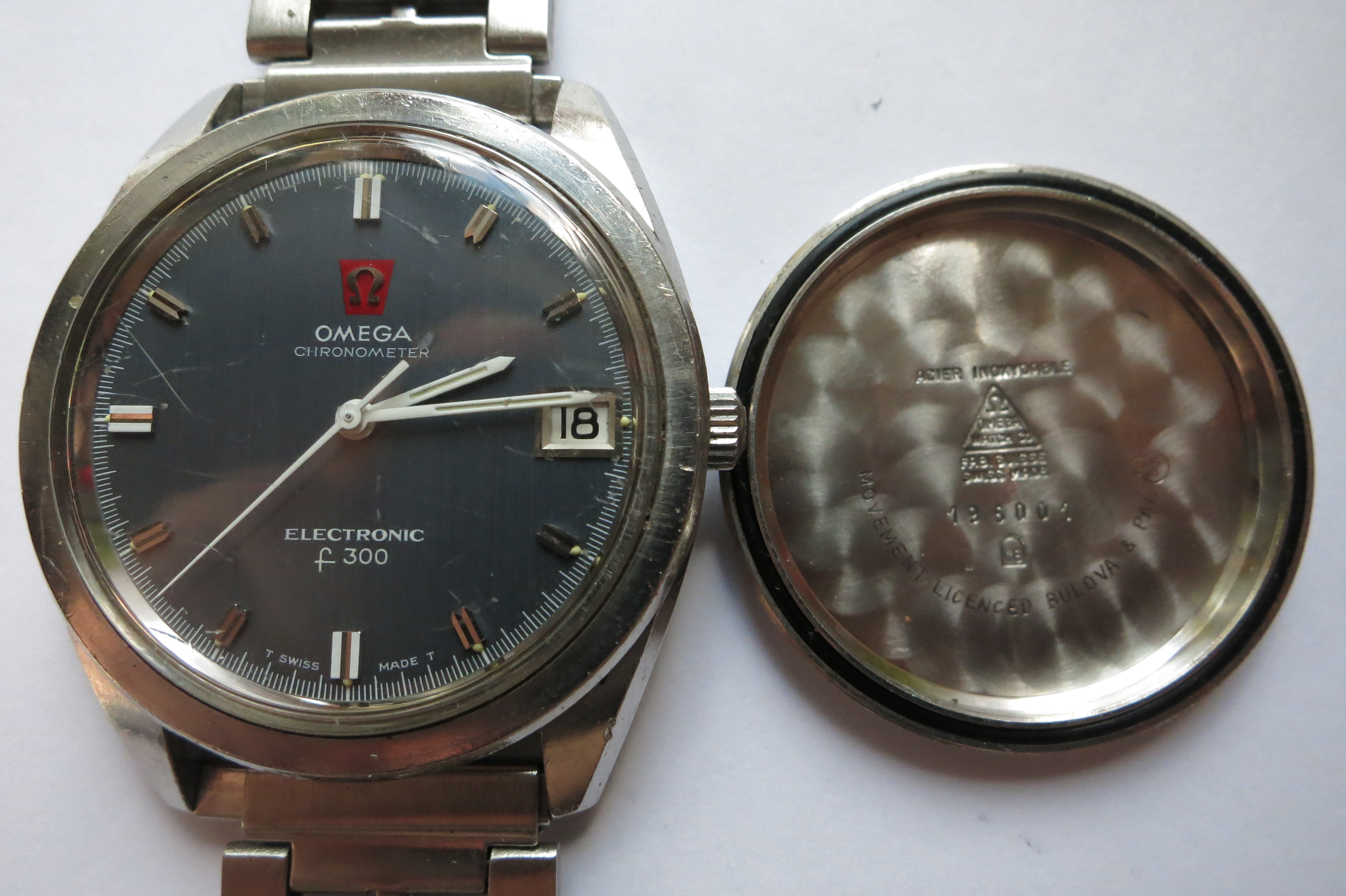

I have made a picture of the other watch as well and a closer shot of the case back.
This one has the Bulova patent stamp, but it looks like it has been engraved later then the rest. The serial number of the movement seems to be an early one (32.002.000).
10,804
16,814
Very interesting. I wonder if there is a significance in that both your 196.001s are CB (La Centrale Boîte) manufactured casebacks (and presumably cases). Off the top of my head, the majority I have seen are from other manufacturers or not marked so perhaps they did an early batch marked thus and lost the contract or ceased production or who knows! Having searched further, I have found a few of these advertised for sale and a NOS 196.001 case described as for the 1250 hummer movement for sale in Sweden so you are not the only one with a watch described thus. It is a bit of mystery alright.
