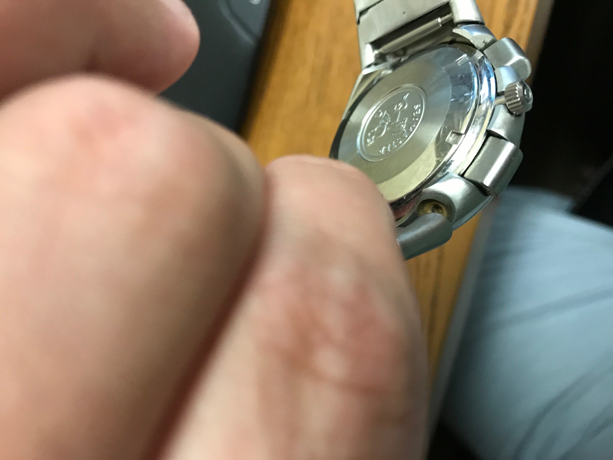

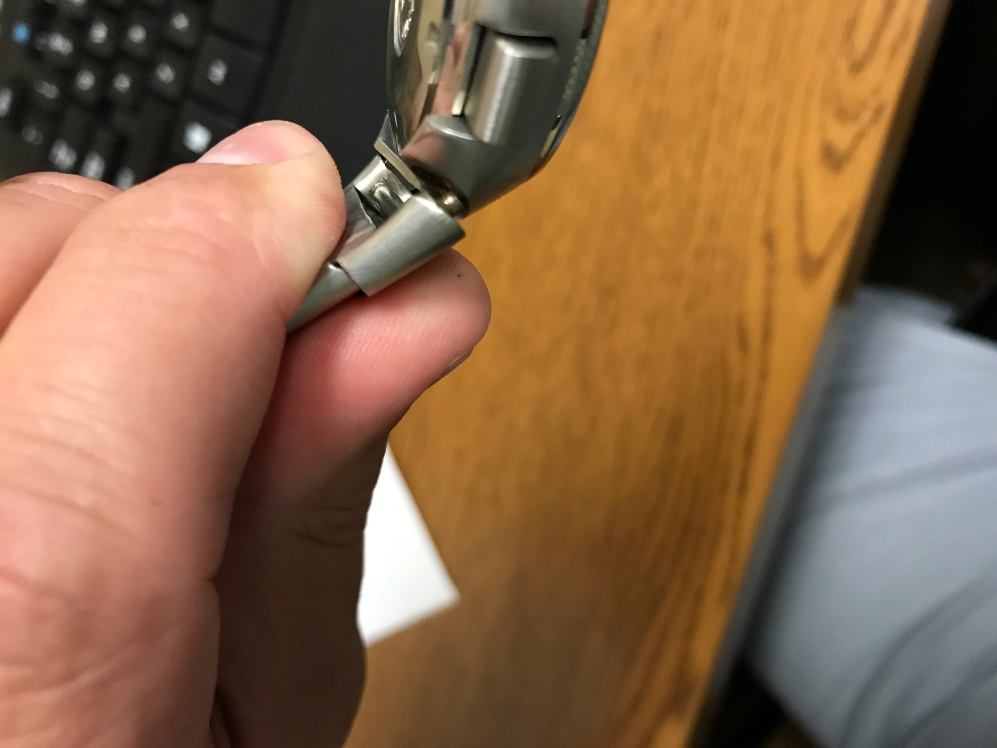

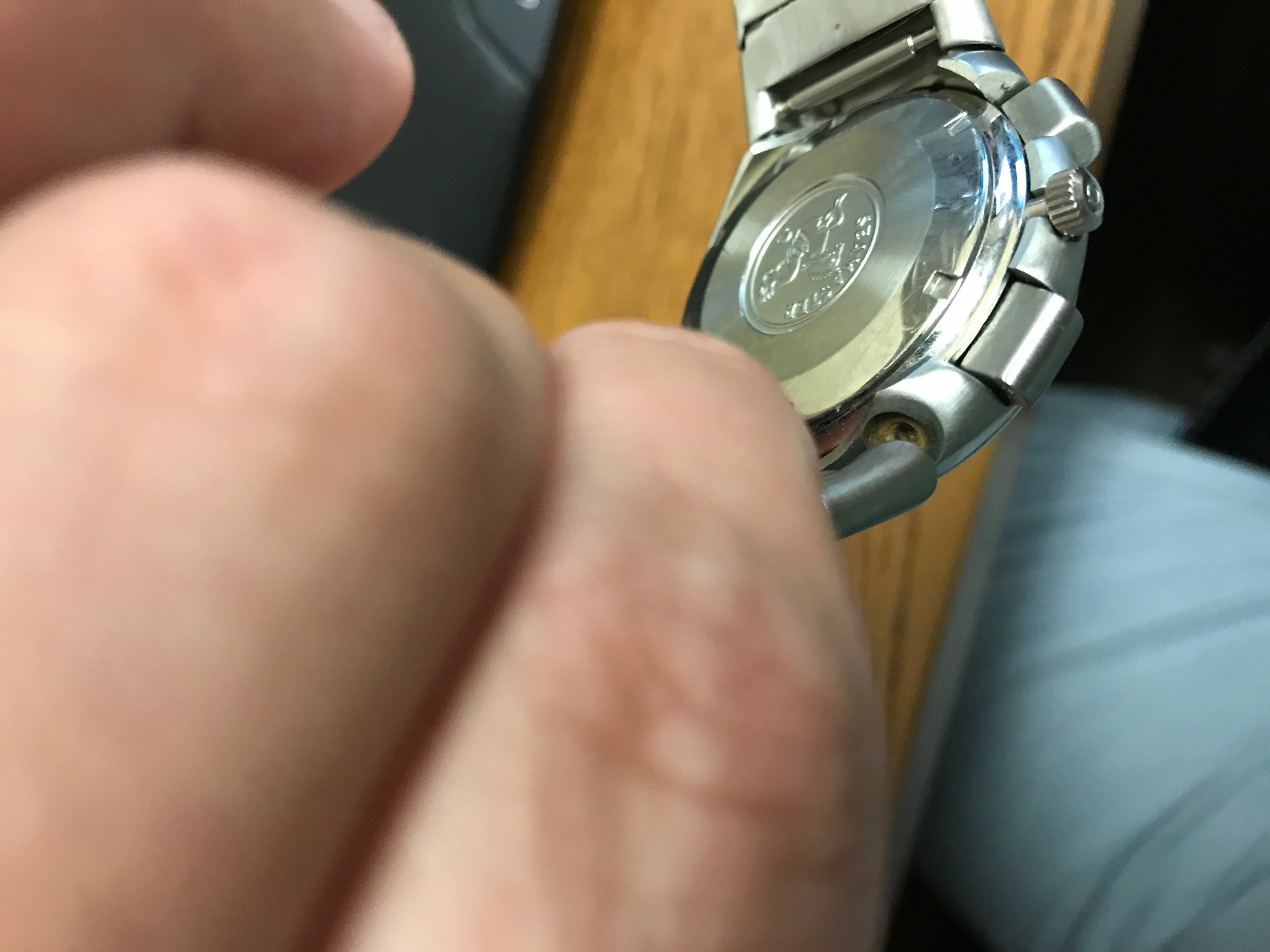

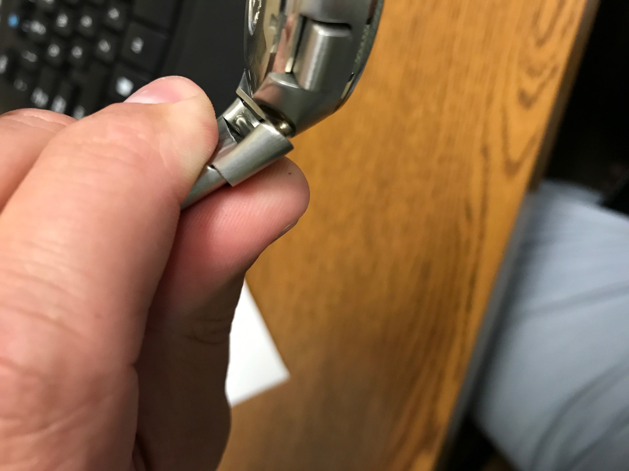

There seems to be a peg on the end-link that inserts into the body of the speedsonic. I don't know what is supposed to keep this peg connected to the body of the watch. I cant seem to find any diagrams or booklets of the Lobster bracelet
228
264
Sorry to say. But this is not the bracelet but the lug that is broken. They are screwed into the case. I think this could be fixed by laser welding or you could go to an Omega agent and ask if the single lug is available. The problem would be to remove the remaining piece from the case.
Here you can see the case without bracelet:
http://www.ebay.com/itm/OMEGA-SPEED...431360?hash=item1ec6a09440:g:3qkAAOSwjqVZC-e5

I have approx 60 of these Omega hummers, both f300 and Megasonic, two of them are Speedsonic. And one of the Megasonic has the lobster bracelet you are showing. What exacly has come of? Can you post a picture of the other side of the endlink? Here is one of the Megasonic:

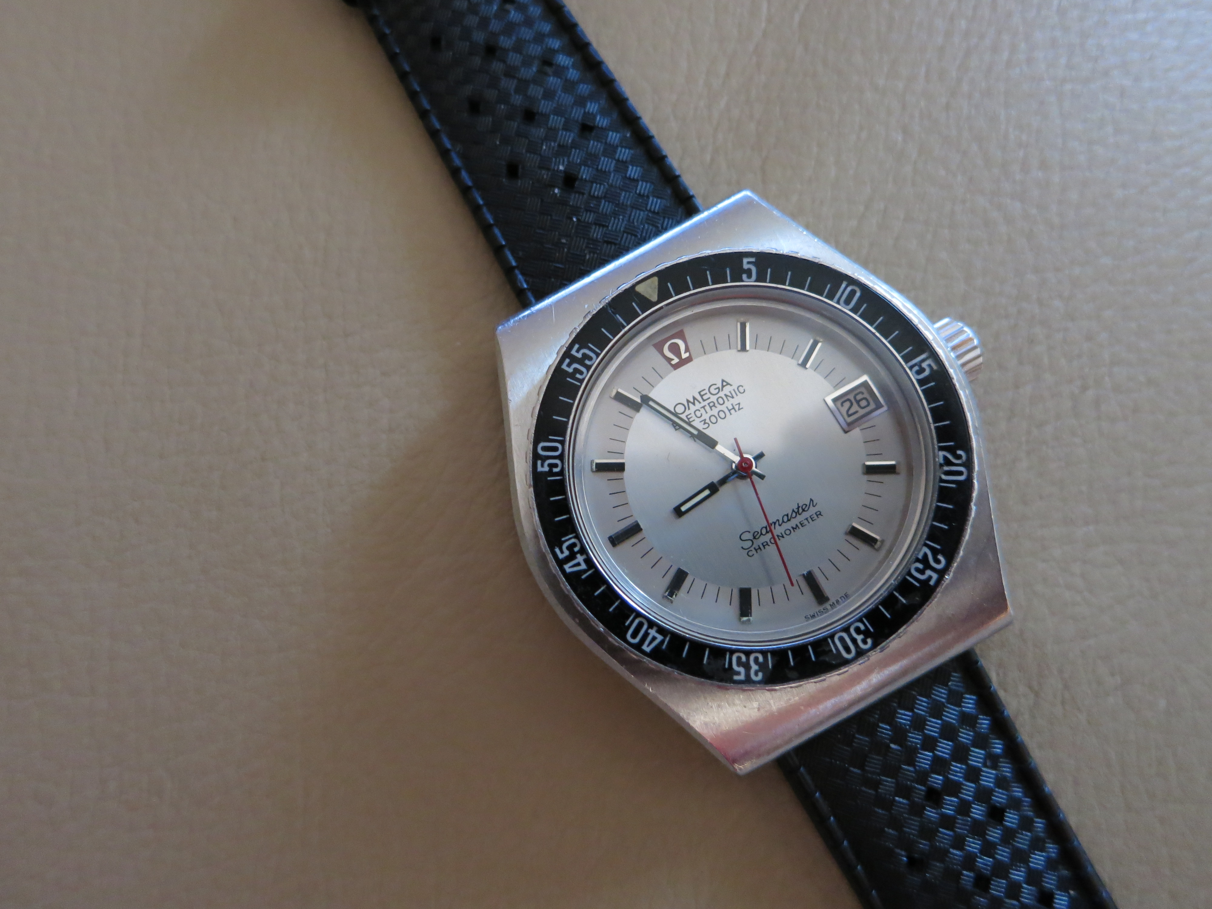

this looks like a 196.0030 with a Kal. 1310 to me😉
