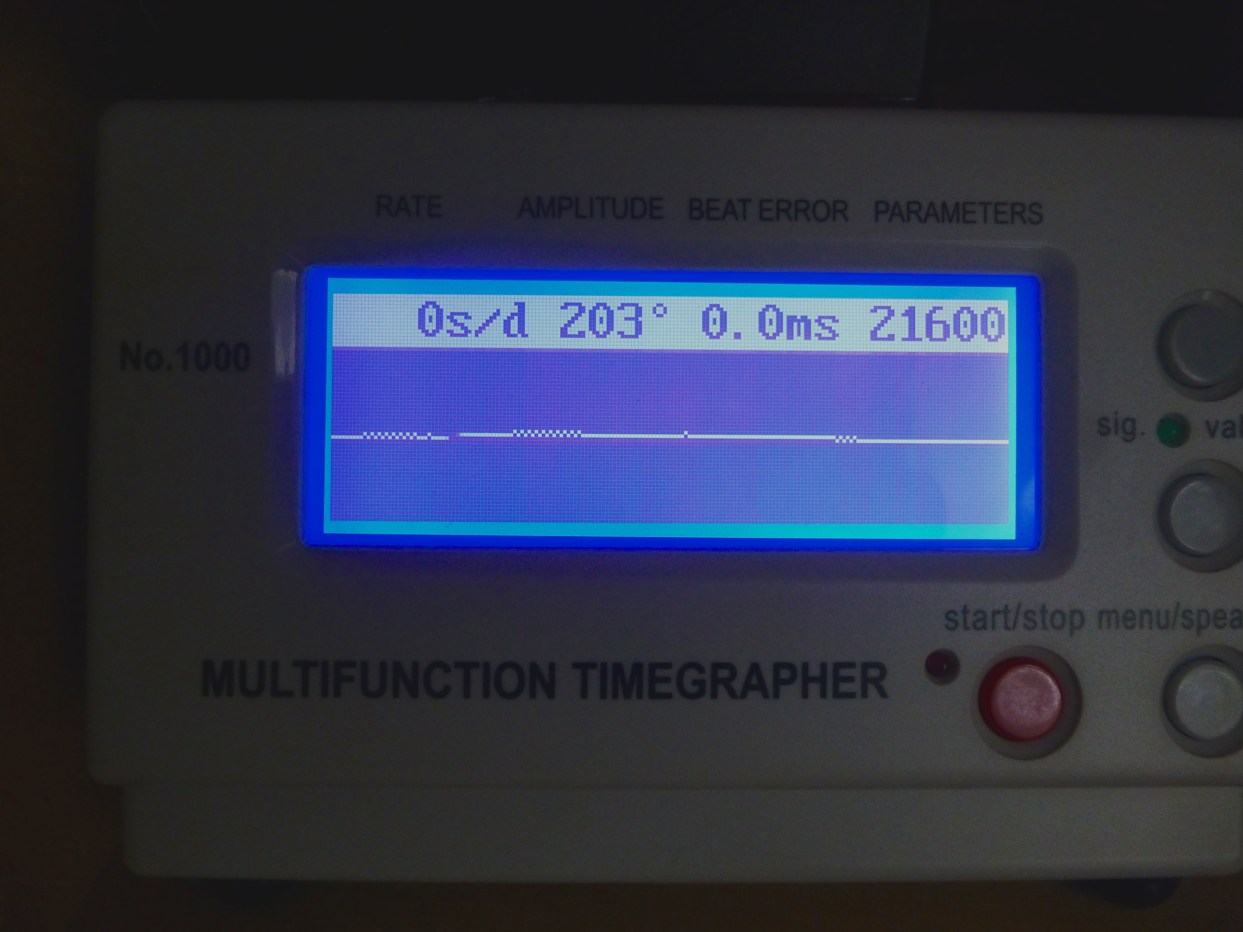

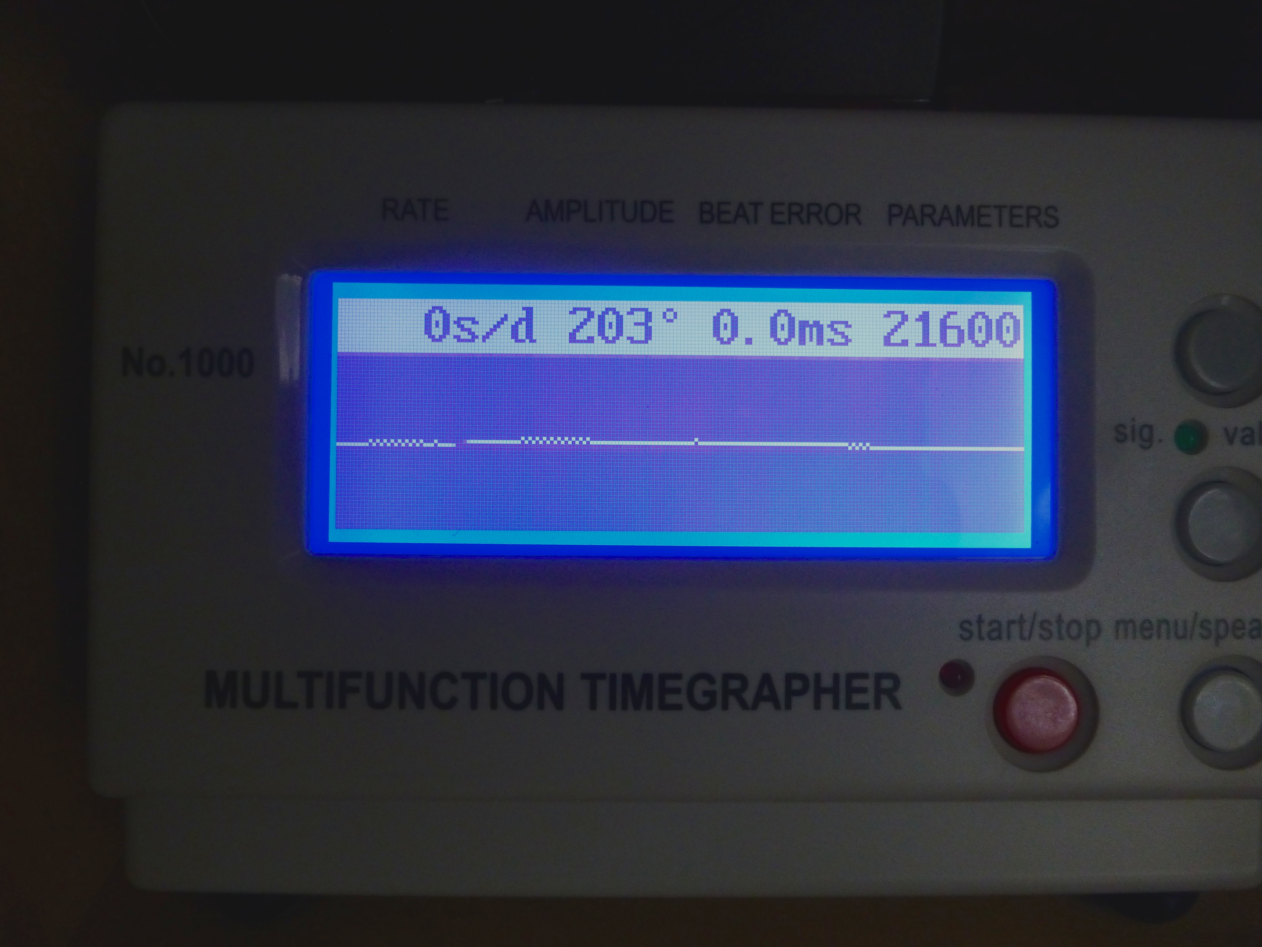

So after stripping, cleaning, drying and re-assembling the train, I'm getting this.
Not bad for a 30 year old movement that had never seen a screwdriver
Only tested in face down so far, will do the others maybe tomorrow.
Lift Angle set at 54.5 degrees, amplitude only about 200.
Or should it be better?
Comment invited.
(of course I showed the best trace, but 0 to -4 seconds per day is about the variation).

Hi Jim
This is a Seiko 6309 I think and my table of lift angle also shows 54.5 degrees. If you’ve just started it up, you might win 10% or so more amplitude after a few days running but that does seem low to start with. I have read somewhere that Seiko movements suffer from low amplitude as I have been experiencing lowish values on some Omega 550 series and discussed it with Al. It may have been he that mentioned the low Seiko amplitude but I’m not sure. If I can get 250 degrees with a 550 based movement, I am now more relaxed.
You really want the Seiko spec but for movements where I don’t have the specifications, I’ve been viewing minimum amplitude as 160 degrees at +24H because that’s what I’ve seen in the Omega specs. That would be for all 5 positions (excluding 12H) for me. I don’t think I’ve ever measured less than about 180 though at 24H even in a poor movement and I would not be too happy with that.
The Witschi training “Measuring Technology and Troubleshooting for Watches” on Page 15 shows:
250-330 for horizontal at full wind and 210-280 at +24H.
250-270 for vertical at full wind and 210-230 at +24H.
I think these are a bit ambitious for some of the old movements we have but most of mine fit in those values or are close. Let’s see if Al says anything about this. Nice straight line in your graph so the wheels all seem to be running true. No beat error - is this an adjustable stud carrier or do you have to move the collet?

Jim - If that's full wind in a horizontal position, that's pretty low, even for a Seiko. I would hope to see something more like 240+ full wind horizontal if you can get it.
Chris - yes that was probably me who told you that. The first Seiko I did I could not get up to what I consider a normal range, and when I asked some other watchmakers about it, they all told me the same thing - Seikos tend not to have great amplitude. I don't service a lot of them, but this is the case for every one I've ever serviced - the highest I think I've seen going through a few photos just now is in the 260's.

Thanks for the feedback, especially Al (always informative).
Amplitude has come up to 220 max and keeping reasonable time although the beat error crept up to 0.2ms so I'll have to tweak that.
Reading in various places, it seems that 6309s seem to function perfectly well between 180 and 230 so while Swiss movements are much higher. So if I can't get it higher I'll call it a day.
It is after all it's first service in over thirty or so years, and I don't have the high level skills of a pro watchmaker which is probably what's needed to get it really swinging.
Update in a few days after I get it cased and time it in the case with all of the additional components fitted.

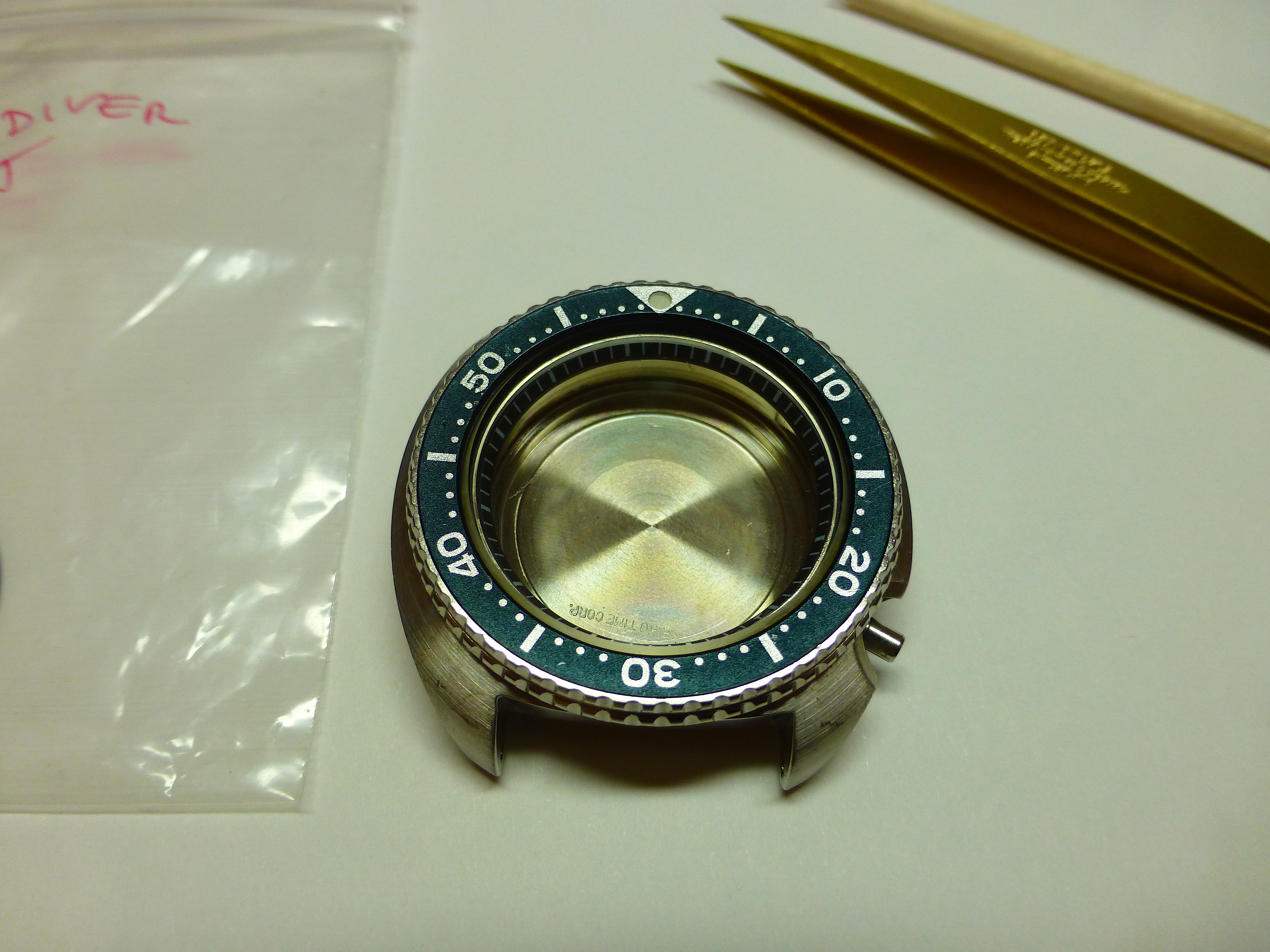

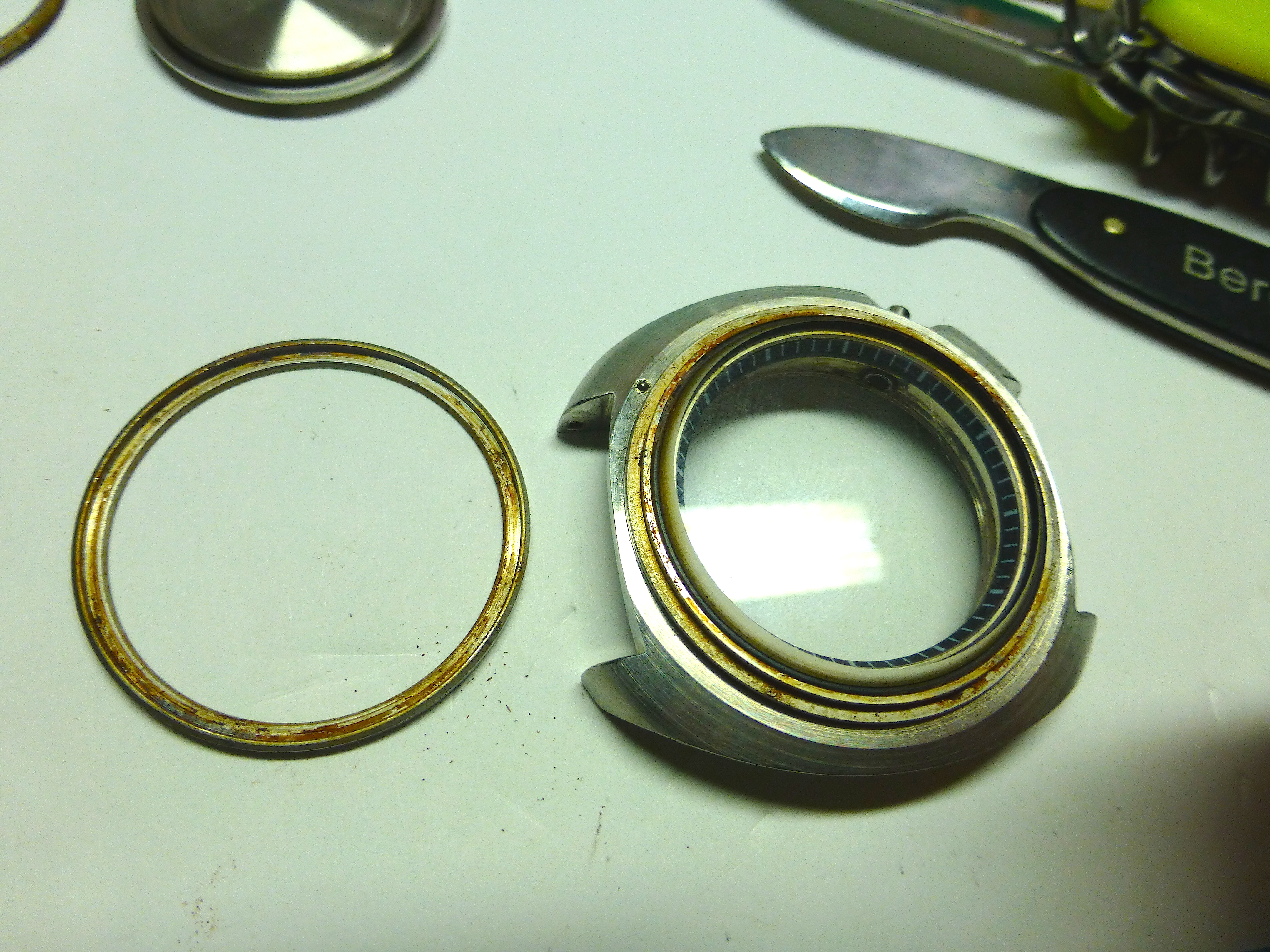

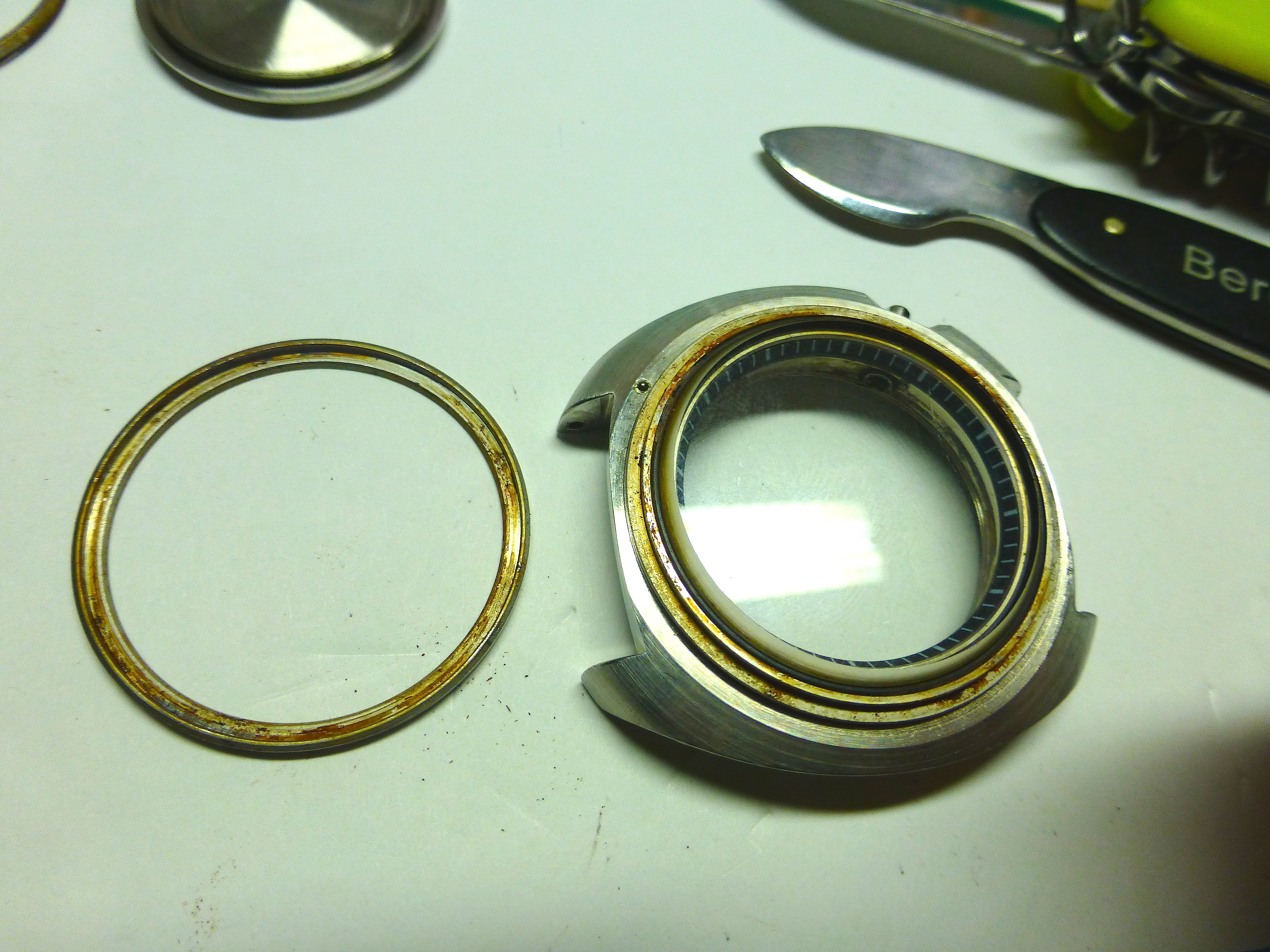

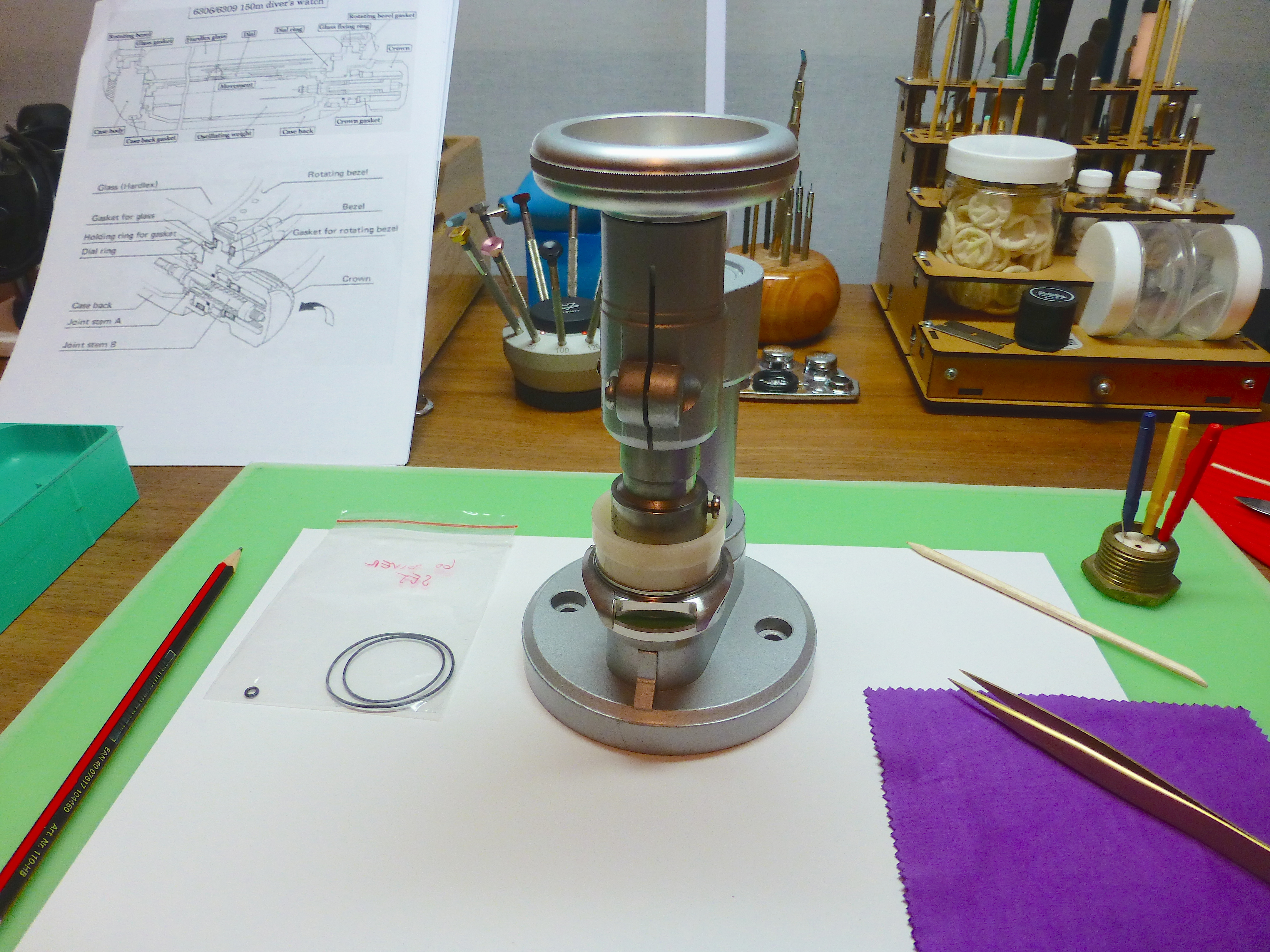

Now that the movement has been done, time for the case.
The bezel area looked OK, but I thought I'd have a look underneath.
Ummmmmmm.............

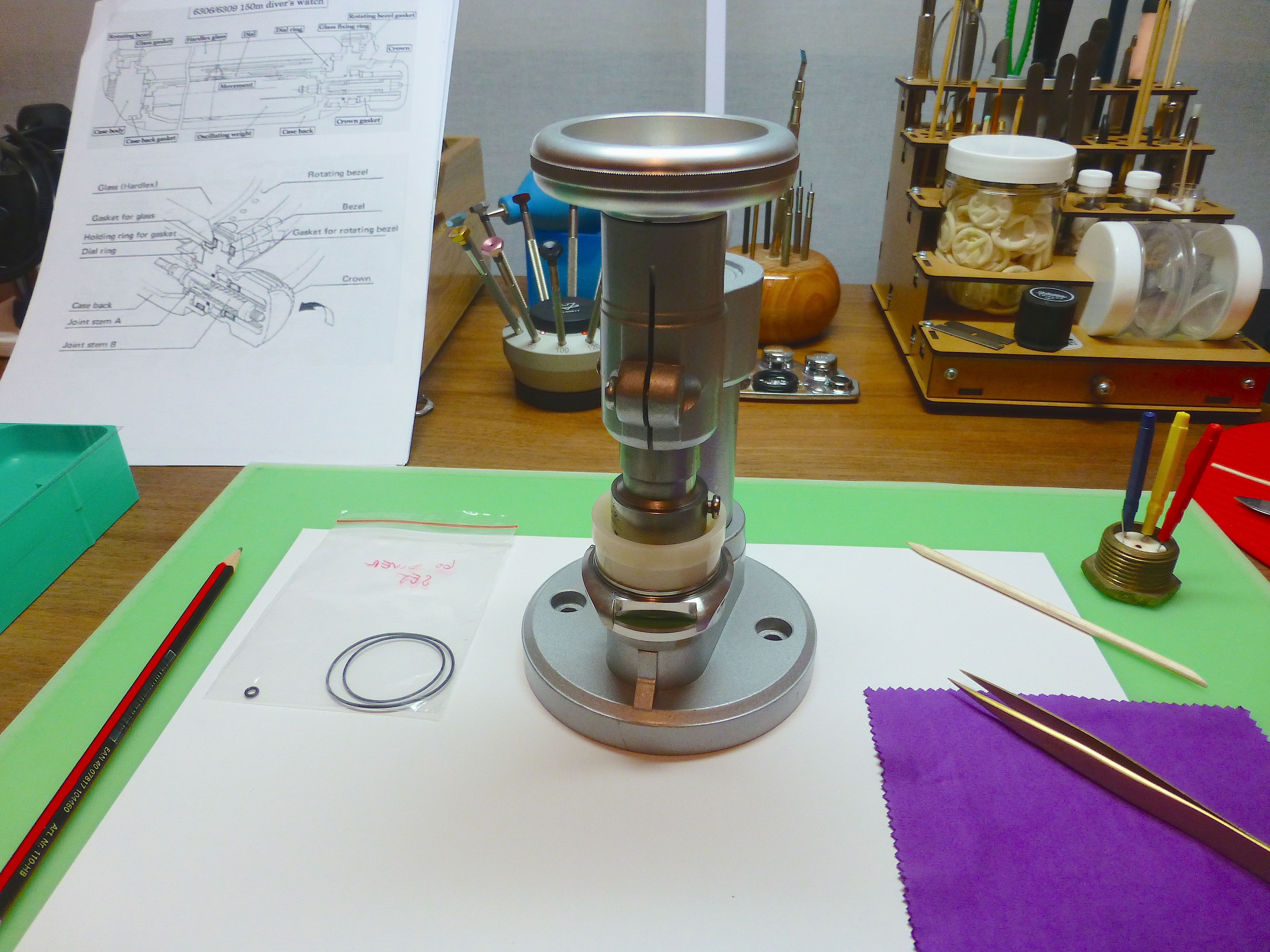

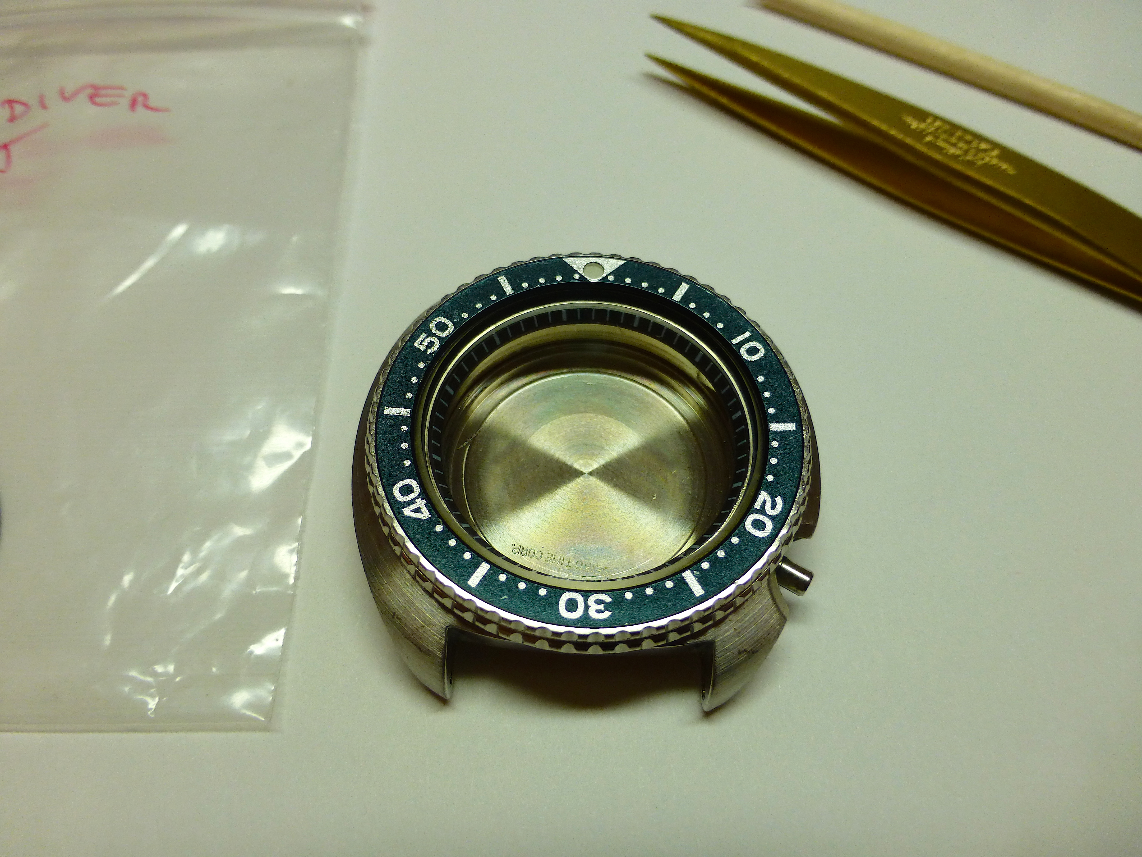

So remove all components and clean, wire brush the rust from the stainless rings, ultrasonic clean, lube the old crystal gasket, re-assemble.
Then bezel cleaned and dried, new bezel o-ring, bezel click oiled and back together. Looks ready for the movement!
(that bezel is beautiful, only @STANDY has a better one 😉 )
I was tempted to polish the case a bit, but it has nice soft wear without any serious gouges so I've left it to match the age of the rest of the watch.
So that's where we are at the moment. I'm waiting for a new crown/stem/spring (first one was faulty 😡 ) and then I can get it all back together and adjust it.

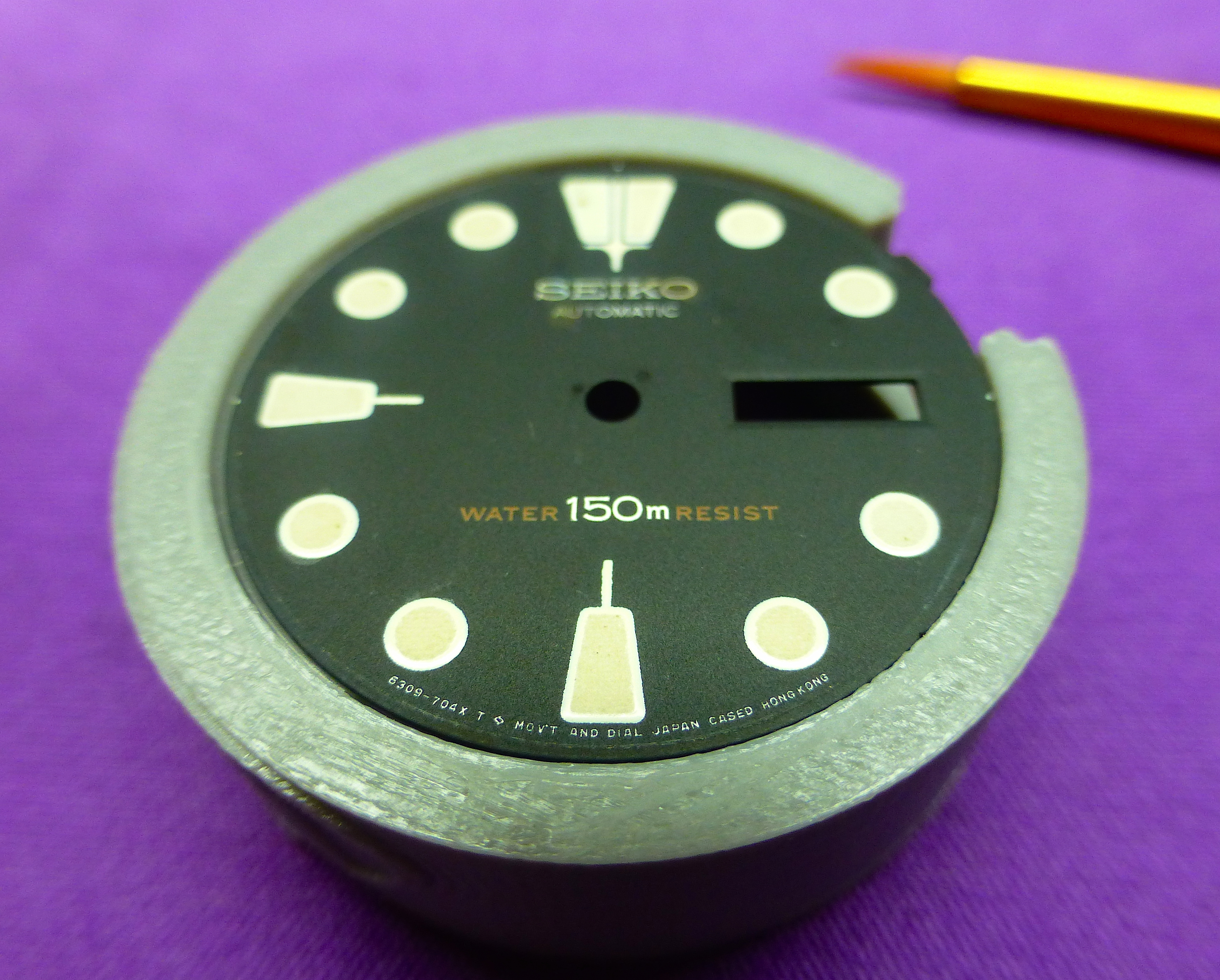

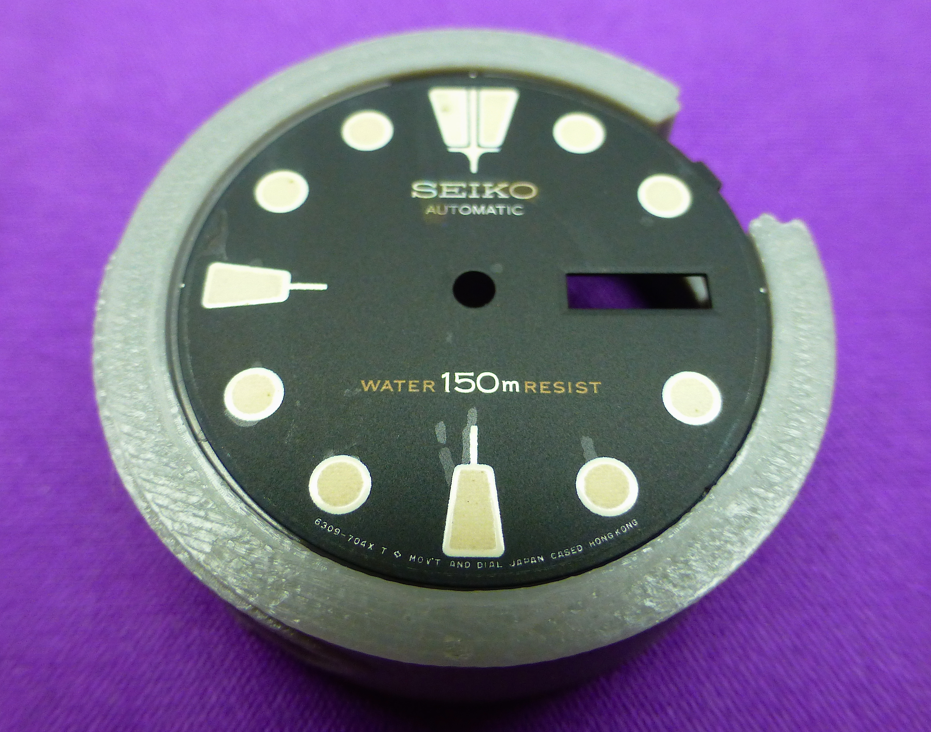

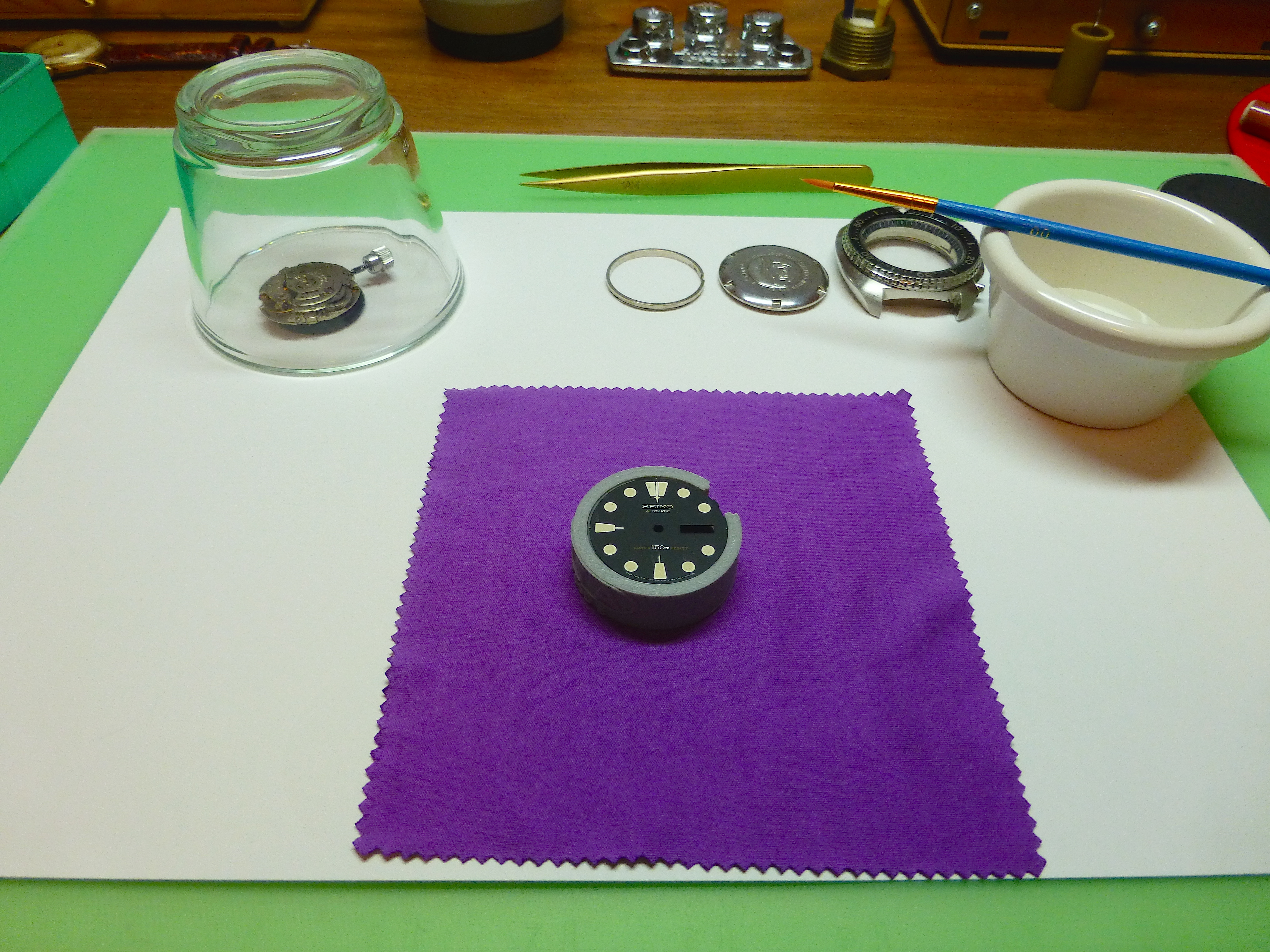

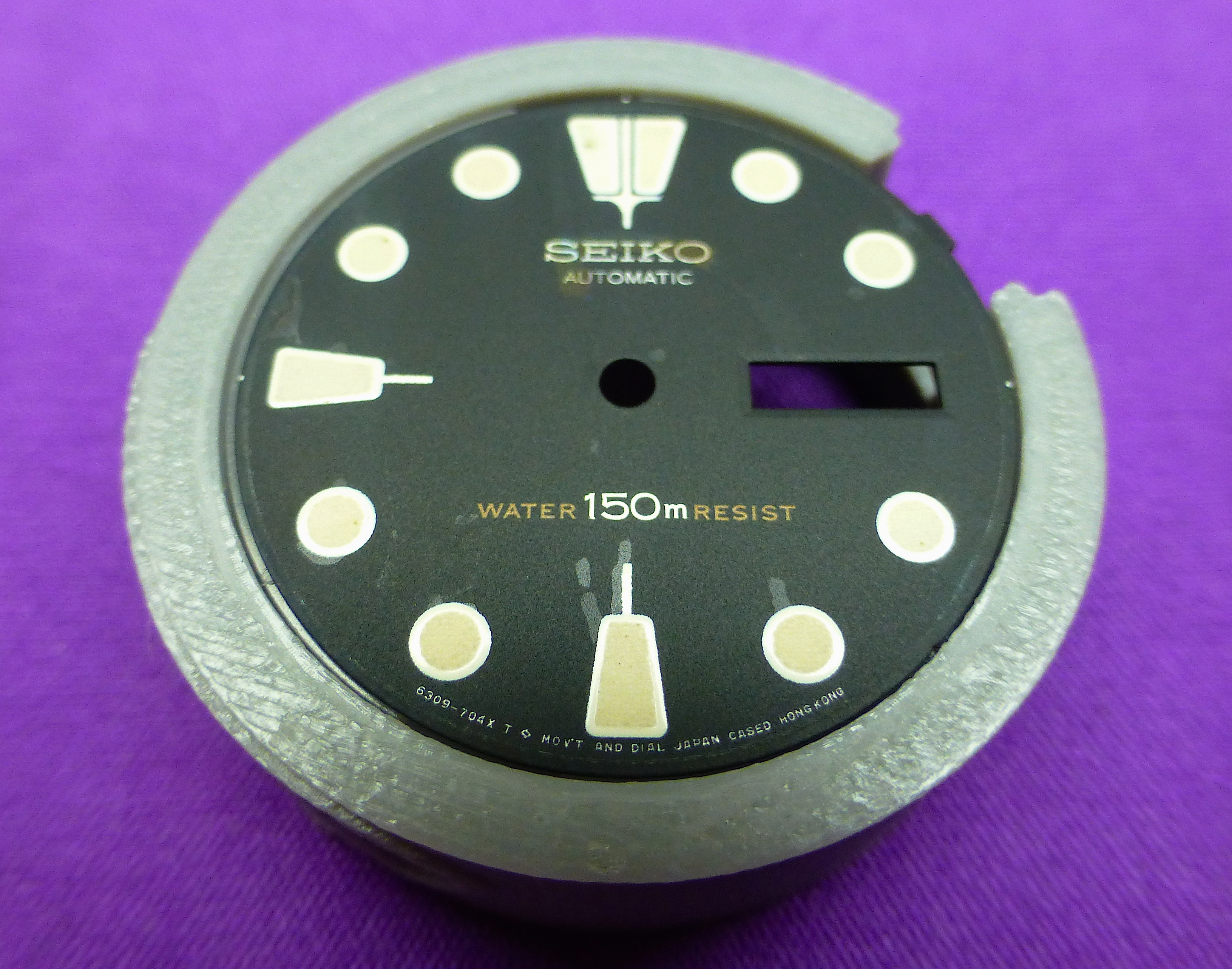

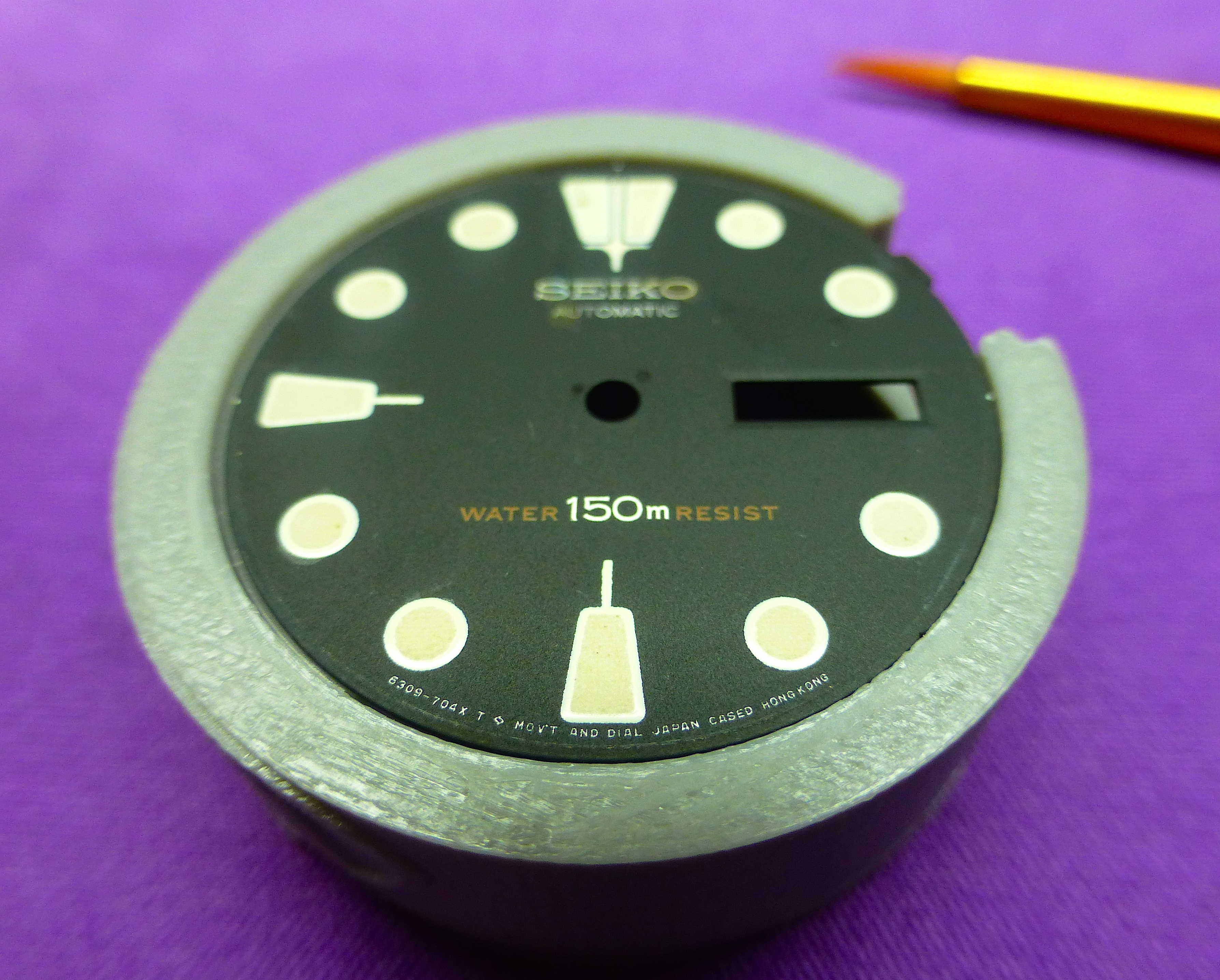

So what's going on here?
The dial had some runs coming from the lume, probably due to the large amount of condensation, you can see the little tracks running up from the lower markers, some more on the others as well.
After seeing some dial restore horror stories, I decided to do a minimalist clean. So with some purified water and a teeny camel hair brush, I gritted my teeth and got to work.
While not back to NOS, it's as far as I wanted to go and still let the dial show some age. A lot better I think.

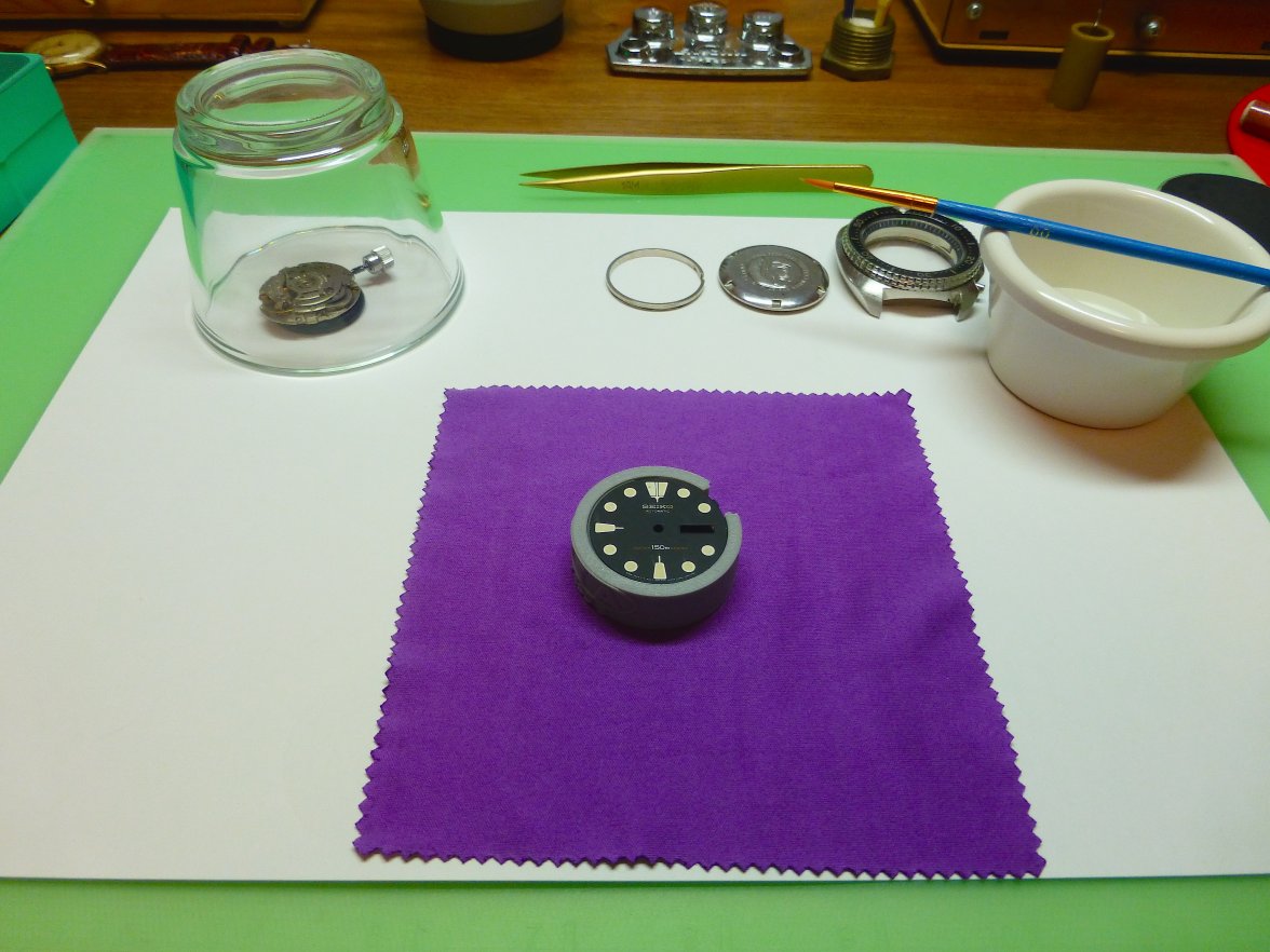

Now to case it up ready for final regulation.
2,219
4,955
That's a terrific improvement Jim. I am very nervous about doing anything like that but you've given me some (probably misplaced) confidence. Thanks.
18,808
39,076
I admit I was a bit apprehensive, but using the smallest brush (trimmed of stray hairs) dipped in body temperature water and then wiped on a tissue before gently touching the brush to the marks. Keep repeating until the brush has picked up all of the residue.
I didn't go onto the markers or the print just in case it got nasty.
I might dig out some old dials and practice various tecniques, but not the dishwasher method (just yet).
