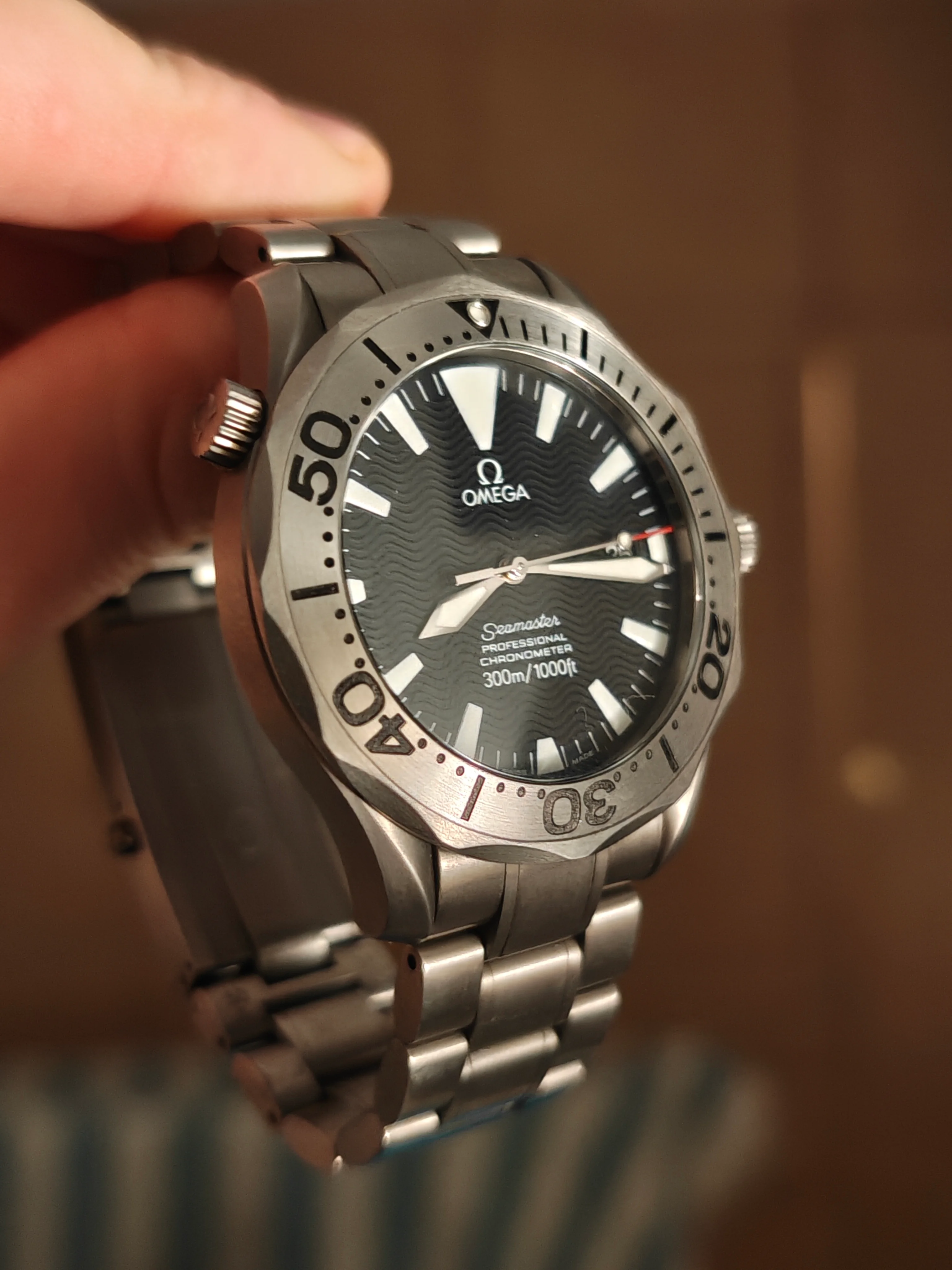

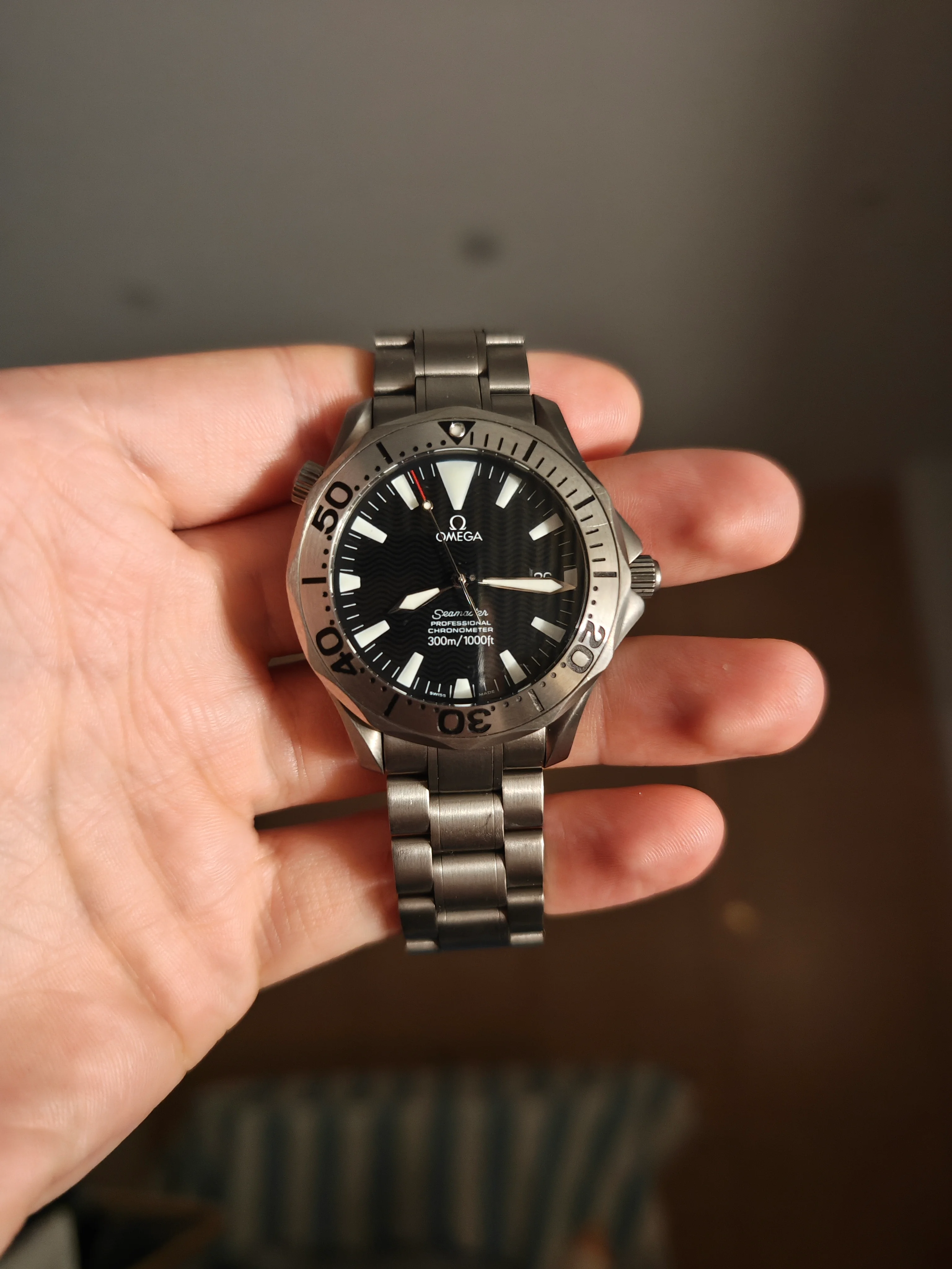

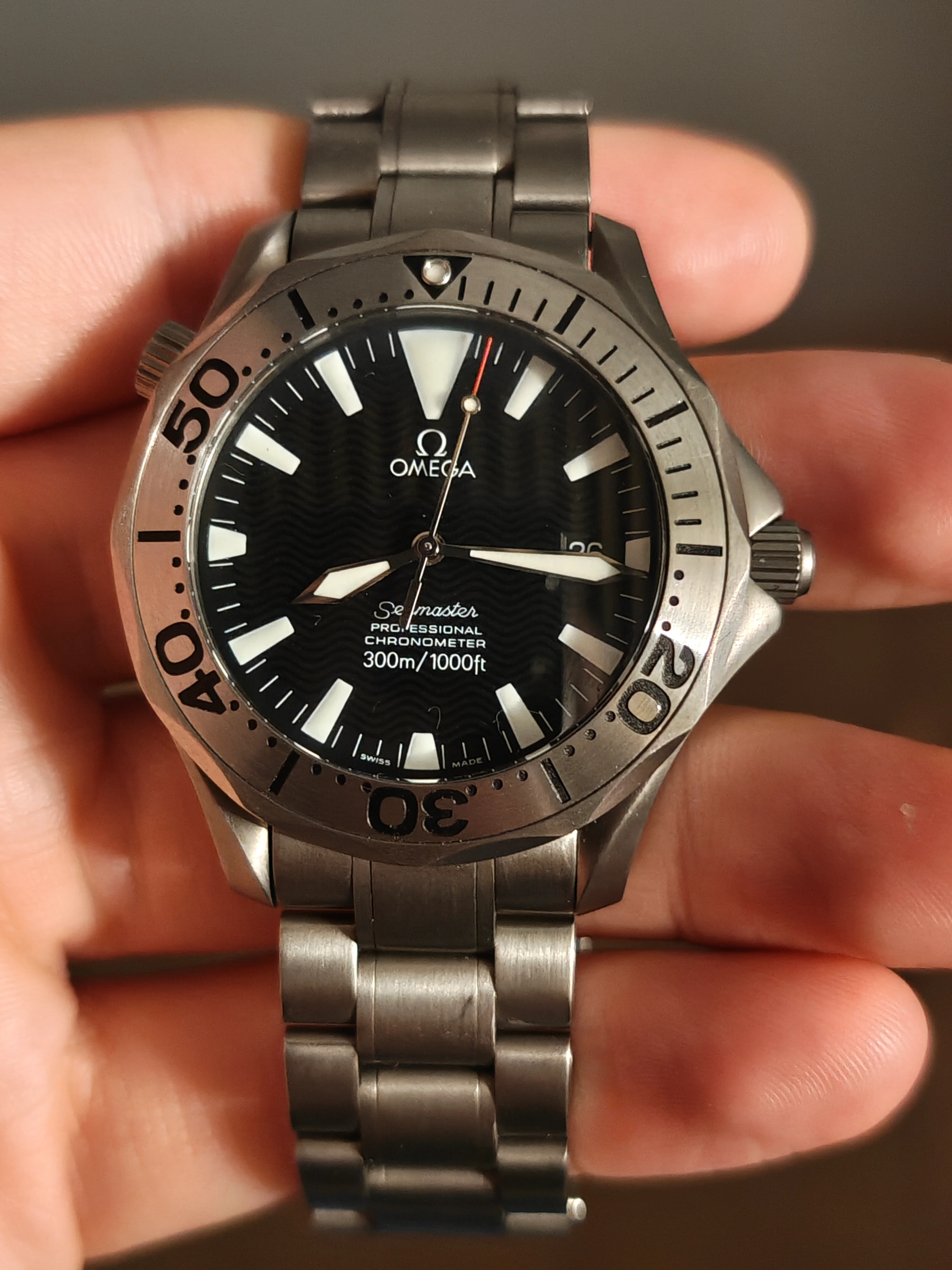

I've bought a mint brand new Omega Seamaster 2231.50 titanium which is my favourite model from Omega. It still had the red seal factory mark where the caseback meets the case so it's never been opened. Condition was mint when I got it and it's running very, very well about +2 seconds a day with my testing. My question is, should I wear it and enjoy it or should I send it for a service. I take it all of the lubricant and oils have dried up by now.
I'm curious to know what more experienced watch makers think of this?
