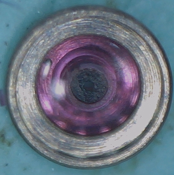

    The only reason the owner paid any attention to it was due to condensation under the crystal.
    I said I'd open it and dry it out for him. After opening I saw the insides. That was when I asked him the question.
    So we agreed on a strip, clean and lubricate.
    This was the balance jewel, note the pool of black gludge in the oil well. :confused:
    The cap jewel also had a nice little mound of black crud dead centre
    As our mentors here say, just because it works doesn't mean regular servicing can be ignored.

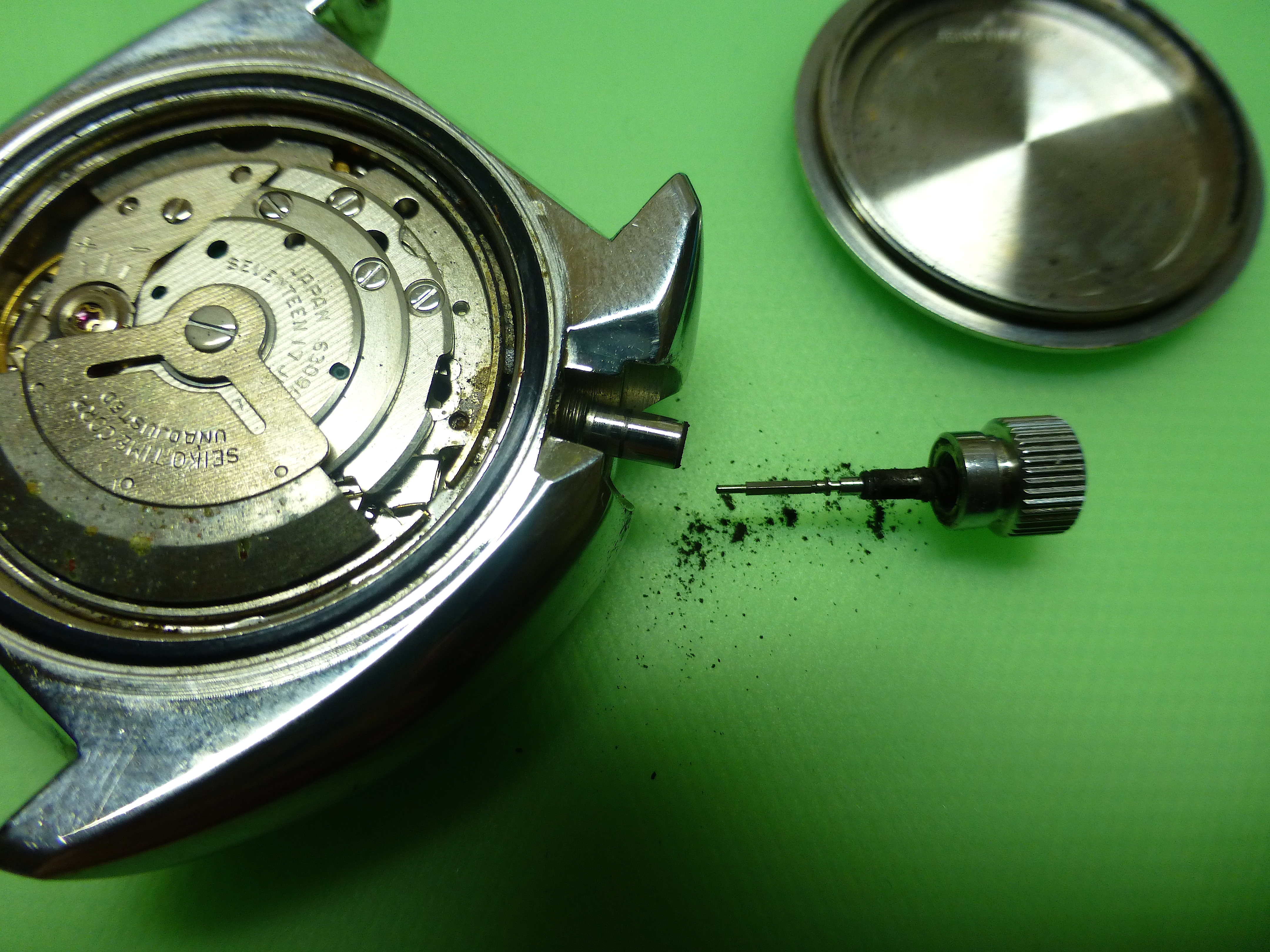

  3. JimInOz Melbourne Australia Apr 19, 2015
    15,476
    32,329
    I neglected to do much photography as it was going to be a quick "dry and seal back up".
    But here's the first pic that made me go "Uh Oh!".

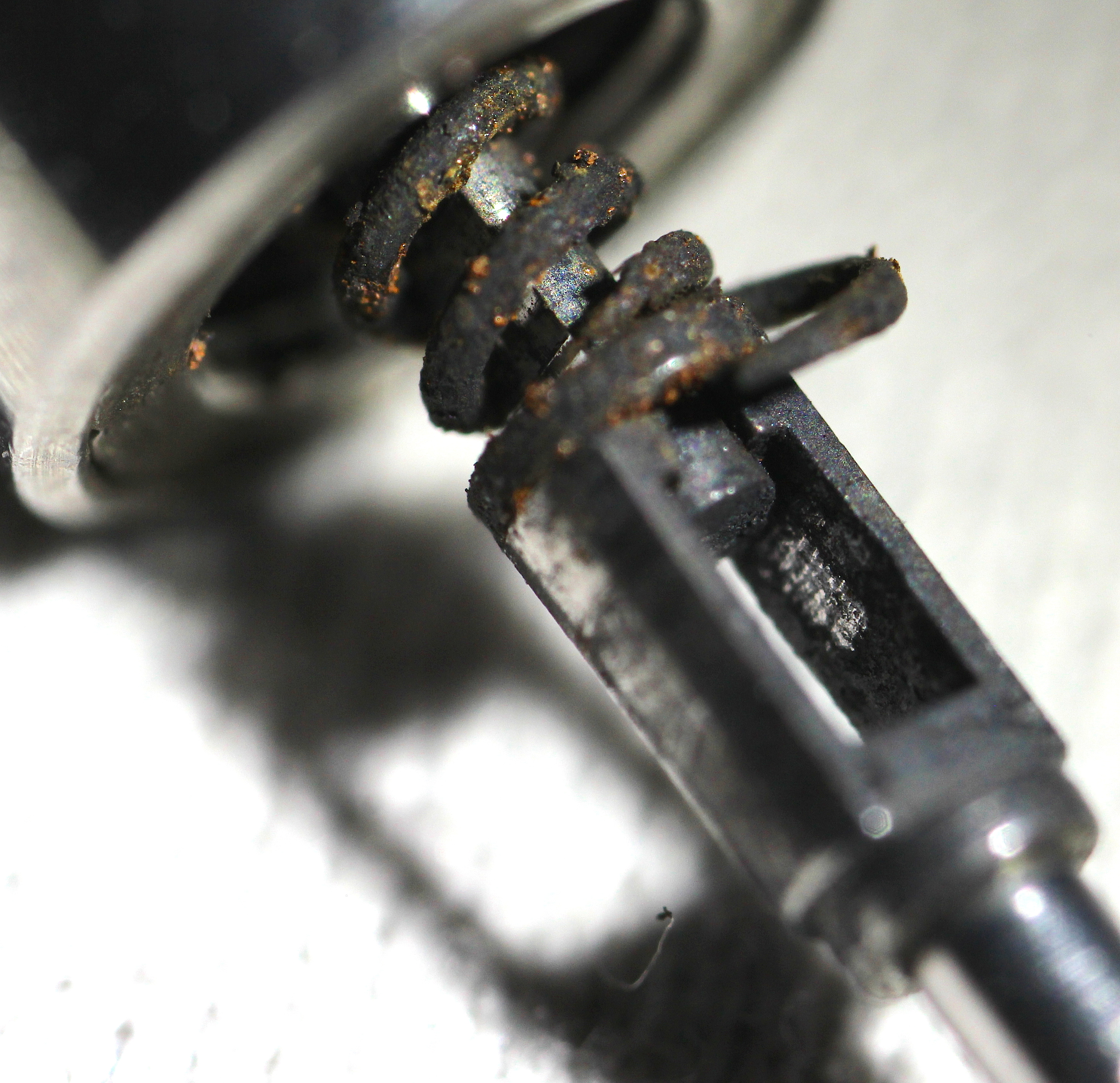

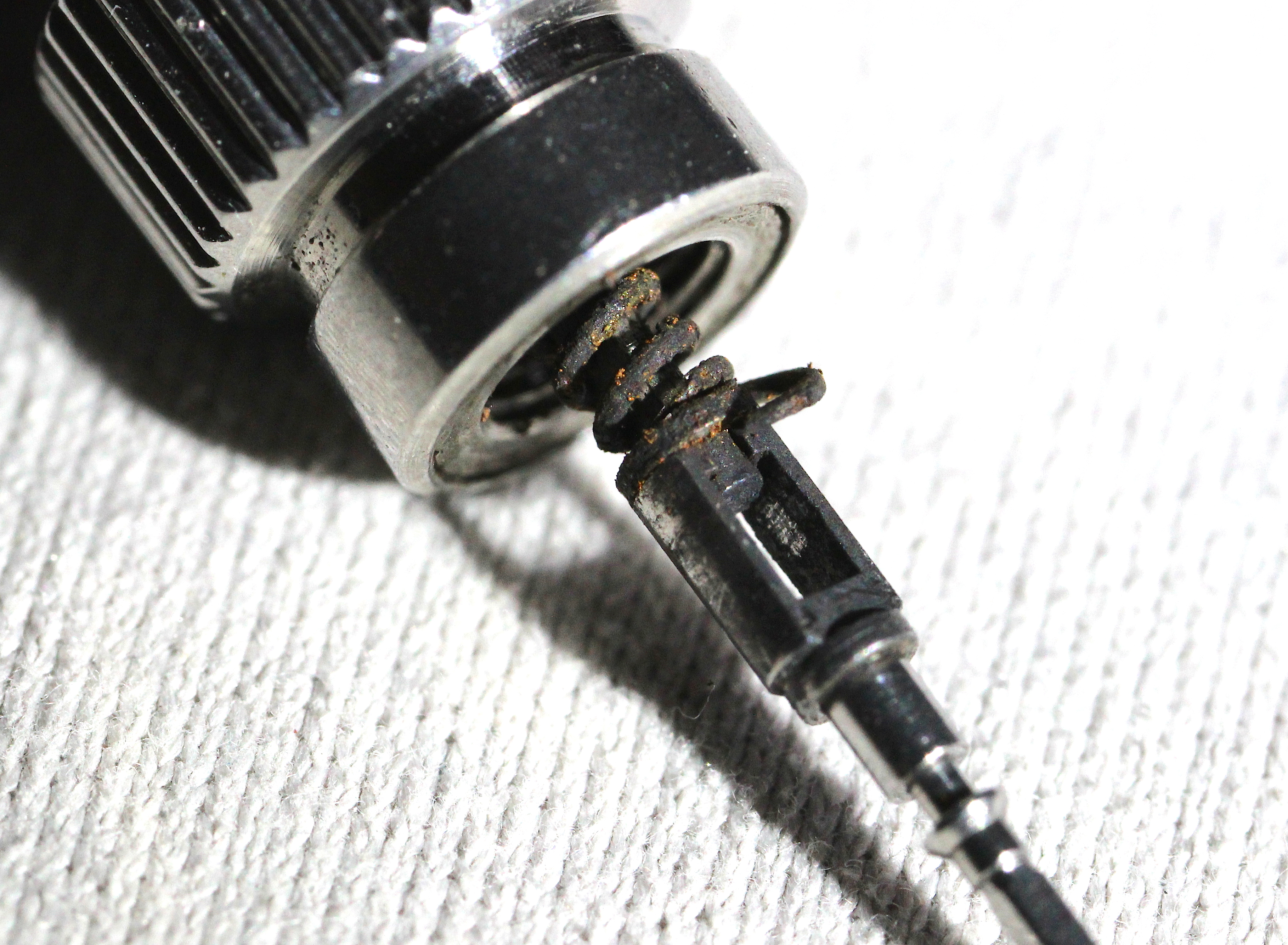

  10. JimInOz Melbourne Australia Apr 22, 2015
    15,476
    32,329
    I don't think I can save the spring :rolleyes:
    But I might save the rest, but will probably try to find a better crown/stem assembly.

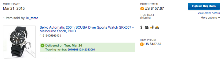

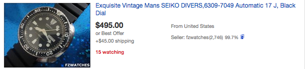

  18. JimInOz Melbourne Australia Apr 30, 2015
    15,476
    32,329
    Why list it cheap?
    Do it this way.
    Sell for $495.
    Buy for $157 (Practically the same, brand new versus 30 year old cluncker)
    Spend the profit on other watch bits!
    :D
    KIMBER likes this.
