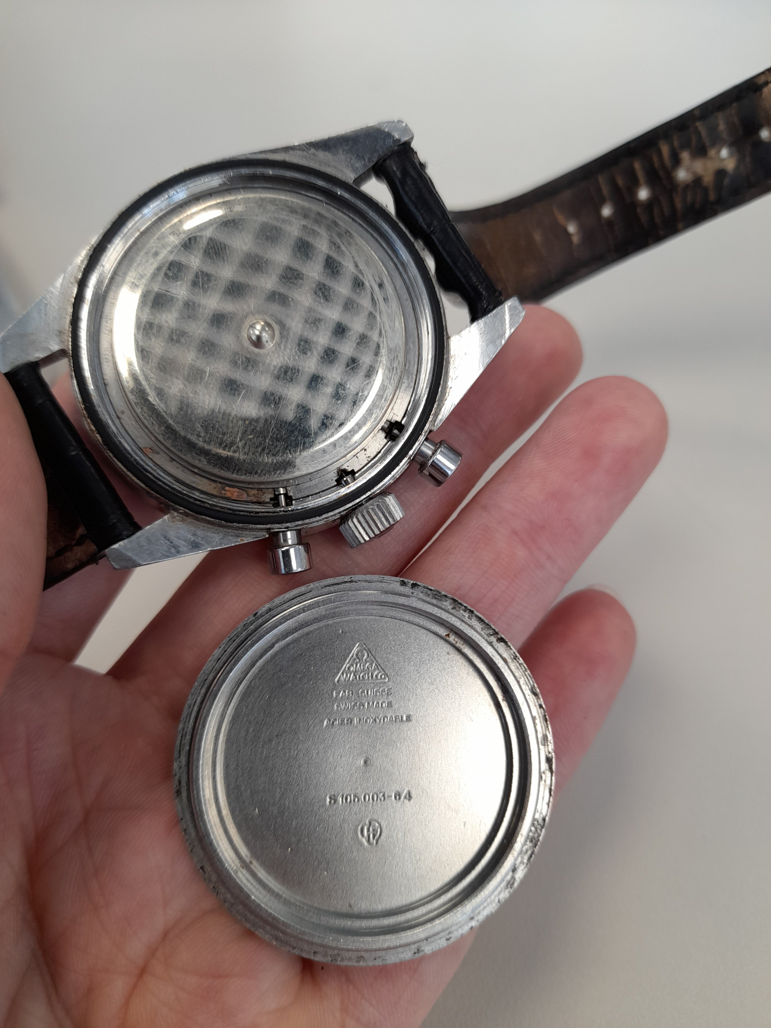

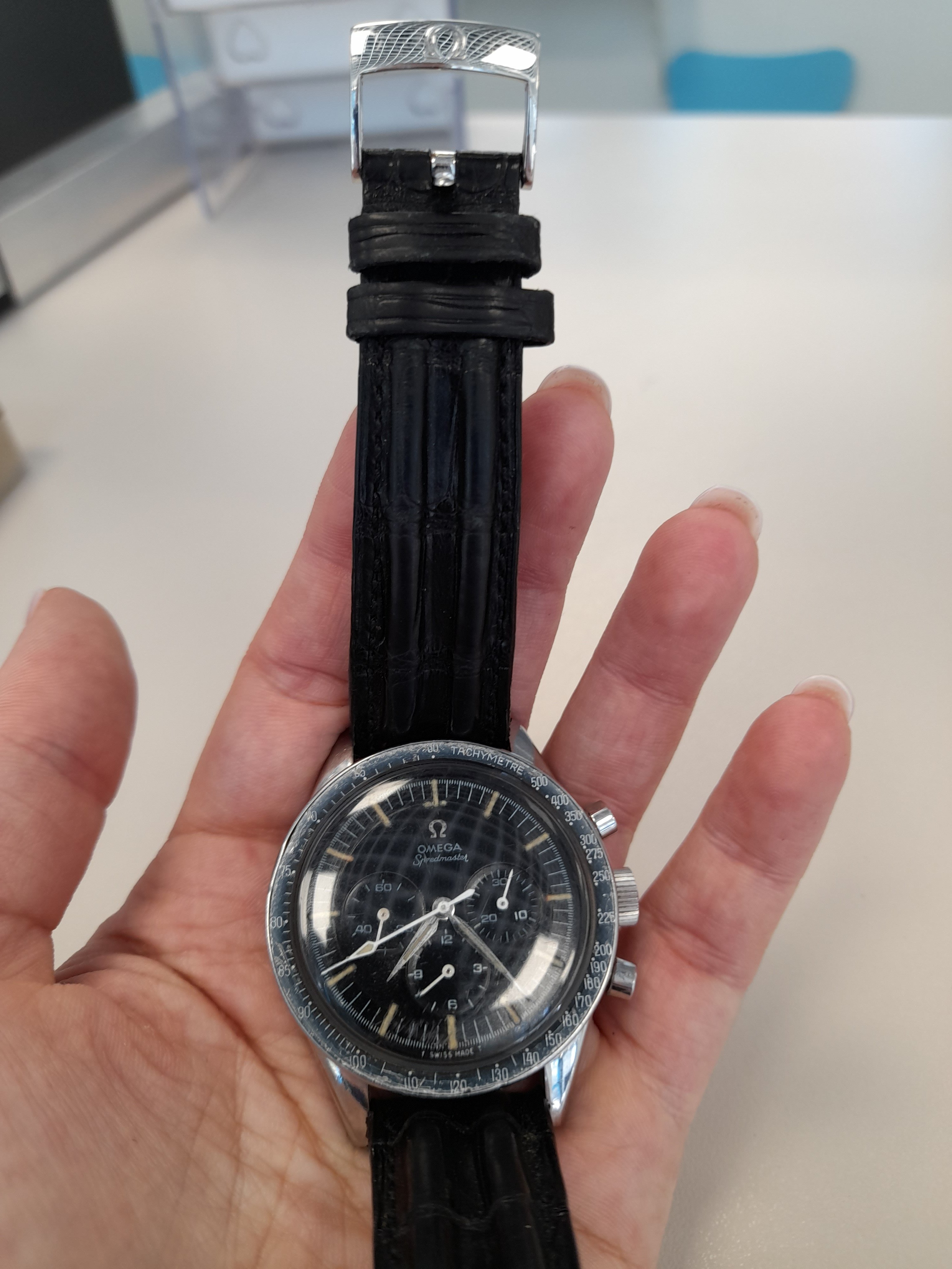

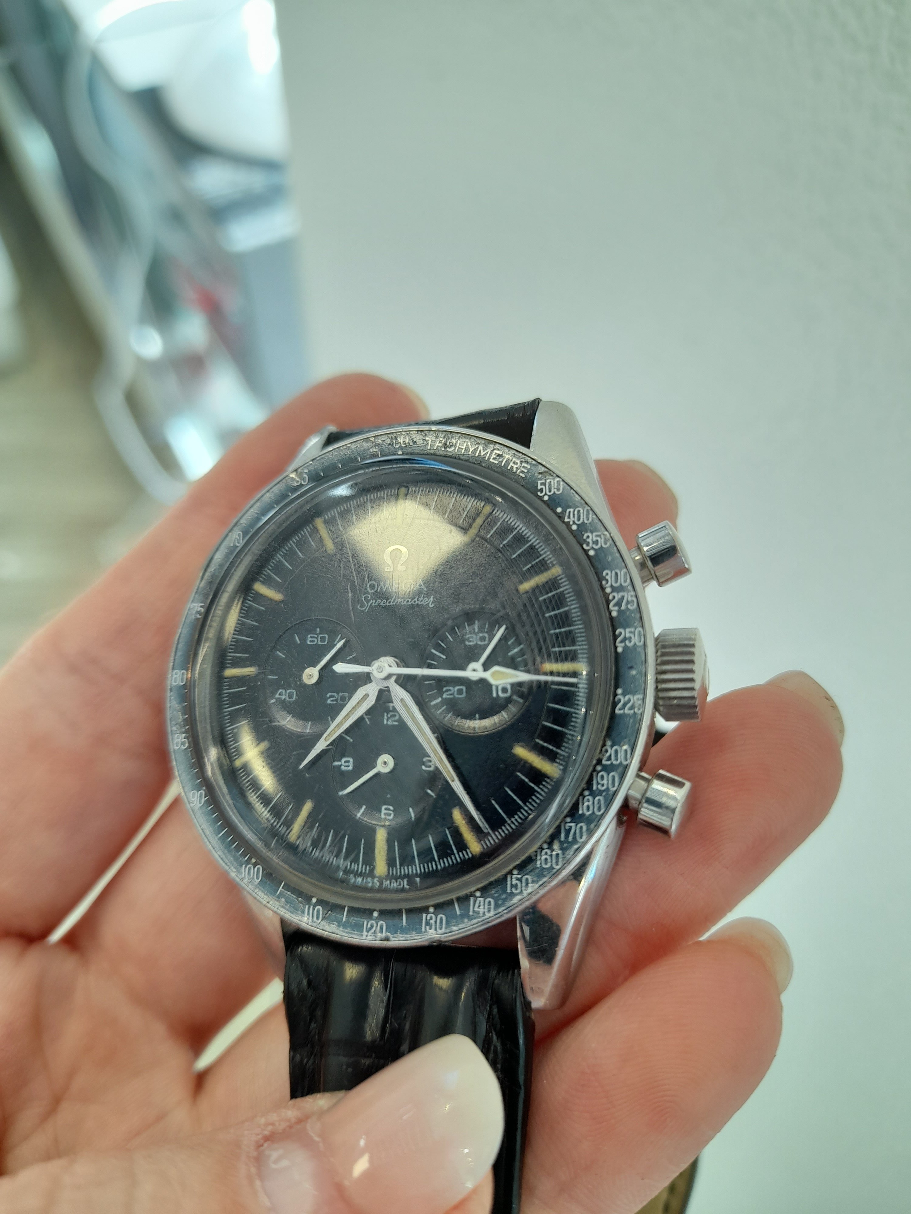

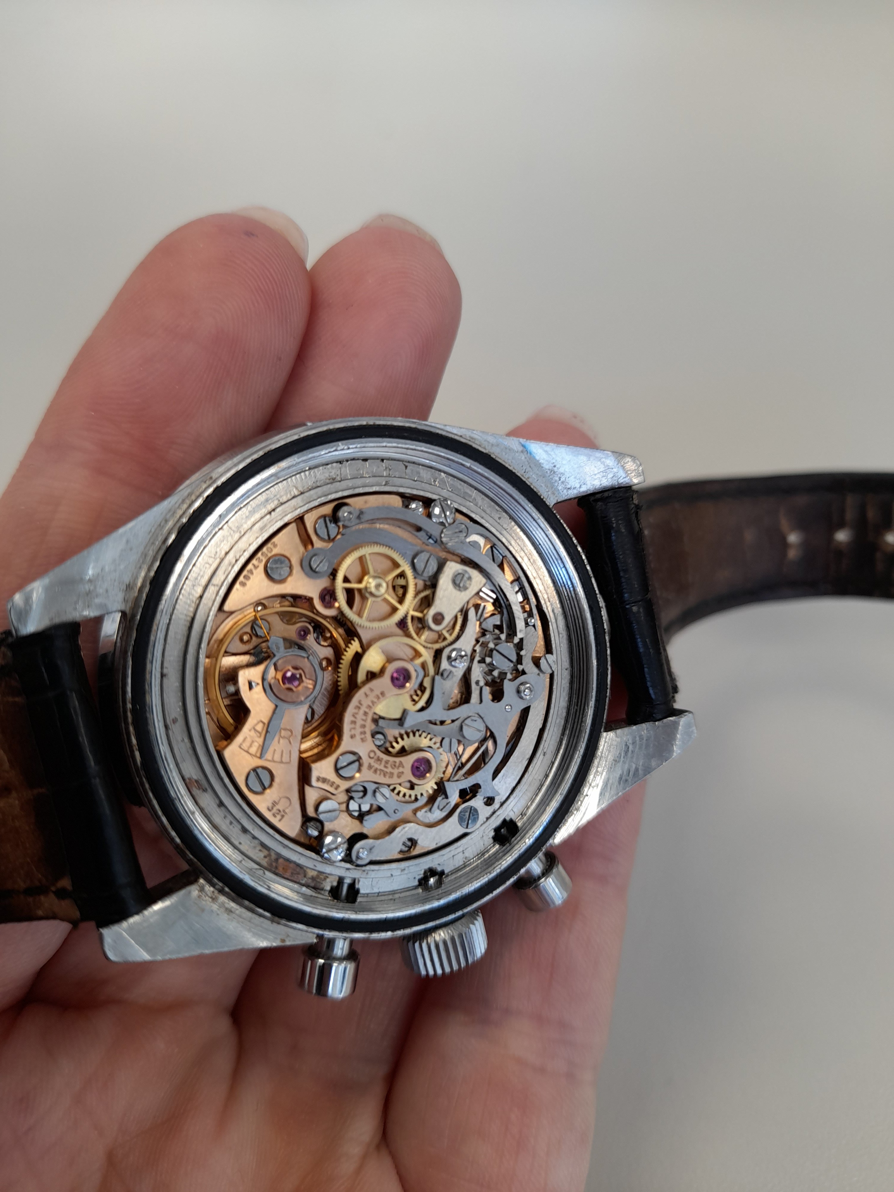

Hi guys!
What do you guys think about this. Serial seems in range. DON seems damaged but real. Dial and hands off? Pretty bad photos tho. Thanks in advance.
Regards,
J

Those are not the Ed White hands though they may be quite valuable if genuine. Wide Ts too which is wrong for a -64 I’d have thought. It must be a put together. Treat all the parts with suspicion inc the movement.

Dial lume is ugly/relumed/stabailized
Wrong crown, pushers look questionable

Thanks for the info! 5500e starting bid so I think it is a pass

Yeah, was looking for a watch to wear. So too many possibly switched parts I recon

I have found this to be true as well. Either the case is polished, the plots are moldy, the bezel is beat - there is always some problem. Hard to find a truly clean example without some major issue.
975
1,517
This is the third doctored dial like this (pro dial turned into a pre-pro) I have seen in the last six months. I guess there is an insatiable hunger for Ed whites out there nowadays.
