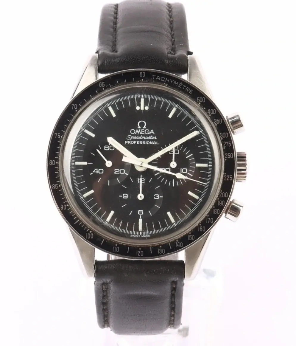

Below is a picture of the dial and hands:

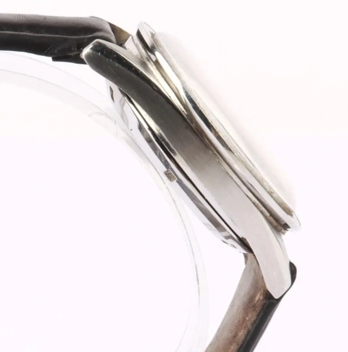

Personally I would stay way away from this hodgepodge’d piece. Bezel is also a modern replacement and from the proportions of the chamfers, case might also have seen a polish. Would need to see a photo of the back for other comments, but so far big pass on this one.

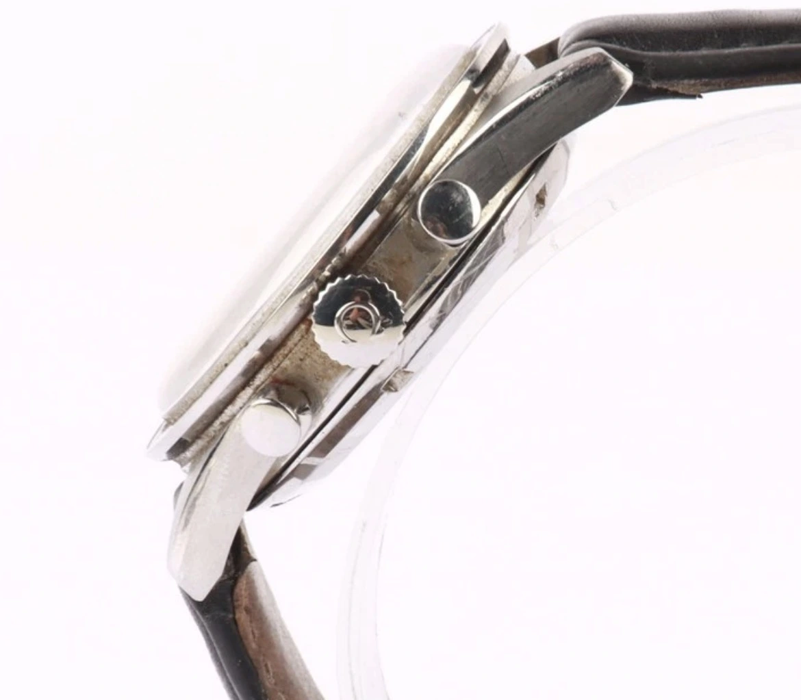

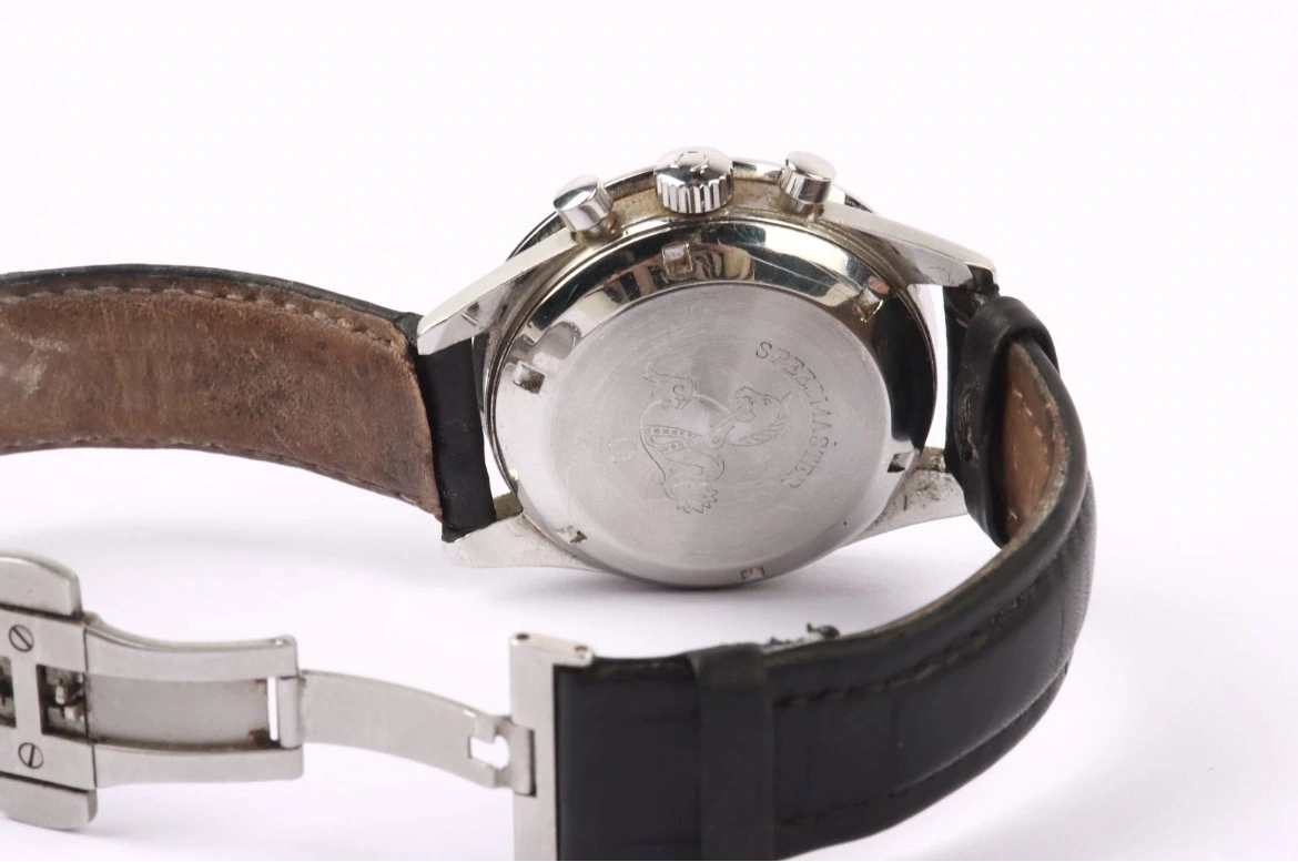

Here are some more pics:

I actually consider the case to be in interesting condition - not to badly polished or am I wrong on this as well 🫣😉

The dial is an incorrect service dial. The hands, bezel, crown and pushers have been replaced. The case has been fully refinished to (incorrectly) mimic the FOIS, not the true form of the 105.003-65.

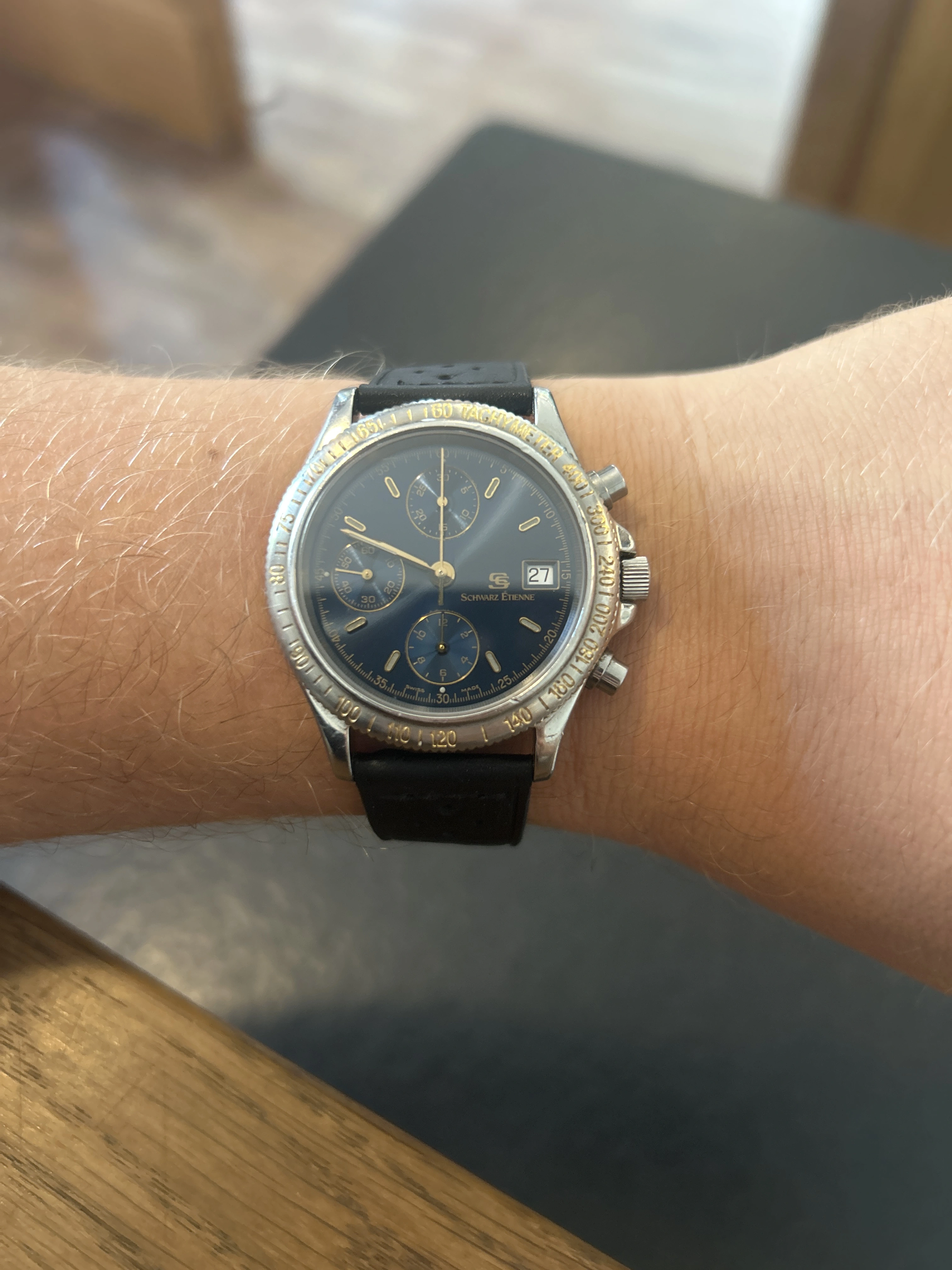

Lately I am wearing this 7750 chrono from the 90s as a daily beater:
But I am getting a bit bored of it and want to switch it up a little bit 😇😉

This kind of service updated watch is the kiss of death, in my opinion. I would never consider buying this watch except to resell as parts. it simply is no longer a vintage watch, to me. If you want the real thing, this is not the right choice. There are plenty out there to be found with original dial and hands. At least get one with a nice, attractive orig. dial. Hands can be found or aged.

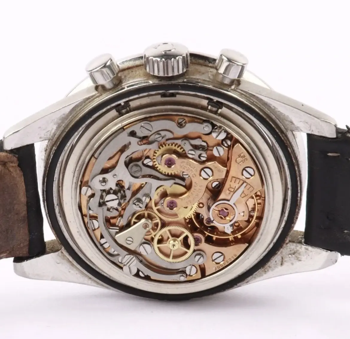

The movement number looks to me to be 2052xxxx.
That is not a range I have seen in -65s. It is seen in early Ed Whites, and also in late 105.002s.
So before getting excited about the price, that is the first thing I would want properly resolved.
Next just check the pushers - they look incorrect, they might have been butchered into the case. Check if they are screw in of push fit. Ed White pushers are the smaller ones and its not always easy to see on photos.

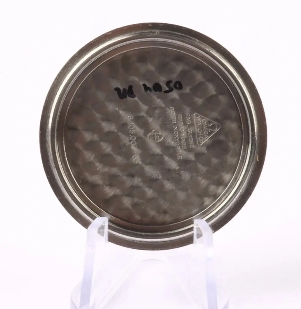

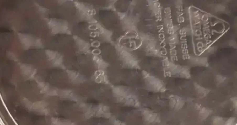

Where did the jump to suggest this was a -65 come from? The pic above shows a HF mark. It is deffo not a -65 with a HF caseback. If this is remotely original (not necessarily so) it is a -63 not -65 and the 20.5m serial also suggests this. I'd take a FOIS 1 or 2 over this all day long personally but as noted, with the right hands it would look ok I guess.
3,697
8,507
The very first line from the OP says it's a -63. (The caseback pic is not clear enough to verify).
5,375
24,540
If it is a -63 thats great news. I saw this its pretty hard to judge
From OP above - could be a 3, I saw a 5.
If its a 3 then the movement no is corresponding
