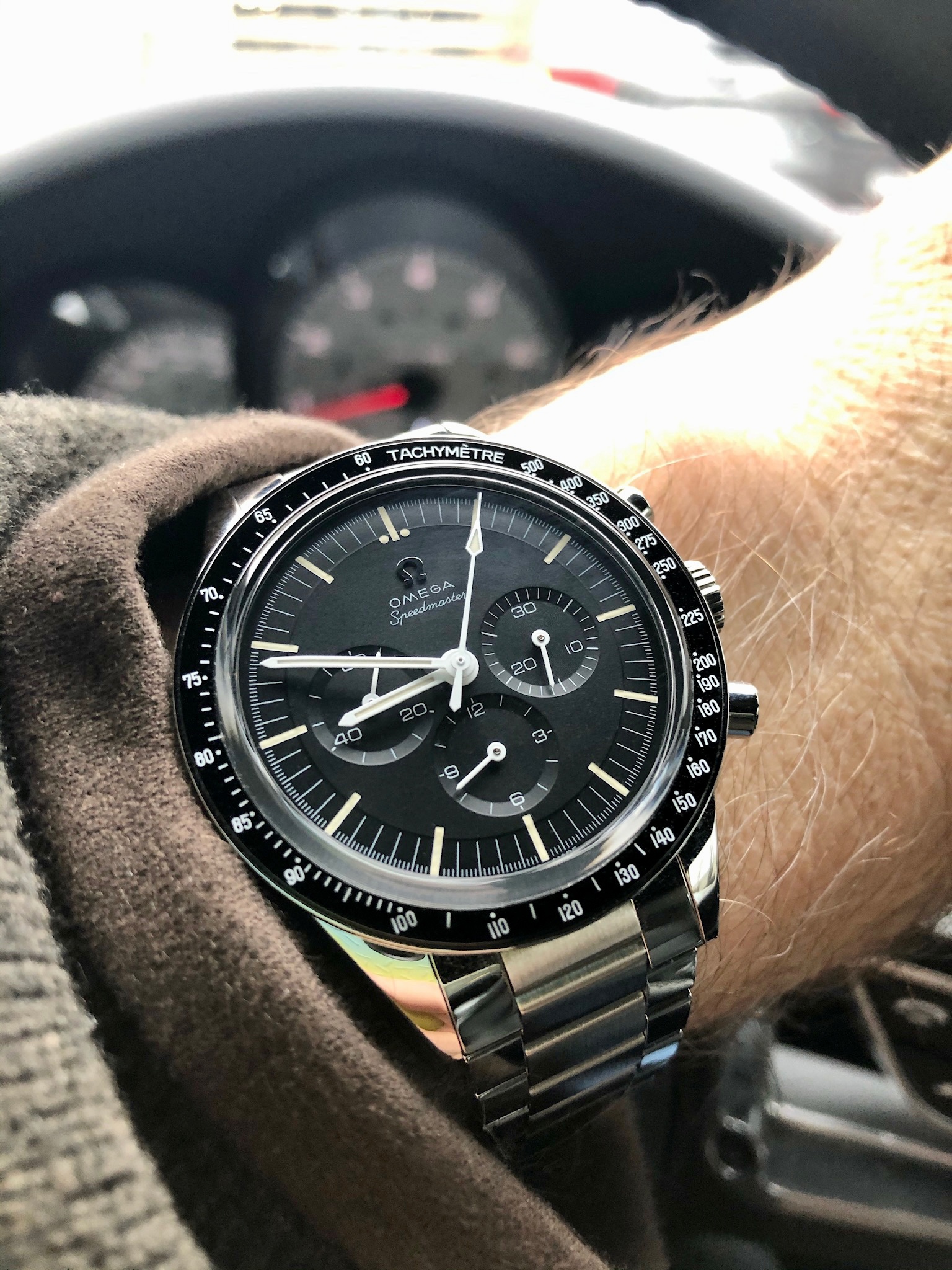

Some (even Omega) call this an Ed White too, but it doesn't seem to be sticking. Perhaps because Ed White never wore this reference? ☕
10,804
16,814
It's the opposite AFAIK. Prior to the launch Omega did refer to the recent 321 straight lug reissue as the Ed White but for whatever reason backtracked on that and now his name isn't used in any of the literature. Just a guess but may have been because his descendants or representatives were approached but decided to not endorse the naming of it that way and Omega complied. Or perhaps Omega realised that they had modelled it on the wrong iteration. It is widely referred to on internet fora like here as the New Ed White, though some have tried with limited success to make other names stick.
8,743
69,528
Yes, the new "Ed White" didn't stick long for Omega's official use. In 60 years, we'll be discussing why they changed it, and probably won't know any more than we do now. 😜
For now, I guess we can call it by the easy-to-remember reference number - the 311.30.40.30.01.001. That way there is no confusion with the 105.003.
That’s because it’s the “Cernan.”
Well exactly! Doesn't this kind of prove the point that maybe they don't really know what was the original "Ed White"?!!!
Now, was “New Ed White” really widely referred to? I thought we were crediting you with that? 😗
8,743
69,528
Rolex fans have all the silly nicknames tied up (ok, there is the Jedi, so maybe not all of them) so I suppose we are left with trying to link to actual history.
