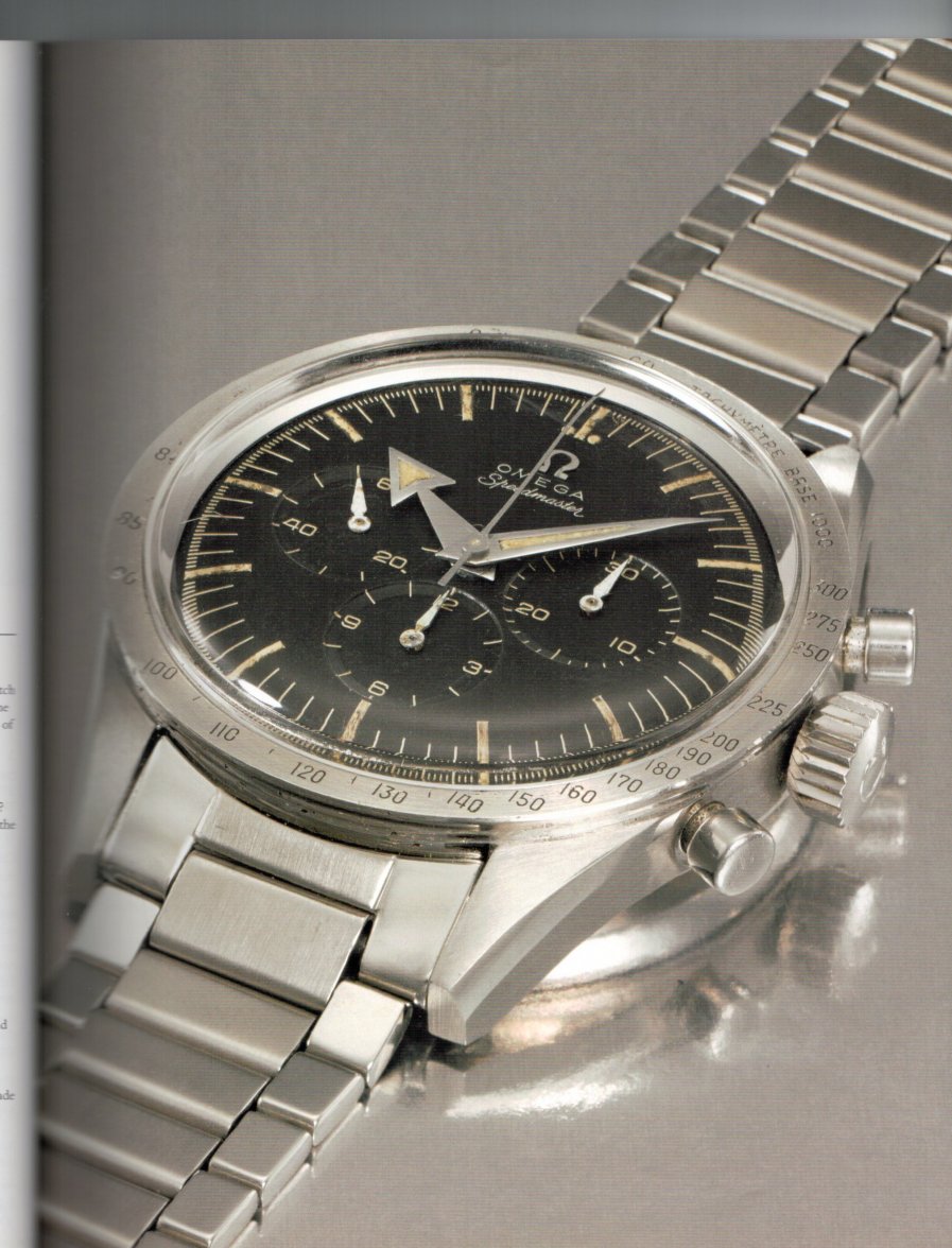

OP case bevel is very similar to another, infamous, case example.
Lot 3, 2915-1, Christie’s Omega Speedmaster 50 Auction
December 15, 2015 New York
Due to the case irregularity, the watch did not sell
