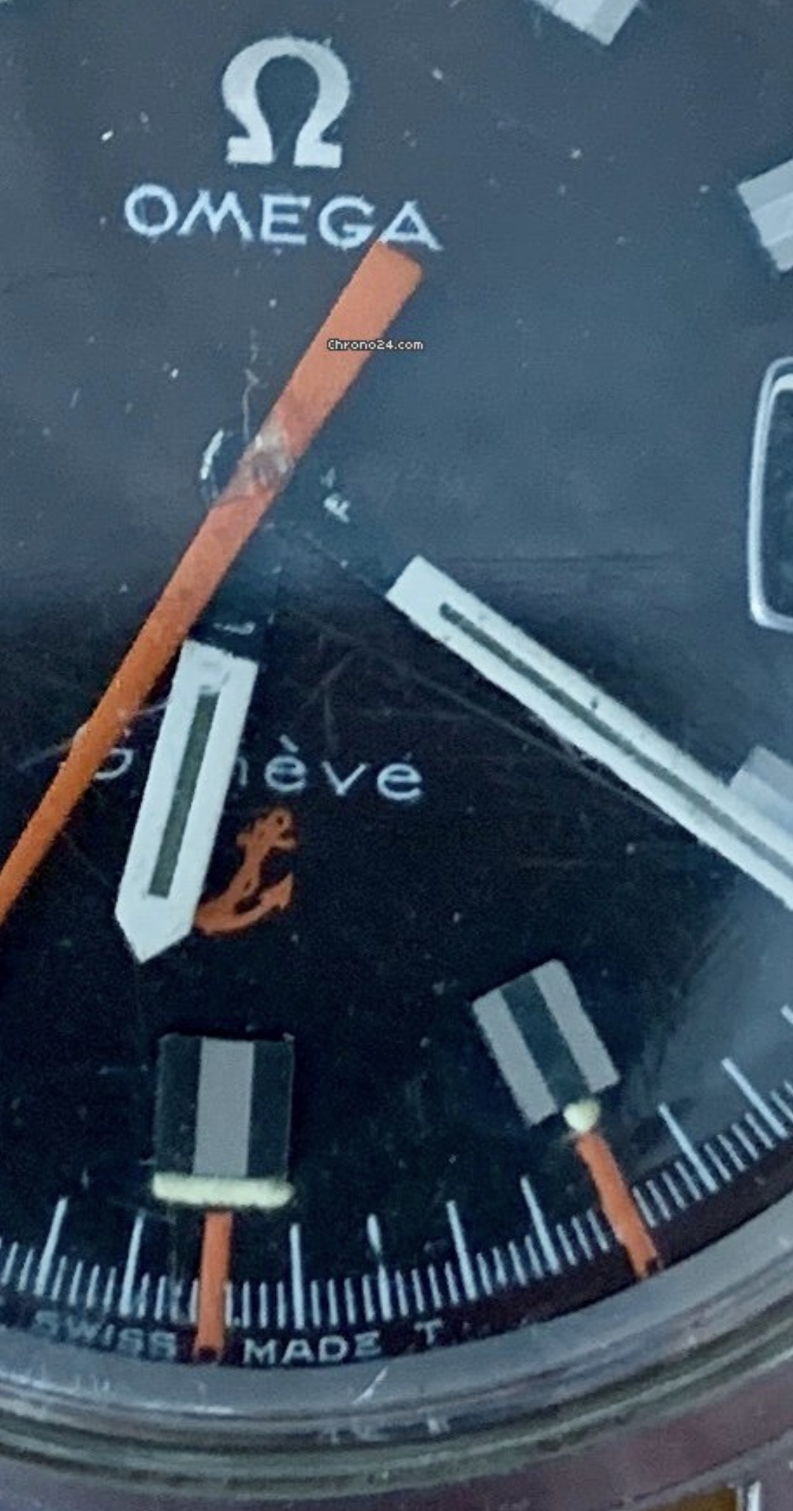

What’s wrong with this dial? And white of the hands seem re-painted
79
113

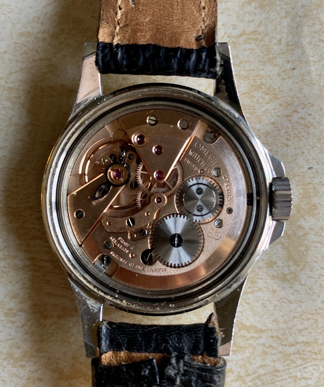

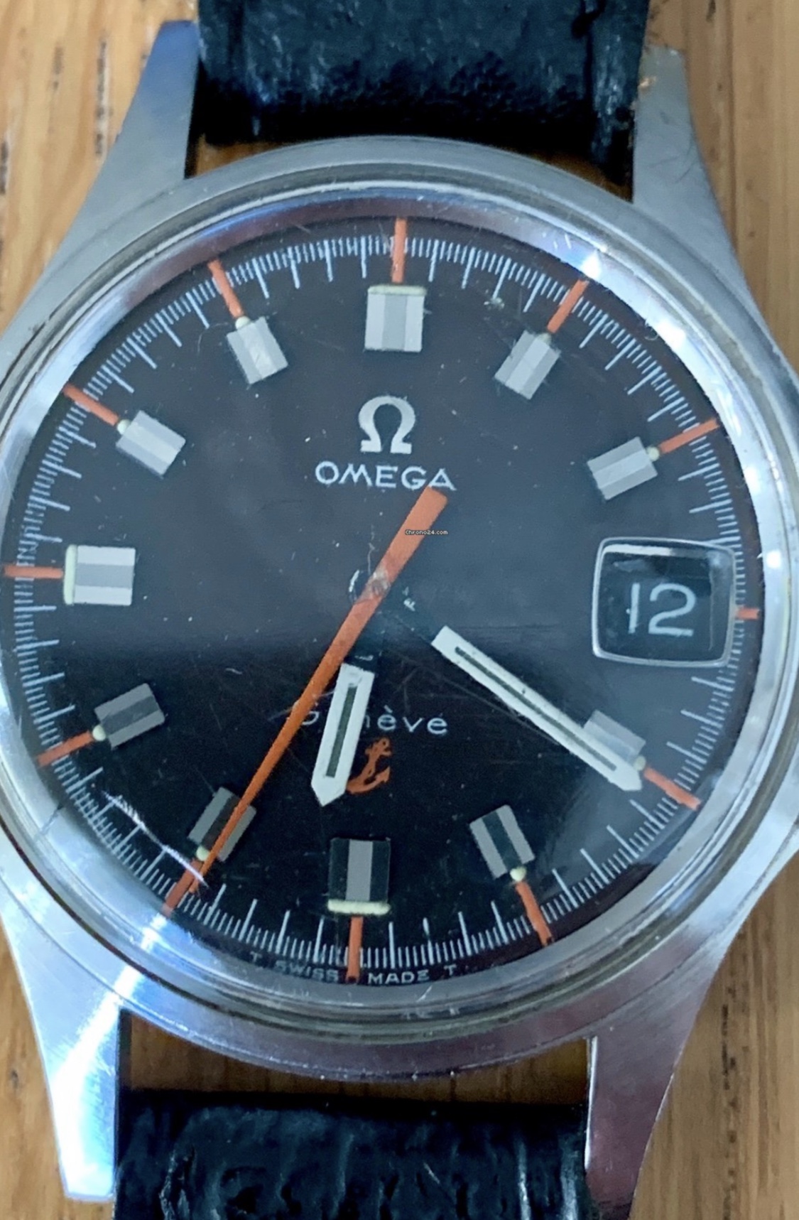

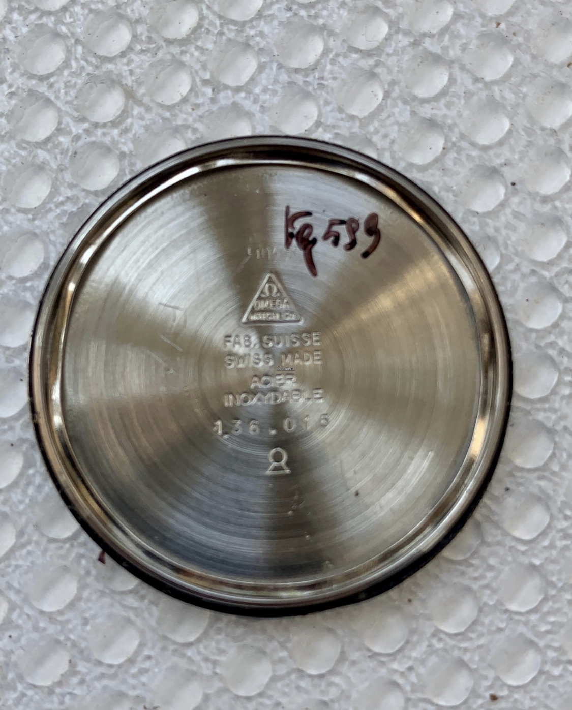

Hello guys and gals. Another desperate question from an over paranoid Admiralty shopper. I found this Admiralty from Italy for a decent price in today’s Admiralty market, $1300+shipping. I haven’t purchased the piece yet, but the seller has said offer on the table. Looking for help from the pros before I commit. It’s a non-diver/manual/date (136.015), in black. Pretty much what I’m looking for, but something bugs me about the black on the dial and the white on the hands. The dial seems pretty darn scratched up, and I don’t think it’s the crystal. Is it spider webbing? The dial also seems too glossy. Repainted? The crystal is bad too, but I’ve already ordered a replacement (PZ 5127) since I know I want a non-diver with a date. Either the 166.038 (automatic) or this version the 136.015 (manual), so having an Omega replacement crystal is a feather, even if I don’t get it. The hands also seem odd. They are beat up closest to the center (black), yet seem super white around the lume. Repainted at some point? I also realize the crown is a replacement, probably a ST42057 or ST42242. I can live with that given the rarity of an original crown. Also it comes with the original 1122/563 Fixo-Flex, but it’s broke, but salvageable. Any thoughts on the hands and dial? Help for a guy trying to buy his first Admiralty. Always thank you in advance! Pics below:

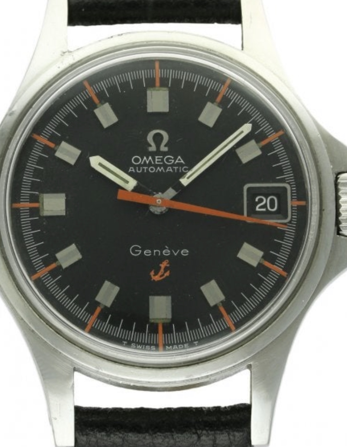

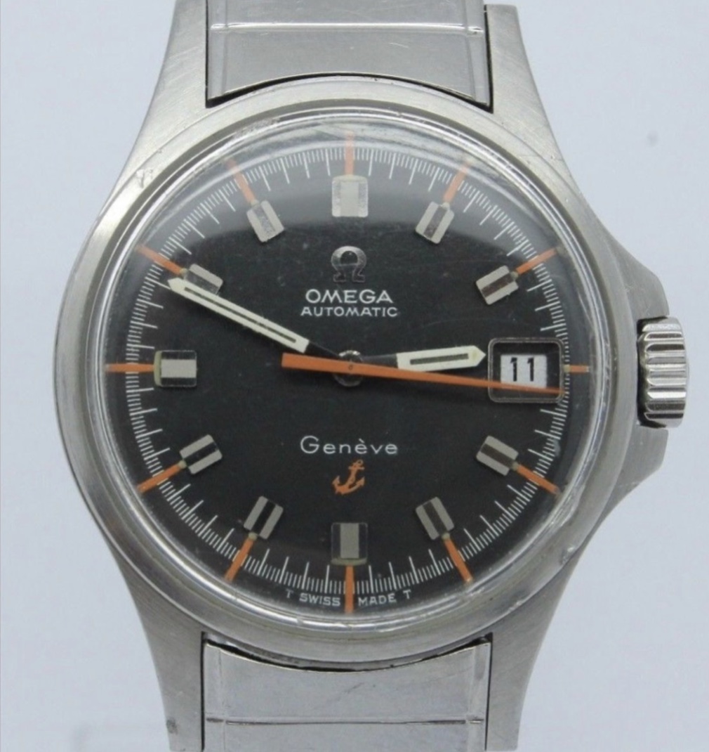

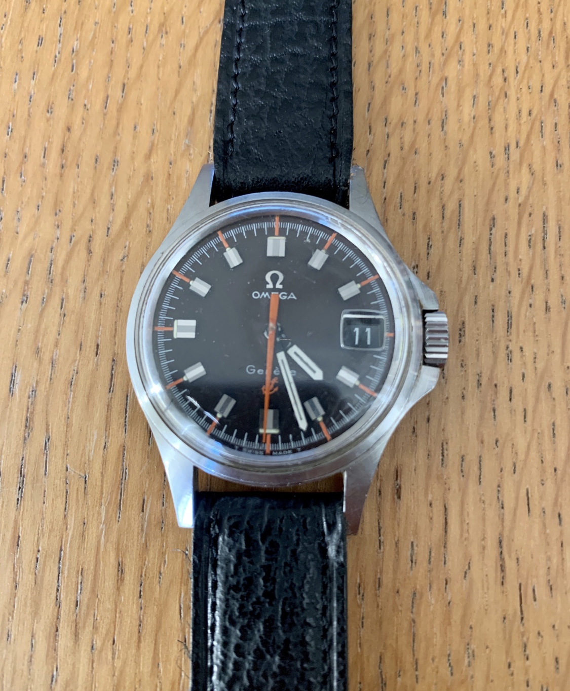

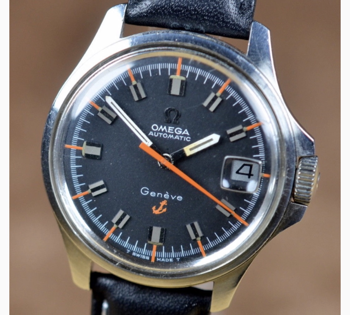

Some black autos, one non-date (165.038) and one date (166.038). Trying to find a manual.

For anyone wondering, the above Admiraltys are other black dial examples for comparison. @STANDY asked and I appreciate his thinking. Thanks again all!

I would be asking for more pictures of the dial. As dial scratches kills any deal I am afraid. If it’s hands and crystal it’s hard to tell.

Seems like you are onto it. A lot cheaper you would gamble on a bad picture nice watch scenario like many have scored over the years.
The condition of the dial is the number one thing here. Dial scratches are always hard to live with and Hard to move on later.
Better to overpay for a great example on a watch like this

I suggest that you hold your horses until the watch has arrived. A poor crystal often makes a fine dial looks poor, and also generates spekulations which often seems to be incorrect, when the watch can be seen in real life. I think your dial will be just fine 😀
