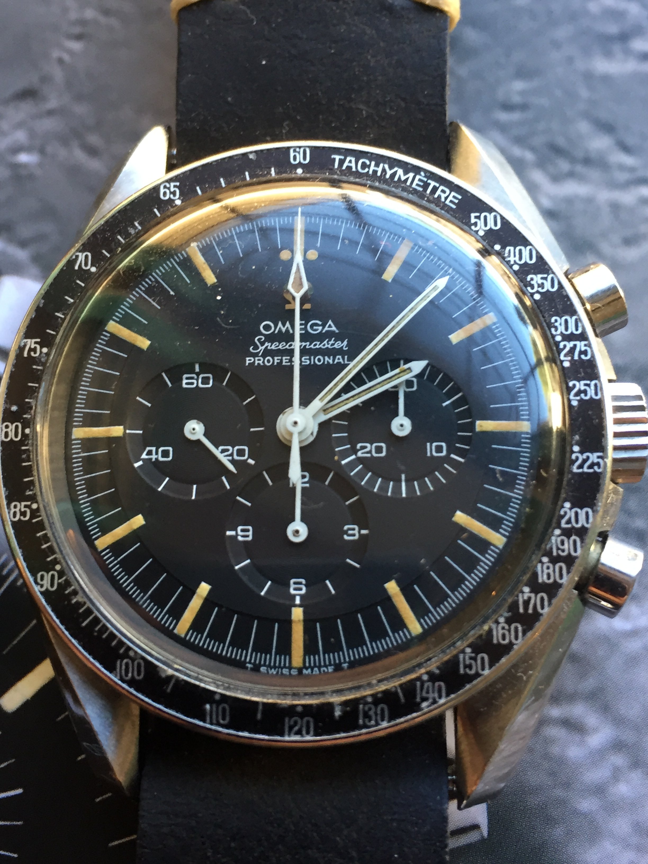

On my 68 Transitional Speedy, the DON Bezel shows the 120 on the right edge (or just inside it) of the 6 o'clock marker.
I've seen this same alignment on several DON bezel pictures on the internet.

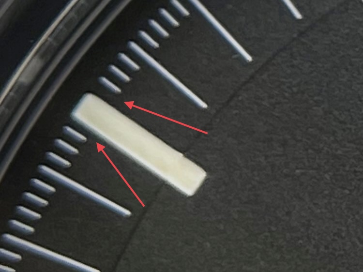

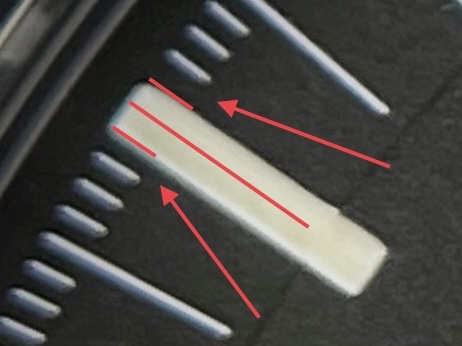

If yours is off, it’s off by 1/5th of a second. That seems to be about the error tolerance for these dials in terms of how perfectly (or imperfectly) the lume is applied, etc. if you look closely at these dials, the loom plots can be off center almost the entire way around the dial (and inconsistently) - and this is true of even the modern dials. Here is a picture of my SS cal.321B:
View attachment 1153858 View attachment 1153859

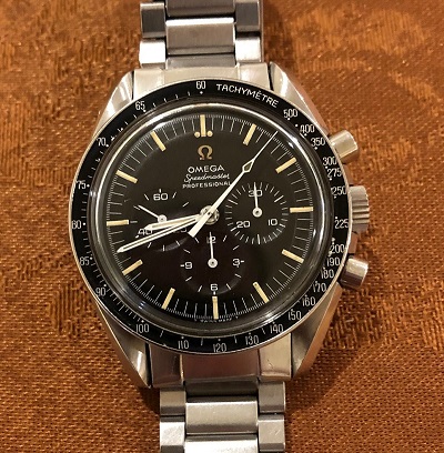

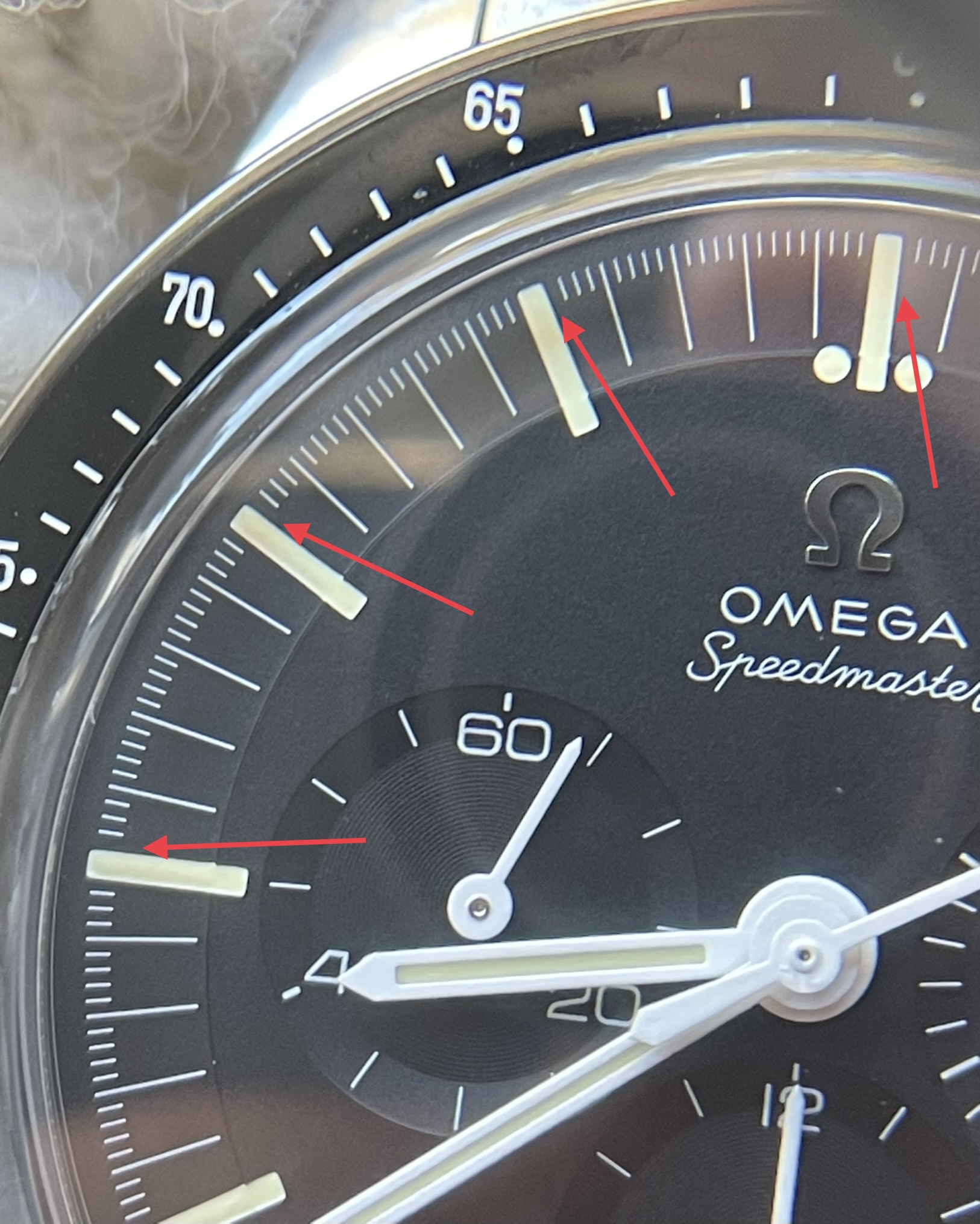

Have these pictures from a recent thread where we found that these uneven placements of the lume go all the way back to the original Ed White (two different examples below):
That’s pretty much the amount they are all off, when they are off. Assuming the OP’s dial is slightly torqued clockwise, it would be off approximately this amount as well, no?

Not really an exact science to it, but the OP watch appears the 0.5 sec off he mentions. But maybe more strange about the OP is that it’s not just the lume plot that’s off but instead also all the sub-indices near 6 o’clock, but not at 12 o’clock?
maybe better pics will say otherwise

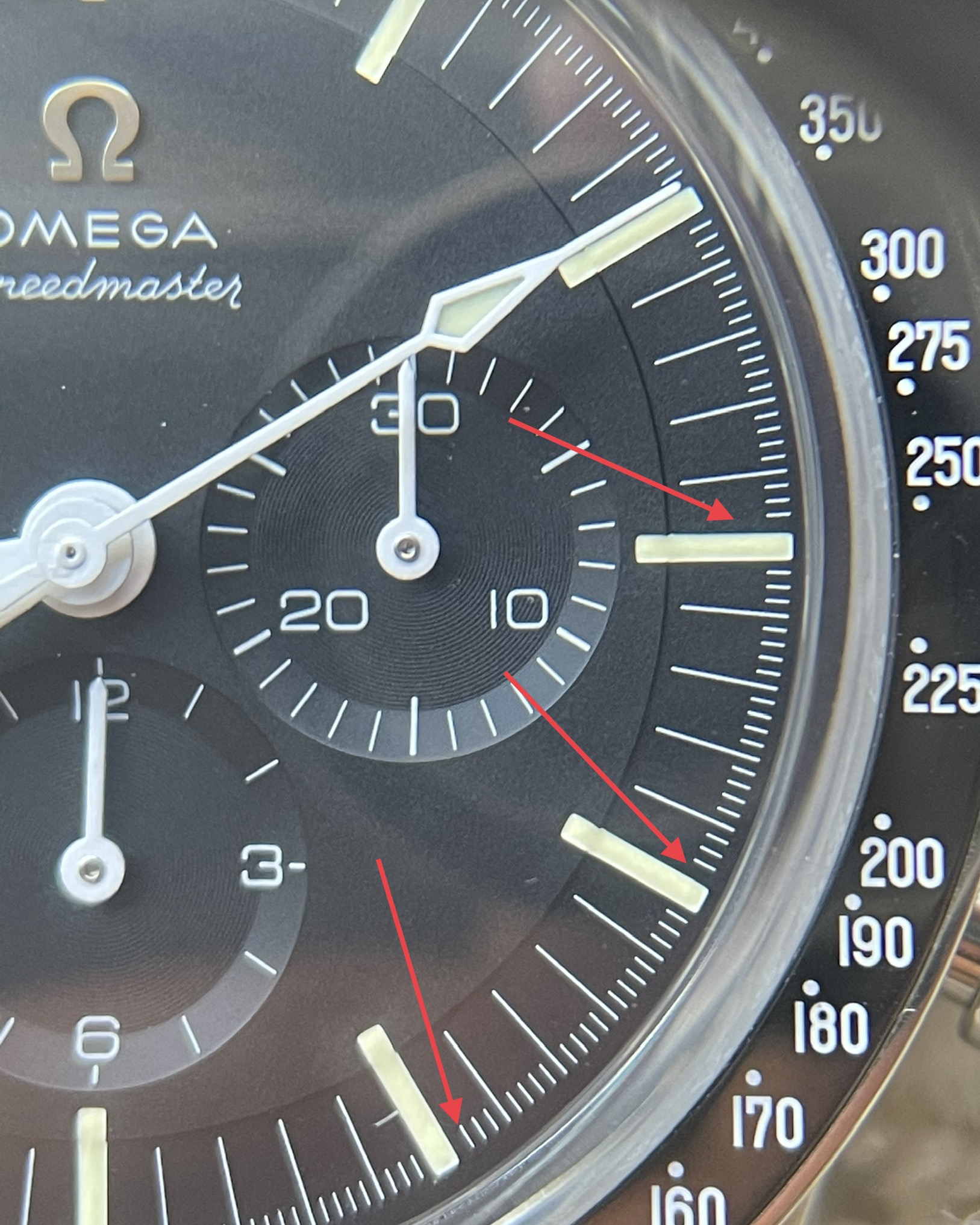

Below are pics of (in order):
A Hesalite 3570.50
A Sapphire 3573.50 from 2007
A Sapphire 311...006 from 2017
These helpful in showing both range (type, age) and also because the lume plots don’t extend through the sub-indices.

A SS cal.321B
Note that it’s off in the other direction compared to the lume plot, but the lume plot itself is the item out of kilter

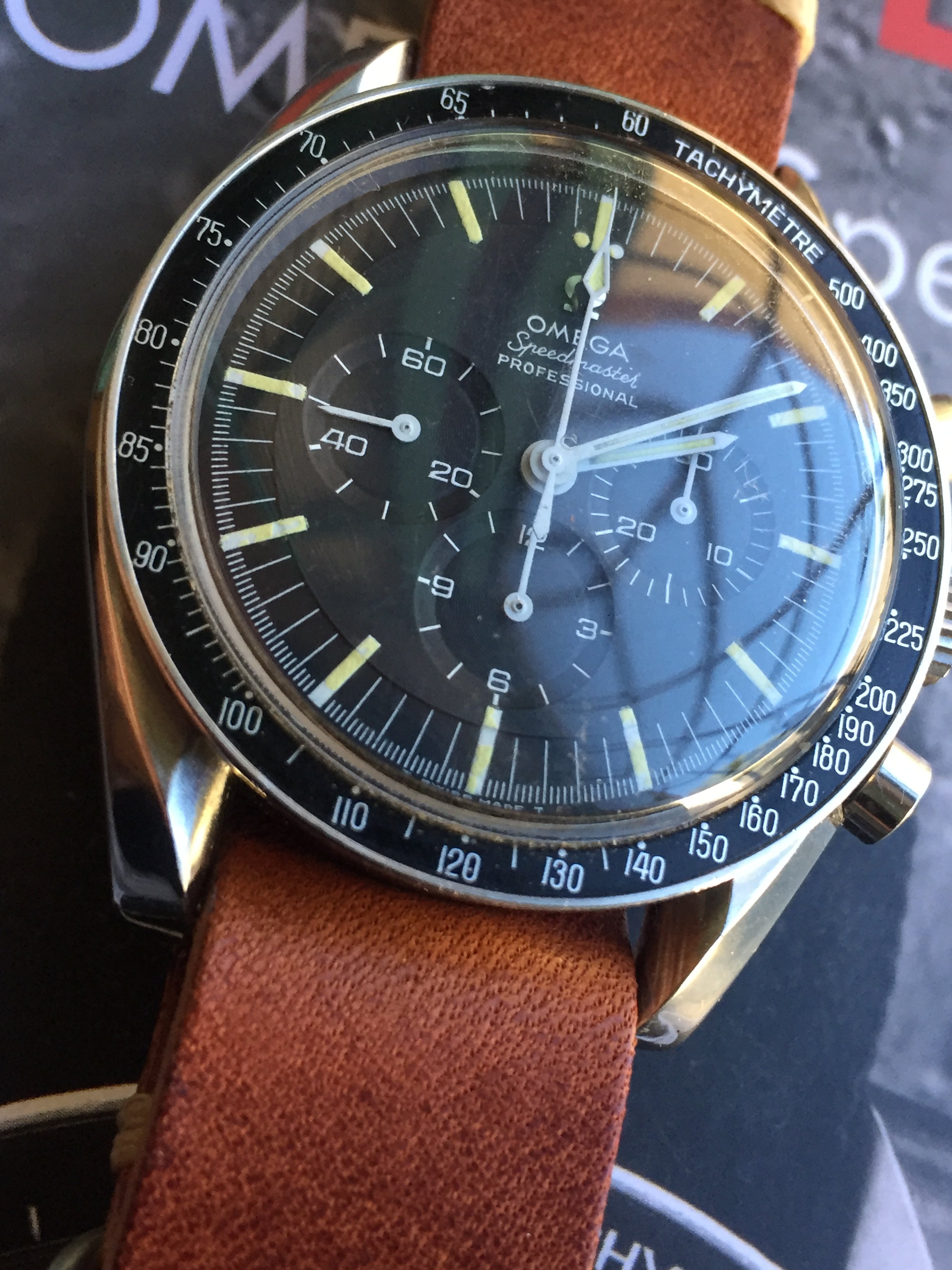

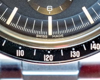

Hello everyone,
I have been observing that there are DON bezels that have the 120 offset from the 30 .. my 105012 66 CB has it around the 29,5 minute. Was there a manufacturing fault?
Thanks

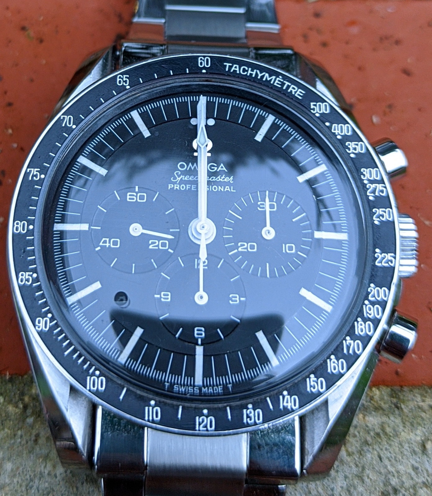

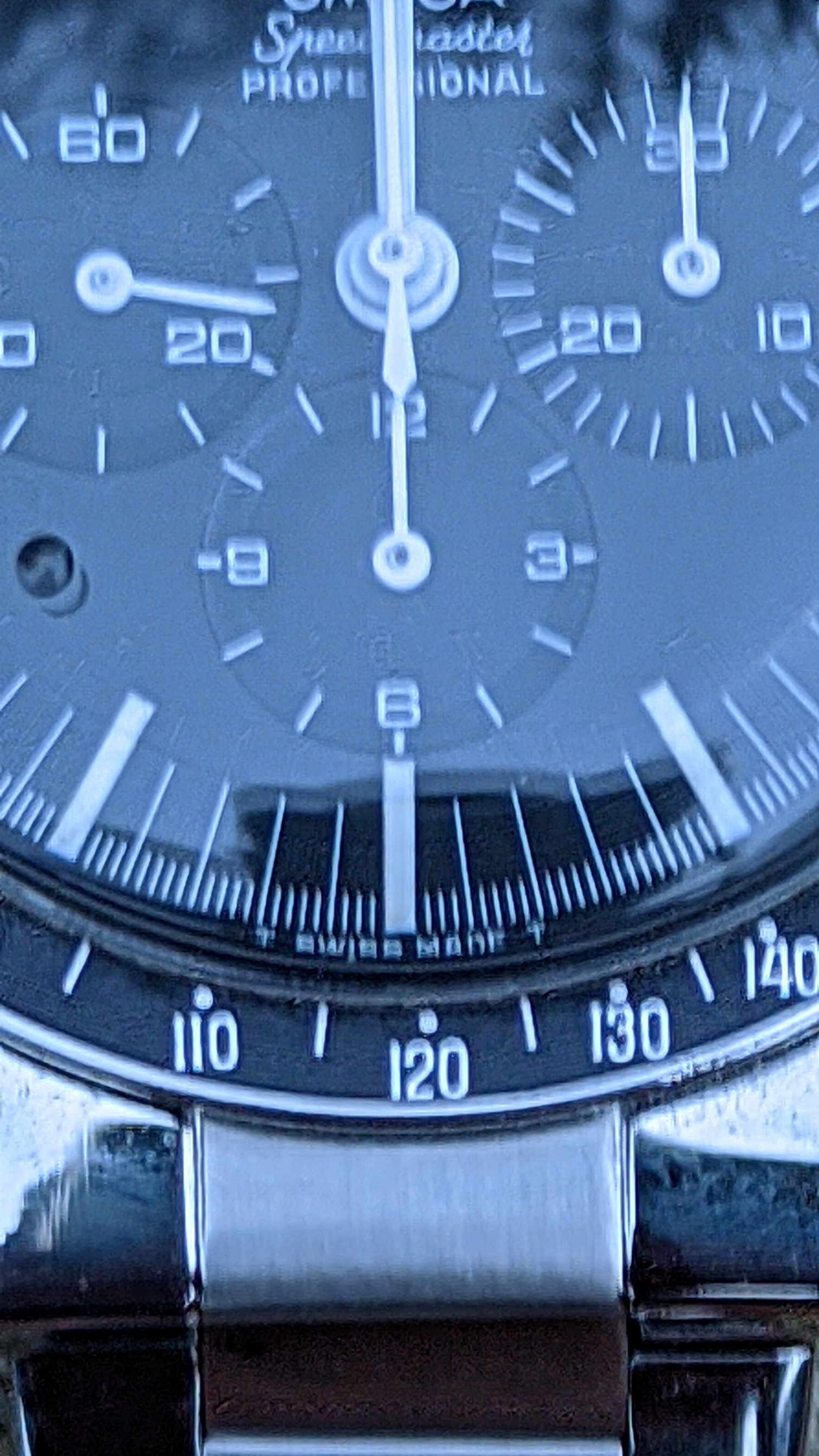

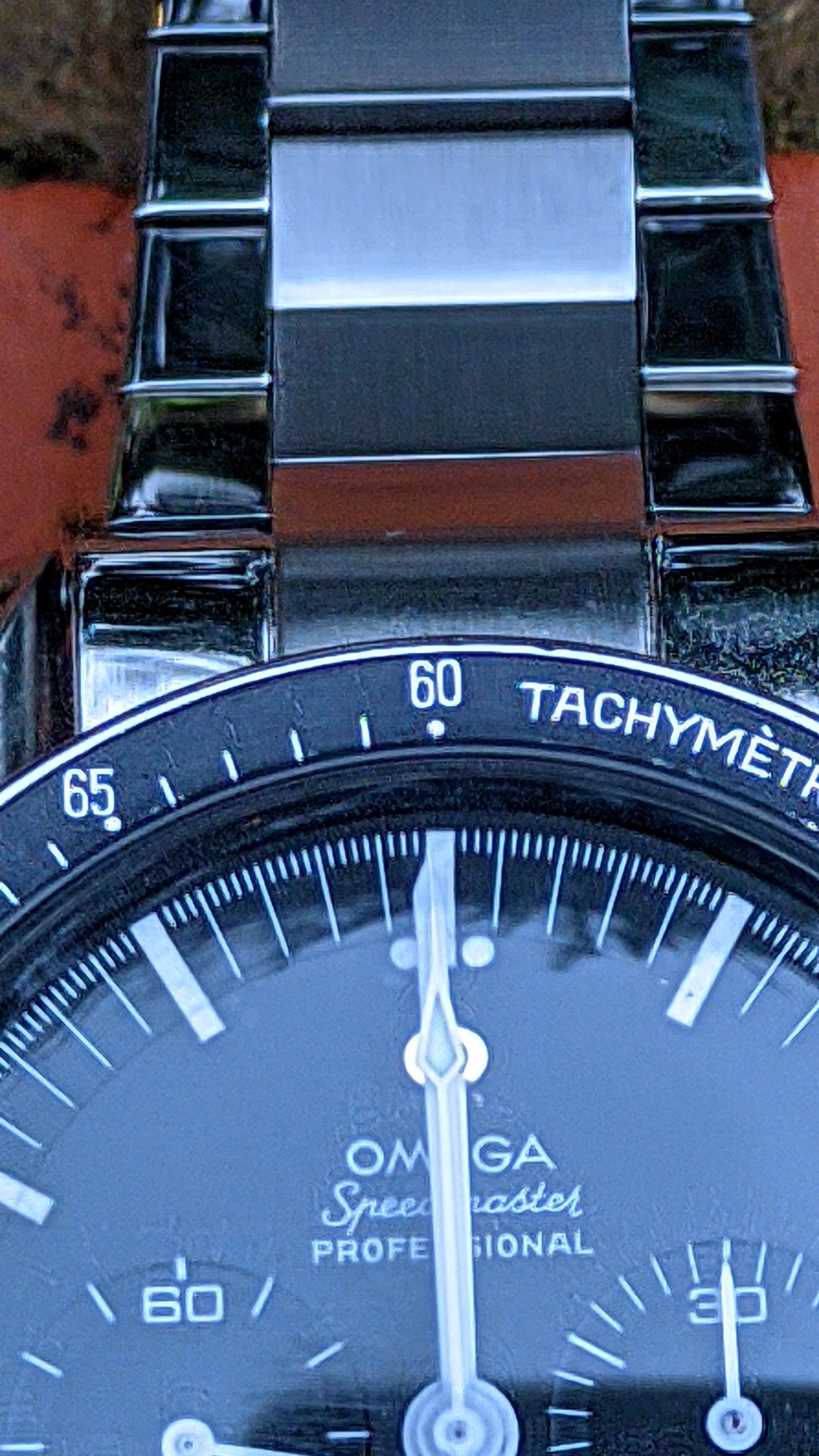

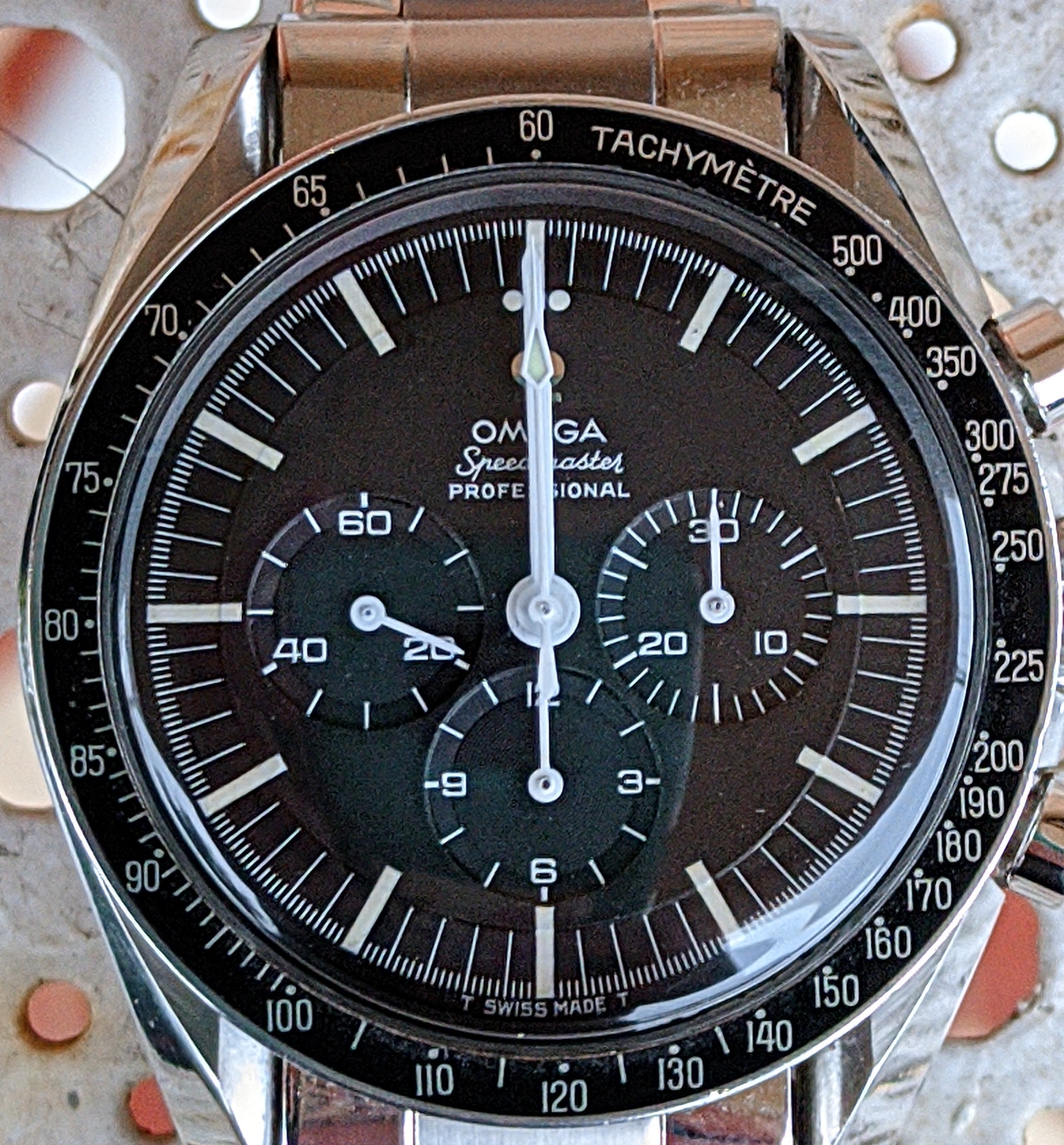

Let's see if with these photos, as perpendicular as I could, the mystery is solved!

Hmmm, both the dial and the bezel appear to be out of whack 👎

The dial is oriented correctly, the crown matches the 3 o'clock line and 12 matches the 60 on the bezel.
In addition, the dial is oriented according to its 2 anchors to the movement, and the movement according to the crown in the case...

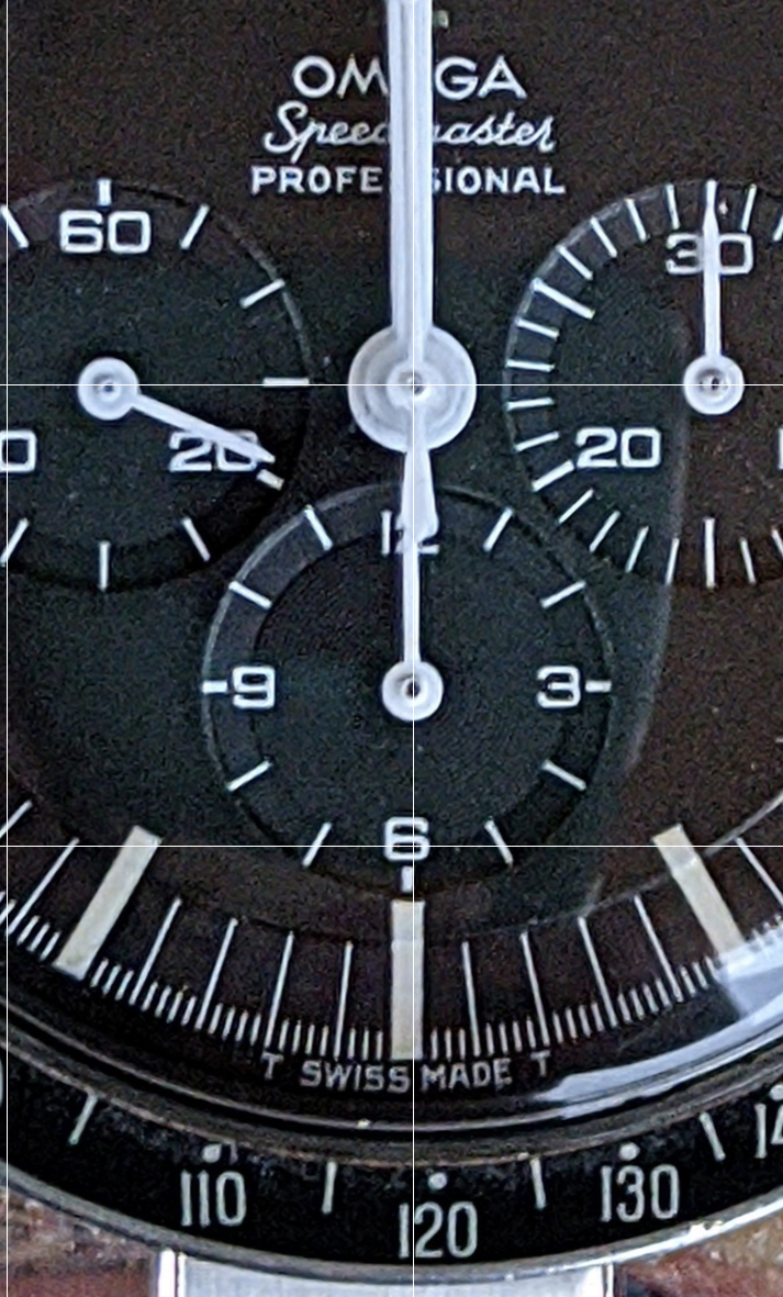

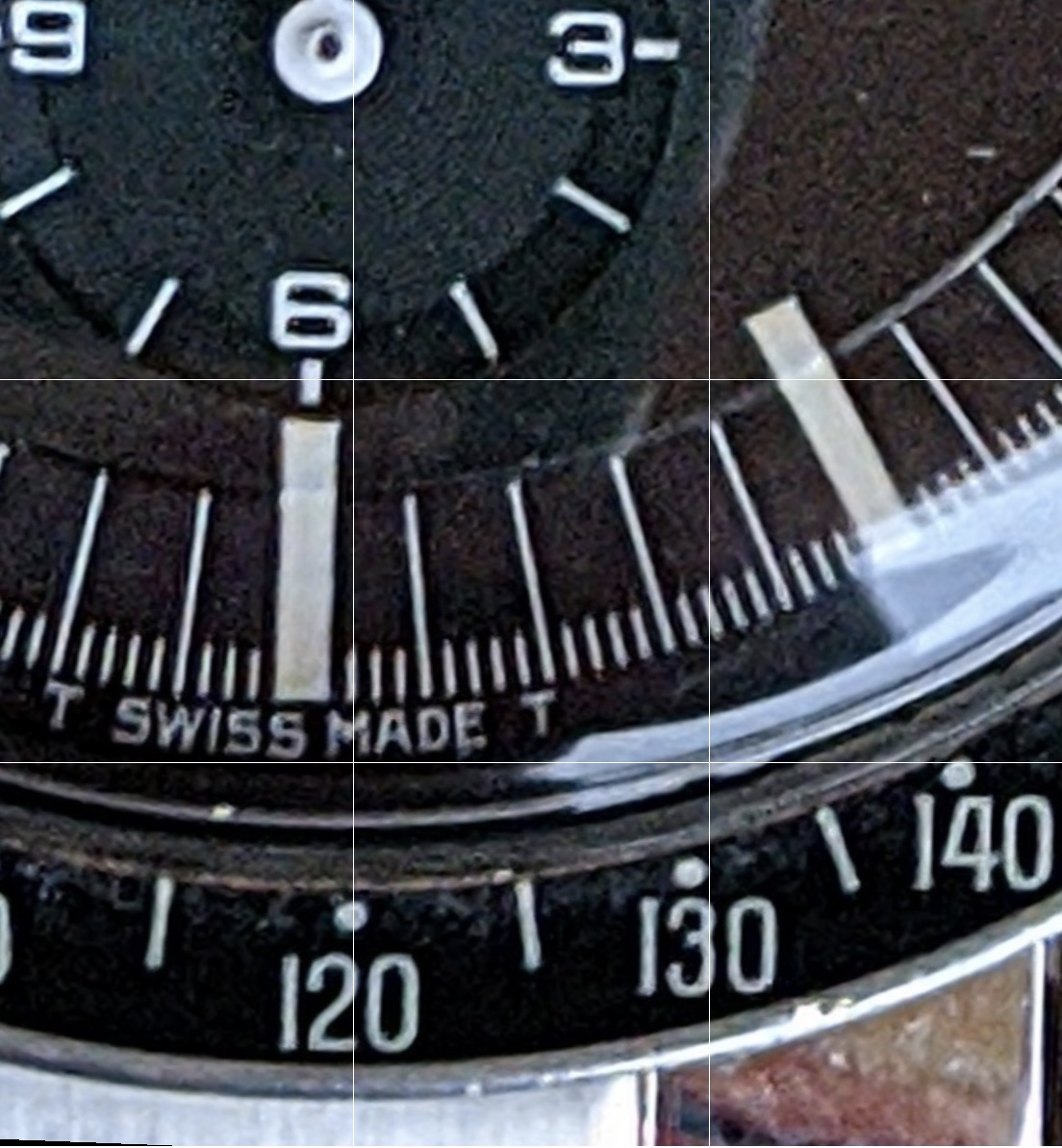

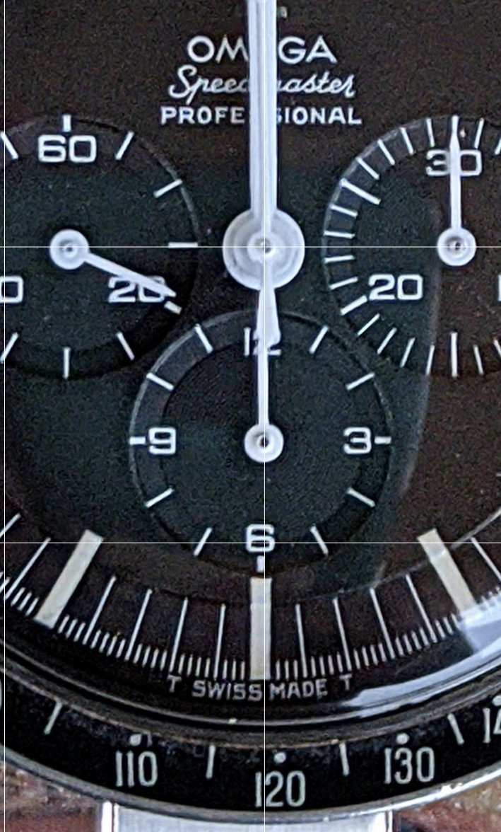

I have no clue what you’re saying, but here’s a picture of OPs watch oriented to the central and lower handset as center 😁
Don't be confused by the relationship to the hand set - they are influenced further by being in "orbit" relative to the fixed dial and bezel.

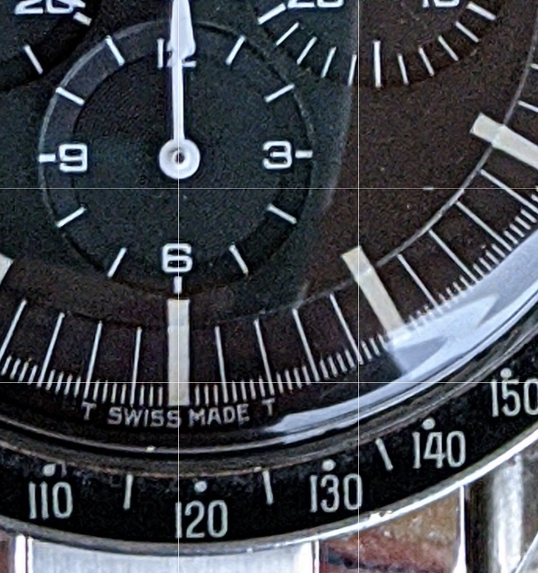

Here’s one oriented to apparent center of the sub dial’s “6” and the hour lume at 6 o’clock, followed by one oriented to apparent center of the dot over 120 on tach
finally, a wrist shot, oriented to @Darlinboy ’s comments

As the lume plots represent three sub-indices or 2/5ths a second, it seems to me that OPs misalignment is itself 2/5th a second
If, for example, Omega’s tolerances on these dials and bezels is 1/5th a second, then OPs watch could simply be a particularly matched combination of the lume plot tweaked clockwise by 1/5th and the 120 mark tweaked counterclockwise by 1/5th

It's definitely wonkier than I expected to see when first clicking on the thread. 😵‍💫

The OP's watch definitely appears to be farther out of alignment than is typical. As cvalue13 says, perhaps just a victim of the 1/5th error rate occurring on both the dial and insert to compounding effect.

I suppose at a service the bezel could be adjusted just so to split the difference between the 6 and 12 o’clock positions, and blend/minimize the effect
these things have a tendency to not be unseen, and the above tweak may alleviate
