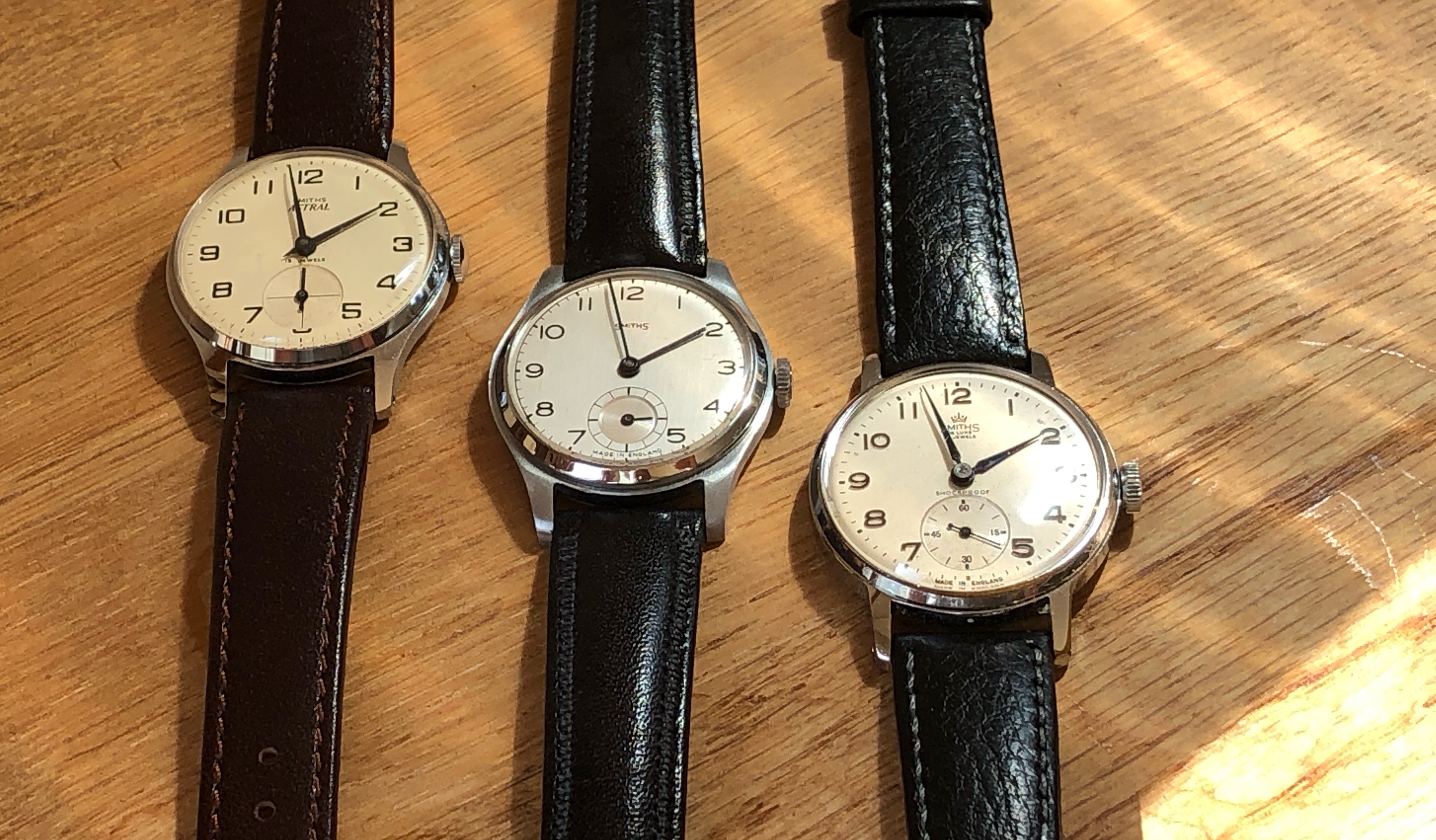

If you are considering other brands, maybe take a look at Smiths, made in England up until about 1971. I have had a few and found them to be very well made and robust. If they were good enough for the British army.....
Mine are all pre 1960 but they made some lovely centre second hand Deluxe models in the mid to late 60s. Prices are creeping up, particularly the military ones, but they are still very affordable.
