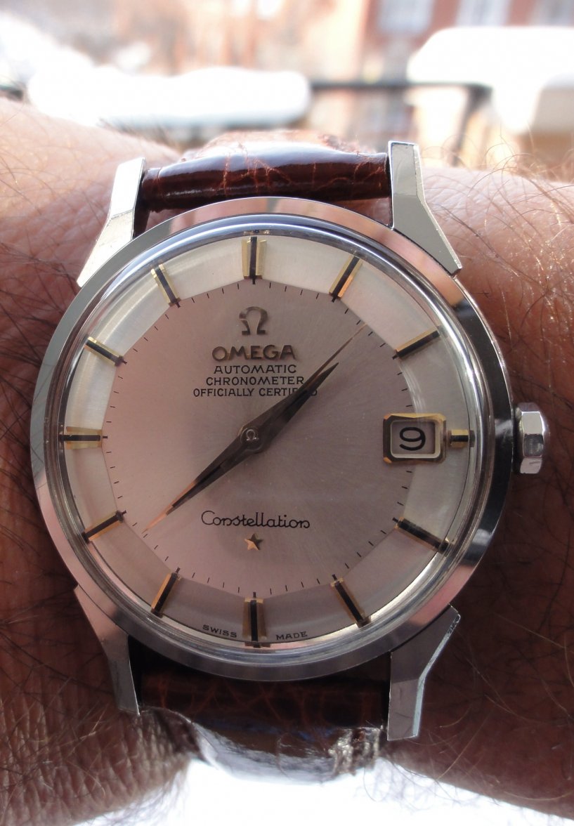

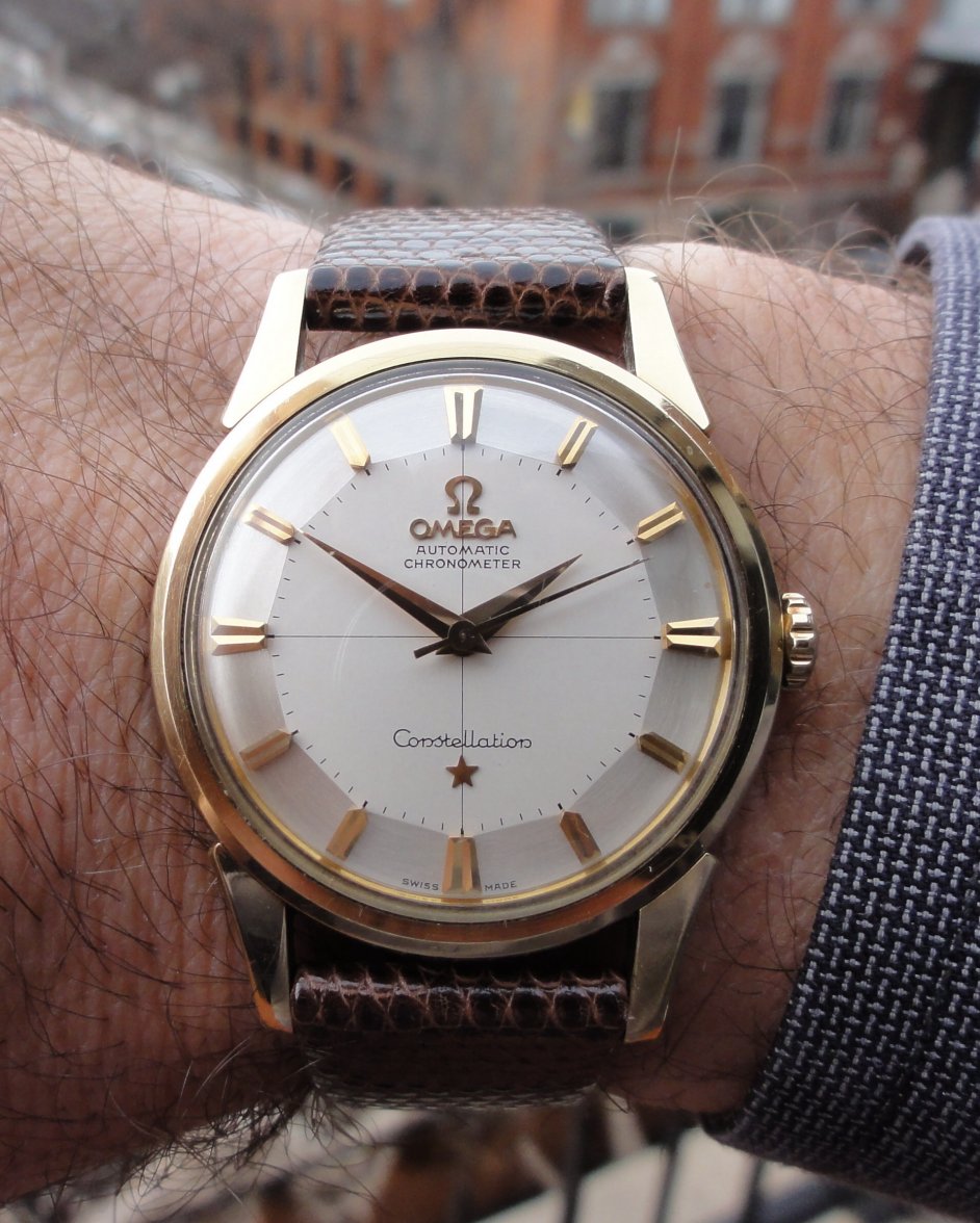

I purchased the cal. 551, ref. 14393 10sc, ca. 1959 Constellation a few months ago along with the cal. 561 (date)
ref. 14393 4, 1961. Did both of these come with the decagonal crown? I have read where the original crowns
are sometimes replaced when serviced. Many of them now have a standard crown like mine. Both of these
do have the Omega symbol on the crown. Was there a problem with the decagonal crowns? (Disregard the Tudor)
7,225
24,428
No, there was not a problem with the origional crowns. Crowns are a wear item as over time their rubber seals wear out and the crowns got replaced. Since these origional crowns haven't been available for some time they get replaced with what is available.

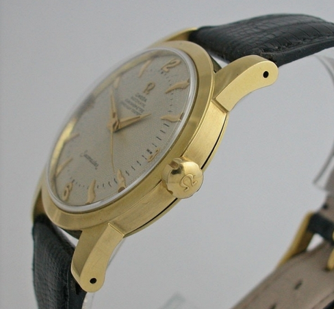

Some origional crowns...
Thicker Decagonal (1954) reference 2799
Narrower Decagonal (1964) reference 168.005
Serrated crown (1960) reference 14393
Serrated crown (1959) reference 14381
As you can see my reference 14393 has a serrated crown but I believe yours could have come with either the narrow decagonal or the serrated crowns. Hope this has helped you at least a little.

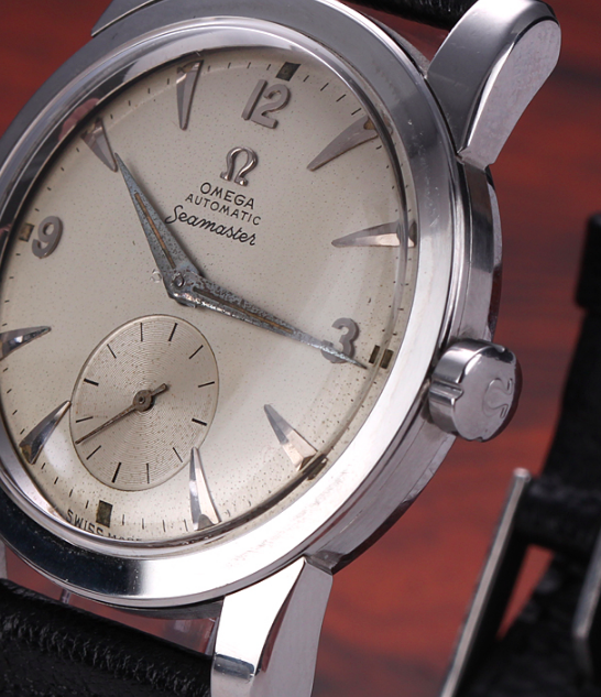

Decagonal crown on a seamaster
2,876
1,962
That must be Kyle's watch, rare to have in that condition. 👍
Interesting that most of the contemporary Seamasters have the same tube size as the Constellations of the time, but only the 2984 are known to have the decagonal crown.

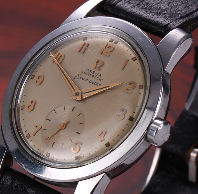

What I meant was there are slight differences between decades of replacement thick crowns. I have a replacement one from the 50's, it's nothing like a new one. I also had a replacement from the 80's or so that I know was real omega, and it was a little different too.
538
519
The 50's one has a rotten gasket Even though it's never been used, so I took it off.
