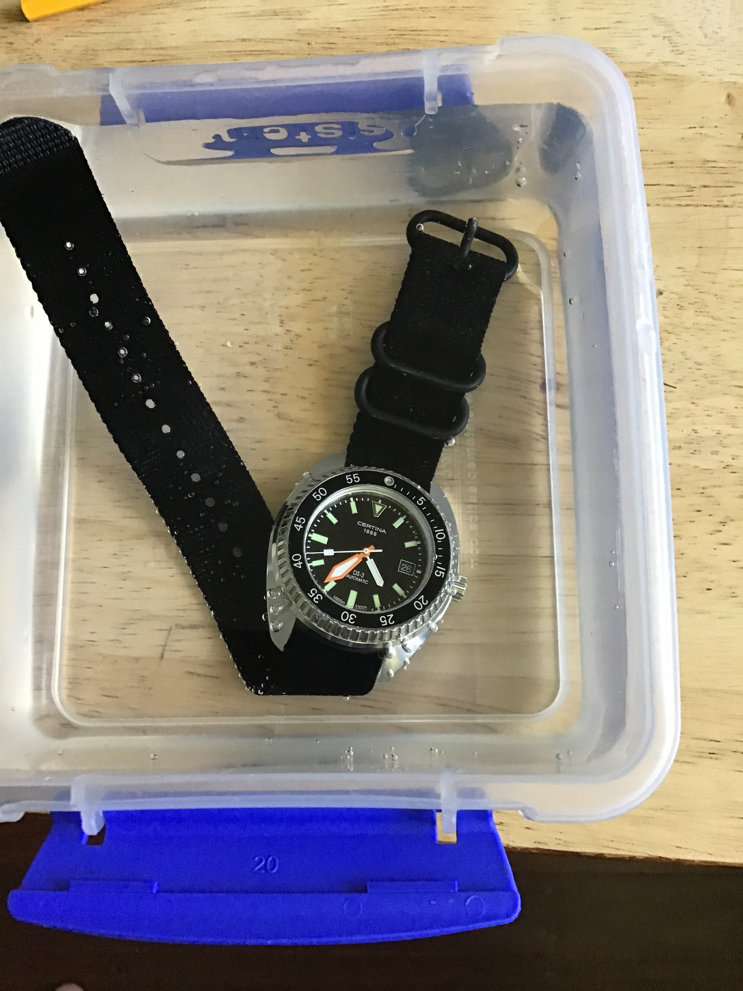

Every time I use a watch in the ocean I clean it with water and then sink it in a glass with clean water for a couple of hours. Never had a problem. From time to time when a rotating bezel is attached, I put a drop or two of liquid silicone between the bezel and the glass and give the bezel some complete turns, clean the excess with a paper towel and voilá.

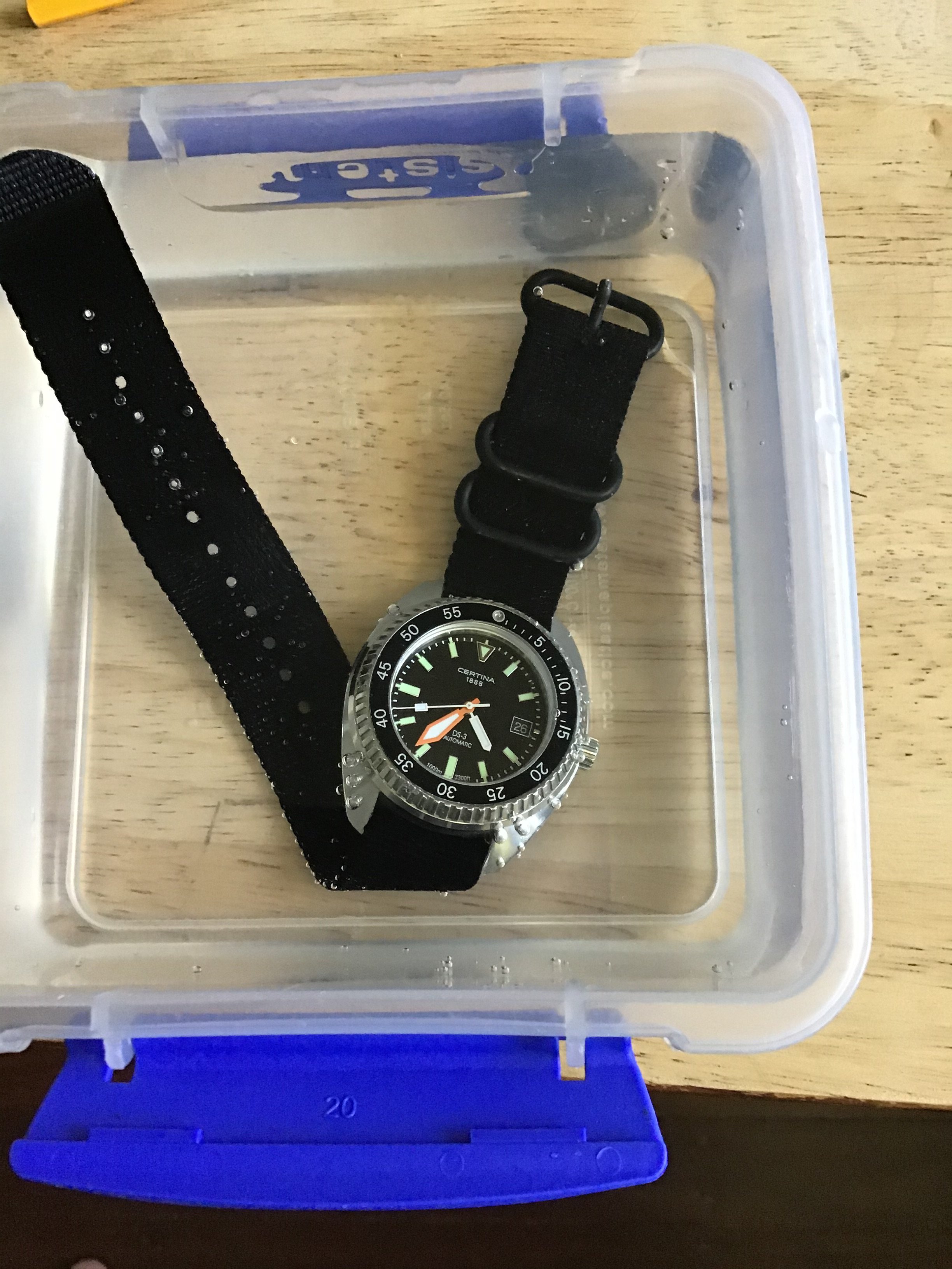

Or a simple Tupperware container for 30 minutes and a wash under running water will do 👍
