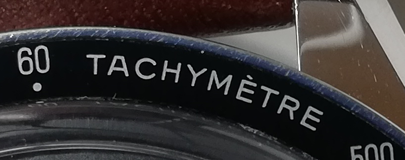

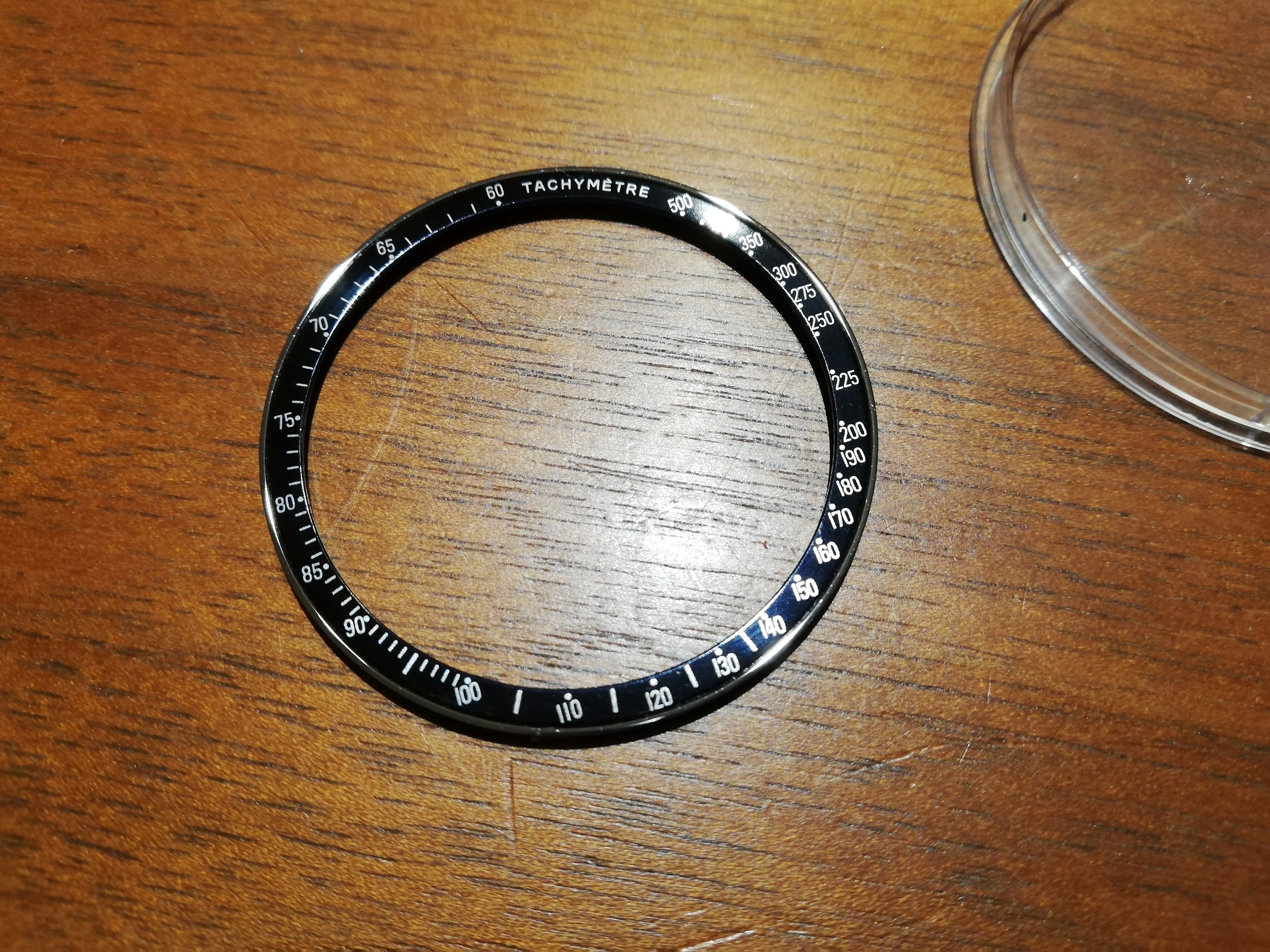

Hi all,

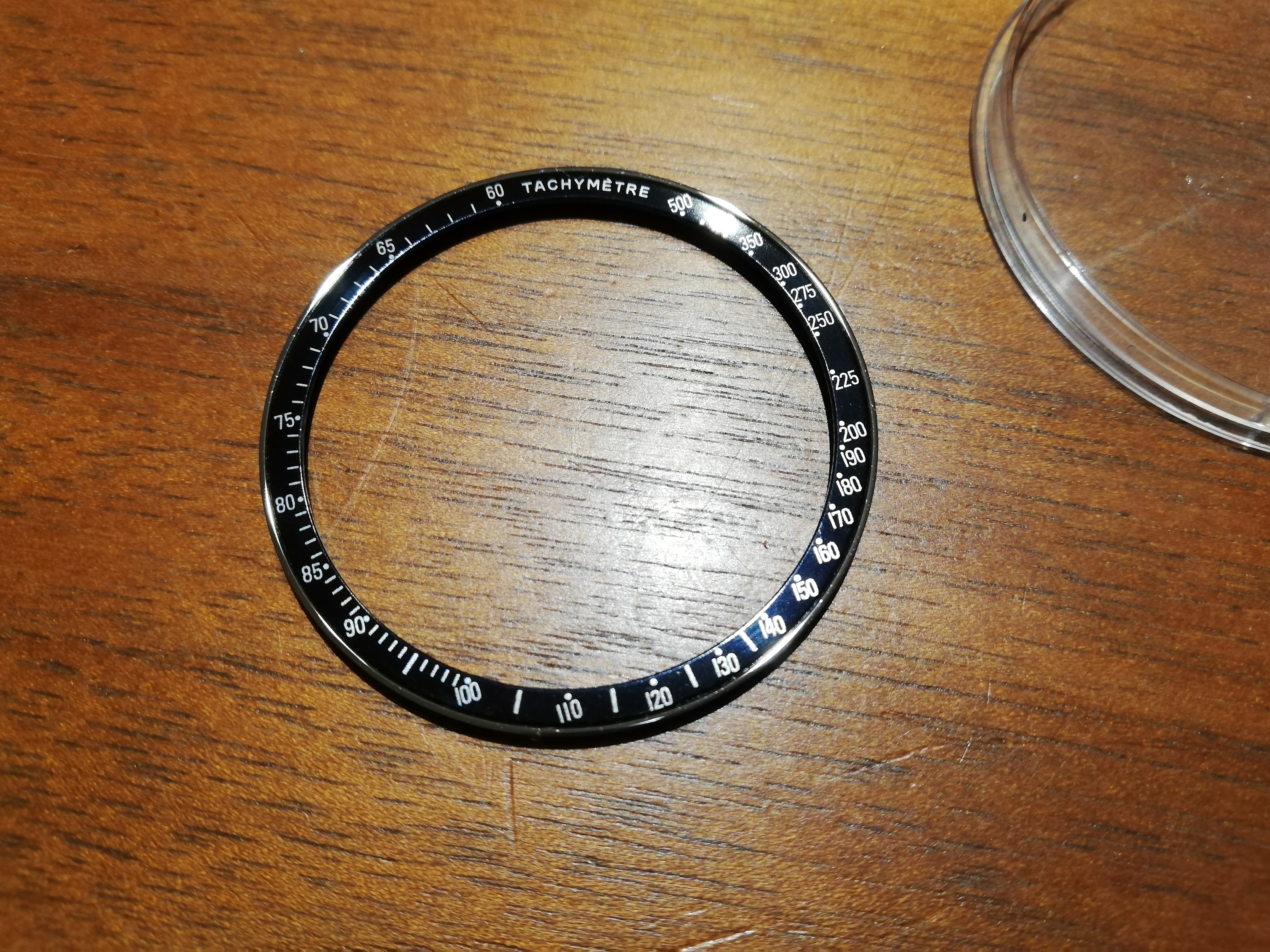

recently i bought a bezel from a long time member here on OF. It was sold as an original Omega Speedmaster Professional bezel.
I didnt really scrutinize it upon arrival, since at the first glance it looked good. Today i decided to check it out closer under a magnifying glas and compare it to the bezel of my FOIS.
I hope i am just paranoid 馃榾 but you never know, these days the fakers are getting better and better.

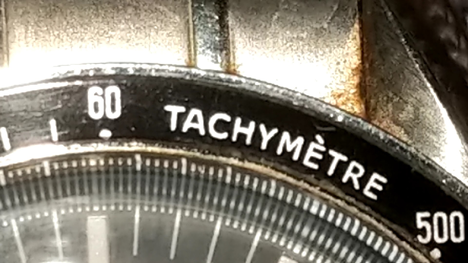

The things i notice are:

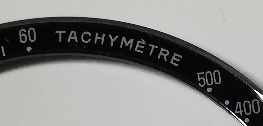

1) the Accent in Letter E in the word TACHYMETRE is touching the Letter E.

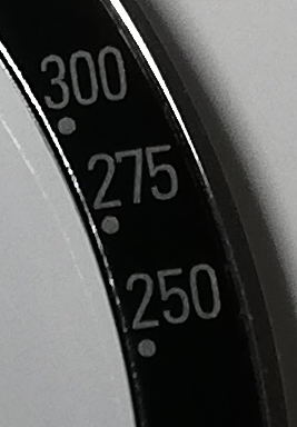

2) the printing of numbers and dots under magnification has some minor imperfections, like the edge of the Dot under 60.
(but as we all know, if you zoom far enough you will allways see something..)

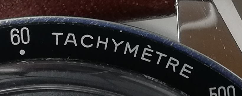

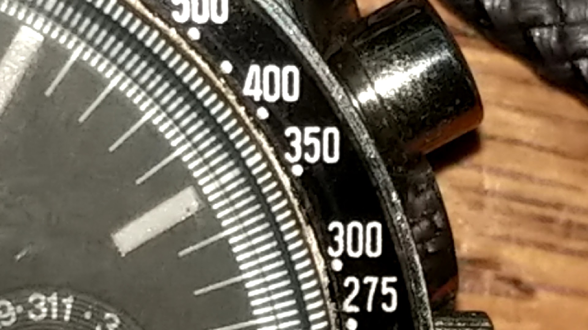

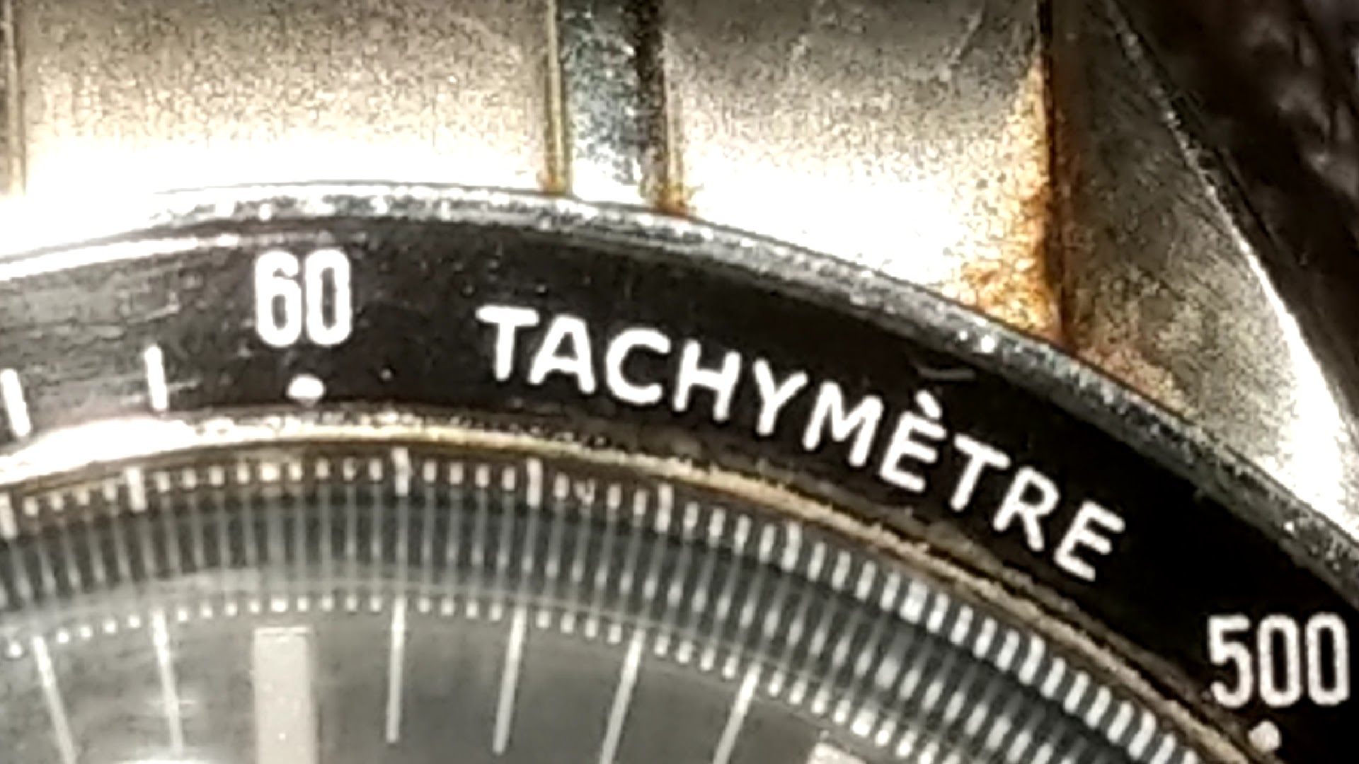

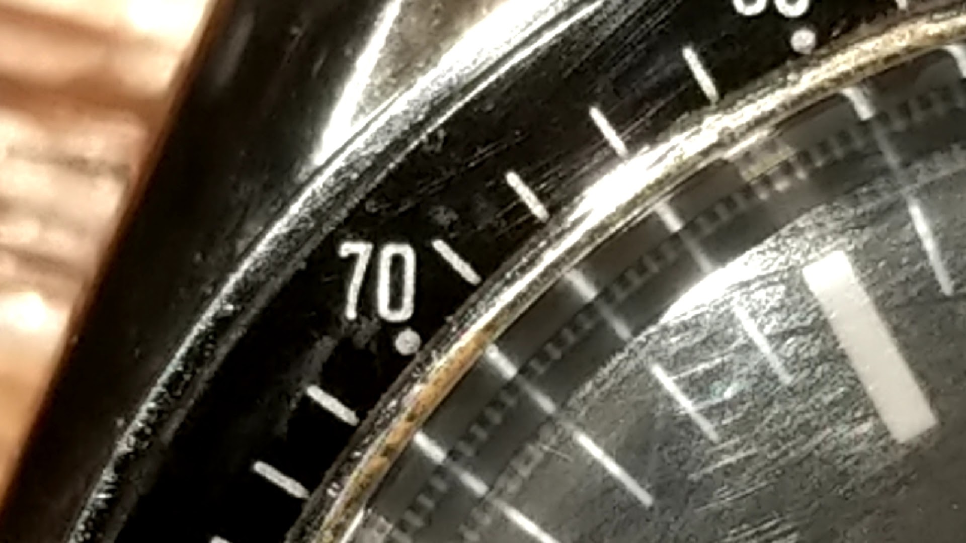

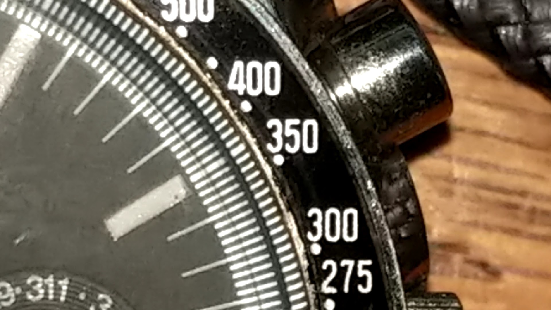

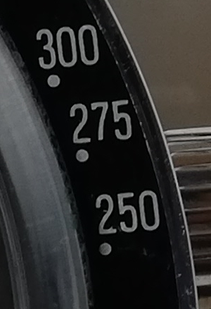

Thats my original FOIS bezel for comparison:

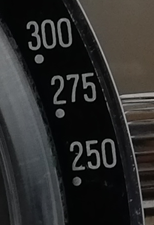

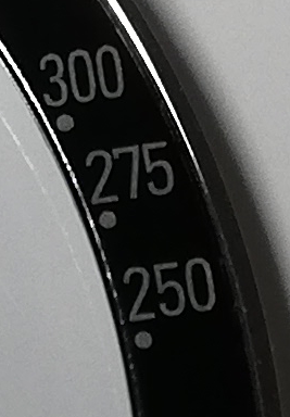

FOIS on the left (Numbers 2 and 7 in 275 looks more curved):
Then i googled for Speedmaster Bezels, i found a few dealers, who offer reproduction bezels, and they also have an Accent touching the letter E in word TACHYMETRE. That was the trigger when i started doubt originality.
What are the other tells?

the font difference on the 7 is worrisome, but I am not up on the bezel differences on ones made in the last decade. At the very least it is from a different batch then yours and in the future might be considered wrong as that is not the variation that it shipped with.

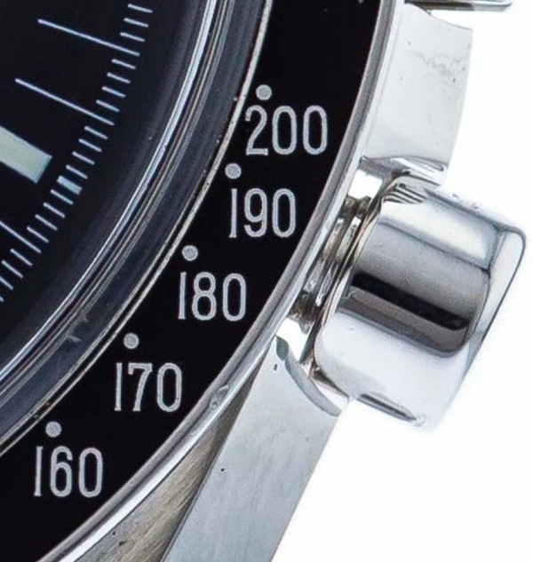

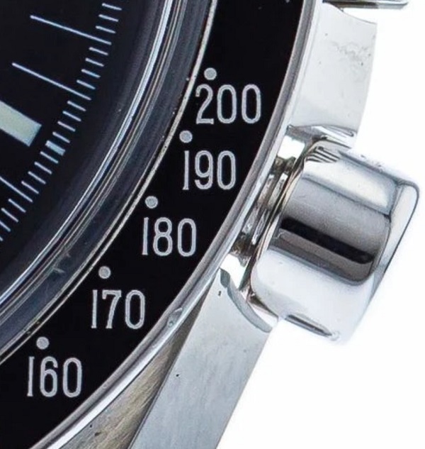

I am no watch expert, but when I compare the bezel to new Speedmaster pictures, it seems the Dot above the "190" is more to the right on your bezel than on the new watch bezels.
On a new Speedmaster watch, the Dot looks like the Dot on the letter "i" right above the "1" in "190".
Not sure if this Dot above the 190 changed over the years or if it is a difference you should notice in your bezel.
Here is a picture of the 190 on a new bezel.
Edit: I did some checking of Speedmaster pictures on the internet and the older DON bezels did have the Dot above the 190 a bit to the right of the "1" digit. But, checking the DNN bezels since 1970, it appears they have the Dot above the 190 directly above the "1".

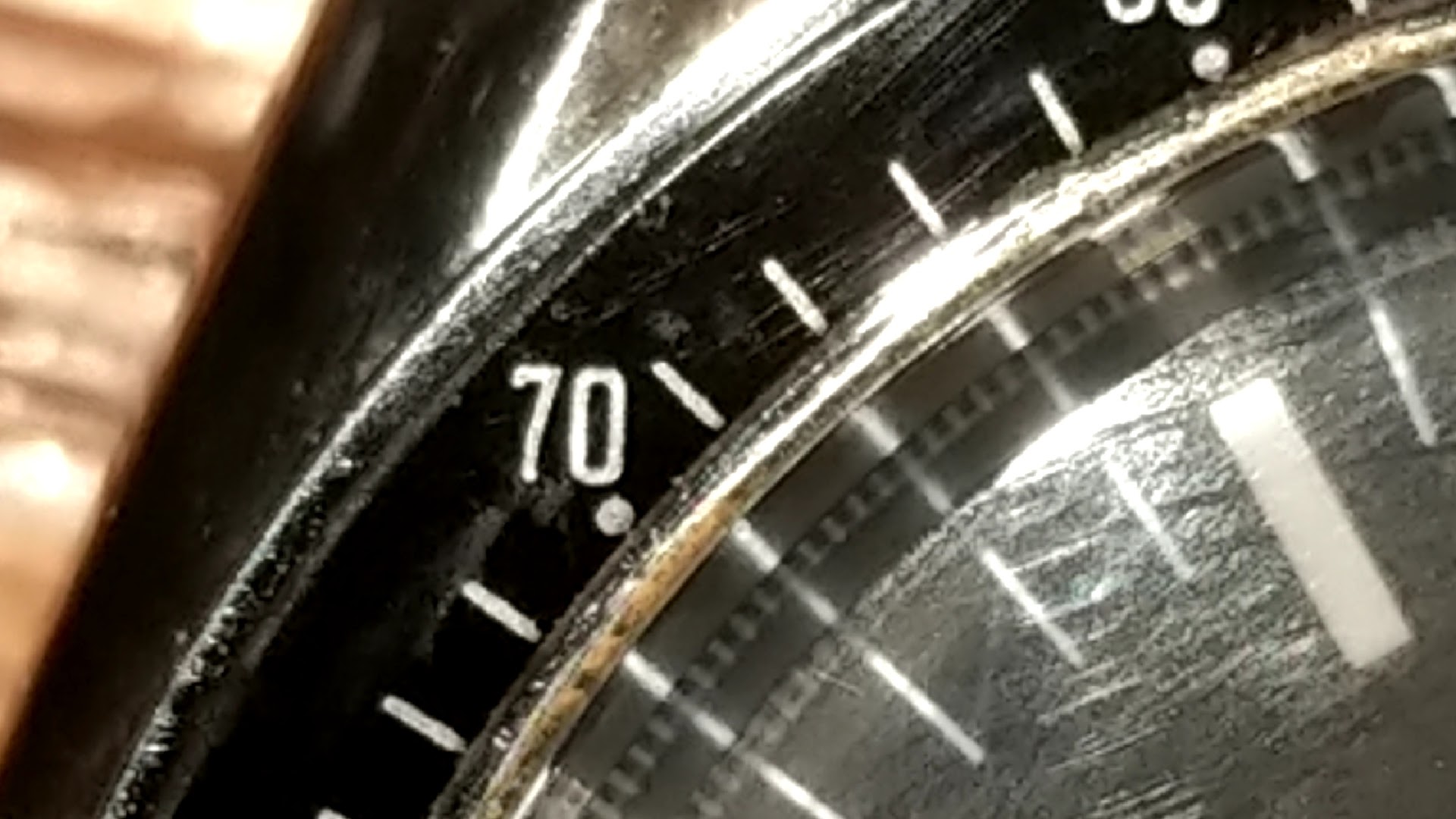

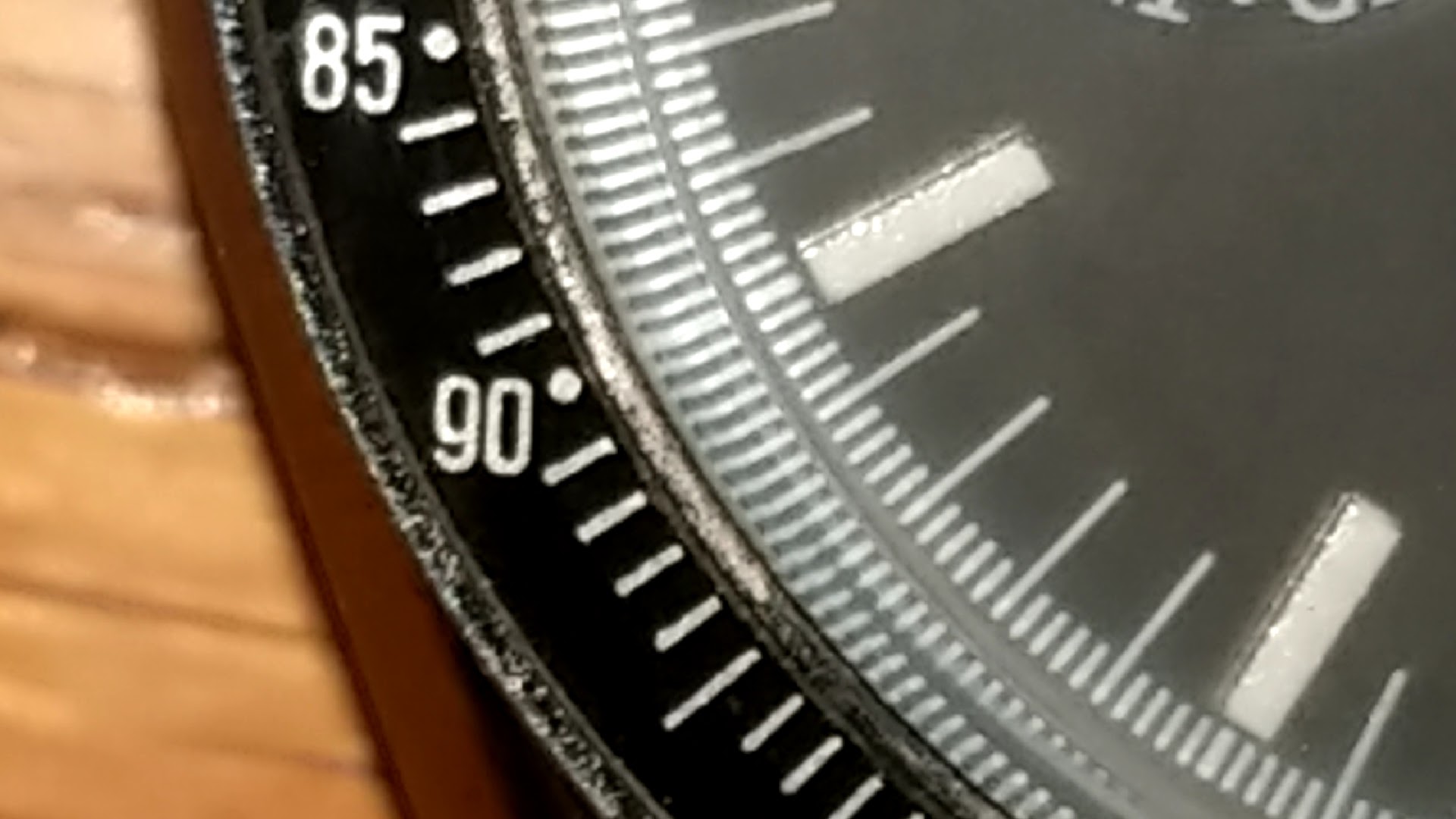

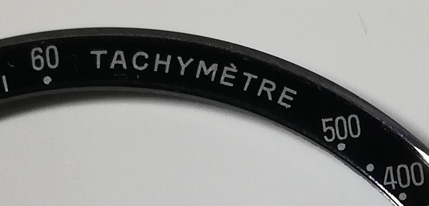

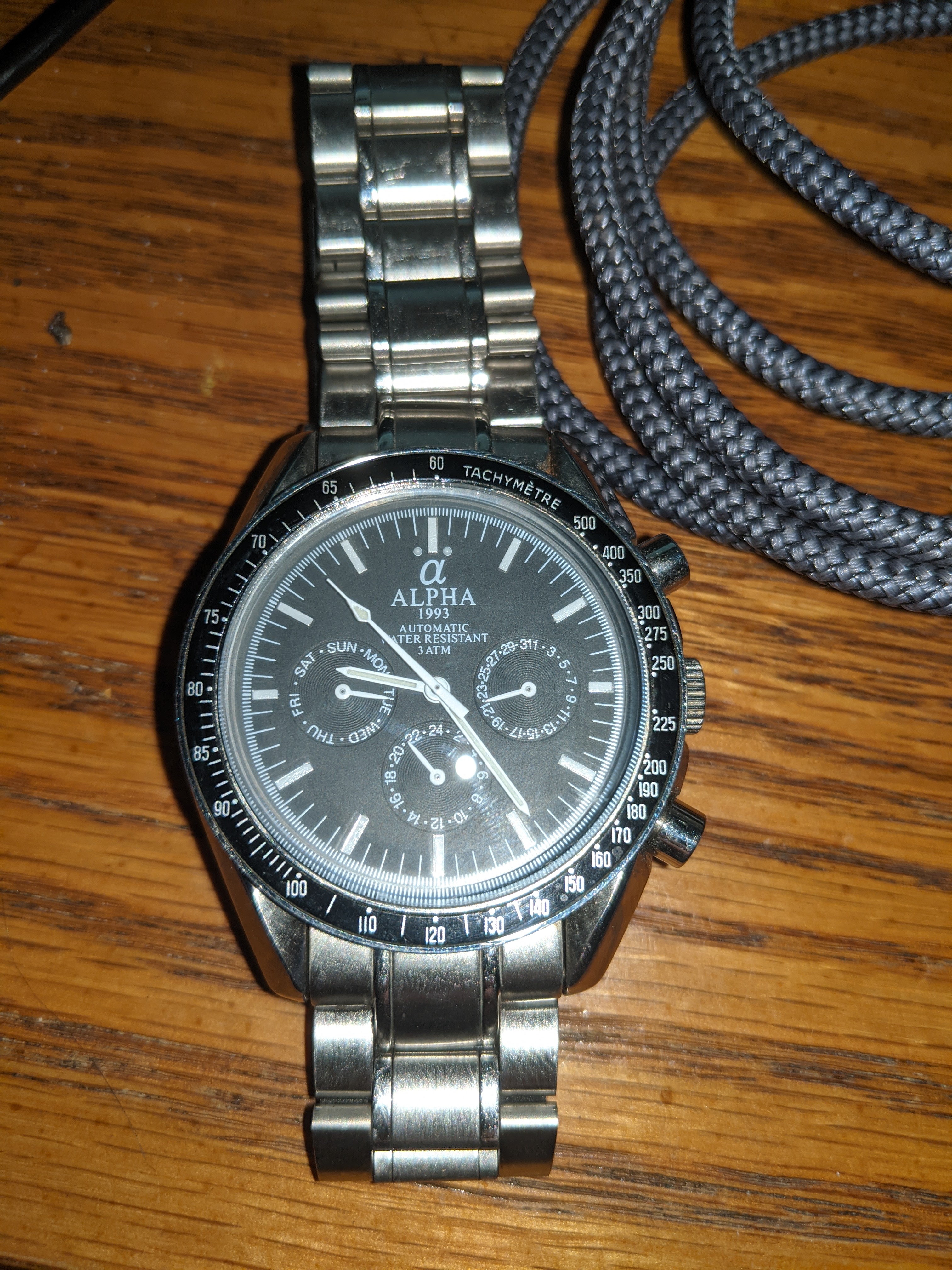

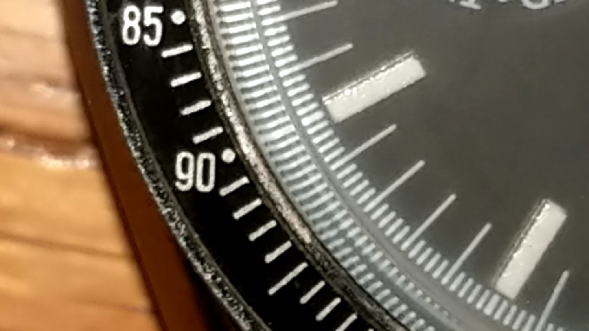

Ok, here are some pictures of a bezel I have - it isn't actually alised like it looks in the pics - that's artifacts from the fact that I have no macro lens and I'm using my cell phone with a magnifier app:
To me, this looks somewhat better than the one the OP is asking about. But it comes from this watch:

2,510
3,737
I dont want to help fakers to point out the details with this thread. but i guess it is clear somehow that the bezel is not original.

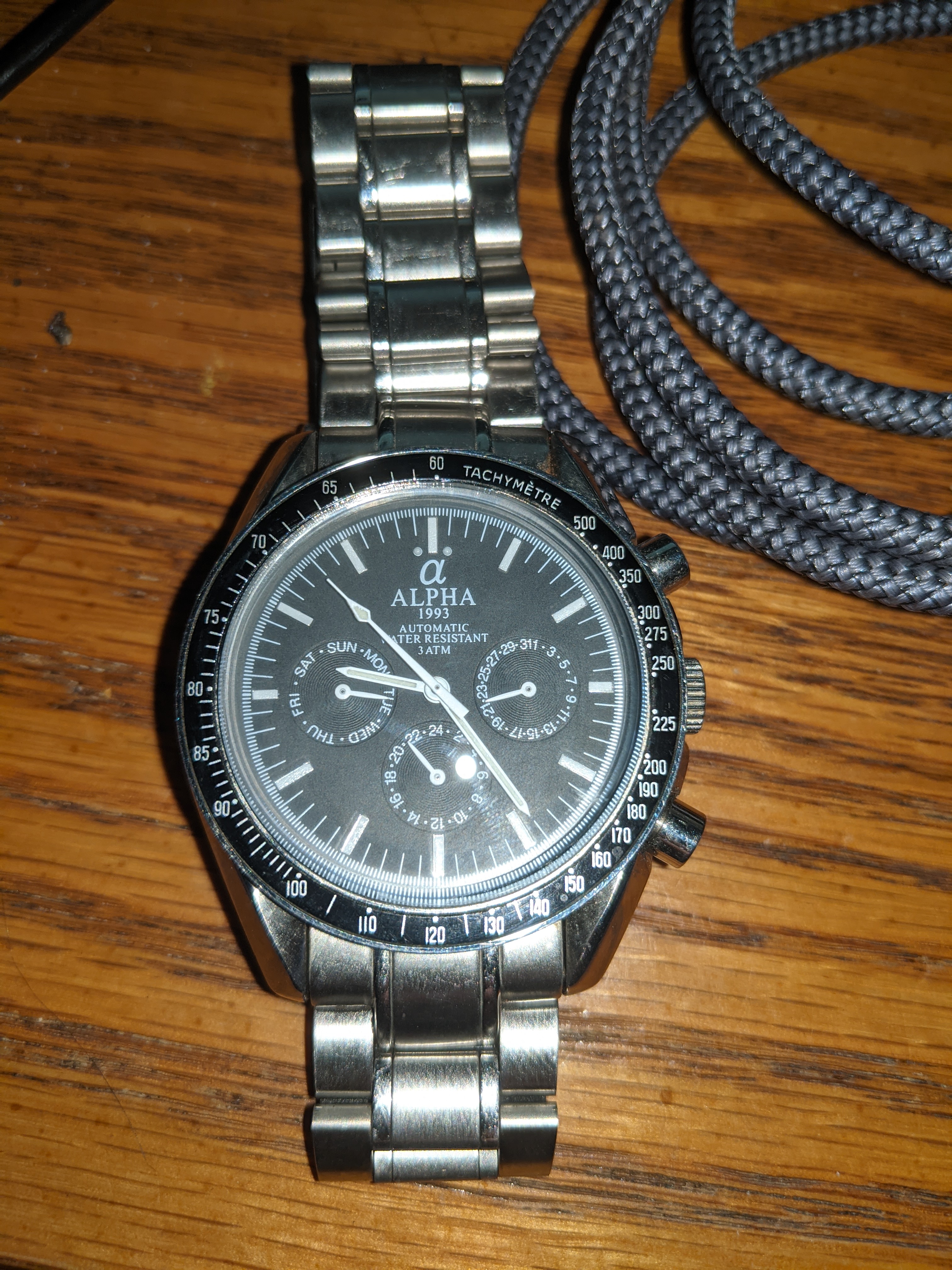

What's odd is that looking at the bezel on my Alpha I am not picking up on any tells that it isn't genuine, which is kind of scary.
1,678
5,309
Maybe it is genuine 馃槜 馃榿
Just kidding 馃榾 I believe i see a few tells on your photos.
