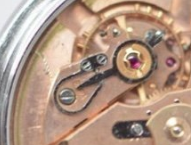

    Won an auction online the other day for an "Omega Constellation Pi-Pan, waffle dial, Steel, Ref 2852 1SC, Caliber 501, 1956".
    Received the watch today and I am a bit concerned that it might be fake. The condition is practically new, even though it should be over 60 years old. After some googling I understand that there are a lot of really well done fakes out there. I have tried to follow guides to authenticate it, but I'm still not sure.
    I paid about $1k.
    What's the verdict? Thanks. 305705070_0a2160d7-e9dc-4db4-b206-423cf38da14e.jpg 305705070_41b868a2-9670-4127-a286-1205f0118b08.jpg 305705070_dca7151b-2c03-4f1e-8d27-ba6f22f540b2.jpg 305705070_3f53b14e-7df9-4cdc-a016-871048ce5f81.jpg 305705070_49bc0f99-ae25-423e-b484-2f48bbd4f0d3.jpg

    It's a repainted dial

    I cant read the caliber number but should be a 505 i think

  5. X350 XJR Vintage Omega Aficionado Apr 25, 2019
    12,629
    29,961
    Yes, it's genuine, unfortunately it's in really poor condition with a refinished dial. It appears to you to be "practically new", but this is because you don't know what a correct one should look like.
    Sorry, it's a mess.

  6. Shabbaz Apr 25, 2019

    Caliber 501 is a non chronometer movement. Although i can not read the movement (i'm on my phone) i can see 19 jewels on the rotor. But a 505 has 24 jewels i think. So it could be a franken too.

  9. STANDY schizophrenic pizza orderer and watch collector Apr 25, 2019
    16,356
    44,939
    You ask here, then buy. It’s a lot cheaper that way :thumbsup:
    Redialled, movement missing a screw
    The one that goes here

    I did a quick search and it looks like the early 2852's came with the cal 501.

    Omega did produce a chronometer rated 501 with 19 jewels but only for one year.
    Desmond advises caution as non chronometer movements have been ‘enhanced’ by swapping out the rotor for a chronometer version.
    The colour differences on this movement would certainly make me question its originality.
    Perversely, the ‘19 jewel adjusted 5 positions’ rotor may be the most valuable part of this watch to a collector as they are as rare as hens teeth.
    @komakino
    If the seller described the watch dial as original, I would return it if you can.

  18. JimInOz Melbourne Australia Apr 25, 2019
    15,492
    32,385
    Not missing Andy, it's just the head broken off and the shank is still in the spring boss.
