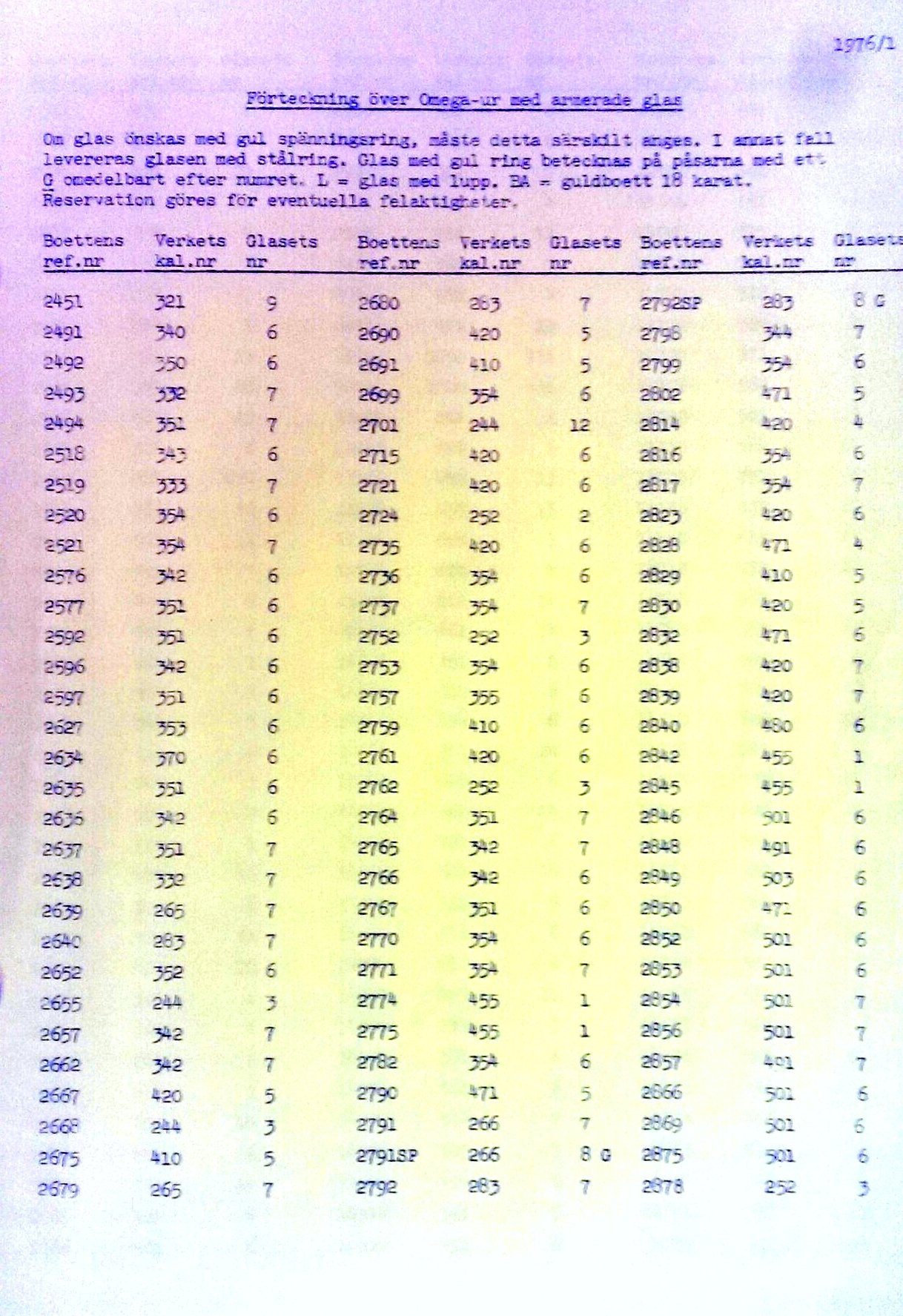

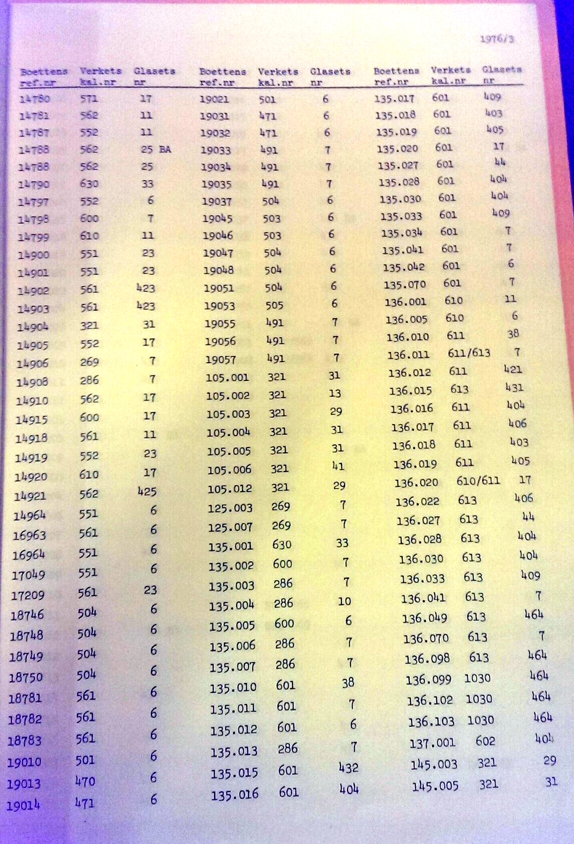

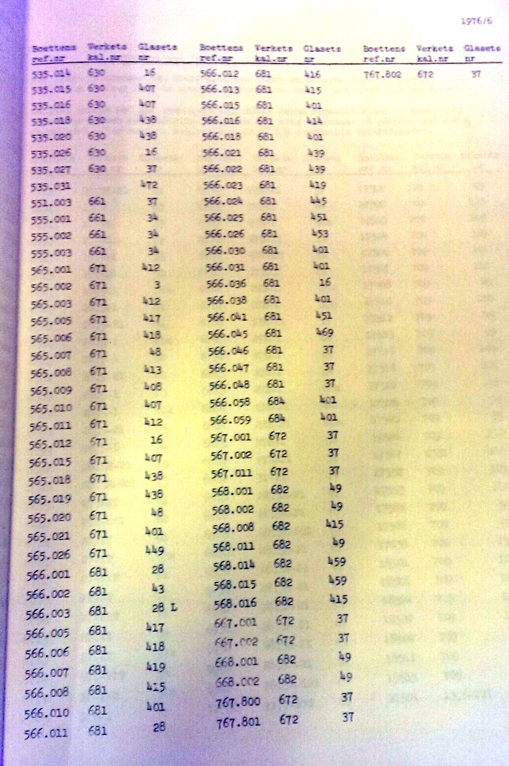

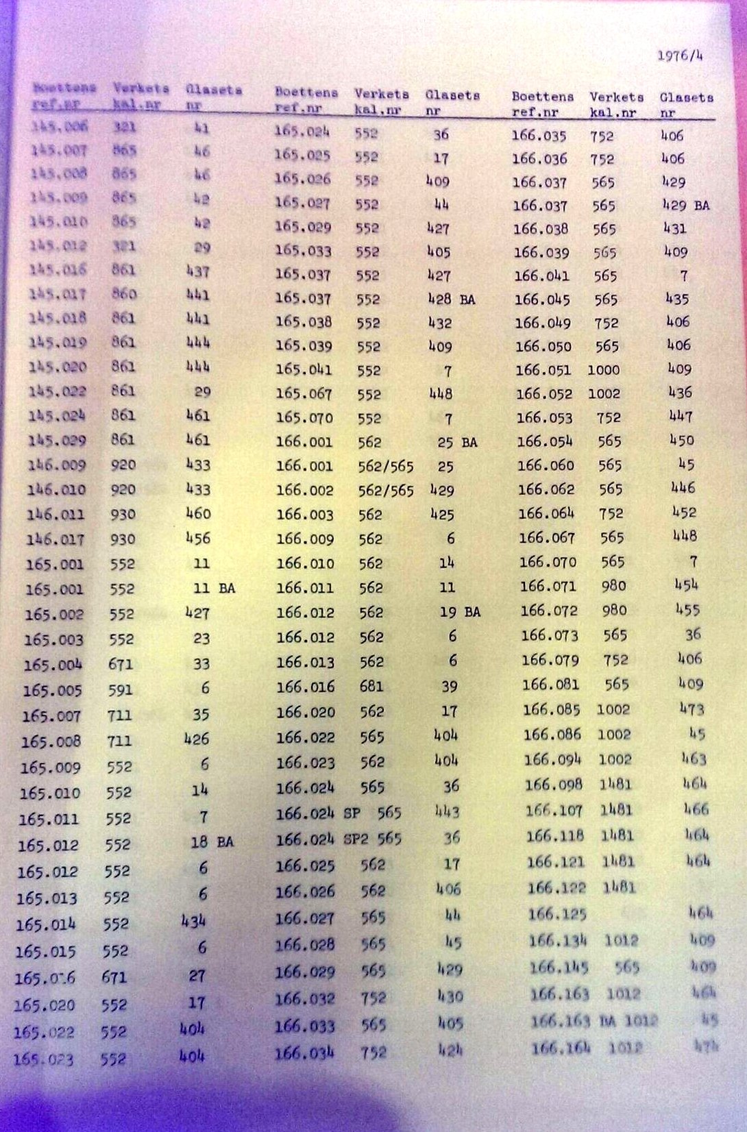

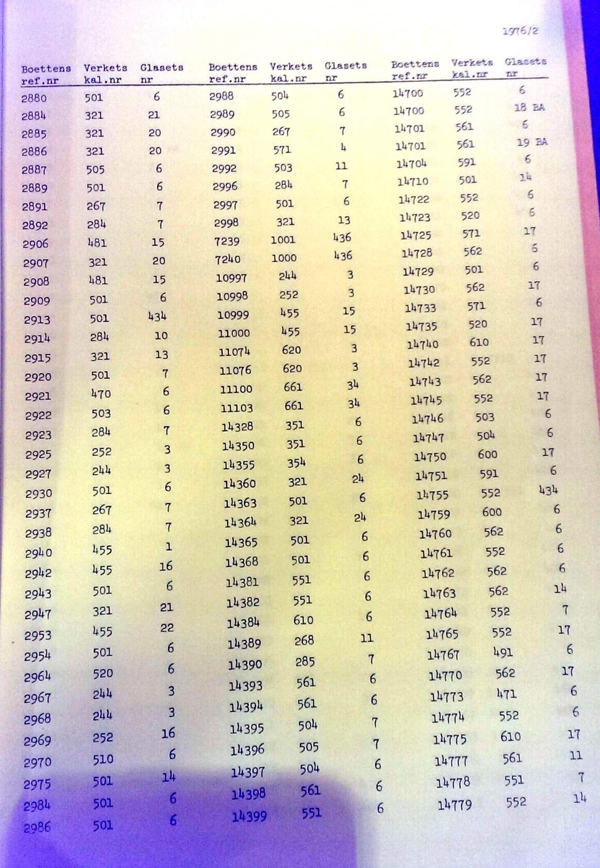

I don't suppose there's a page 5 of this anywhere? The source also has pages 1, 2, 3, 4, 6. Or can anyone please confirm the Swedish crystal ref for case 168.018 / 029 is 47?
The crystal ref for both the 168.018 and 168.029 are listed in the first post...
140
114
Thanks, yep I see the Swiss (?) ref is 5118, but was wondering about the Swedish ref. I think it’s 47 but would have been on page 5 of the other catalogue posted.

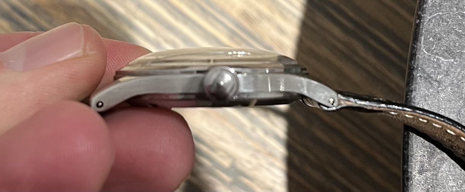

062PN1094 is the crystal for this watch, and yes OD is 31.4. Note that this is not a tension ring crystal, so it is not pressed in. The OD of the crystal is collapsed slightly in order to get it installed.
Digging this thread up, I’m looking everywhere for 2 crystals of this ref, 062PN1094, or at least a similar compatible as I understand these were not signed anyway, but can’t find any…
Any tips of where to look?
Thanks!

I can't help with a 062PN1094, but what do you mean by similar compatible? If you want a generic crystal, you should be able to easily find a non-tension ring crystal with an OD of 31.4mm. You just need to figure out what profile you need. They're available from any watch parts stock house in the US and they're also available from Cousins.
739
1,027
Thanks! A generic will do the trick, especially with these non signed crystals…I looked on the cousins website (anything similar EU based btw?) and there are many references with different profiles…
this is the profile of what I think to be the original crystal (or at least one that works well with!). Is it a regular dome? A low dome?
Are Sternkreuz crystals good quality?
thanks again! 😀

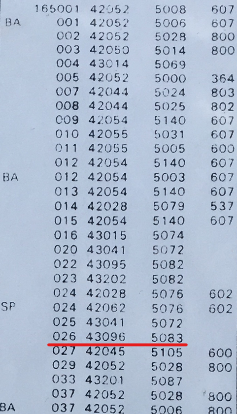

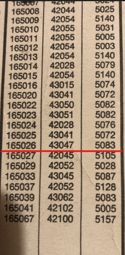

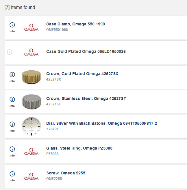

Hi everyone, I recently acquired a Seamaster Cosmic with reference 165026SP
I was looking for an original crown and I ended up on this thread thanks to some forum members. I also did my research and the funny thing is I ended up getting a variety of apparently corresponding crown references.
Now, how does this happen? Did they change the crown reference over time or are they somehow equivalent? I think I'd be able to find 2 of these crowns over the internet but I'm kind of confused 📖
1,733
14,794
They discontinue over time and get replaced with other references, I think they call it Bestfit.
29,672
76,830
Bestfit is a US company that produced and sold parts, and is not related to Omega in any way.
But yes, Omega does change the numbers/style of parts used on watches over time.

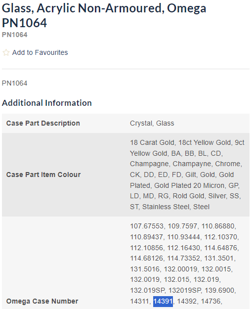

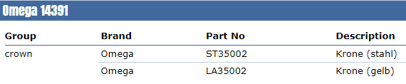

Very useful thread indeed!
However I'm not able to find the correct glass and crown for case ref 14391.
Can anybody help?
869
3,632
Can anybody help?
PN1064 (062PN1064) is the crystal you need based on Cousins, and 35002 is the crown based on Boley.
