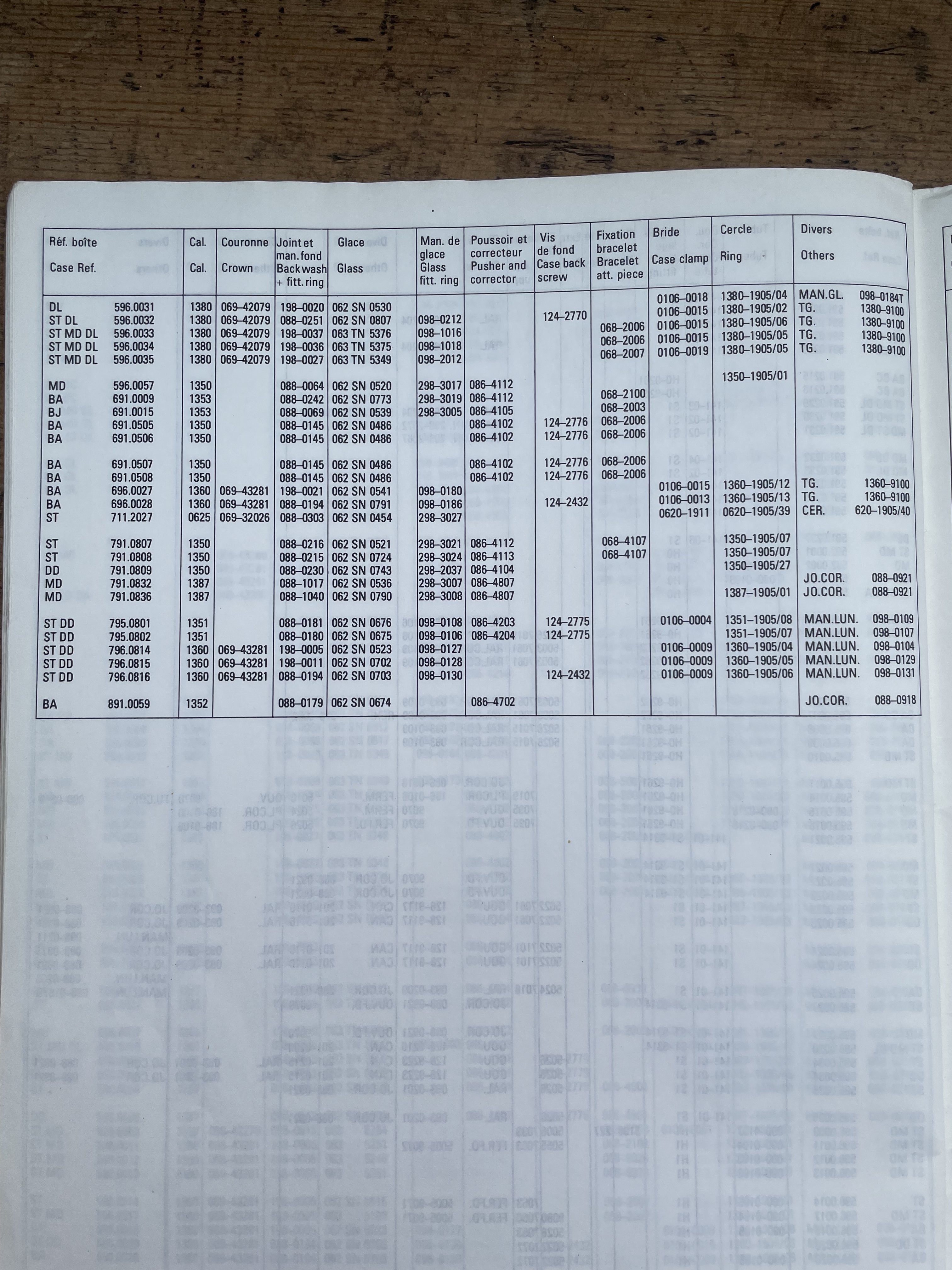

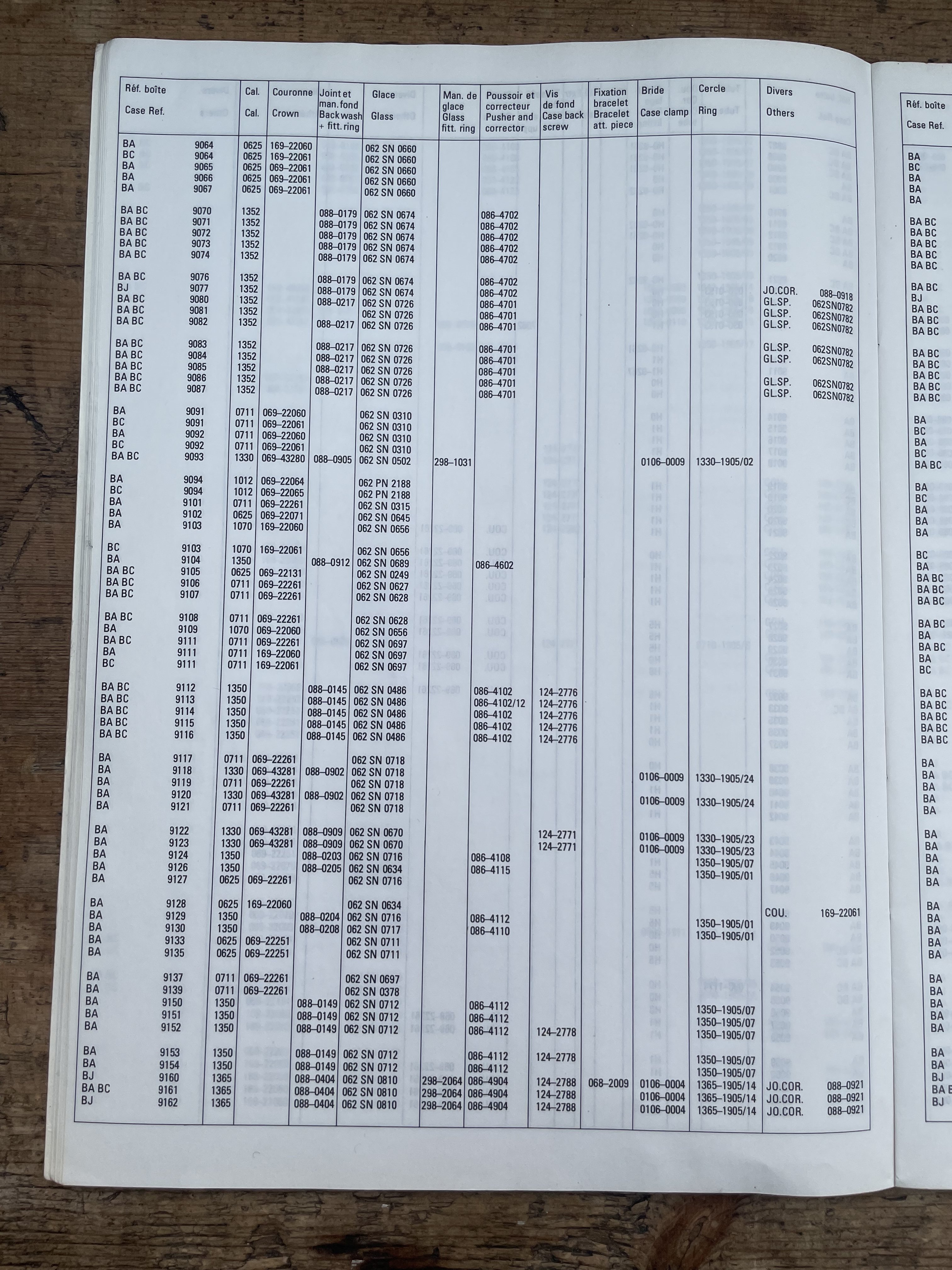

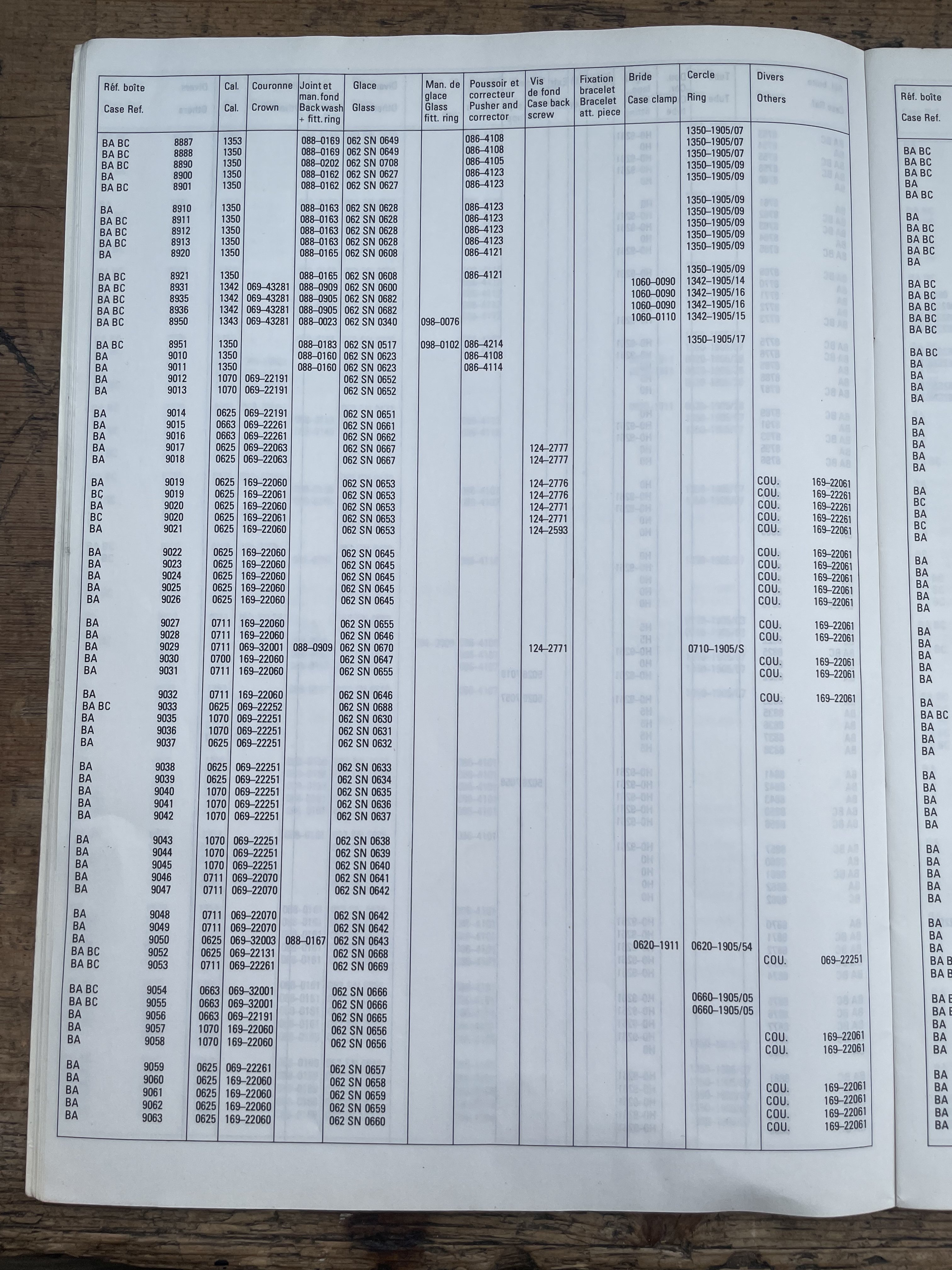

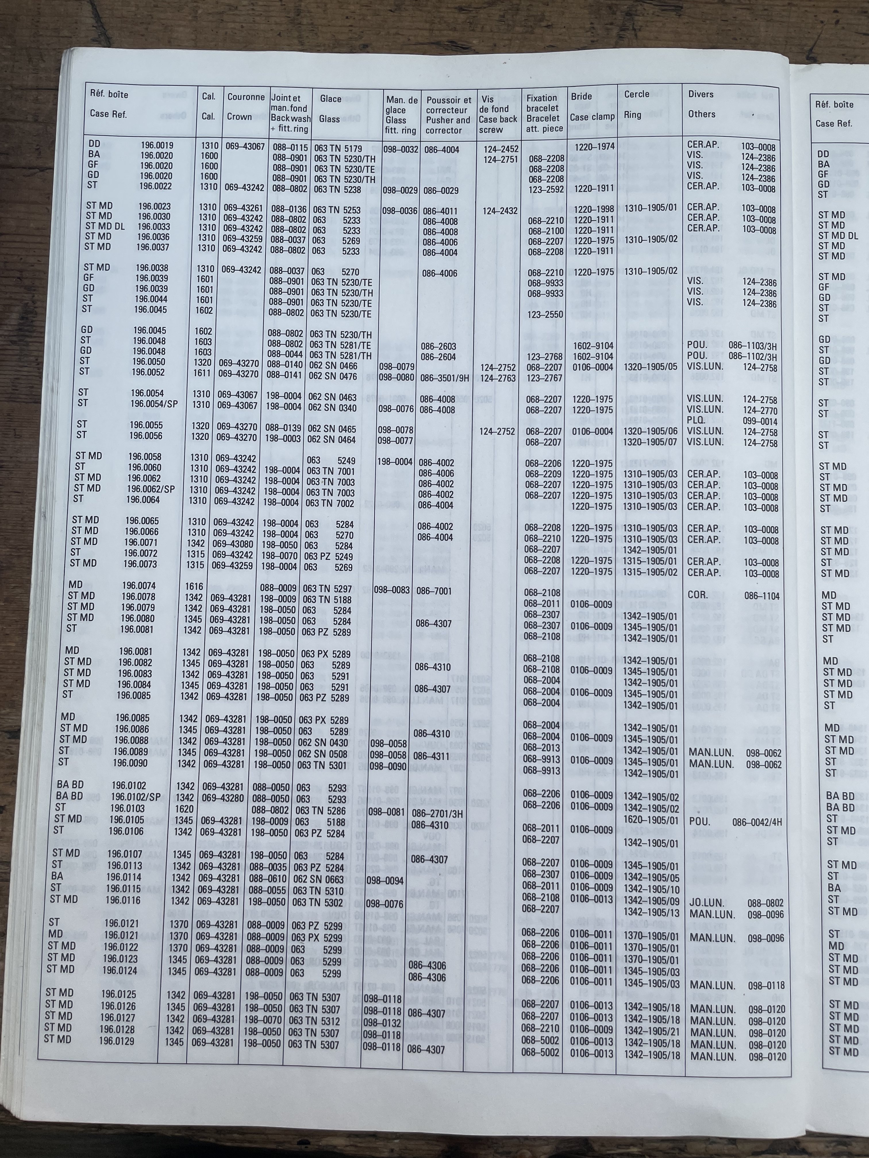

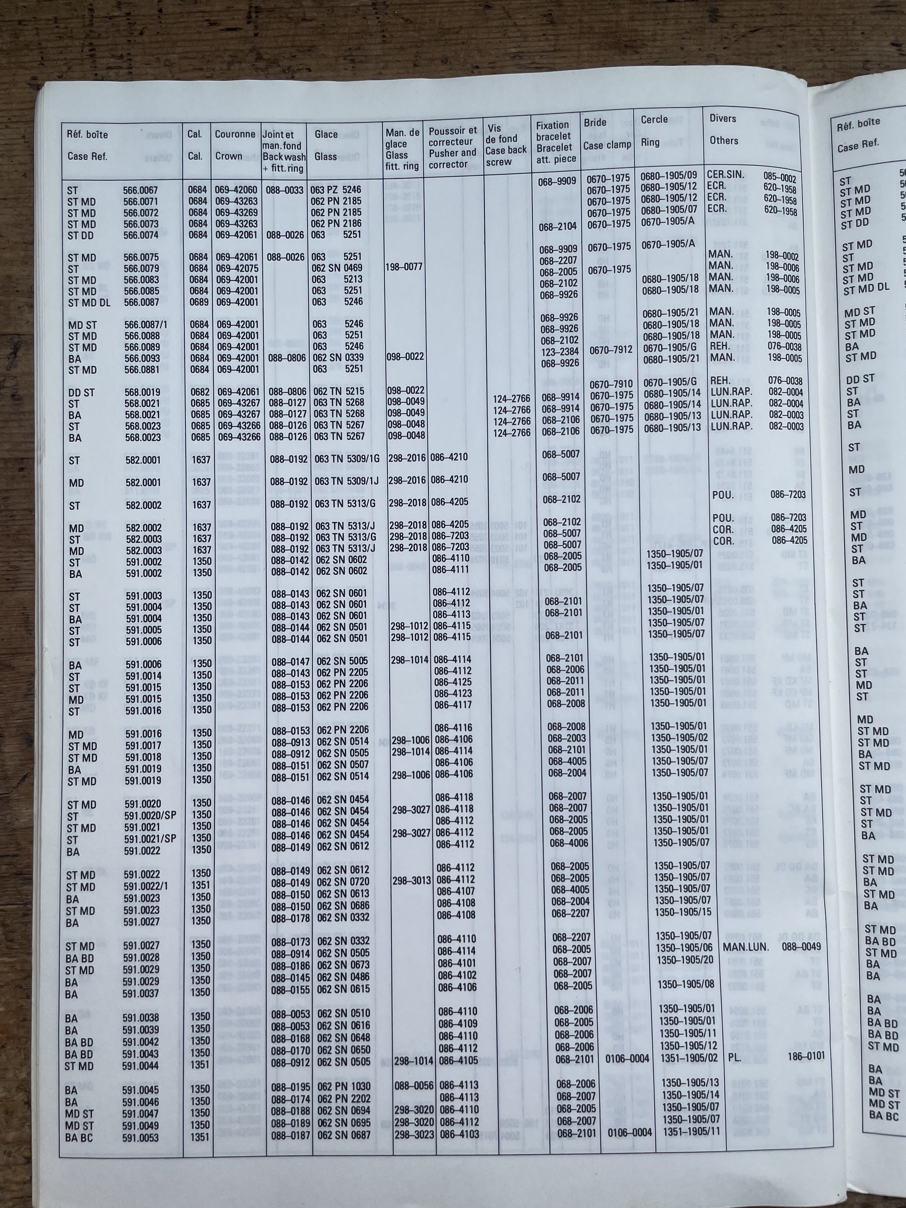

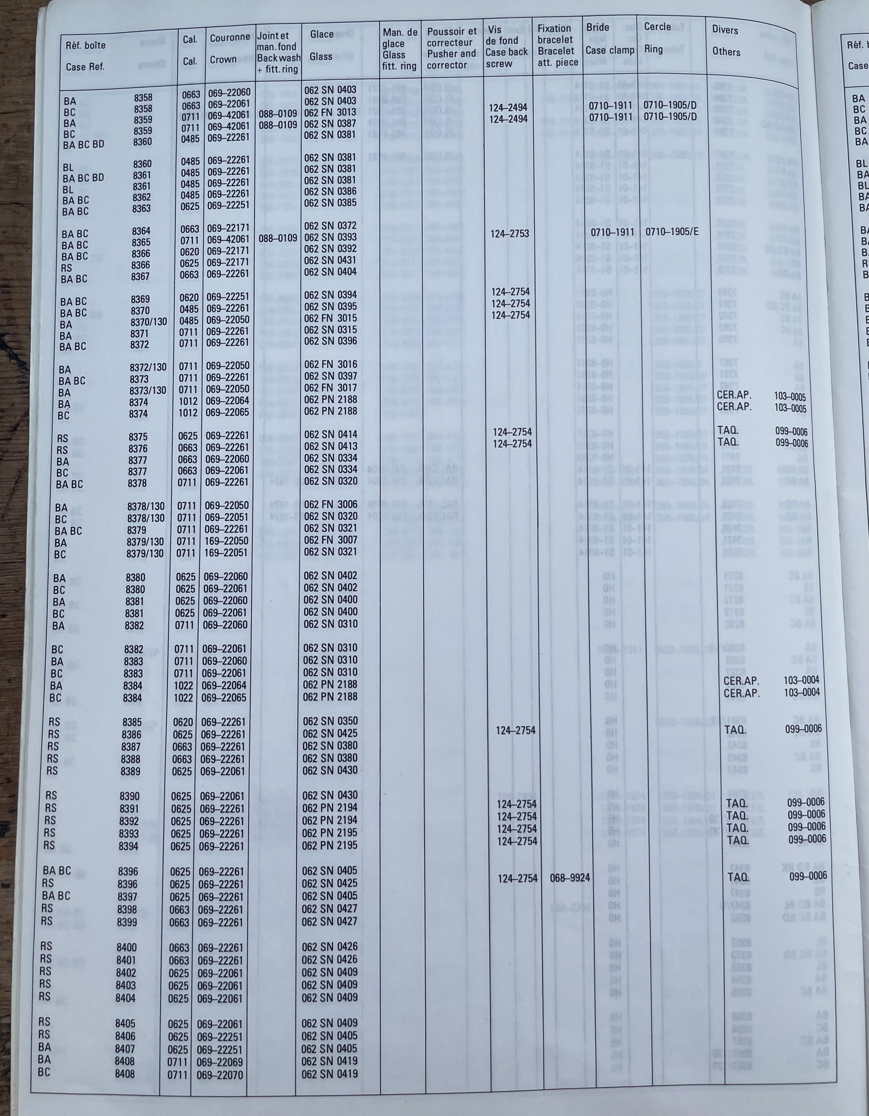

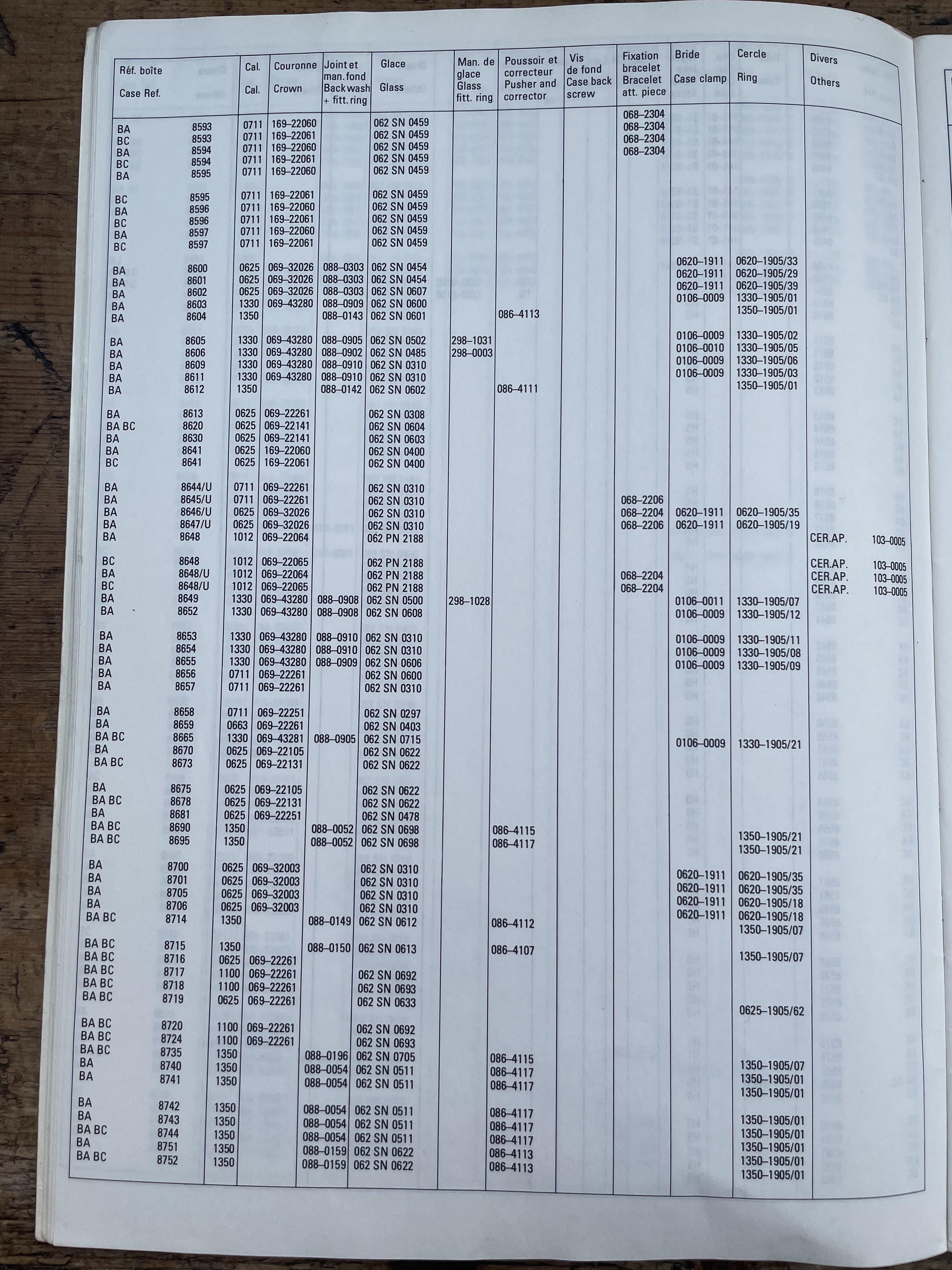

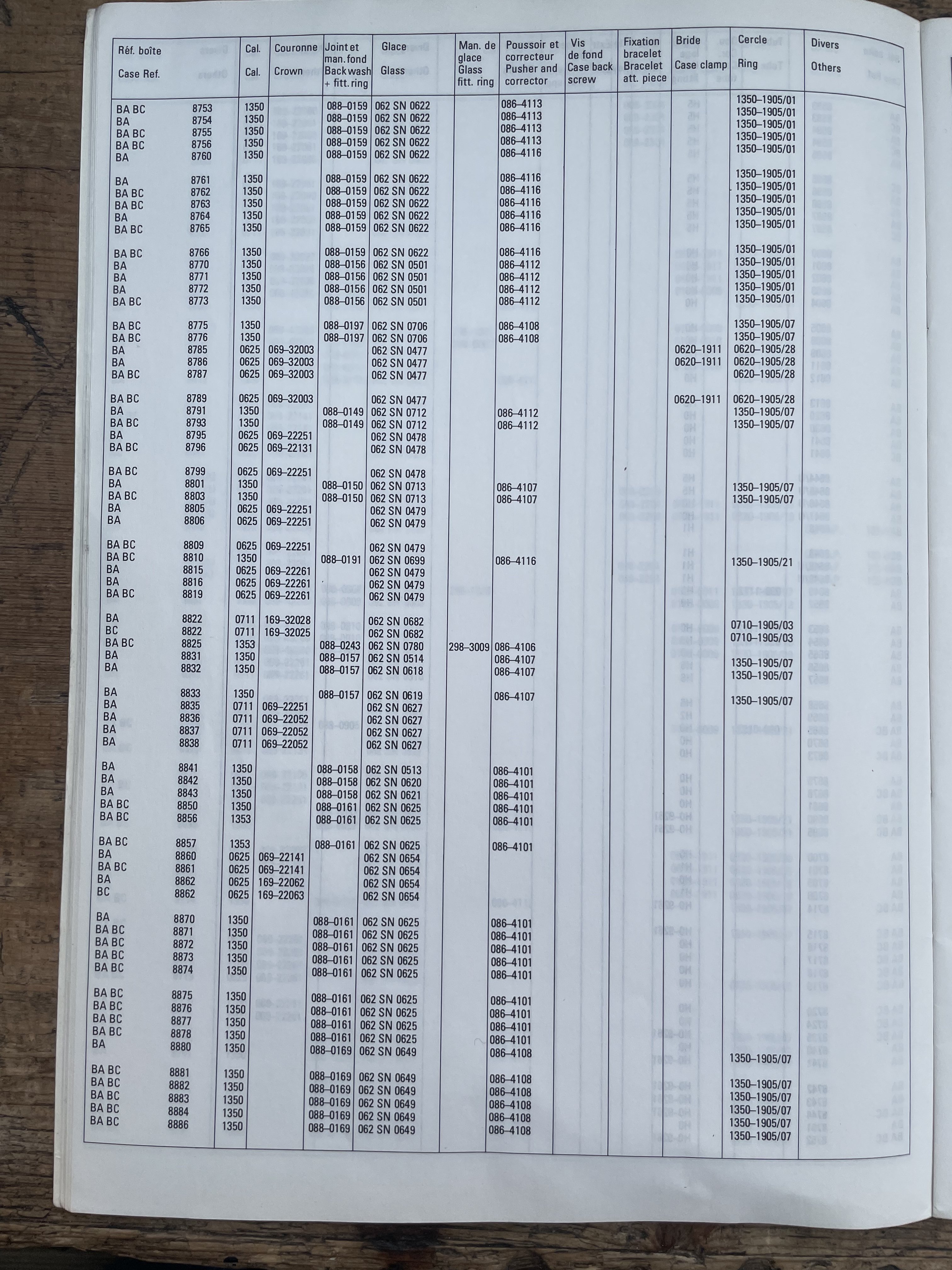

Crown-glass-gasket list.
739
1,026
Thanks a lot! Now this won’t be easy to find though…
Is there a brand doing generic crystals that does a better job than the others? 😁
739
1,026

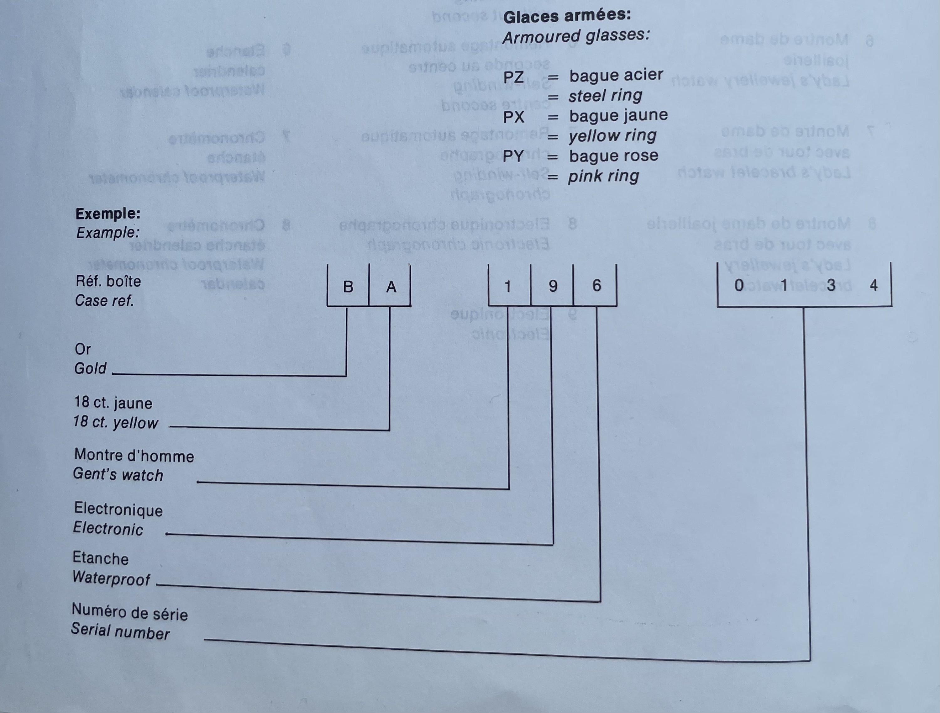

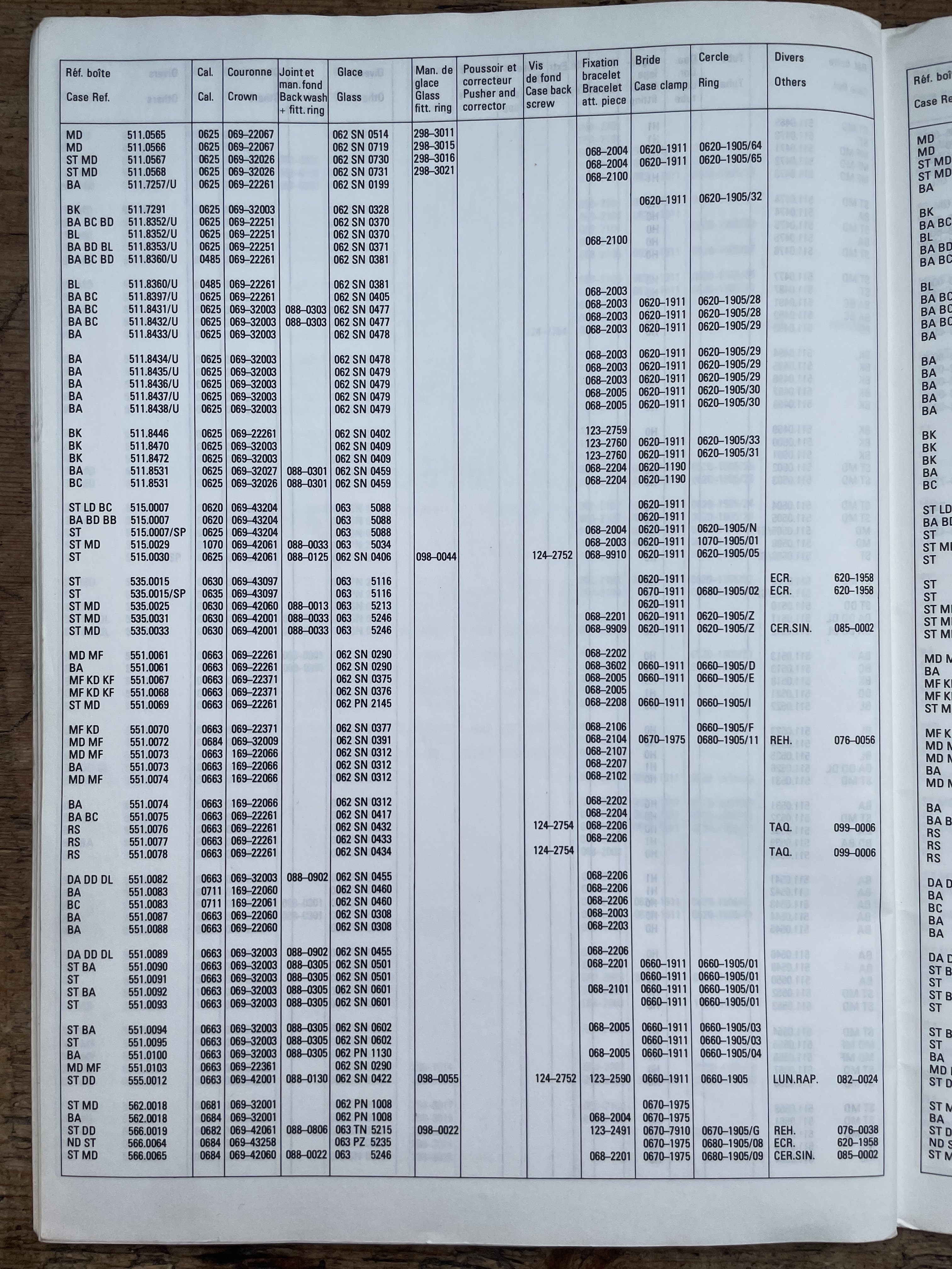

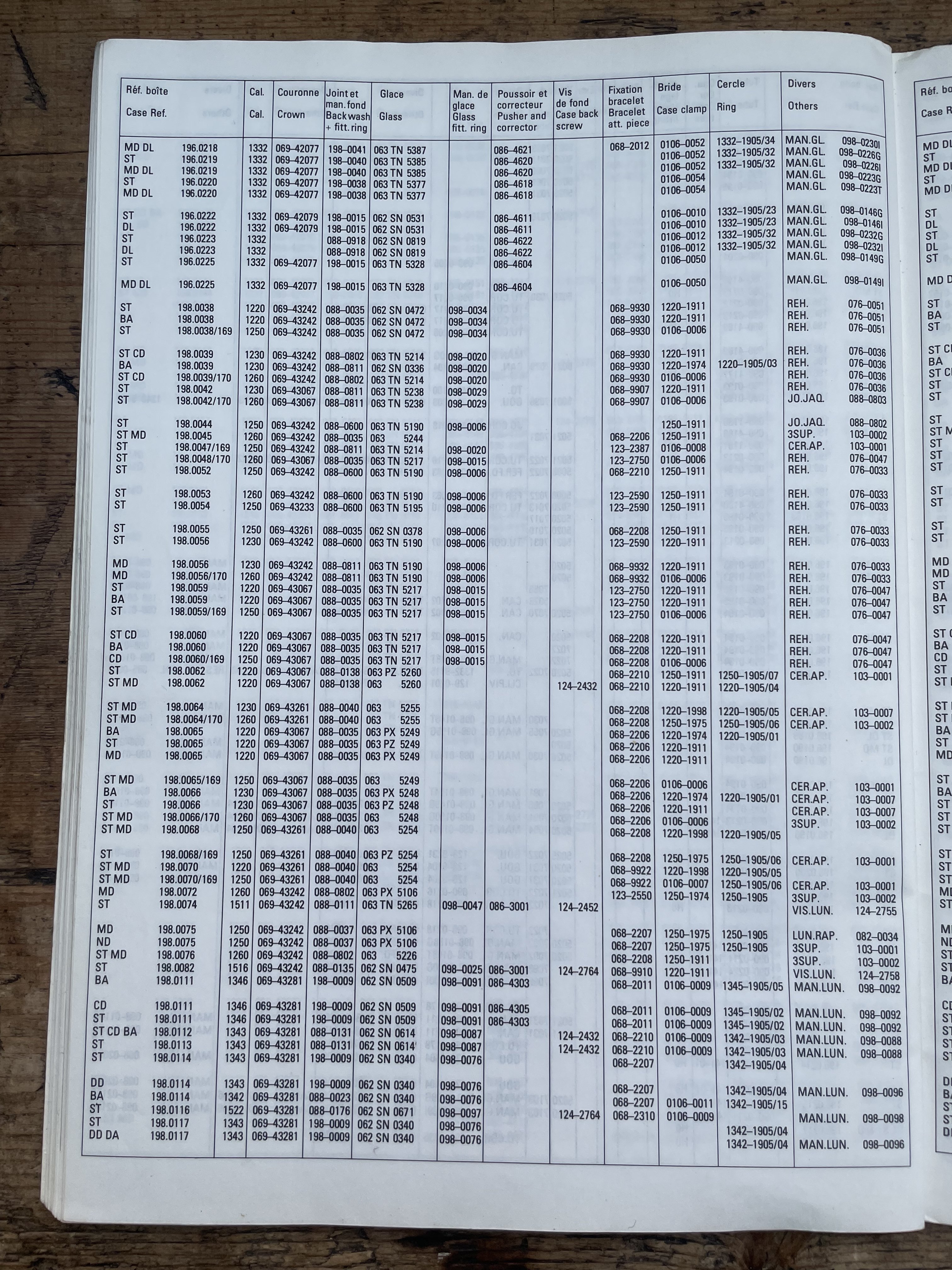

By the way, how do we know from those charts if there are supposed to be tension rings and what colour it should be?
for example, I noticed some of my favorite references share the same crystal, the 5005 (2639/50, 2937/38, 2990/96). Is the tension ring colour only supposed to match the aesthetics of the watch (gold or silver)?
Thanks again 😀
29,672
76,830
Thanks again 😀

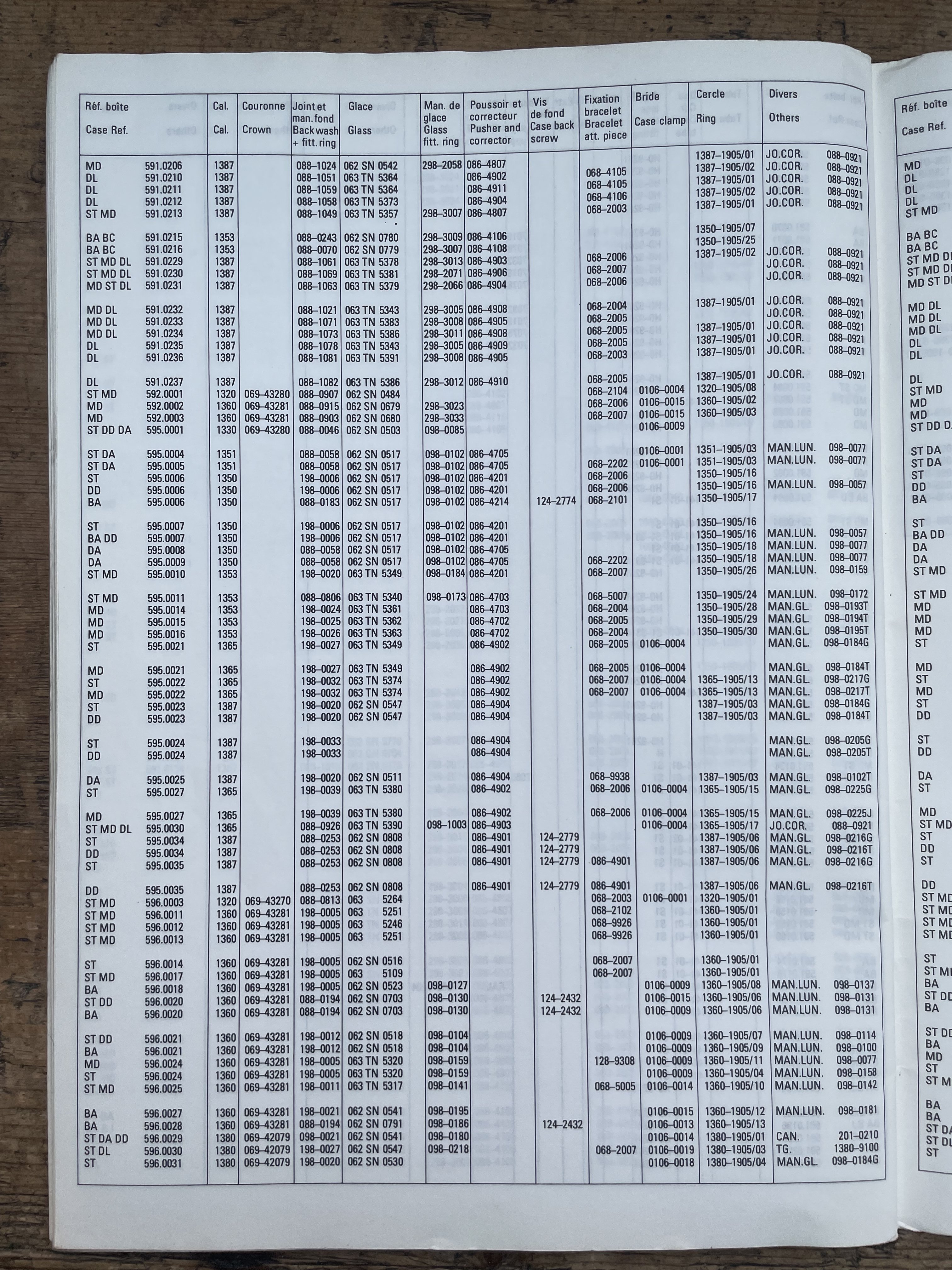

Tension ring colours match the case. Gold case, "yellow" ring. Steel case, "white" ring...

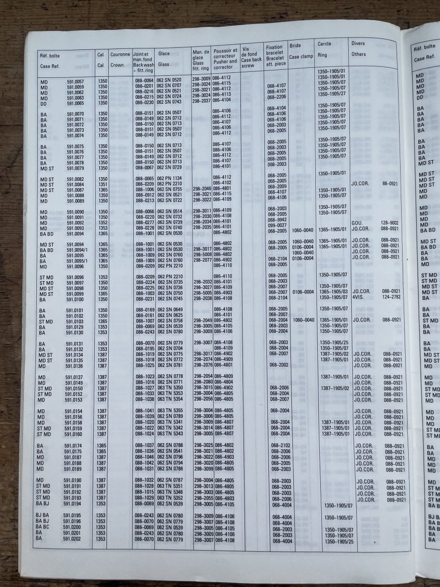

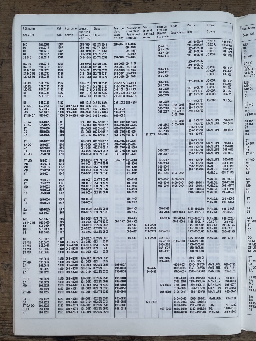

Not finding any info for reference 2504-10 in that list. Anyone can help with the crown reference?

Cousins suggests these 2 for ref. 2504.
PN1055
PN1065
Archer will surely know better 😀

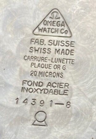

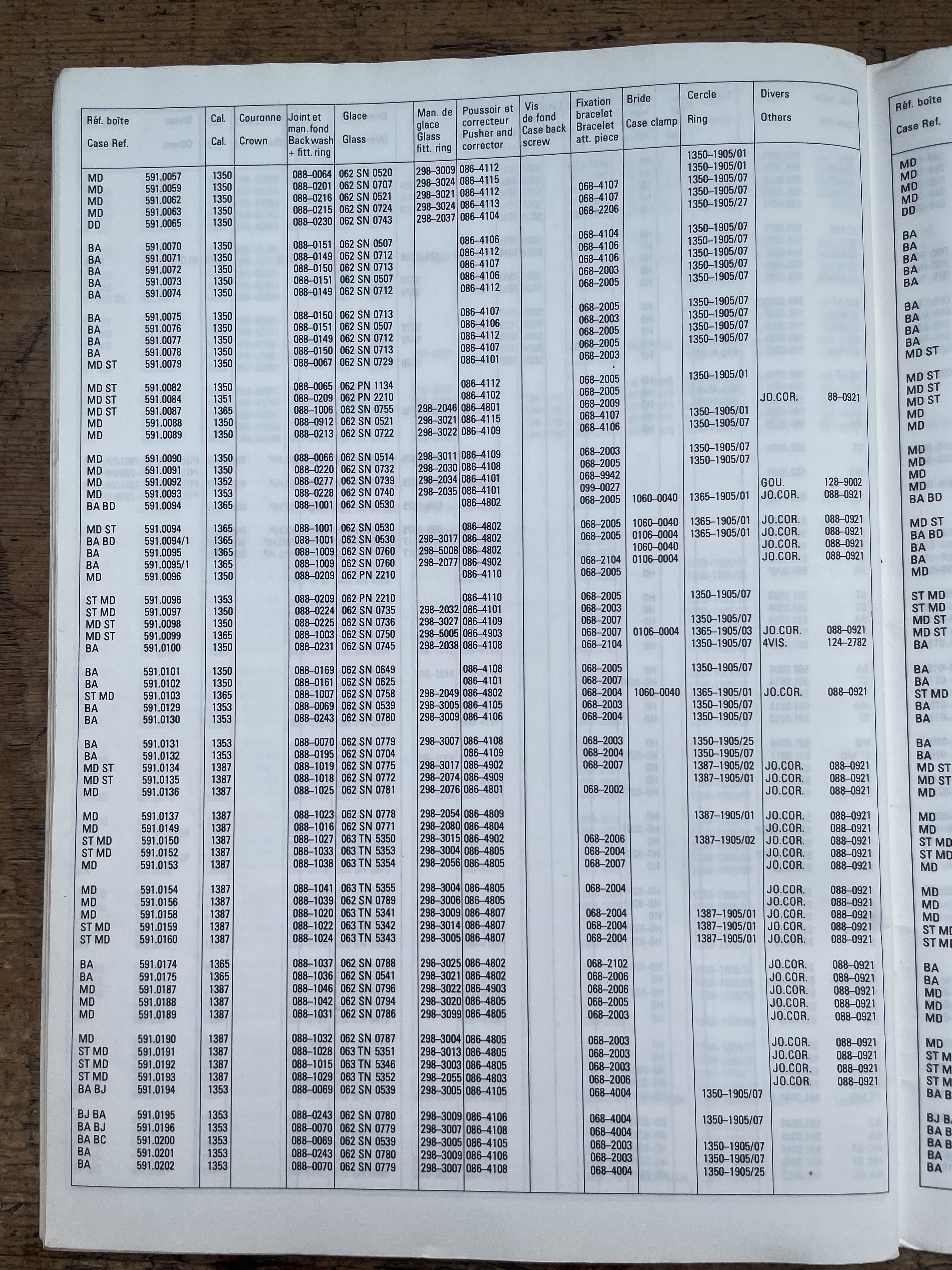

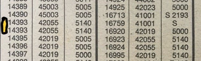

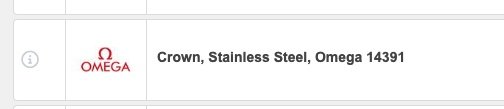

Hi all, I am struggling to find a (lost) crown for a 14391-8 case... Cousins says it's unavailable, and doesn't report the crown number. The table on 1st page of this thread doesn't show the case reference numbers. Anyone can help me? Thanks a lot.
crown 42055 (thinking that maybe there is an error in the table) has 90 stem, while I have 120 stem measure. Could it be 45003?

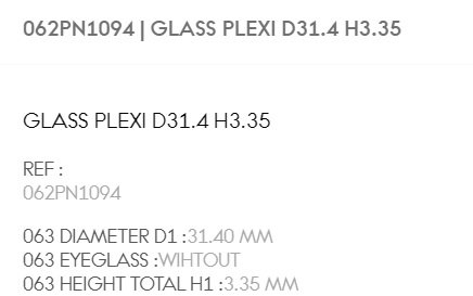

062PN1094 is the crystal for this watch, and yes OD is 31.4. Note that this is not a tension ring crystal, so it is not pressed in. The OD of the crystal is collapsed slightly in order to get it installed.

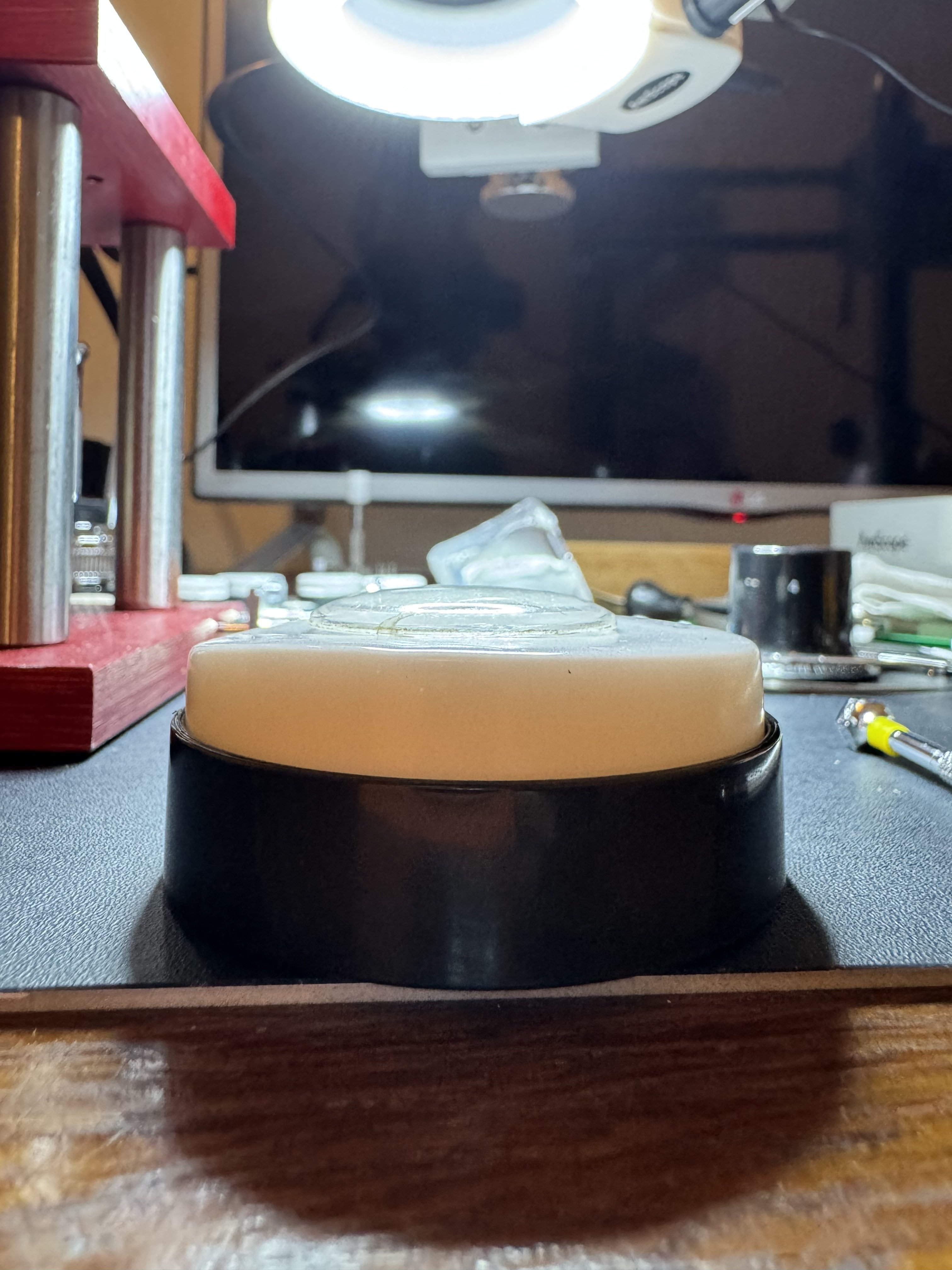

Hi all!

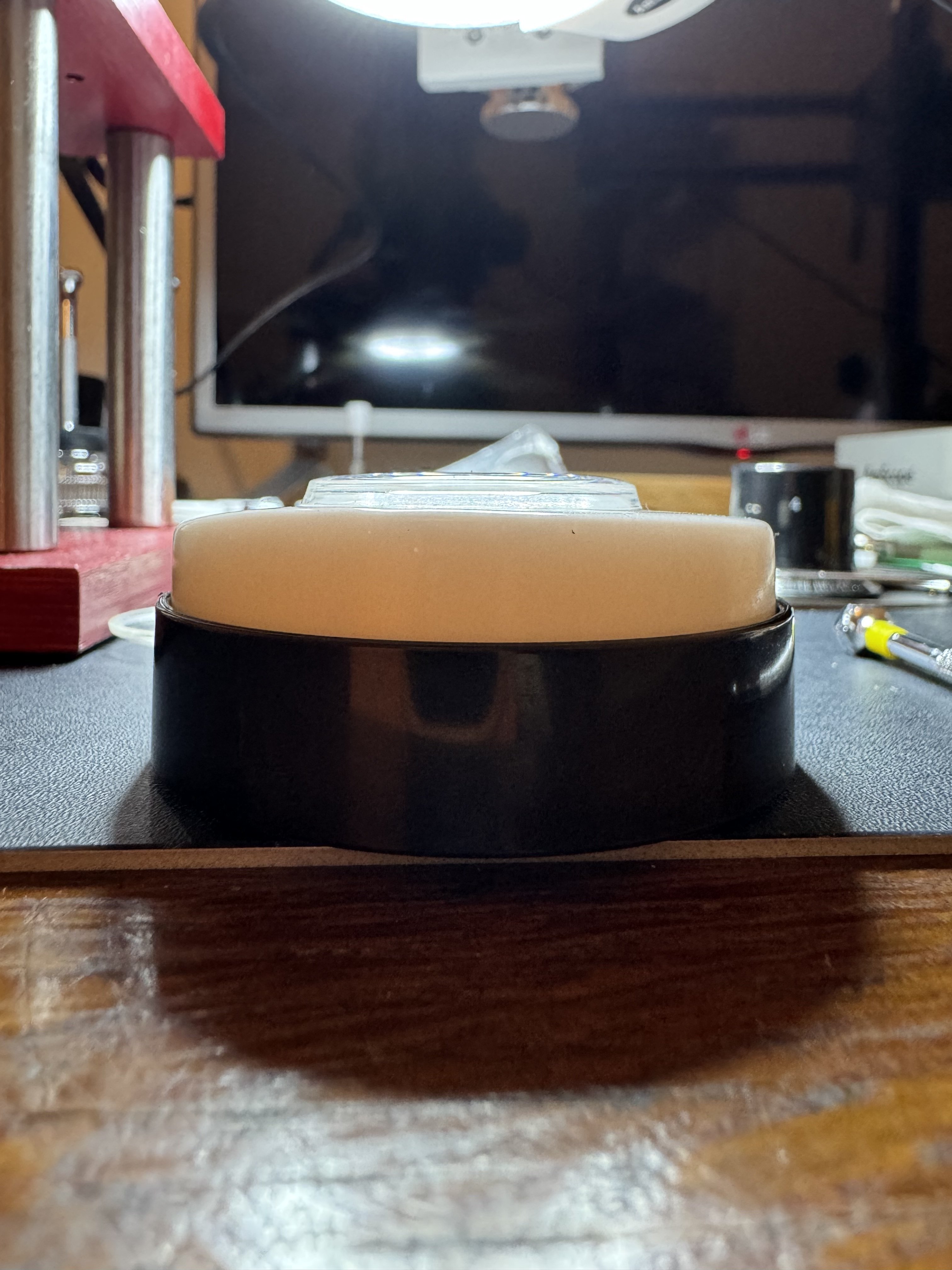

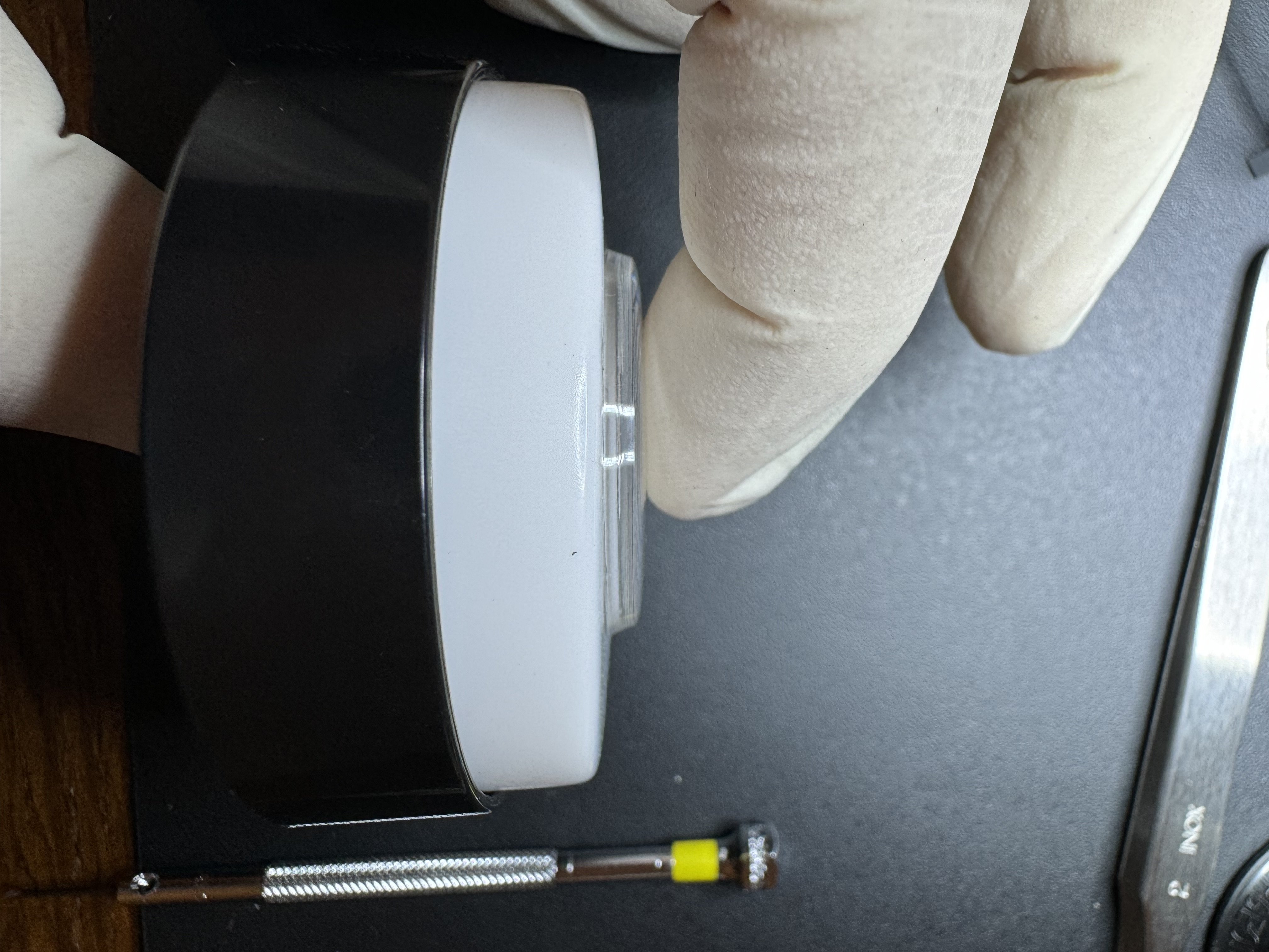

I finally got my hands on a 062PN1094 from Perrinwatchparts and it doesn’t fit on a 2383/2400 case. it is wider than the previous crystal installed, almost 31.7 and flatter (2.85mm vs 3,35 announced).
They told me before the order it was their last one and that the blister had been opened for pictures purposes but it seems quite different from what I expected.
and of course it won’t fit neither a 2383 or a 2400 case :/
29,672
76,830
Hi all!
You can send them this...
739
1,026
I did send them an email with my measurements, I’ll see what they say.
But as I measure it with my digital caliper at 31.68, there is no way it can be the right one is there?
Here what it looks like :
And the previous one :

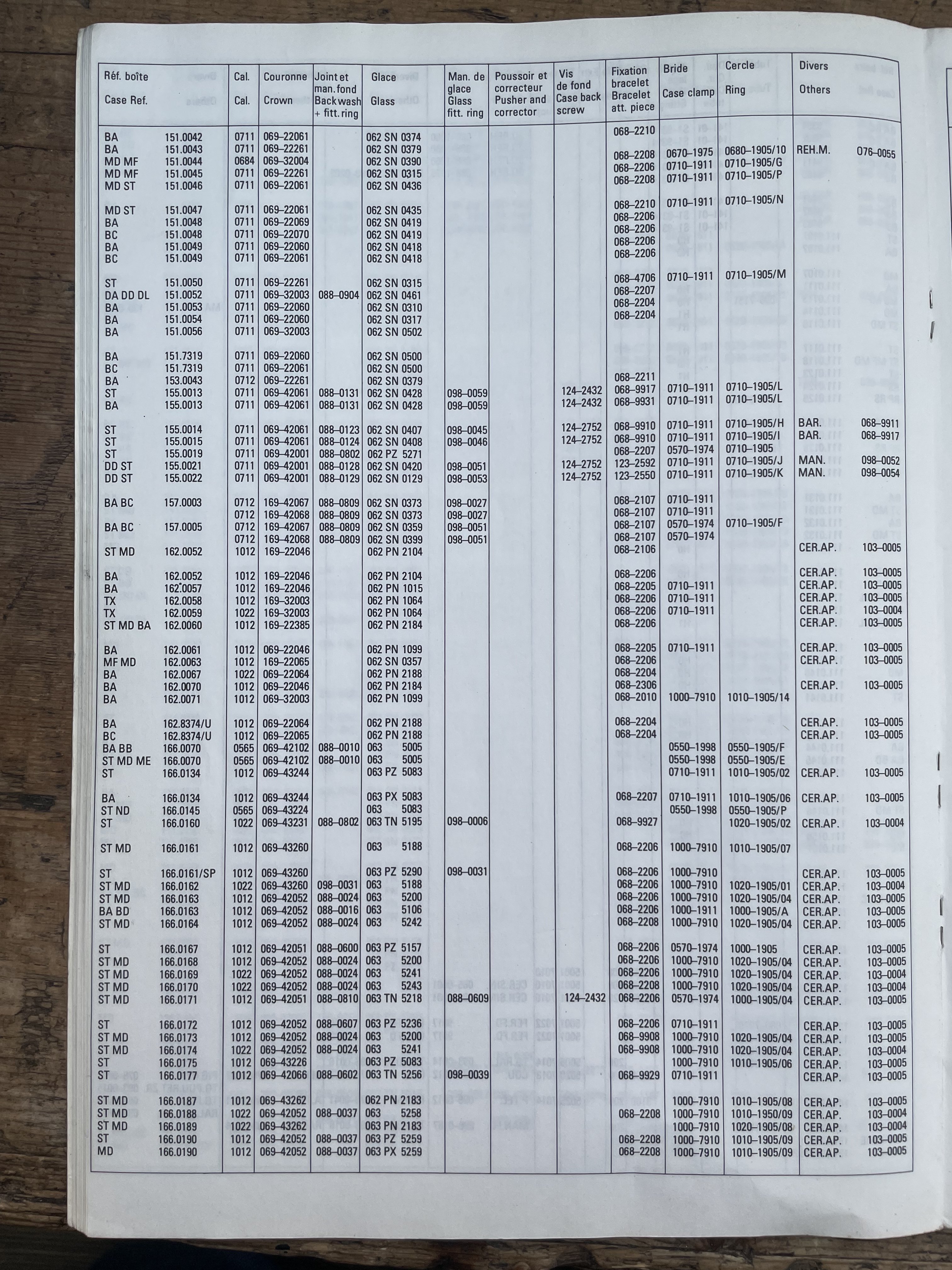

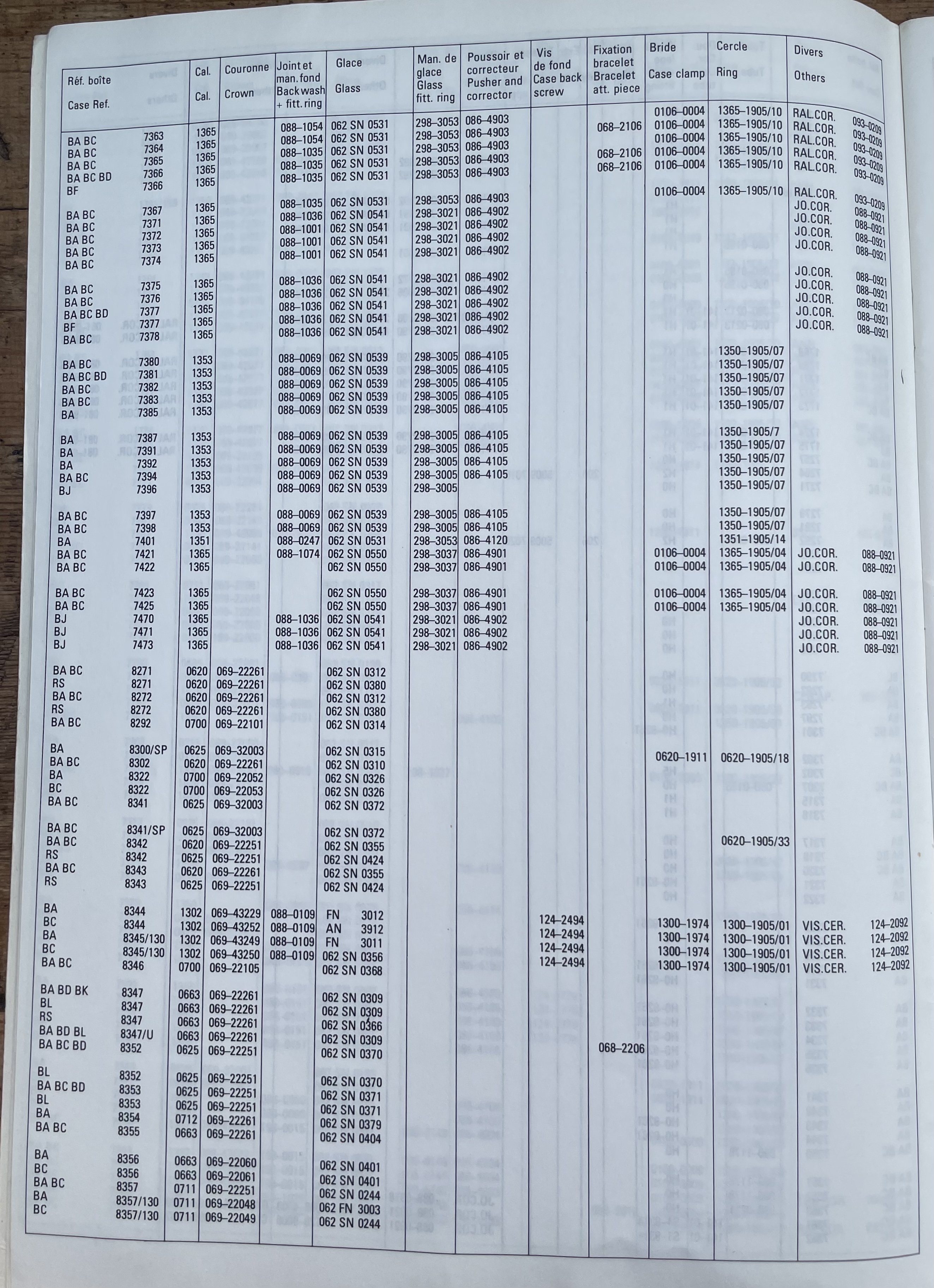

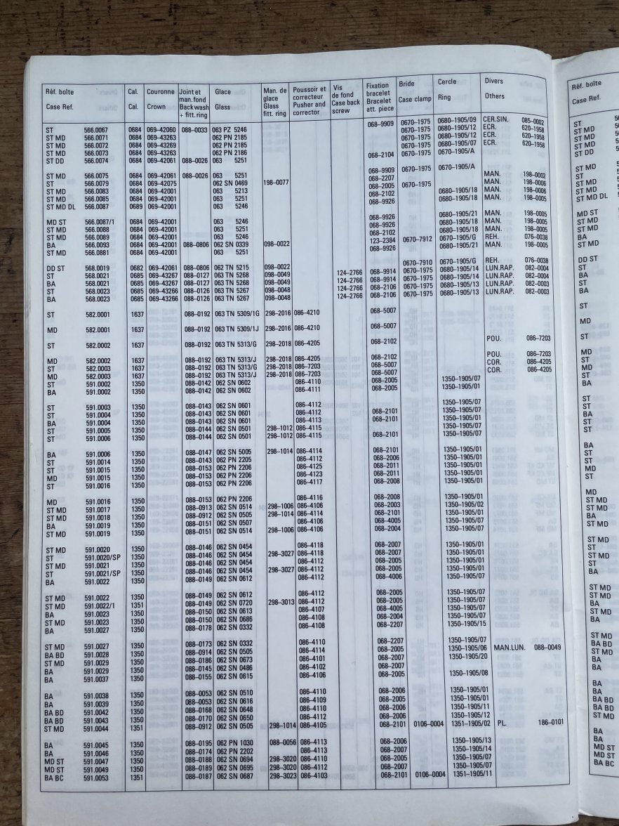

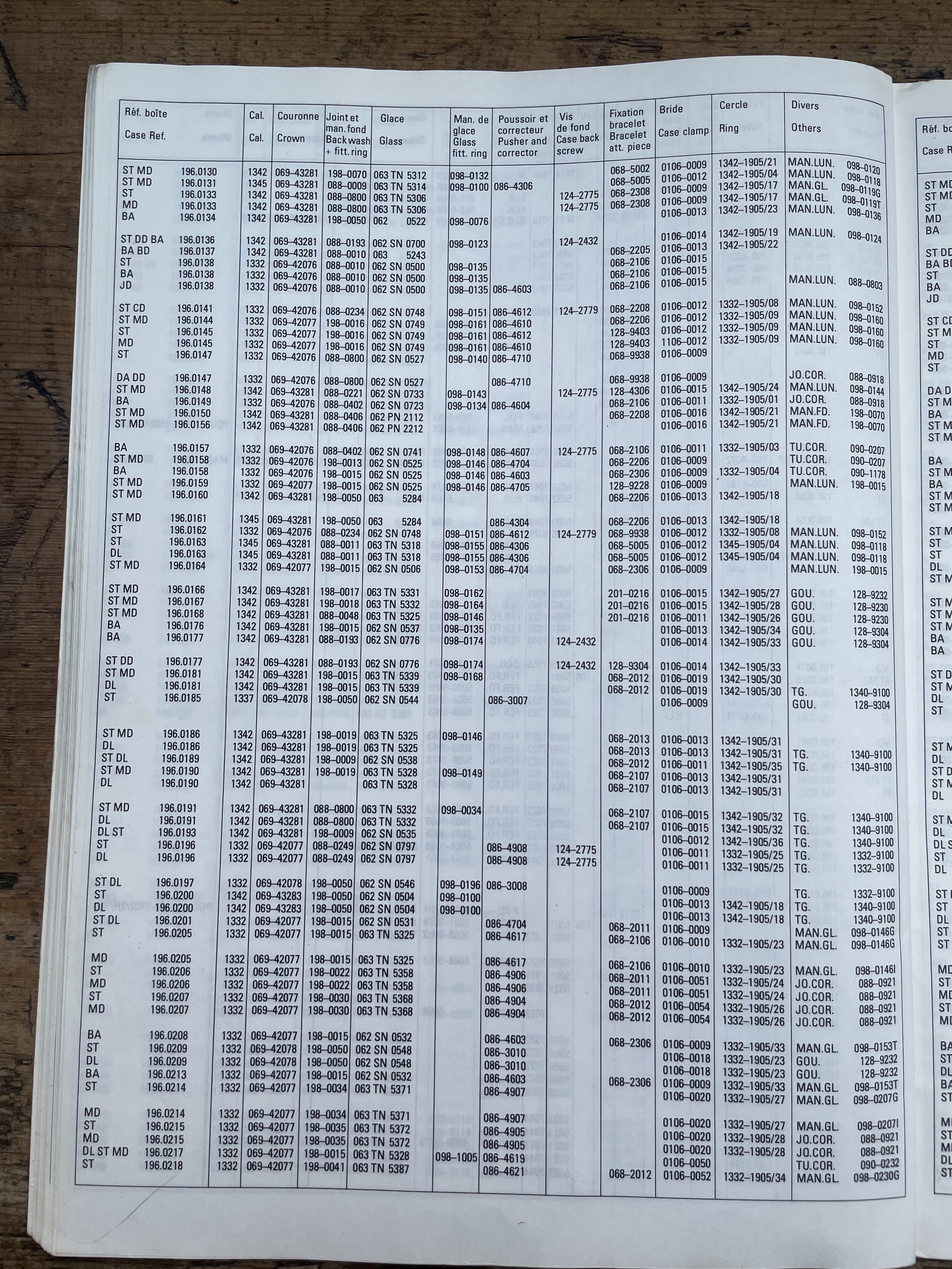

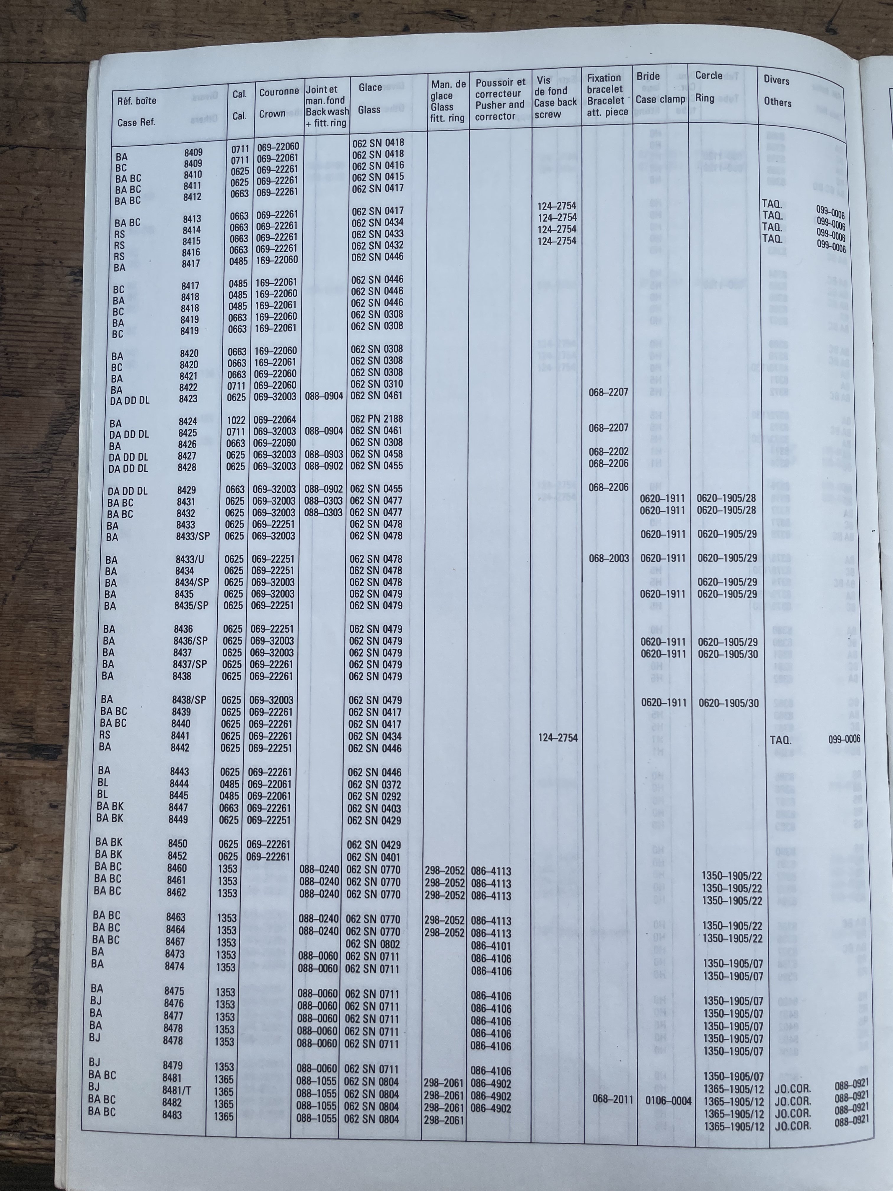

is there a digital copy of these reference guides? i feel like an accessible, searchable digital document will answer a good deal of the questions that pop up in this forum.
2,842
4,537
A lot of the PDF scans have been OCR converted. Not always the easiest thing to search as the source often comes from a fax or some other sheet feedeer what can cause sections to distort.
Photographing the pages on the ref manuals often leaves the curve of the page.
OCR is pretty common these days. It was pretty well worked out in the late 1980s. Even more so in the 1990s when autocorrect became the normal. With AI it can get pretty close although 99.999 percent still leaves a lot of errors.

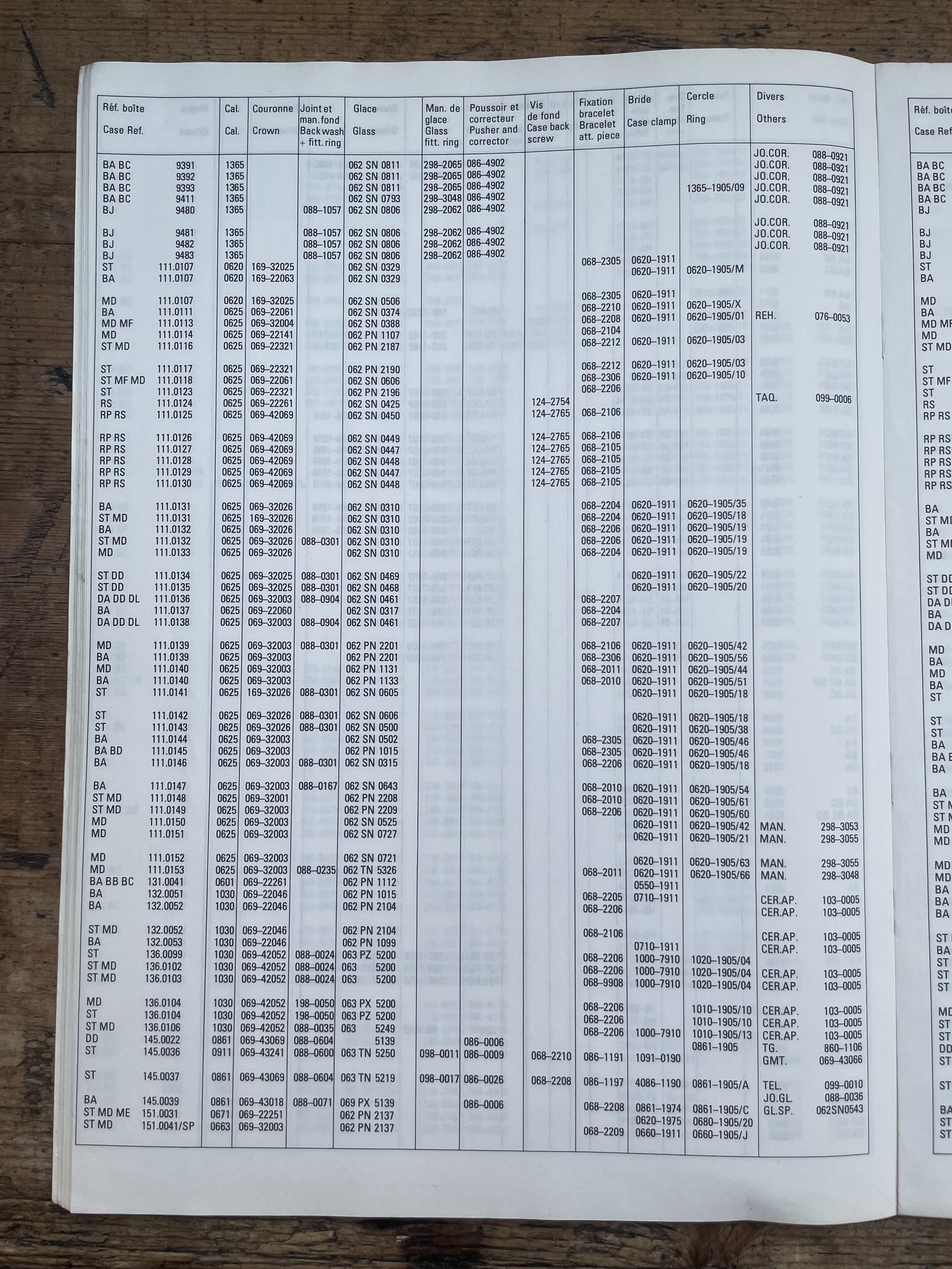

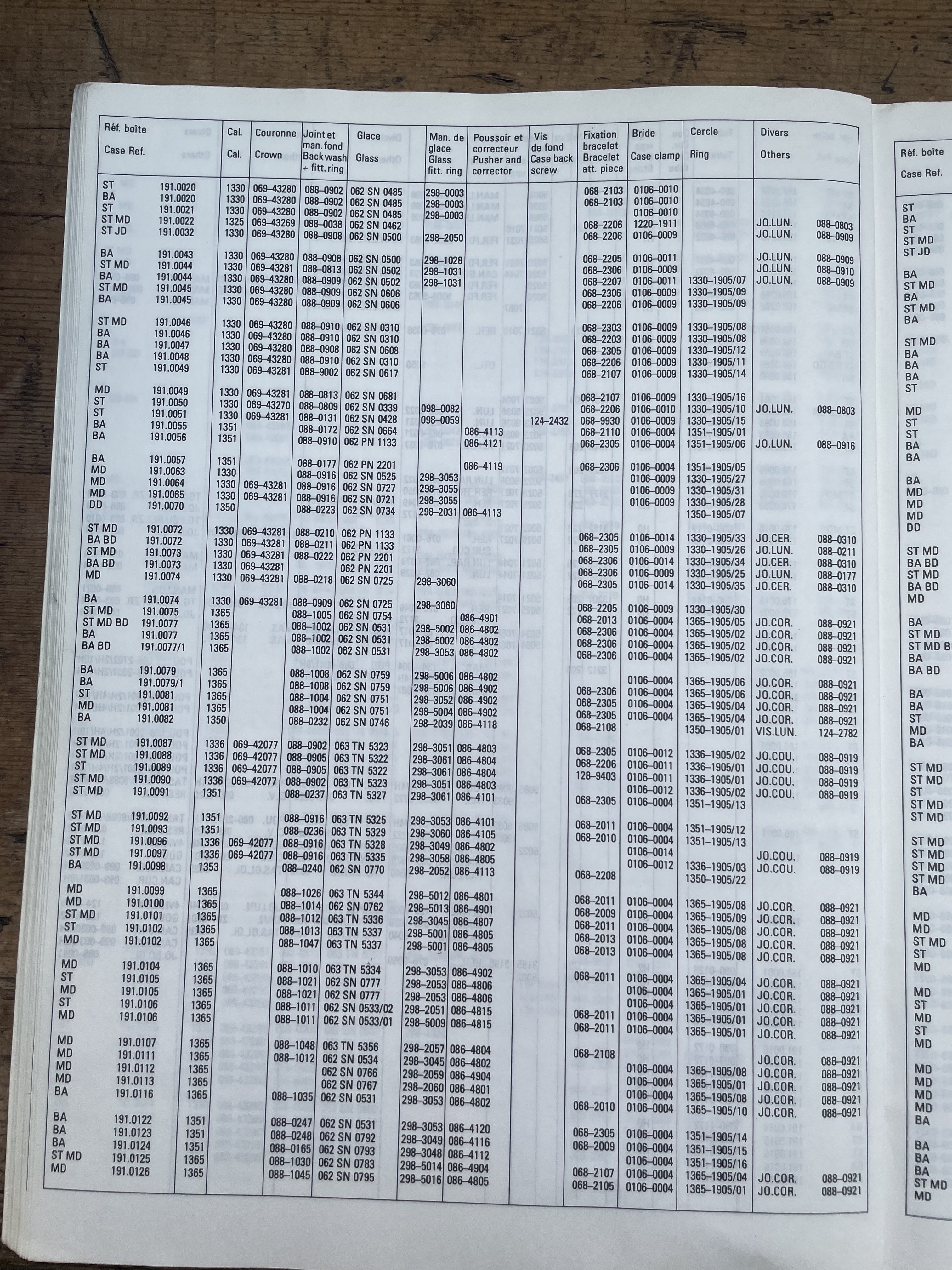

Hi, I'm not seeing a crystal number for a 2982 1 SC case. Do you know where I can find it?
29,672
76,830
063PZ5005

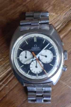

Hi thanks for the amazing thread! I'm still struggling to find a non Omega branded crystal for my 145.016. The NOS are crazy money. How does one identify for example the Sternkreuz model number for my watch? Thanks in advance and attaching a pic👍🙏

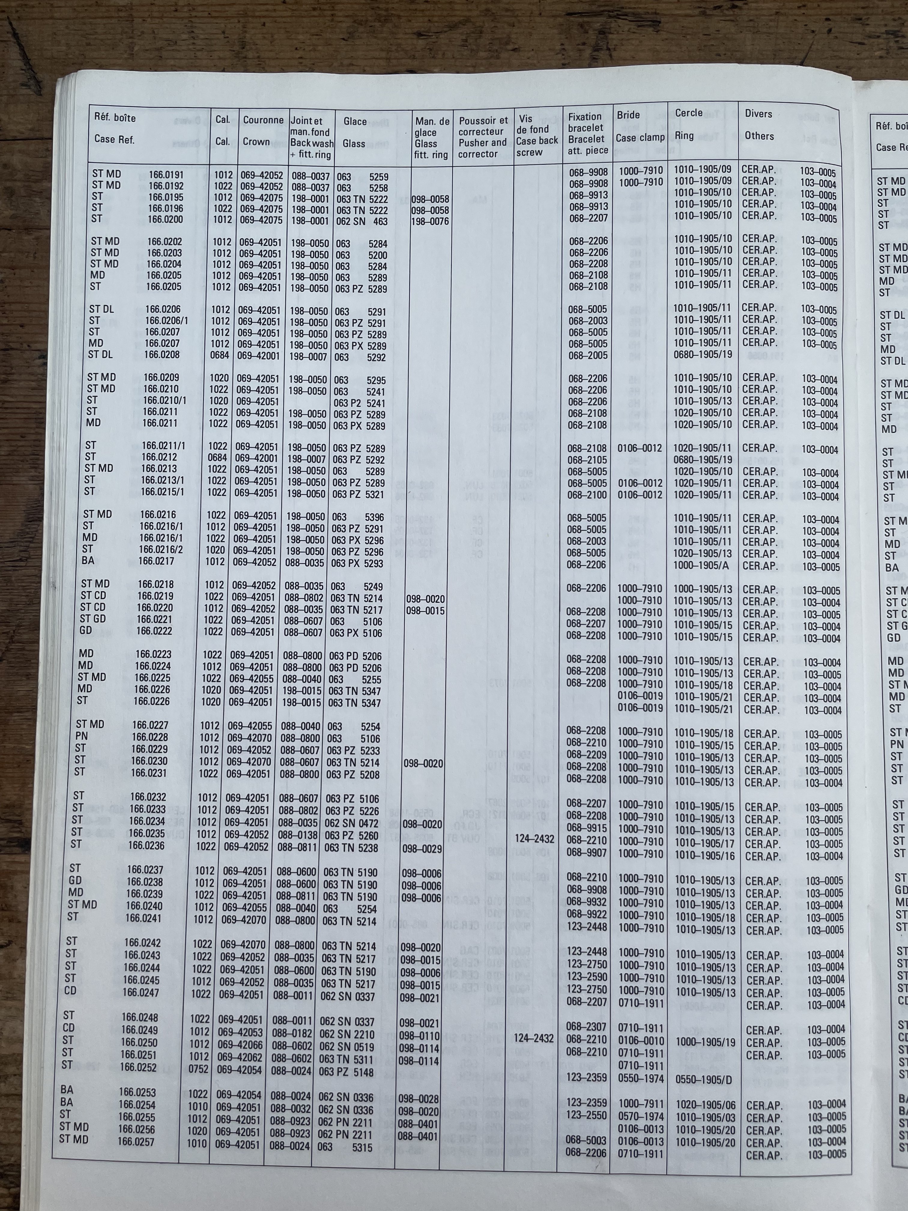

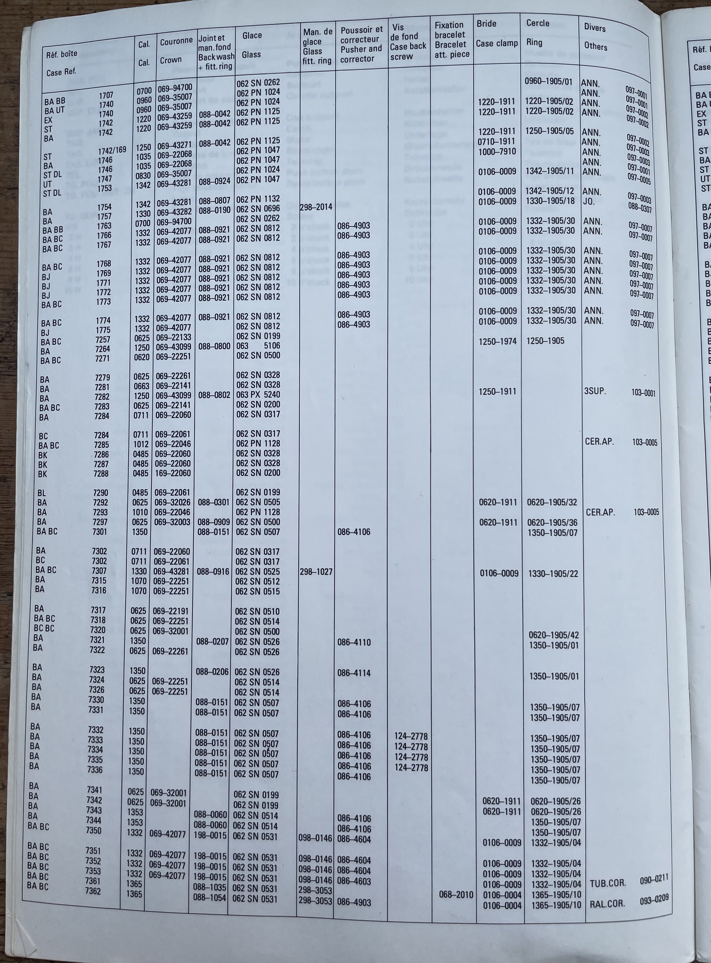

hello! I went through the documentation and was unable to find the crystal number for a Ref. 2933. Any idea idea on if there is a neighboring reference that would have a similar crystal?
Thank you for any help!
939
3,881
Double checked and re-reviewed all the lists but did not see the ref. 3999-sc. Does anyone know the crown replacement part number?
Thanks!
133
115
I was able to solve mine in bit of a reverse way.
I carefully removed the crystal and the used a pair of dial calipers to check the OD of the crystal. from there I searched ebay for a range of diameters that were near that and see if I could find anything that matched it visually and was also omega related.
